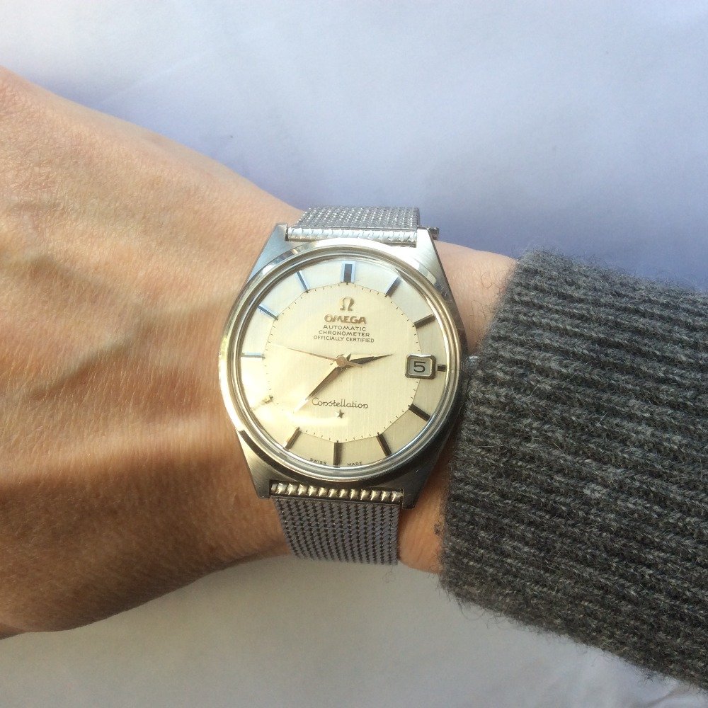

Hi, after being a lurker on this forum, I have bought my very first vintage watch...Constellation 1968 monocoque case 168.025, 564 movement. I'm very happy with this beautiful watch but do have a few questions, hoping some people on here can help.

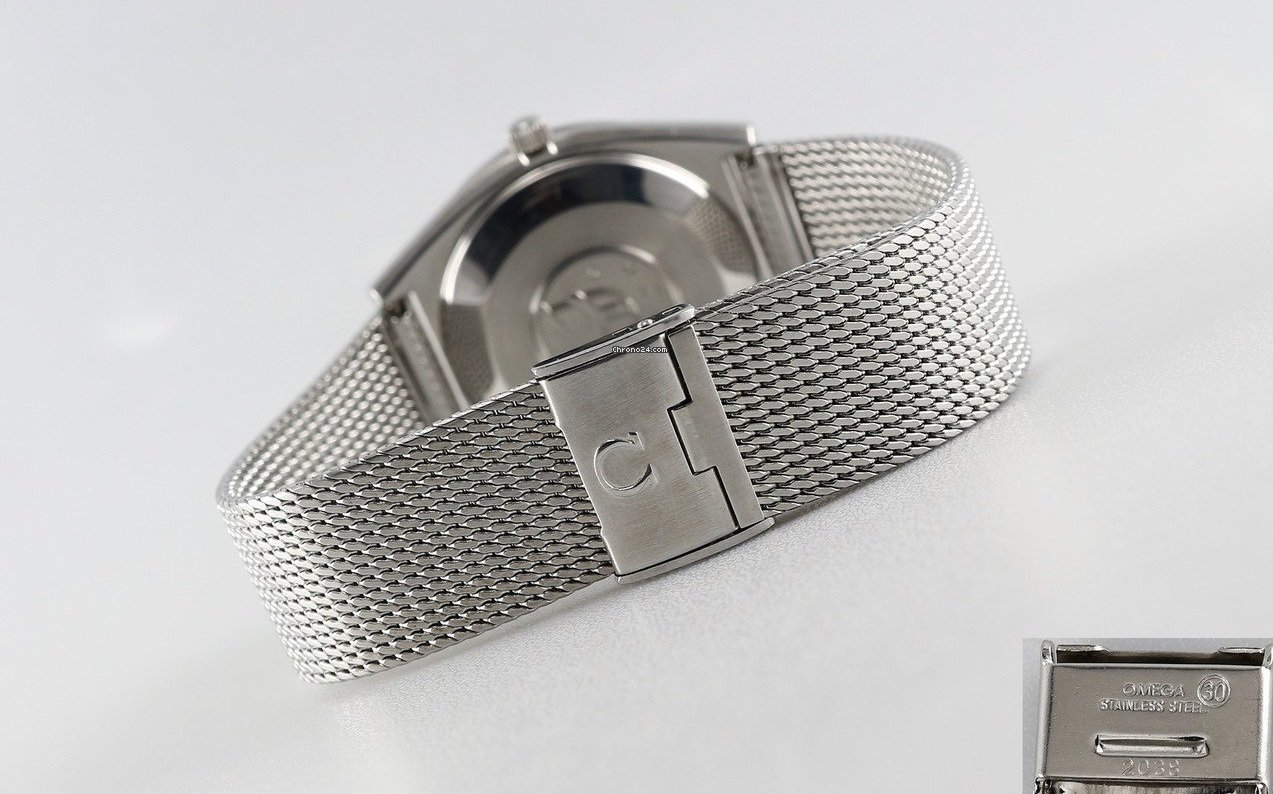

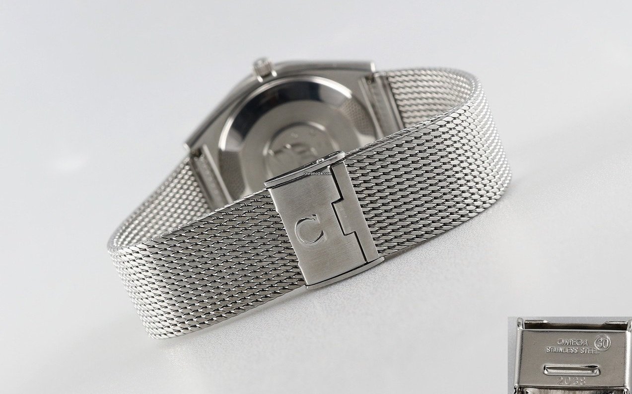

Bracelet catch - The other thing I'm not sure about is the bracelet clasp/catch (Omega 2038 milanese bracelet, sold as orginal bracelet). Until now I've only ever owned modern/new watches where clasp fastens with a strong click and you need to really get your fingernail under it to pull it up and take the watch off. I noticed if you fasten the clasp very gently, it closes very 'softly' (minimal or no click sound) and then (if you flick fingernail against edge of clasp as if to open clasp) there is a tiny bit of play where it will move out slightly by about 1mm or so as if it was going to open (although it doesn't). The clasp seems to catch much better/tightly If f I close the clasp very quickly and firmly with a bit more pressure (then I hear the click and it feels more secure). Now I realise this is a vintage bracelet and clasp so it wouldn't be like it was when it was new - I assume its reasonably secure, but the last thing I want is for it to open by itself and drop off my wrist! Am I worrying about nothing? Is there a way to tighten it? I have looked at it with a loupe but no idea how it works.
This is likely an OEM optional bracelet. It may also be possible that someone added a branded clasp to a generic bracelet. No way to tell from these pictures. A jeweler may be able to manipulate the clip to the proper position to give a little more security. I have several similar bracelets and have never had one fail on me, but your mileage may vary.

The watch was sold as having the original bracelet - I'm no expert so I don't know if it actually is the original bracelet (see photo) - but it came from a reputable dealer in Switzerland who has very high ratings on Chrono24. There is a good jeweller in my town which does sell vintage and high end watches, so I will take there to get them to have a look at it.
I am very pleased with this watch, this case style is perfect for me being female with very narrow wrists. As much as I love the dog leg style, it wouldn't suit me as much I think.

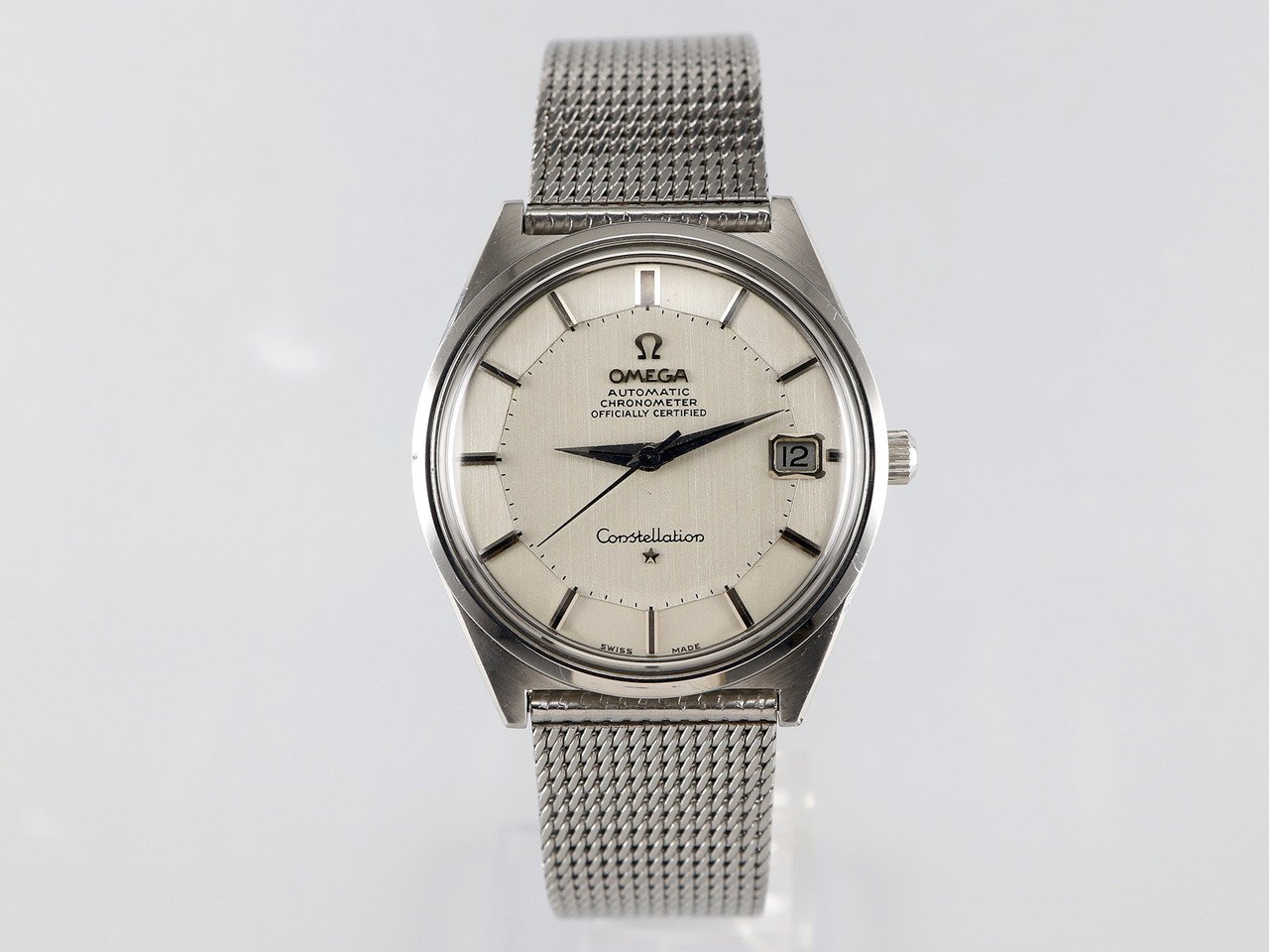

I've never seen this reference before, it's really nice. Looks like some sort of transitional design between the dog-leg Pie-pan of the 60s and the C-shaped ones of the 70s.
Thanks for posting it!

The 2038 and 2039 can release by tension if they are worn, so your worries are real
You could yank the part where there is the Omega logo with a screwdriver, gently, the 2 sides, increasing the width, this could increase closure tension
If you pay attention, there is a rail underneath, so while I don't know about the click etc. - you might be pushing it to a non-rail spot etc.
