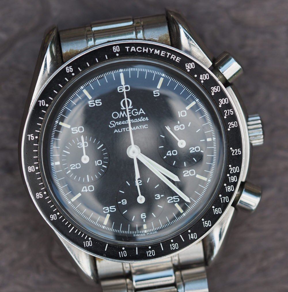

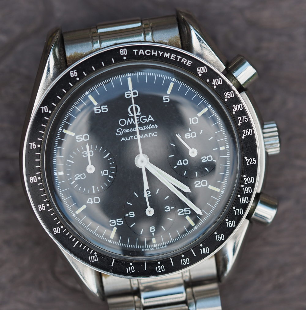

Many thanks for the response, that's good to know, would still like to get the vendor to sort it as none of my other Chronographs have this issue.
I'm assuming it's around the £500-600 mark?
Getting mine done cost £379 in 2016 -- no issues or replacement parts needed. Mark Lovik, that watchmaker, doesn't do servicing any longer it seems, preferring to concentrate on his training courses & videos. But there's a goodly number of recommendations for UK watchmakers with solid Omega credentials to be found in these threads.
