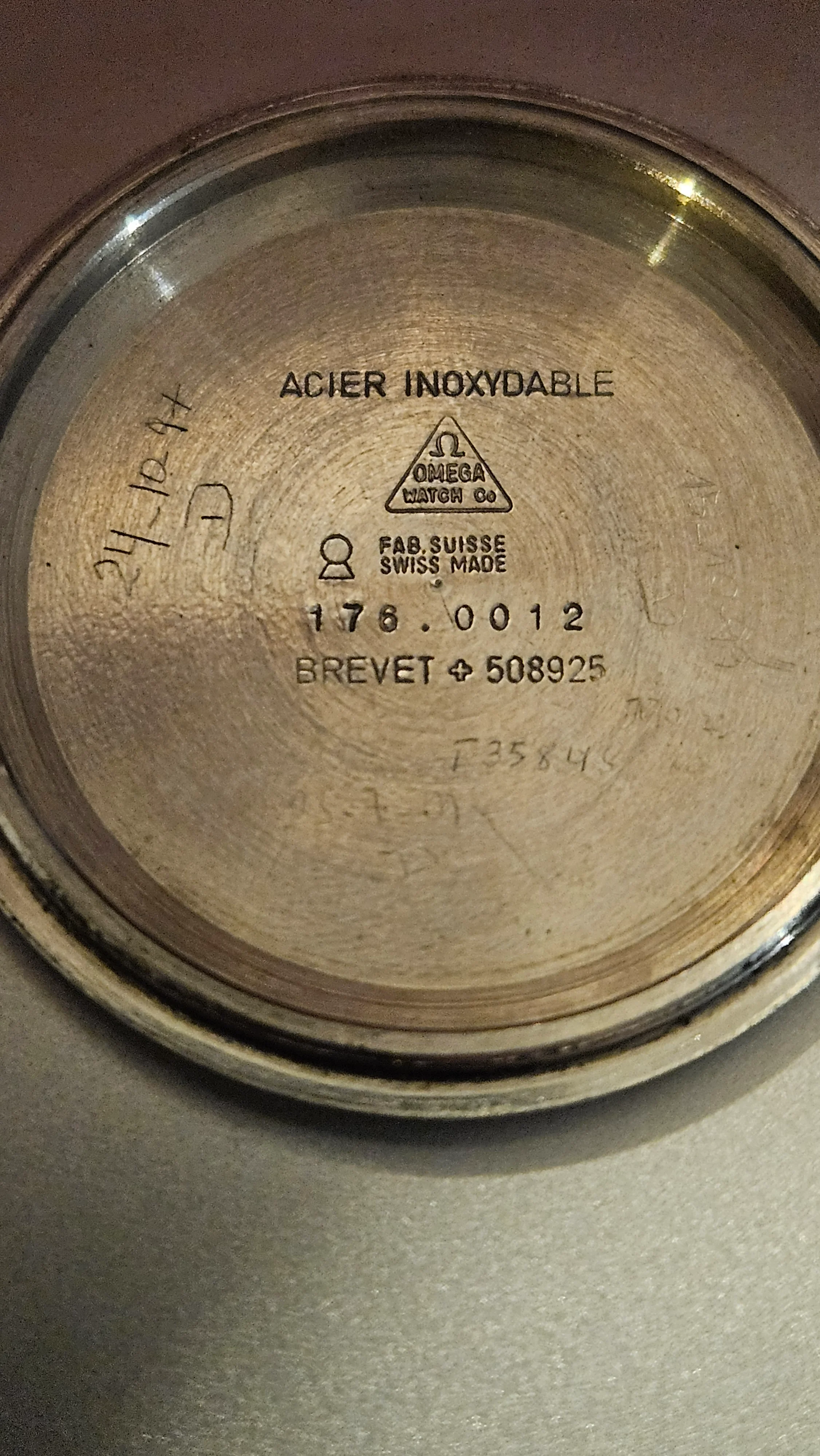

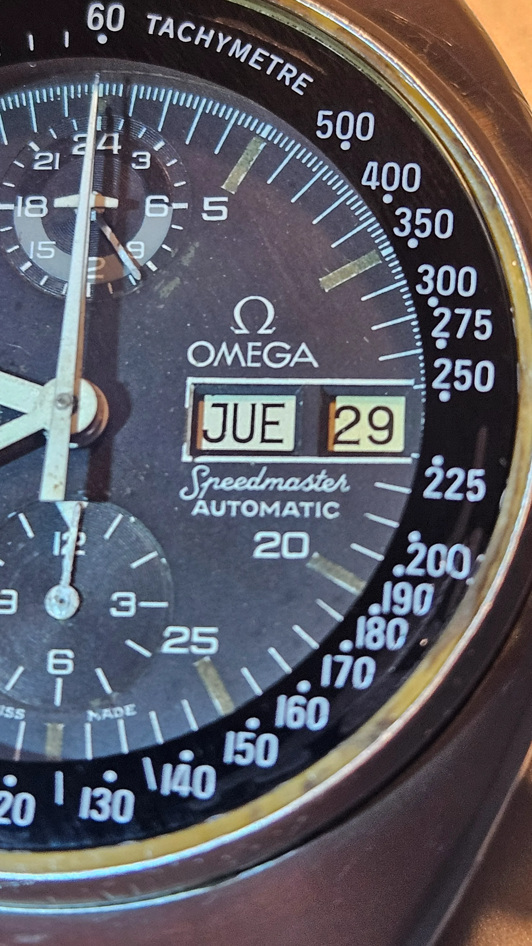

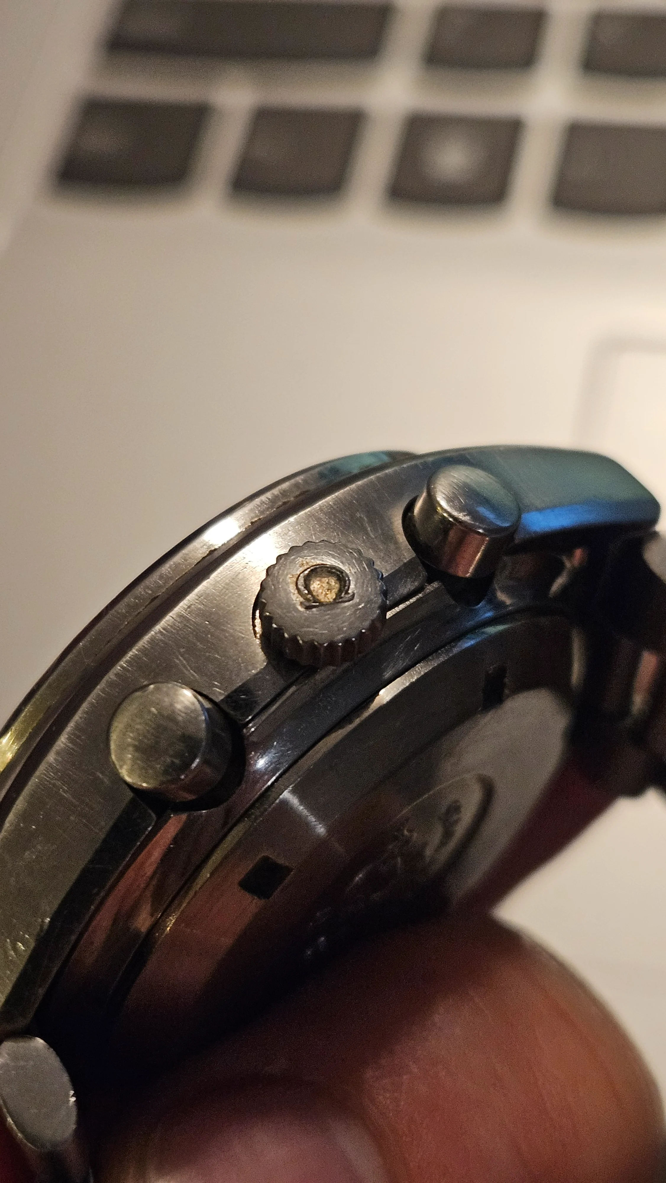

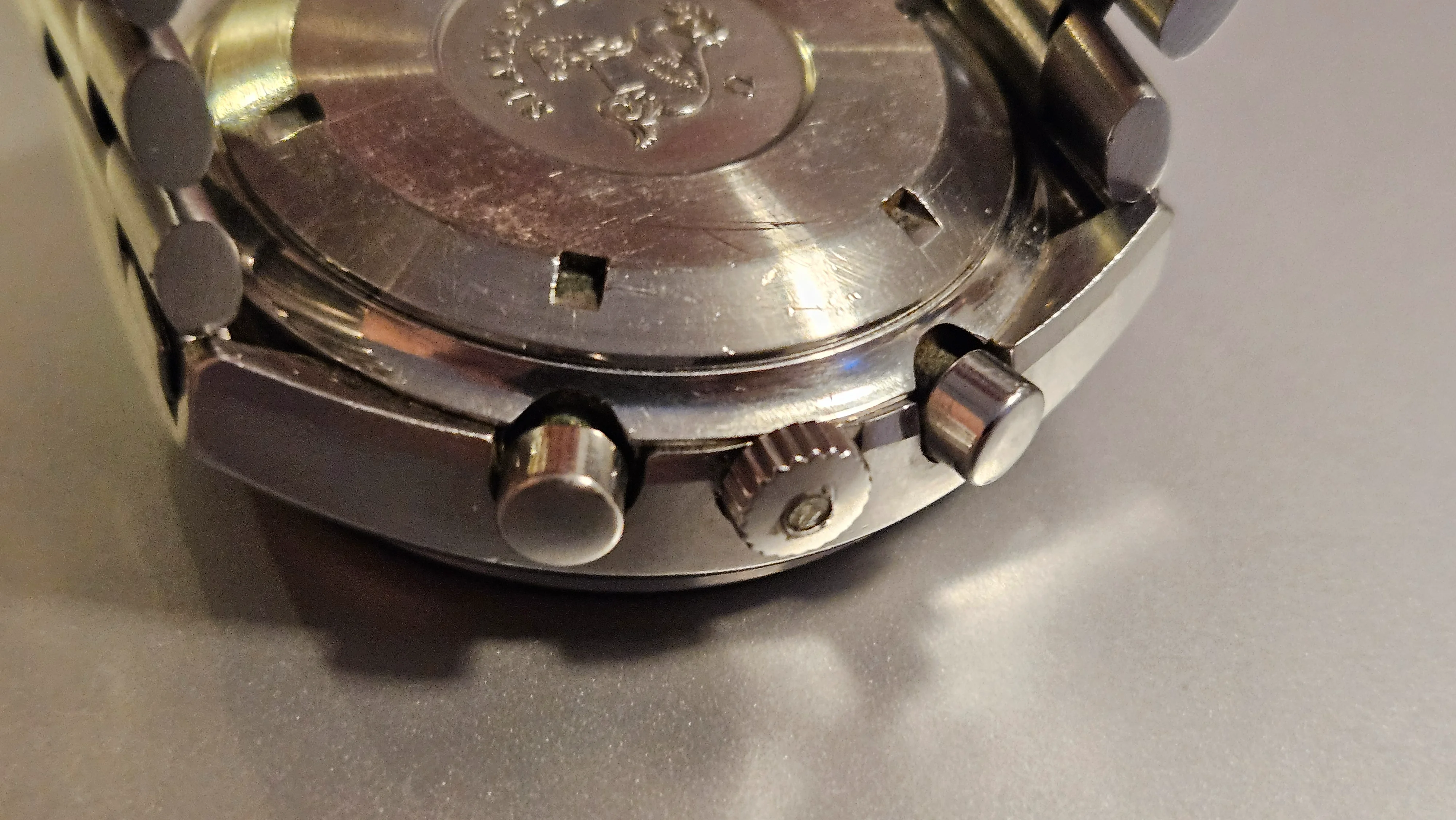

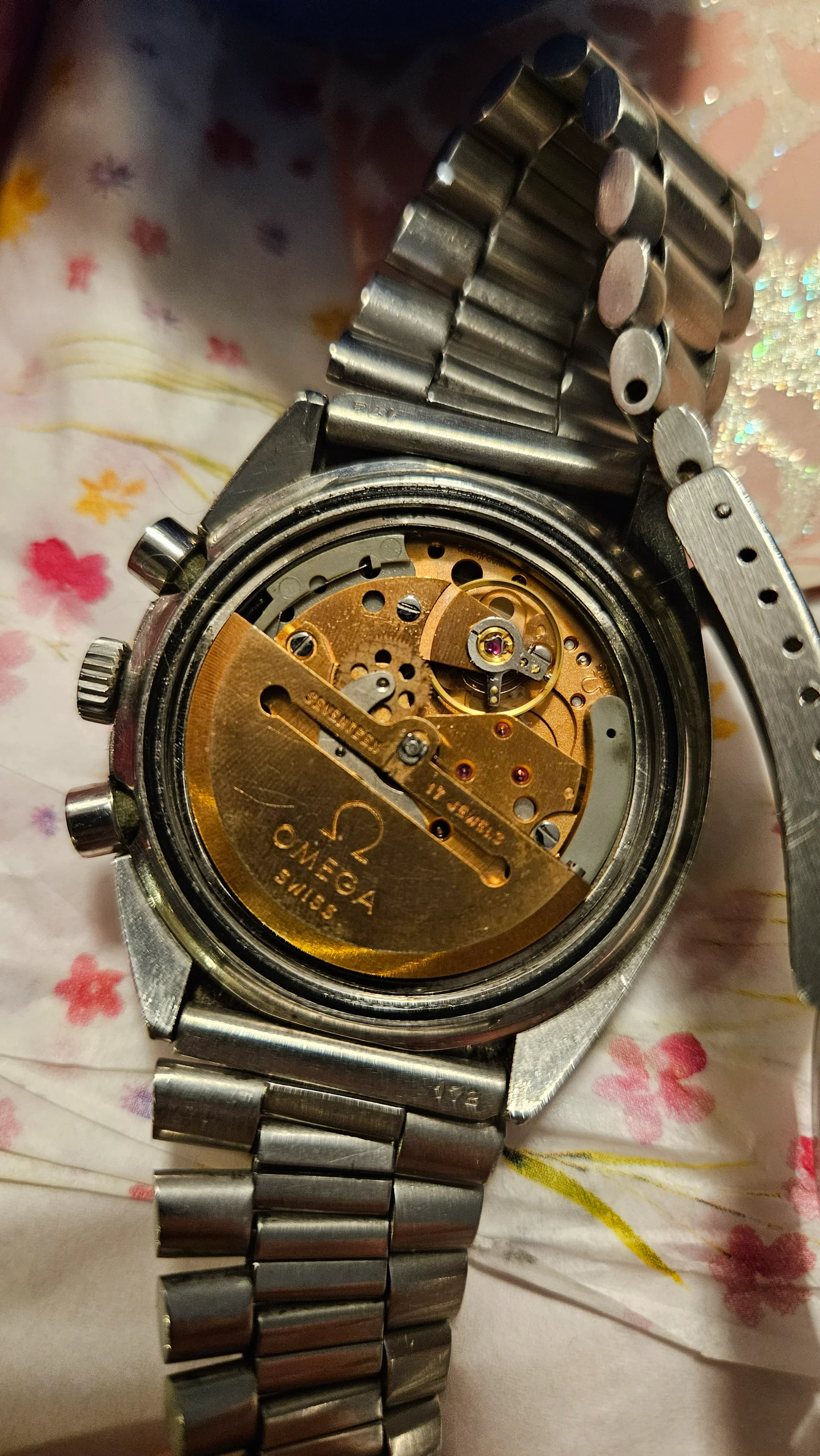

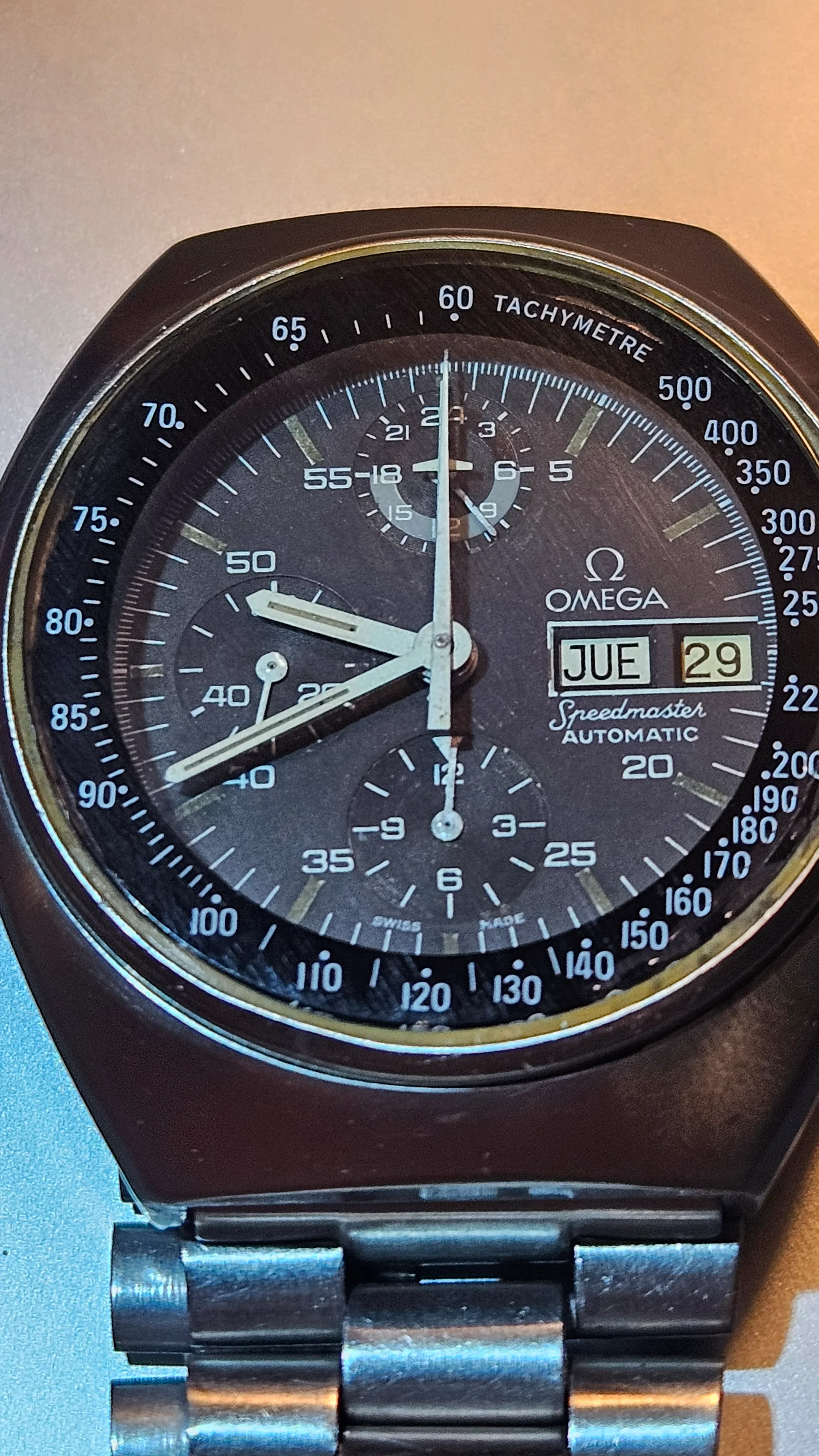

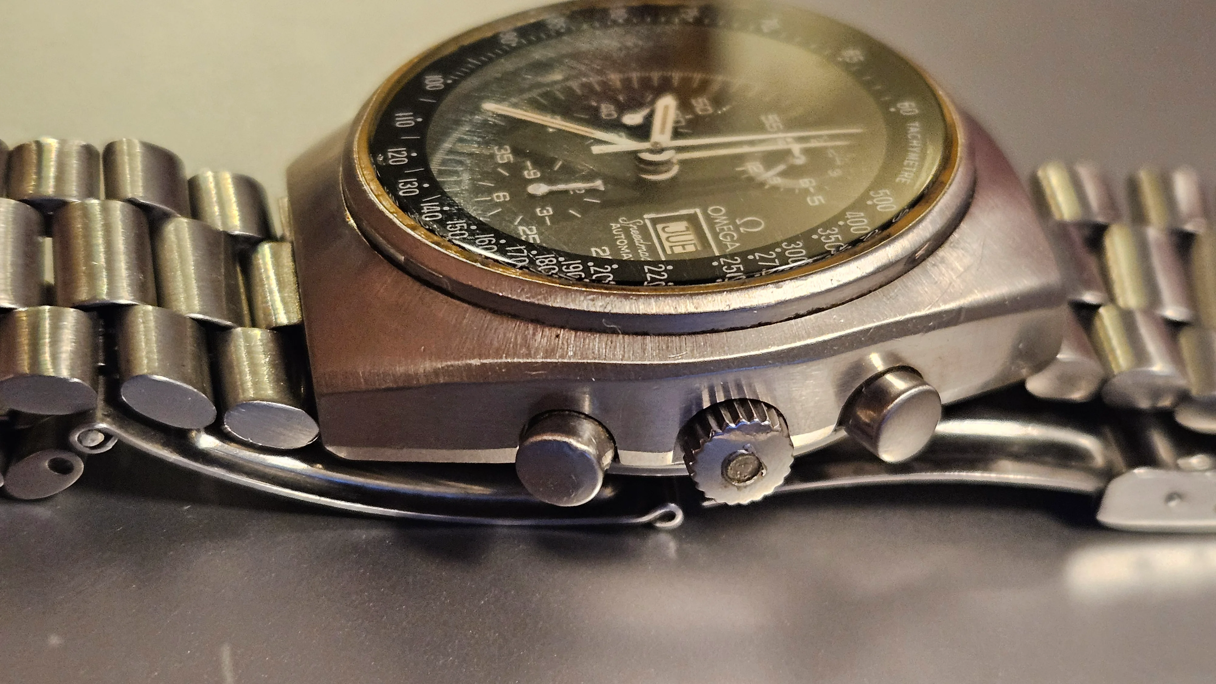

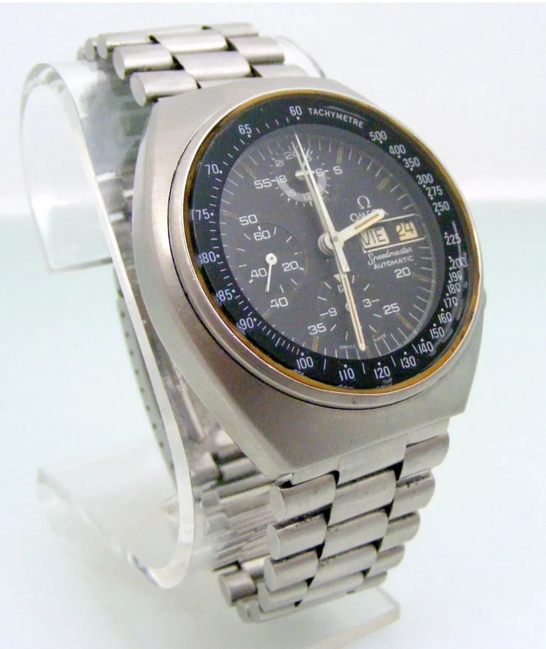

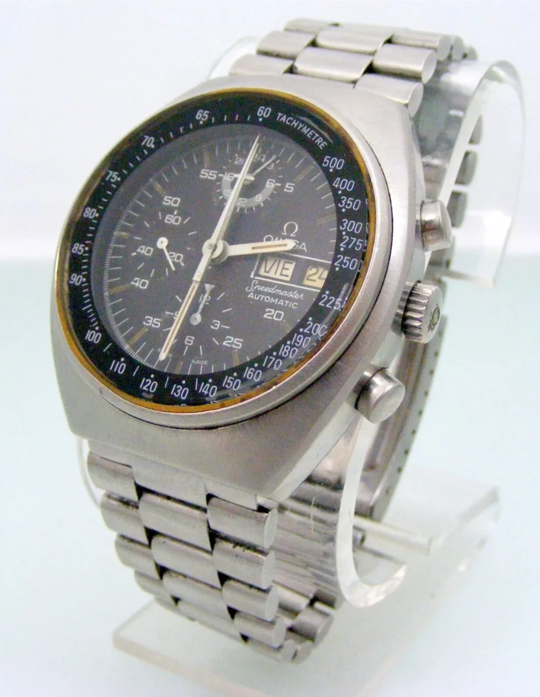

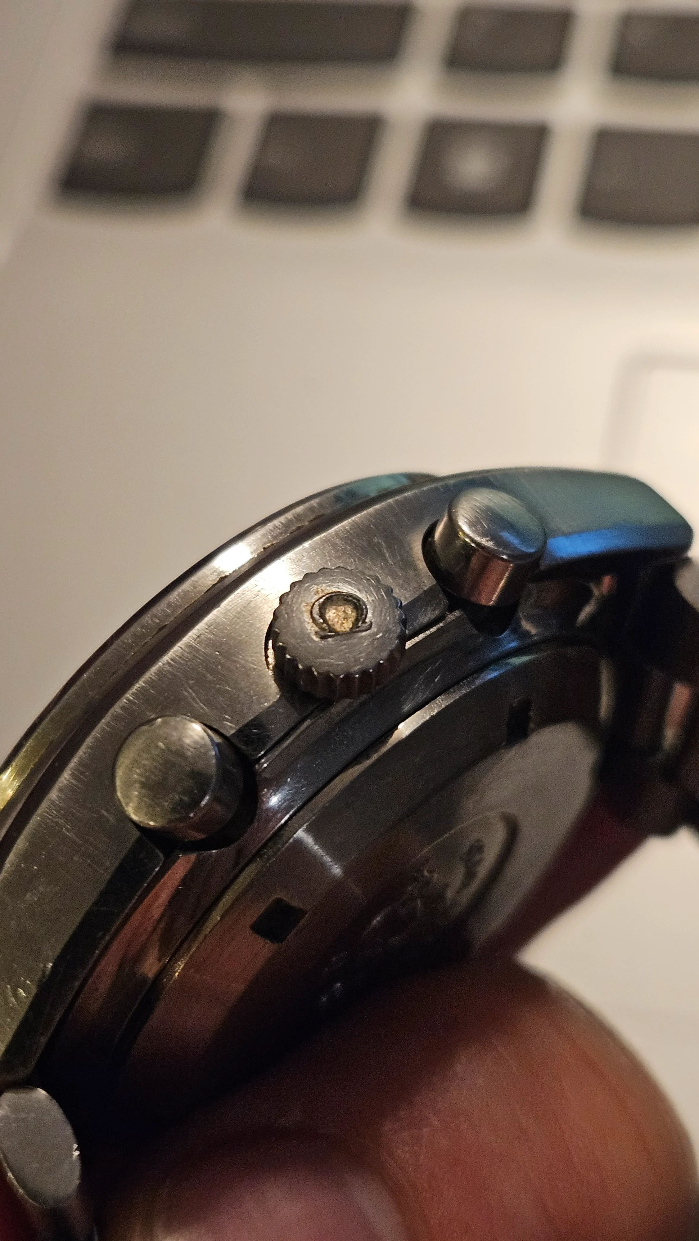

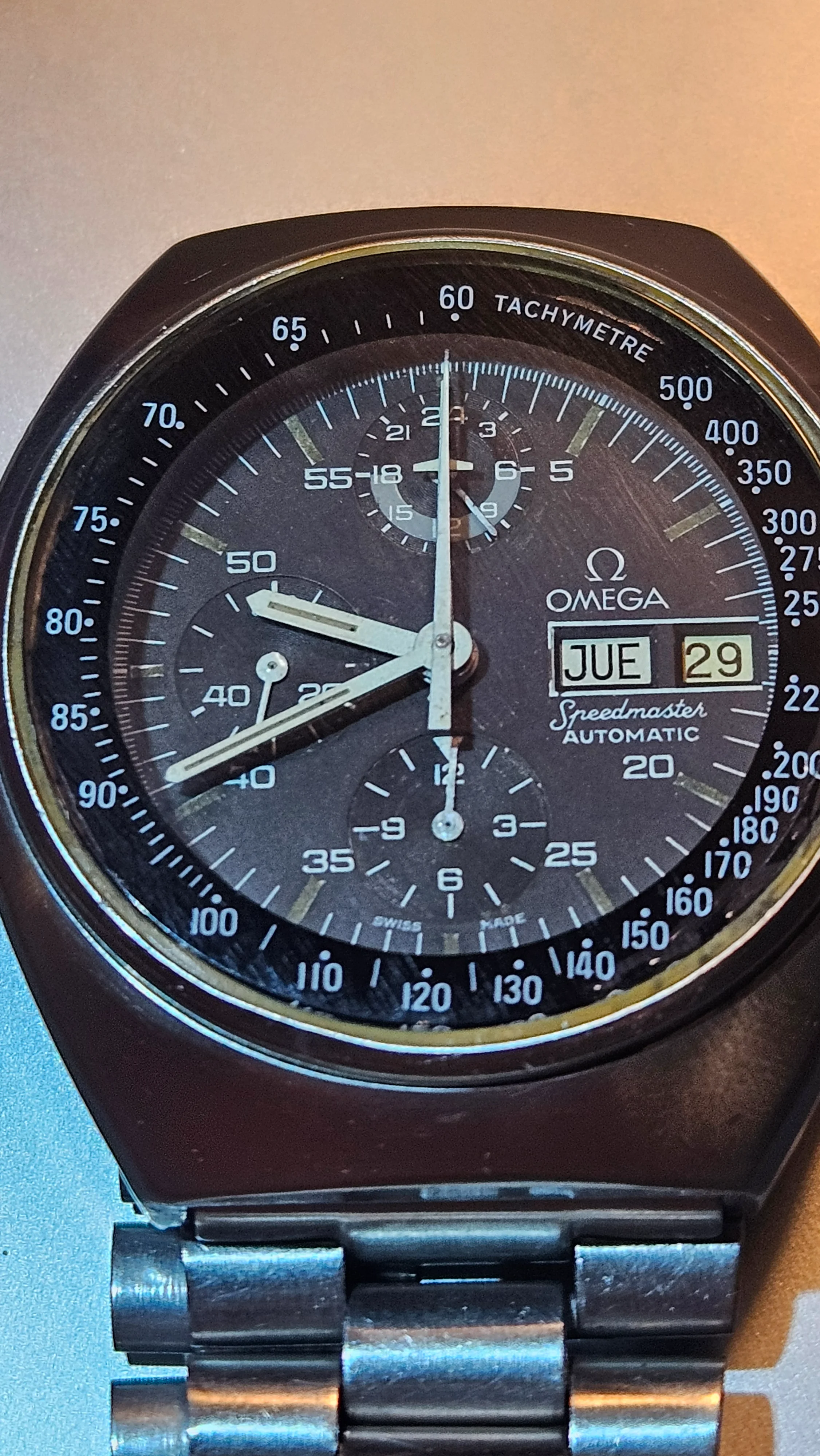

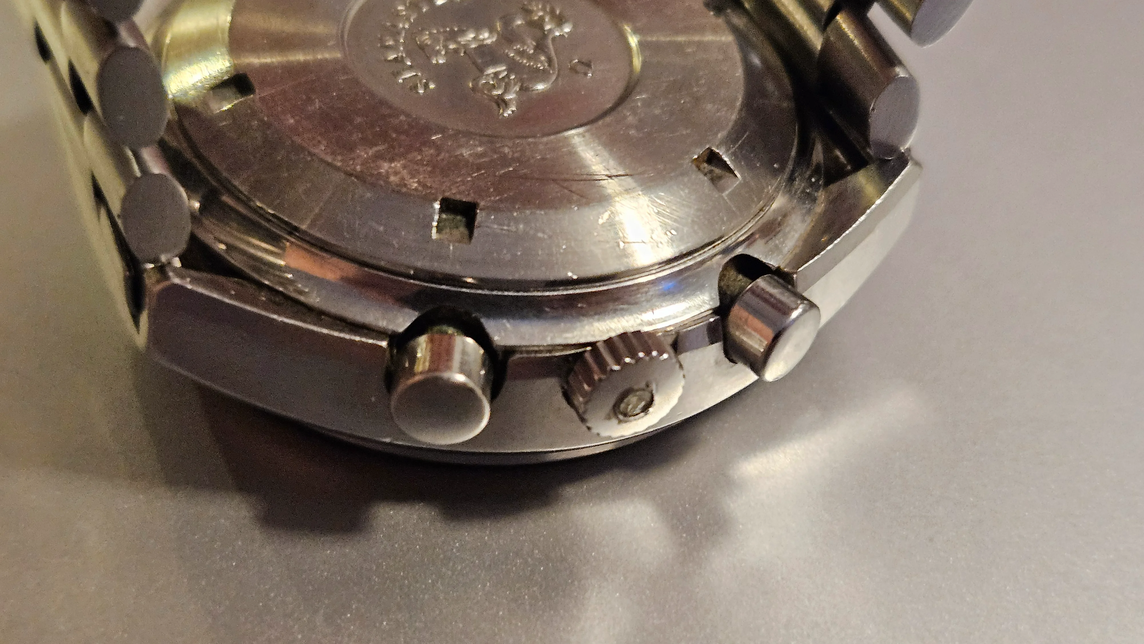

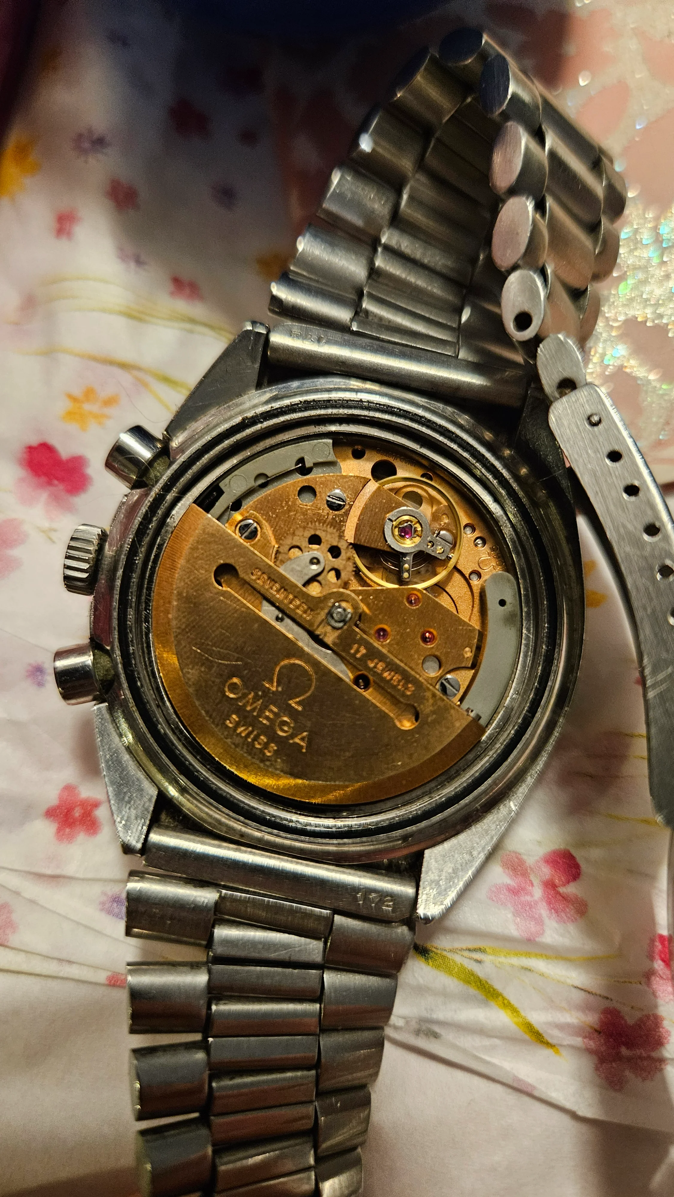

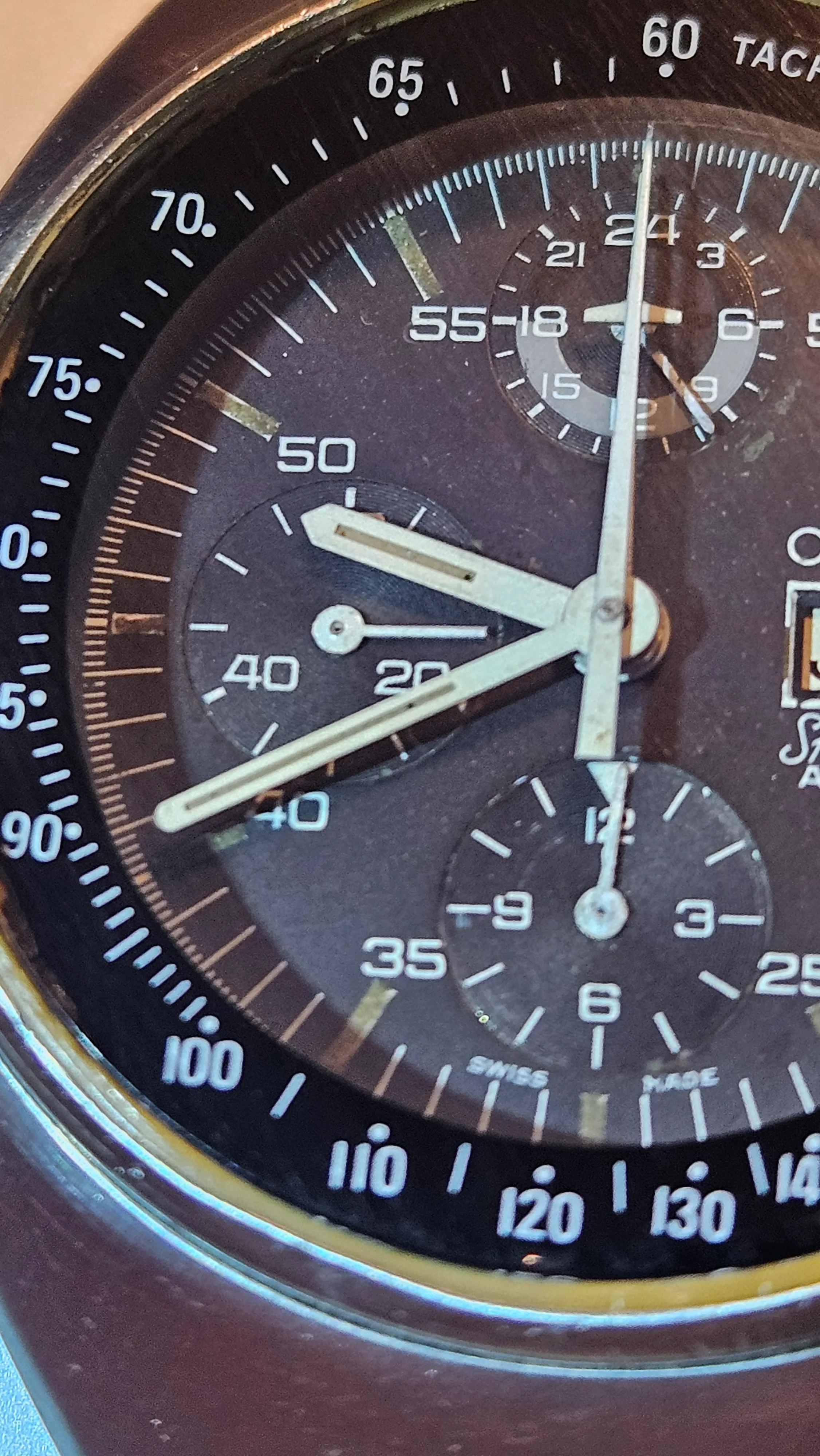

Just acquired this (my 4th vintage Omega) and very happy with its condition. Can I ask more knowledge members to check the pictures for any potential problems, replacement , non-original parts, etc.
It runs great, winds and sets time/dates smoothly. Small scratches all around, slightly rounded edges of the case, few service marks on the case back.

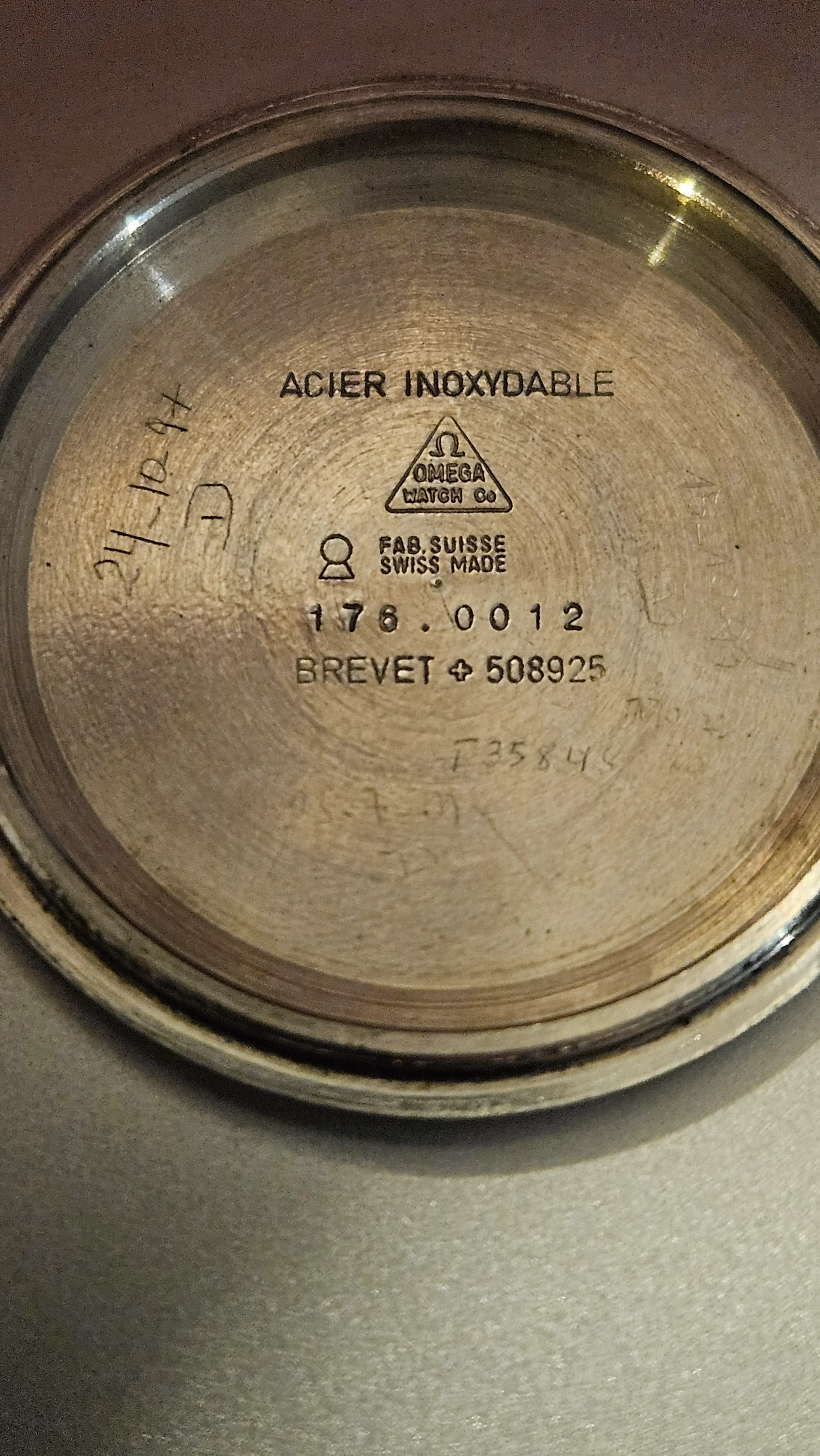

All marking appear to be correct but I can not find any serial numbers.
Any information about the year of production would be greatly appreciated.

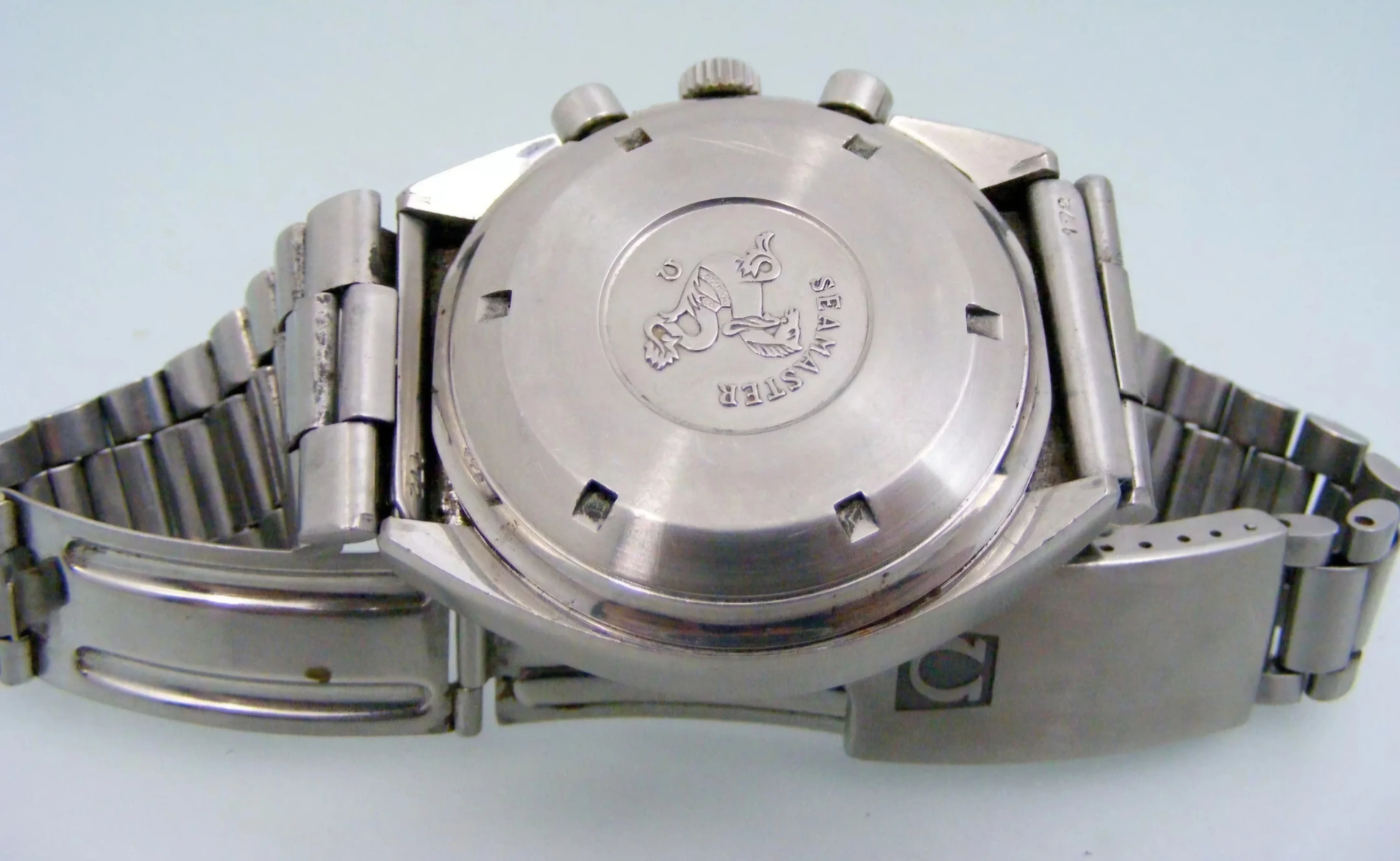

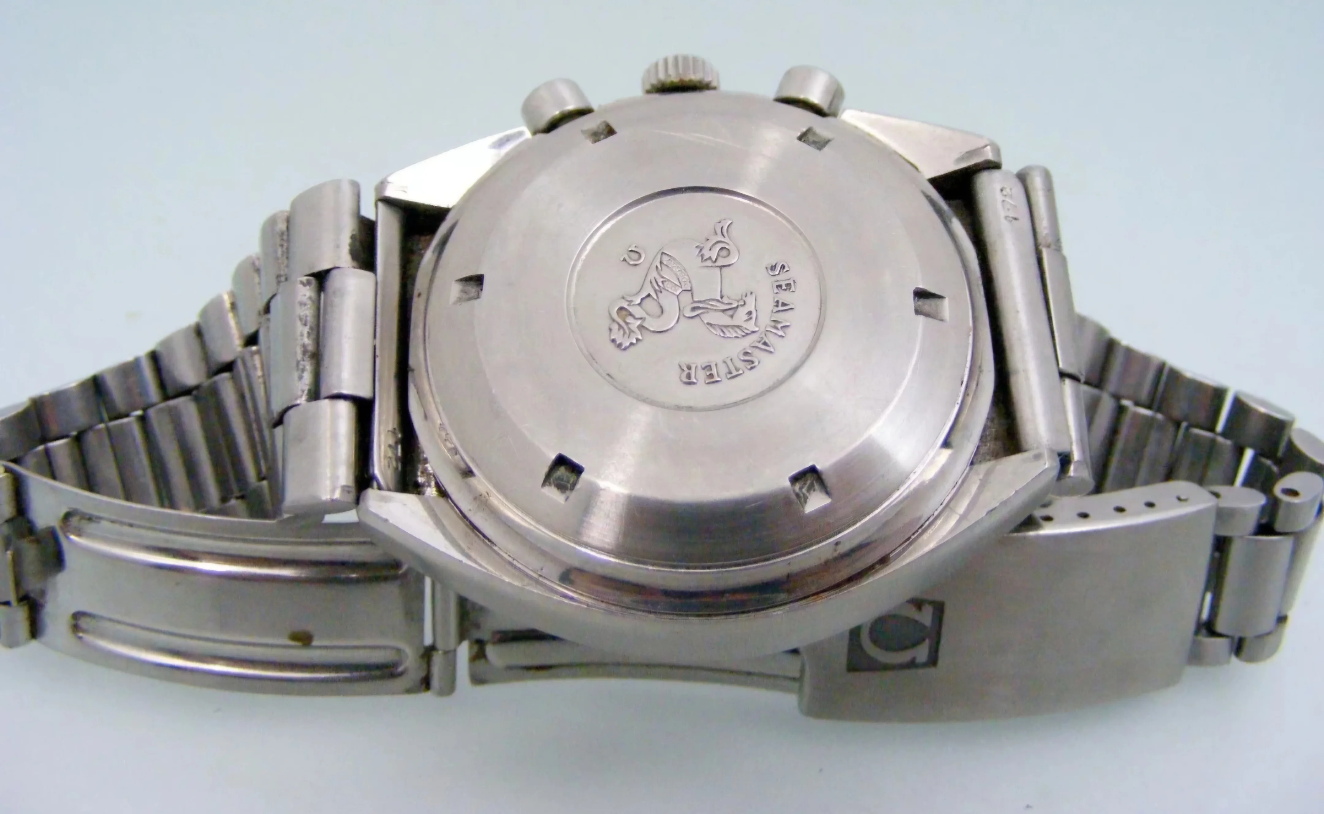

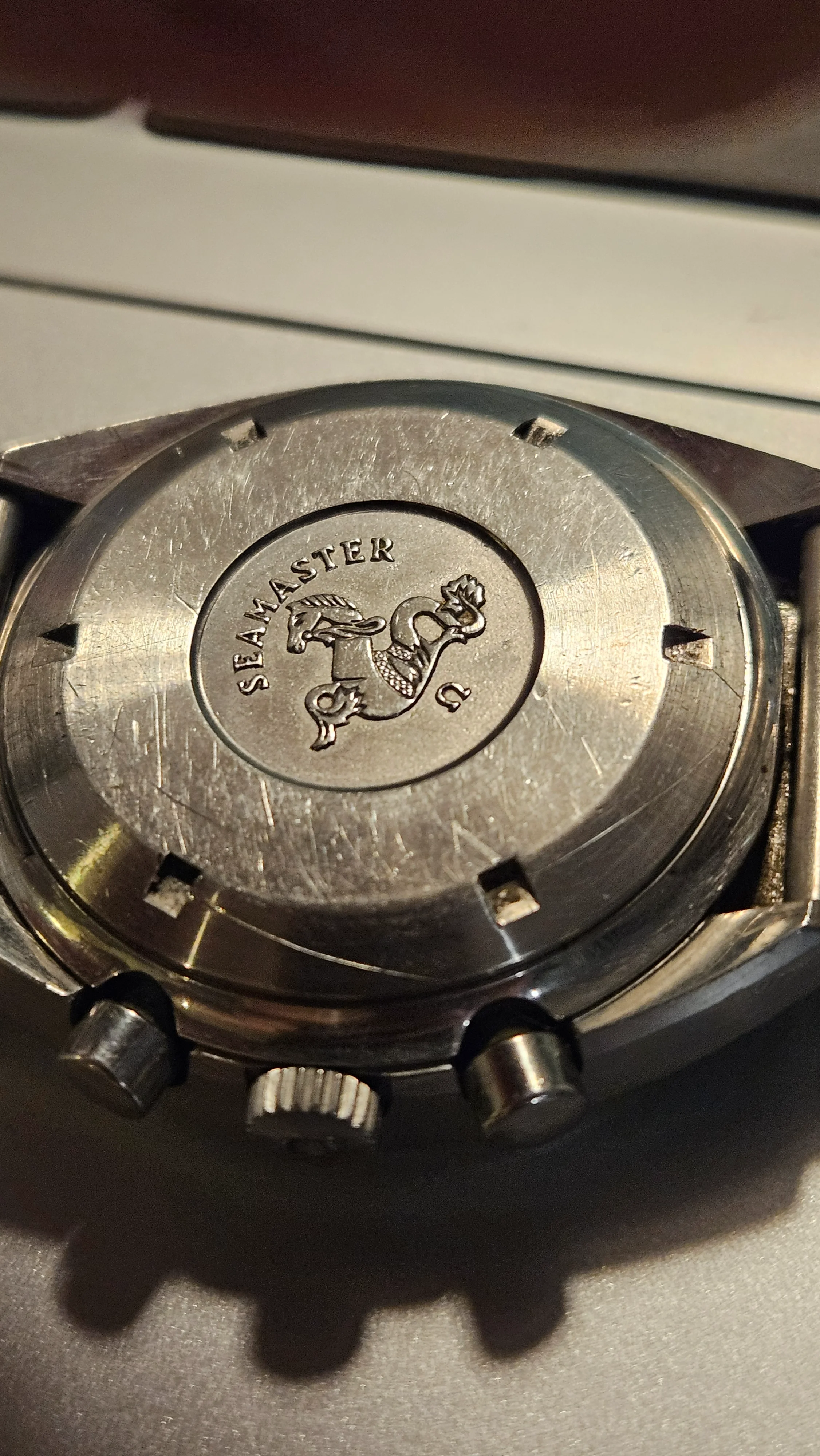

I'm no expert but a caseback with seamaster is quite strange imo.
2,818
3,753
That’s normal on these models. I’m pretty sure all the Mark III, IV, and 4.5 have the Seamaster case back - because the cases were shared with Seamaster models and so it was cheaper to not have different caseback symbols.

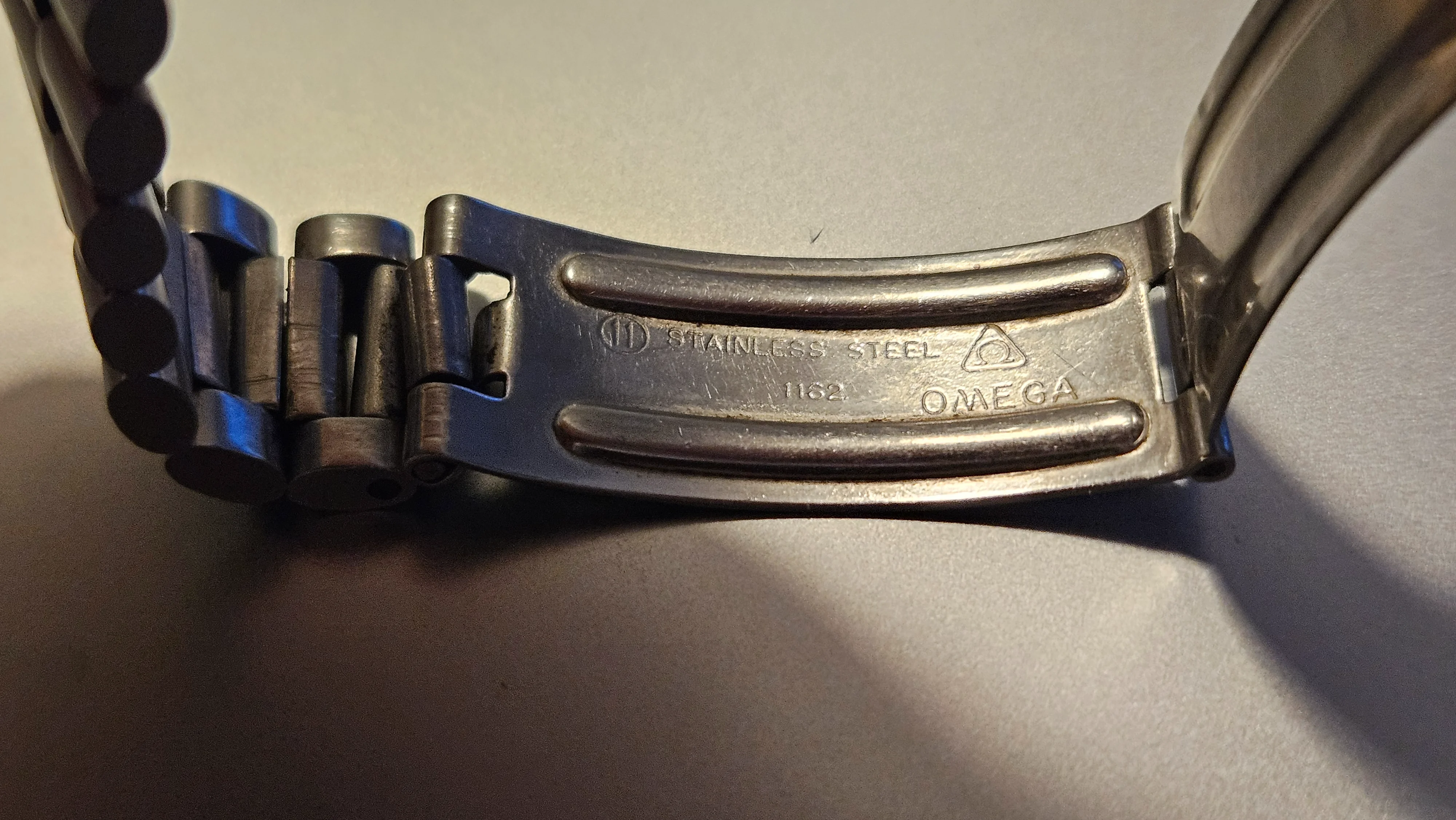

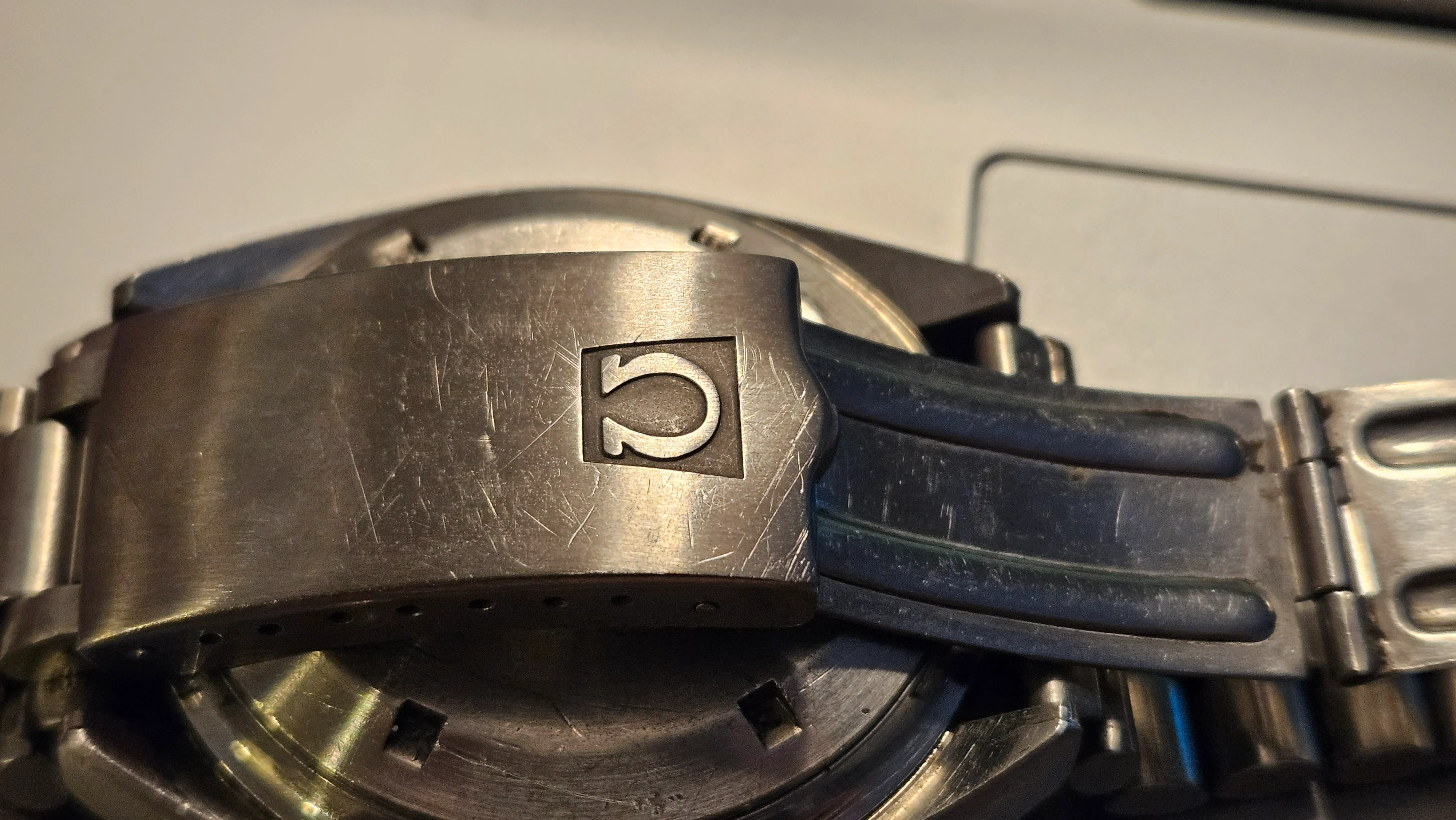

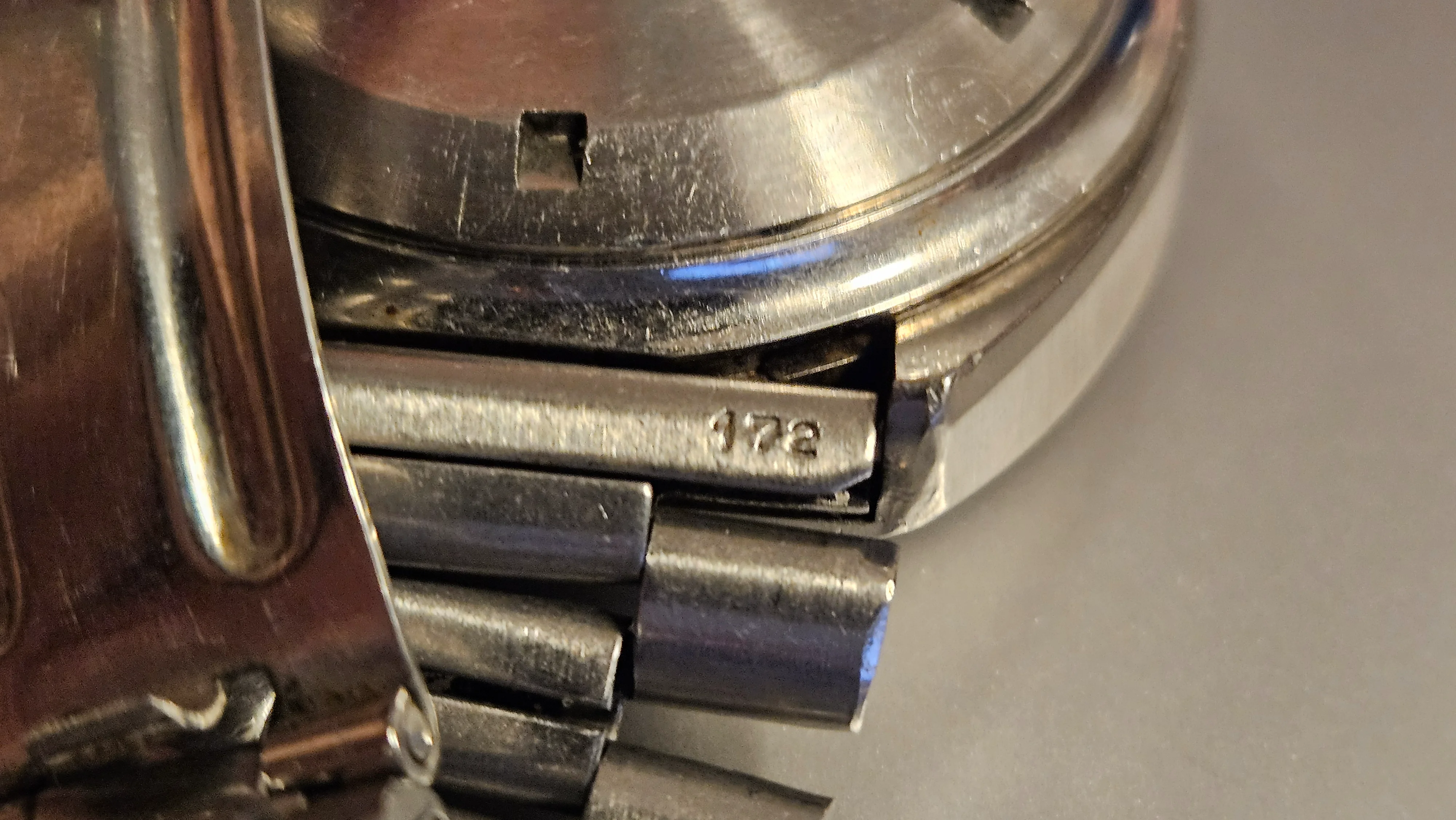

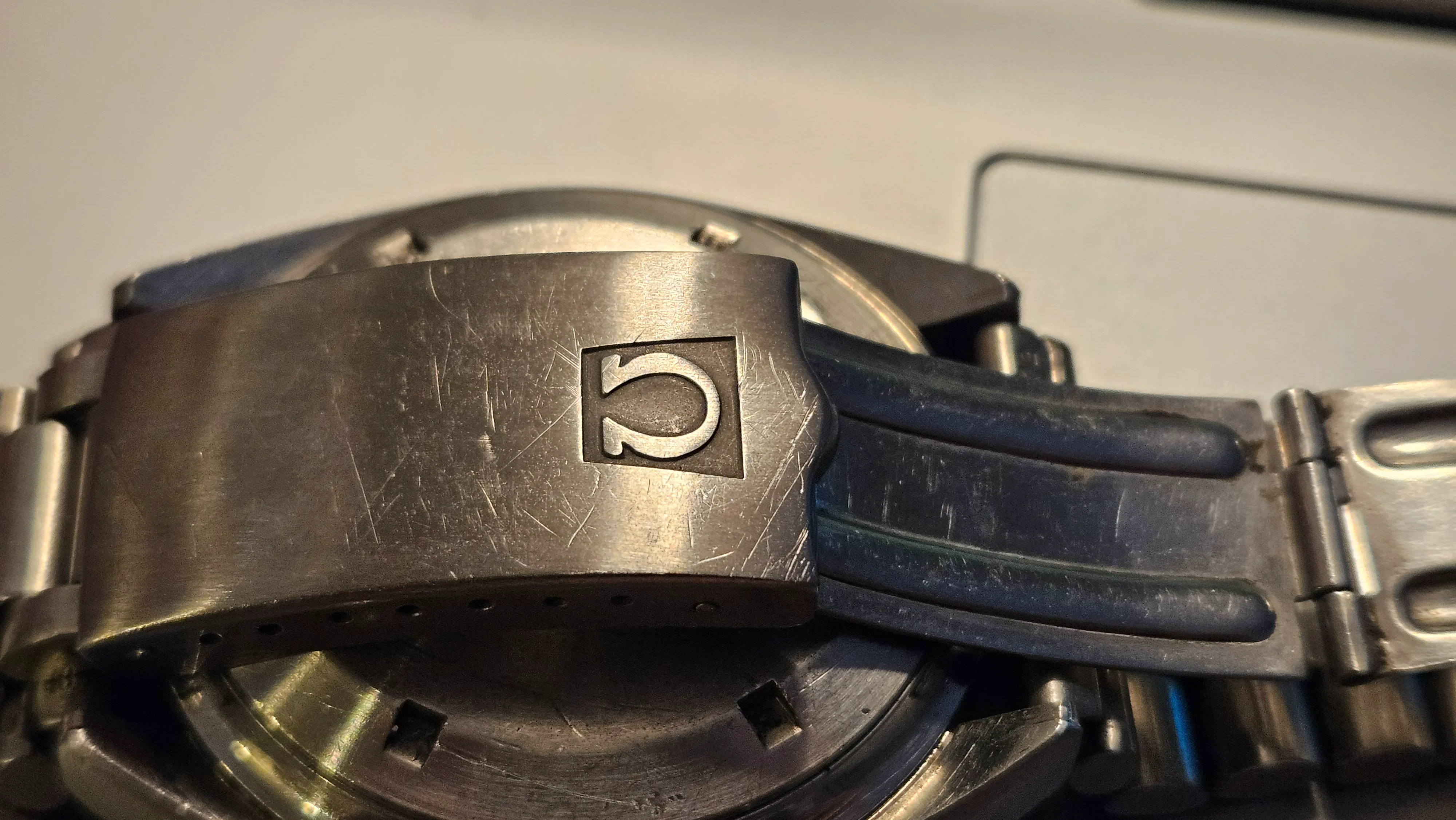

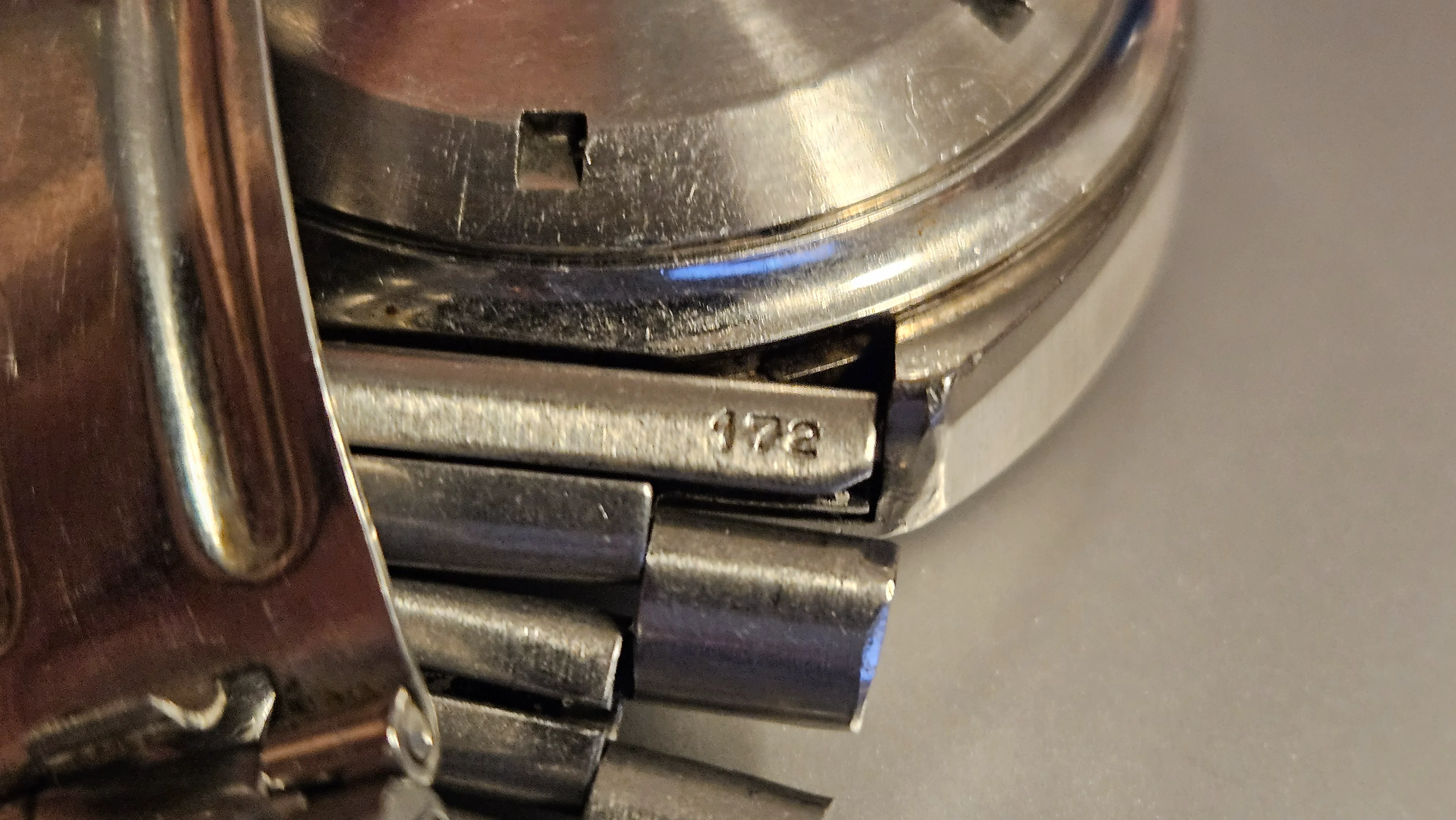

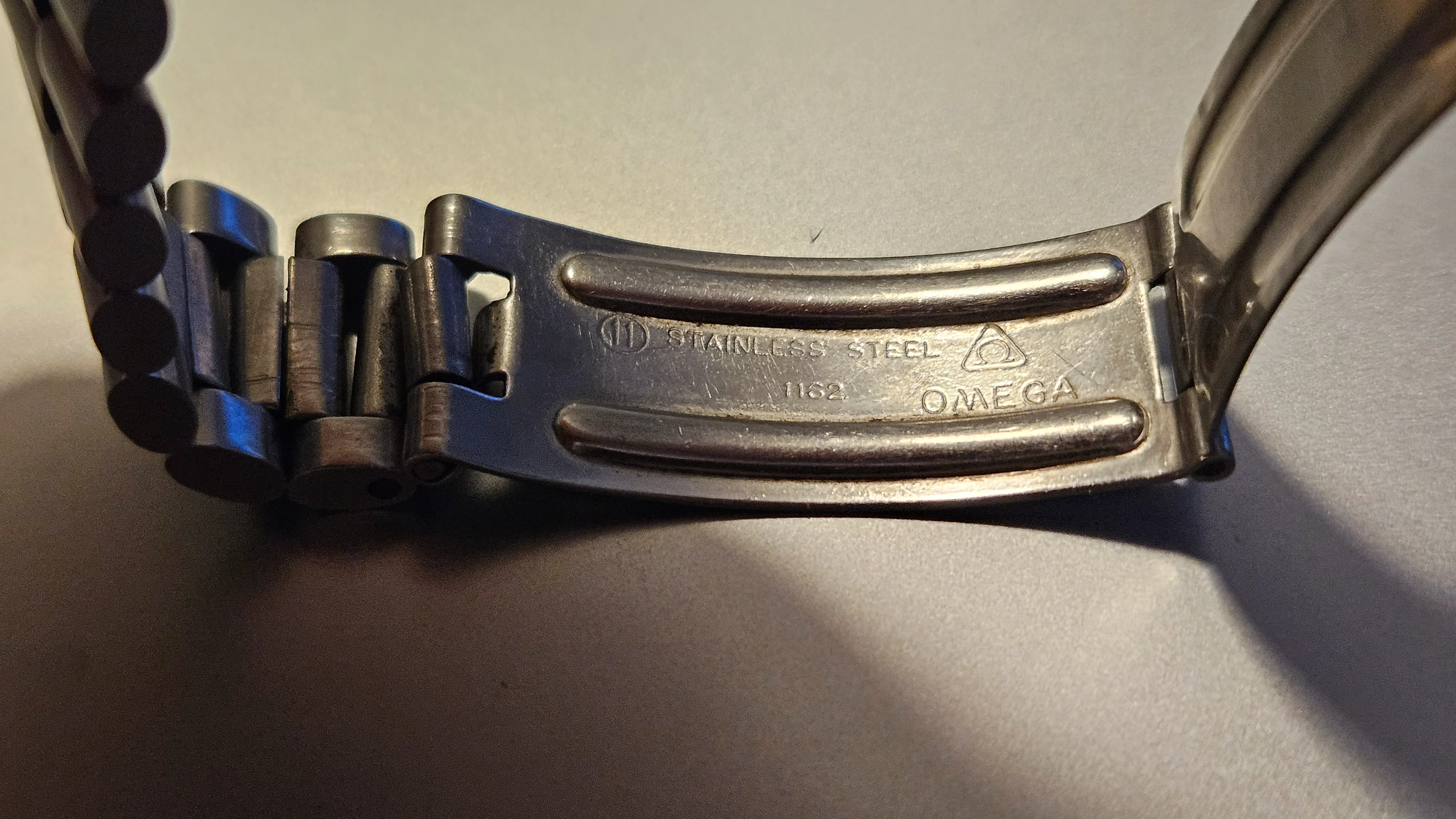

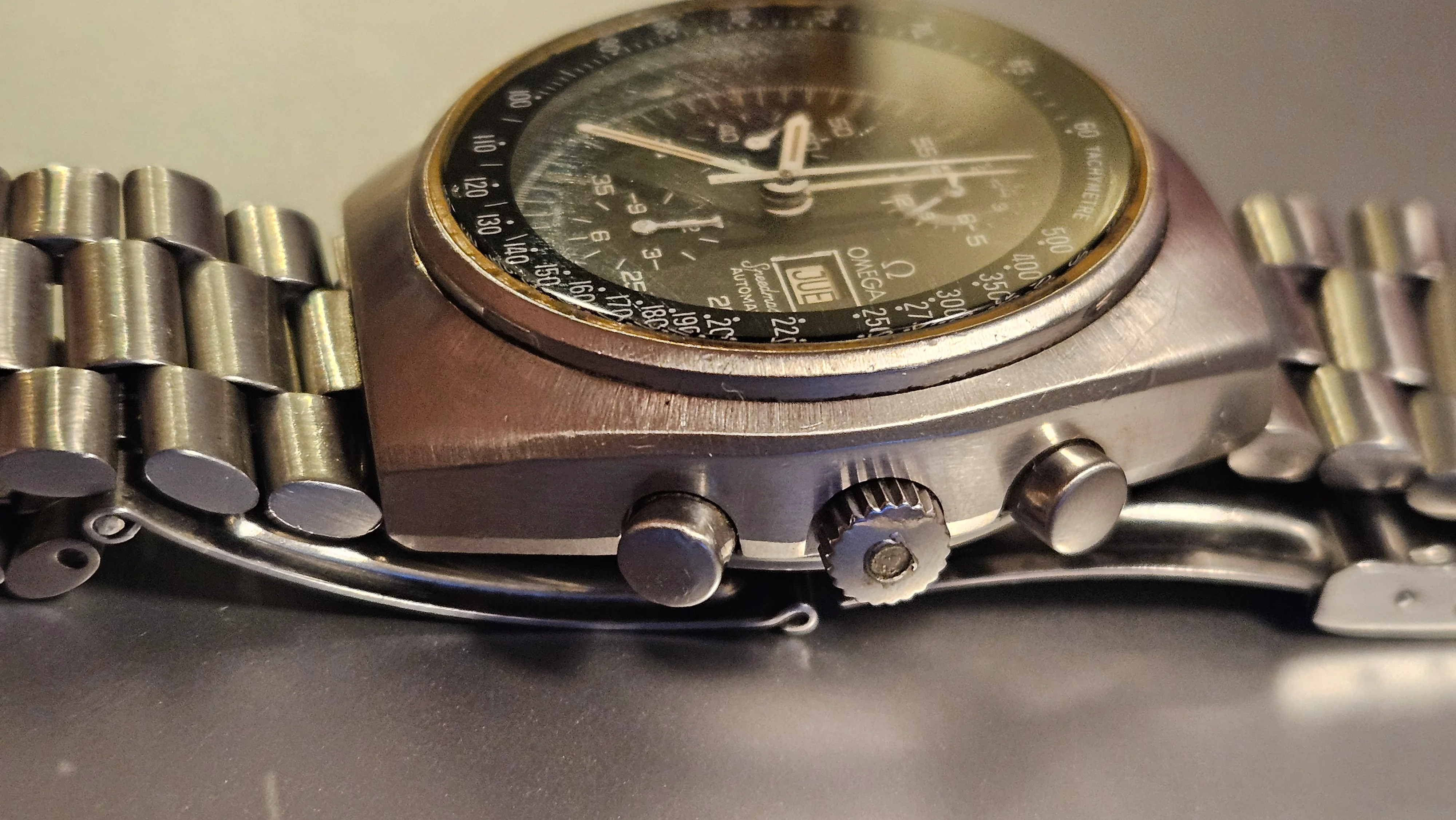

Only thing that strikes me is the bracelet - while correct, that apparently empty hole on the one link pictured is troubling. These use a screw system and shouldn’t have an empty space at the end like that. I suspect someone was Jerry-rigged it with a pin or another type of screw. I wouldn’t trust that bracelet for wearing the watch until I evaluated all the links and connectors thoroughly.
5
Thank you. Will check and report back about the bracelet later today.

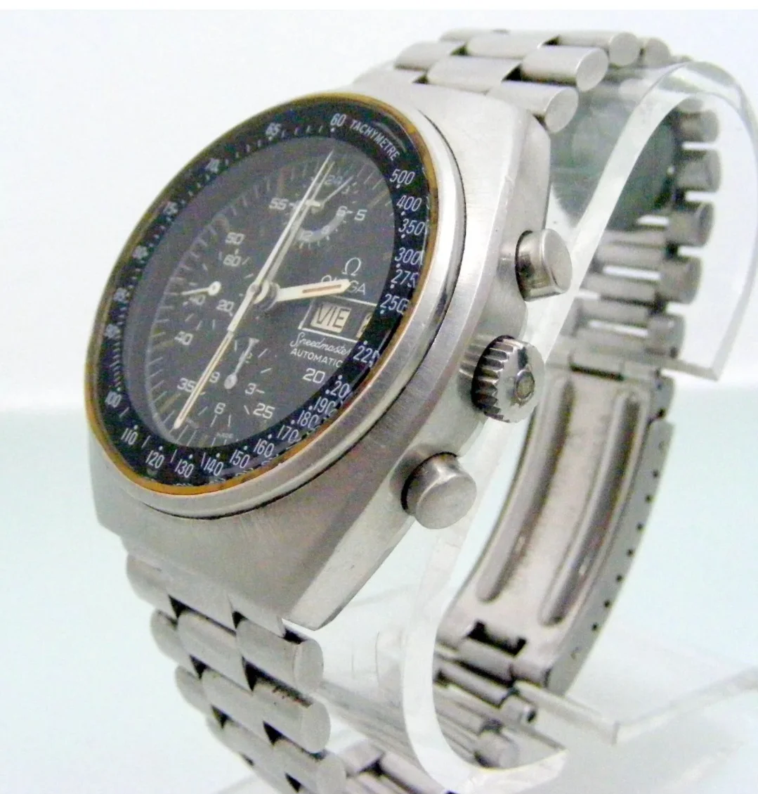

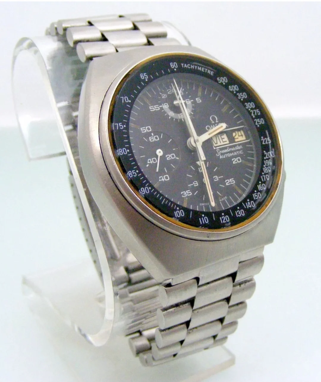

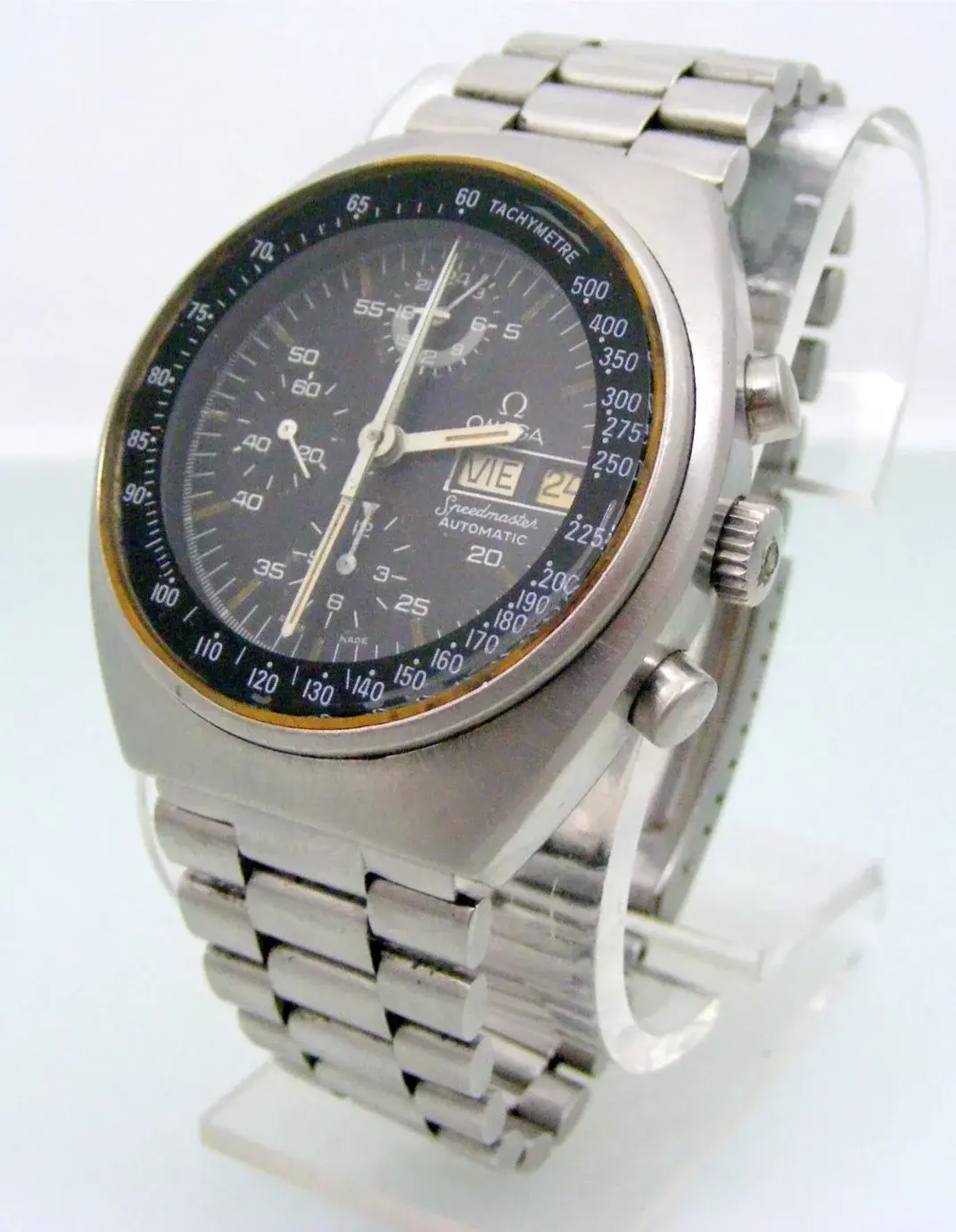

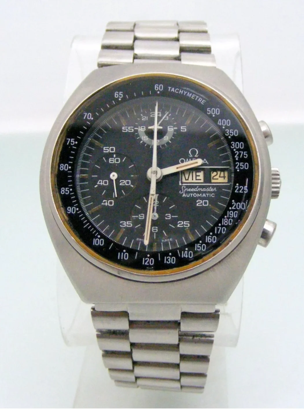

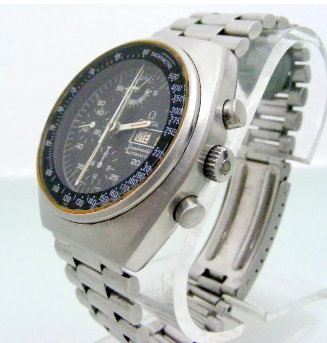

Few more pics from the original seller

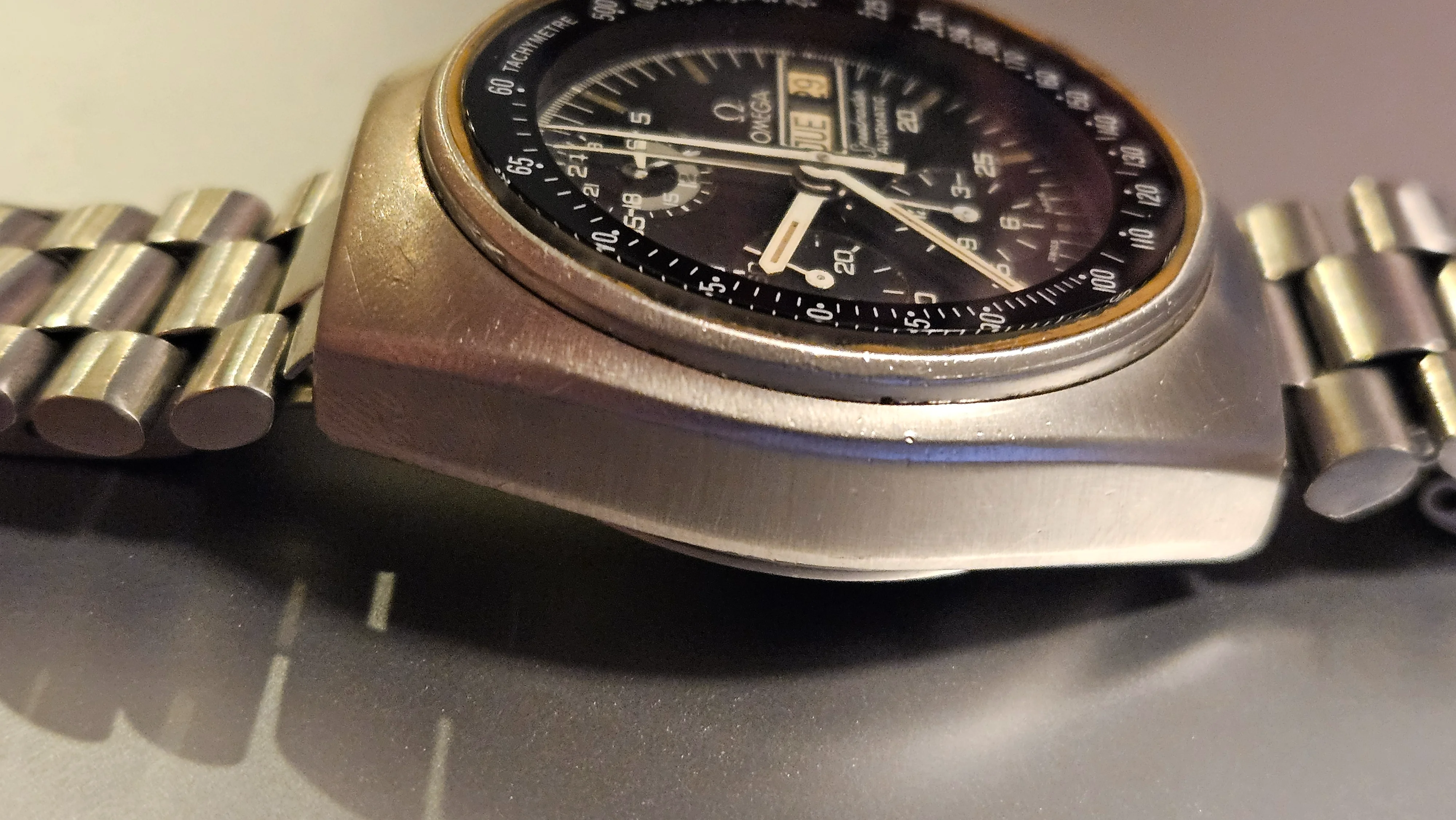

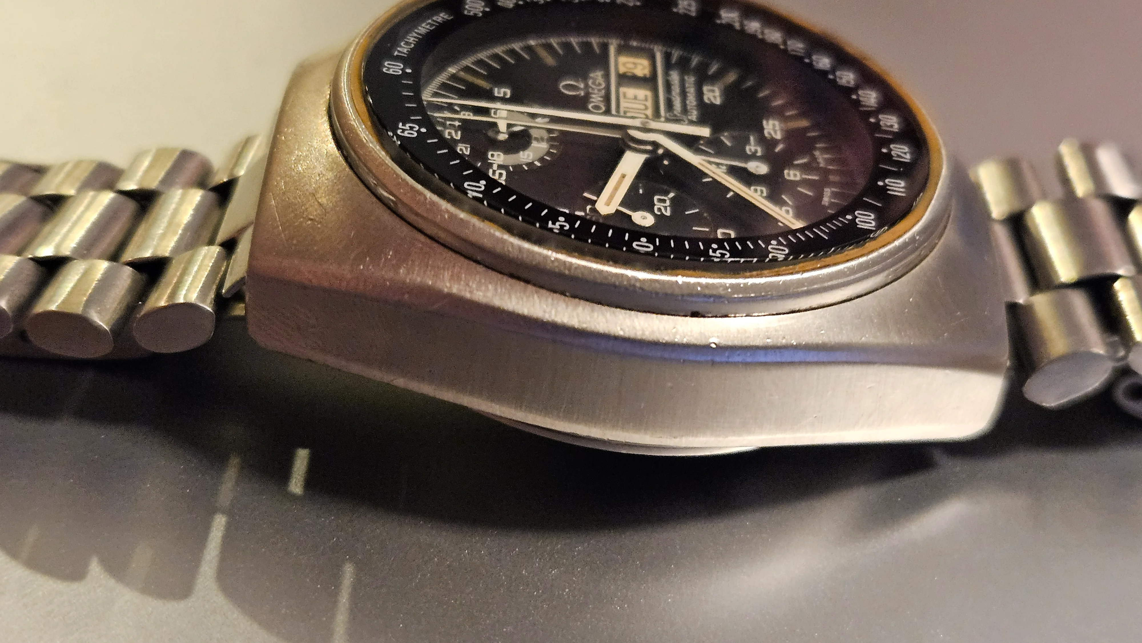

This watch sure has a lot of "patina". The bevels on the case look pretty softened as well. I hope it was a good price.

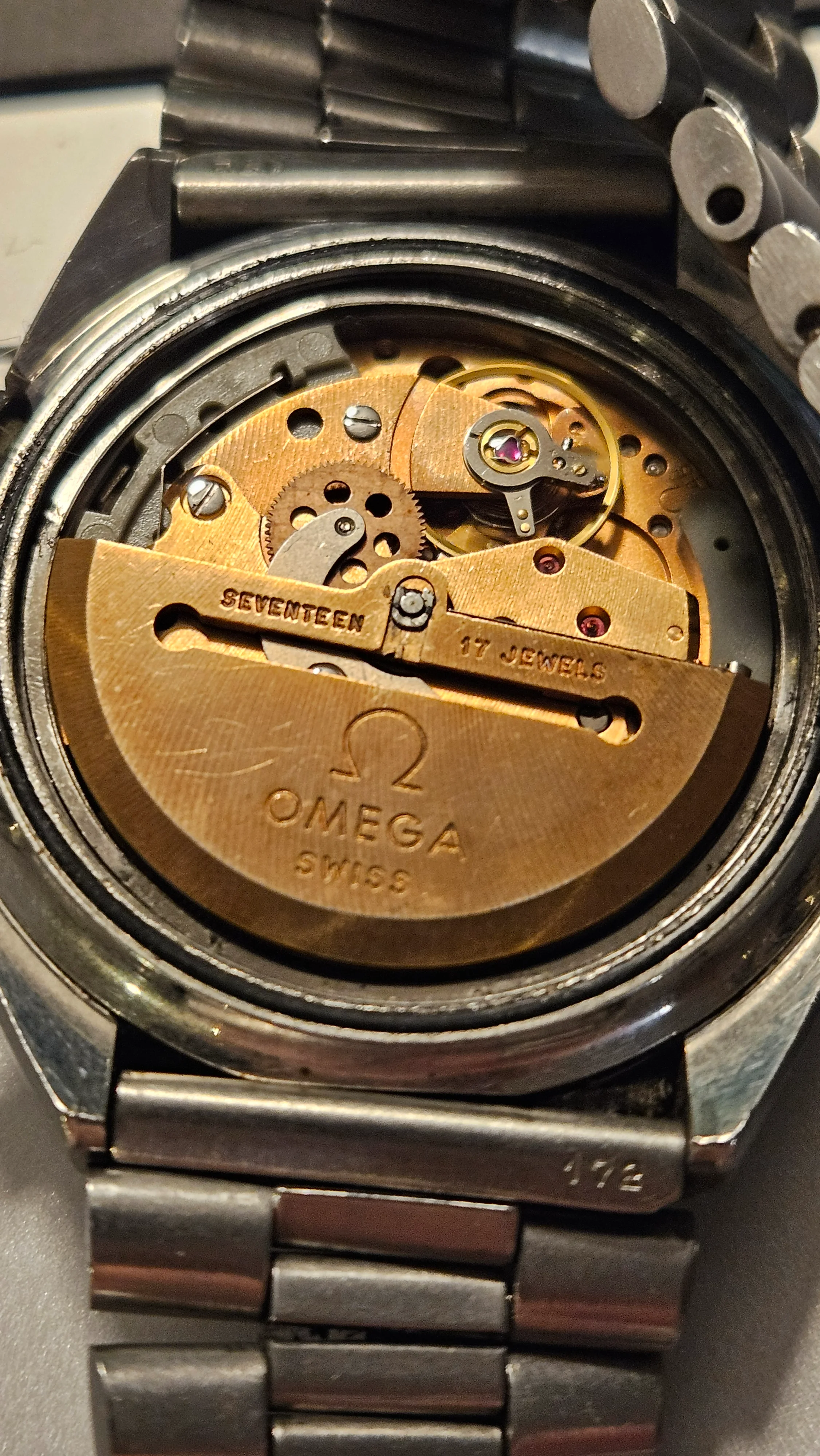

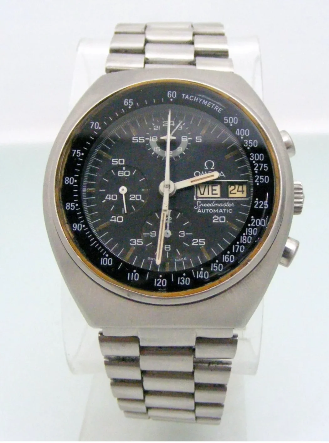

That watch is mostly correct, but it's had a bit of a rough life by the looks of it.
There are two issues I could spot at the glance though.

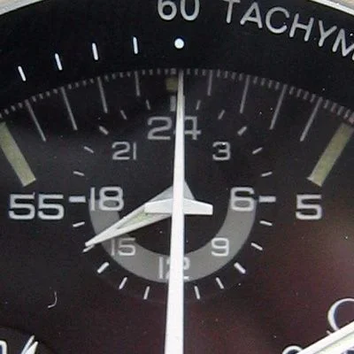

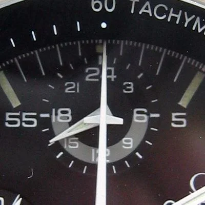

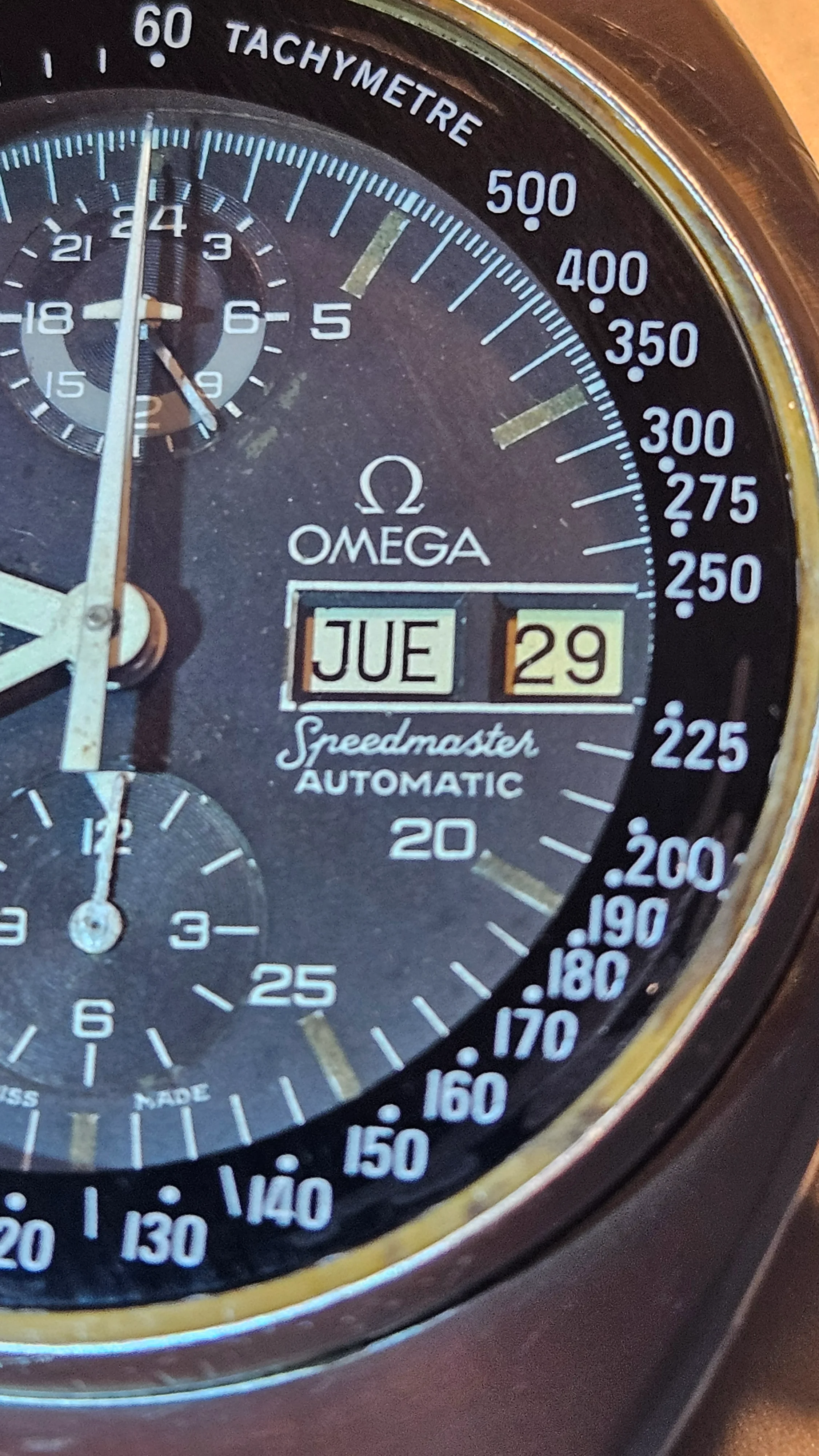

The first one is that the hand for the 24 hour register at 12 is not the correct one. It should be triangular in shape, therefore distinct from the ones on the other two registers, as shown on the picture below.

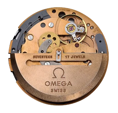

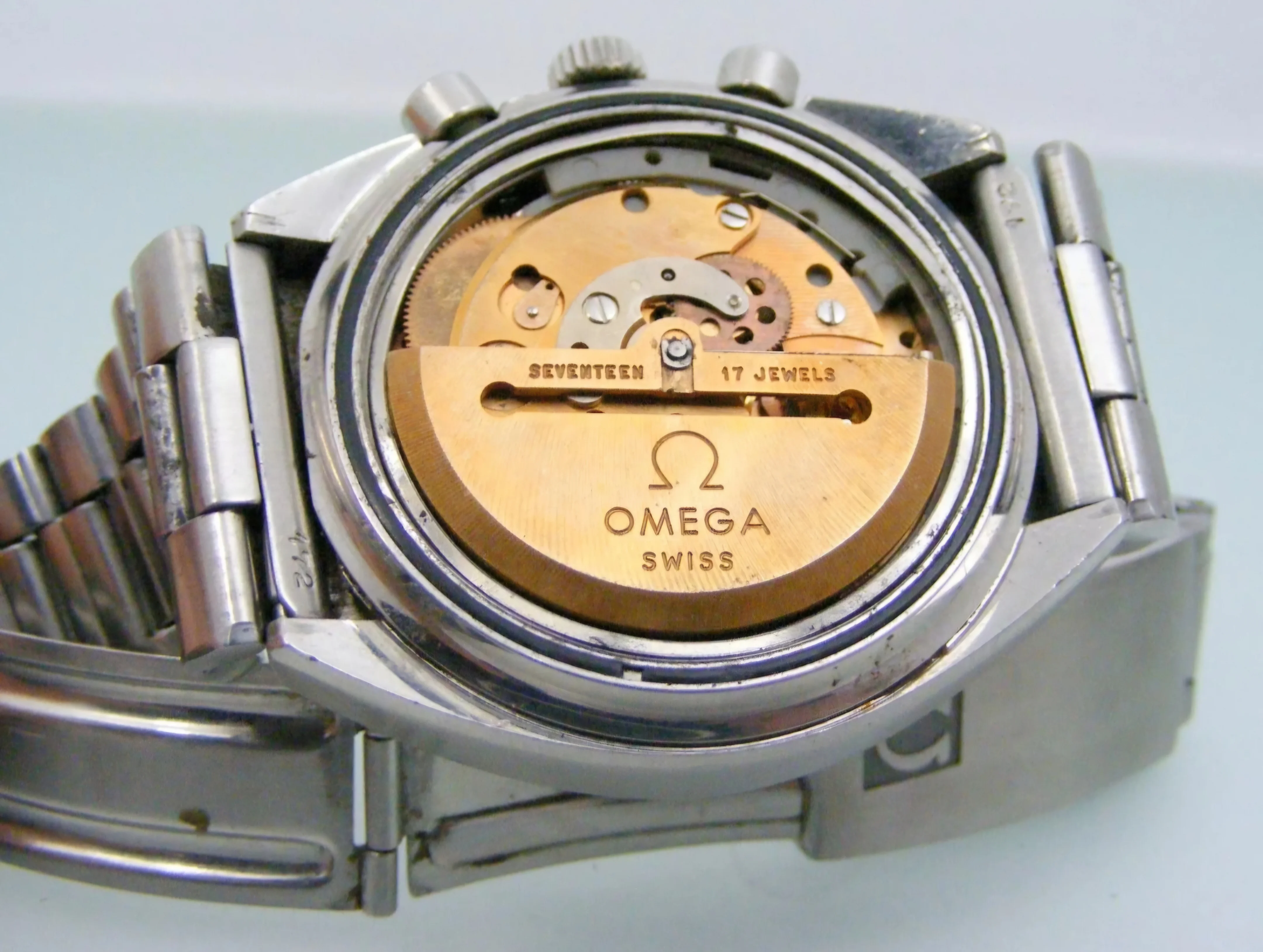

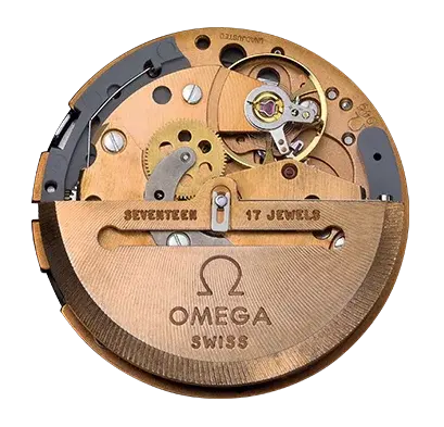

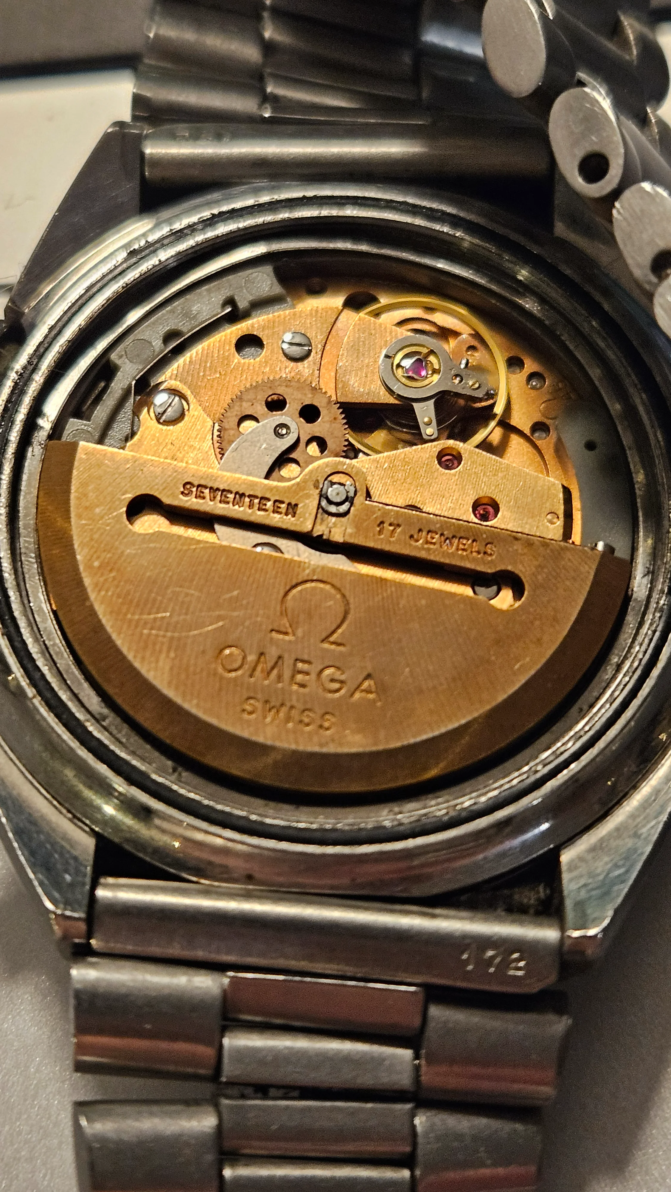

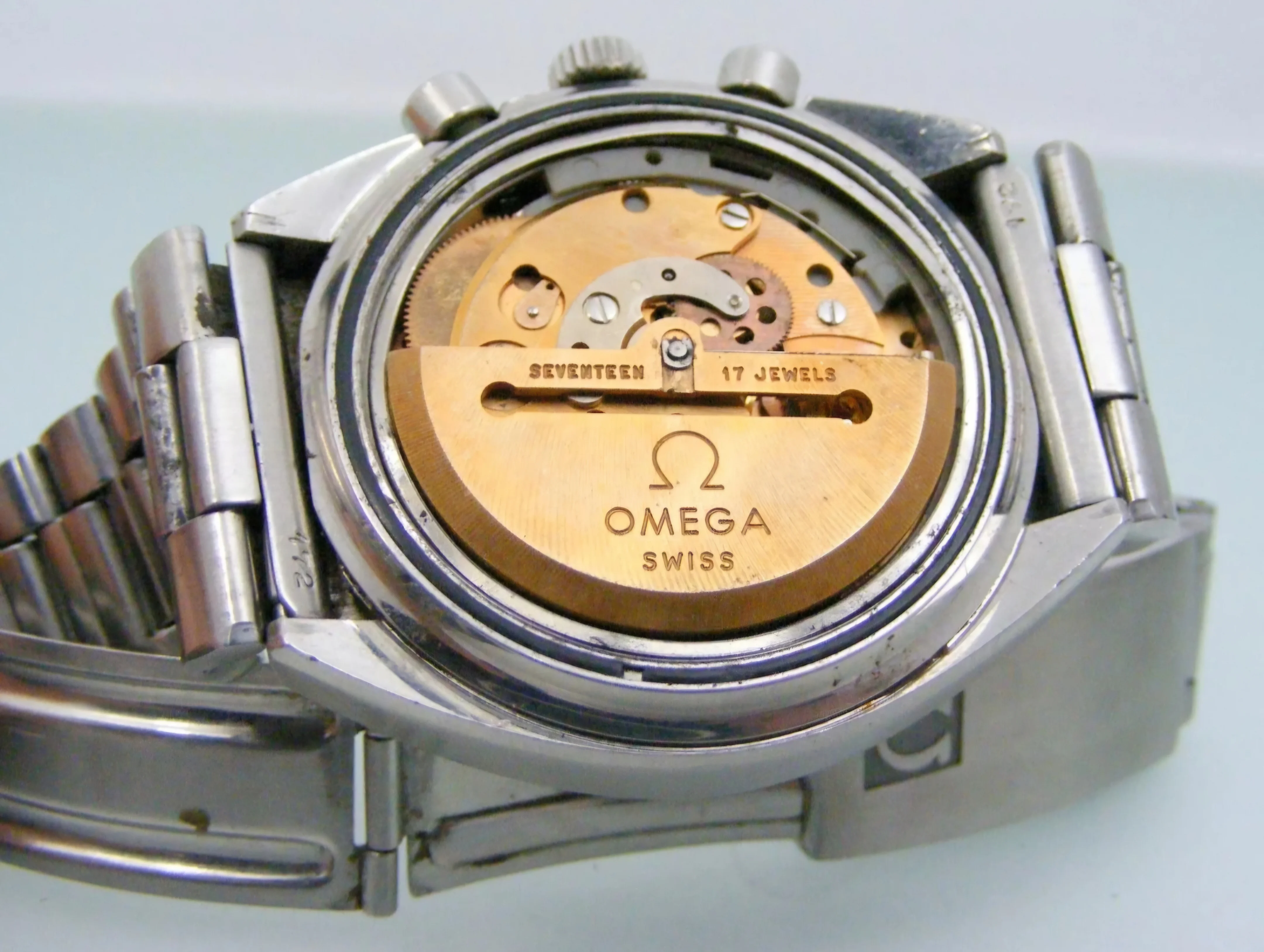

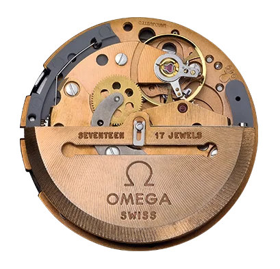

The second issue has to do with the movement's rotor. The part holding it in place either has a bit missing or is not original, and I suspect that it is not as secure as it should be. See picture below for what a Calibre 1045 should look like.
Amazing info, my friend. You have a good eye.
I will try to source those things and eventually replace it.
I paid $1600 after shipping and fees.
It looks nice in person and I am very happy with it.
Thank you again for sharing your knowledge.

Mvmt. Looks correct. The spring loaded Rotor clamp is easily sourced, just look for Lemania caliber 5100. The 24 hour hand should be available from Omega. If you want it serviced, only ask and find a Watchmaker with experience of the Lemania 5100. These are very rugged and well constructed movements.

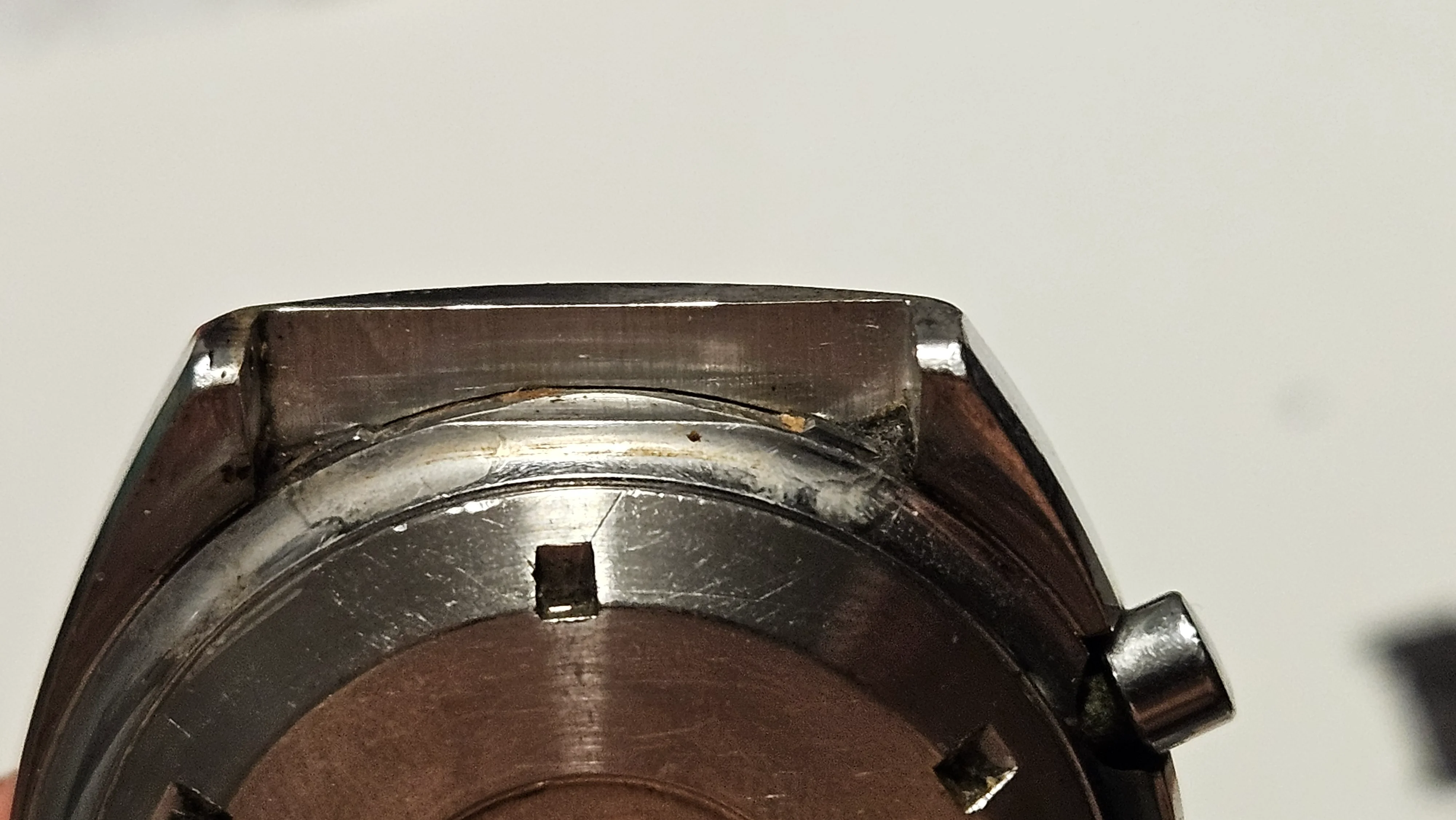

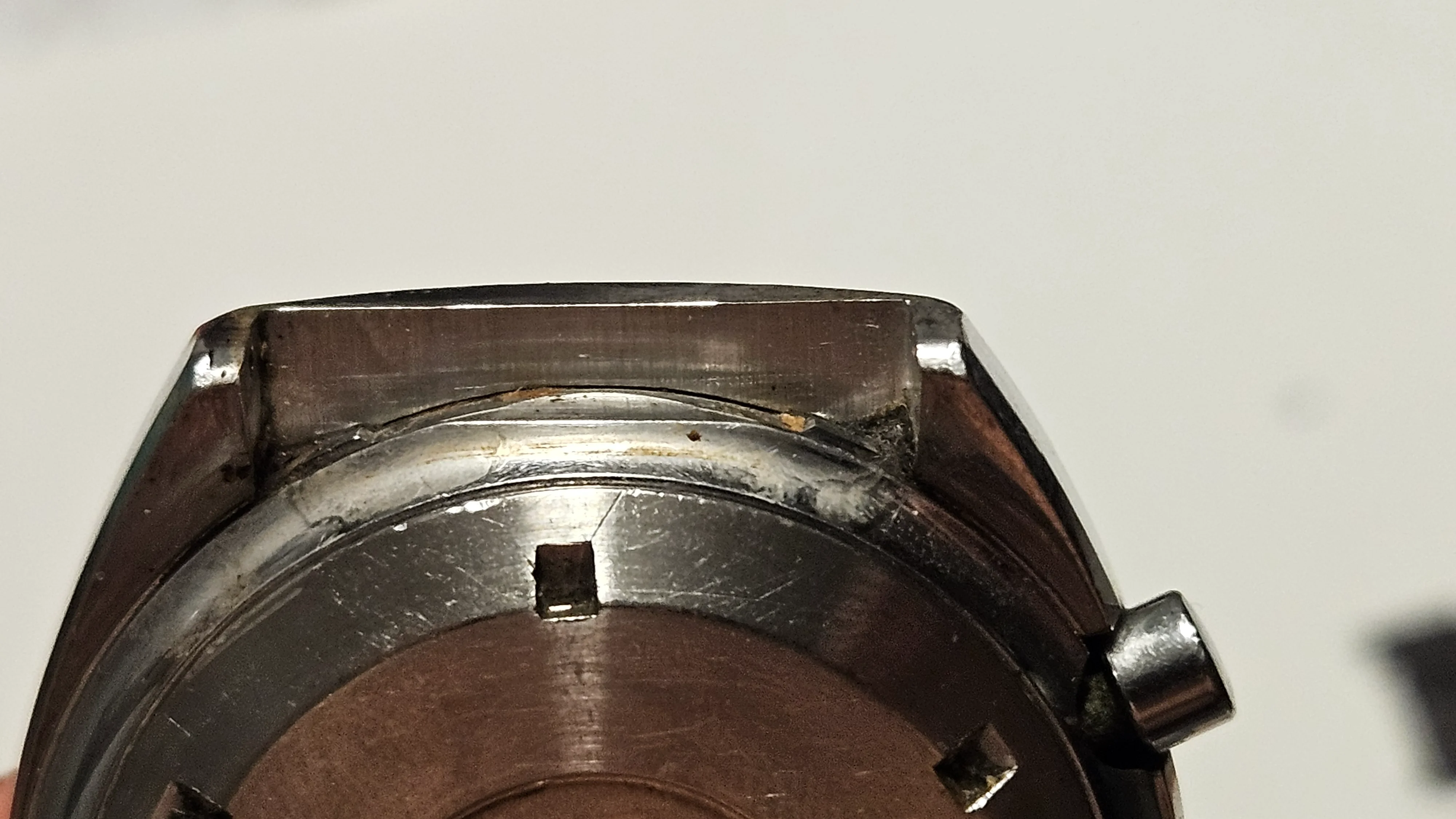

Case very worn, dial looks damaged with discolored lume and possible water damage. Hope that was factored into price.
5
Thanks for all the help, I ended up returning the watch to the Ebay seller. In search for a better example.
