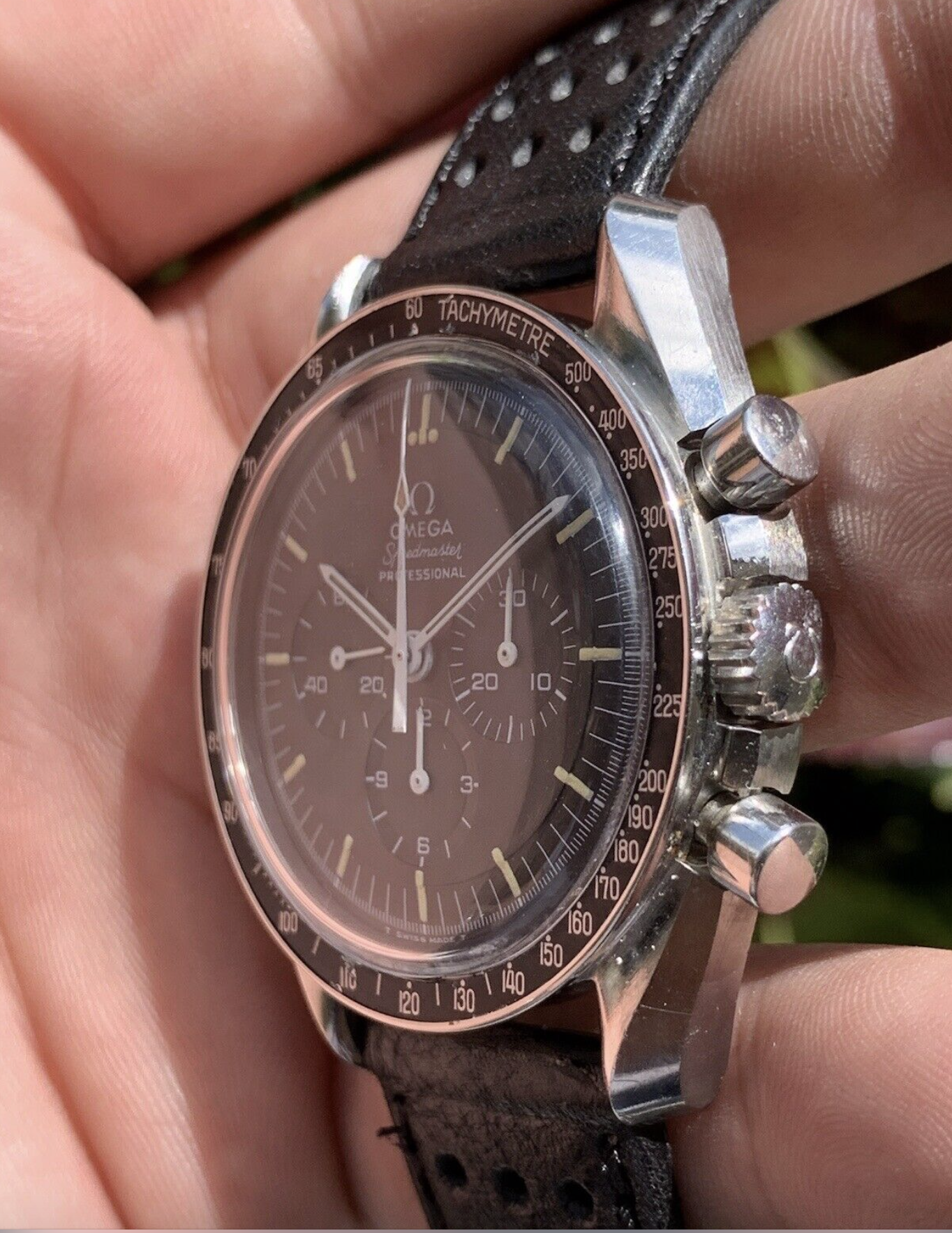

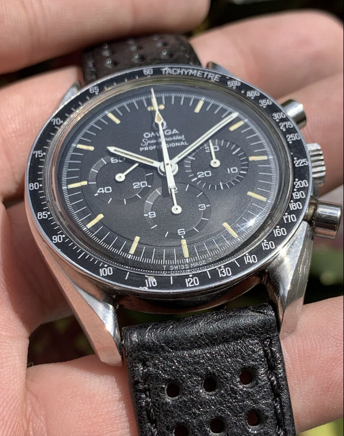

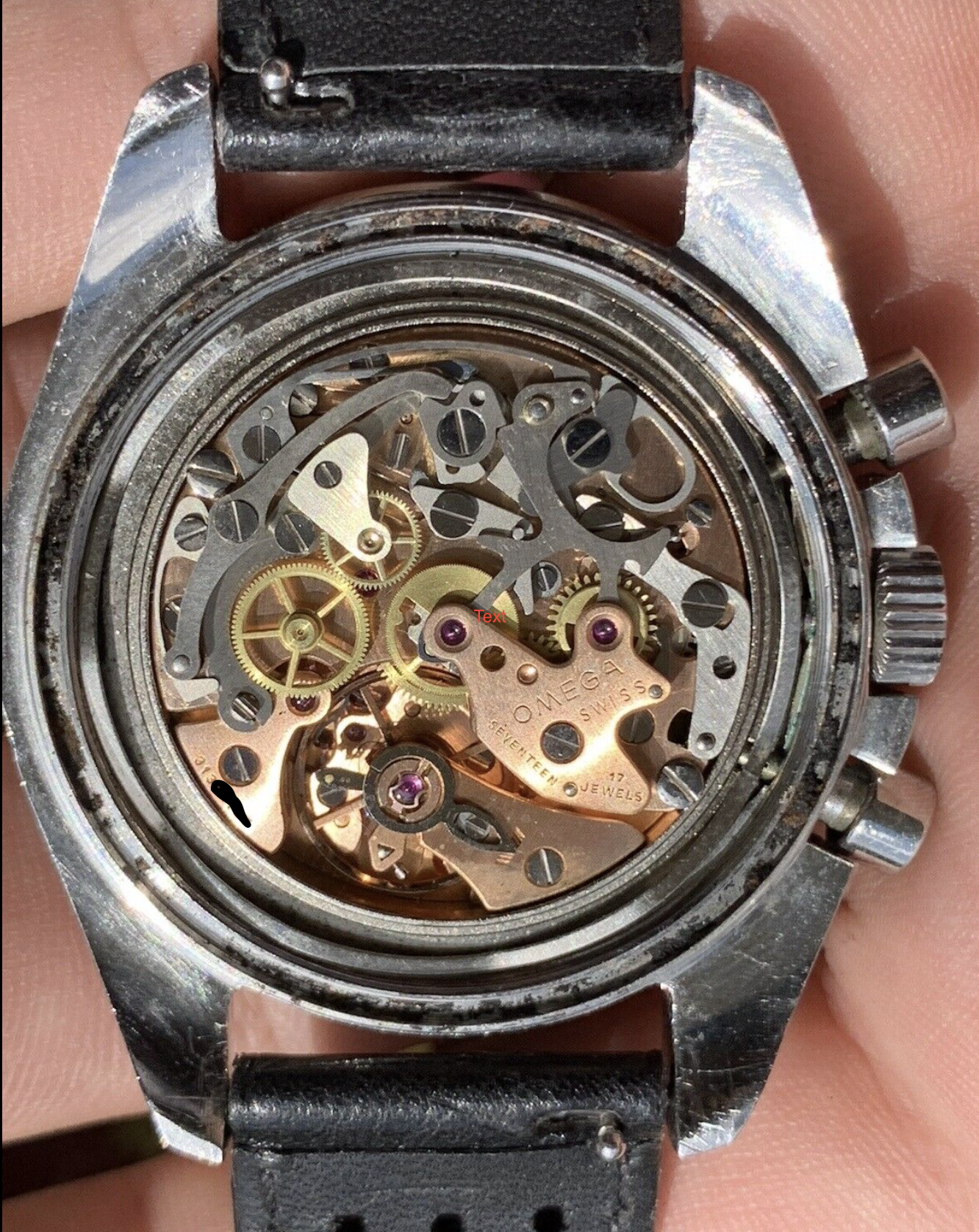

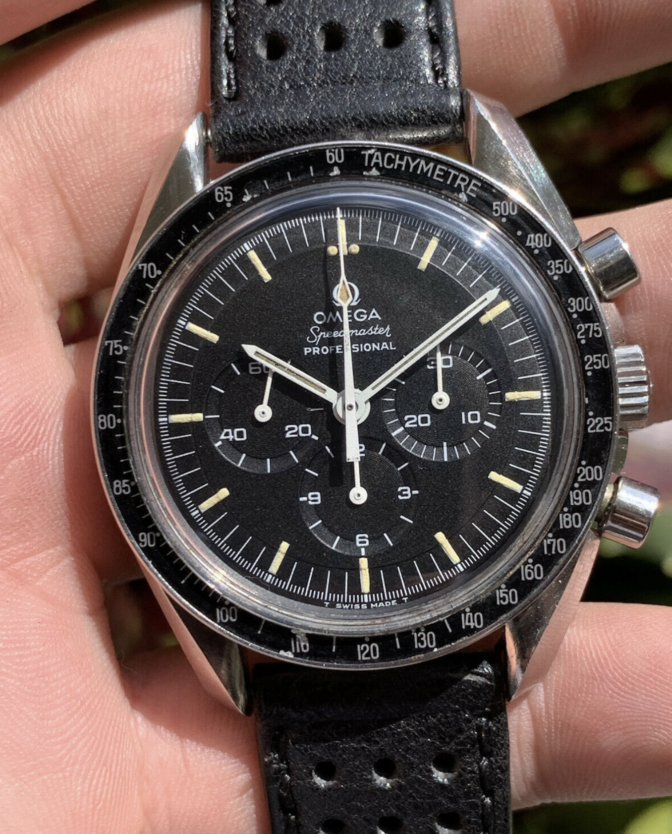

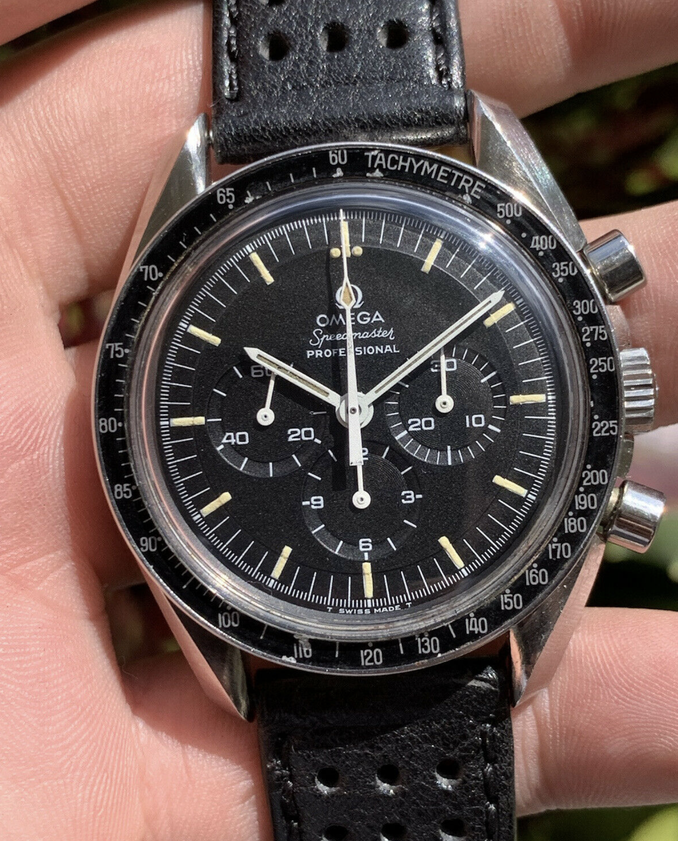

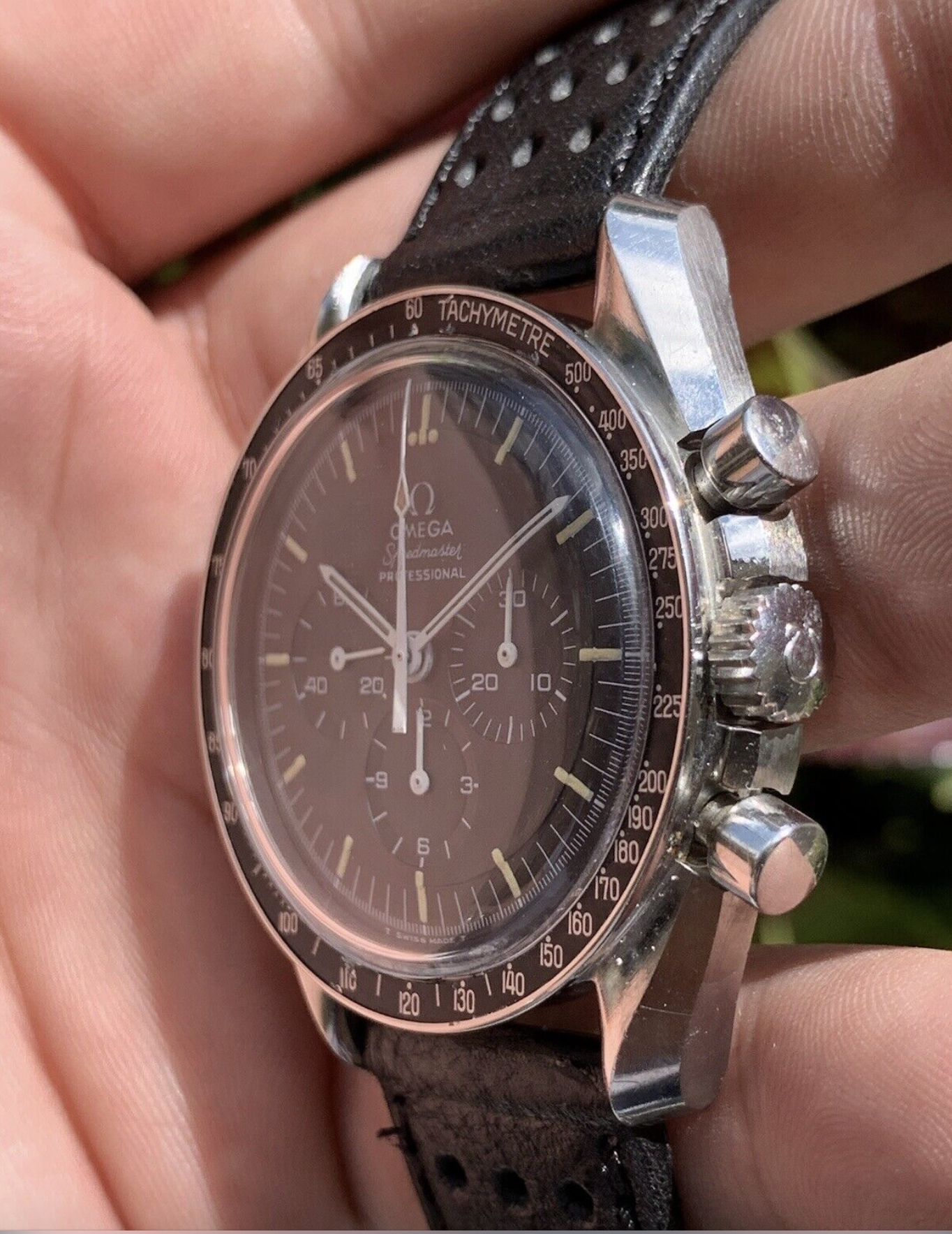

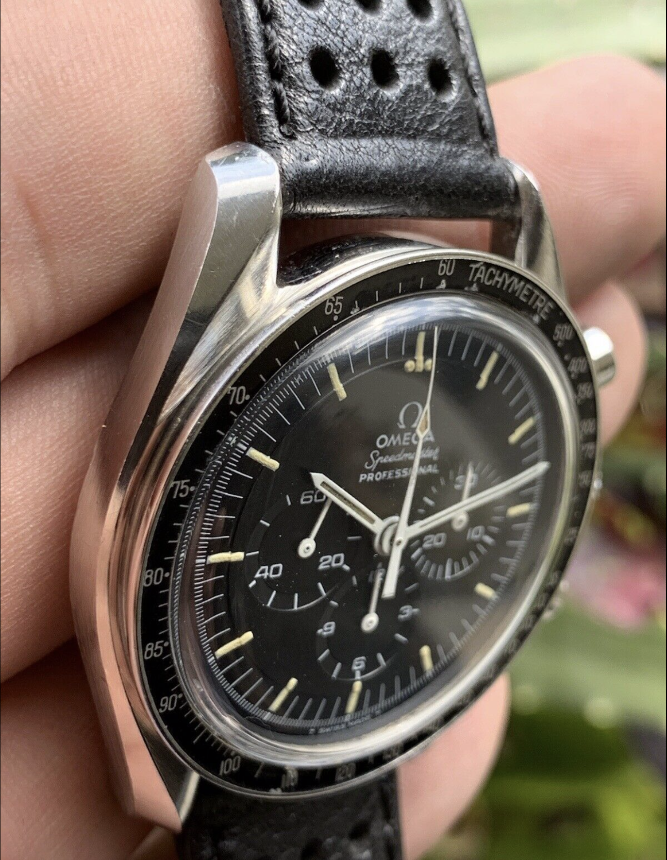

-- Late 145.022-69 with DNN bezel, etched/smooth caseback, and movement number in the 31,3XX,XXX range, and stepped dial
-- Watch isn’t without a couple minor dings and scratches but overall happy with the condition. It does not appear to be heavily polished (realize that this could be a trigger word), but I find both brushed and higher polished on the case.

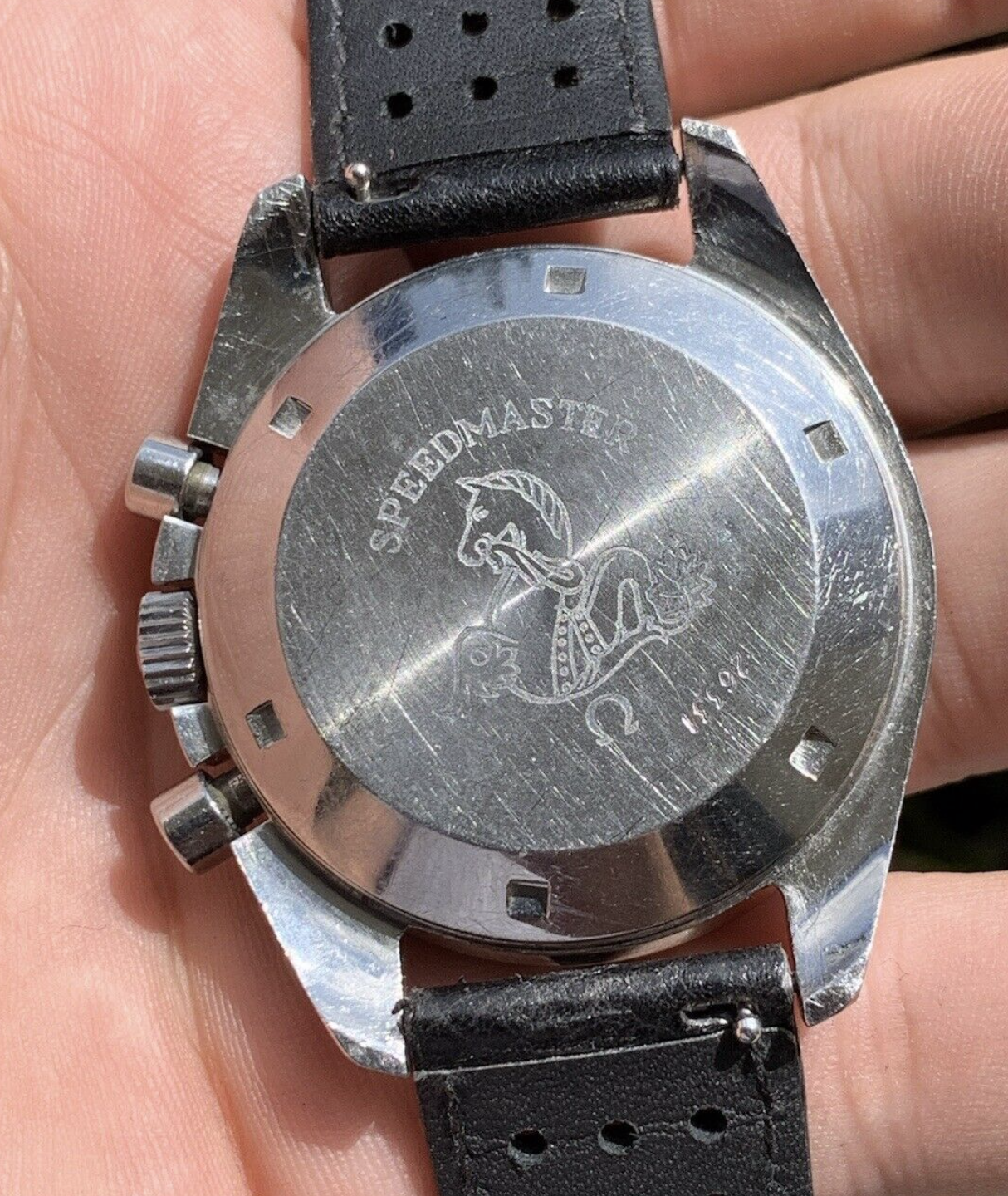

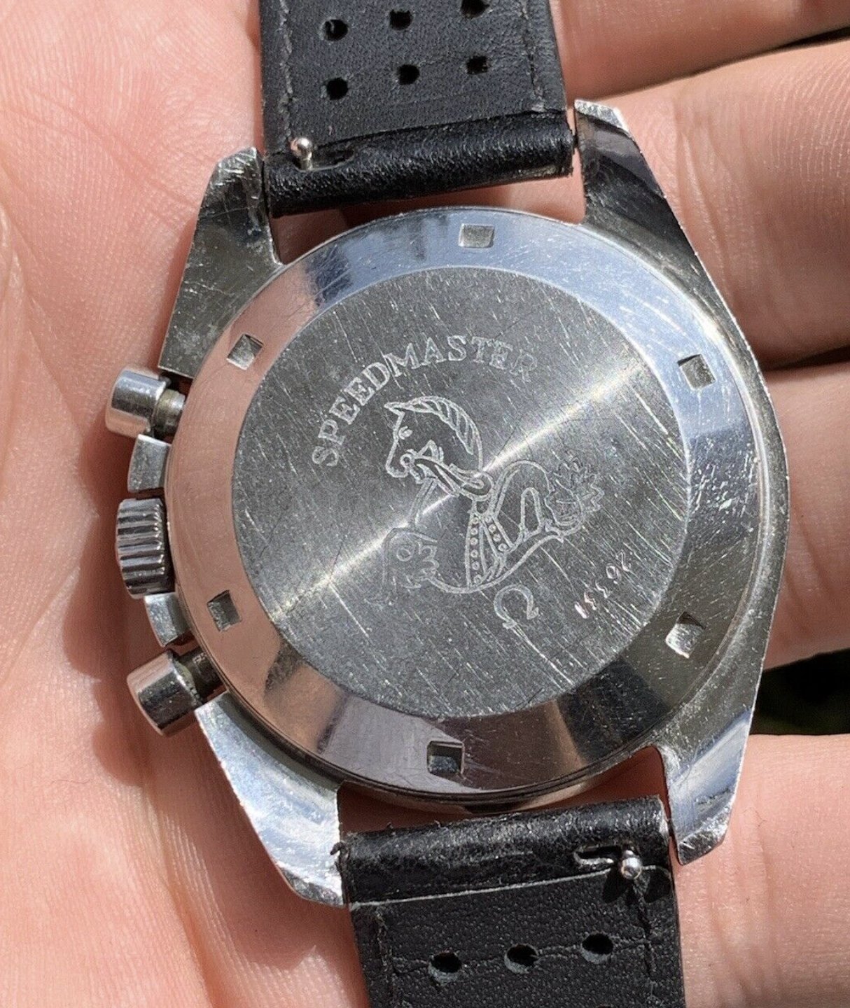

-- Interestingly, there’s a numerical engraving on the caseback “26331” and I have no idea what this represents
My concerns/minor niggles:

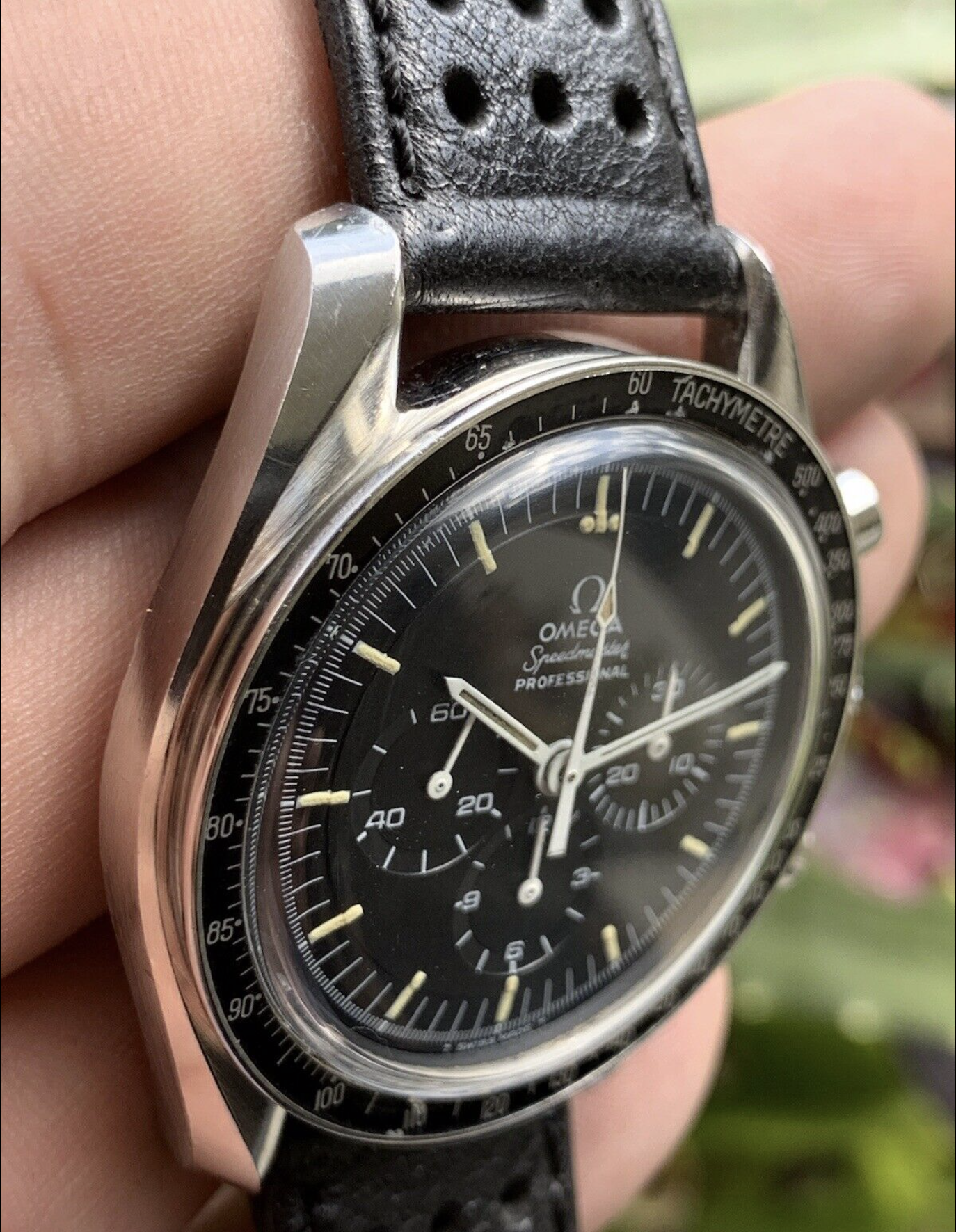

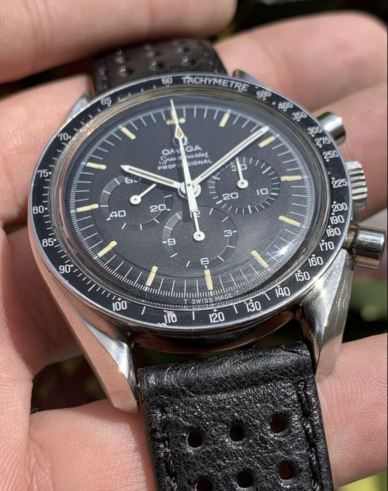

-- Lume plots looked a little puffy in pictures and up close, but I saw documented in other examples that this likely is still the original factory applied lume. It glows greenish for about 10-15 seconds then goes very faint when stimulated with light. This was my biggest worry
-- Crystal doesn’t seem to have the Omega logo engraving
--Reset pusher button is a bit “out there”
--Chrono seconds hand has a bit of a periodic “stutter” which is barely noticeable
--Caseback seal is gone

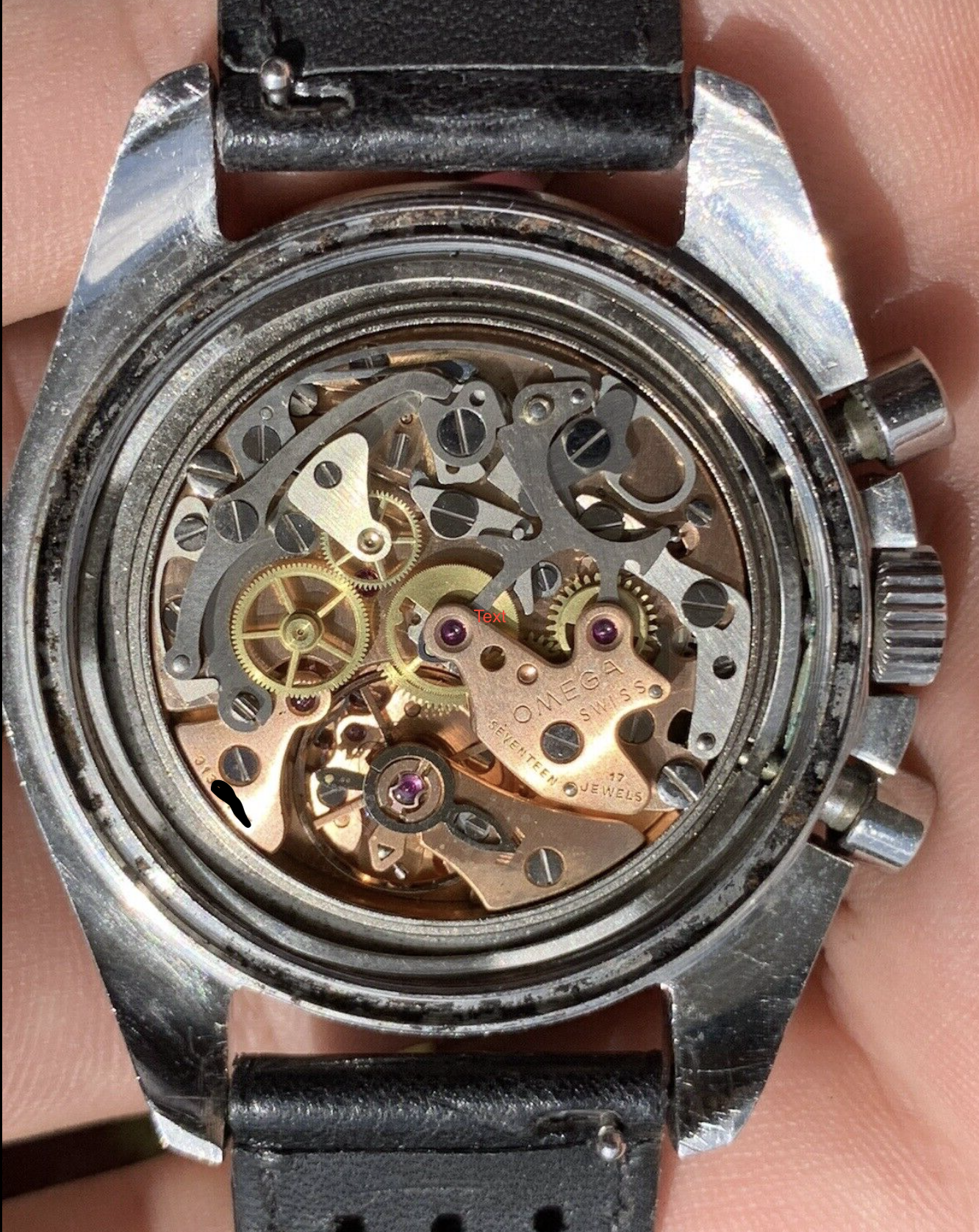

The watch is keeping good time, but I will be giving it in for service to ameliorate the last few bullets (and generally because it’s a good idea). I’ll probably look into getting the hand lume stabilized, although I don’t see any debris on the dial.
Overall, the condition of the watch components on their own seem to be consistent - it has an overall used, but cared-for vibe which for me is ideal because I wasn’t after a safe-queen nor a beater. Yes, there are scratches, there is damage to the bezel insert, but on wrist as a practical daily wear this doesn’t bother me in the least. I would have preferred to see the watch in person before buying and admit that I was uncomfortable with the notion of buying from pictures and (minimal) description only. I kept reading about “buy the seller” - for me I had a feeling that this might be a nice watch and just decided to go for it despite the feedback rating.
Okay, enough drivel, and onto some pictures! I’ll have to work on my watch photography, so in the meantime, most of these pictures are from the seller.

Looks like a nice example. You'll want to get that pusher cap tightened. If it loosens too much, it can fall off.

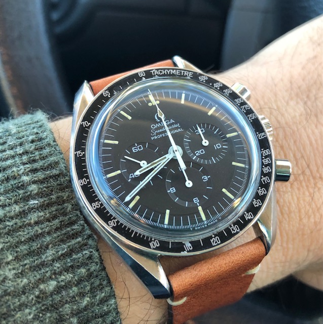

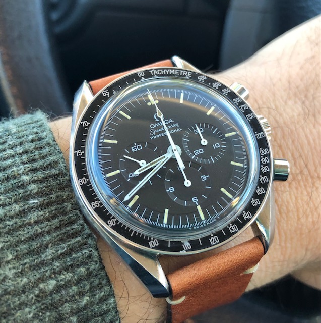

Congrats on what looks like a nice honest watch to wear daily (after the service of course). Crystals get changed all the time, I consider them consumables. Mine had an aftermarket when I got it and wore it like that for 15 years before I finally got a factory crystal from a nice member here. The factory crystal was a totally different shape (more bubble than the aftermarket which was more flat) and it totally made the step-dial pop in a way I had never seen, totally worth the $150.

The watch looks attractive and definitely worth wearing. Dial looks great to me. Given the gunk on outside and inside I would service it if this is your keeper.
However, the concern is the lining up of the seahorse caseback and the DNN bezel. I am pretty sure that something has to change here. The 31.3 mil Speedmasters from my experience are a bit of wildcards. Some have come as 69's and 71's and sometimes (maybe even contestably so) as 74's.
My concern is the pre-moon caseback and the DNN bezel. I can be mistaken that there are instances that the pre-moon caseback can line up with a DNN and that serial number but I don't recall that being the call. The easiest fix is to find a DON insert, but again depending on where in the 313 range your watch falls the DON/DNN may need to follow that.
Again, I leave to someone else to comment. I feel like @Foo2rama has weighed in on these 145022s in the past. And again - I may be mistaken to some degree.
Thanks! Yes, that's something to address in the service for sure but I wasn't aware that they could be tightened -- good to know!
And glad I could offer encouragement, but are we sure I wasn’t enabling? 😗
Thank you. Yes, this aftermarket crystal is a bit flat -- and that's an interesting comment on making the step pop. This the first step dial I've experienced (other than the new 3861) in the metal and the effect is subtle. Having that more pronounced would be cool. There doesn't seem to be as much of that fun distortion (in my limited experience) that the OEM Omega hesalite provides.

Let me take a stab at a more meaningful comment than Dennis'...
Thank you very much for your observation. I had wondered if such a late serial number should be in the realm of a different caseback as well...maybe a straight writing -69? In fact, my non-rigorous internet analysis of movement serial numbers only found one source (speedmaster101.com) that listed my serial number in the -69 model range. There does seem to be an overlap of the -71 and -74 as well as you stated.
I would think that the 313 serial being later would mean a DNN bezel, but then again I see where the question of the seahorse caseback being coupled with those two facts comes from. I would question a DON with this serial, but I defer to other's experience on this one.
There are lots of possibilities here I suppose (watch is original "wildcard", caseback swap, bezel swap, movement swap, etc). For me the condition of these components seems consistent, and the parts look original to my eyes, so I'm not terribly worried. It seems that Omega made a lot of -69s and the model experienced several changes (DON to DNN, seahorse to SW casebacks) so perhaps this example is caught somewhere in between those transitions.
Really appreciate this analysis and would love to hear more on people's experiences.
I see no problem with the pre-moon case-back, DNN bezel and 31.3M serial.
1,597
6,851
Agree fully! I've actually seen at least three other 145.022-69's in the 313x range. As this is a 'late' 145.022-69, a DNN like the one the OP has is exactly what you would expect to see.

Nobody talked about it, guess it's an accepted variation, but I've never seen this caseback's engraving shape 📖
Very nice Speedmaster anyway 👍
Hmmm, interesting point you bring up. I suppose that this would make for an interesting....................case study 😉
Anyway, it seems that there may have been different engraving versions even on the 145.022-69. There's an article on watchbooksonly.com that discusses this model Speedy and compares casebooks found on DON vs 220 vs DNN bezels:
https://www.watchbooksonly.com/articles/watch-reviews/understanding-the-145022-69-reference/
At a quick glance, there do seem to be some subtle differences (DON has different engraving of the Ω and the text on the later bezels looks "stenciled", brushing is radial, etc.) but that DON example does look like it's had a polish or two.
