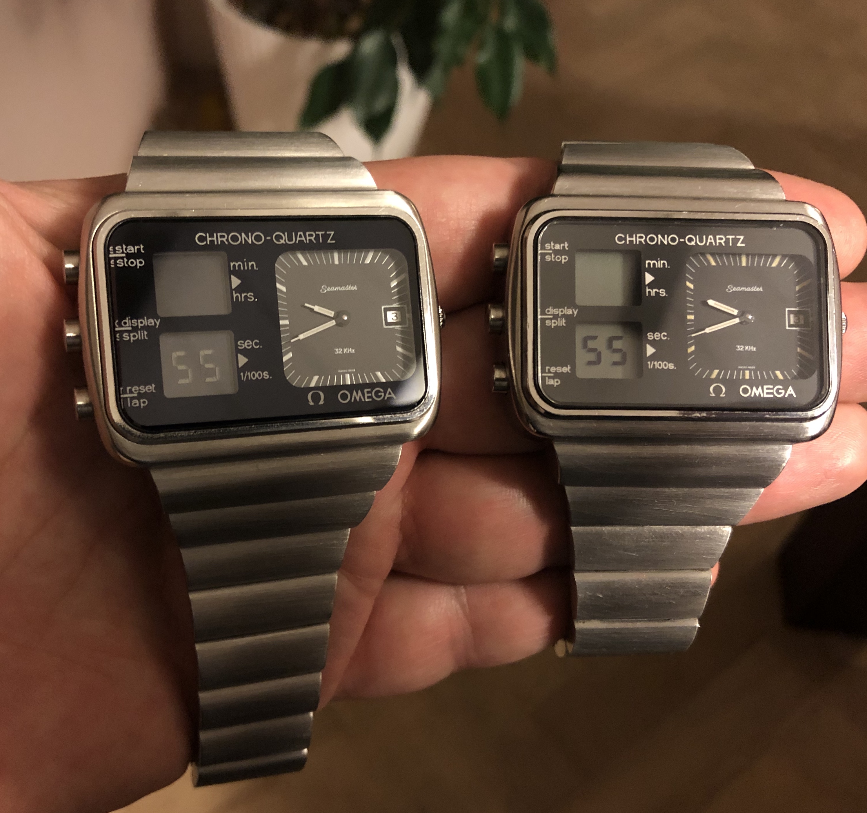

I made a side by side pic of the service parts watch on the left and full original on the right

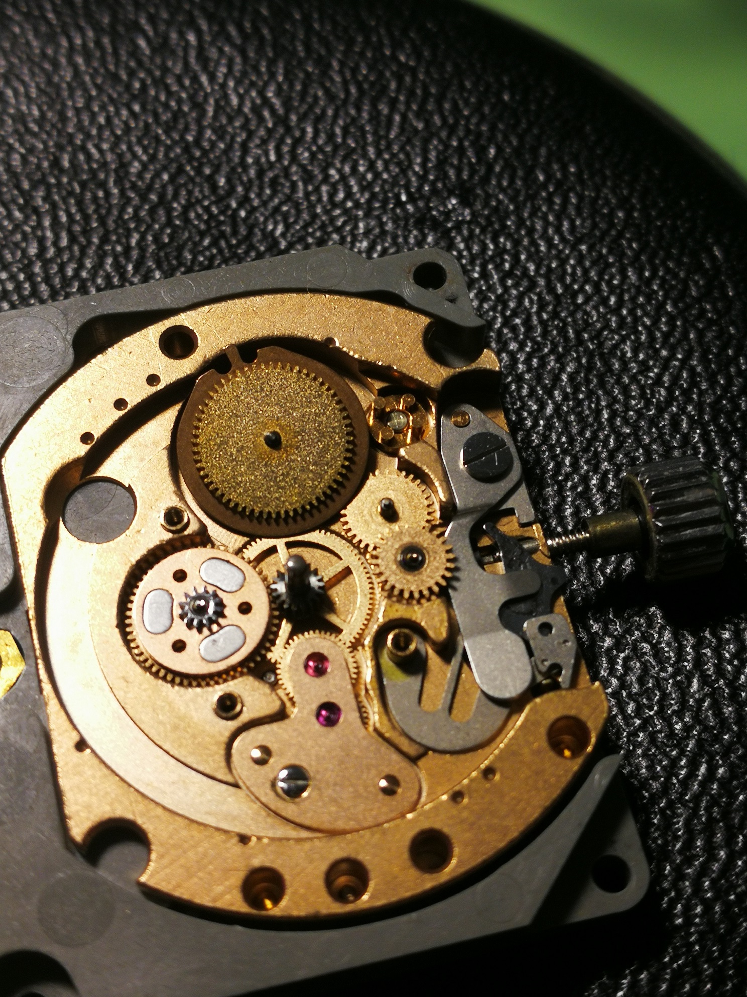

Hi Crazy,
I just received a NOS magnetic hour wheel and driving wheel, it ran fine for 2 days but last night had the same fault.
I am almost thinking that the motor doesn't have enough torque to push past the hour???? Or something is sticking somewhere???? It is a really WTF moment at this stage.
The hour hand gets stuck around 8:30PM each night and then clicks back to 8pm. The minute hand keeps going. It usually makes it through midnight but sometimes continues looping. Manually winding it sets the date beatifully.
HAAAAAAAAAAAAAALP!!!!!
5
All I can say that's it's never the magnetic wheel. Happy to help if you feel in the mood to send the movement or module to Victoria.
I don't have a movement in front of me but know this one pretty well. Notice the difference in the riveted wheel next to the wheel that kicks the date disc. This riveted wheel has four pins but there are 2 of each height. Make sure you position the larger wheel in proper alignment against this riveted wheel as both options are physically possible but only one will change the date.
At 8:45pm the date mechanism starts to be engaged and I believe that is the problem you are facing.
