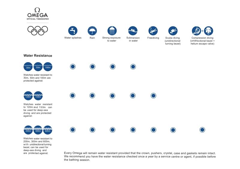

Local AD referred me to this chart - and that showering and swimming is considered perfectly safe.... just FYI. I am certain people have seen this chart before... but good reference none the less
