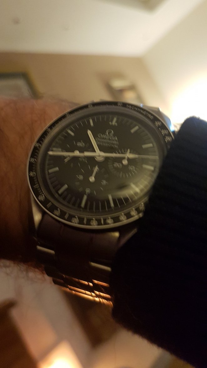

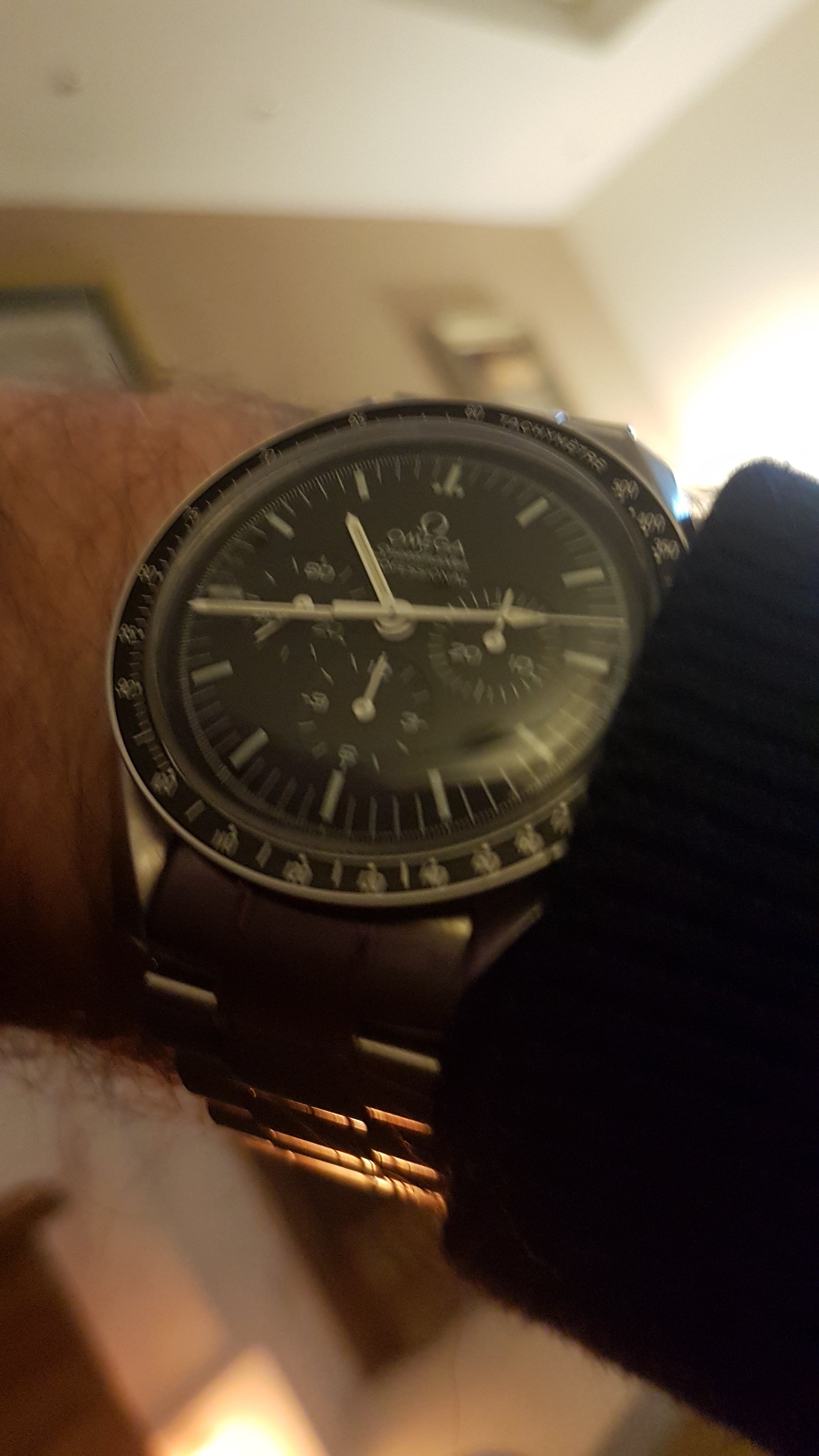

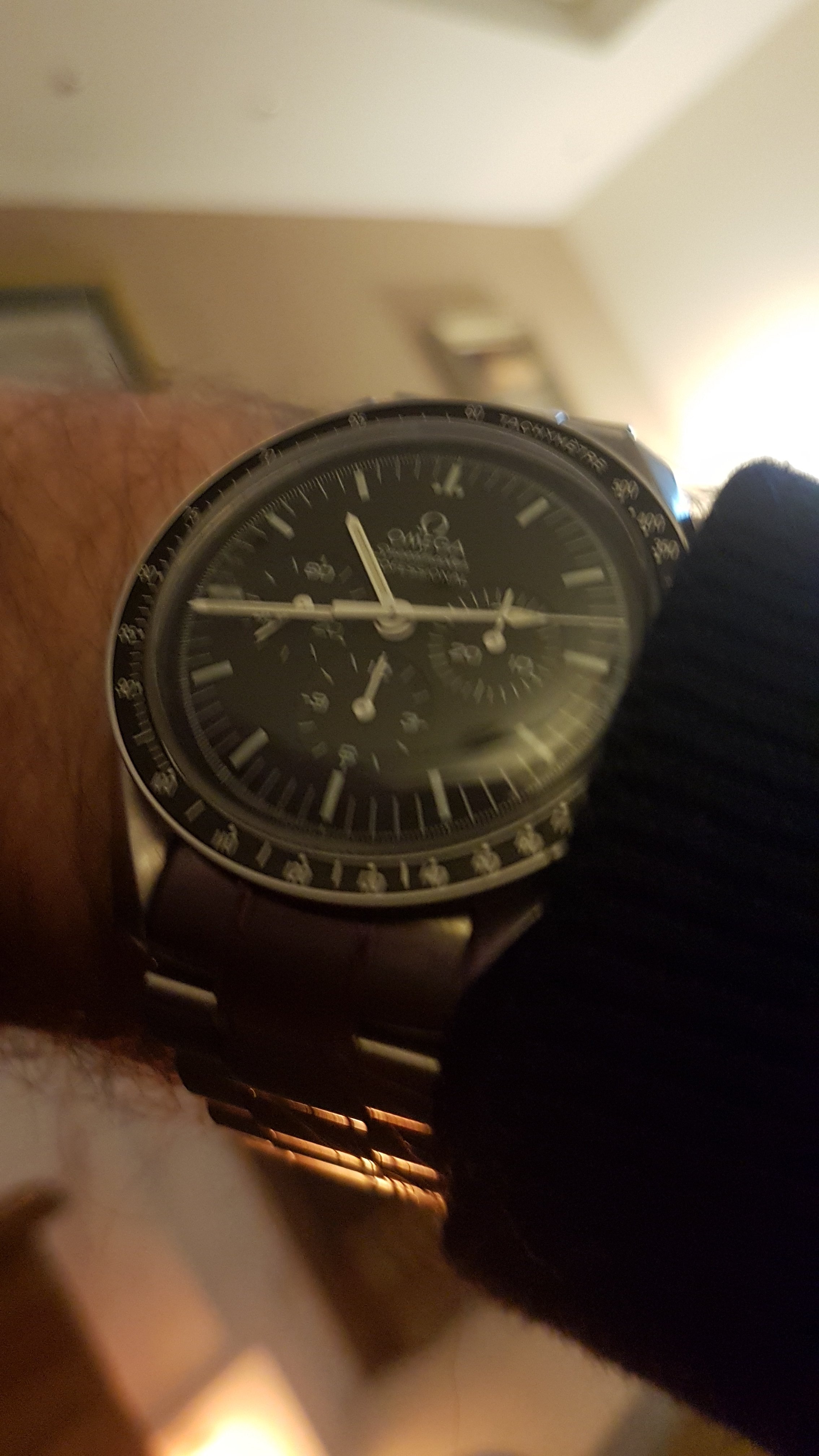

Hi guys,John here, I just joined tonight. I have had a Seamaster Professional Automatic for the past 6 years but treated myself to a Speedmaster with Hesalite and Manual Winding. Call me sad but I walked into the shop to buy it on the 11th day of the 12th month at 13:14hrs. This was to represent Apollo 11 and 12 and then Apollo 13 and 14. At 05:12 hrs that night was the full moon and I got up at 5am to introduce my moonwatch to the moon at precisely 05:12.Very sad but very true..... I have the main tachometer hand stopped at 13.8 seconds for the Apollo 13 final approach burn. Love the history of this watch. ... looking for some words of wisdom regarding the winding of my watch. When winding it's really hard to tell when fully wound. No definite end wind. On winding it, each turn it turns back on itself. The strangest bit is that twice it has stopped but the second hand has kept going. This makes it challenging to tell when it has actually stopped. Is this normal?

Lol......I know they travel more slowly but the time had fully stopped for about an hour. Actual time tonight was 20:15 hrs and the watch showed 19:25 hrs.....but the second hand was still moving.....has totally confused me

So a “wee while” is pushing an hour...well that clarifies things significantly.
Loose cannon pinion is likely in that scenario, so something it needs to go back for.
