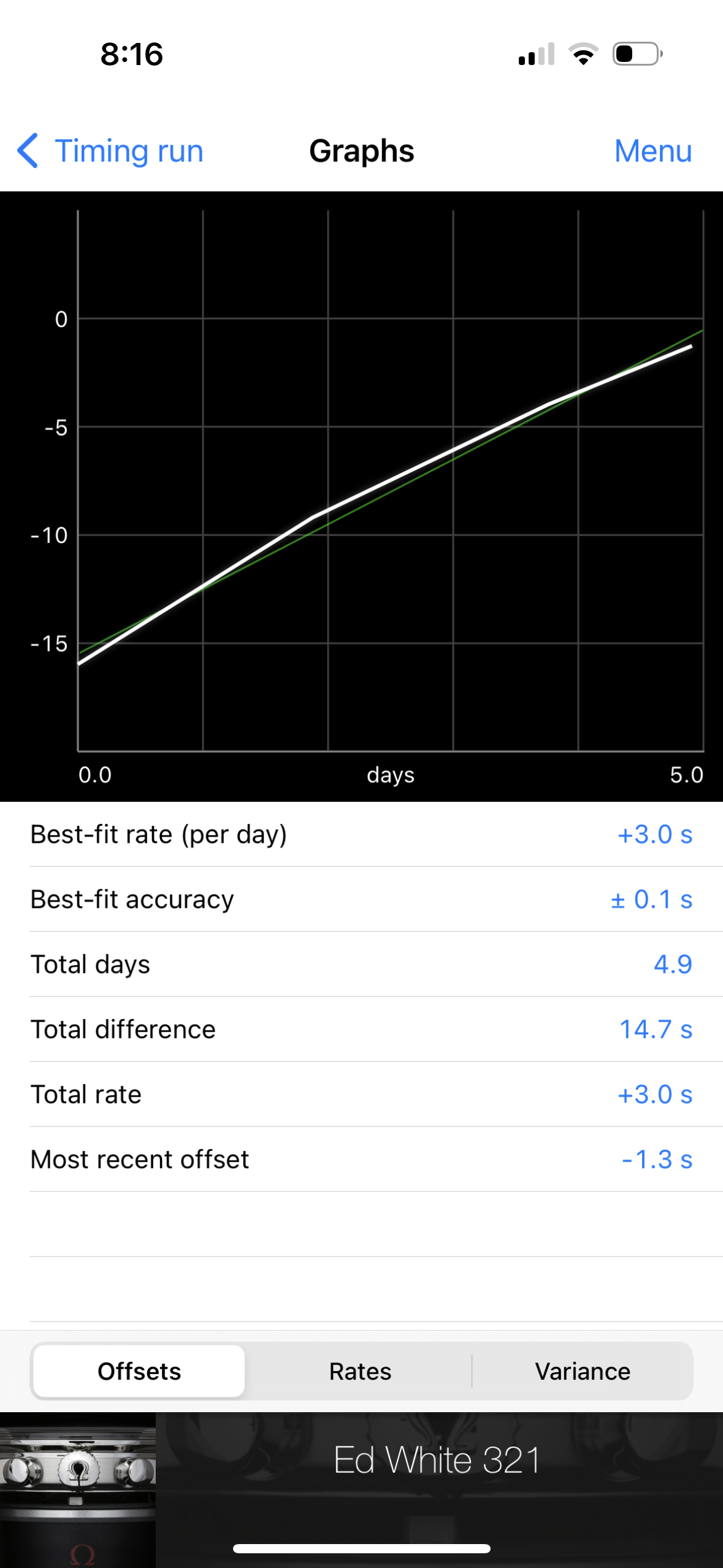

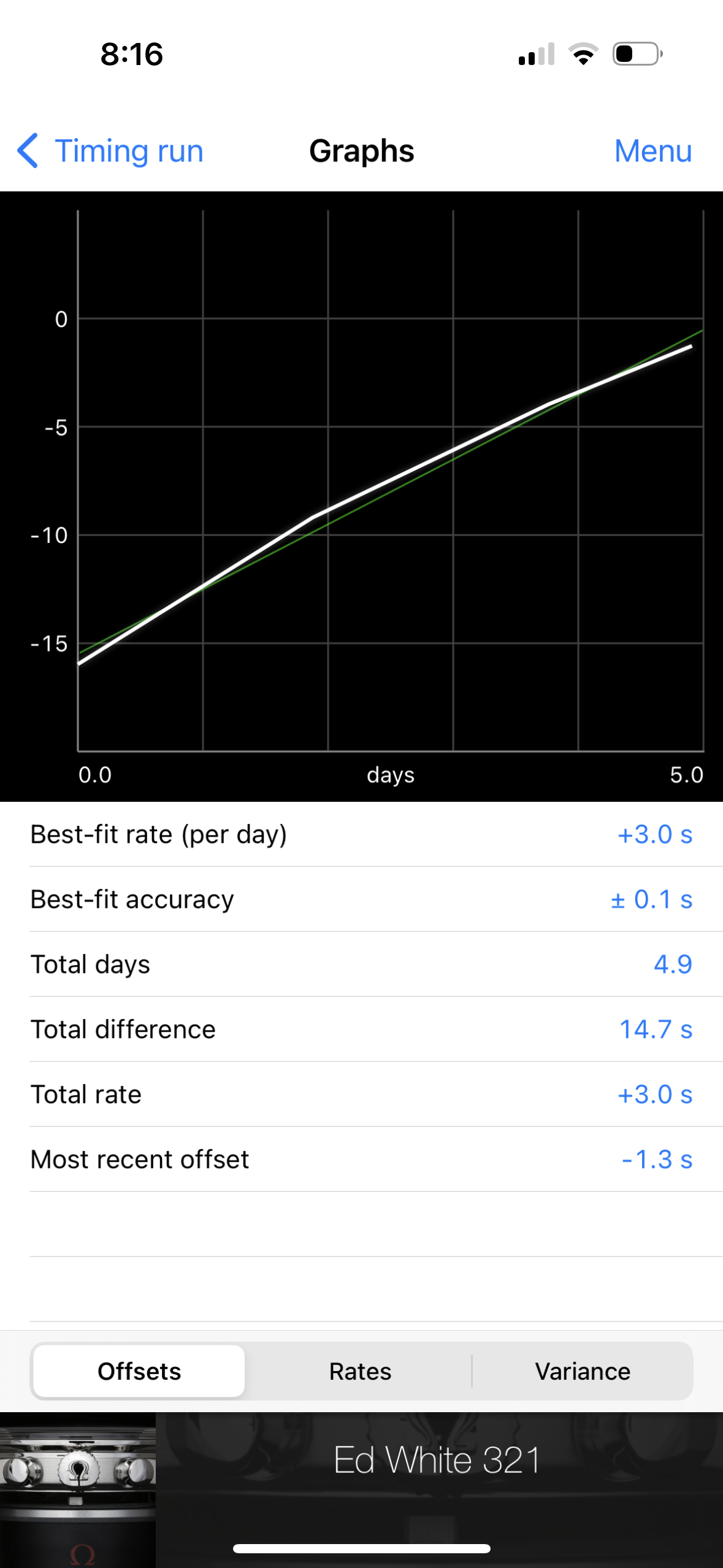

Have only owned mine for 5 days, but began testing accuracy on the way home in the plane, no internet access had me looking for something to do. +3.0 /s with fastest daily rate of 3.6 and slowest of 2.4.
Have not had a specific daily winding time as yet, so I imagine the variance will improve simply winding the watch at the same time each day.
