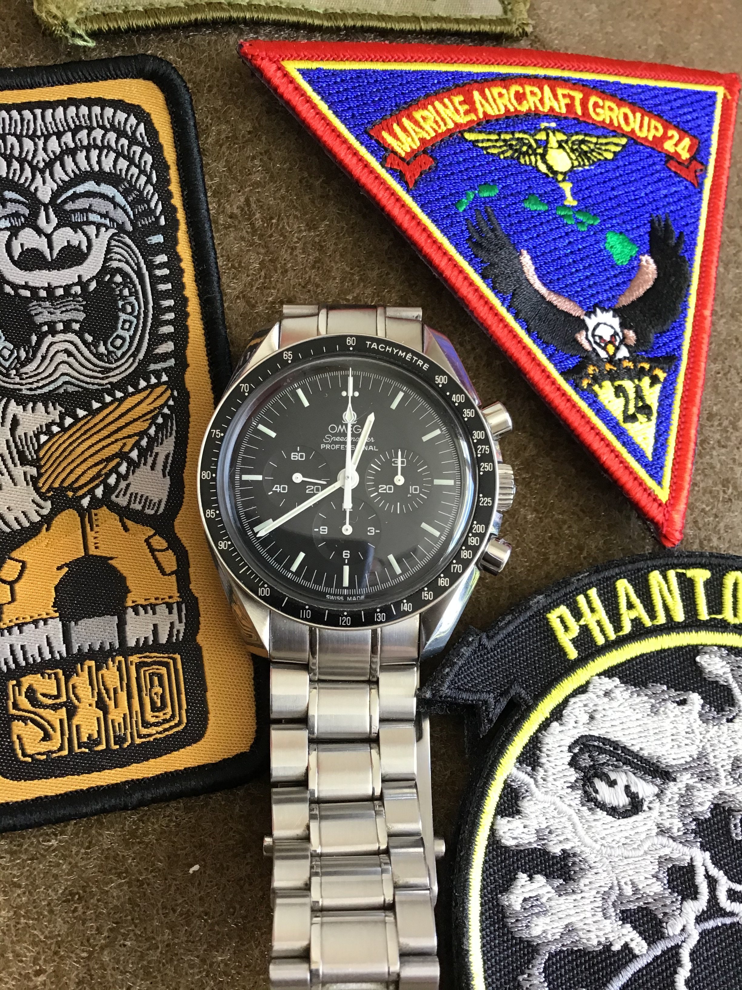

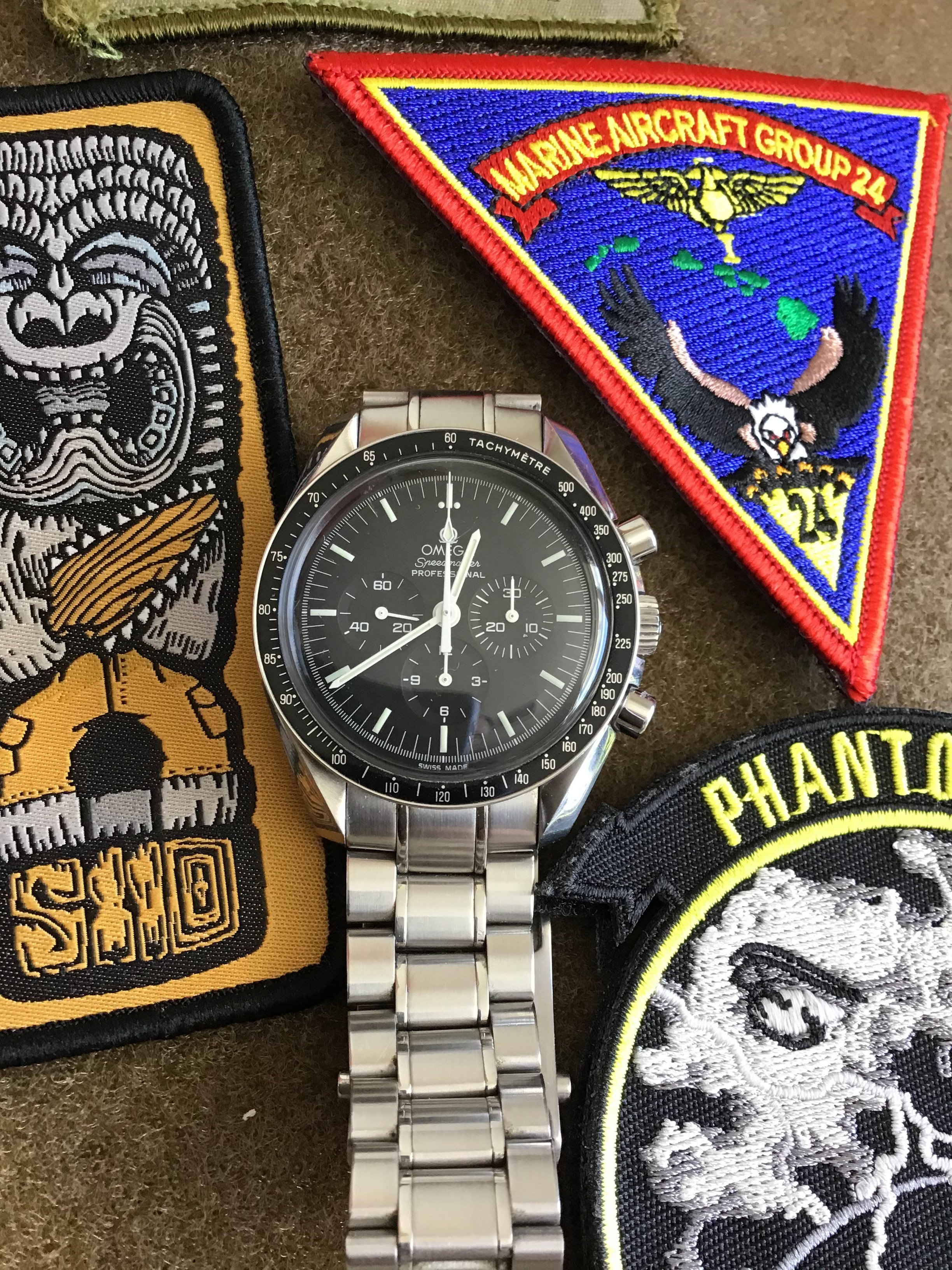

Have worn a Speedmaster for 10 years and never timed it or bothered. Check it with the TV news in the morning occasionally and always set it to correct time the once or twice a month it’s usuall 10:30 for several hours (forgotten to wind it 😉 due to change of shift or been awake since 1am on a work call out and scheduled has changed)

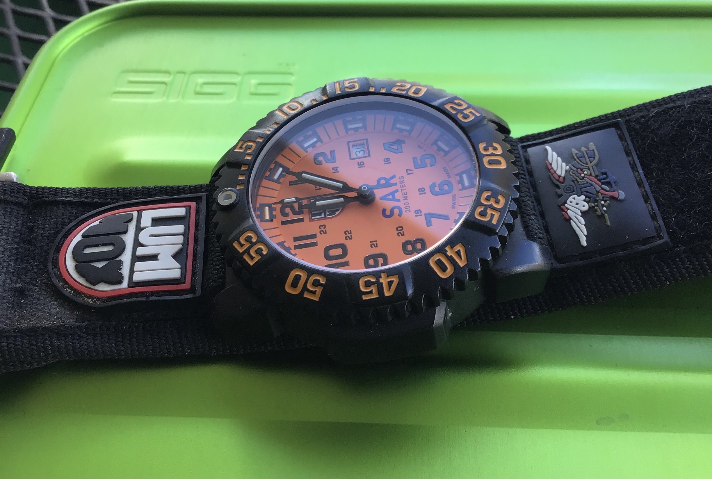

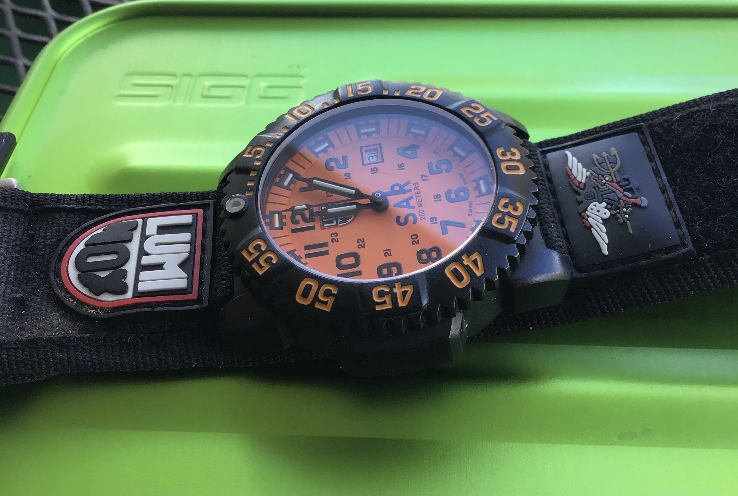

Luminox watch is my best time keeper
