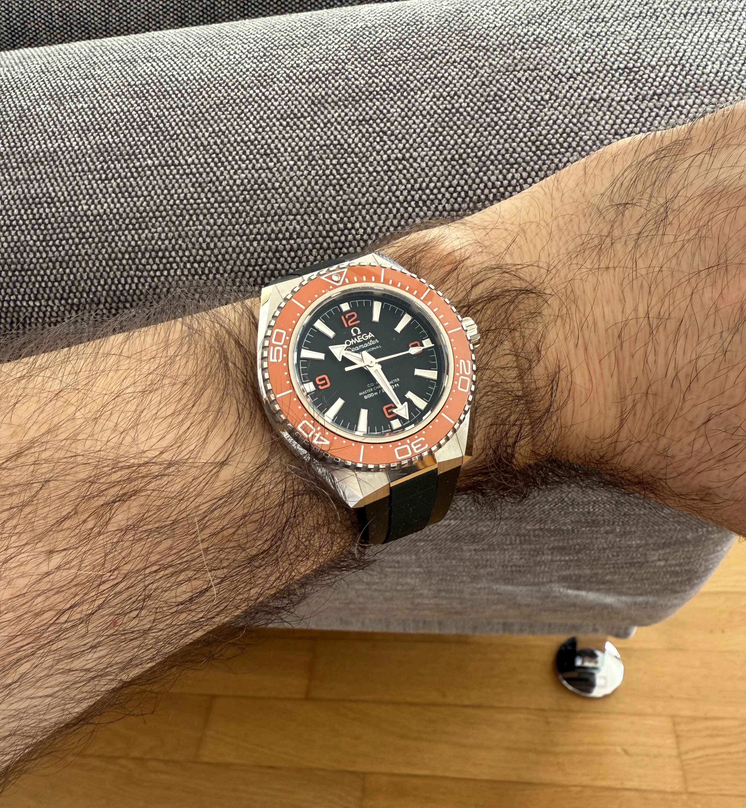

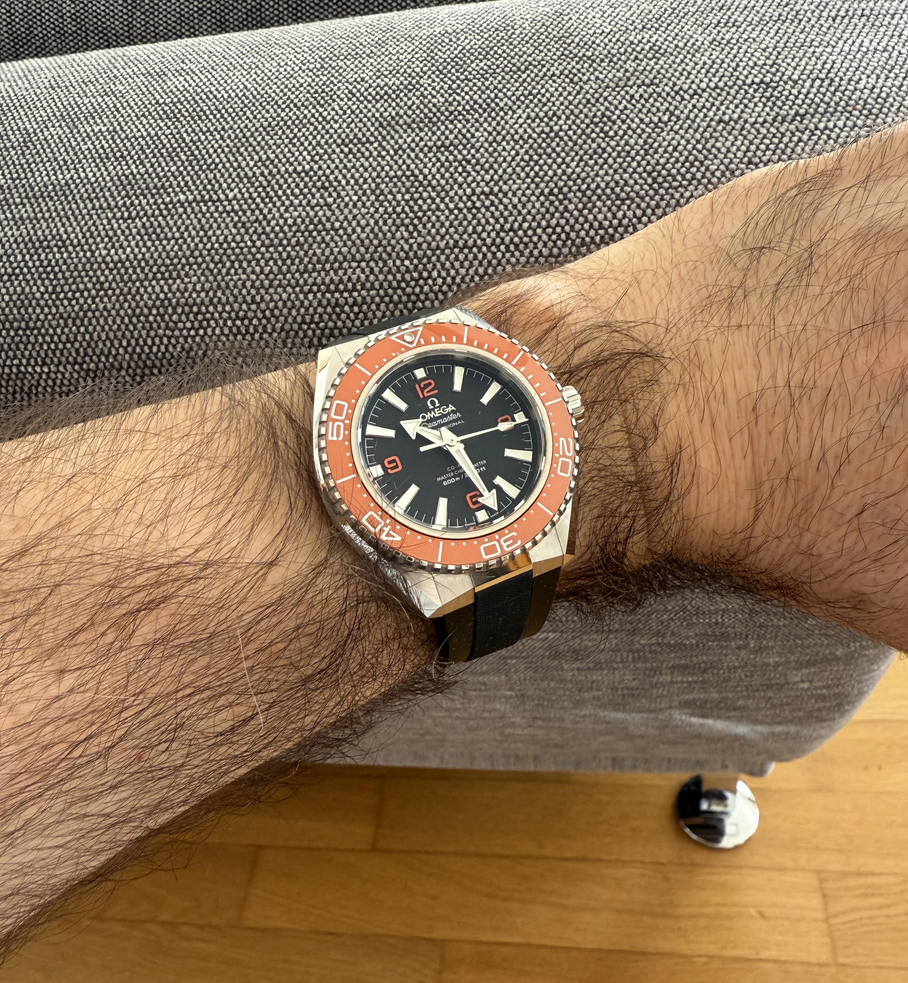

I love most everything about the new PO but wanted to see if other owners are seeing the same kind of side to side bezel play that I am. I’m used to some rotational play - my 8500 PO has that - although my SMP 8900 is bank-vault tight.
But this kind of looseness seems like it does not belong on a $10k watch, like the insert is ever so slightly too large.
My boutique says that every example they have in stock shows the same kind of play, and I checked out another one to confirm. They also said that other customers have remarked upon it.
They are not sure if it is something service would/could fix, and I’m not especially keen on waiting 3 months after just dropping this kind of cash.
Curious to hear from other owners if they’re having the same experience.

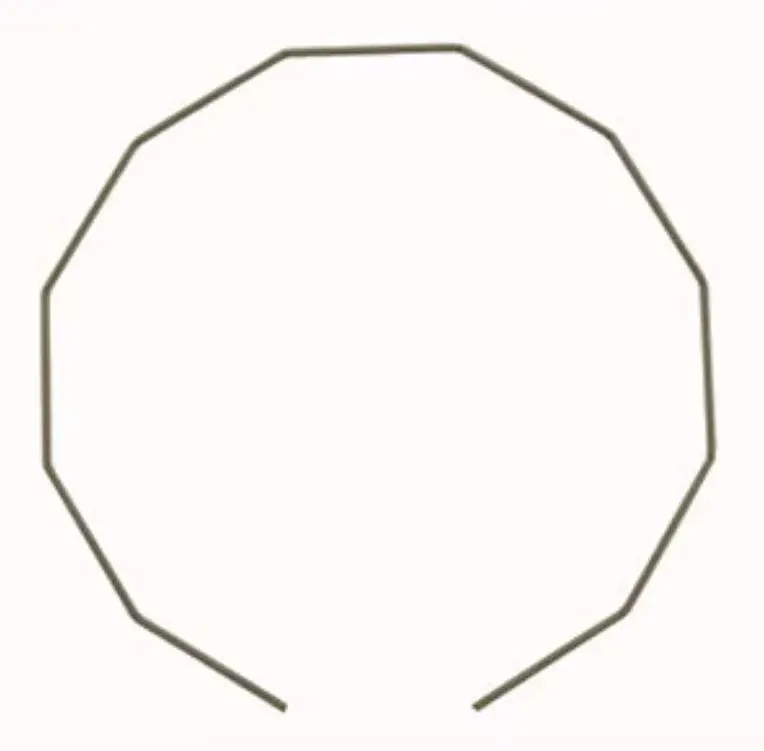

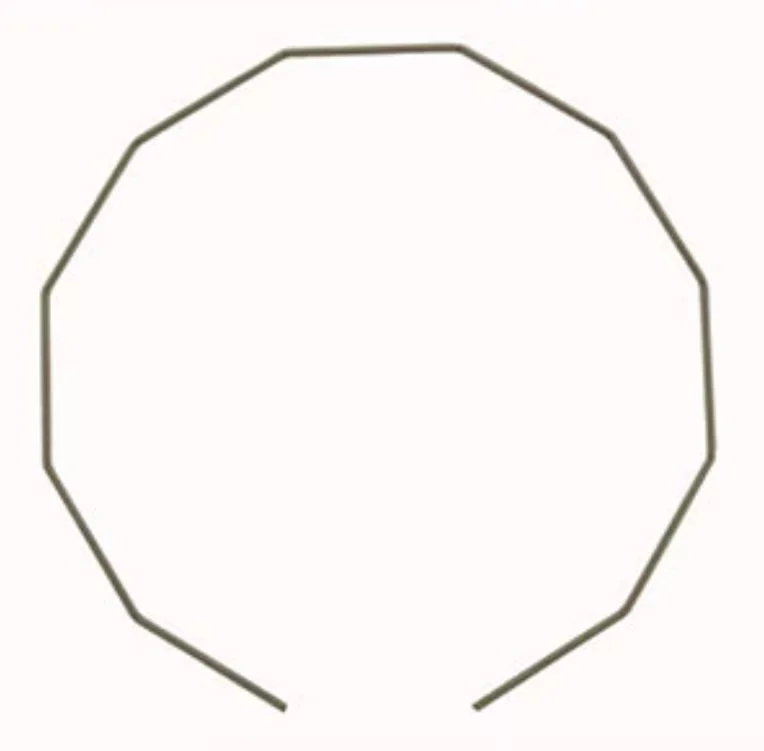

Maybe @Archer can confirm, does the Omega bezel use a gasket?
Edit, just realised (thanks to @Meme-Dweller) that the bezel is held by the hendecagonal spring (had to look up 11 sided polygon 😁).
Obviosly a faulty or incorrect spring, should be an easy fix.

Quite gently, actually. Not using much pressure at all. It feels quite loose in every direction.
The action itself isn’t great - maybe a step up from my 8500 PO - but significantly less solid feeling and “creamy” (if that makes sense) than my 8900 SMP
But I’m really only complaining about the side to side movement
