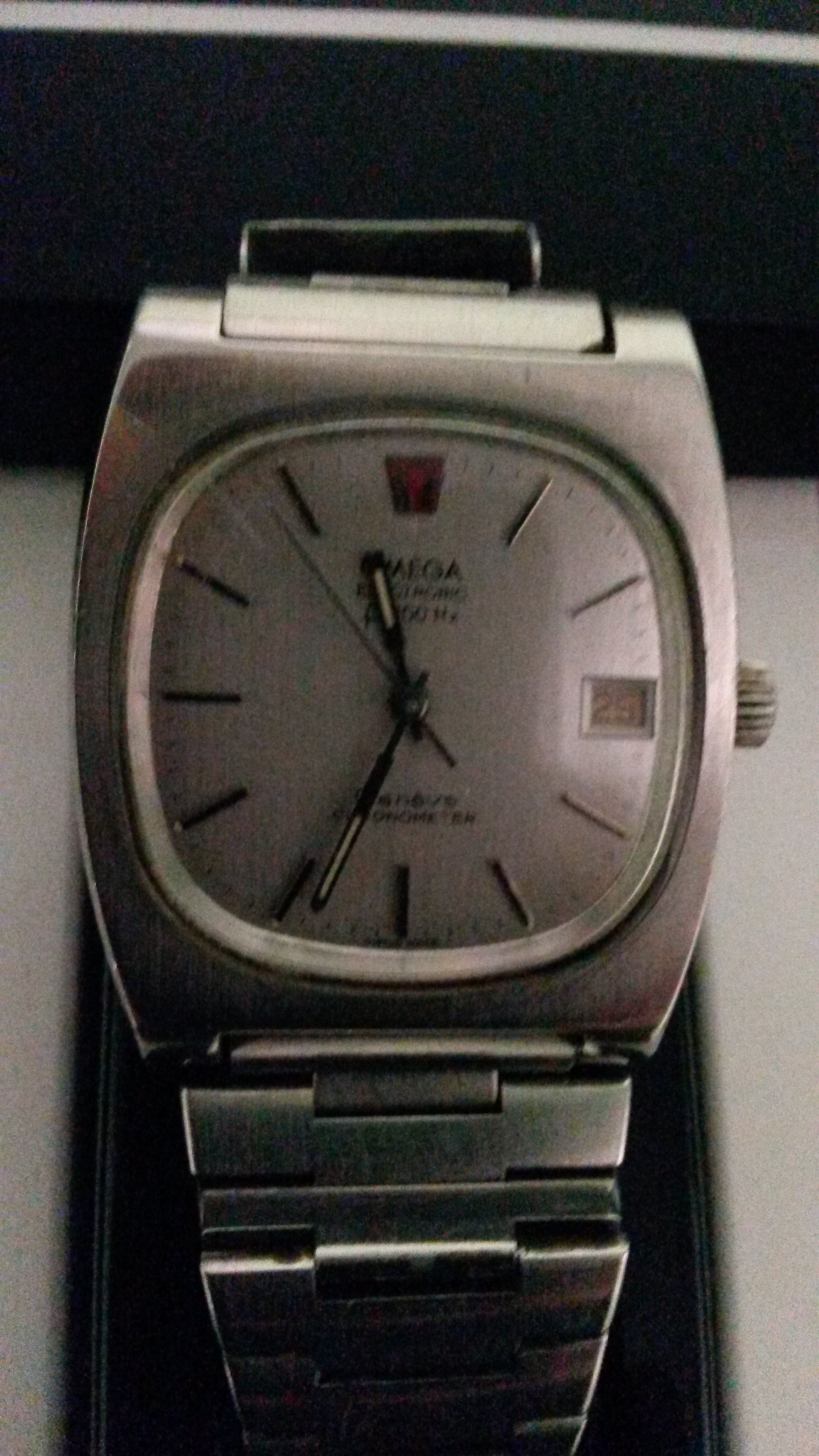

Hello all, just joined up and thought I'd introduce myself and my watch. It's an Omega f300hz Geneve Chronometer, given to my father by Heinz for 10(?) years service circa 1974. I just recently inherited the watch and am keen to find out more about it and get it in tip top condition. From what I can gather it's quite rare, quite collectable but not particularly valuable. As you can see in the pictures it's in quite good condition but absolutely embarrassingly filthy! Of course the date function doesn't work. From my research it seems most likely the calendar wheel has a broken tooth/teeth and it seems virtually impossible to find a replacement. I've contacted various Omega independents who have told me I've got pretty much no chance. One place, Swiss Time Services told me that they have the part and could fit it but have been told by Omega that they are not allowed to as a watch of this vintage can only be fixed by Omega themselves. My search is further frustrated by the calendar having red text on a white background which according to STS is quite unusual. The search continues!
If anyone has any information on this watch, production dates, is it actually any good etc then I'd love to hear about it.

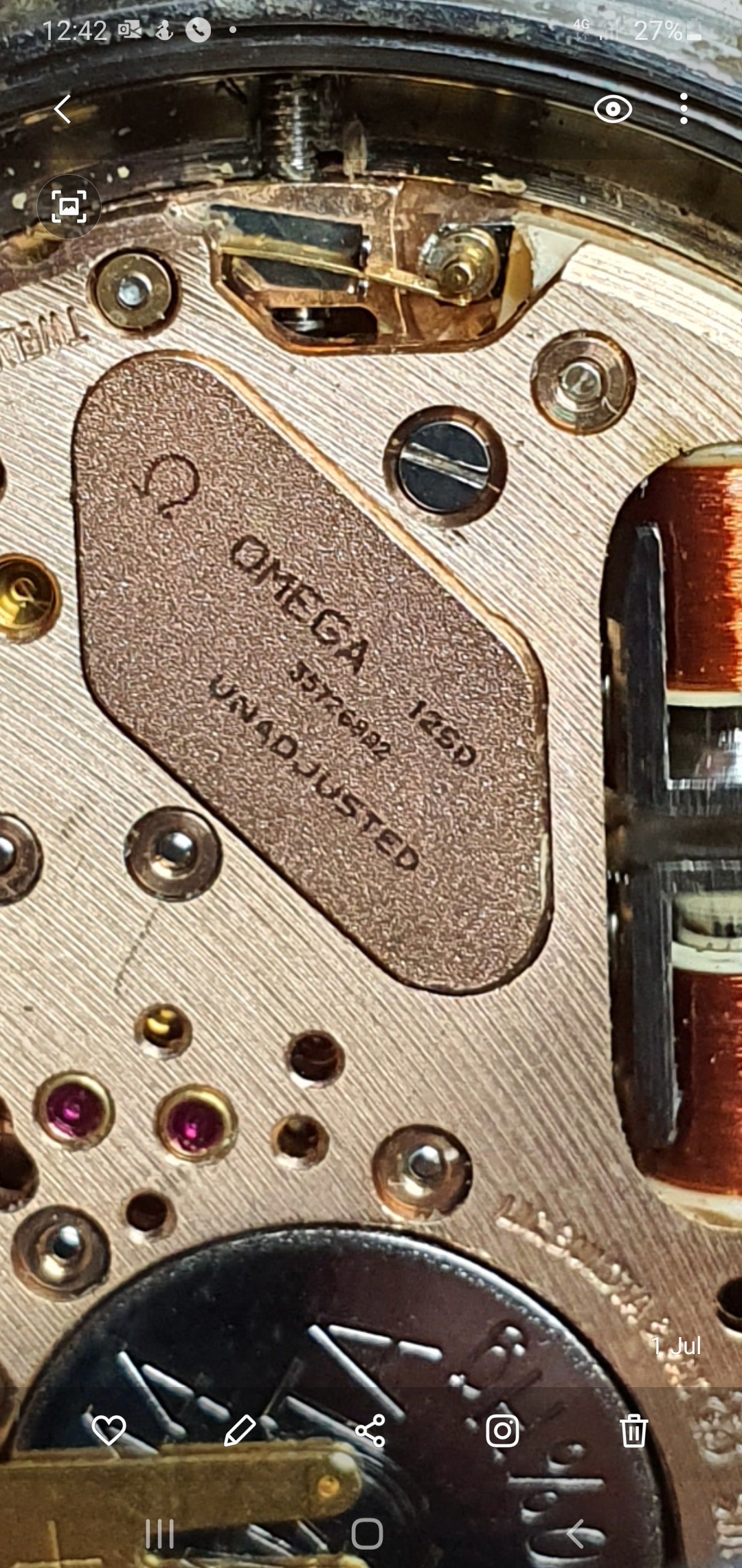

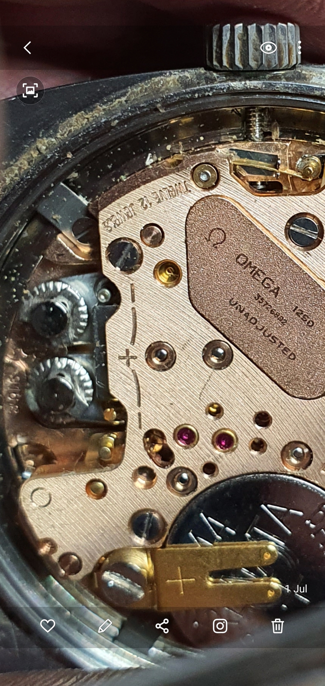

The case back is blank. Are the numbers on the second photo I posted relevant or useful?

Where do you see that it's a 9162? The photo shows 1250.

Apologies, I'm not as familiar with these electric watches. It would appear this is all I need to know. The Omega 1250 is the ETS-ESA 9162.

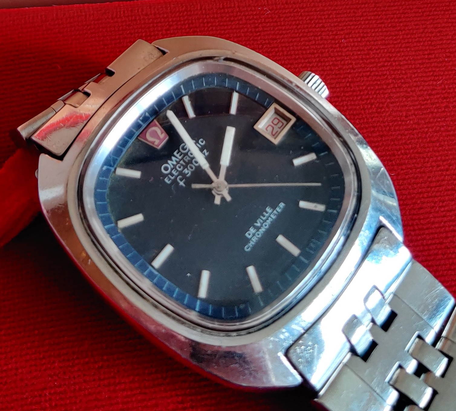

As a side note, I share with you photos of my f300 DeVille with a red date ring (that's how I found this post searching for more information on this topic)

After Omega got out of the f300 business, Titus bought up some of their old stick and then made some of their own. My Titus has the same movement as yours, seen here:
