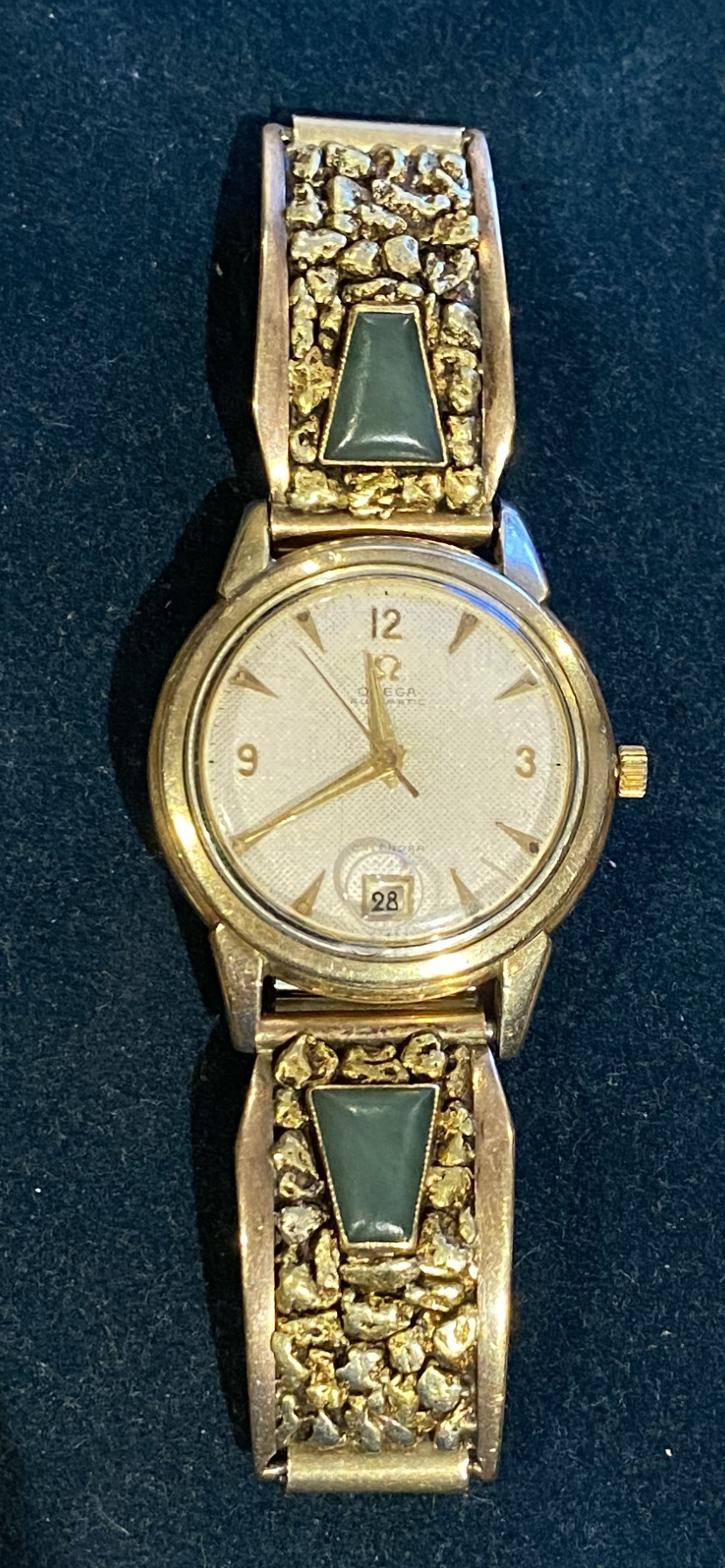

Hello!
i'm looking for help.
I think I already know that the main response will be for me to take the watch to a watch maker and have the back opened up and get the serial numbers....
BUT....

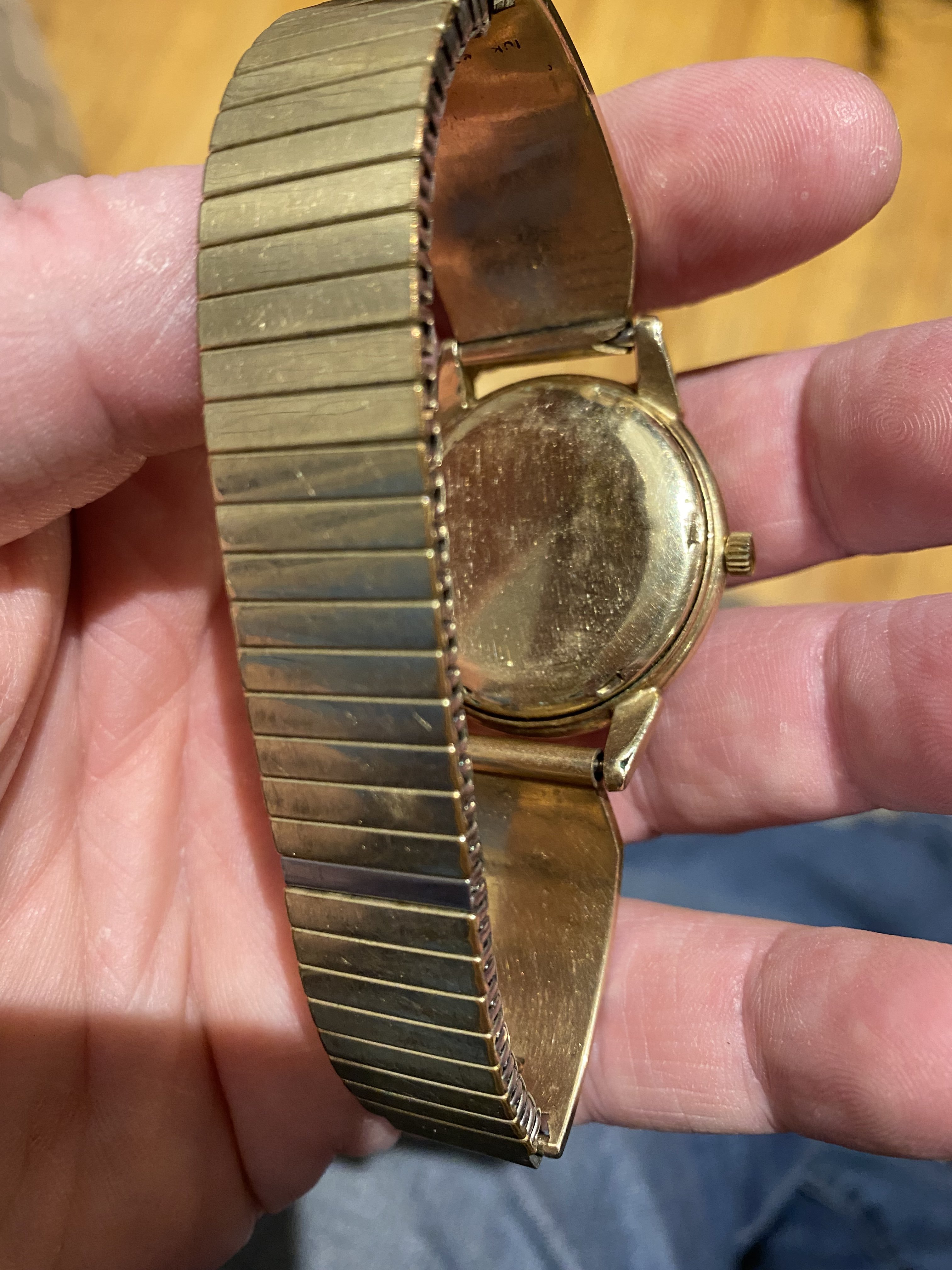

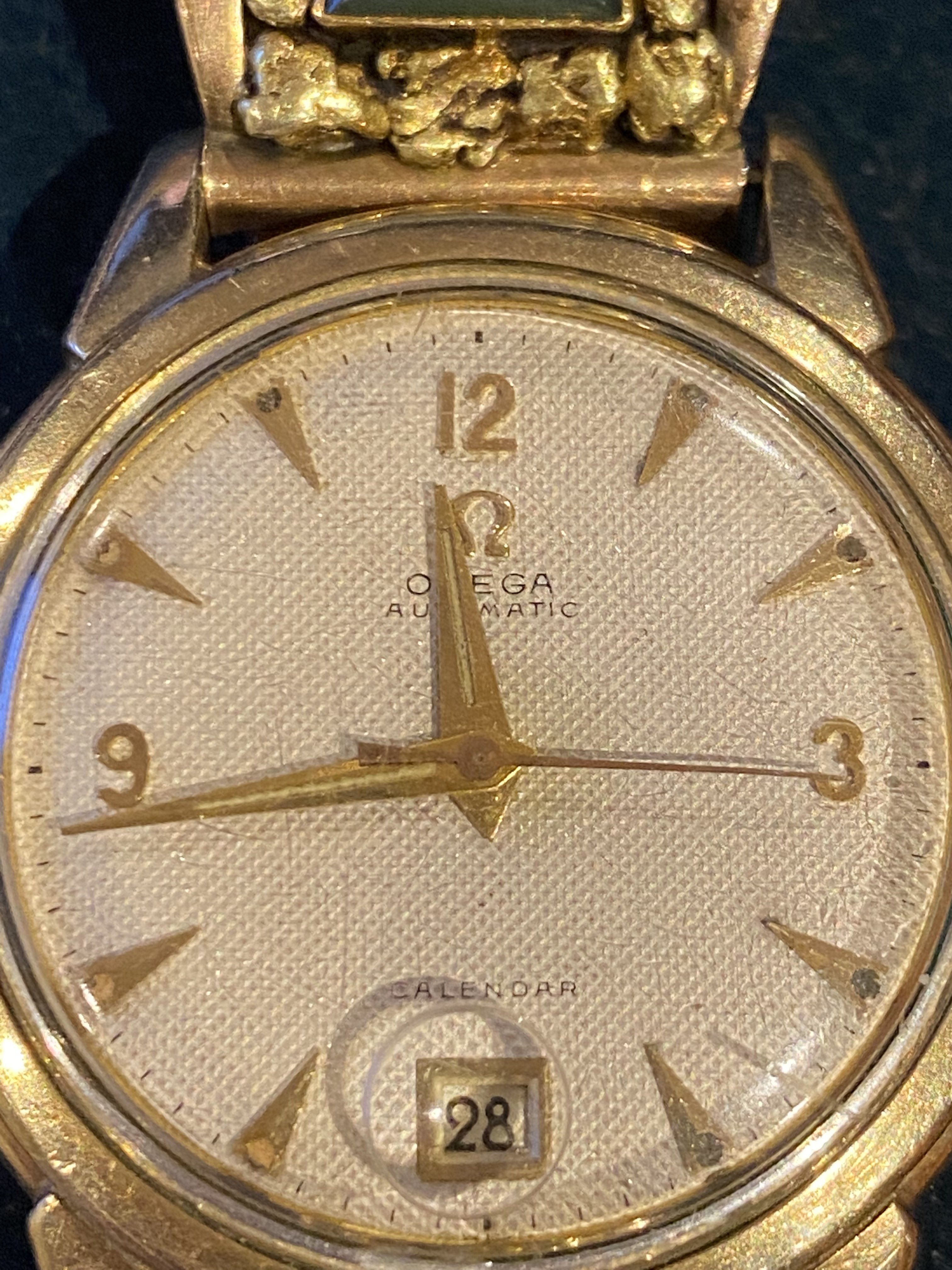

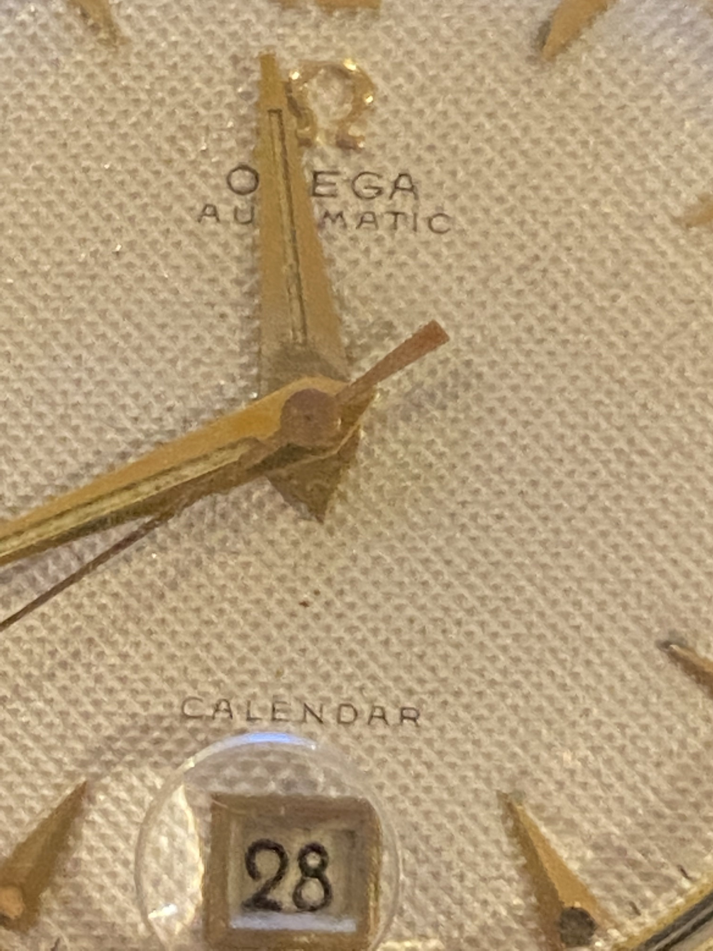

I am wondering if anybody can tell me why my grandfather's omega watch only says "automatic" and "calendar" on it. It does not say Seamaster or any other model on the face....
I would guess that it's a Seamaster, but every other picture I've seen of a Seamaster... the word Seamaster was written on the face.
The wrist band was modified as shown in pictures
I own this watch now
Thank you

I am waiting for the folks in the know but I have a genuine feeling that your grandfather's watch might not be a genuine Omega.
2,845
9,198
It's a genuine Omega. An early calendar model. Some said seamaster some didn't. It's not a swiss case (still genuine but were not imported from swiss to avoid tariffs) so opening may not tell you much unless you order an extract. I'd go with what @X350 XJR is calling it.

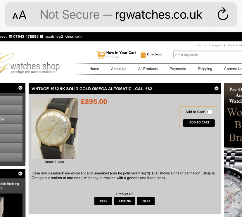

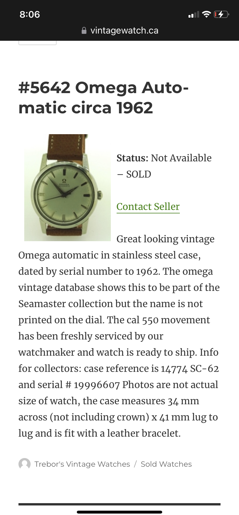

Here's a few photos and descriptions that I found online of other watches not sporting a name..

Looks like a ref 2627.
just had a look at the model online and I think you're right. It does look very similar!

Your heirloom is from early 1950's , but your pix of watches are from 1960's.
Nice heirloom
Thank you Tex
1950's would make sense time wise...
Any idea why it does not say Seamaster?

Early models had no model name, Seamaster appeared shortly thereafter.
And, like everything Omega......there was overlap.

Is there value in a watch like this? Or would the value be greater with the name?

Good value, but I would not get out your Sharpie and print the Seamaster name😁

Value is in the dial!!
Case appears heavily polished

The early watches were not marked with the family name. That refers more to the watch being waterproof with a screw down back.
I have been looking for a case for a caliber 351. I have two watches which are 344. The date at 6 is usually 353.
The more one works with these watches from the 1940s and 1950s can one see the subtle variations. Especially the dials.
Before the 1970s and the quartz crisis movements were sold as a commodity. The concept of Intellectual property was not as strong. Companies relied more on reputation and customer service. As others said, the Tariffs were high (to protect the so called domestic industry.) There was also a huge service industry to keep things in repair.
With the advent of transistor radios, calculators and cheap watches, all this stuff became disposable.
What most collectors look for is condition. What may appeal to one may not appeal to another.
You have a nice watch and a family heirloom. The value is in having it serviced to wear and enjoy.

Any idea why it would not say Seamaster on the front?
Yes, your watch predates the use of the name seamaster.

So, can my watch be described as a Seamaster? Or would it be described as a reference 2427? Or as something else?

I'm guessing it is a 2627 with a cal 353 -- their first foray into watches with a date window -- from the early 50s, just about the time they were bringing in the Seamaster line
