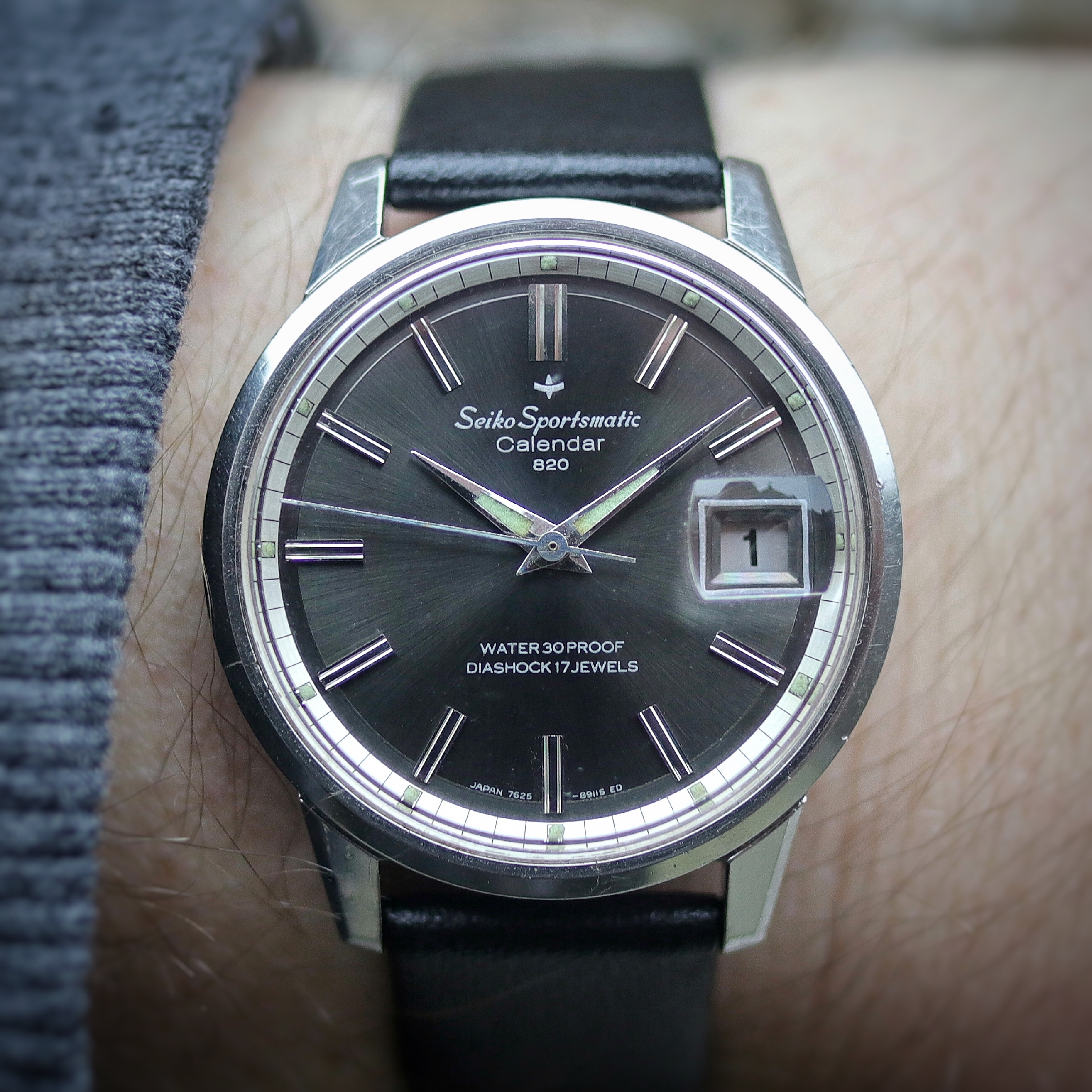

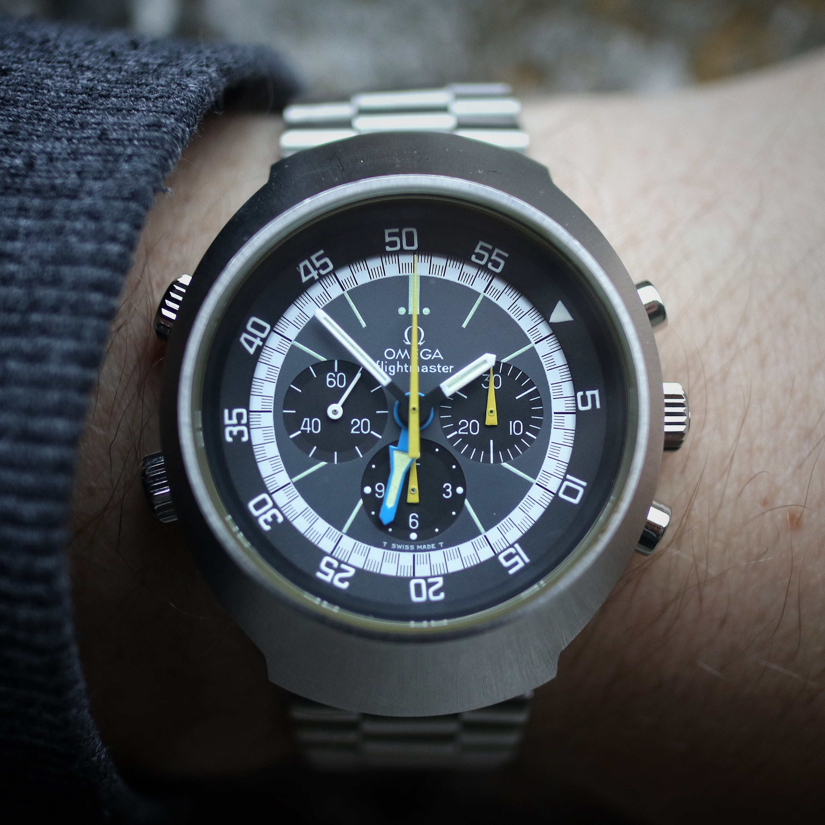

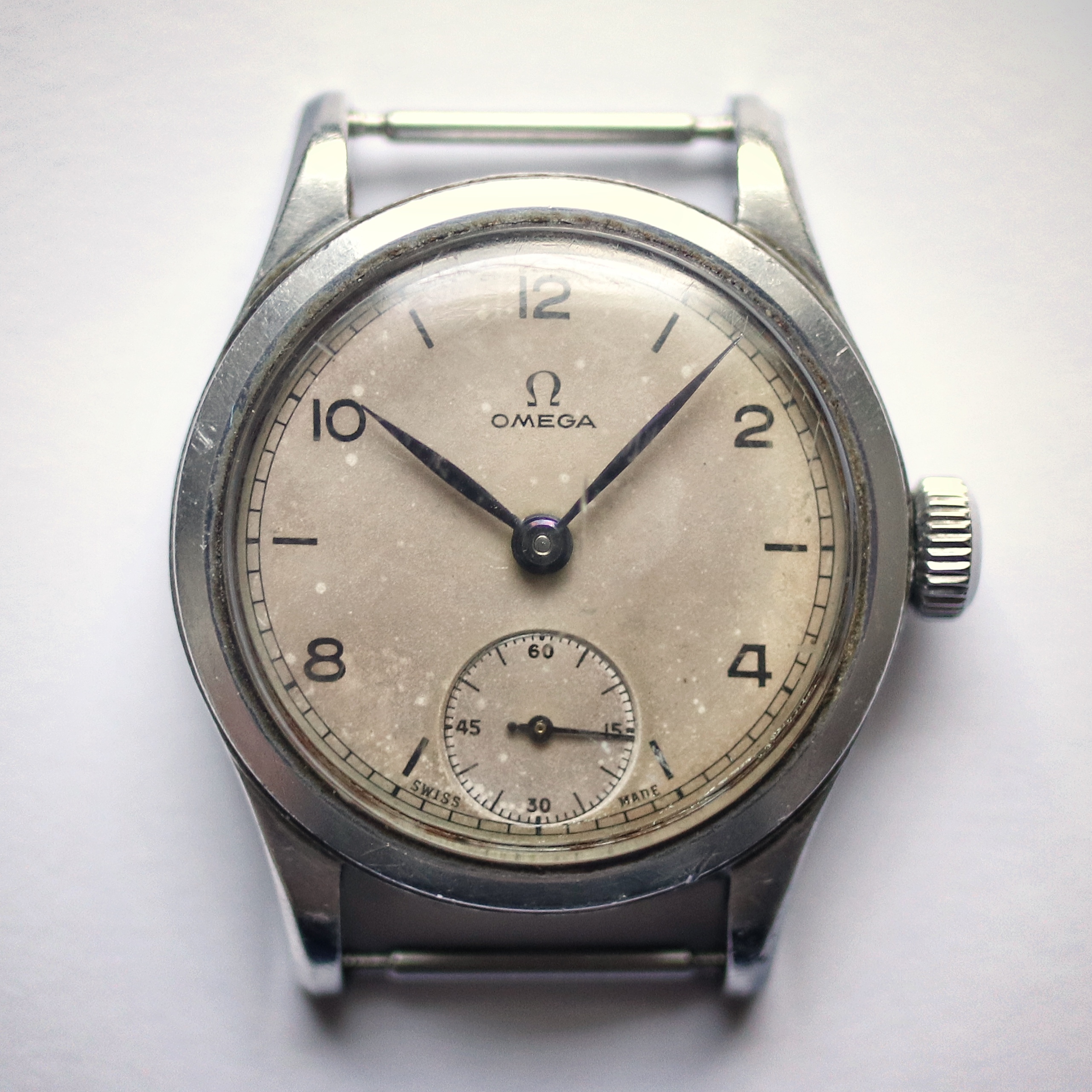

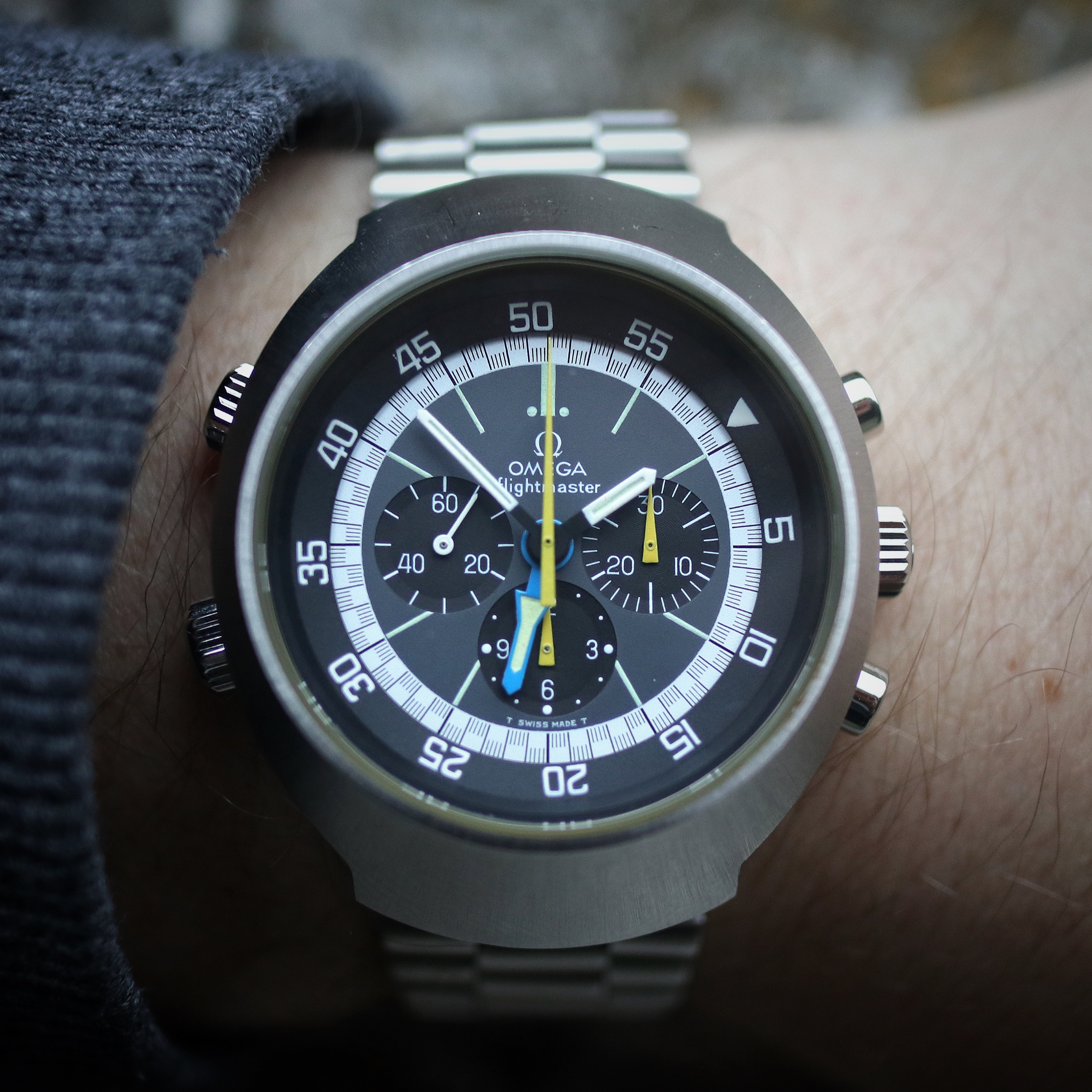

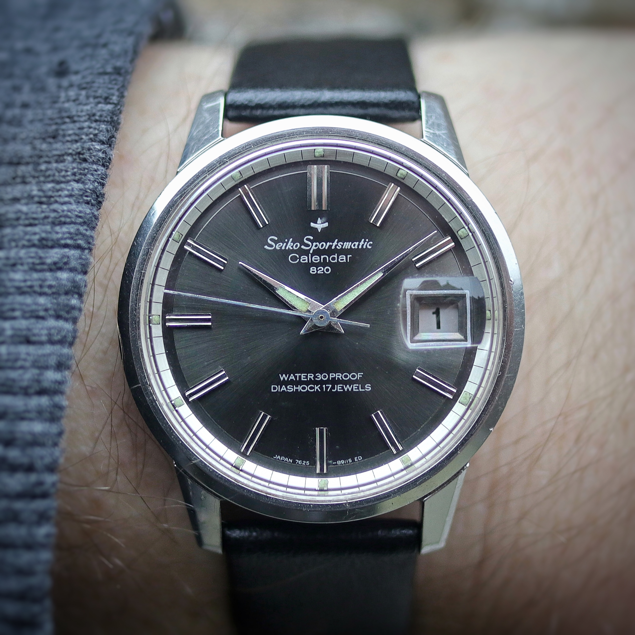

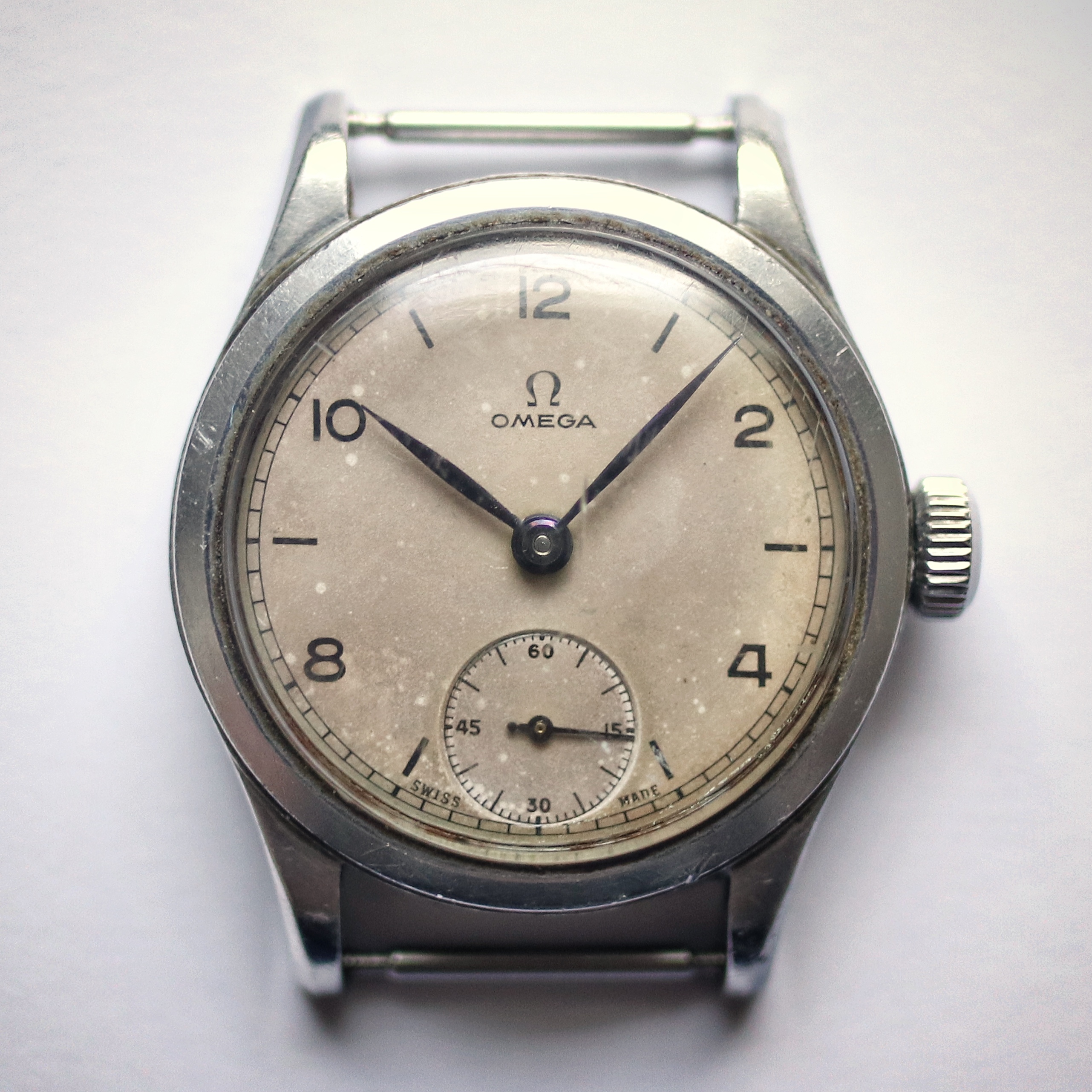

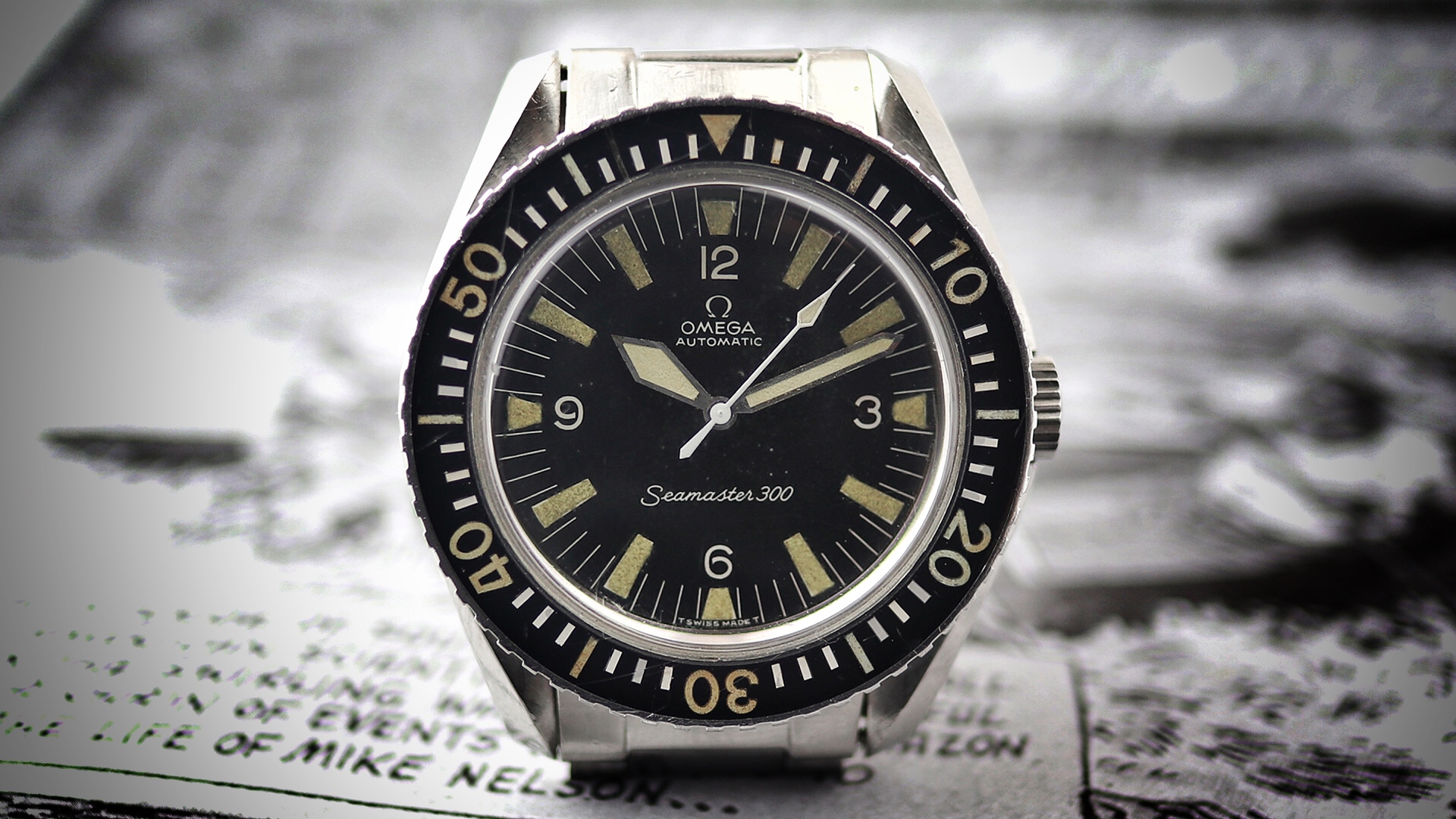

Been shooting an M3 and then M5 for a couple of years now - replacing an old 40D (and then the 3 with the 5).
A few watch snaps out of the M5, all from the EF-M 22

So macro 60mm not really necessary judging by those. How close are you to the watch with the 22mm Chris?
And how much is cropped?
8,855
28,095
15-20cm from the watches... not sure on the crop. Anything from a bit, to quite a bit. 😁

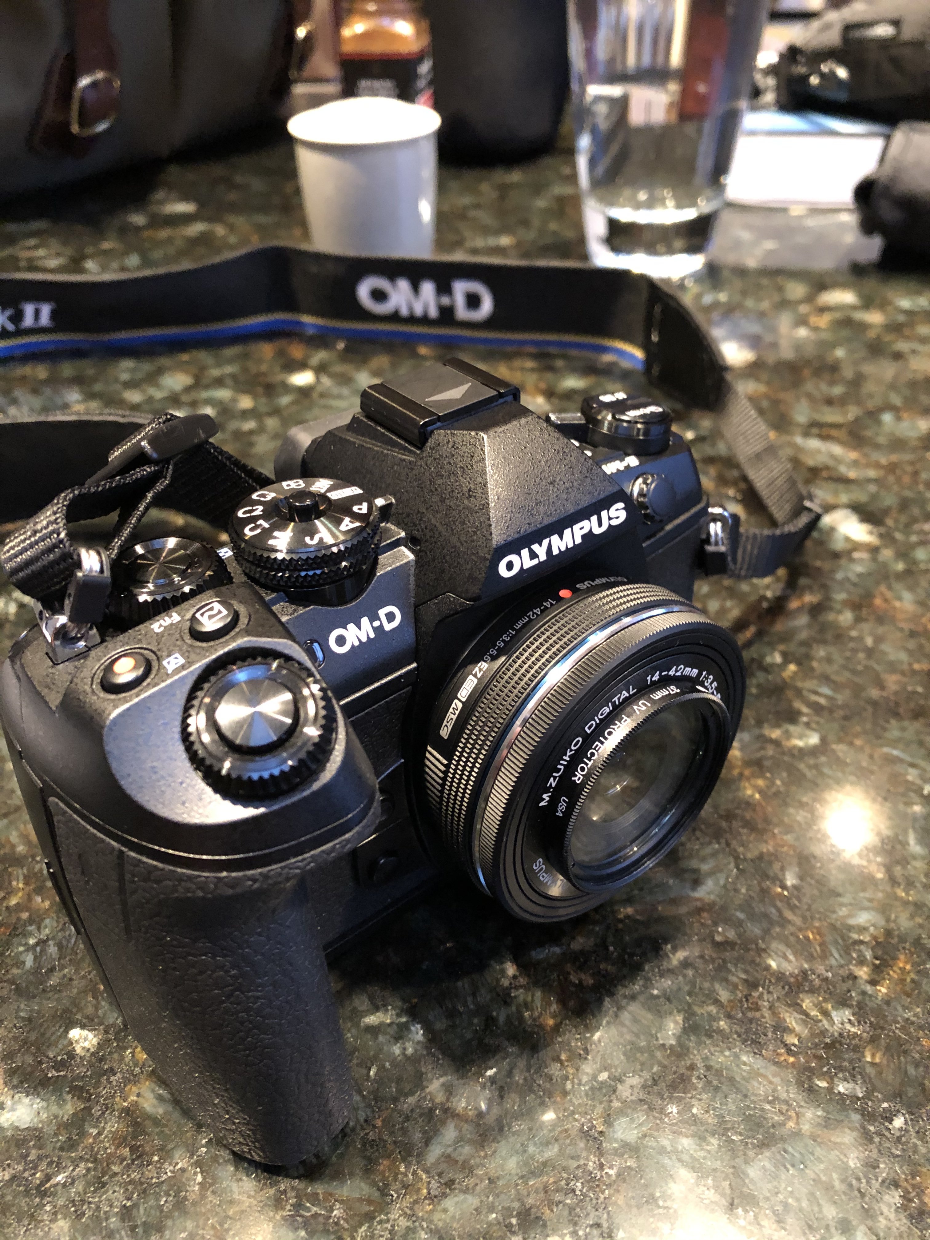

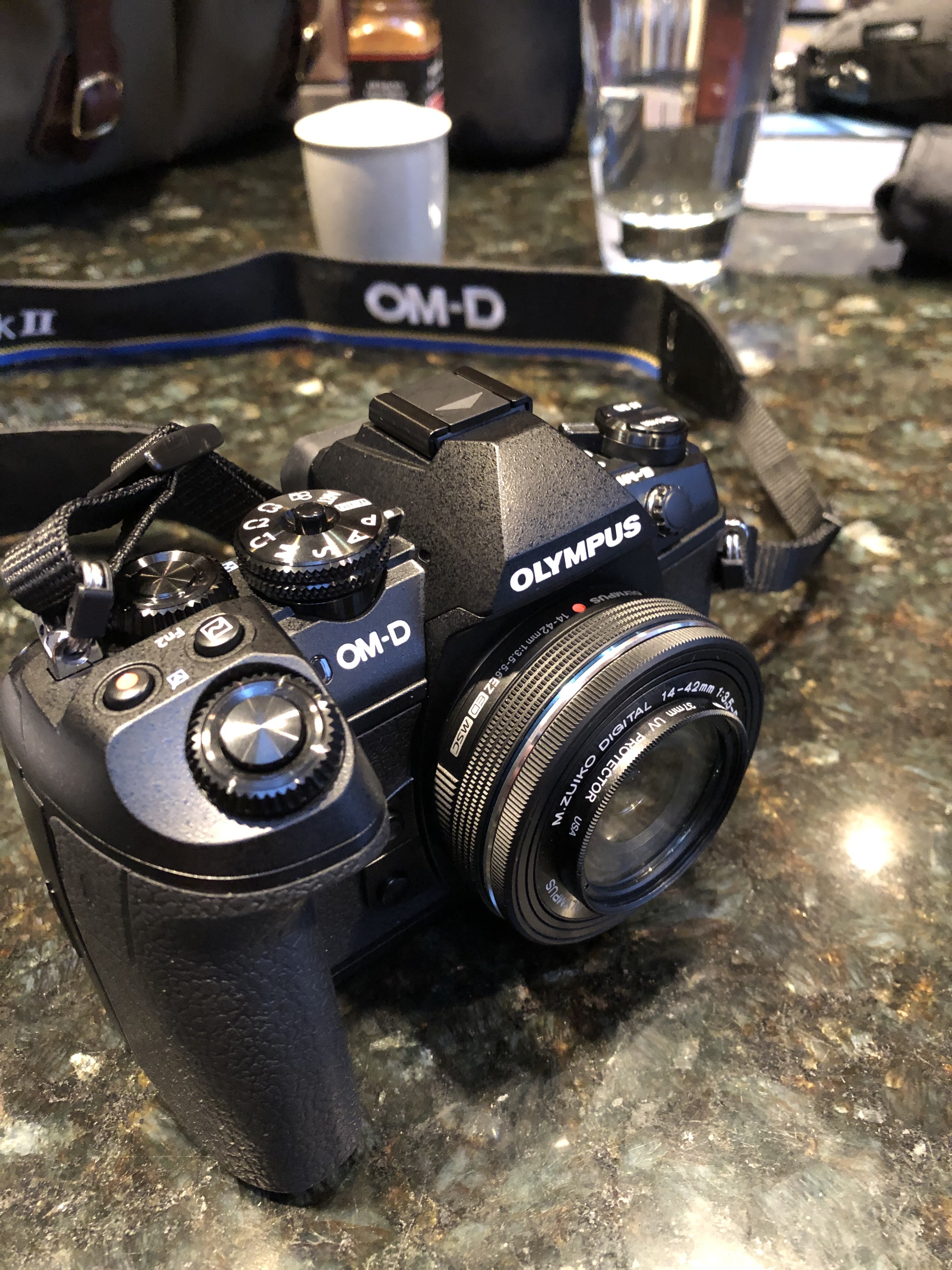

I went with a 3/4 Olympus OMD EM1 II in Sept. 12-200; 14-42 lenses. Very happy with it.

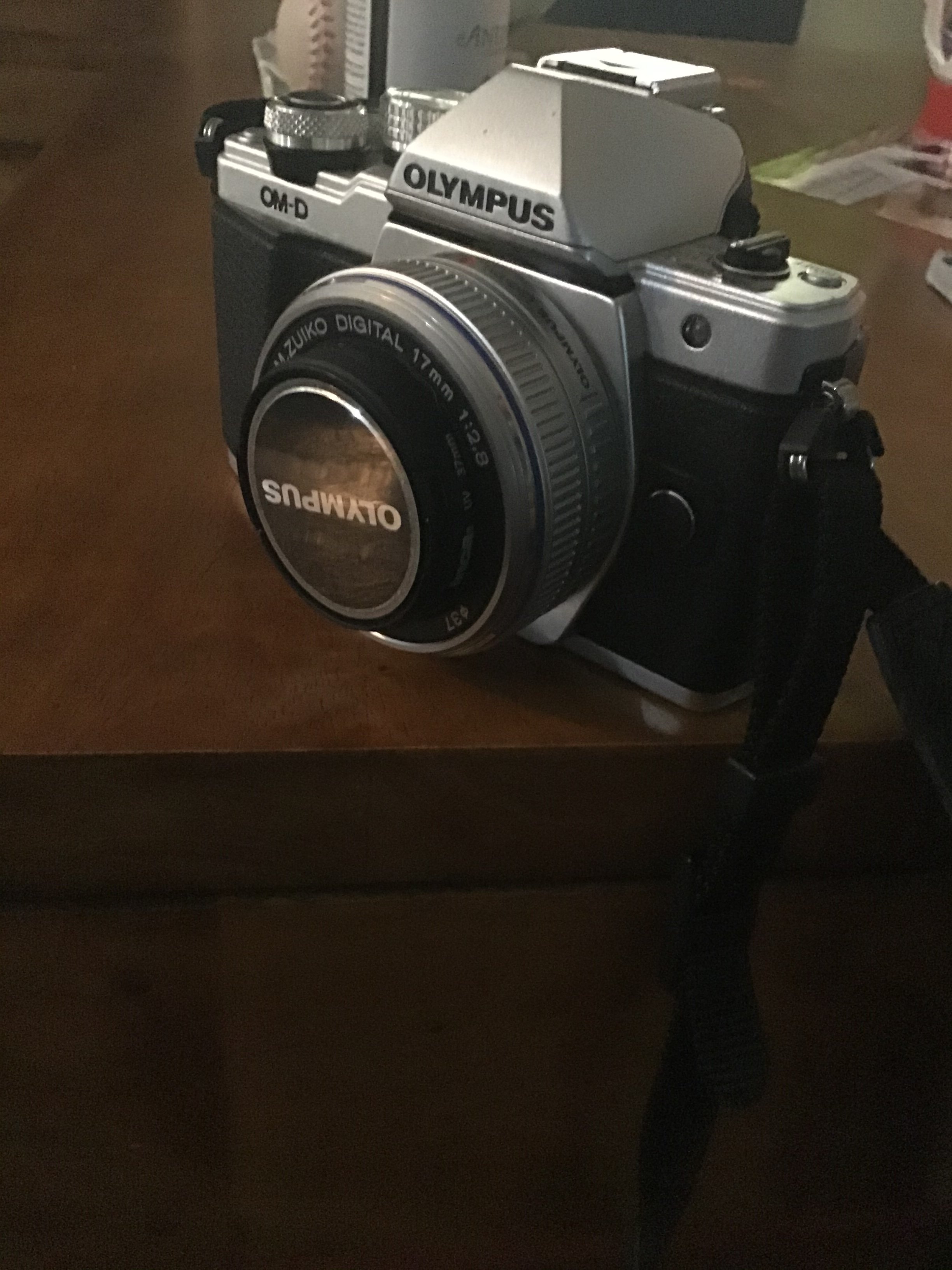

@Larry S I have recently put the M Zuiko 17mm Pancake lens 👍👍

@STANDY .....I may get one of those too. Right now the 14-42 works pretty well for street shots and is less bulky than the big zoom (which is awesome for nature shots) ... The camera is just so intuitive after you practice with it
despite a complex menu.

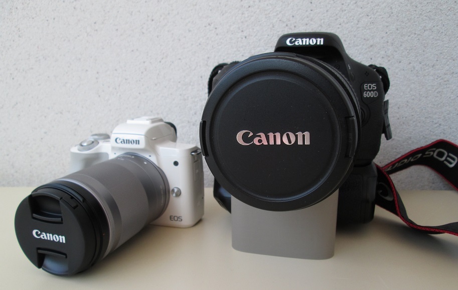

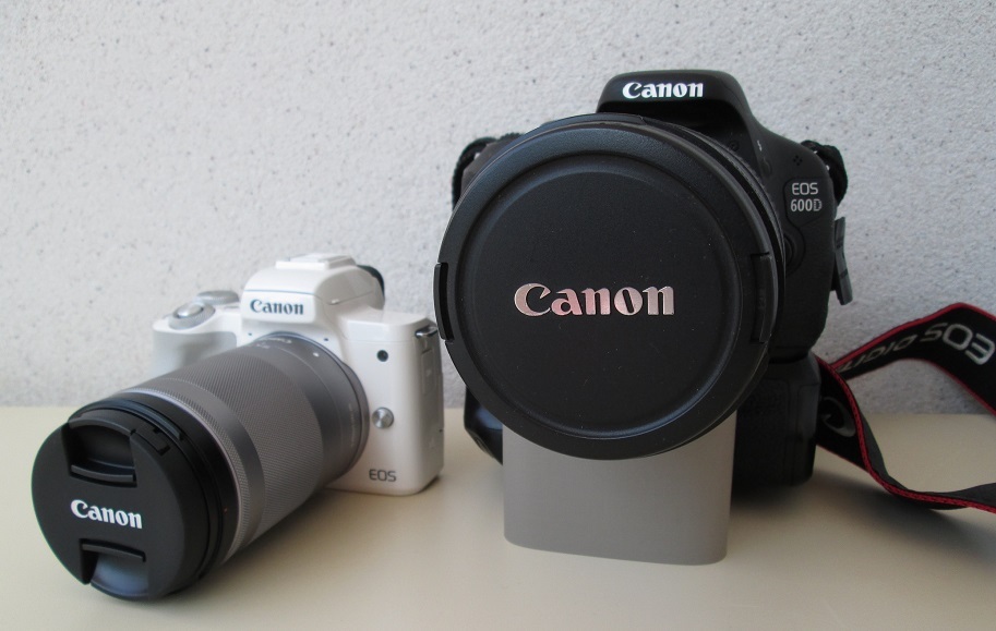

Both DSLR and mirrorless photocamera's have the " Live View " function, seeing directly in which light exposure and sharpness You're shooting...
I went for a mirrorless EOS M50, very lightweight and a great camera...
But don't go for the white body version as the white will show up in the glass of wristwatches, so a black cloth is needed ☕

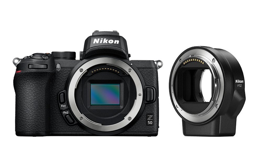

Many thanks Simon for starting this thread - it's probably saved me from making quite a mistake with my next camera!

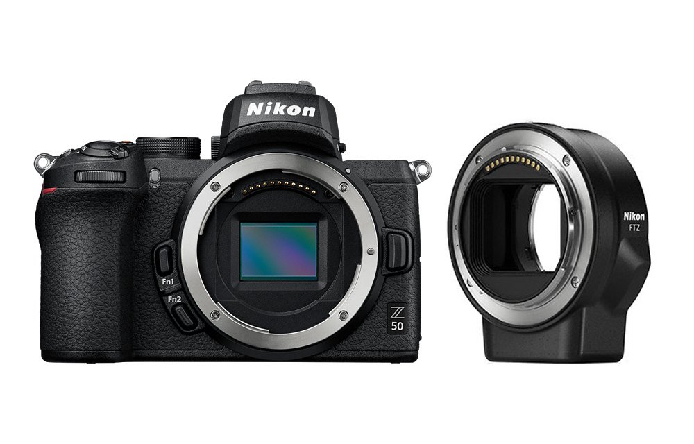

I have been using my umpteenth Nikon, a D80, for about 13 years now. Recently my thoughts turned to a replacement before the D80 fails and I might then have to choose something in haste, (likely a D7500). Don't know why, but I'd ignored the whole business of the mirrorless concept until coming upon this thread. But I now see what a good idea the mirrorless construction is and that for similar money I could buy a Z50 with FTZ adaptor and use all my DSLR Nikon lenses. However, I'm very tempted to spend a bit more and go for the Z6 and enjoy the benefits of a full frame sensor. Just wondering if anyone here has experience yet with either model please?
