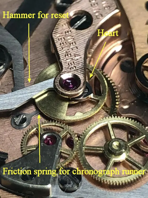

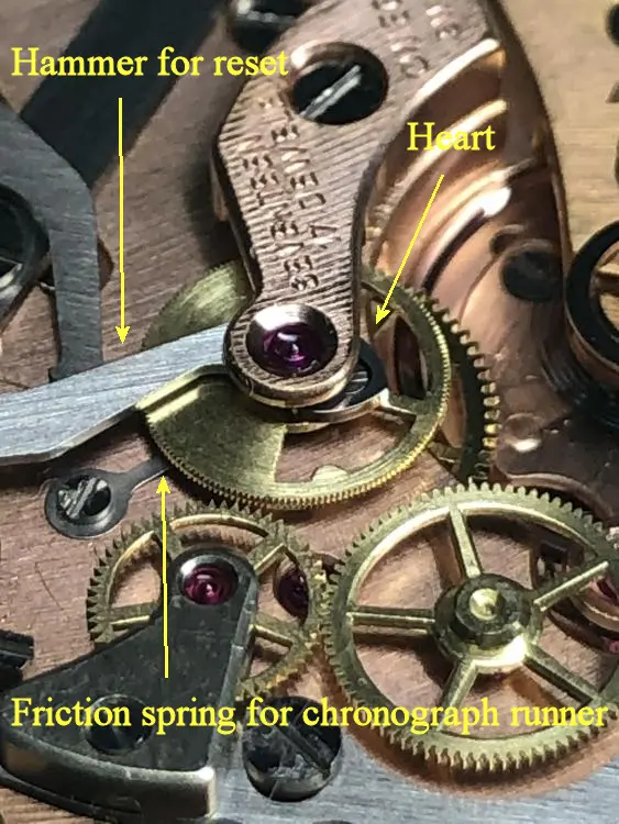

For clarification, this picture (taken from here: https://www.watchrepairtalk.com/topic/19319-chronograph-runner-skips-omega-865/) shows the part a little better:
The 'power' from the watch comes from that 'wheel-over-fourth' in the lower right of that image. The clutch wheel to the left of it stays engaged with it and spins all the time. When the chronograph is running, that clutch wheel pivots (with the arm below it) to come in contact to the center wheel of the chronograph (which then drives the minute totalizer, the hour works... differently).

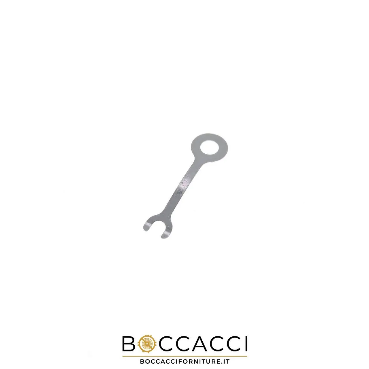

The friction spring he's discussing is the one pointed to there. If it is like the ones I've worked on, it looks like:
The idea is for it to push the chronograph wheel 'up' (in this photo, to the back of the watch!).
So if that spring isn't pushing 'up' good enough for some reason (or the little C shape is off center enough to be causing friction incorrectly?), the wheel could drop below the engagement point (or to a point of lower-enough engagement that the force allows it to skip). At higher wind the wheels 'snap' back and forth faster with the pallet fork, which might be enough force/low-enough-time to skip more readily.
Though, I would expect some sort of positional difference if it was the spring. Here's a question: if you go dial down, does the stutter get worse?
