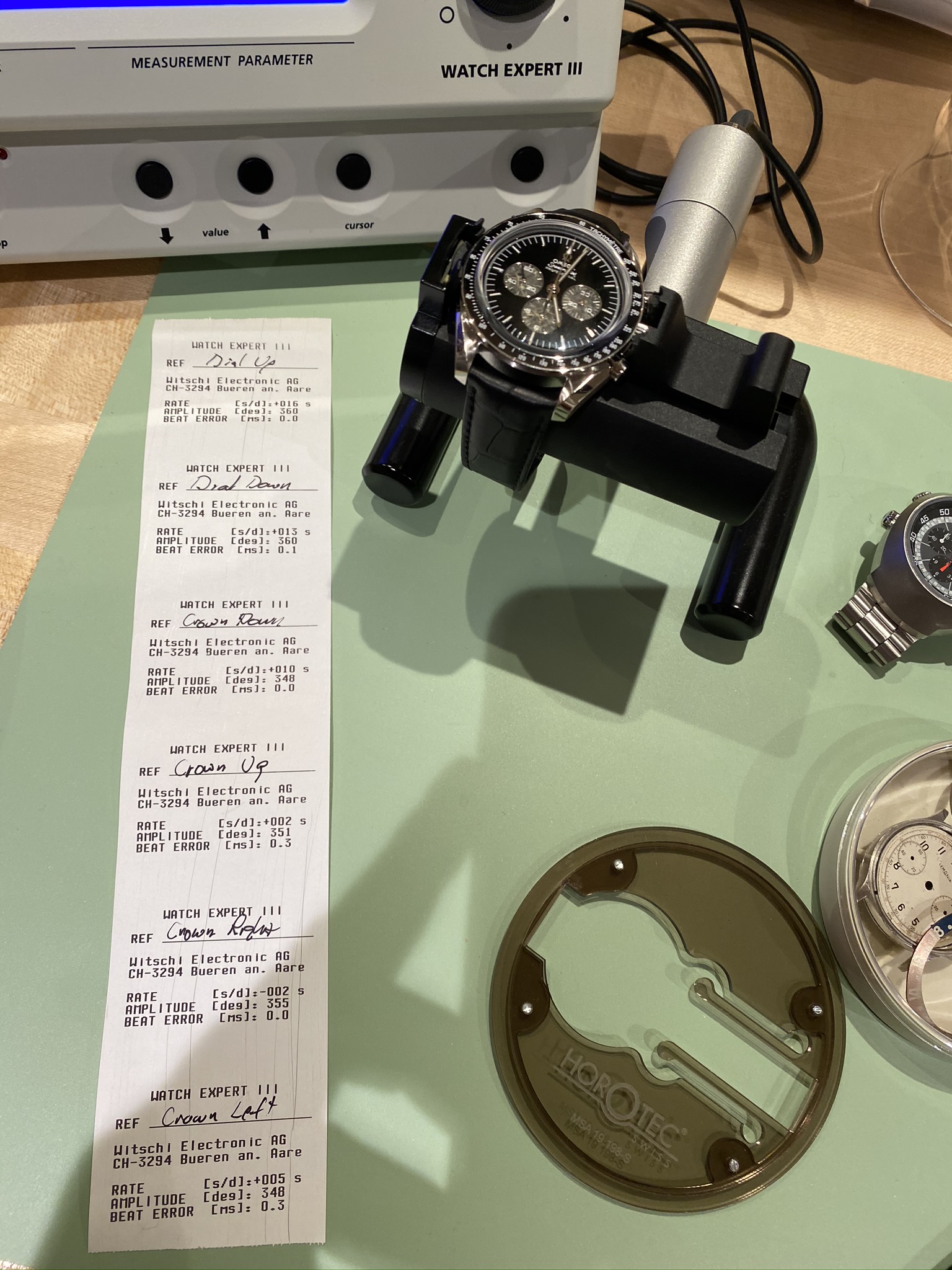

I will run measurements on my Witschi and post later!

This is the exactly the reason for which I would be curious to examine this movement, the quality of its components, the poising of the balance wheel, the hairspring alloy, the finishing of the pivots and, finally, to assess its regulation. At this price point the movement should be performing well above the old specs (mine does, but it took me considerable dedication and parts over the years). However, even if I have no evidence, I tend to agree with you and I would be surprised to be proven wrong.

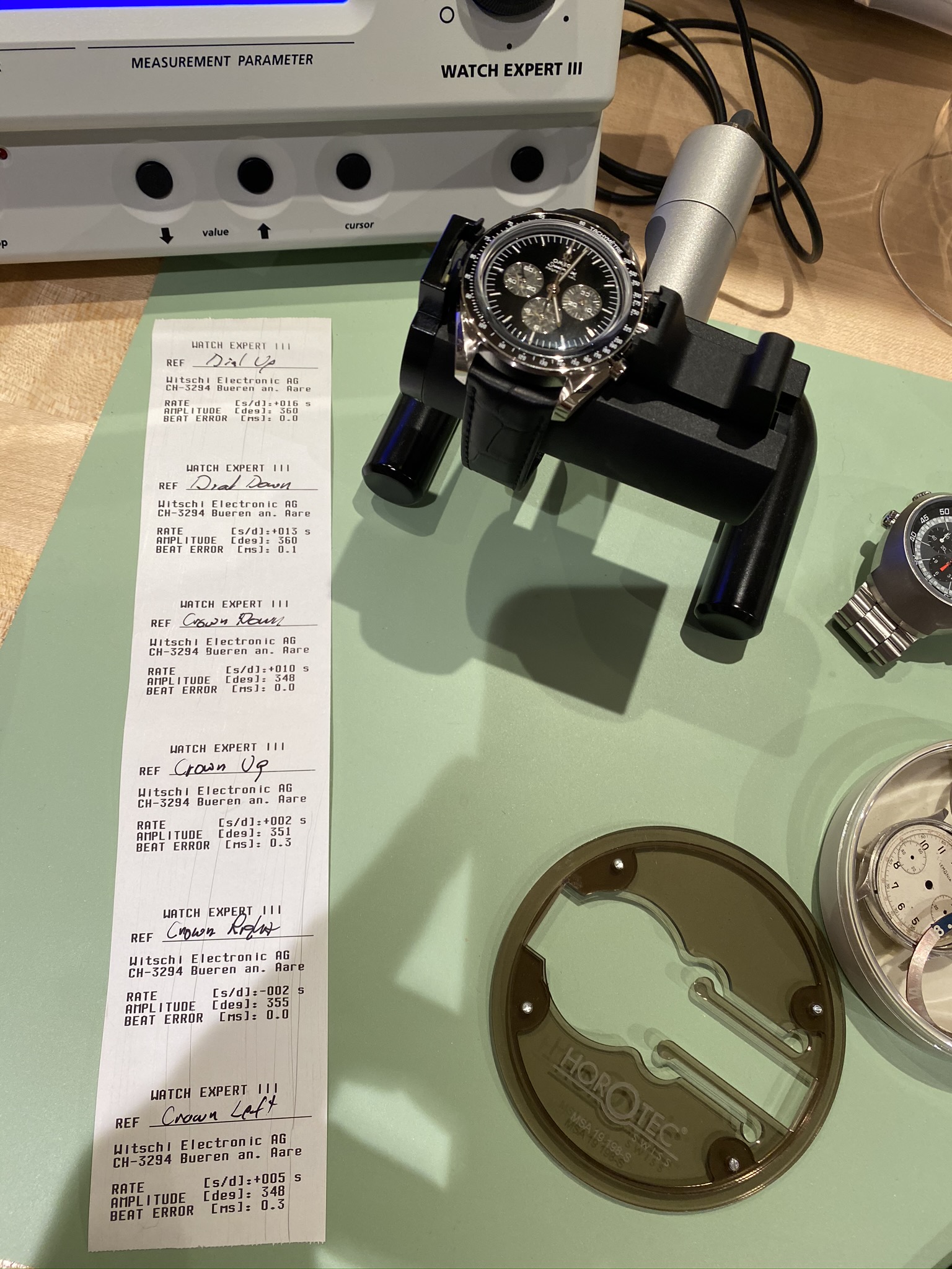

OK, measurements at full wind; picture is not super clear, so here they are:
Dial up: +16
Dial down: +13
Crown down: +10
Crown up: +2
Crown right: -2
Crown left: +5
I'll take a second set at 24hrs.
So, overall, I would be happy with these if this was a vintage 321, but a little surprised for a new movement.
Dial up: +16
Dial down: +13
Crown down: +10
Crown up: +2
Crown right: -2
Crown left: +5
Thank you very much indeed for sparing the time to take these measurements: I believe that they are the first ever published regarding the new 321 movement.
The results are exactly in line with the original specs reported by Archer: average daily rate from -1 to +16, maximum delta of 20 seconds over 3 positions at full wind, and of 30 seconds over 3 positions at 24 hours.
However, please notice that you likely set a wrong lift angle because at 360掳 the watch would have been knocking. 馃槈
