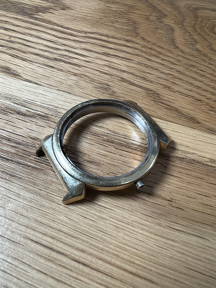

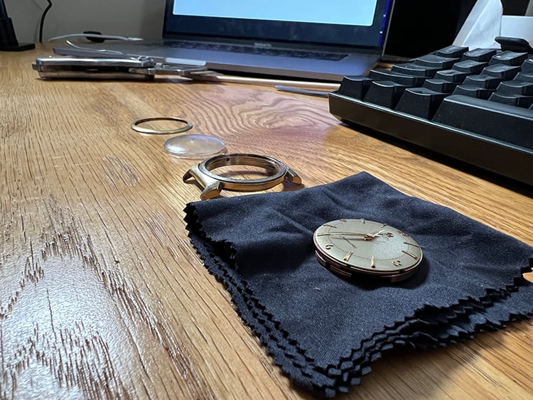

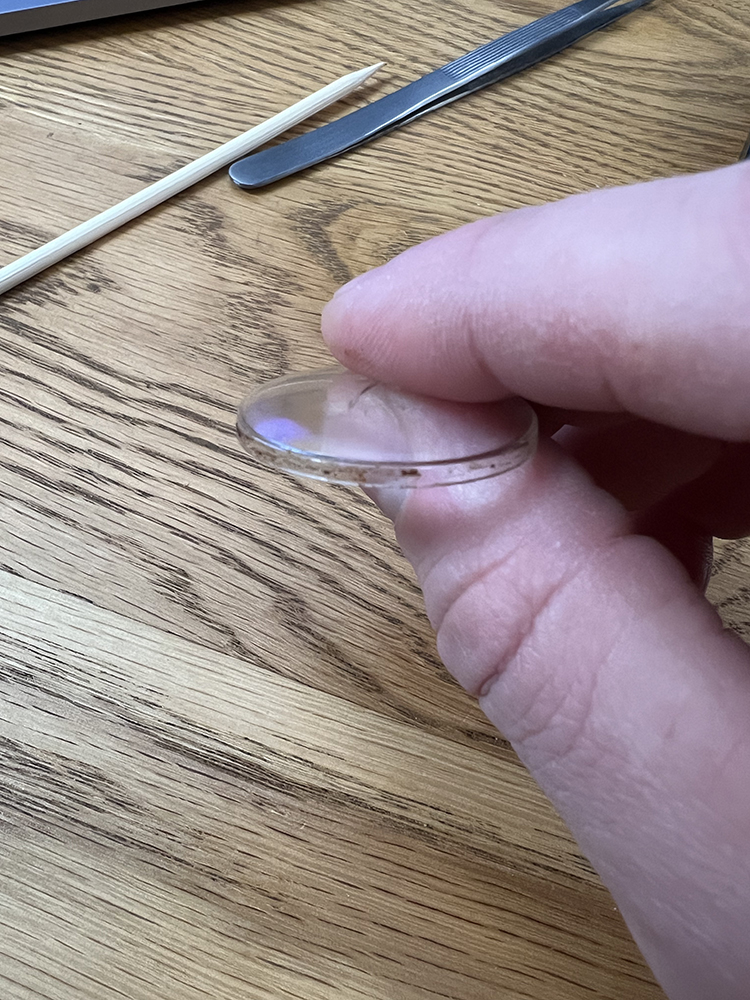

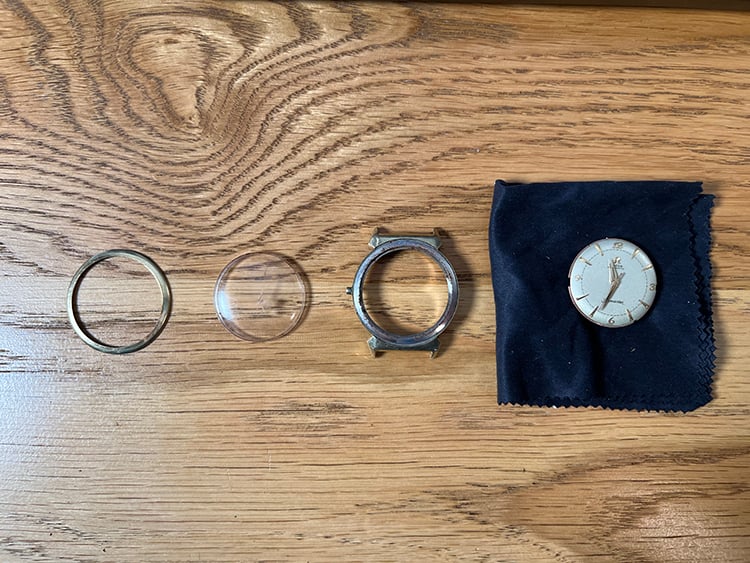

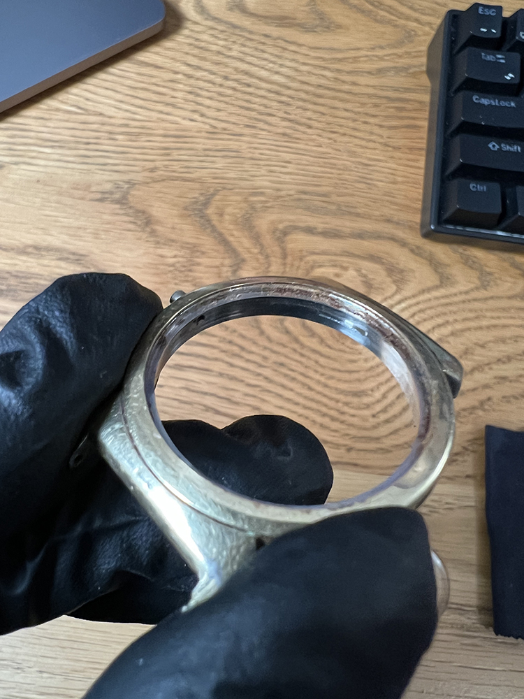

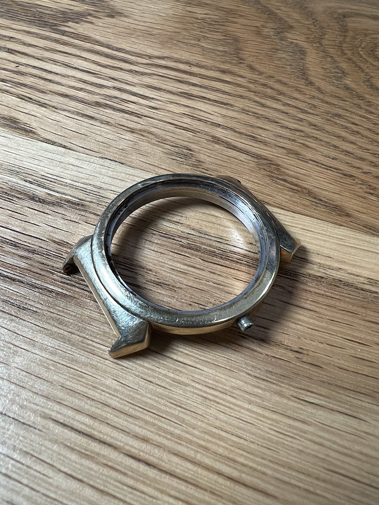

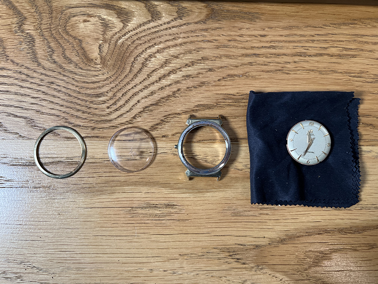

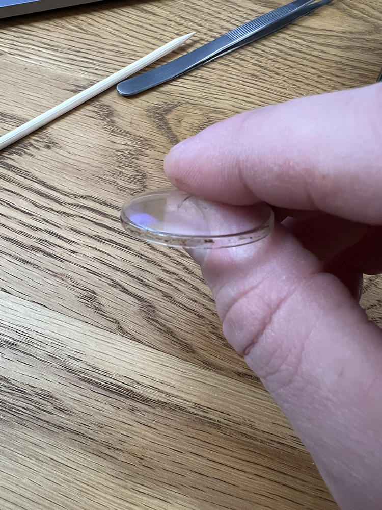

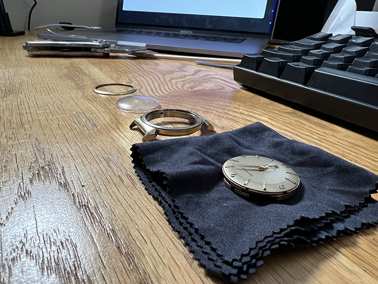

Created a new thread and got some additional advice. After a bit of careful prying the movement was liberated from the case. The crystal also popped right out, which I didn't think was supposed to happen, but here we are. I then carefully removed the bezel and now I'm trying to understand if I have a tension ring or not. Theres nothing attached to the existing crystal.
I'm unsure if the tension ring is still stuck in the case or if its missing. If someone could please advise that would be much appreciated. I was hoping to reuse the tension ring with a generic crystal as mentioned further up the thread.

I don’t see a tension ring on your crystal.
Usually they are gold or silver and cover small gaps between the dial and the inside edge of the case.

right on. I'm leaning toward a generic crystal and tension ring the genuine PX5000 is proving hard to source and fairly expensive. Thanks for the info.

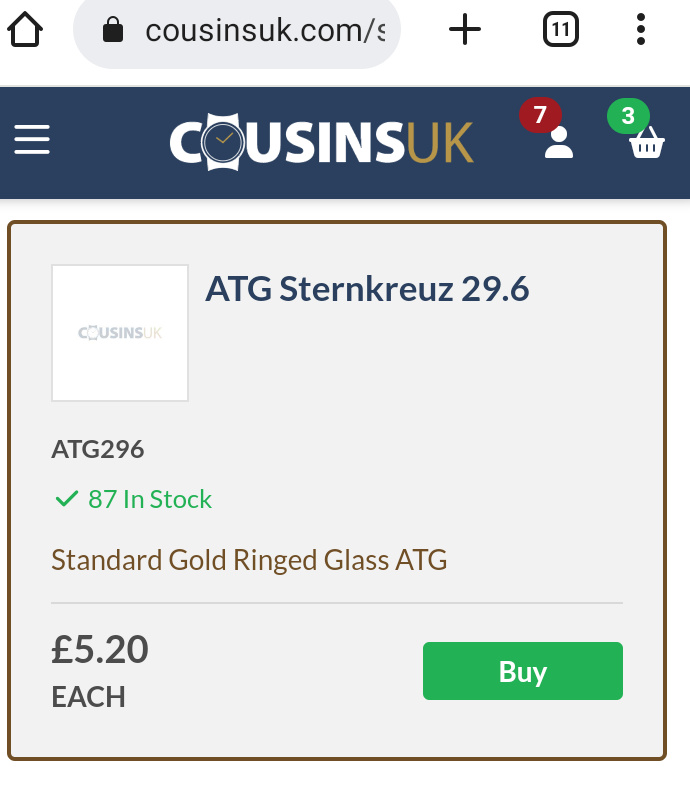

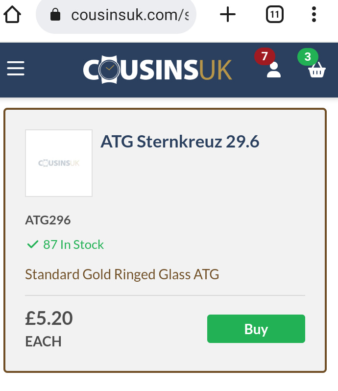

Assuming the information about PX5000 is correct, why not just buy a new Sternkreuz ATG296? Diameter is 29.6mm and height about 4.5 mm. It comes with the gold coloured tension ring and would be a direct fit - cost in Europe is about $8. A branded crystal is the best and definitely preferred but at $100, the price is ridiculous for your watch.

It looks to me as if someone has fitted a snap-fit non tension ring crystal to your case, probably because they were not aware of the correct one. Some crystals are snap fit, some are tension ring plus there are other types. You fit crystals in different ways depending on the type but, you'll need a crystal press to fit one correctly to this case.

Try Jules Borel for crystals. I see they sell Sternkreuz but seem to have changed the codes. I'm in Europe so I don't use material suppliers much from the USA - others will be able to advise. $10 is a fair amount for a simple generic crystal like this.

Ah, the Red rooster Etsy link showed as UK prices. If you end up buying from UK, try Cousins - taxes and postage are extra. Obviously, there are loads of more suitable USA material suppliers than buying from UK. I assume you're in USA but apologies if that's incorrect.

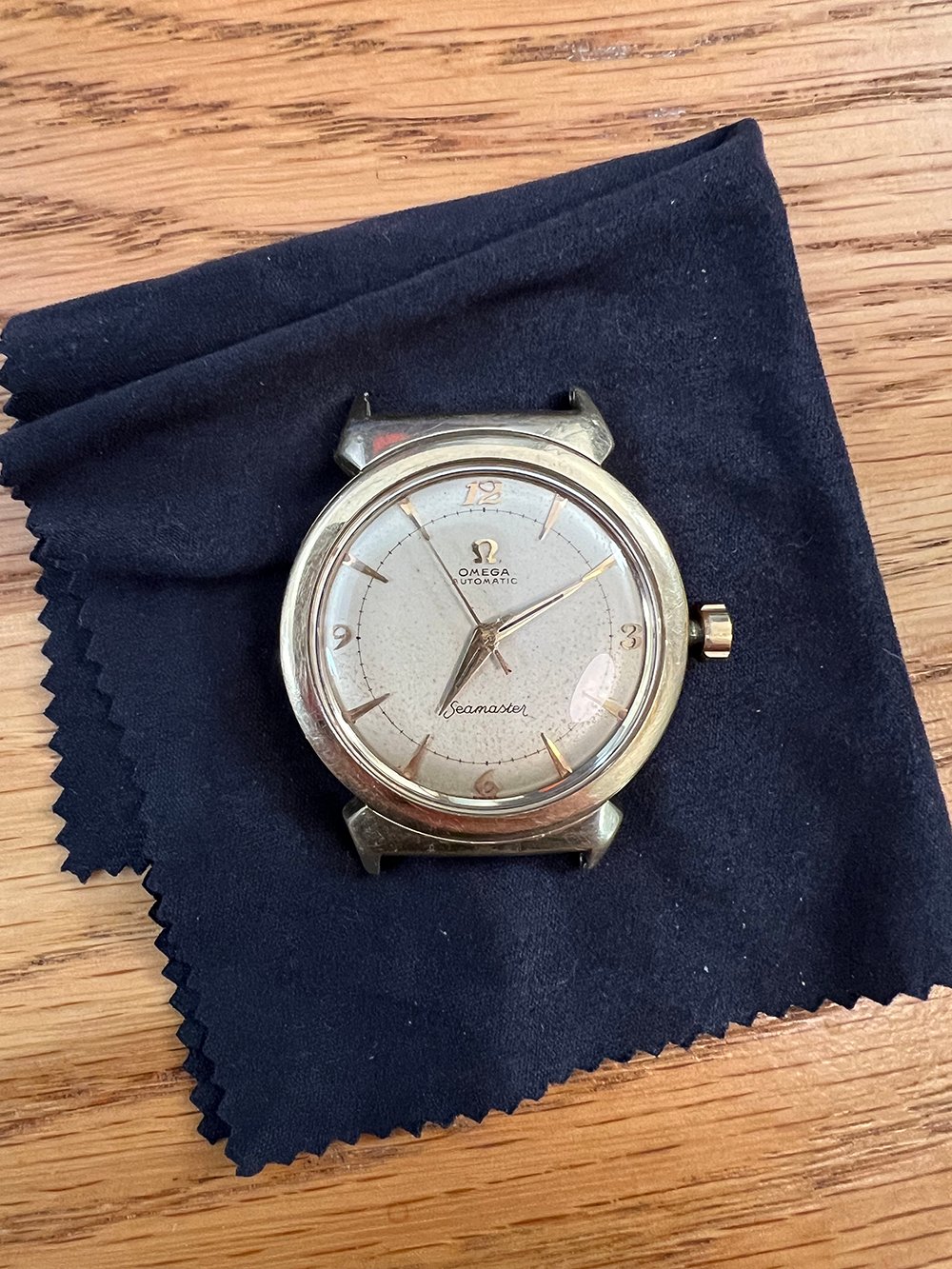

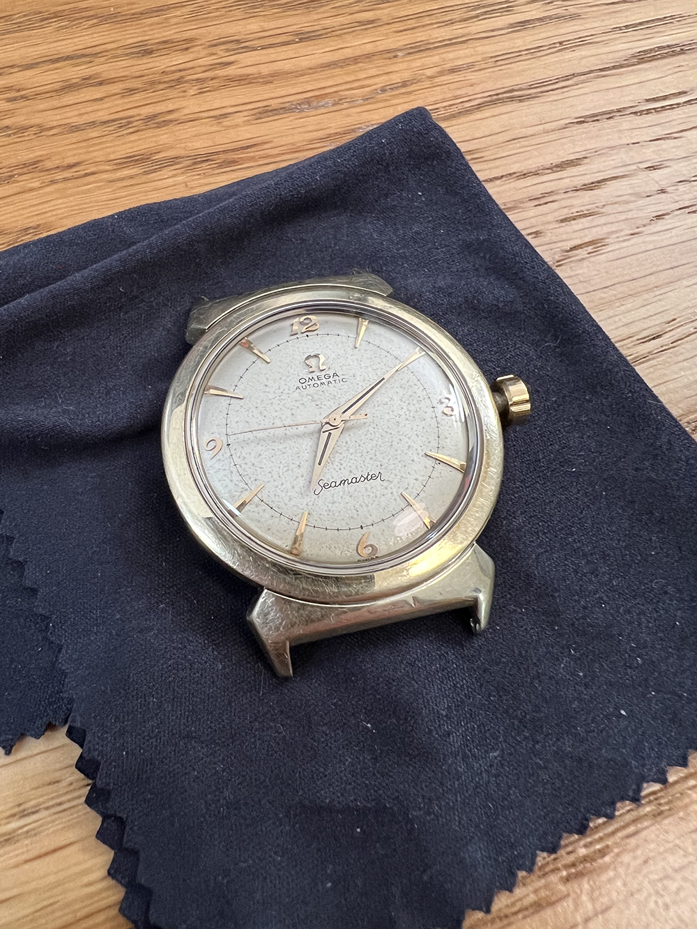

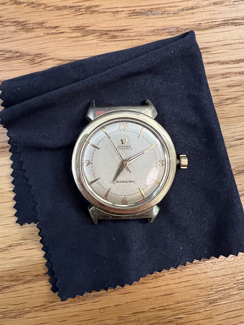

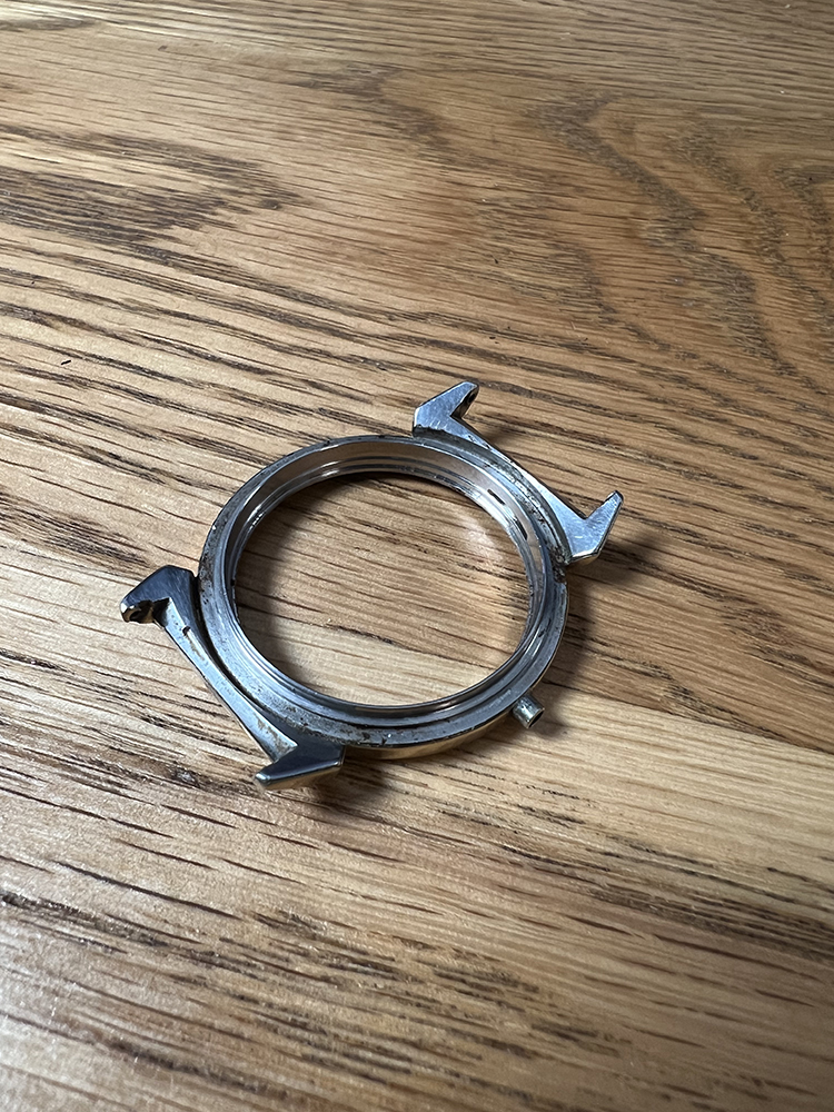

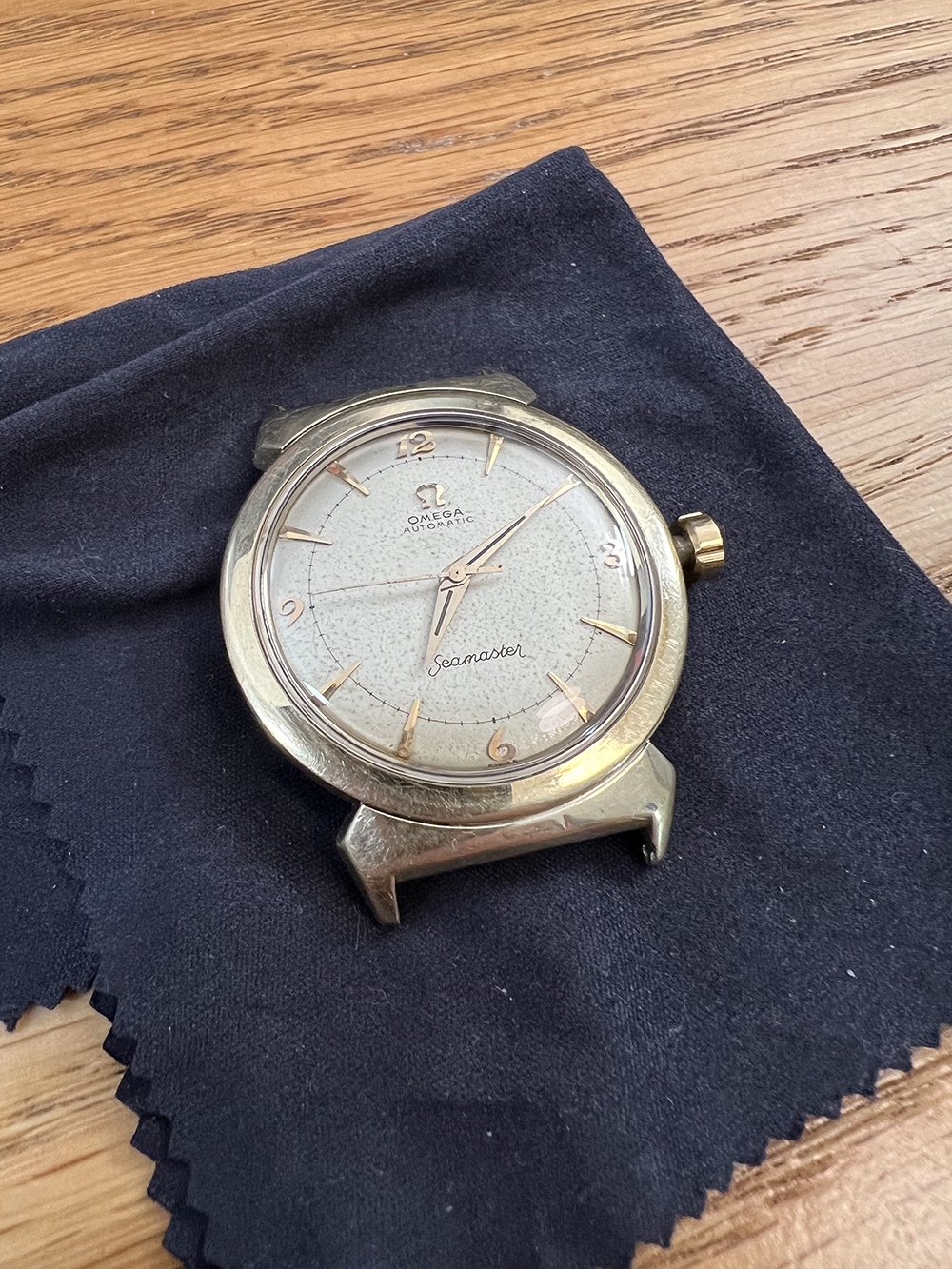

I was able to get the watch back together, seems to be running as it should. I am having some issues with the stem seating into the keyless works as you can see in these photos, but I'm gonna call my part of the project done. I really like the look of the watch and am feeling good about spending the money to have it serviced, so I'm going to be dropping it off to a professional.
Thanks again for all your help Omega Forum members. I certainly enjoyed this little project and am looking to purchase a cheaper watch or movement to practice working on.
547
877
For your maiden voyage, I think you have done very well. Congrats!
Snip a couple of mm off the stem, and I think your "seating into the works"problem will be solved.
