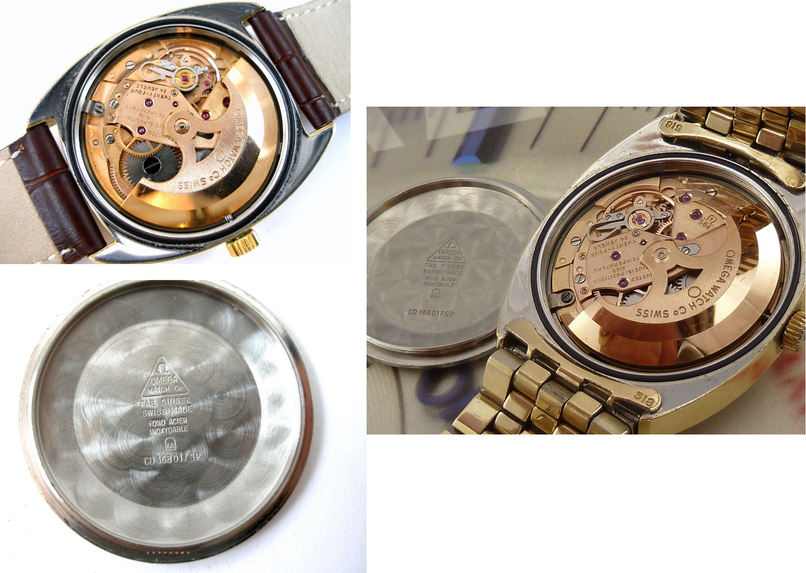

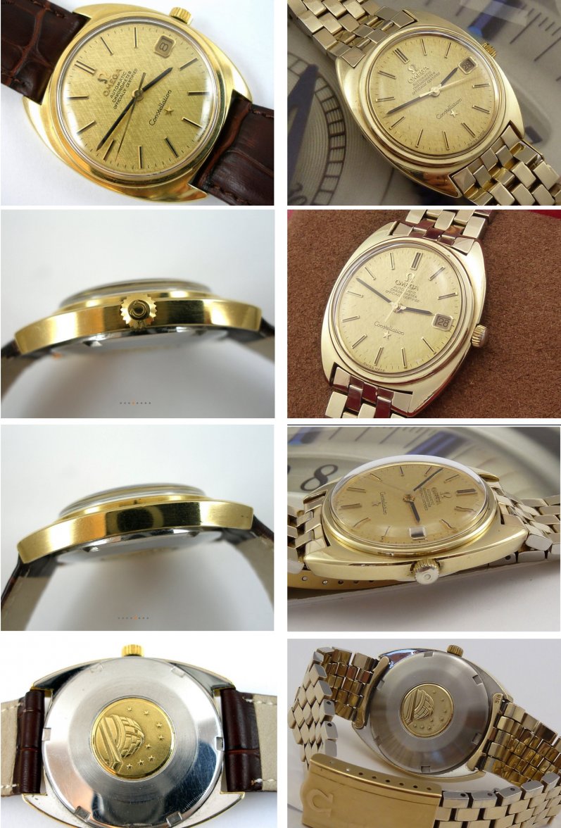

I have bought my first vintage Omega dated 1969. An Omega Constellation C Shape 18k Gold Cap 168.017 with a linen dial and a cal 564. I have never owned a gold watch (but wanted one) and wasn't a fan of gold plated watches (since they are prone to losing their golden finish) but after stumbling across a gold capped watch (a term I needed to research because I never heard it before), I started liking it. The linen dial is beautiful and remindS me of an vintage JLC that had a silver linen dial. Unfortunately, I missed the auction and regret not buying it.
Anyways, I tried to research some facts about the watch and tried to figure out if it has been tampered with.
Luckily for me, I did find an exact copy of the watch on the internet for comparison purposes.
Here is my summary:
Dial & Crystal
Looks fairly clean and I can't see anything that would make me think that it was a redial. The text is uniform and perfectly aligned. The applied golden star looks how it should. The minute markers are all original (no repaint whatsoever).
The fact that it didn't have any tritium is a big plus for me. I have seen some dials getting destroyed by the radiation. The damage is most likely permanent and when the tritium dots finally fall off, it destroys the aesthetics of the watch.
Crystal doesn't have much scratches but is unfortunately not an original Omega one (missing Omega logo in the center)
Hand
At first I was suspicious because I couldn't find a similar watch with blacked out hour and minutes hand. But after finding a 1:1 counter example, it was clear that the hands where the right ones. And it makes sense for them to be black since gold hands on gold dials wouldn't allow for a quick time check.
Case
The case is in good shape: It has only slight polish to it and the gold cap is all around the case. There are no major marks. All the edges are still somewhat sharp. What's missing is the side and top case polish around the dial. Not sure if it really has been polished off or if it's due to gold being somewhat soft and the polish wearing off in the last 50 years.
Movement

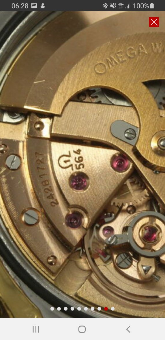

Movement appears clean an the watch seems only a few seconds off a day (5 sec). There is no rotor grinding against the case back.
One thing that came to my attention is that when I shake the watch slightly up and down I can hear and feel the movement of rotor in it's vertical axis (=/= I don't mean the circular movement). Not sure if this is because it's an vintage watch (i.e. normal) or if the rotor needs to be screwed in a little bit better.
Band and Buckle

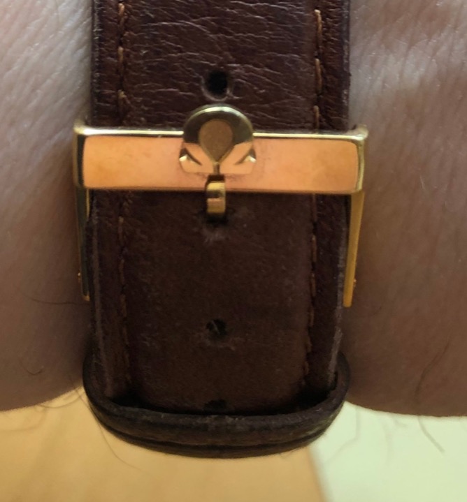

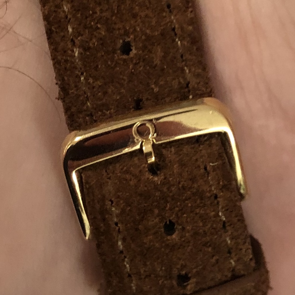

Band seems to be a cheap fake leather band. It's okay since I put on a brown suede leather strap which IMO suits the watch much better.

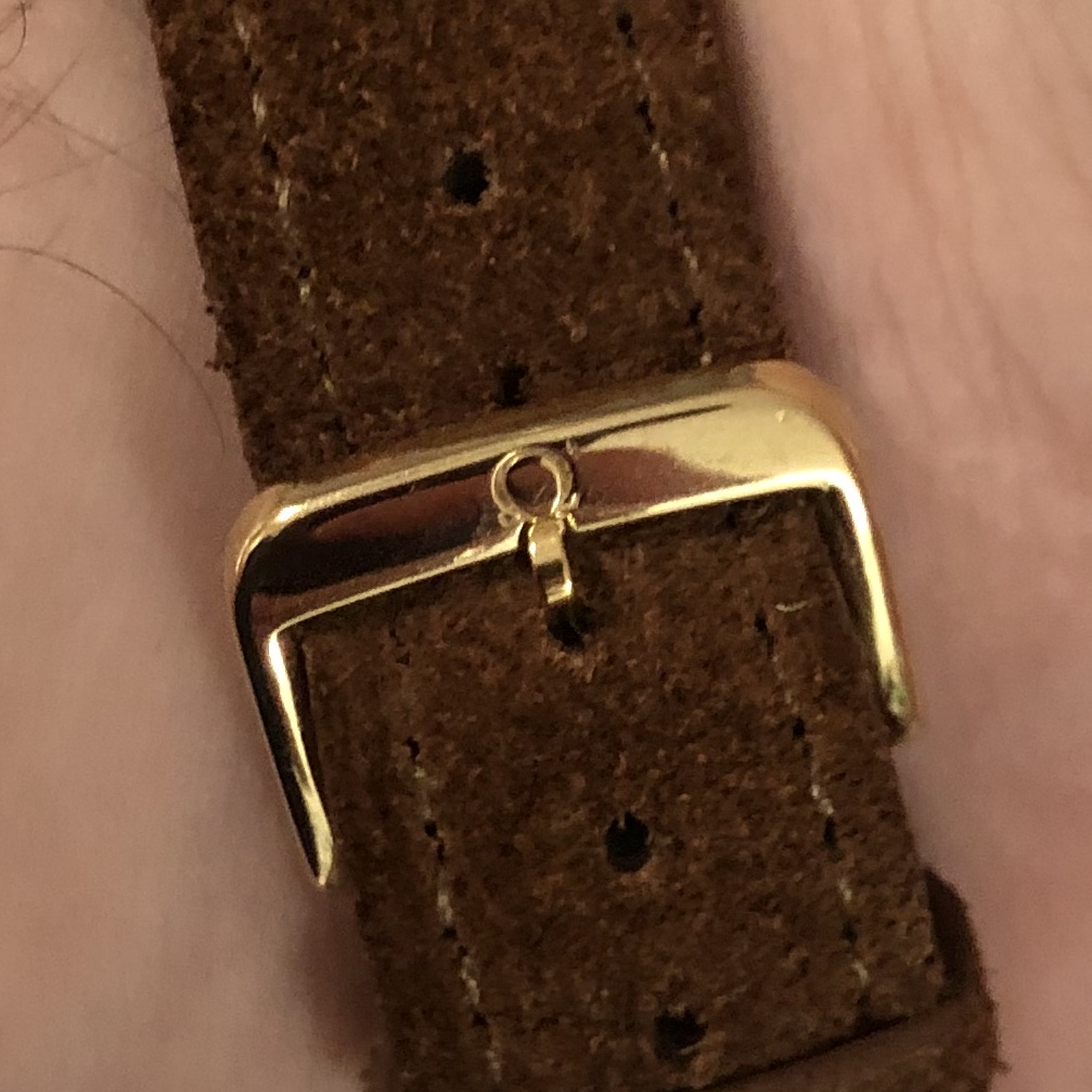

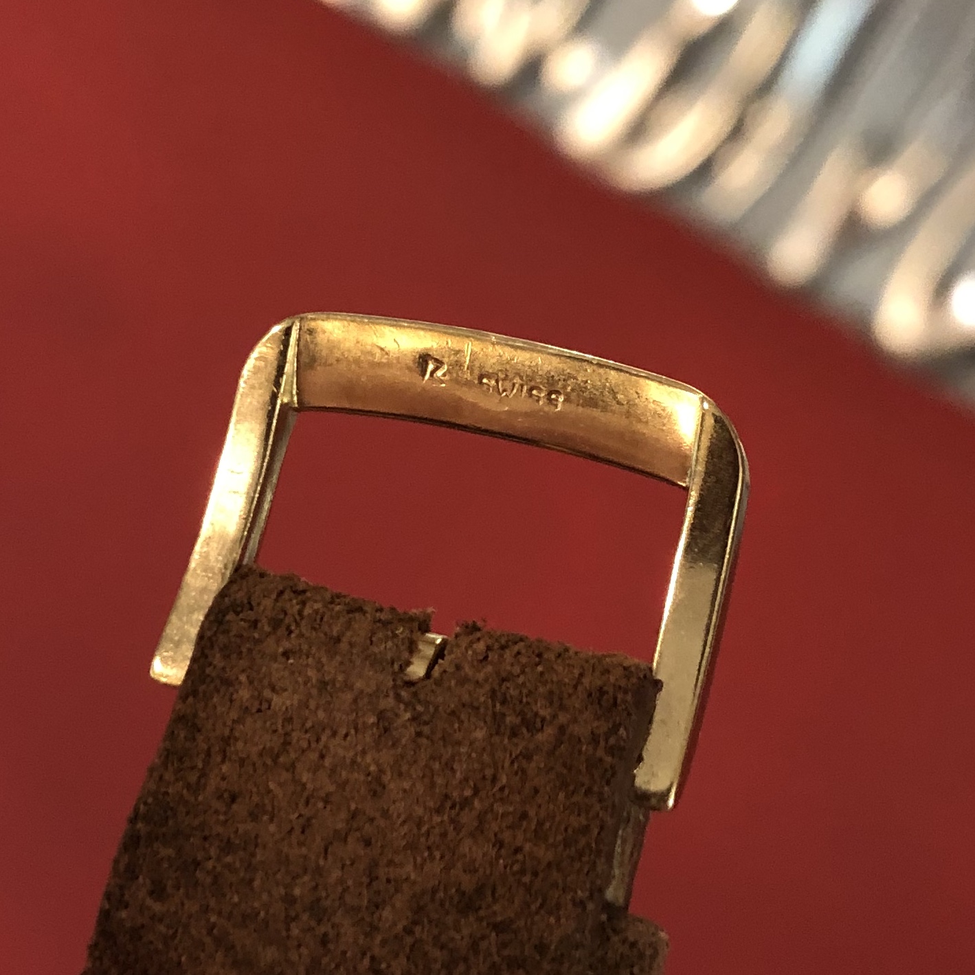

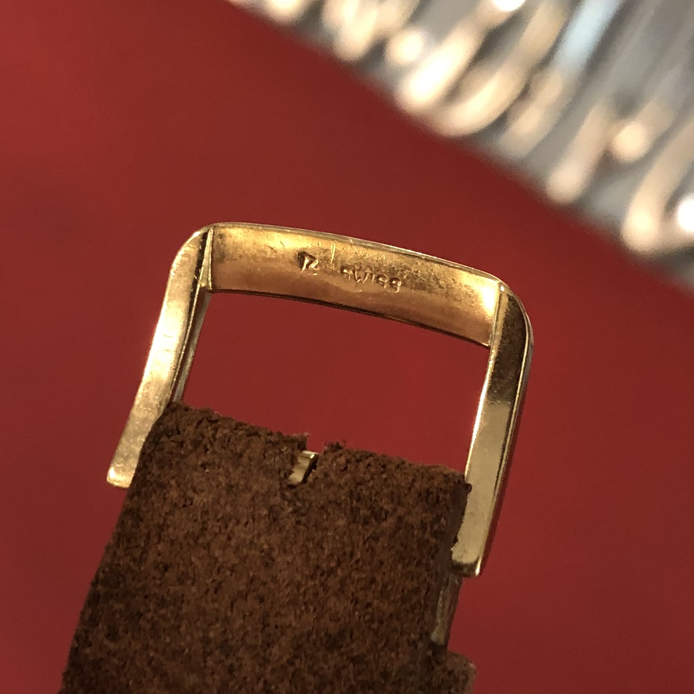

As far as the clasp goes, it's a branded golden one ("B Swiss") but not the one the watch originally came with. I am not quite sure if the buckle is fake or not.
Price
It costed me around $622 here in Switzerland. I have compared similar offers in different places on the internet. Sometimes, it was in the $500 area and other times I have seen similar 18k capped watches being offered >$1000.
I might have overpaid slightly (if I didn't bid in the end, the watch would have gone for $575). Luckily, the other bidder let go off the watch and I could chime in. Considering the watch is in good shape, runs great and looks stunning because of it's linen dial, I think that I did a good job. I don't have the intention to flip it so I think I can't really complain.
After seeing someone else in this forum write: "It's better to overpay a bit for a great watch than to regret not having overpaid" I have to completely agree with that statement (writer unknown).

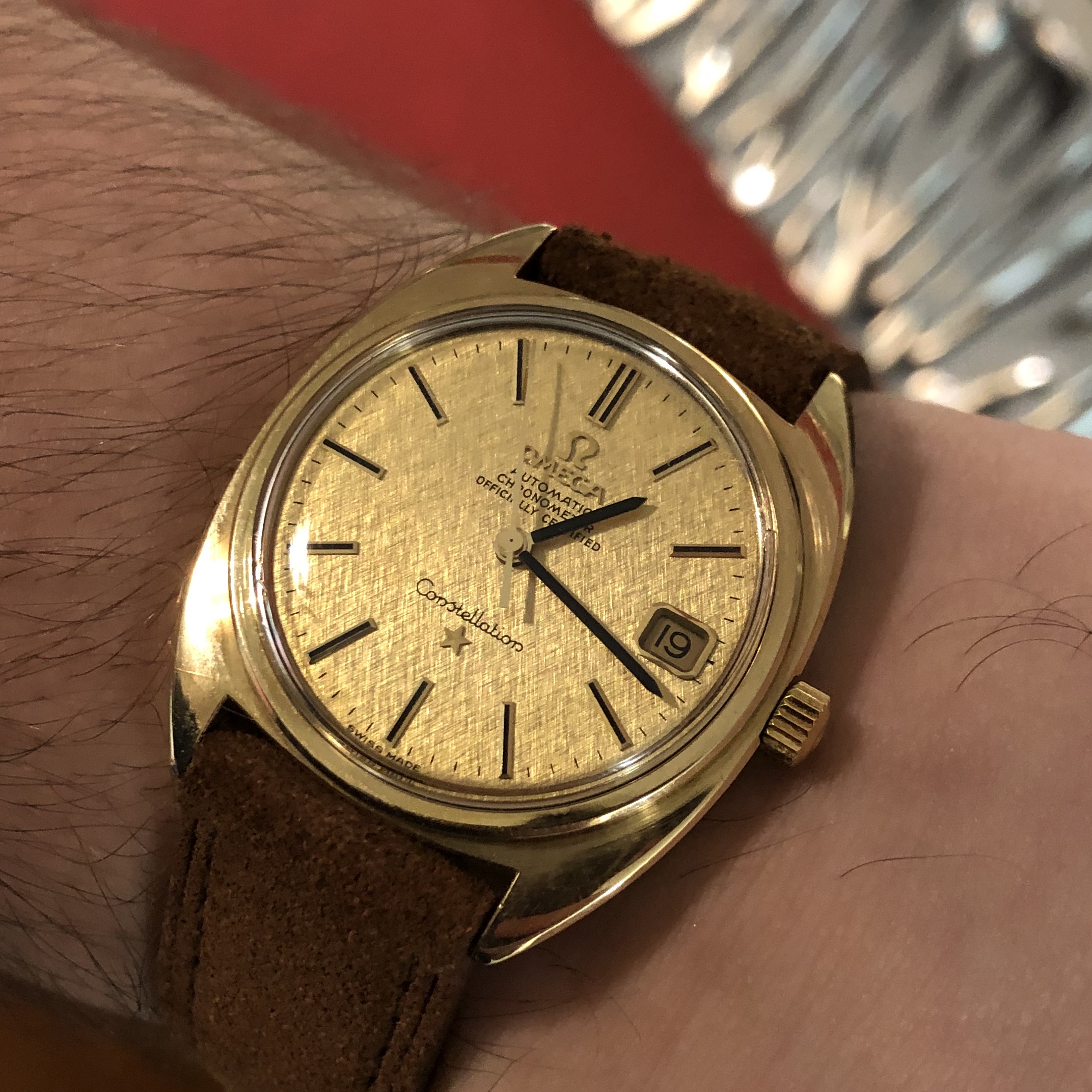

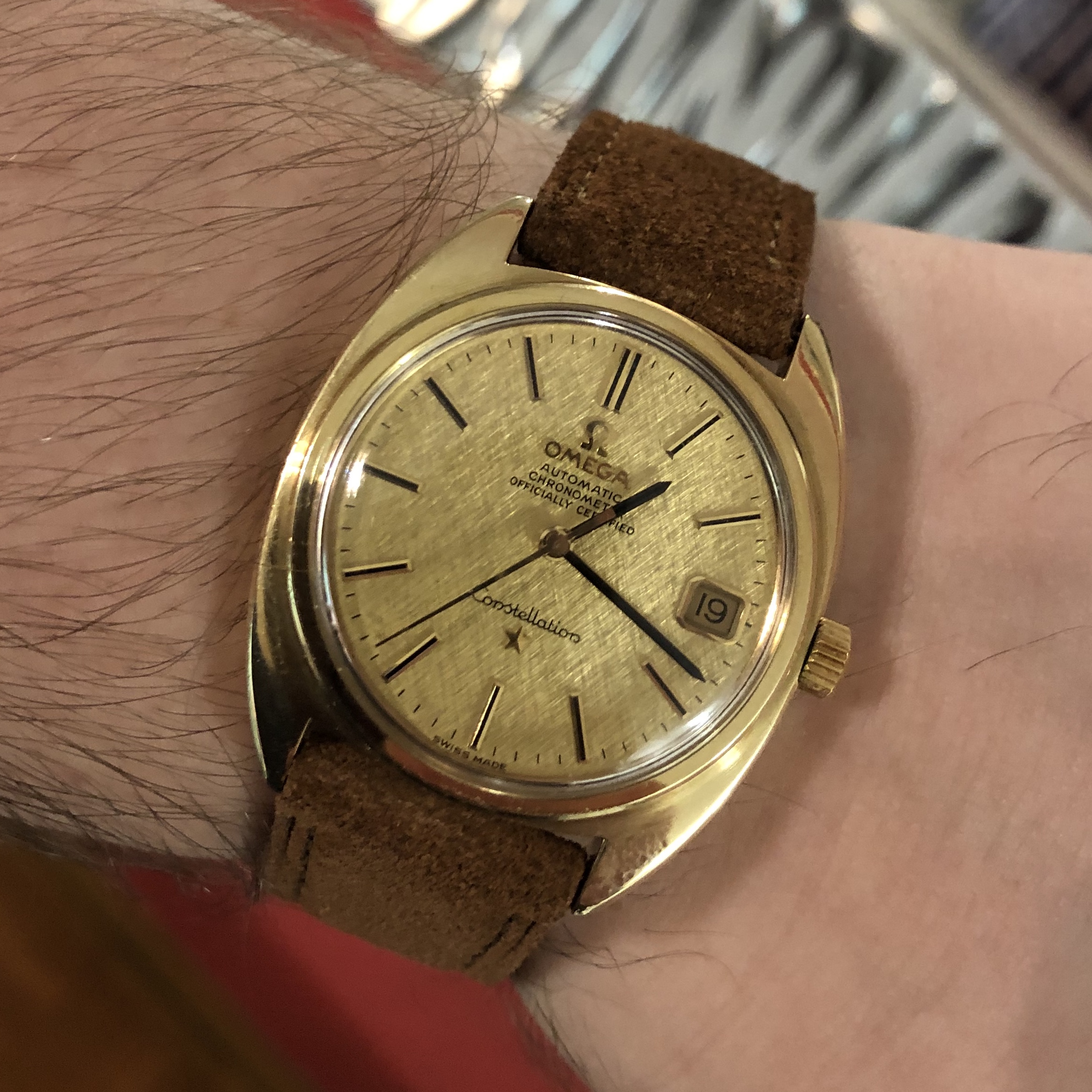

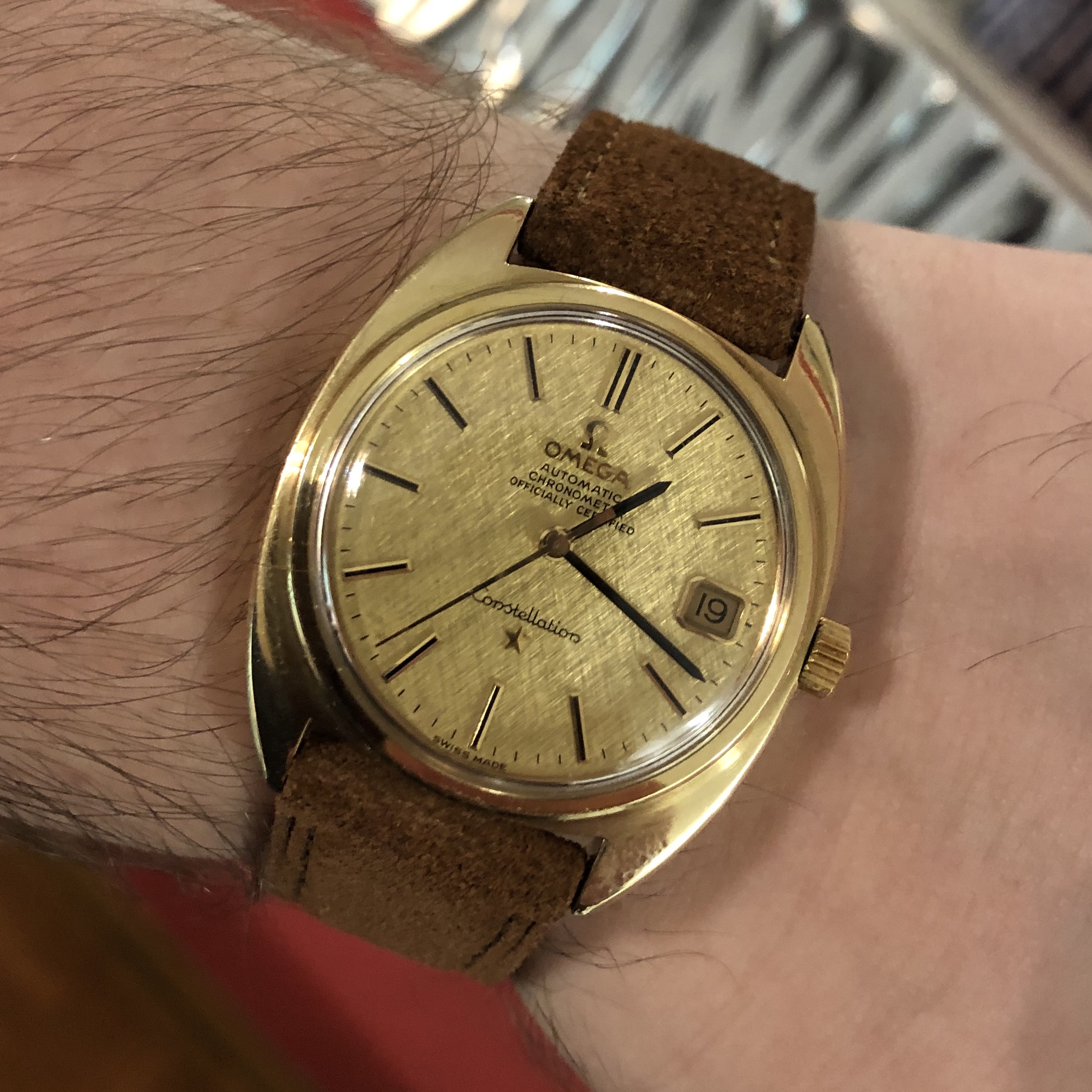

Pictures

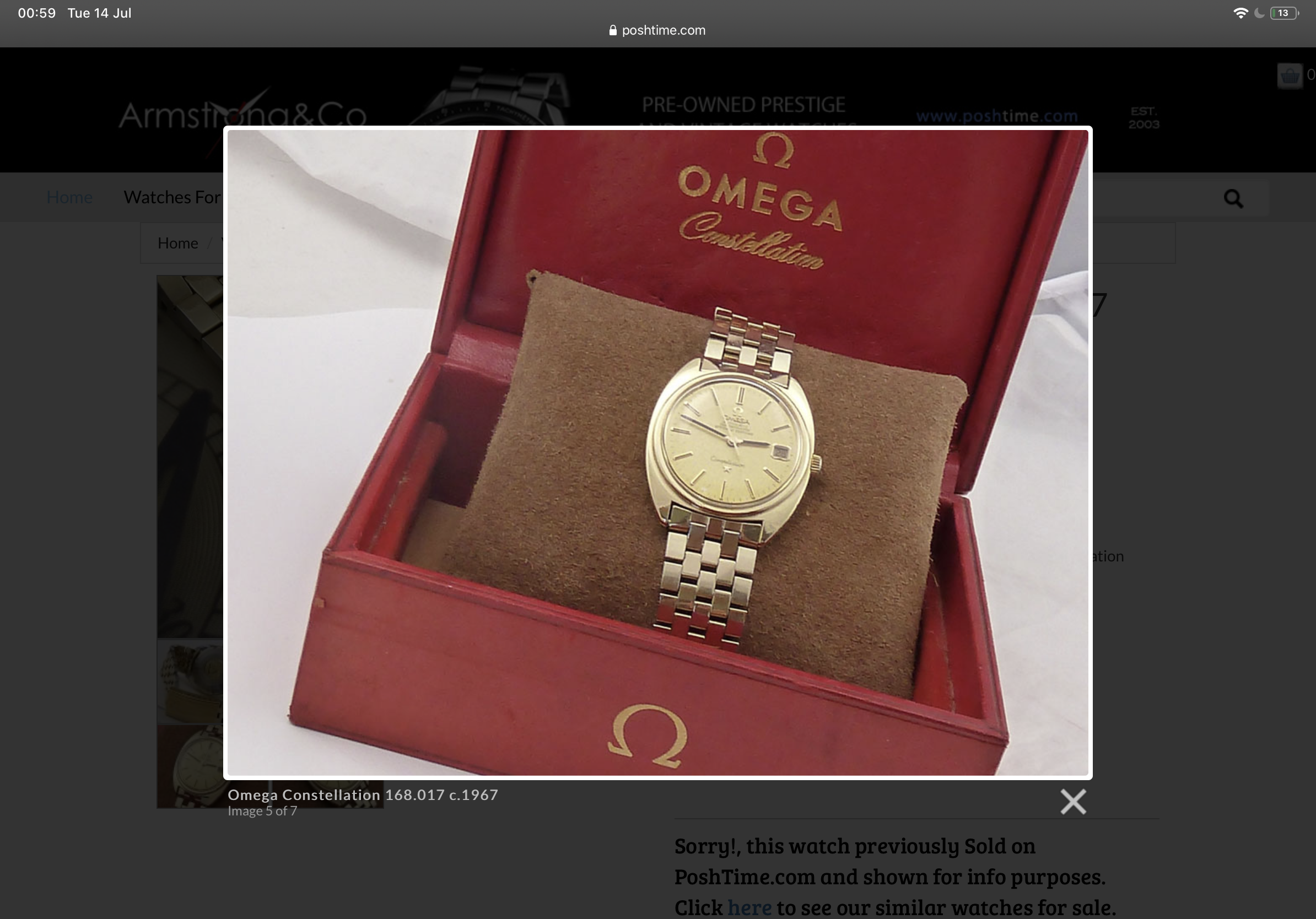

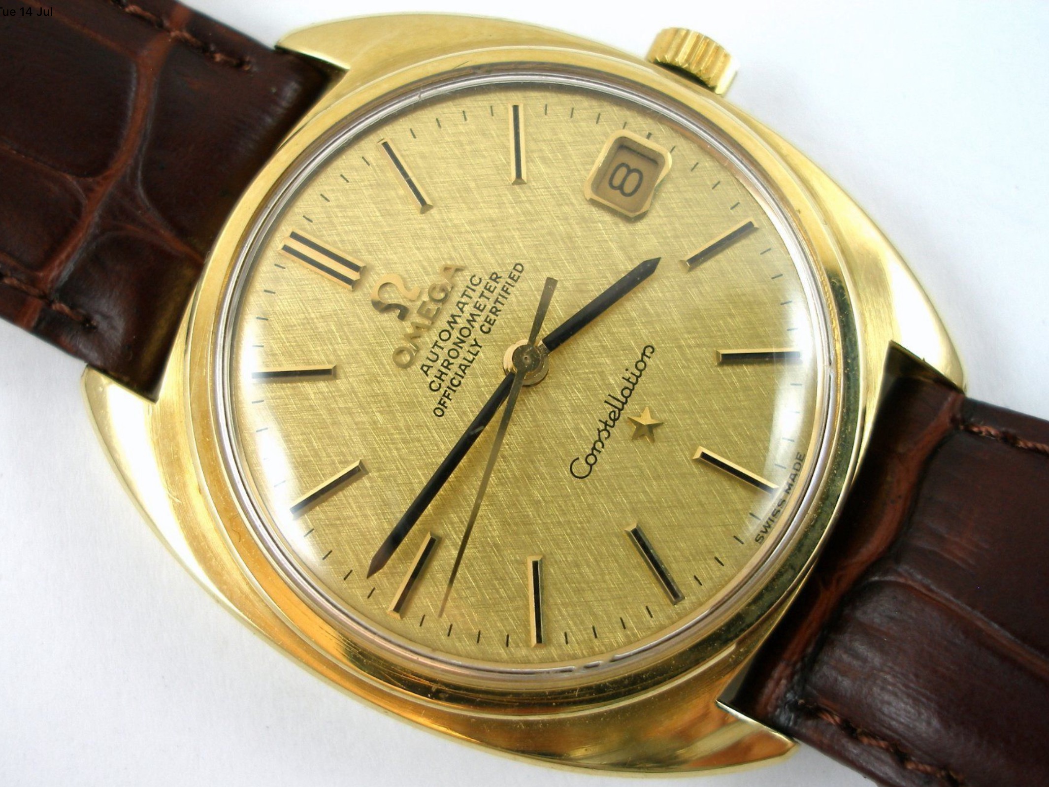

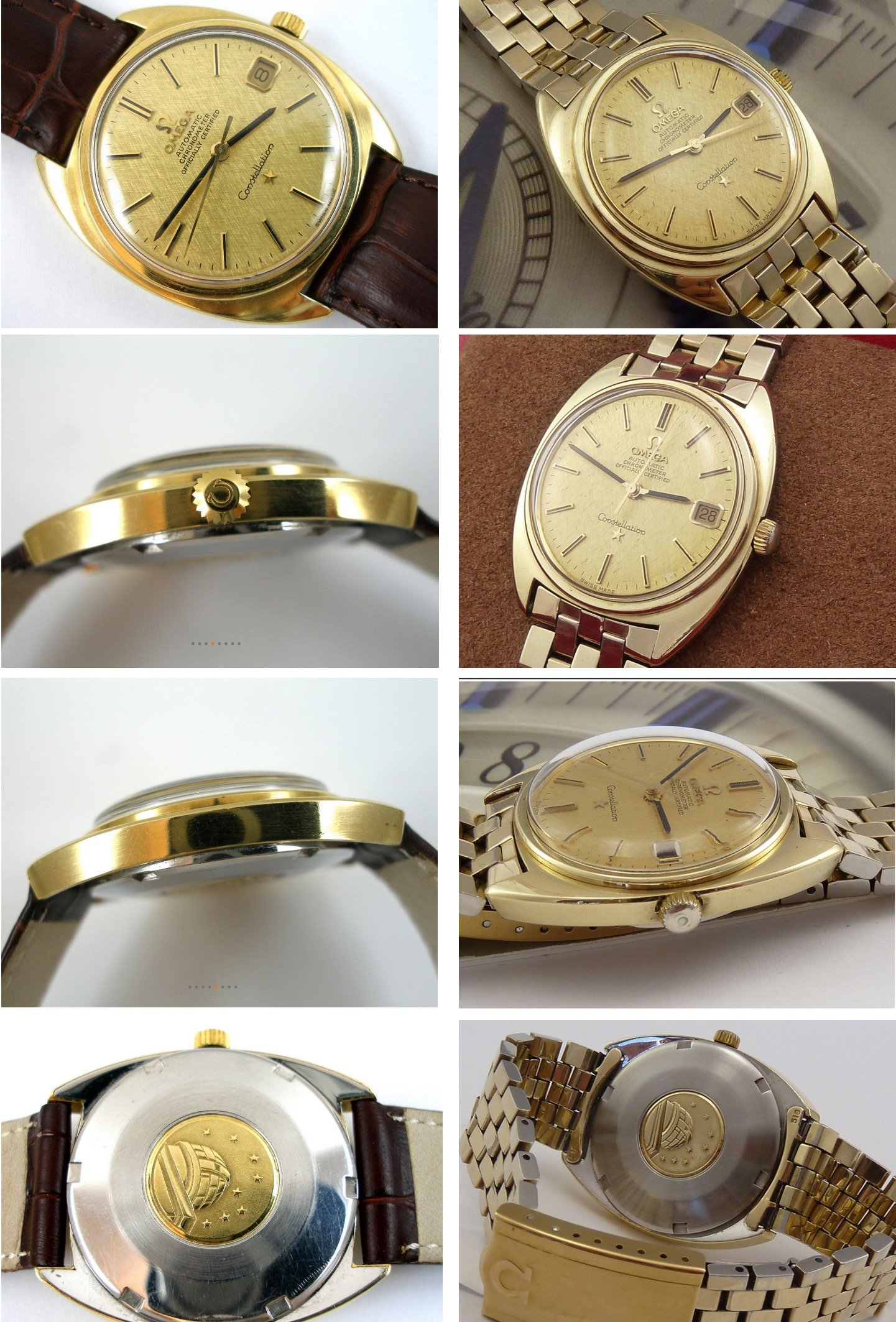

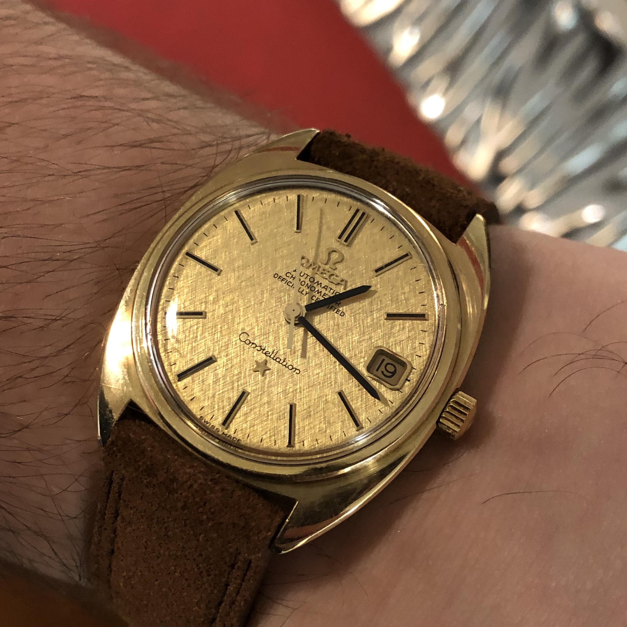

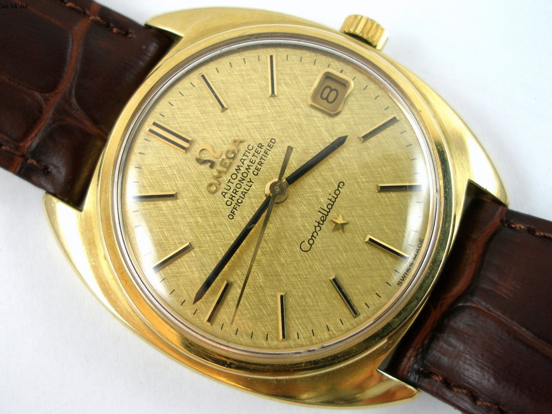

Left is my watch and on the right a similar watch for reference (https://www.poshtime.com/501.024/Omega-Constellation-168.017-c.1967.php)
After changing strap

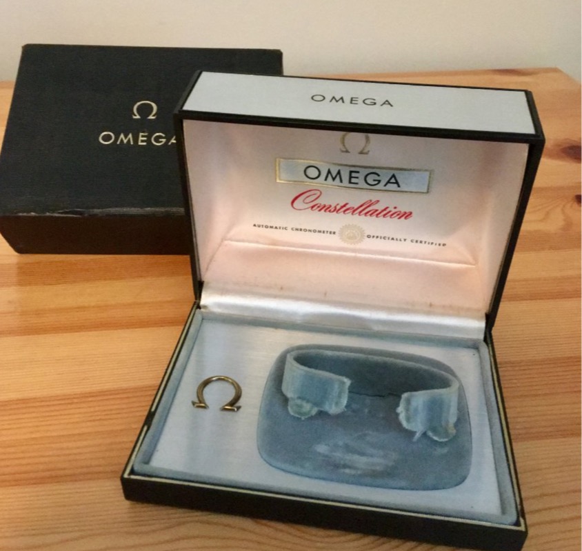

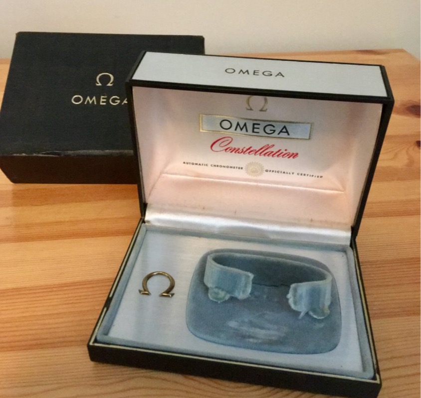

Correct Box
I have found multiple C-shape watches of the same era as mine but all with different boxes. So I am not quite sure what watch box to buy for mine. Would be great if someone could lead me in the right direction?
These are the examples:

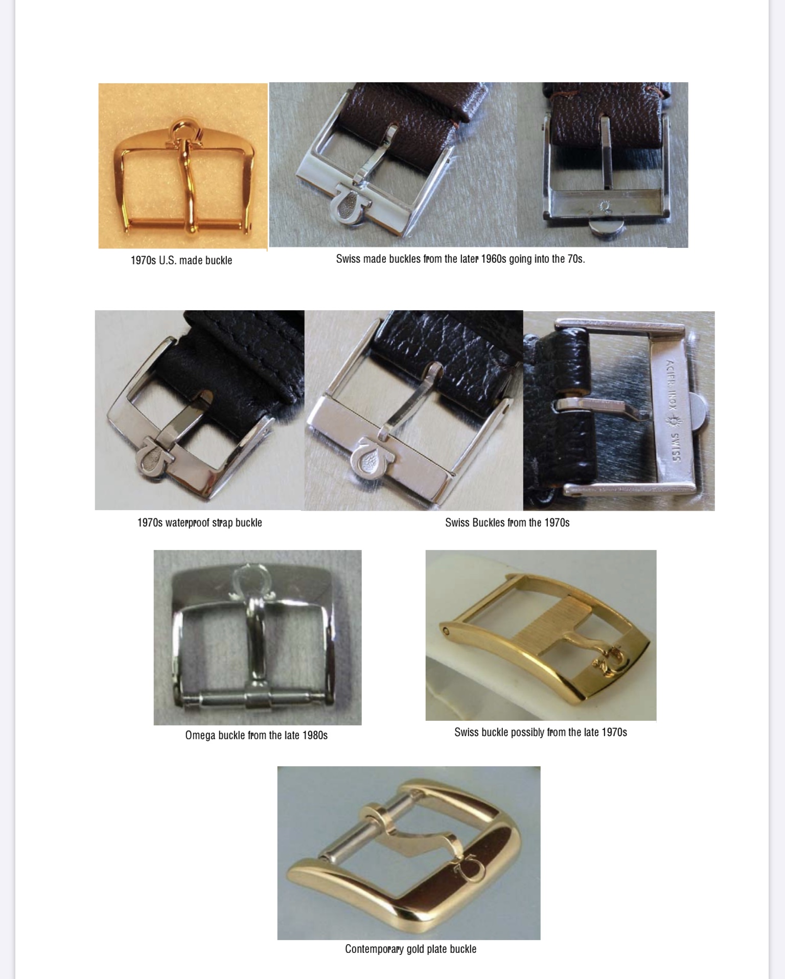

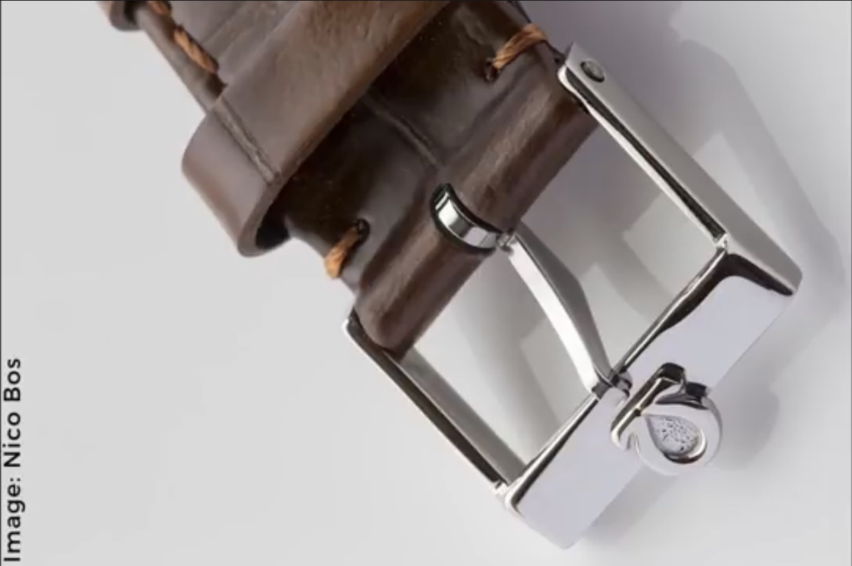

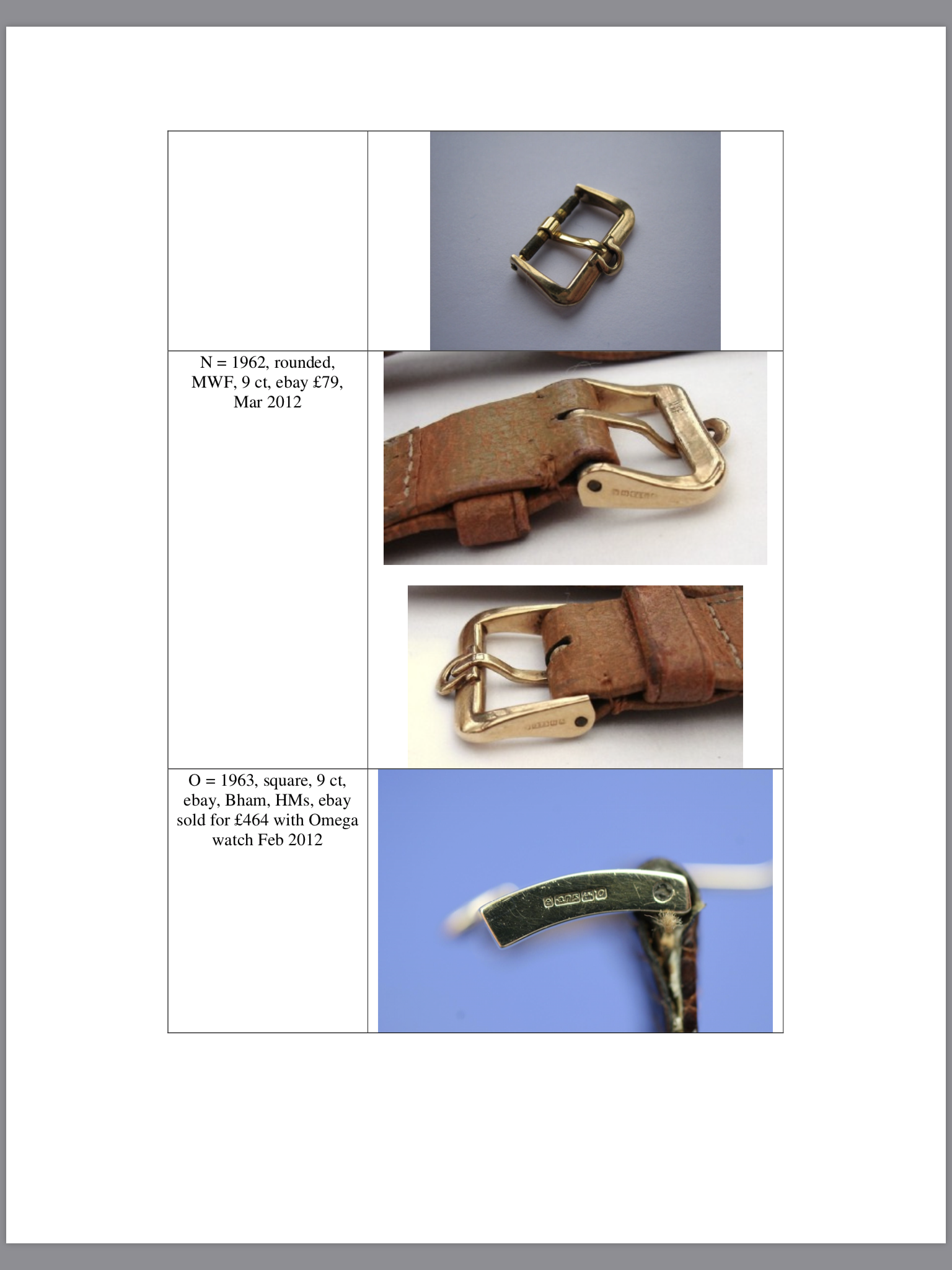

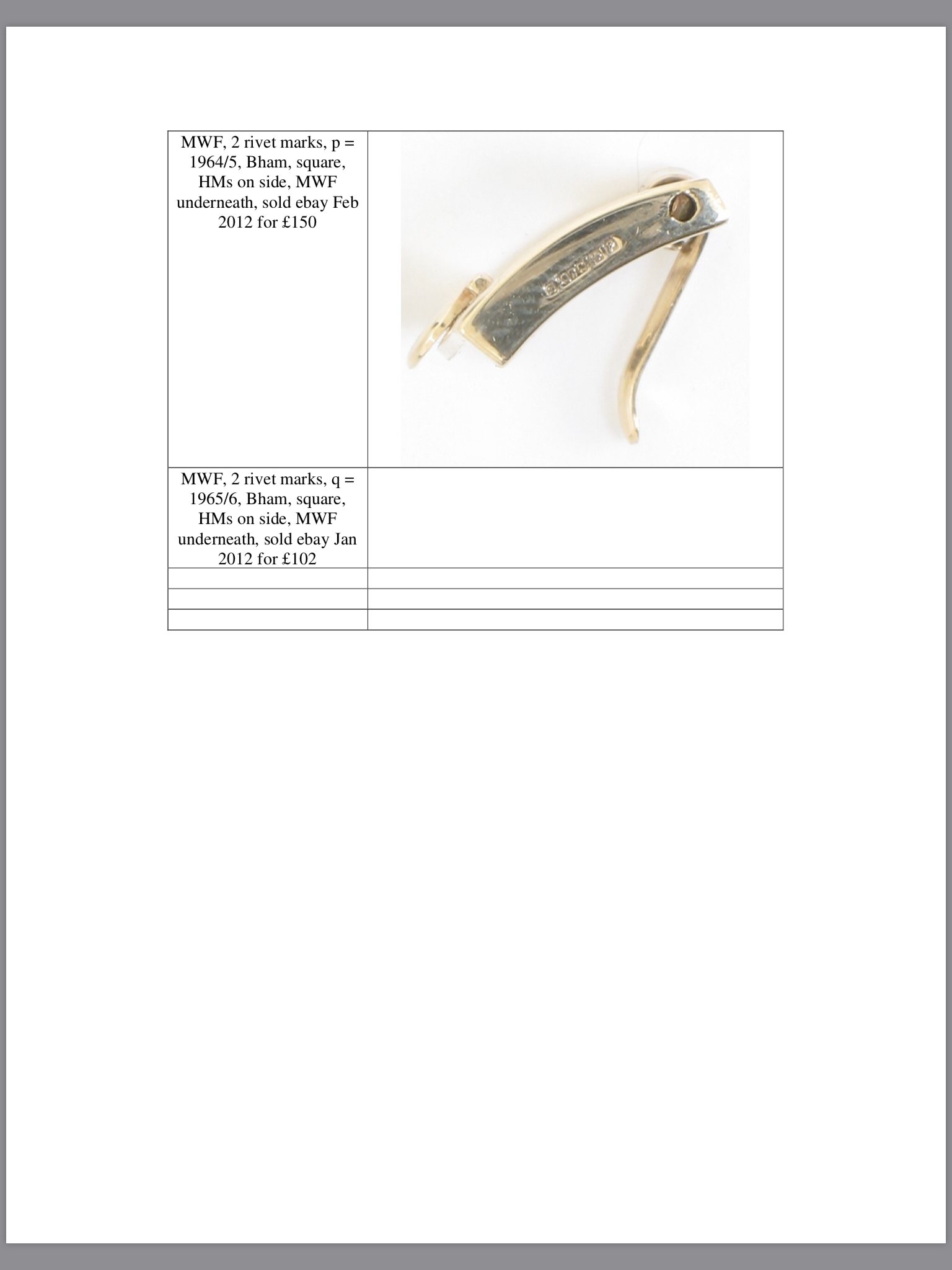

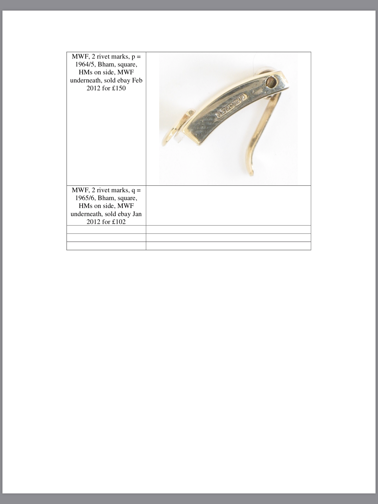

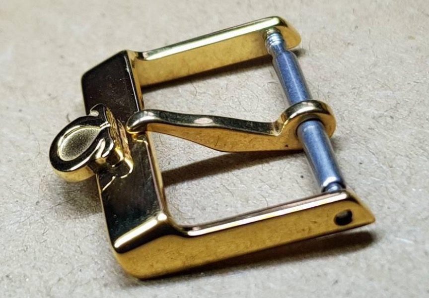

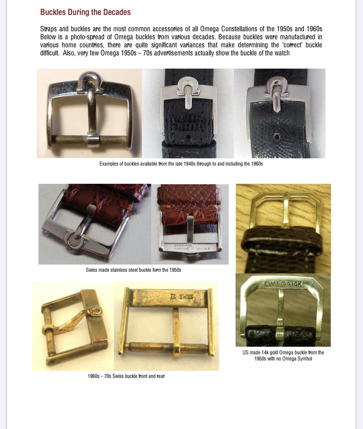

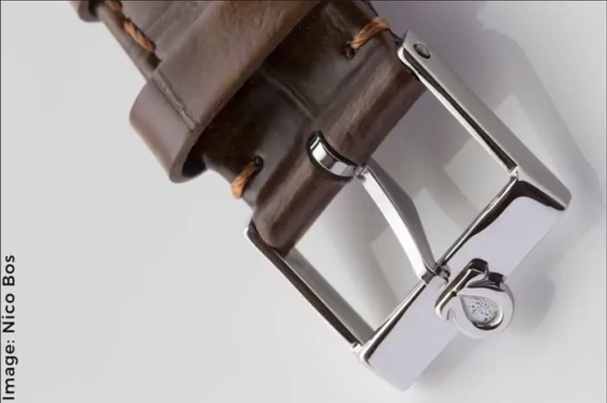

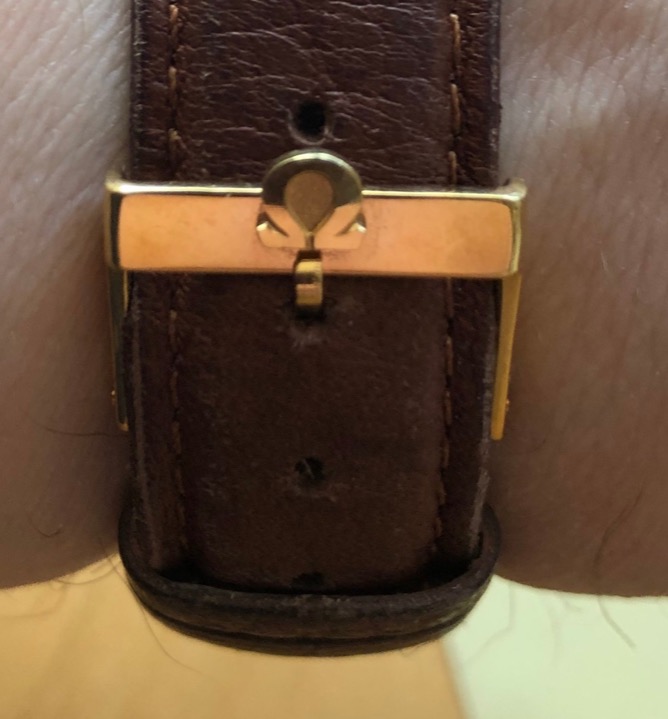

Correct Buckle
After researching what buckle had to come with my watch, I have found multiple sources confirming this buckle was the one that originally must have come with 1960's Constellations:

to answer your, now deleted, questions.

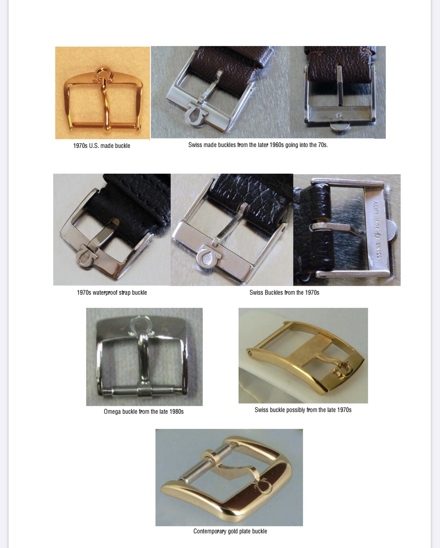

Boxes and buckles are perhaps some of the more vexing questions you could ask.

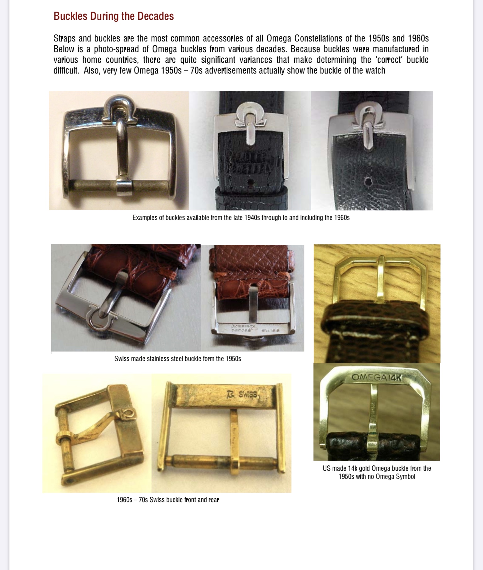

Firstly, the buckle you showed could well be correct, it rather depends on the year your watch was sold.
You can see, from Desmond’s blog, the array of possibilities around the turn of the 60s/70s
Secondly, for boxes, there could be a couple of options.
The original box should have Constellation written inside but a jeweller could also easily have reached for the nearest Omega box to house a watch.
The Constellation was the top of the range Omega, so the material (even solid gold) didn’t affect the box it came in (except for grand luxe’s whereby you could buy a special solid silver box )
Again both the year the watch was sold and the location may have affected the ‘correct’ box for your watch.

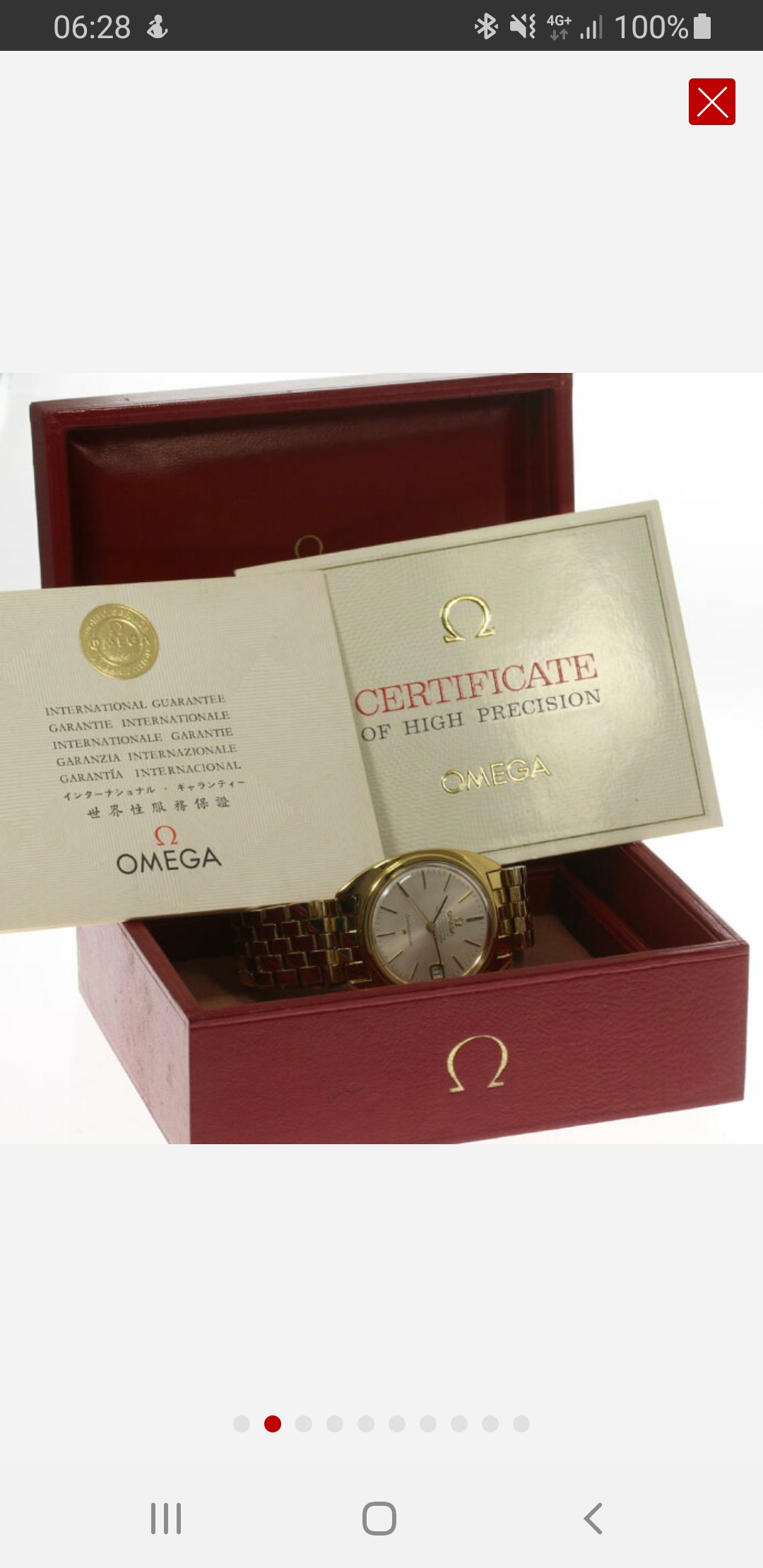

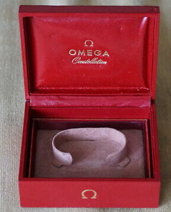

Most Connies in the 60s came in the classic red Constellation box with removable tray and curved watch support, with the grey-blue box you posted coming later.
However, IIRC, I seem to remember posts about the grey-blue box being used in the Far East whilst the red box was still being used in the West.
Not conclusive , I know - but hope this helps

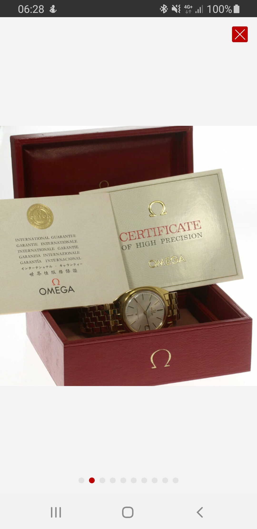

Thanks for that facts about the boxes! I didn't know that Constellations were the top-notch watches of their time.
If I understood the things correctly I have read previously during my research (including your recent revelation), then this pretty much would have been the "generic" box for the C-shaped constellations, am I correct here?
Link: https://www.ebay.com/itm/RARE-VINTA...186883?hash=item443c582983:g:PUYAAOSwfchcyGsY
Constellation boxes of that time era were strictly 5cm (2 inches) in thickness whereas Seamasters would have come in a similar box but 1cm thicker. I guess the above box would surely fit the bill... in terms of being the right box but not so much in terms of it's price 😀 .
I guess, to be really precise about the country the watch was headed to (and thus the box the watch originally came with) I would need to do an archive extraction. Not sure if it's worth though.

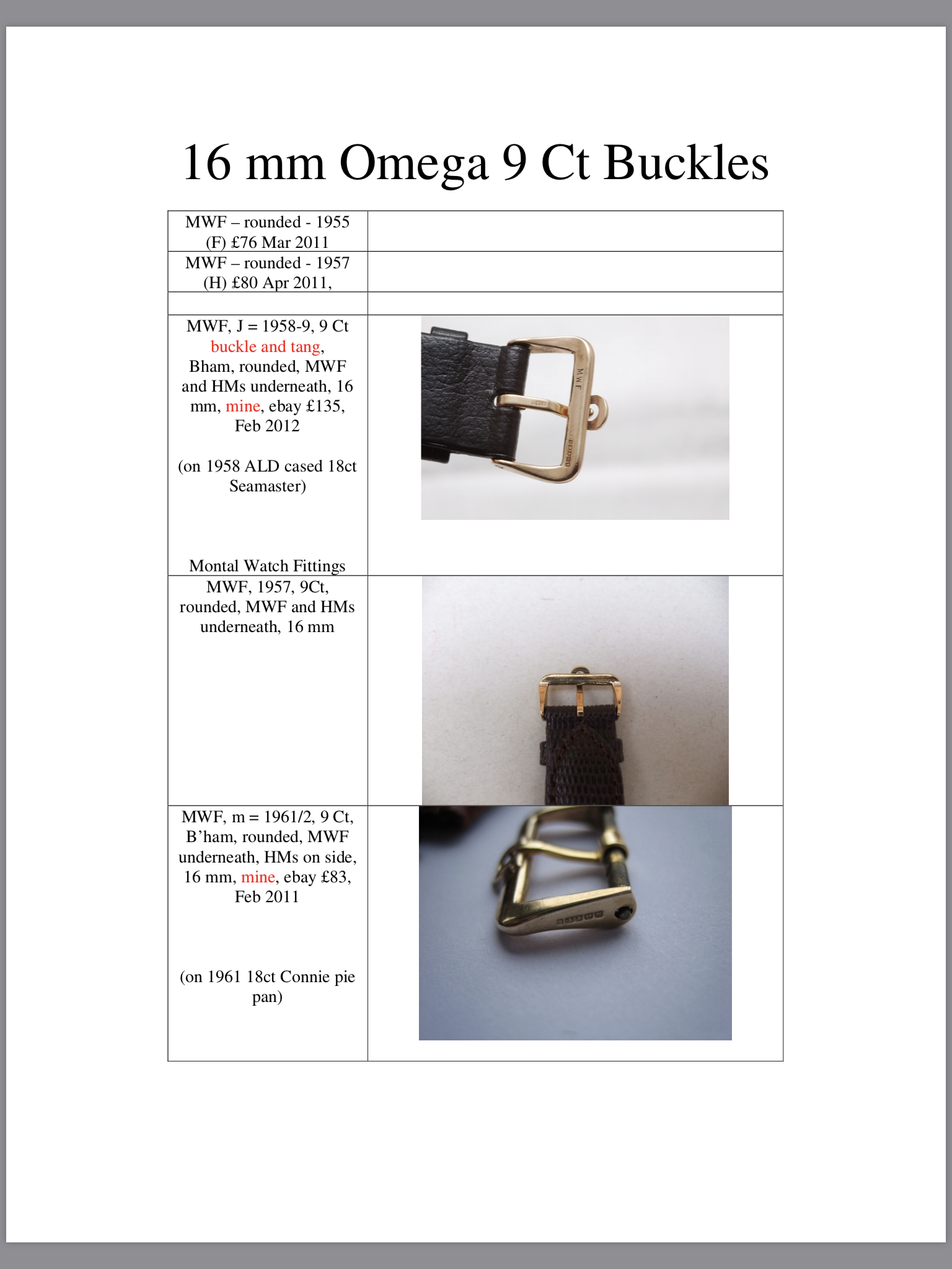

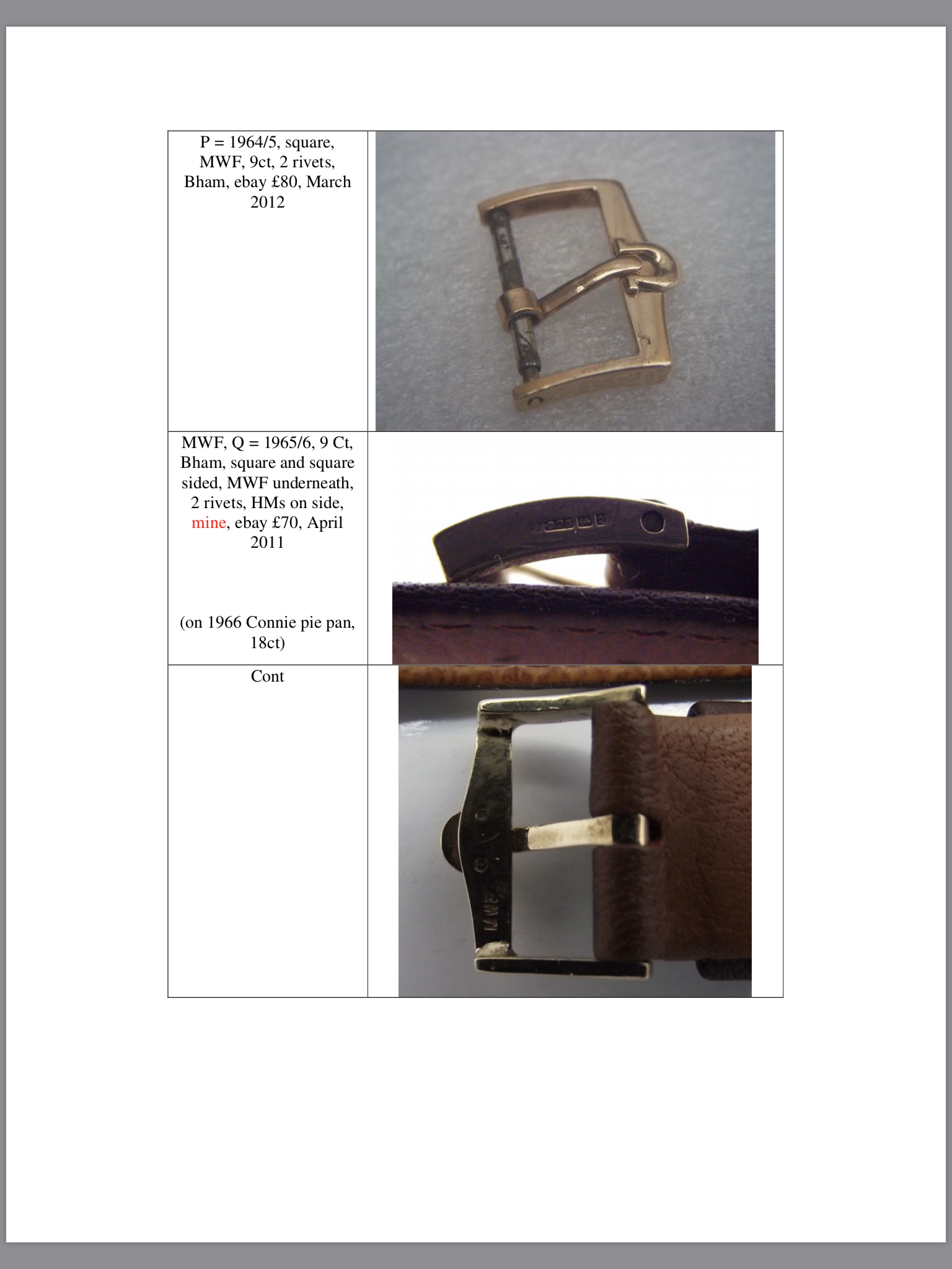

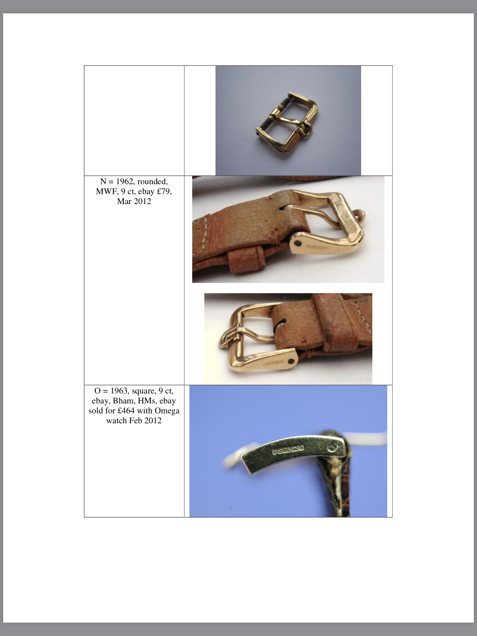

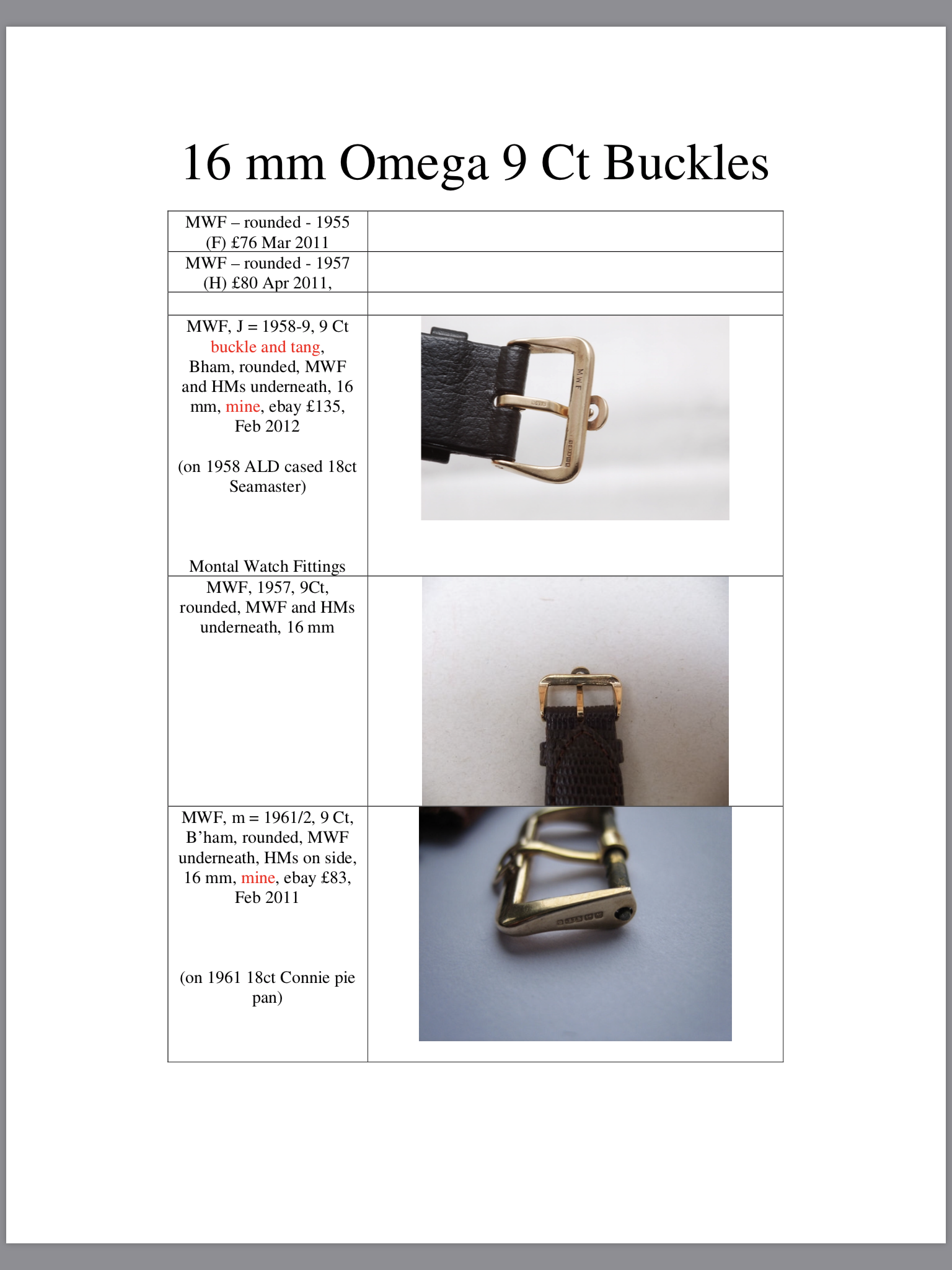

I cant remember now the age of your watch, or the case material, but one option could be to buy a hallmarked 9k gold Omega buckle from the UK, especially if your watch falls into the correct age bracket
these were trading around £80-120 a few years ago, so i have no idea what they cost now, but worth keeping an eye on ebay and other trading sites - as these do pop up
there are two main styles, with the later squarer buckle introduced around 1962 - this was something i wrote up a few years ago, but it gives you an idea

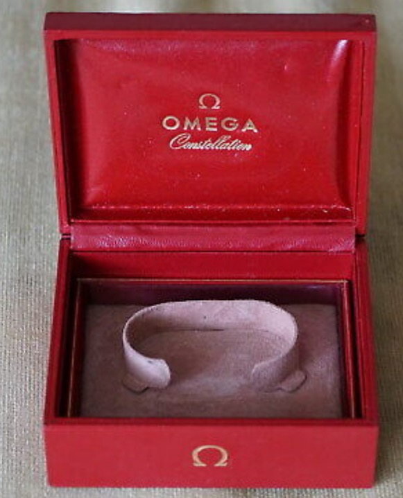

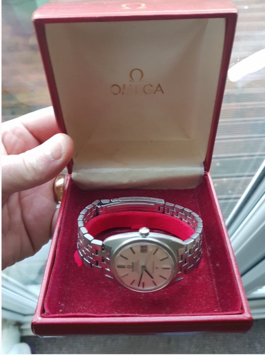

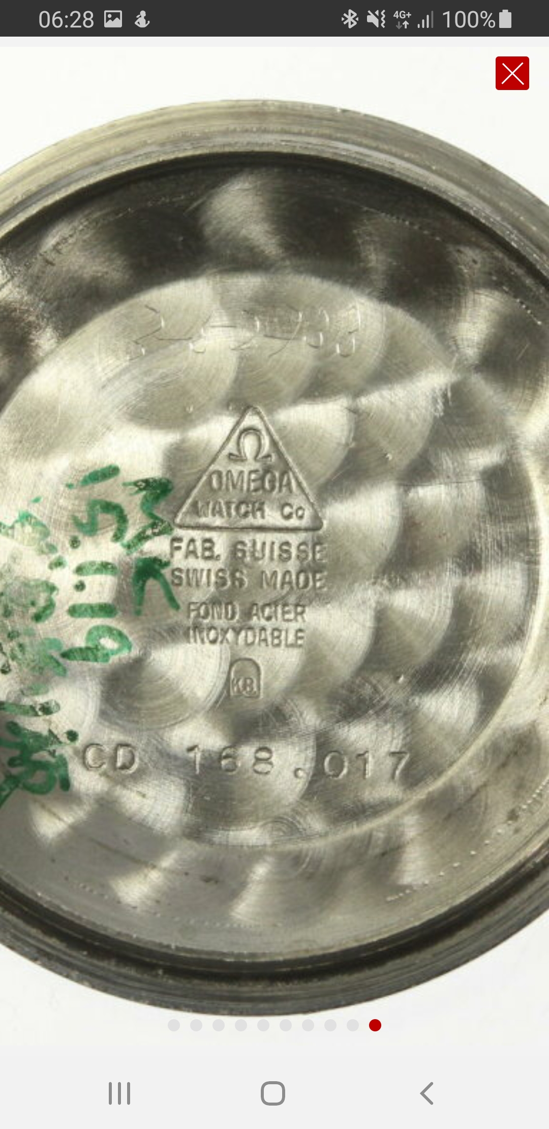

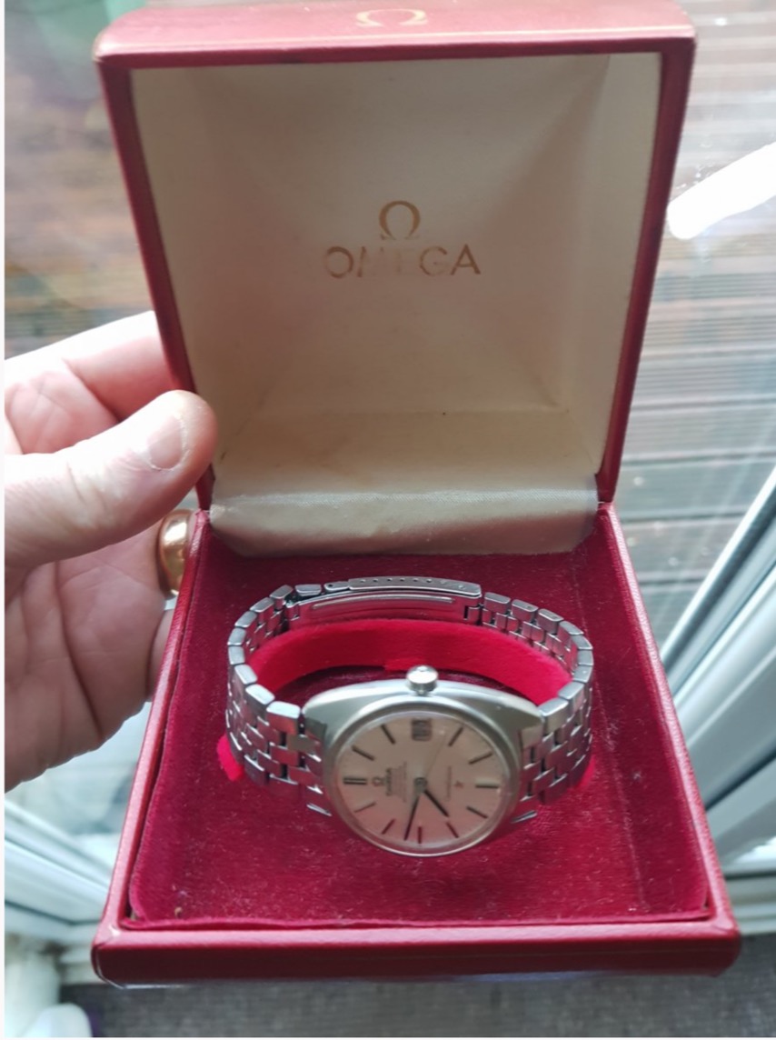

Couple of weeks ago I saw a 168.017 with box and papers. I made pictures for my database
This is the box I would go for if I was looking for a C-case box.
Seamaster boxes came in different styles (and colours)
At least one type was slightly taller and one type is rather lovely with a panelled top but the same height (this latter one came in red and green) both are smaller in plan than the Constellation box being roughly square in plan rather than rectangular like the Constellation box.
The one you posted is outrageously expensive.
Although finding one with the removable inner tray still inside is key.
There was one for sale on the forum fairly recently (now withdrawn)
It was still rather expensive but not as bad as the one on eBay.
https://omegaforums.net/threads/60s-omega-constellation-box-with-tray.114911/
(You could always PM the member to see if it is still available)
I don’t know which country you are in but watch your local auction houses - boxes do turn up now and again. (and check EBay for more sensibly priced boxes)

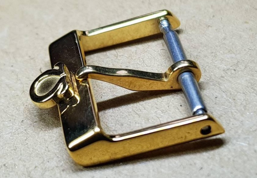

If you go for a modern Omega buckle, try Otto Frei or Cousins they may have some left and will likely be less expensive than an Omega Boutique
