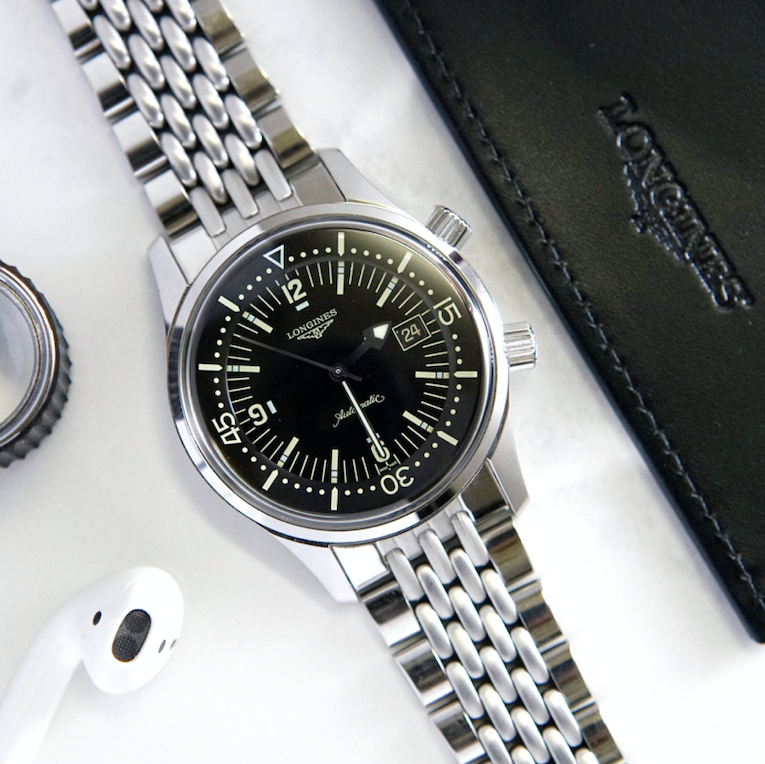

So, I have a question about the FOIS and my Beads of Rice. I just got mine the other day and I noticed the sides are polished, and I am wondering if I should make the BOR reversed, i.e. polished on the sides and brushed down the middle. I did this for the Longines Legend Diver and it worked well. It would have looked odd if the case went from polished to brushed where it connected. What say you?

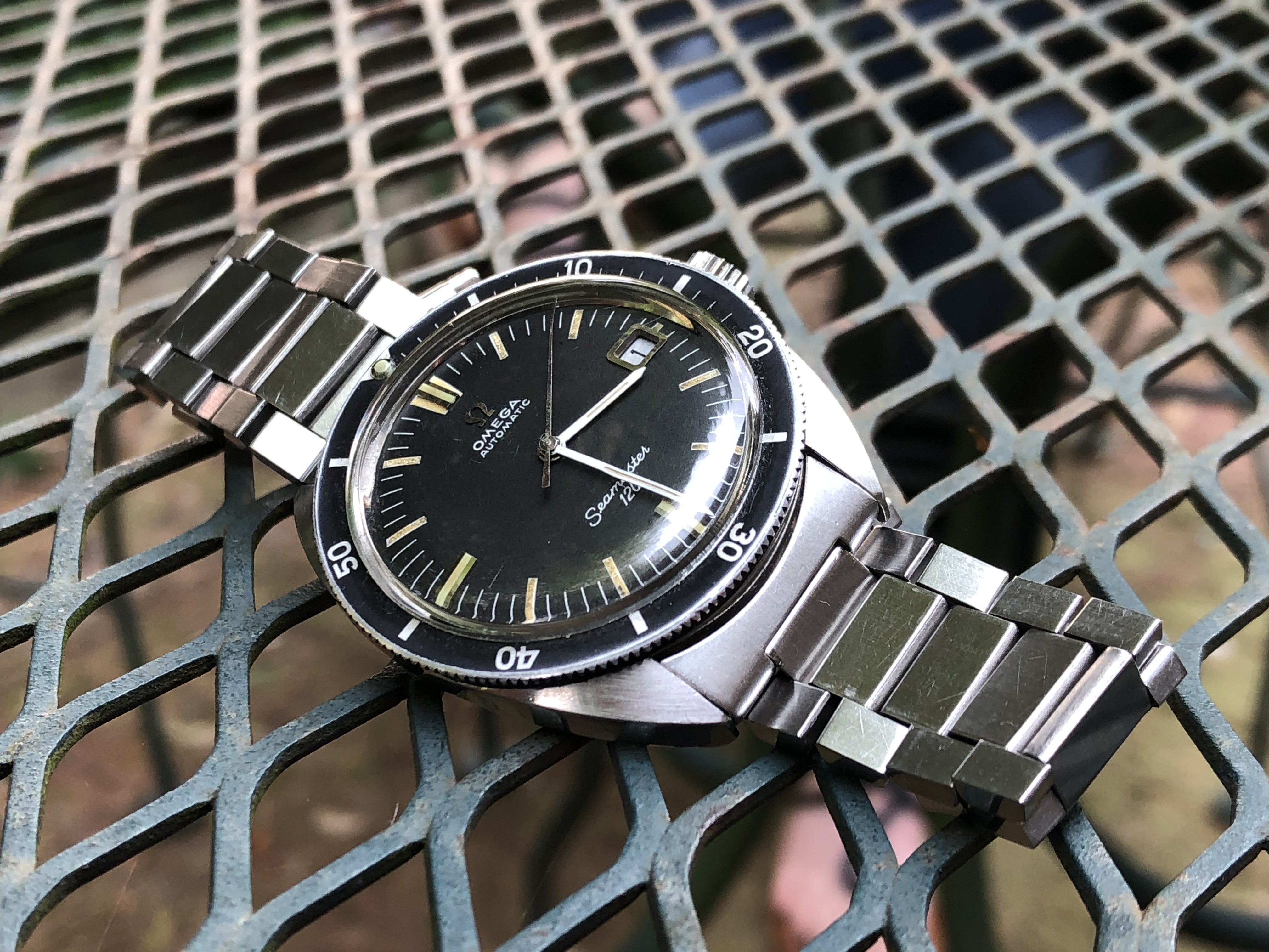

Also, the 19mm flatlink would appeal to the SM120 crowd as well- not sure what the difference is with lug fit. The flatlink (can’t remember the model) was also available in 18mm around 1967- paired in catalogs for the technical dialed Seamaster’s. I believe it was the same bracelet as for the 19mm Speedy’s, but with different endlinks- could be wrong about that. I think if you offered the 18/19 model with both endlinks available you will open yourself up to a whole other market for us non- 300 Seamaster collectors.

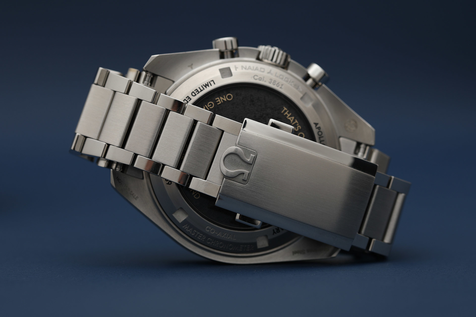

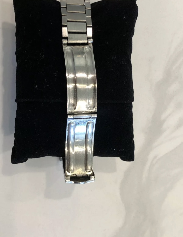

Inspiration for the clasp could be take from the 50s anniversary watches as mentionned above
picture from swisswatchesblog

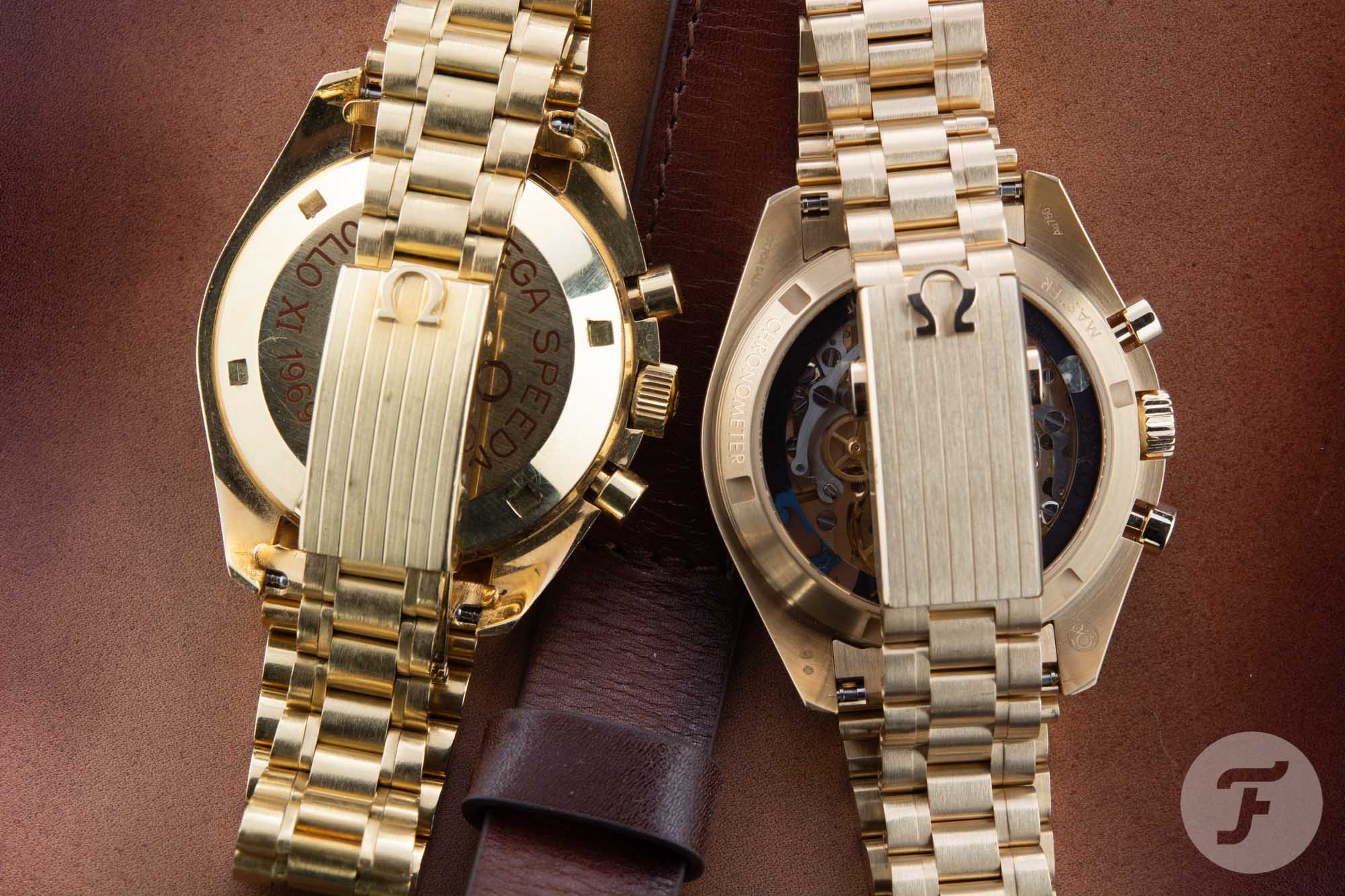

and
pics from Fratellowatches
The FOIS head does combine brushed and polished but it's only the sides. Everything in the head-on/up visibility is polished. To truly match the FOIS head, I would say polish the top, but brush the ends (only visible from side-view).
