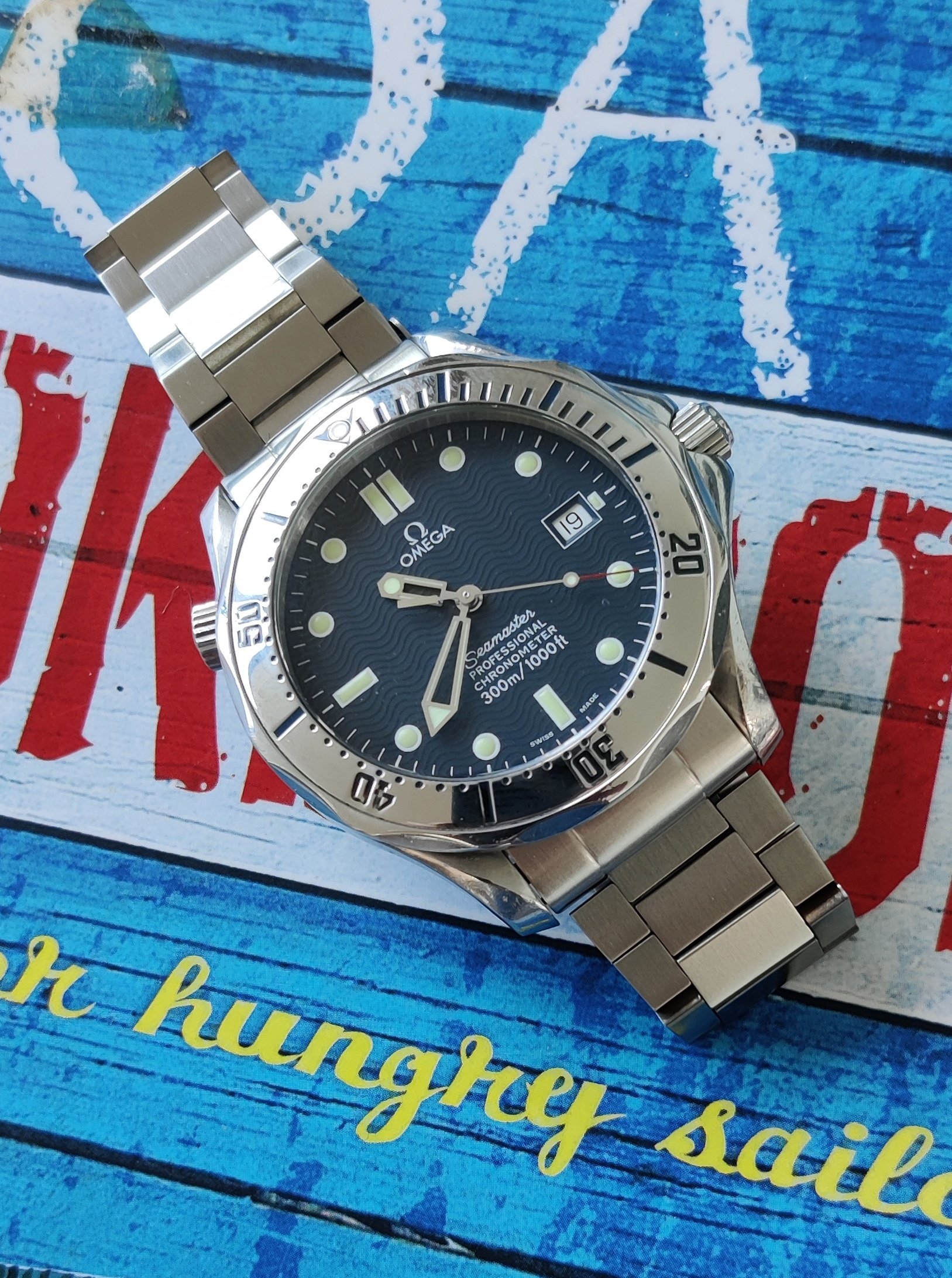

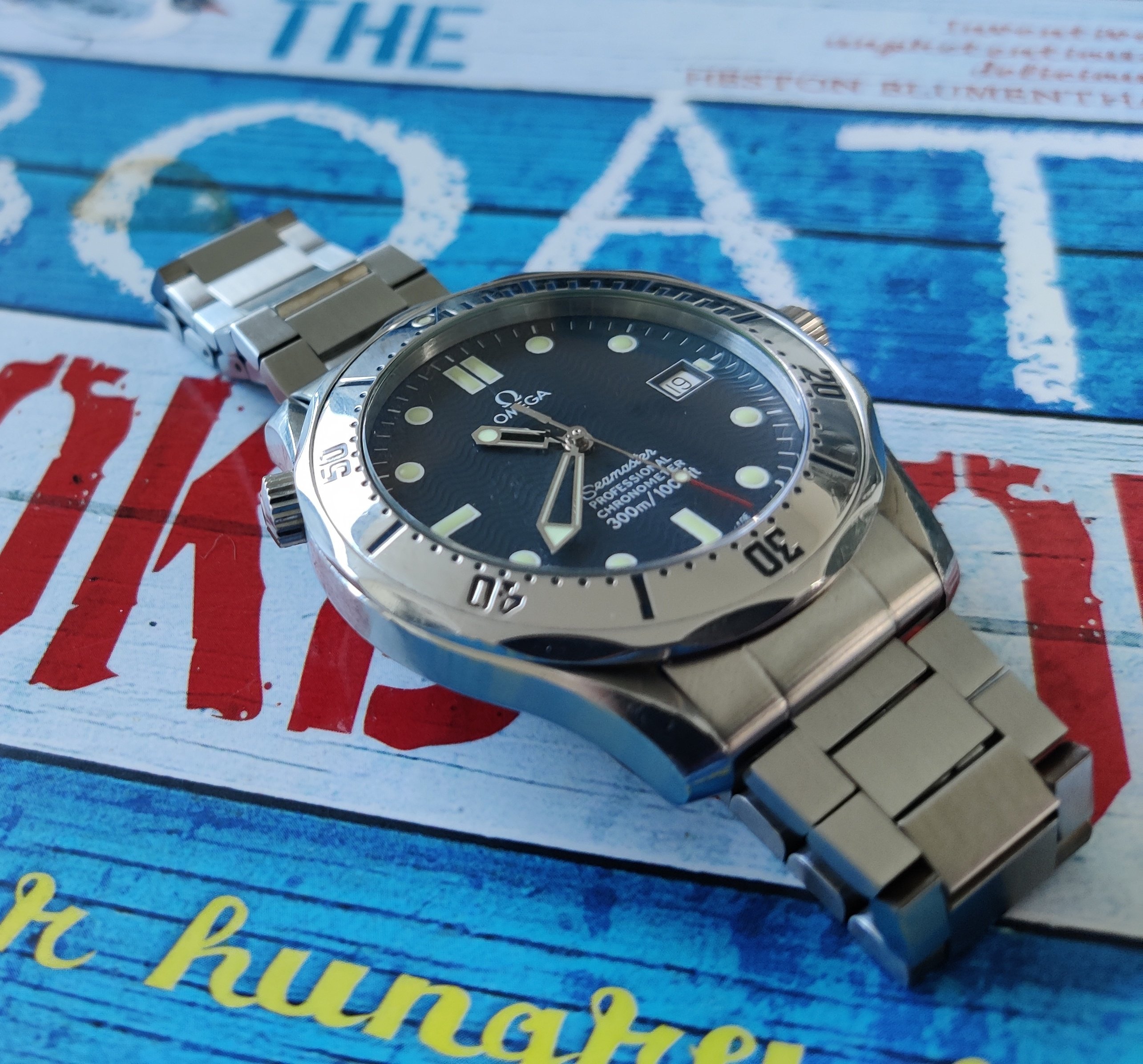

still hoping he’ll put out 21mm endlinks so I can put a flat link on my Seamaster 300 MC.
127
154
‘If you bought some generic 21mm hollow end links you might be able to manipulate them into fitting
Eg. https://www.ebay.com/itm/21mm-Oyste...924484?hash=item4220127e84:g:QdEAAOSwHxZfWNUJ
Or get some 22mm ones and file 0.5mm from either side:
https://www.ebay.com/itm/22mm-hollo...046098?hash=item1a76121492:g:PdgAAOSwPbla7pNG
the opening on both of these end links is about 9mm which sounds about right for the width of the Uncle Seiko middle links. Otherwise, it’s file time. Could be a fun little project actually.
I can’t vouch for either vendor or you chances of success but worst case scenario you waste about $10 on the end links.
2,811
3,739
I have considered doing that - I’ve filed end pieces before. The bigger issue is getting the polished outer part/brushed inner to match well. I prefer that look. Still holding out for an US solution, but may resort to this eventually.

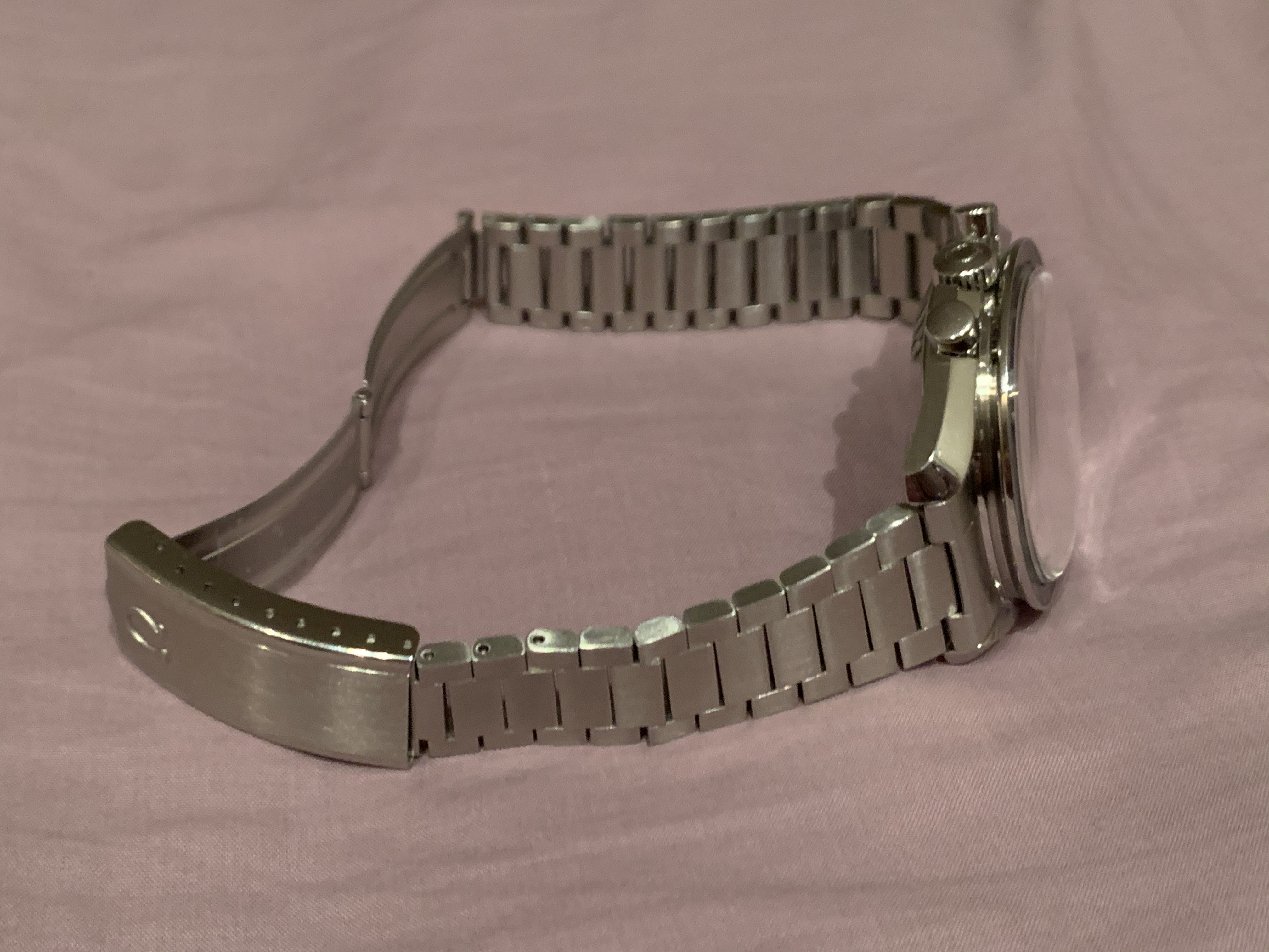

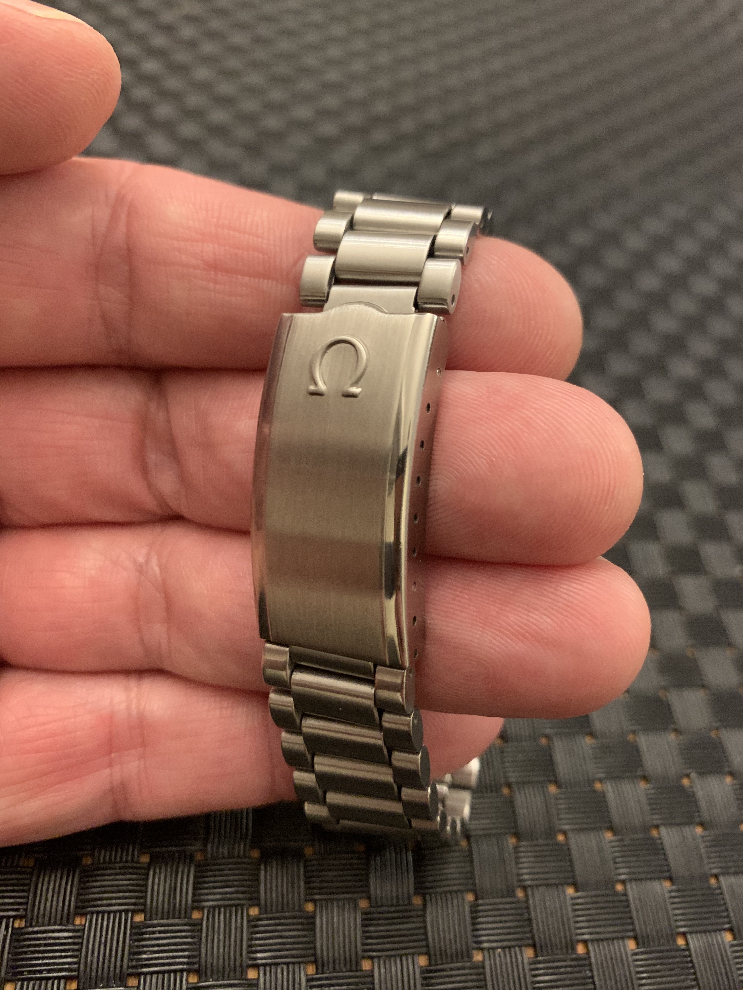

My new ‘Canada’ clasp covers turned up yesterday and must say I prefer them over the genuine new style 1171. Top marks to the seller for fast post to The Nederlands. My 2 new bracelets from Uncle Seiko will get here via a friend in around 4 weeks so will post some pics then of the completed look.
90
163
Here’s a ‘Canada’ clasp cover on a new genuine 1171. imo much better than the new etched version.

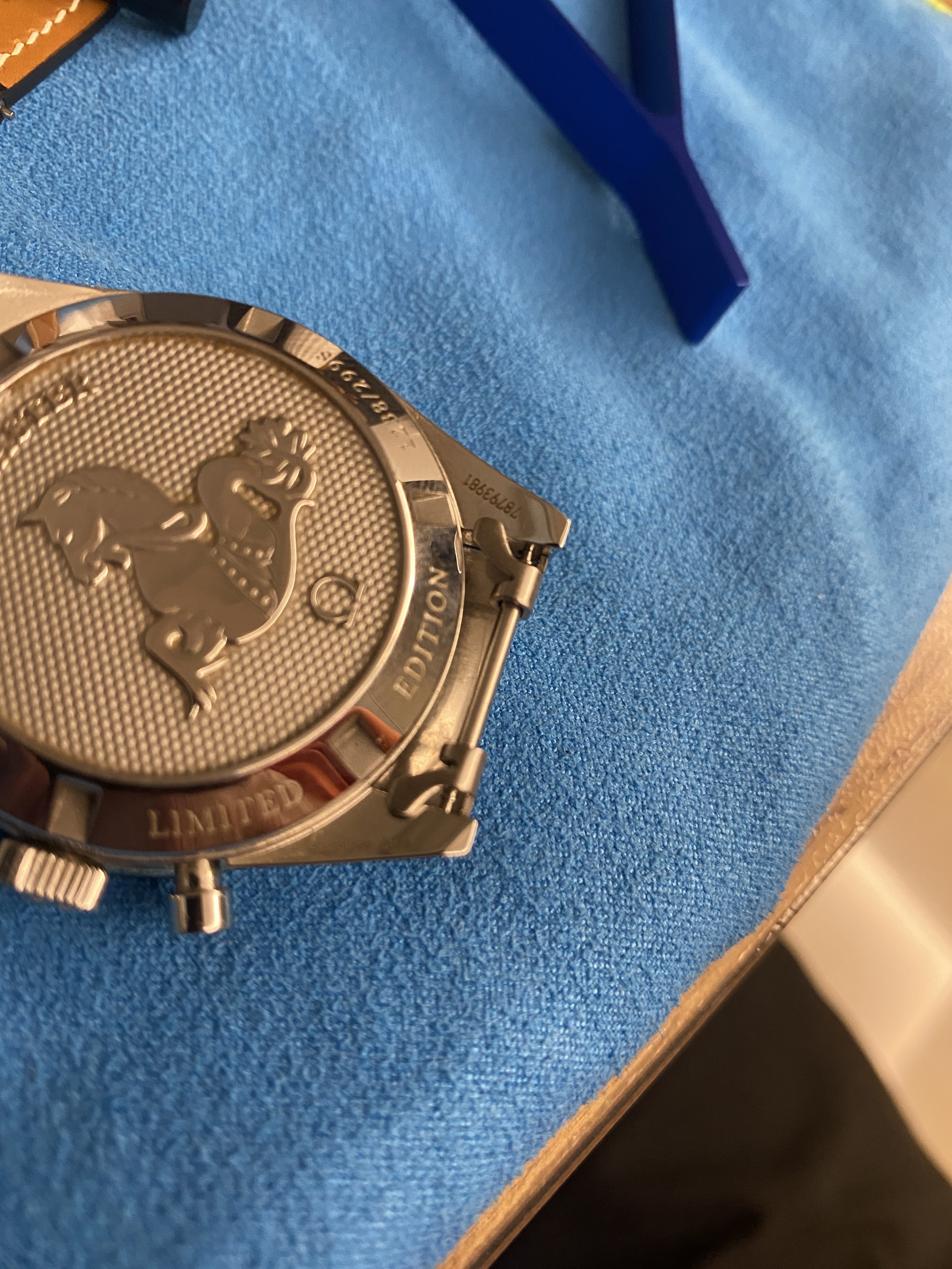

Hi guys, I just received my flatlink bracelet and am having issues installing it. The end links provided by uncle seiko seems to not allot me to line up the holes and the pins... do we have to bend the end links to fit the watch ?
1,023
1,019
you may have to manipulate the tabs to fit. my endlinks did not need any modification but they were a bear to get on.
16,305
45,025
As discussed further back, these endlinks were designed based on specific case profiles (SMP) and not all have the holes in the same place (thank you Omega). You can do some bending using flat ended small pliers wrapped in electrical tape. Two pliers make it easier to get some grip.
Your issue looks like the top plate is too long and hits the case before you can line up the holes. Some filing with something like a rat-tail file (very carefully and evenly) can also take off enough material to clear the case- others have done this and perhaps they can chime in with an instructional.
1,023
1,019
I totally missed that this was going on a seamaster. so yeah... the holes are definitely not the same as speedy or at least modern ones. I would expect that the endlinks would need some massaging to get wm to work.

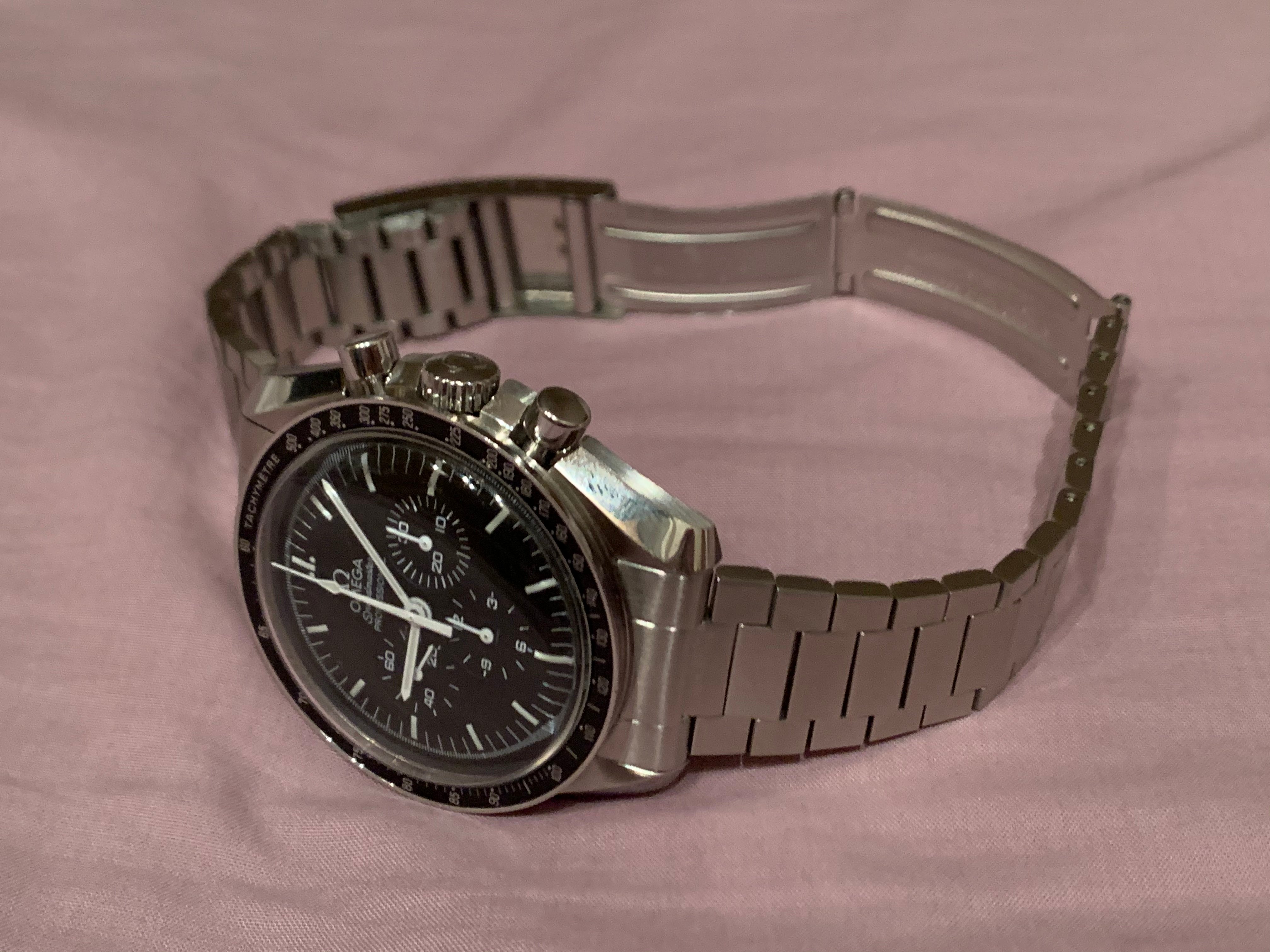

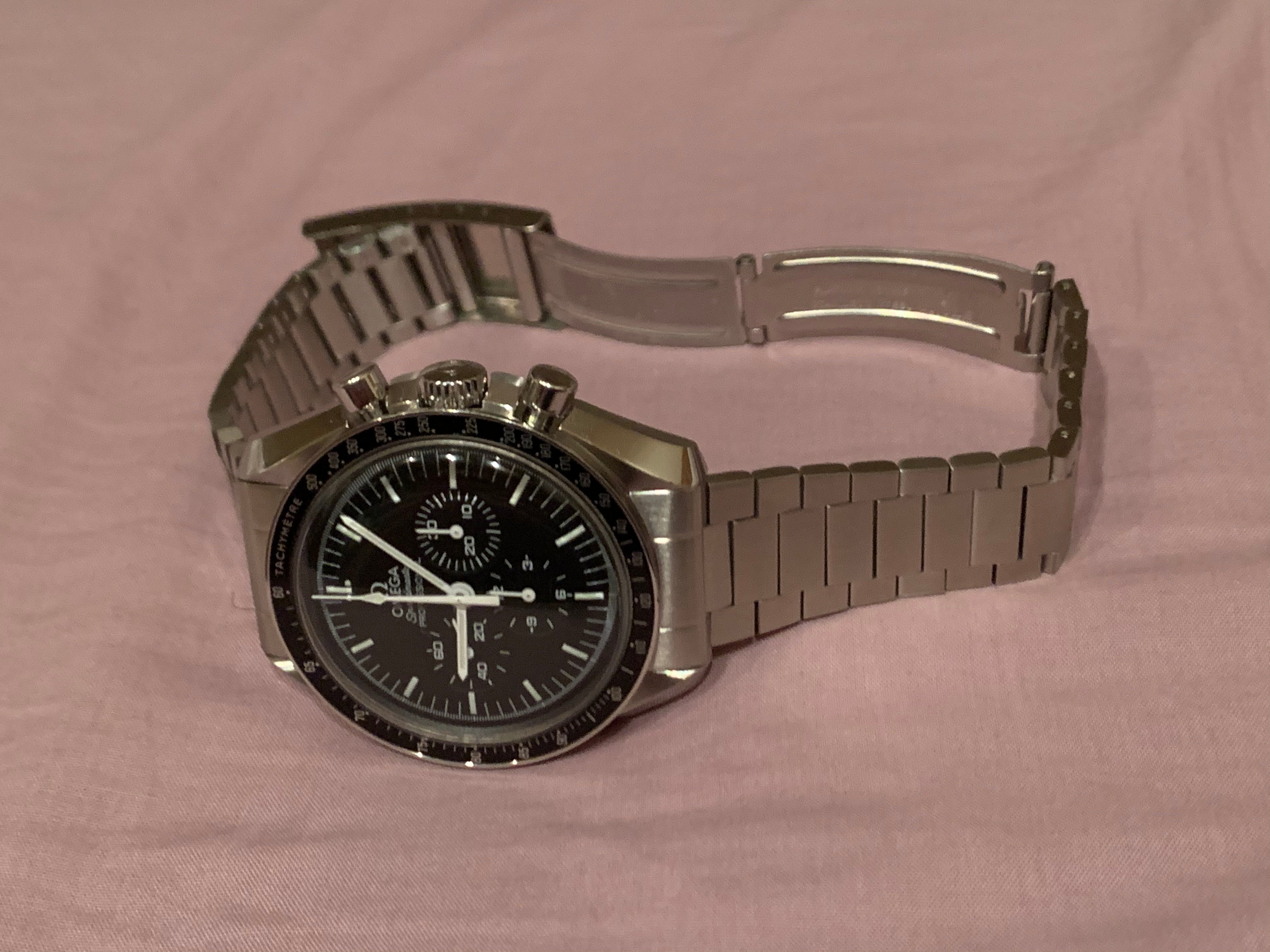

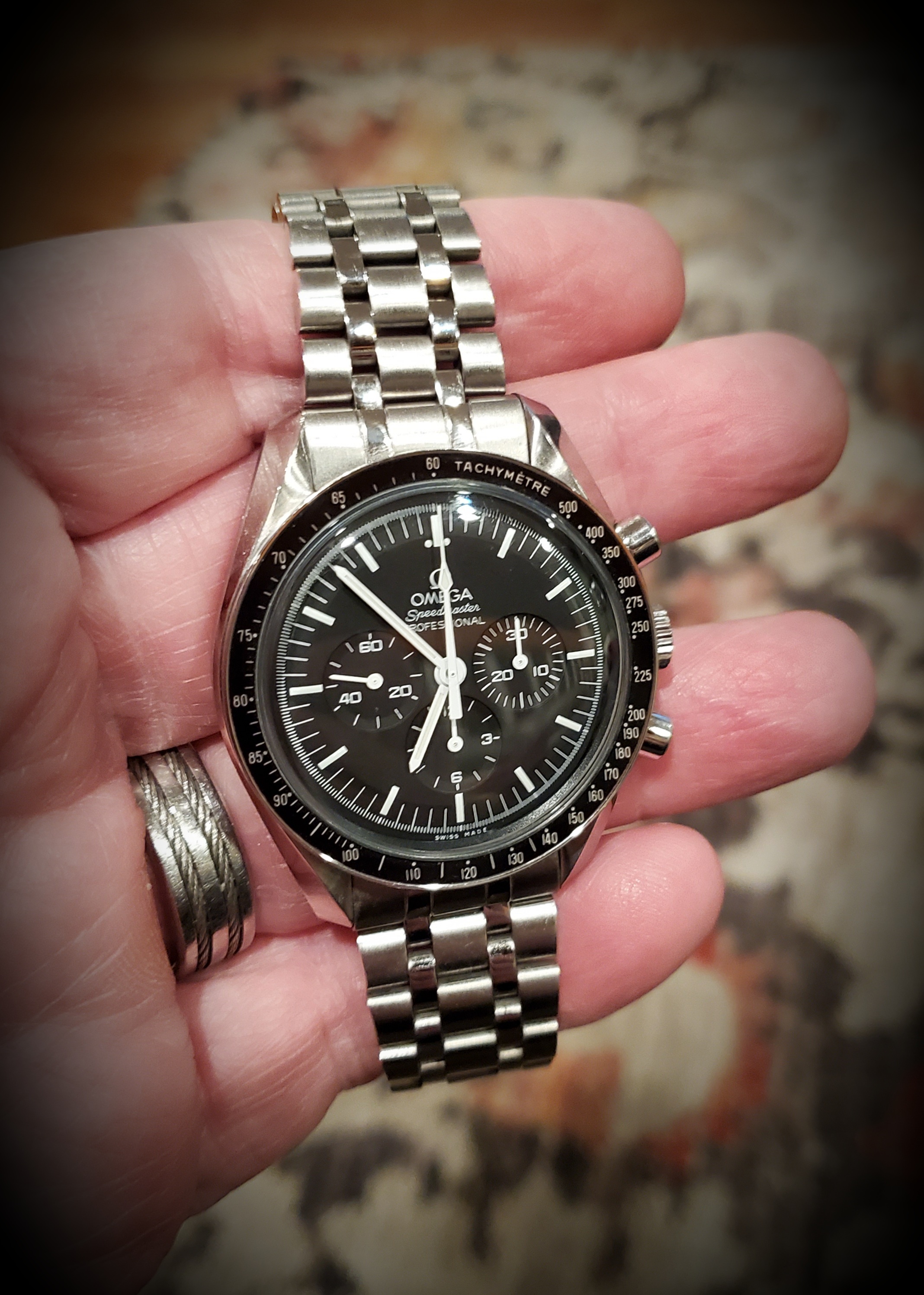

Took a little longer than expected for my friend to bring the bracelets over to the Netherlands however they got here today. All I can say is WOW! Both the flat link and the 1171 are IMO of better quality than my genuine 1171/633. I’ve added Canada clasps and fitted the flat link. The fit is perfect and therefore takes patience to fit. Top marks Uncle Seiko for these awesome bracelets. Anyone looking for a period bracelet for their Speedy shouldn’t hesitate.

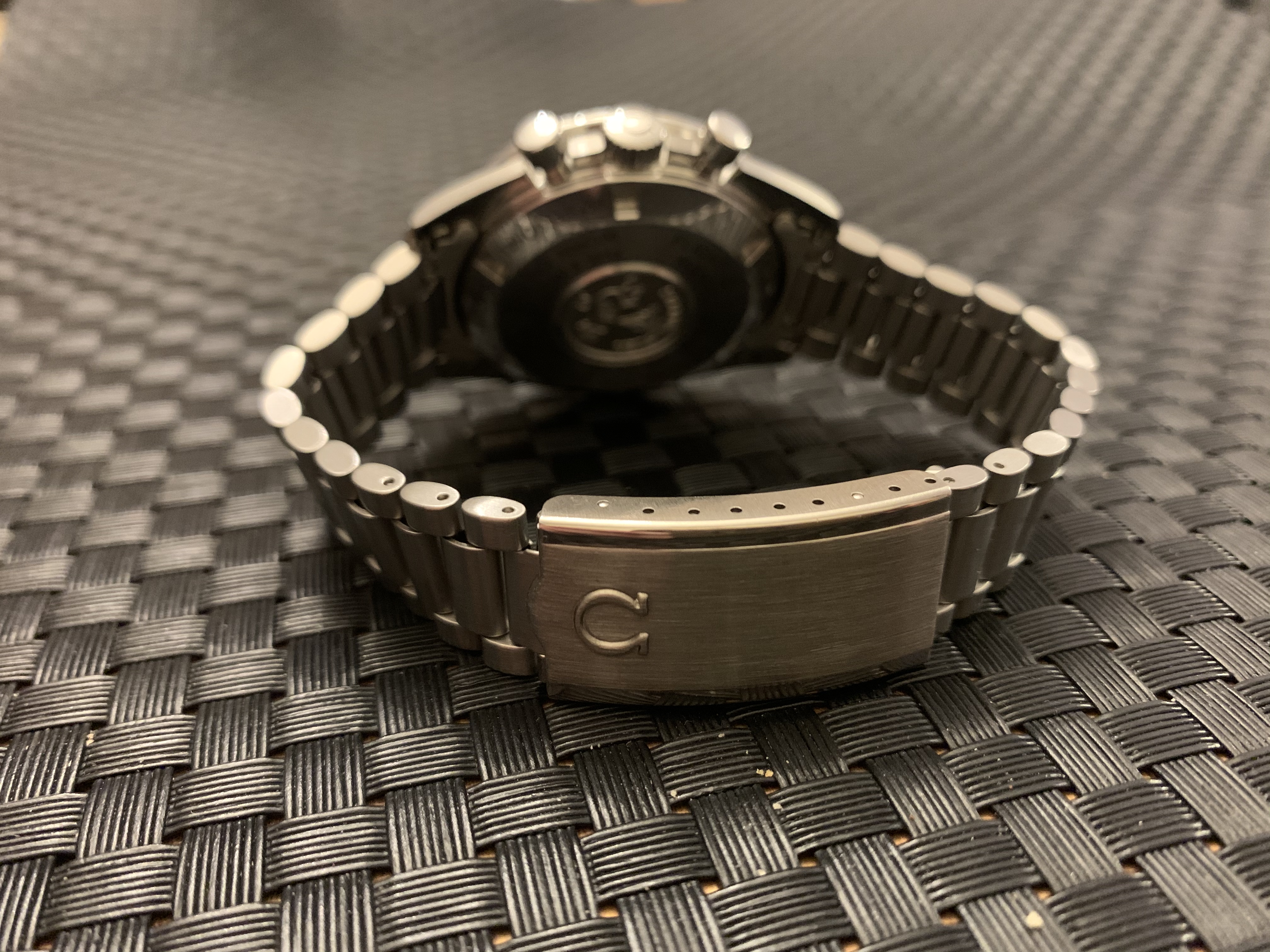

Hey folks, I have been sifting through all this, and I’m a bit confused here. The info is scattered throughout several posts, and some of the older links don’t work. Here’s what I have gleaned; please correct or confirm:
- the Mark IV 1162/173 on Etsy will fit the US 1171 and US Holzer? The ad claims it’s a genuine Omega item. All true?
- the “Speedmaster 1171 Moonwalk deployment clasp” on Etsy would hopefully fit the US 1171, but does it also fit the US Holzer? The ad claims this is also a genuine Omega item. All true?
- if these two clasps are genuine Omega, what is the Canada clasp? A link I missed?
I’m not calling anyone out in particular, but sickboy seemed to be taking the lead on this. Thanks for the clari!
