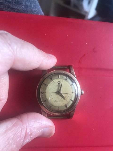

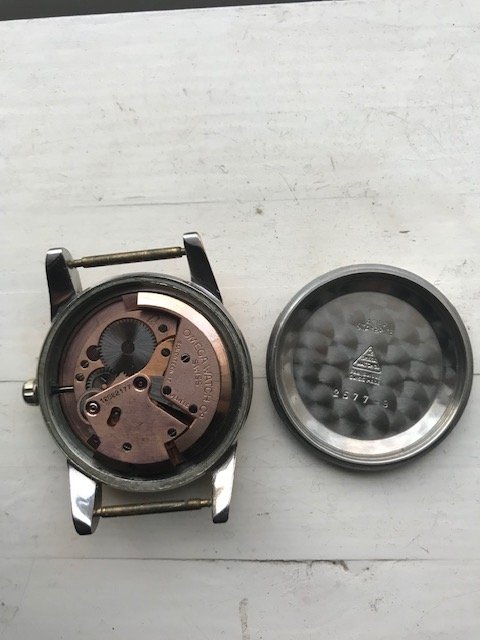

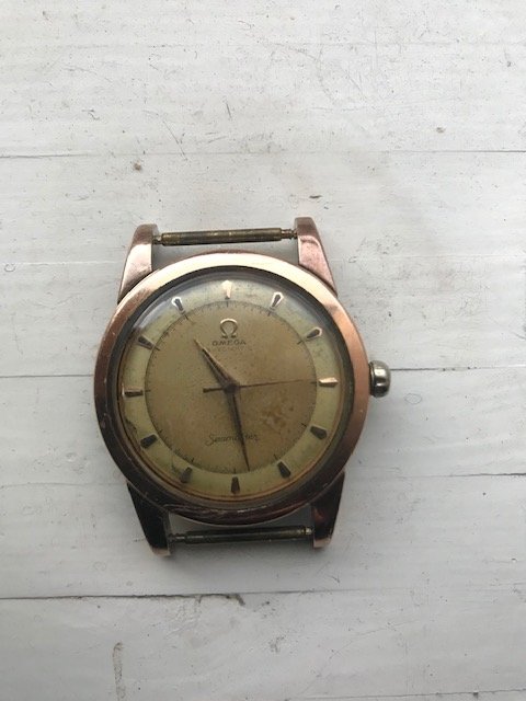

this was my fathers watch (only owner). He used it from 50ies untill 90ies, when his eyes demanded a bigger dial which he could read also nights. Befor I give it to a watch maker, who helped me the last years, I want your help with decision making.
Firstly, I would to know more about the watch. The only info I got, is from internet and it is not so much to read. Can you tell me more about ref 2577?
Secondly, I would to know your opinion in topic how long I should go. The movement is still fantastic and I guess the necessary task is a ultasonic cleaning but more?I can’t decide what to do with the dial. I don’t want to destroy the watch and keep it as it is. But, what is the right way to go?

There are very large numbers of 2577s in the world with a lot of variation. You will want an Omega specialist, especially one skilled at installing bushings, as some of the holes in that movement are likely worn oval. Very common.
A standard service that includes crystal and crown for water resistance would be a good idea. That crown is probably not original to the watch in any event. Talk with your watchmaker about hand-polishing the case. That will brighten it and take out some of the surface scratches and is safer than a buffing wheel. With any luck you can find a watchmaker that has an Omega parts account, too.
I'm sure you will be very happy with this watch once it has been serviced.
