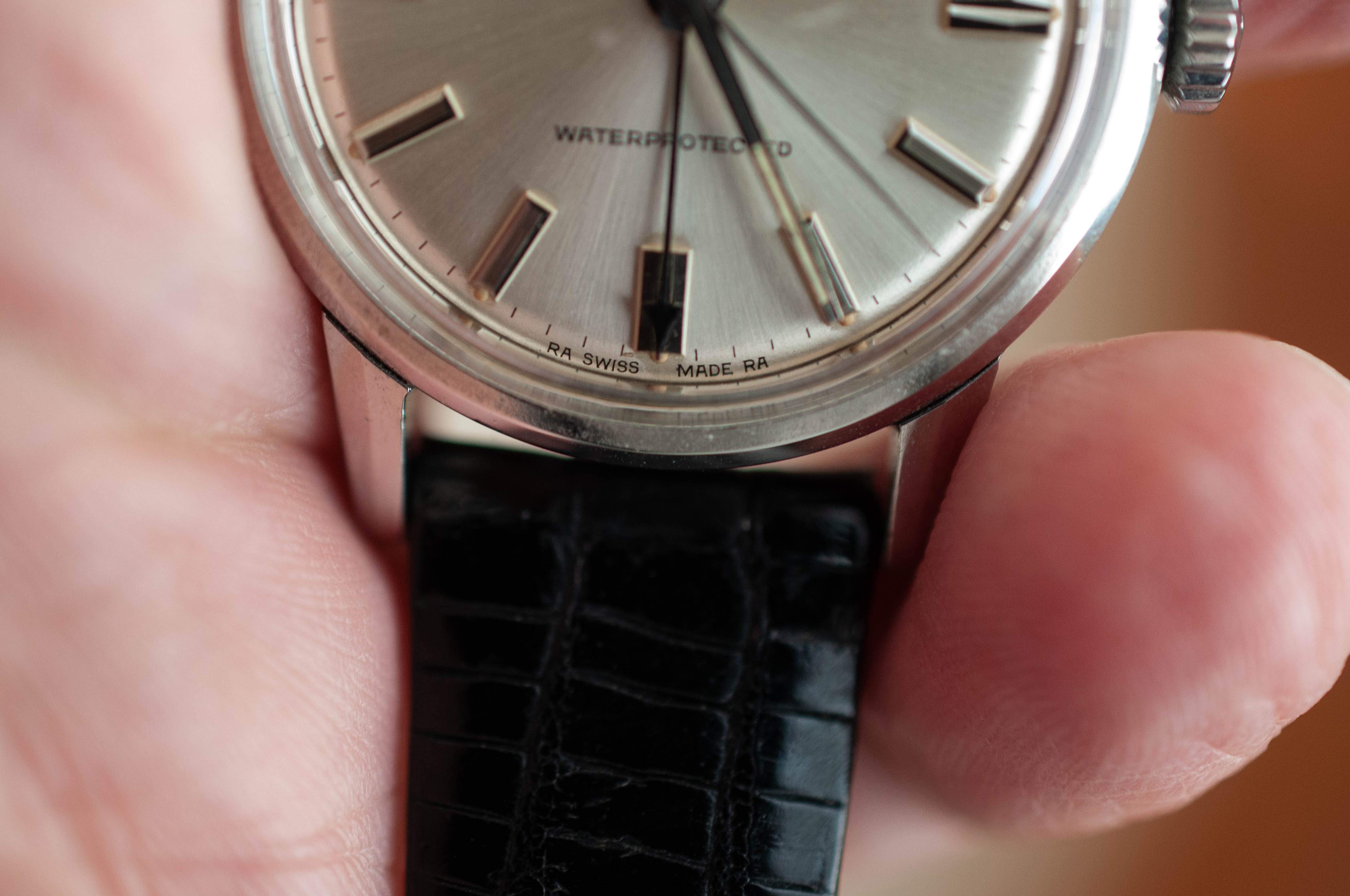

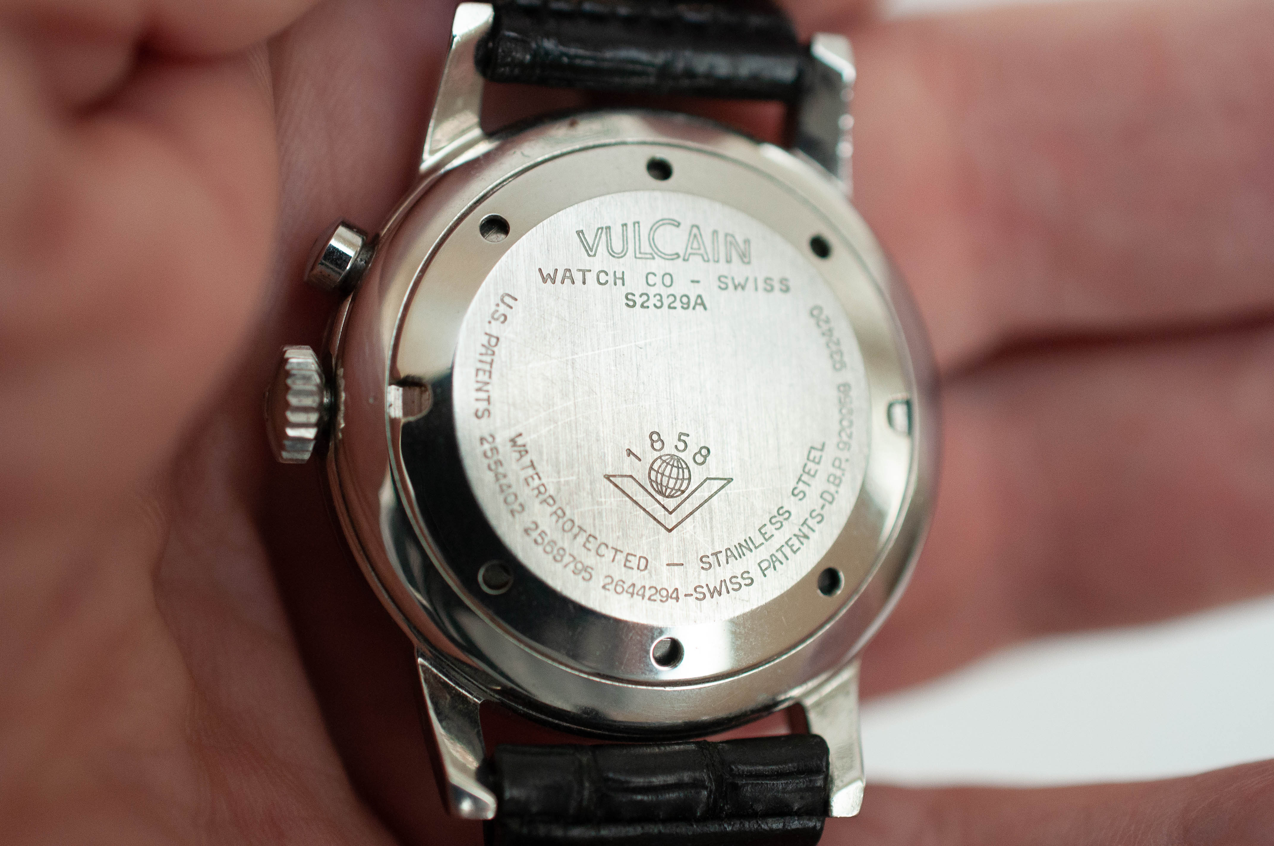

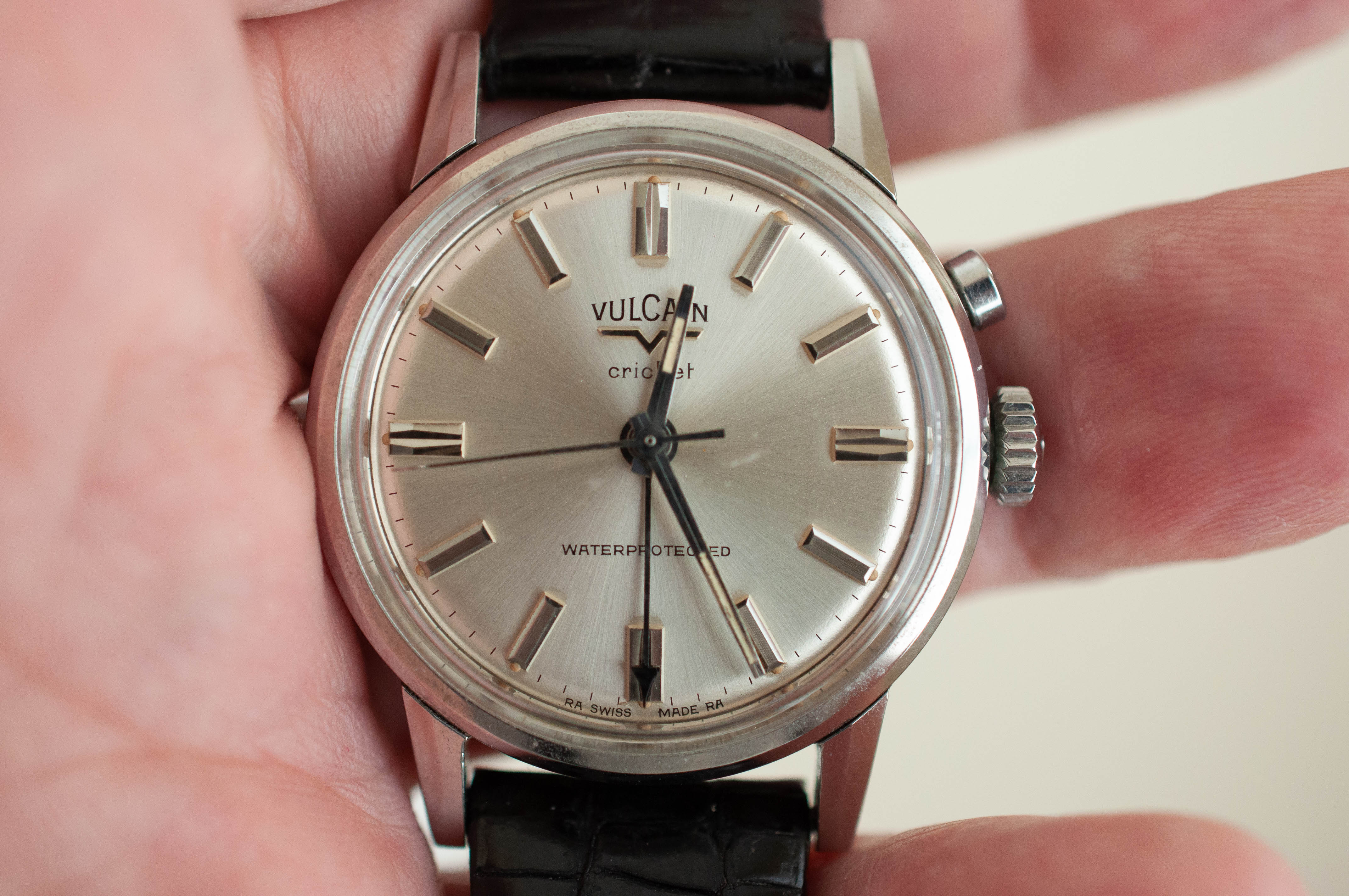

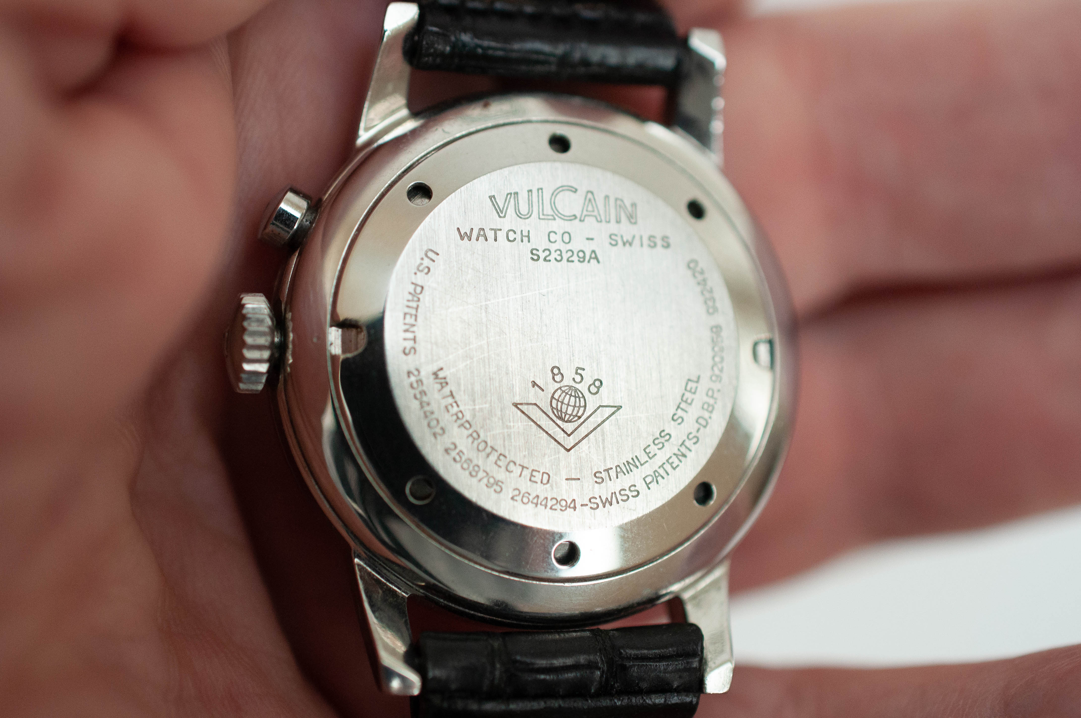

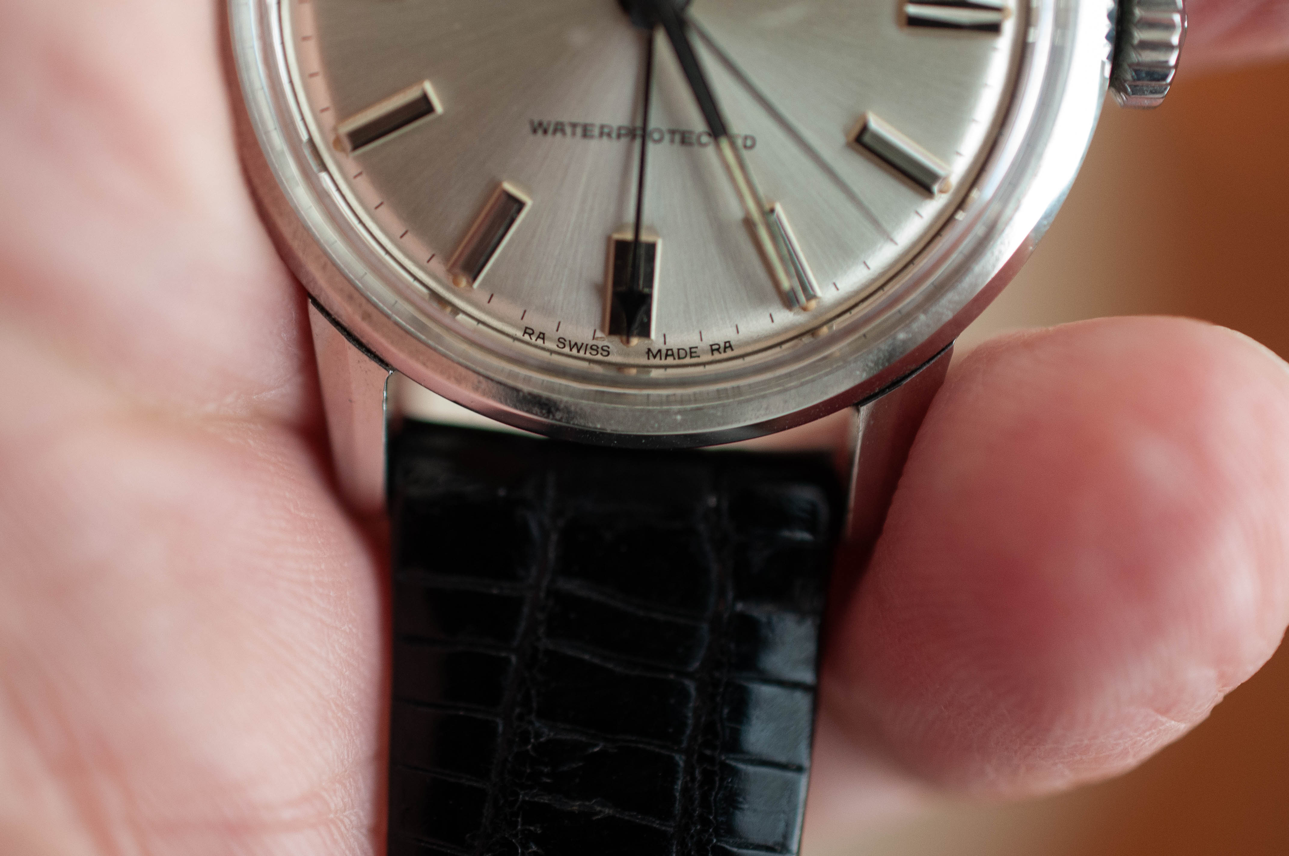

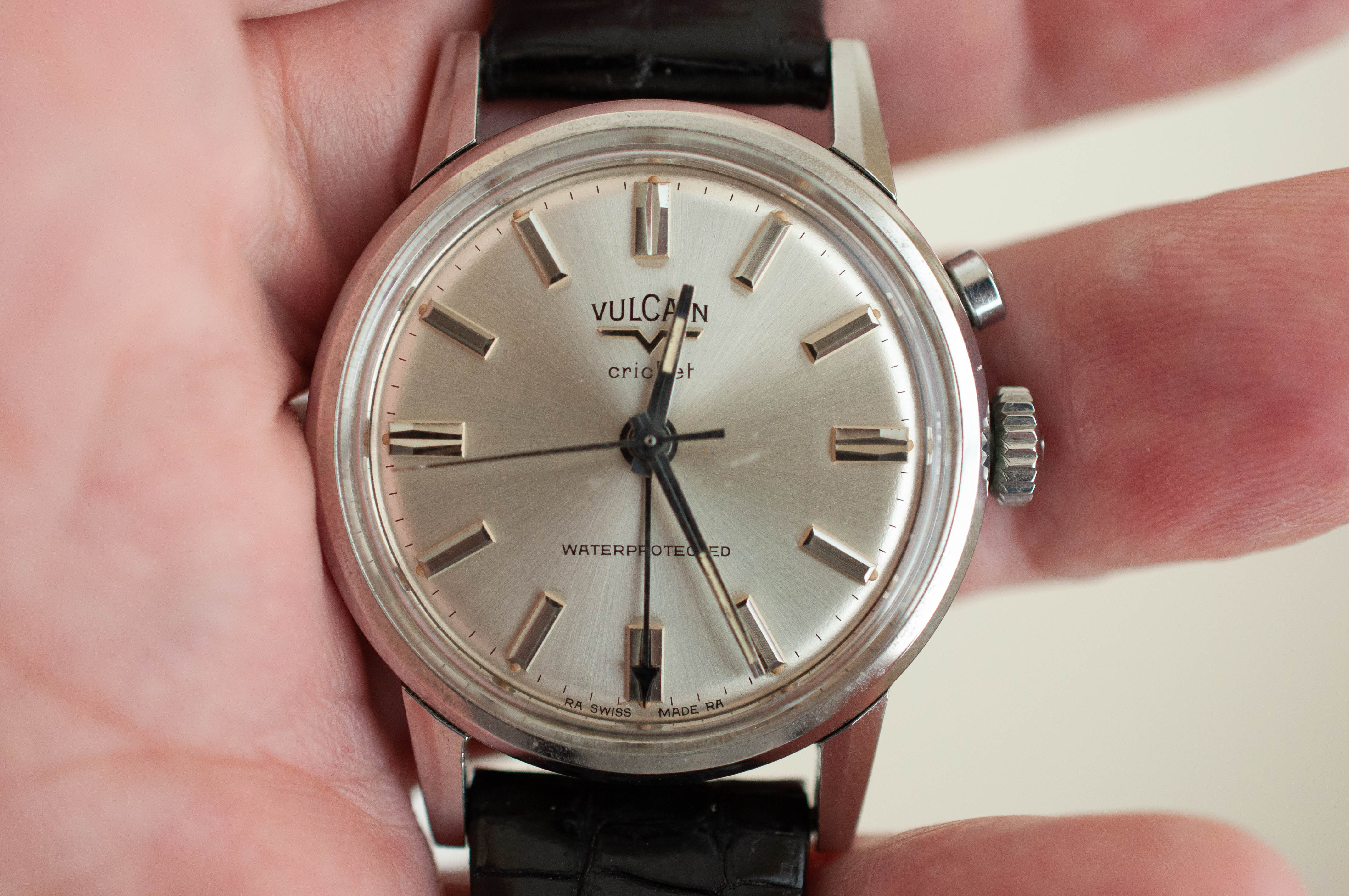

I have a Vulcain Cricket model S2329a from around 1963 or so if my research finding is valid. There is the unusual dial mark pictured below. Does it signify radium? If so why didn't more dials of the period have this marking. Again, if my research is valid radium could have been used up to 1968 but it's only on Vulcain watches that I've seen this marking.

It would normally indicate radium. 1963 would have been right around the end of radium use.
16,307
44,981

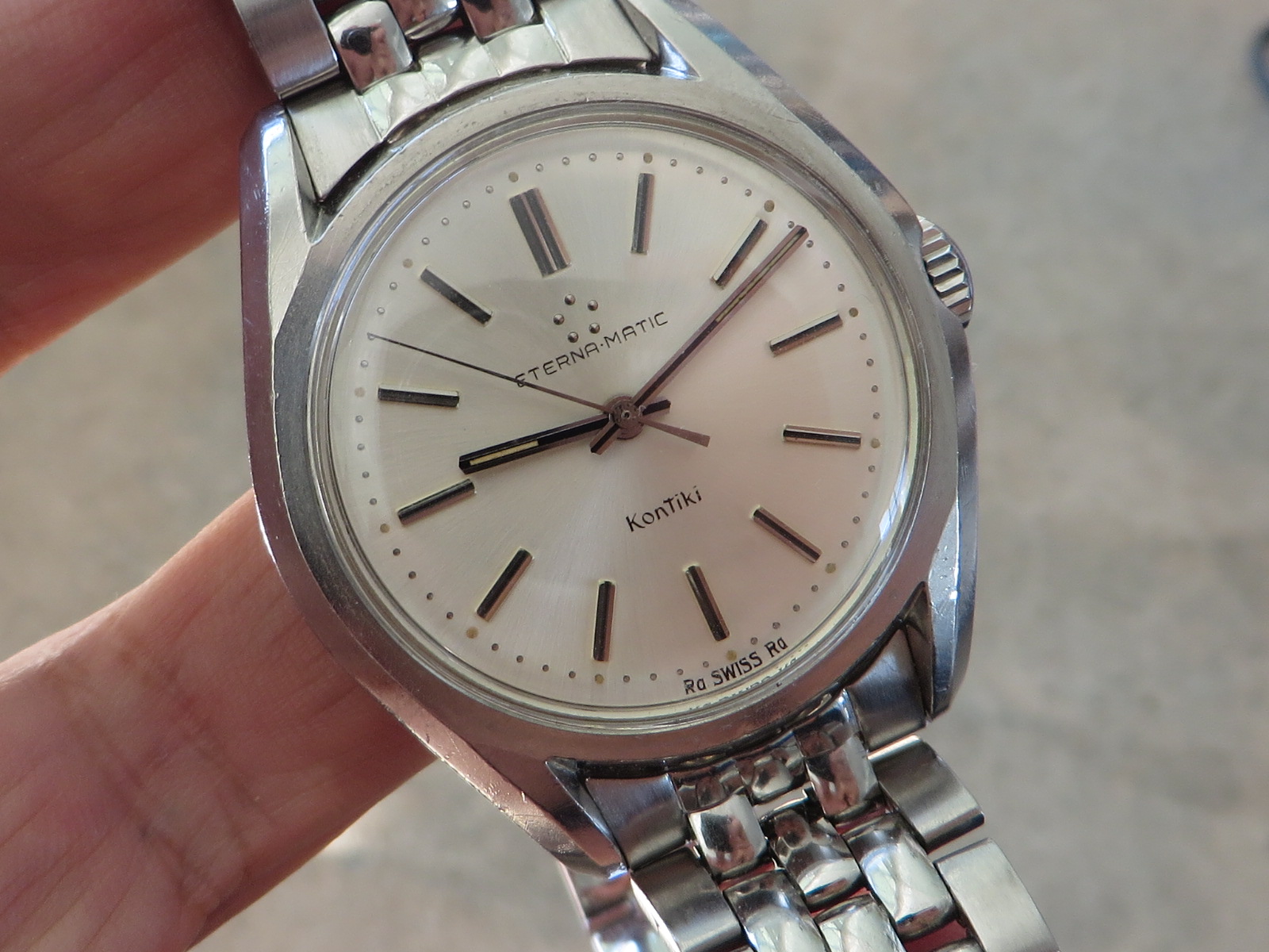

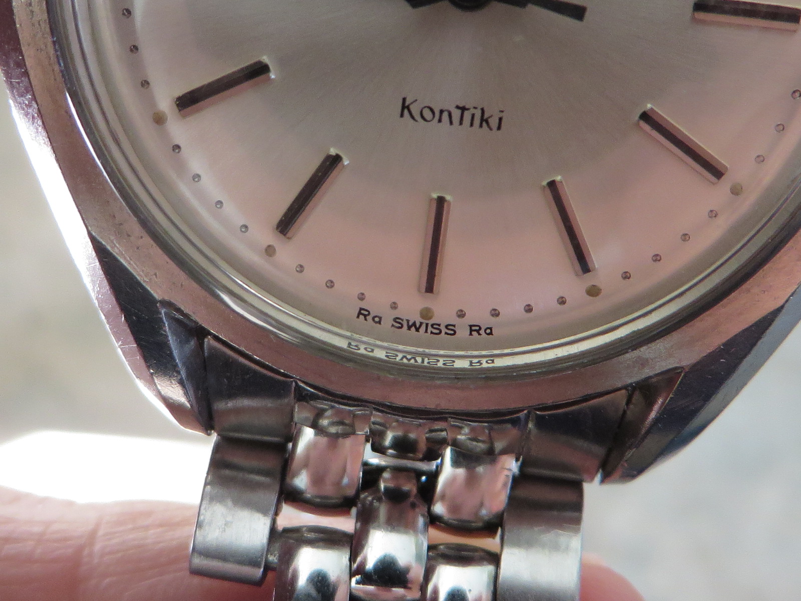

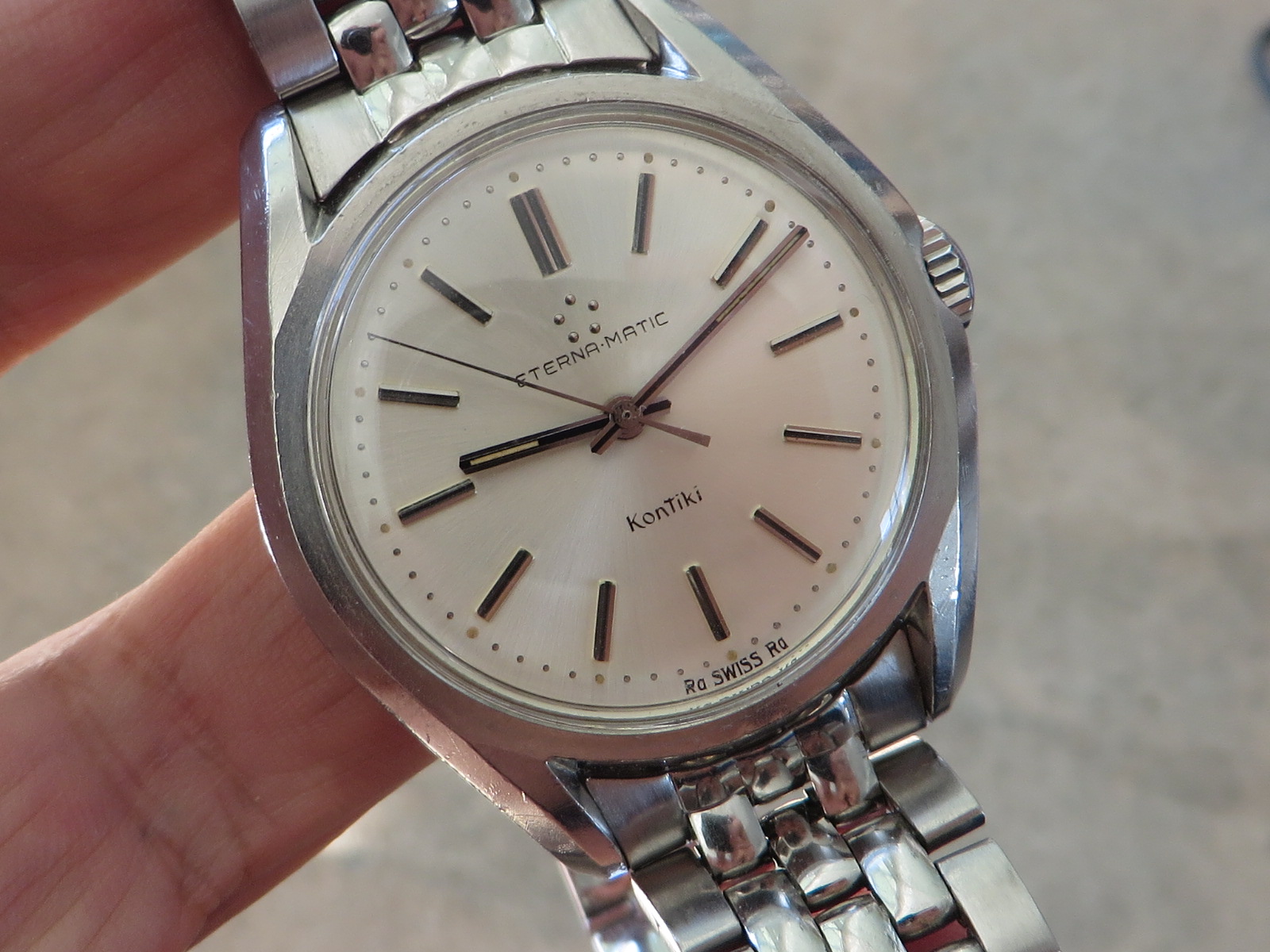

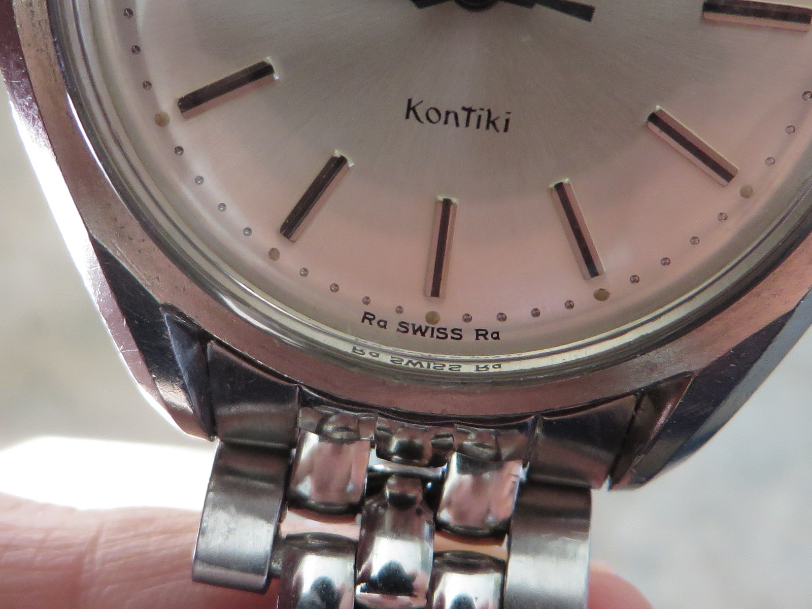

This has always been what I have read but I have a few watches marked RA that are late 60’s according to catalogs so it has puzzled me if there was a firm and hard cutoff.
Prior to the ‘63 Tritium push across the industry, they usually weren’t market at all as there was radium and that’s about it. I wonder if putting the RA on the dial was post ‘63 for the few years is may have continued being used to denote the difference between radium and Tritium lumed watches
