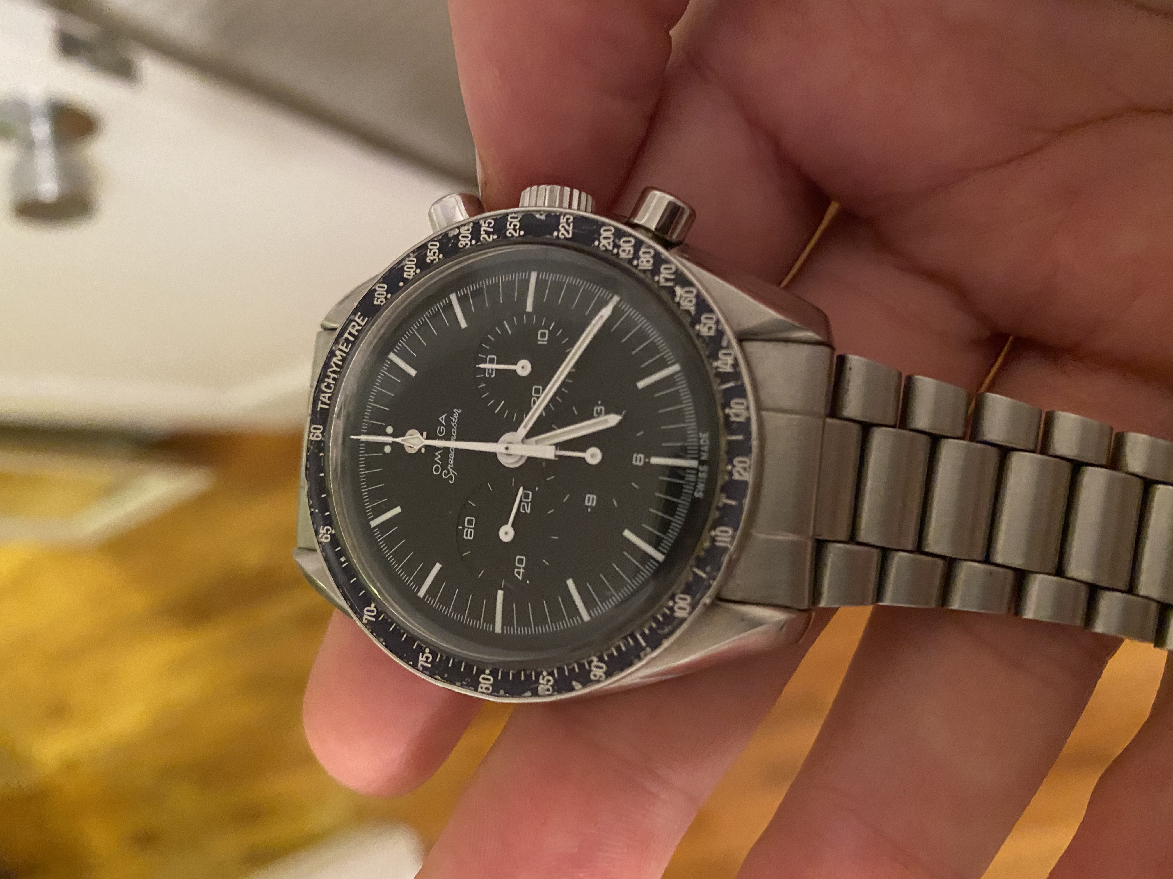

Need help identifying this Omega
7
3
Speedmaster Pro with the wrong dial?
no clue. my father left it to me before he passed. i know he had it serviced about 5 years ago but i am clueless. i just love the watch.

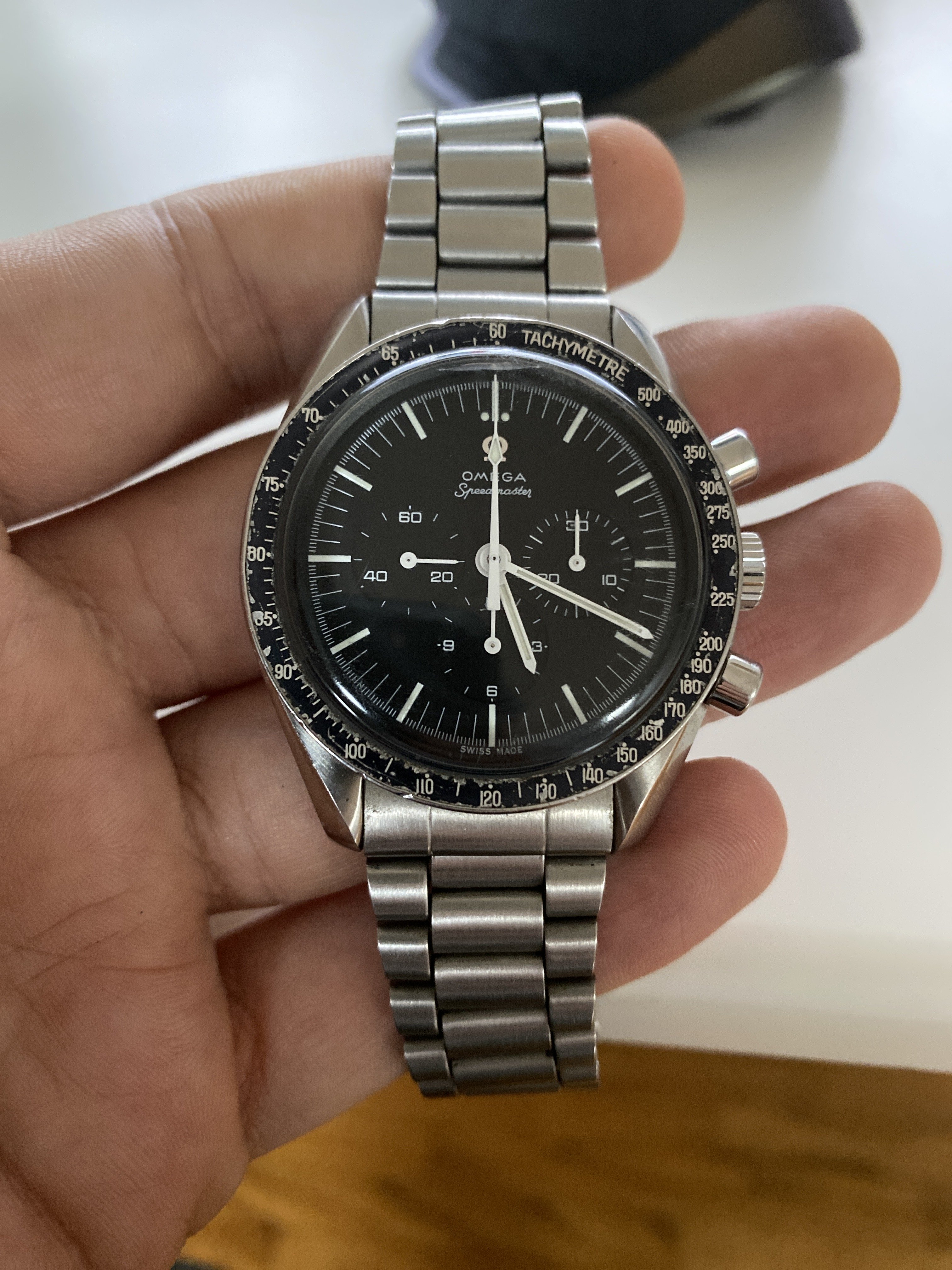

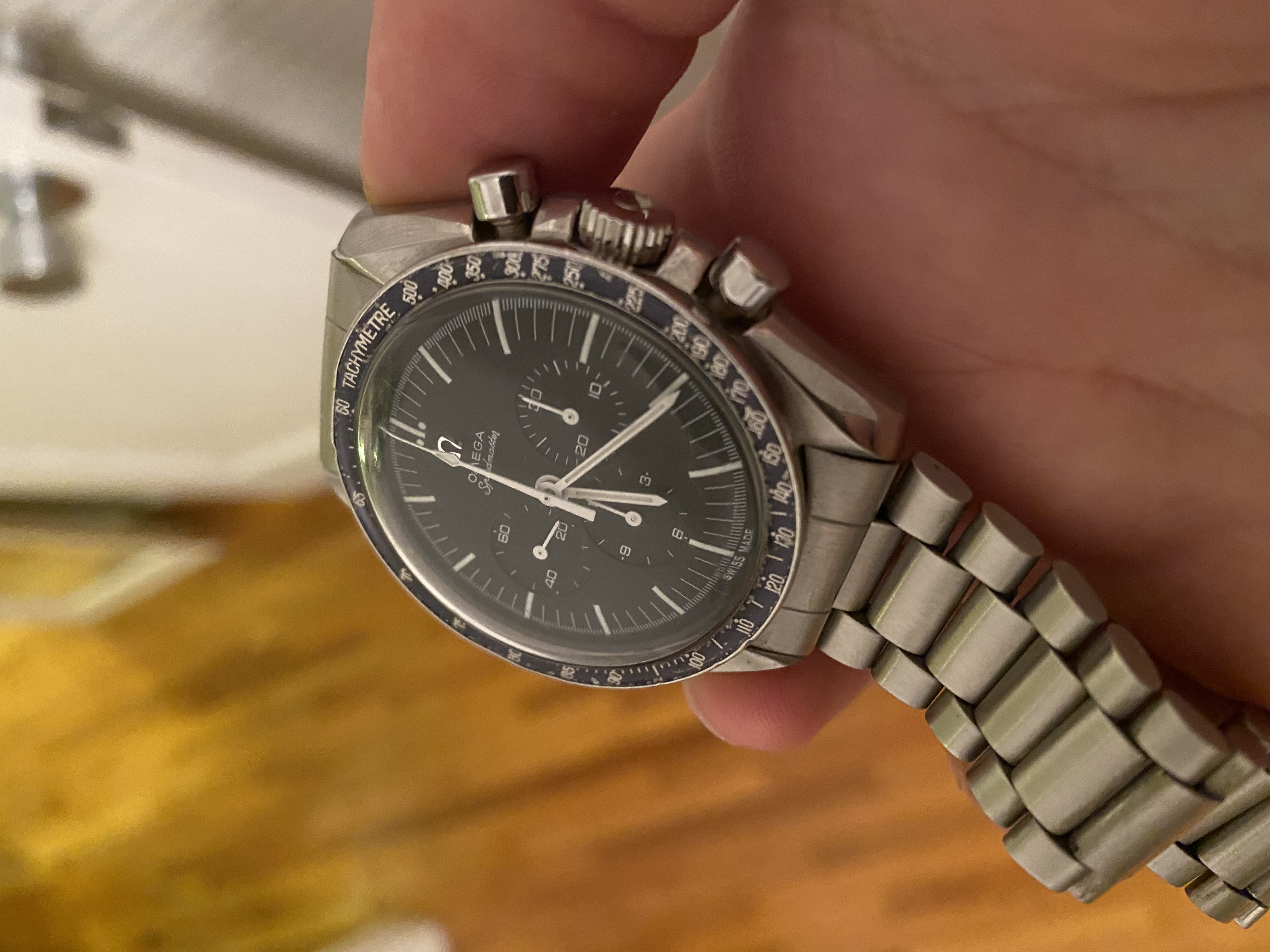

somebody mentioned to me no “T” at 6 o clock so it’s pre professional. if he brought it to get serviced, would Omega mix and match parts from different models?
699
701

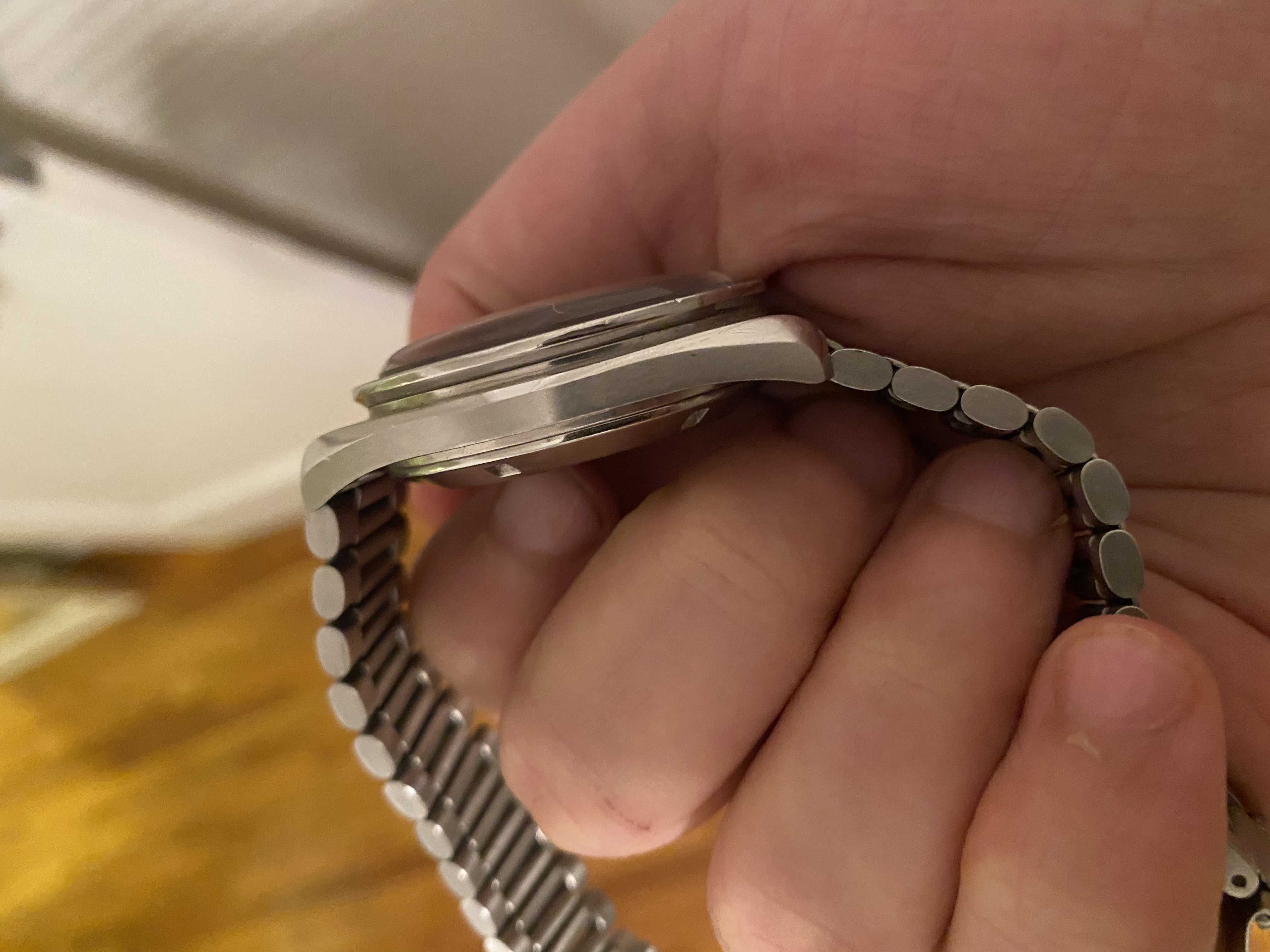

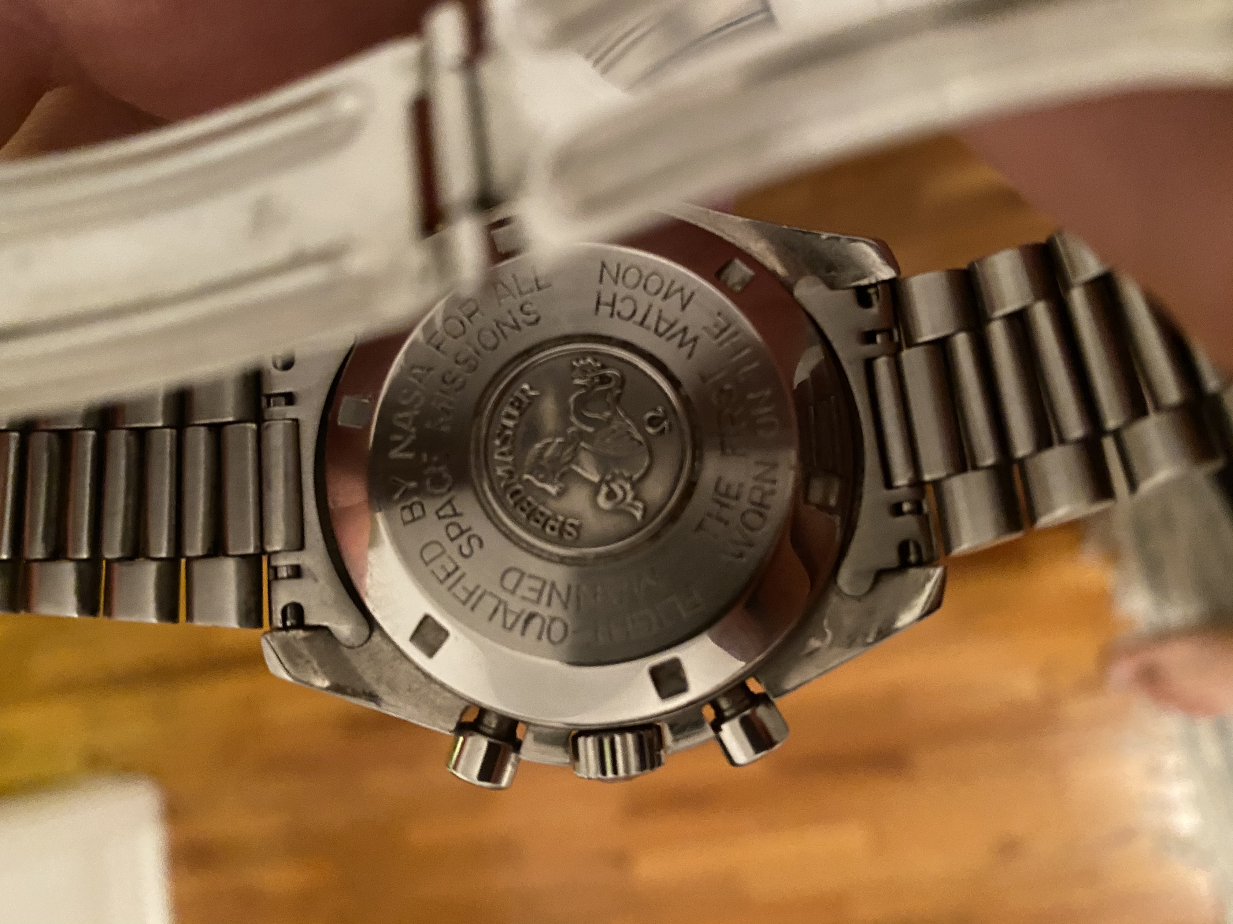

The case looks like it's a 145-022 ref#. You'll need to open the back up to determine if it's a -71,- 74, -76, or -78
As Dan S mentioned, the dial does not appear to be original to the case.
10,804
16,814
That might be the SL dial from the 1999 Replica* model. Looks like a 70s watch with replaced parts.
*this does not mean fake, it was a badly named genuine model

any body know any good watch makers in Miami Florida, that i can take it to, to open the back? or should i just bring it to an Omega boutique?
699
701
To just get the case opened for a close up picture of the movement and caseback, the Omega Boutique should be fine.
Get a picture of the movement (preferably w/ the serial number in focus) and caseback, and then post em up here.
Don't let the OB guys talk you into a service until you post the shots up here to determine what you're working with and what your goals are for the watch.
