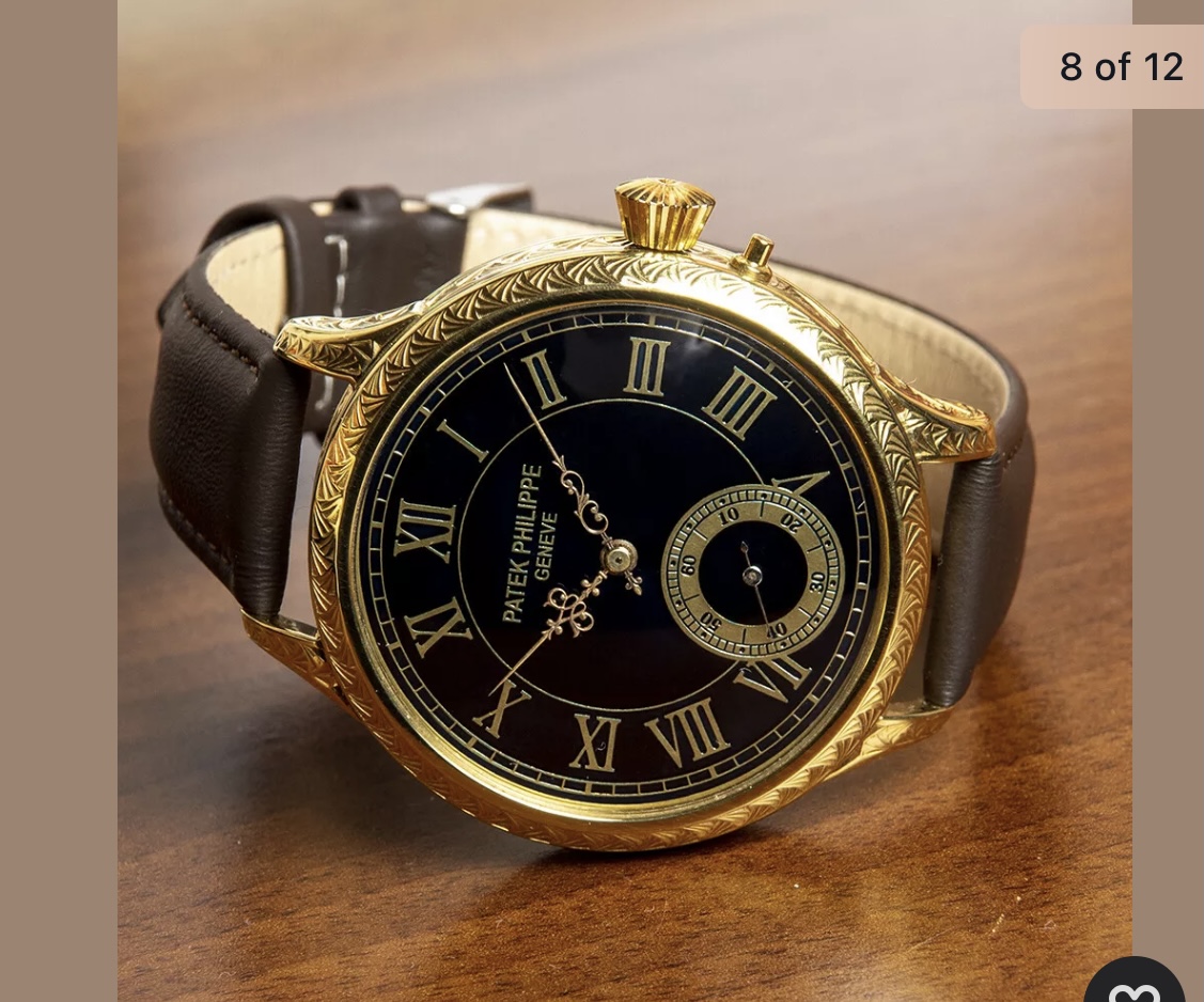

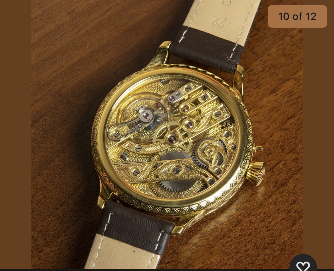

Good day to All! Could please someone advise about this watch from ebay? Understood that case is new, but what about the movement?
https://www.ebay.com/itm/Vintage-Wr...218562?hash=item265a1711c2:g:KQwAAOSwQTxgNWUv
Someone has taken an old pocket watch movement, skeletonized and engraved it, then out a recently made dial on it, and stuffed it in a recently made case. These are known as pocket watch conversions, or marriage watches (marrying an old movement to a new case). If anything was actually made by Patek, it would only be the movement.
Having serviced some of these in the past, the work done on them is usually pretty crude, and they sometimes come with major problems.
Thanks to All! Already found this movement - very far from Patek (old Le Coultre with new engraving on it) cheap fake. Also interesting who gave 2K for this))
