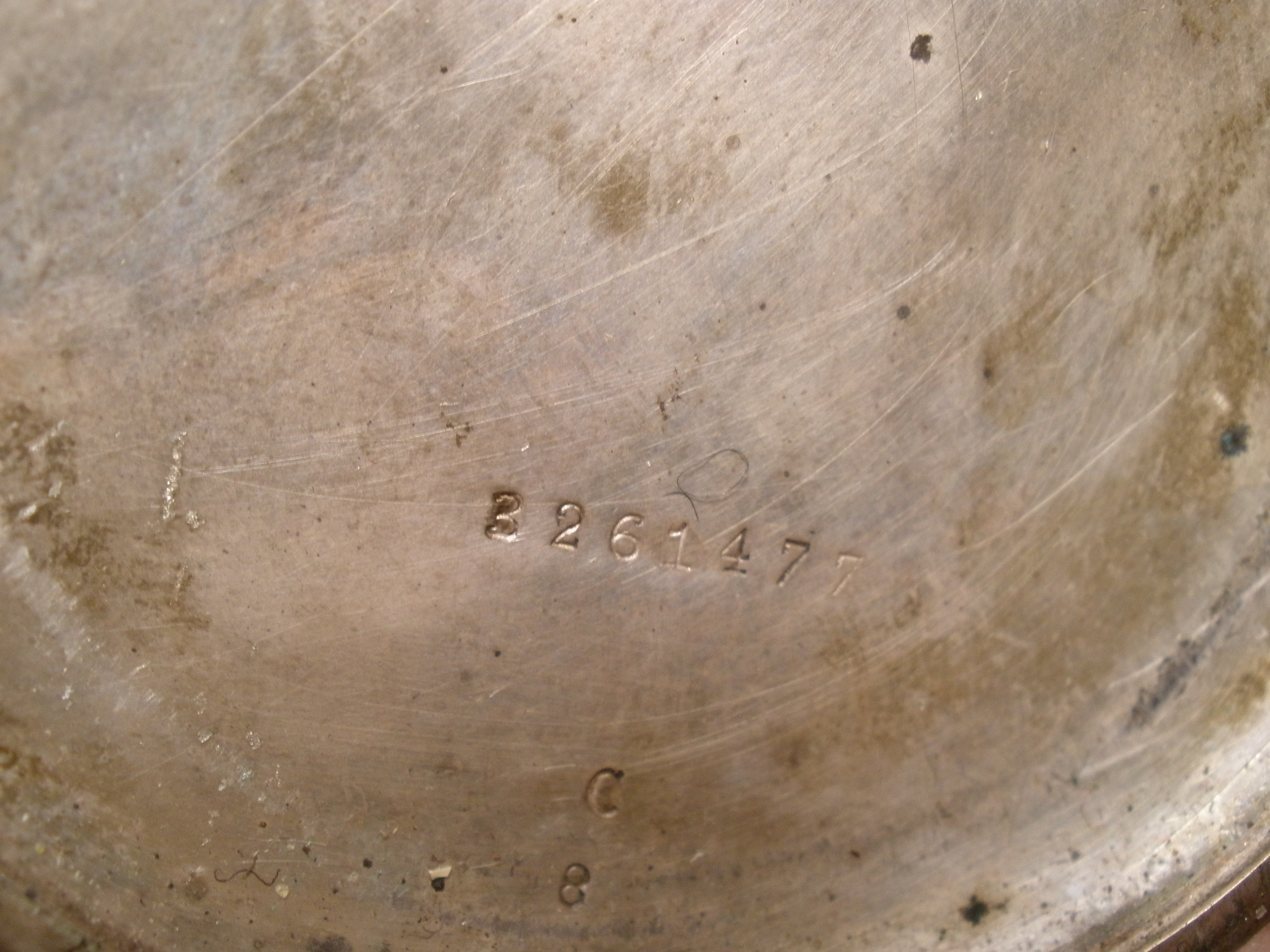

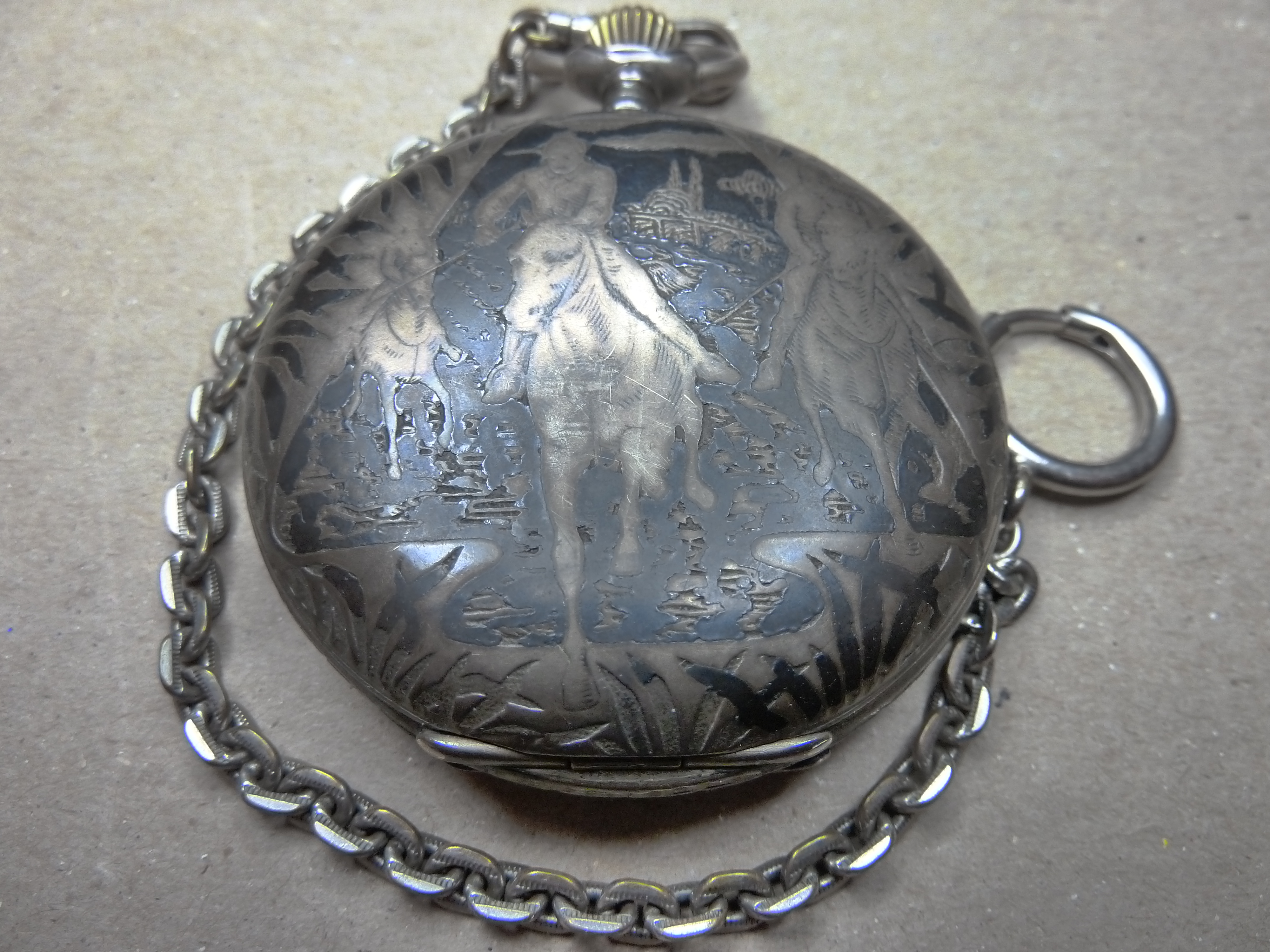

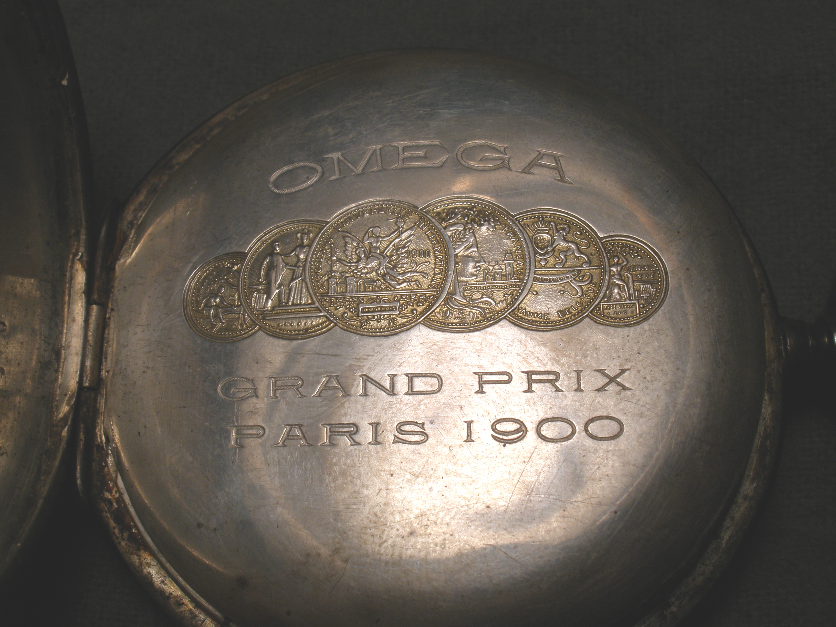

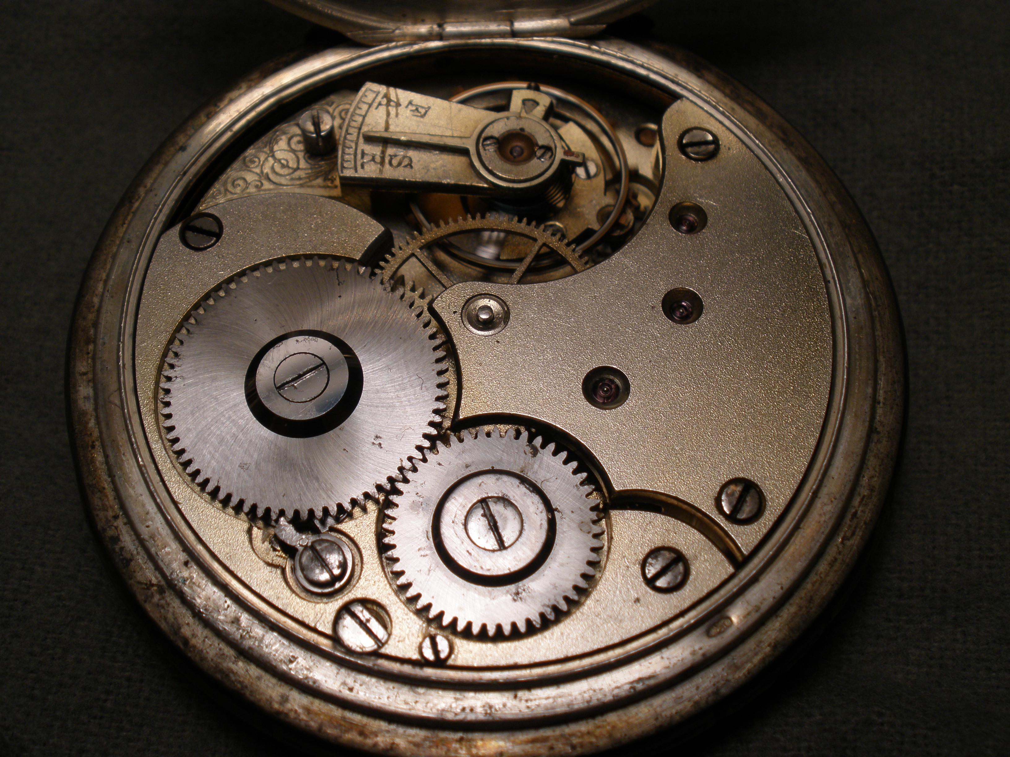

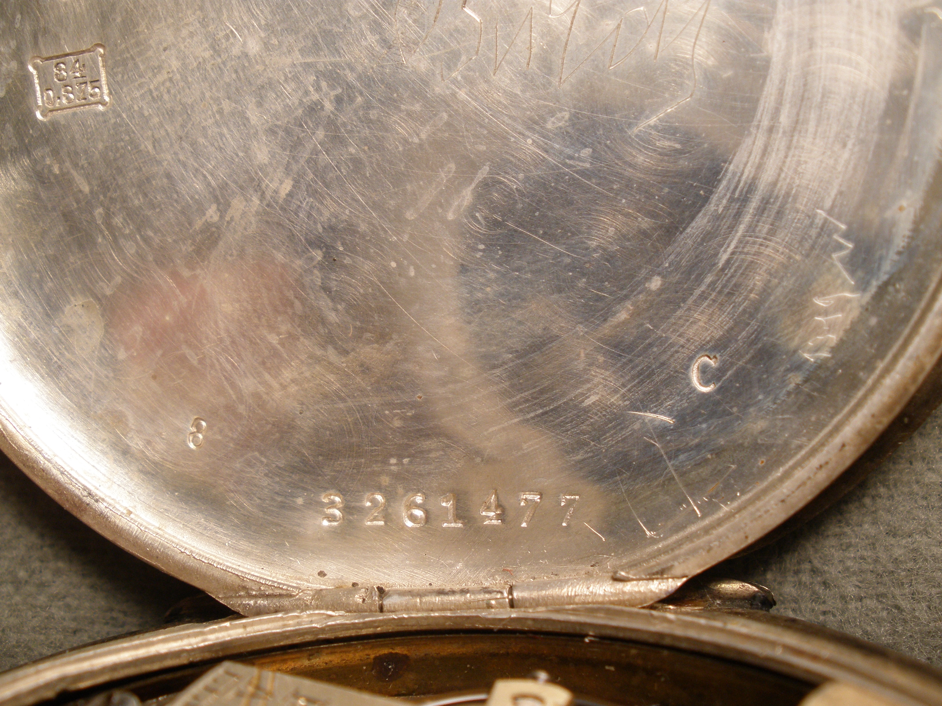

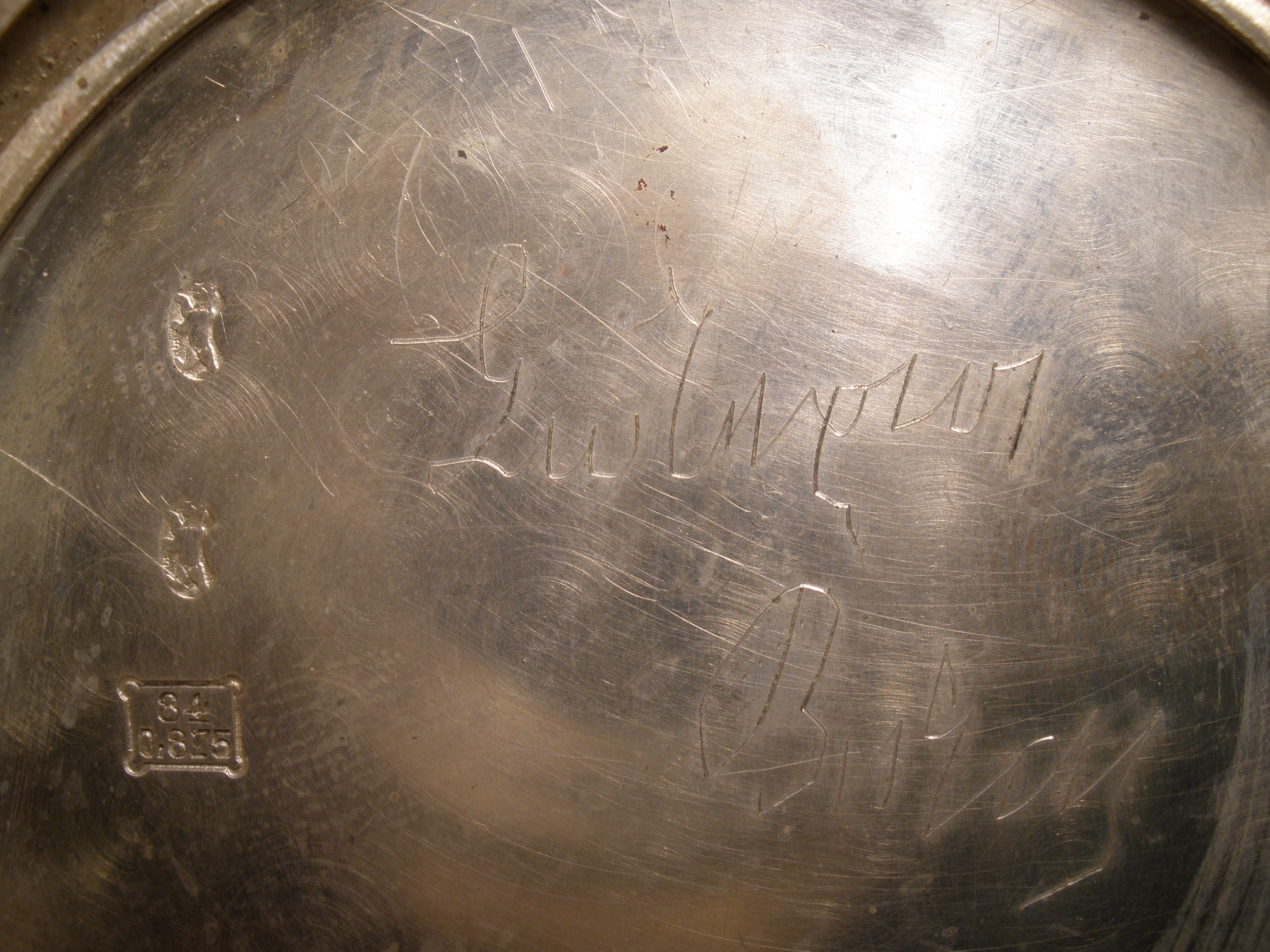

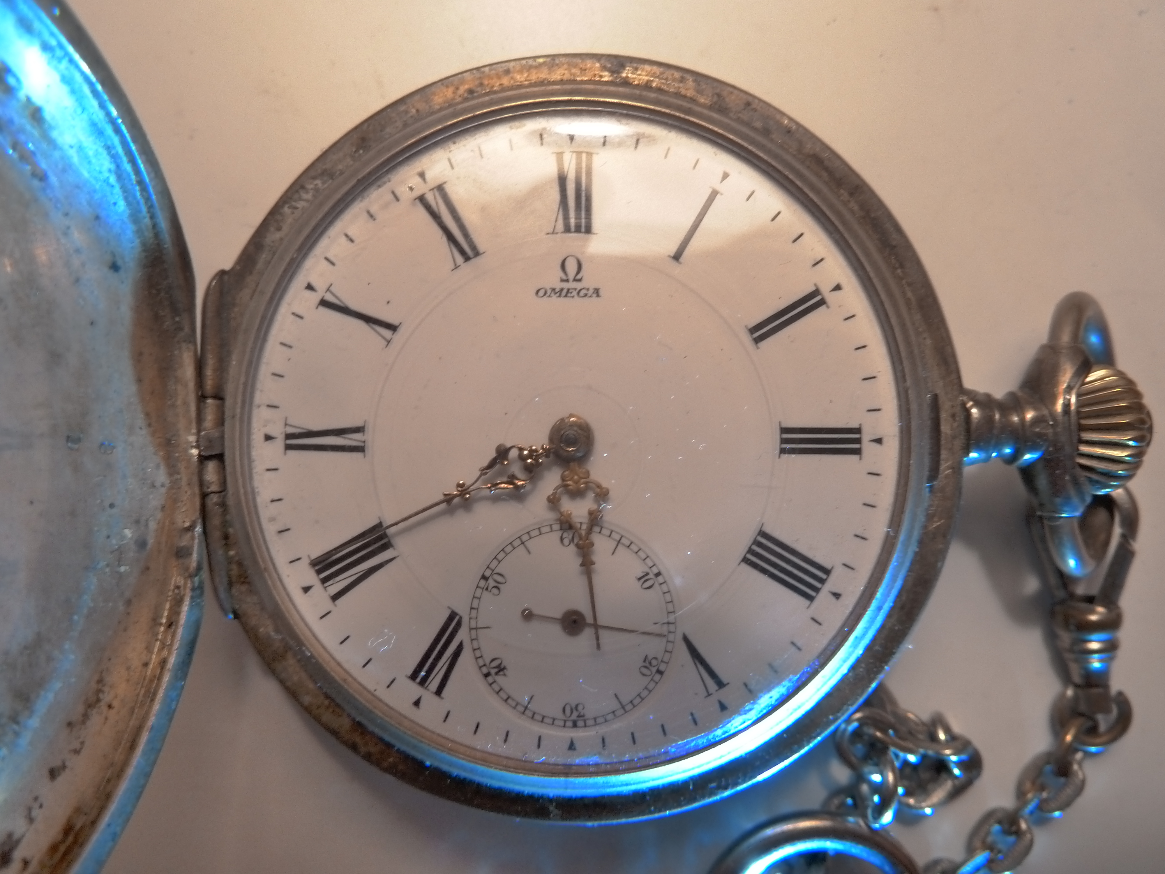

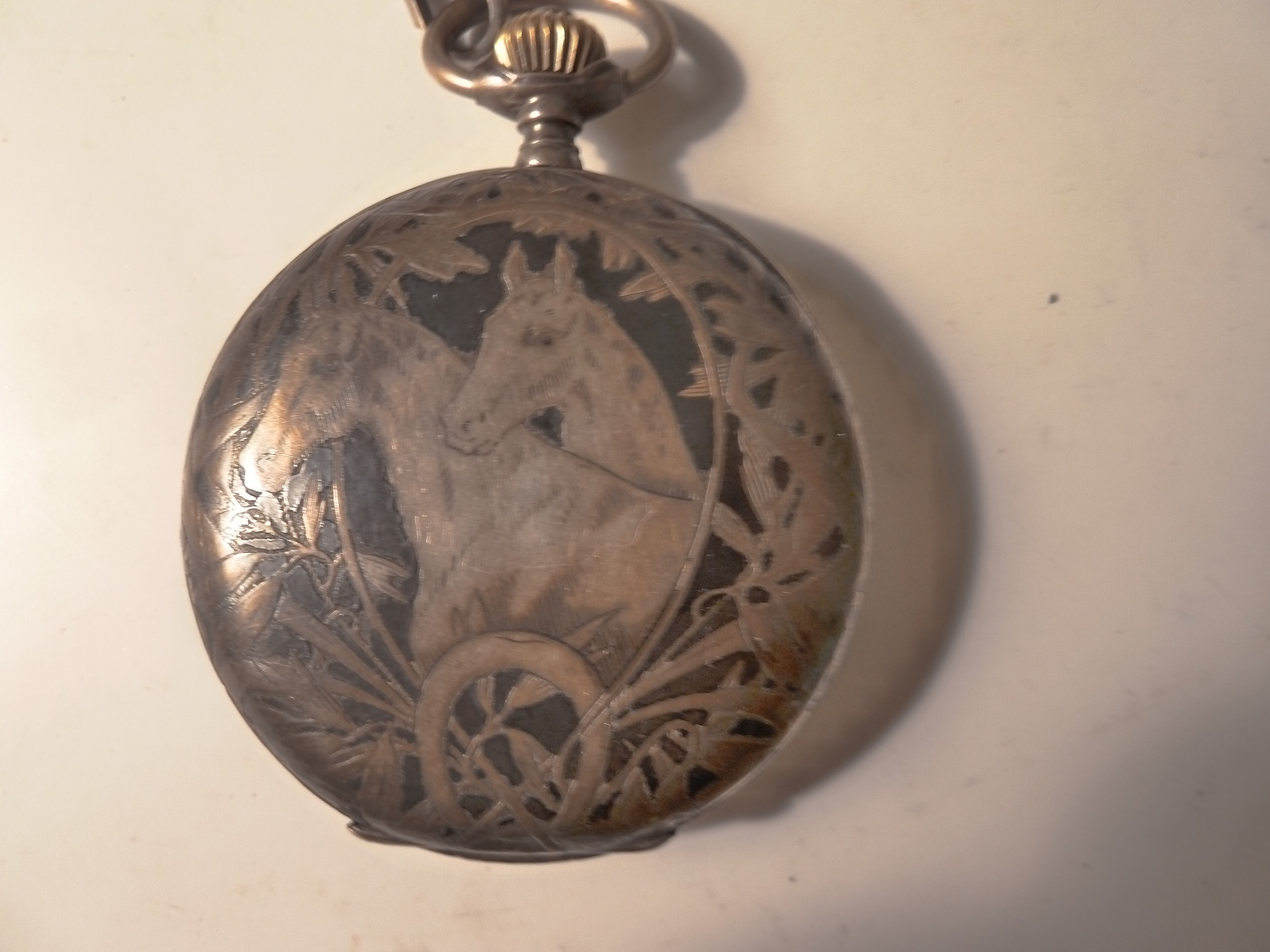

I have a ~1908 Hunter cased Omega pocket watch that I've had for many years. Every once in a while I've tried to find another like it on the web with no success. I'm curious what the decorative case treatment is called. Both members I mentioned suggested that I add some photos to my inquiry. So, I shall.
Thanks 1340920 1340929[/ATTACH]

You will notice the mark .875 inside the covers of your watch. Along with that is the symbol of a standing bear, facing left. The .875 means the case is made of silver alloy which is 87.5% pure. The standing bear is the symbol applied by the Swiss marking system that indicates the standard of .800 fine, or .875 silver alloy. These symbols were approved by the Swiss in 1880, so that helps date your watch. Of course, the cuvette (inner cover) indicates a date after 1900. You have indicated 1908 as the year. There is a lot of information provided in this link that you should find interesting. The case style is called a “hunter” case.
https://www.vintagewatchstraps.com/swisshallmarks.php#875silver
In a previous reply to your original post, I mentioned that the case on your watch appears to have been die struck, leaving a prominent foreground, and a sunken background. This background has been decorated with niello which made of a mixture of elements, the case components then being fired in a kiln at about 1000° F for about an hour, to cause the elements to melt and flow. This results in a metallic looking decoration. If you type niello in a search engine, you can find out more about it.
The mechanism appears to be a 15-jewel, jewelled lever, stem wind, stem set, standard Omega caliber. Nice, but not high grade.
The dial appears to be in fine condition. Considering the watch is close to 110 years old, you might wonder how the dial looks so good. It is vitreous enamel…..basically, glass. Lasts forever, provided careless handling doesn’t damage it. The fancy hands have survived. That is unusual, as they are delicate.
