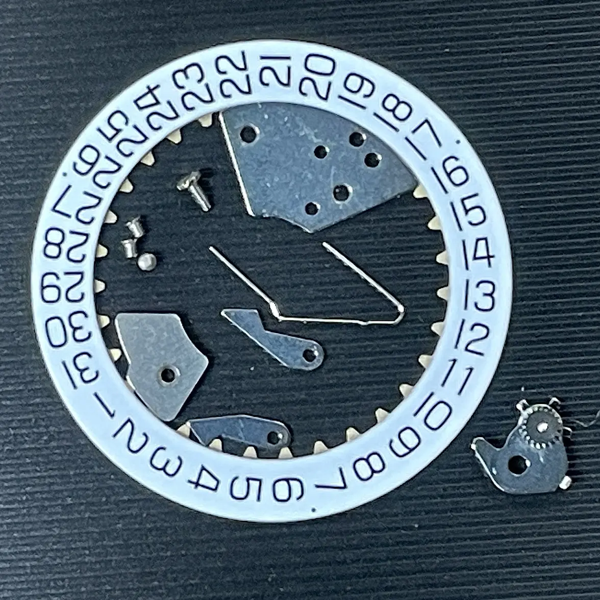

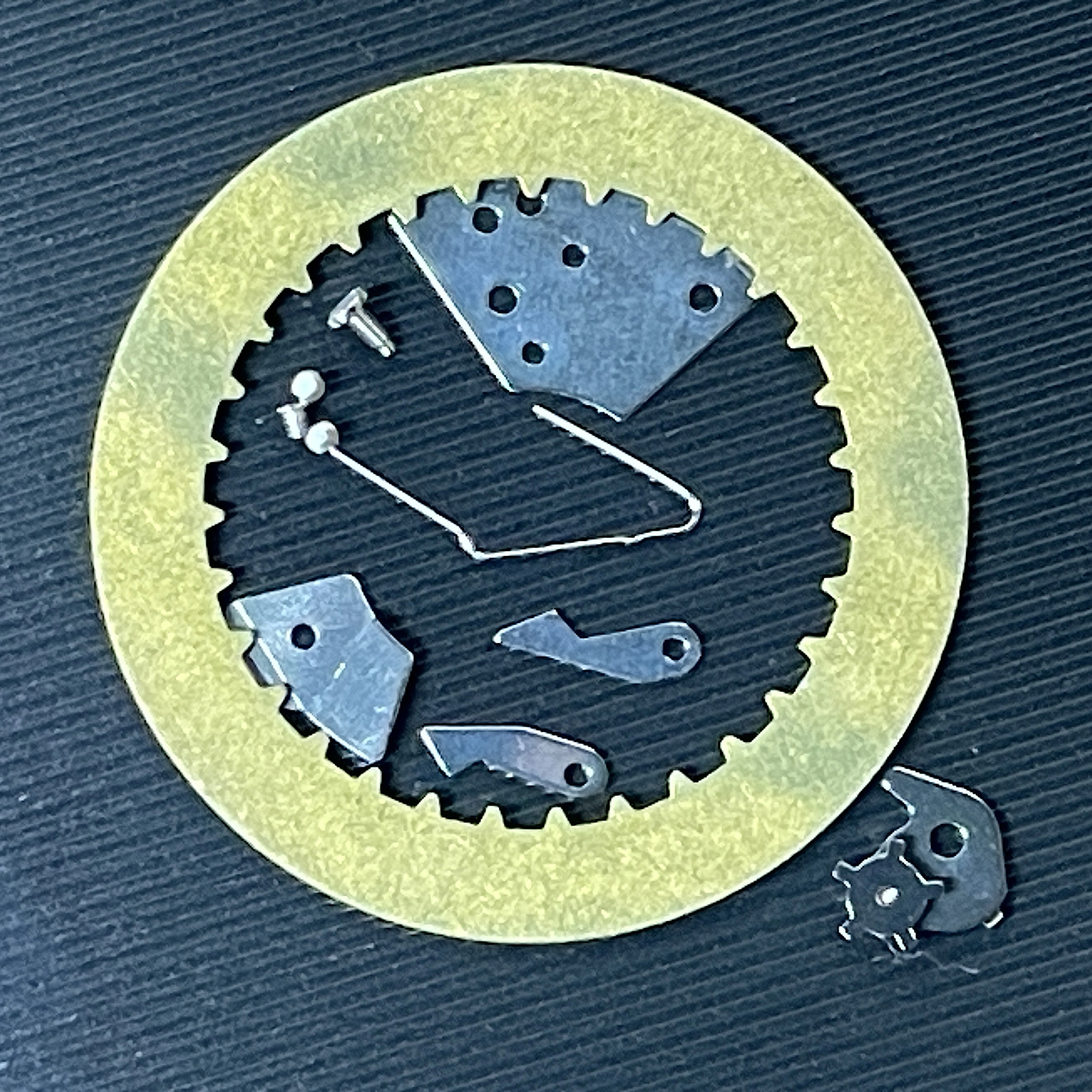

Posts 18,147 Likes 37,878 JimInOz ·May 3, 2026·Melbourne Australia I found a small container with these parts in it. I can't for the life of me remember what they came from. Possibly using a day date caliber for a plain time only conversion? Got me stumped. Does anyone recognise these parts?
Posts 427 Likes 821 TasMike ·May 4, 2026 Google image search: https://gleave.london/date-jumper-maintaining-plate-eta-7750-2595/
Posts 1,618 Likes 3,322 Ron_W ·May 4, 2026 The font reminds me of an IWC and they used val 7750. So following TAs` suggestion you can check pics on Ebay for listed 7750 and maybe see a match ?

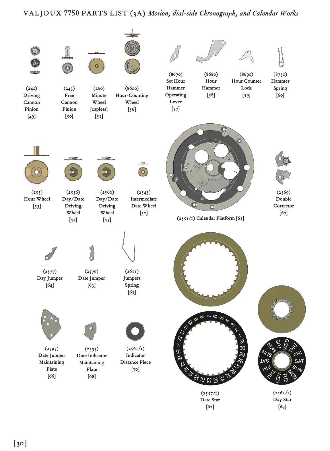

Posts 18,147 Likes 37,878 JimInOz ·May 4, 2026·Melbourne Australia I tried that but it just showed me hundreds of items. Did you just search by the date ring plate? Thanks a lot Mike and Ron. Here it is in my manual.
Posts 1,618 Likes 3,322 Ron_W ·May 4, 2026 JimInOz Did you just search by the date ring plate? I used the broader "val 7750 date ring " as search term and checked for pics showing the date ring side.
Posts 427 Likes 821 TasMike ·May 5, 2026 JimInOz Did you just search by the date ring plate? I first searched for the date ring with the plate with no success, so I cropped out the ring and just searched using the plate and that worked.
