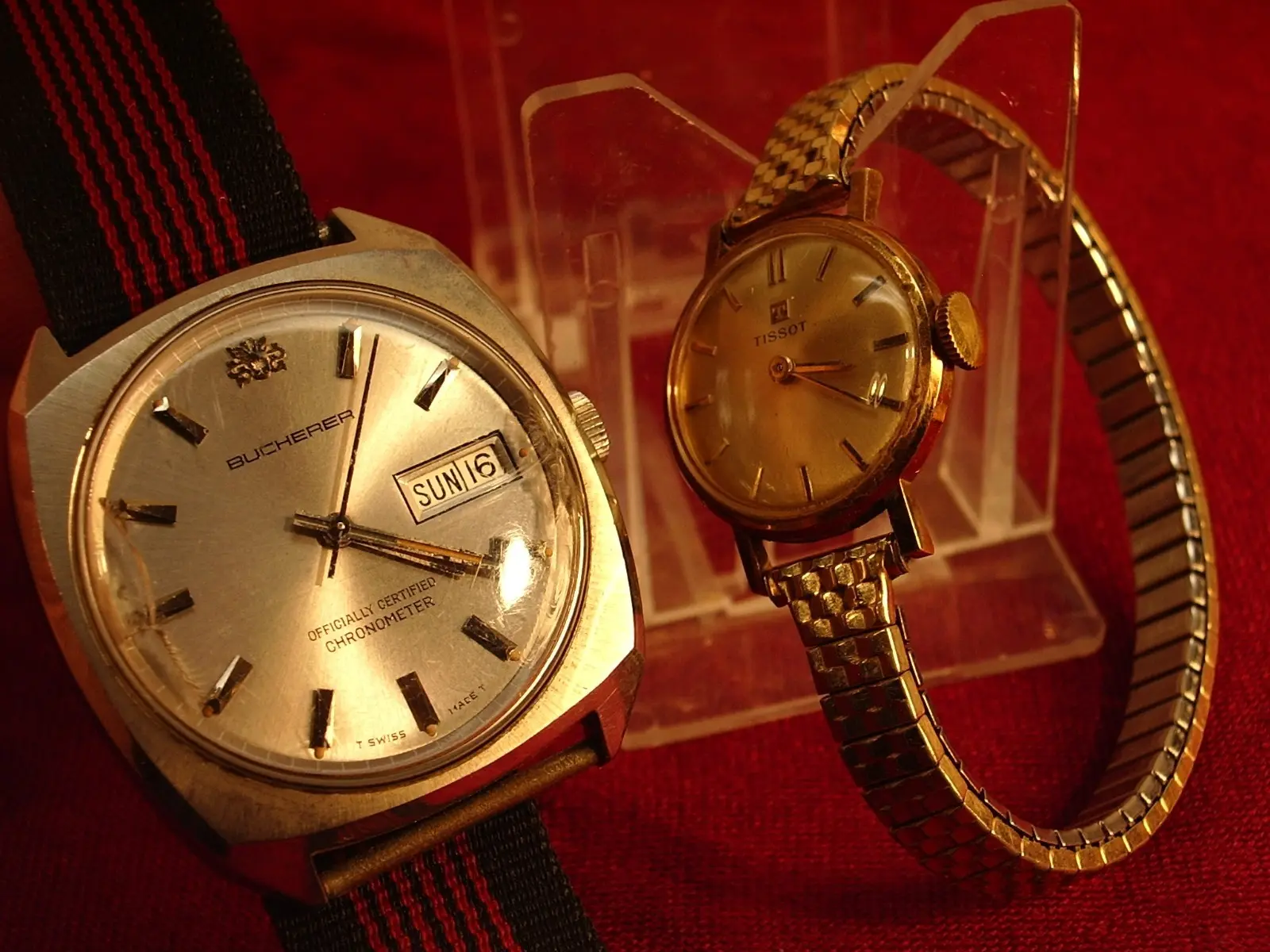

As some know, I've been working through my watchmaker's journey, and am constantly on the lookout on ebay to pick up watches that look fun to work on! Along the way, I bid on a pair of watches in 1 bid:

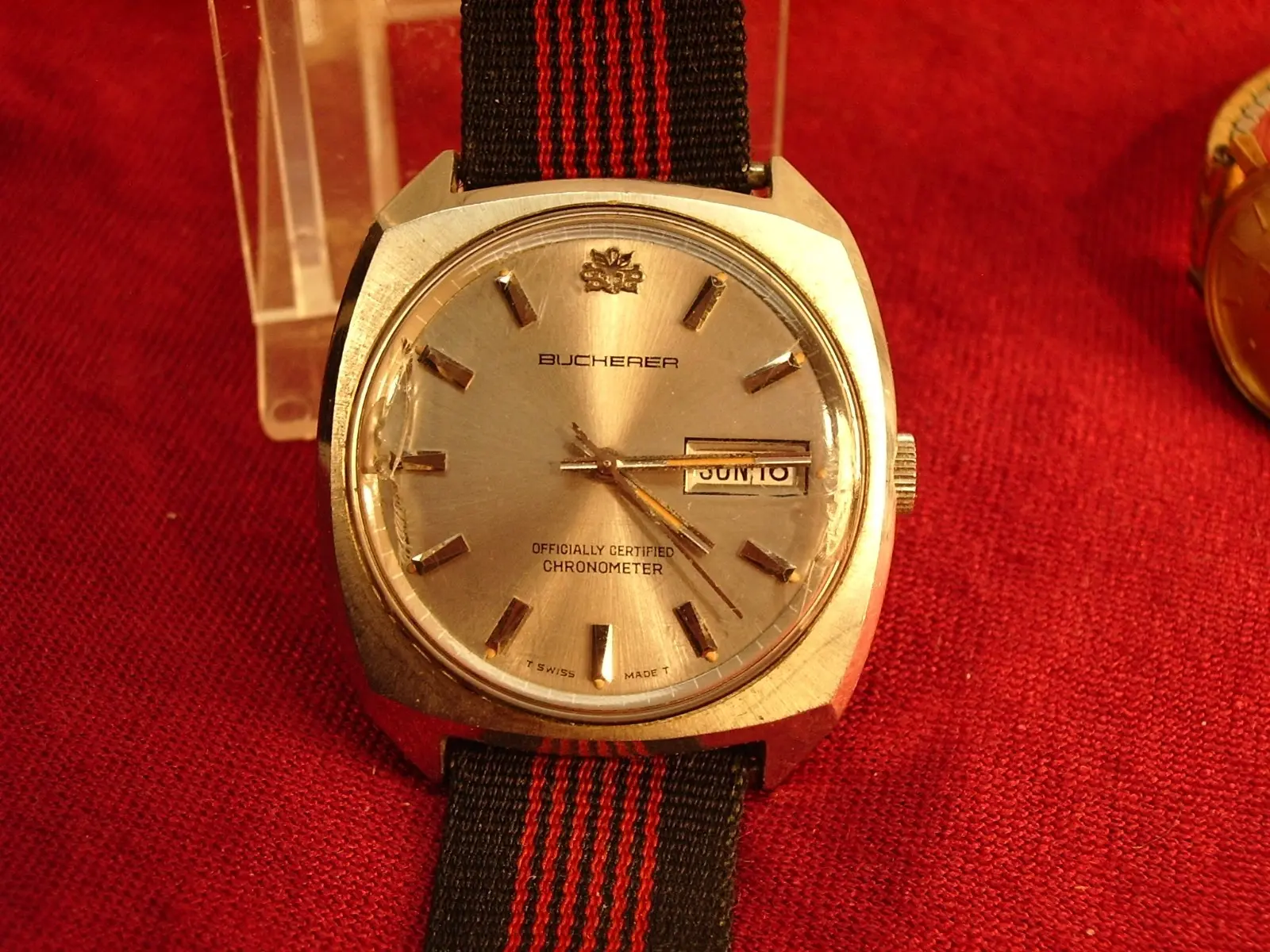

Looking at those, I was pretty interested in the Boucherer (stainless looking case, the red background makes it look gold). I love a good ETA movement and strongly suspected that is what it was, though there were no better pictures. SO, I bid, and had very little competition, so ended up with $102 shipped!
Last night, I got them home and started to take a look and do my initial 'triage'. Interestingly, my wife who doesn't really want to wear watches, mentioned that she'd actually be willing to wear the Tissot once I get it running! She's never really showed interest in watches before, so I figured this would be a win, for the watch of the pair I had no interest in.

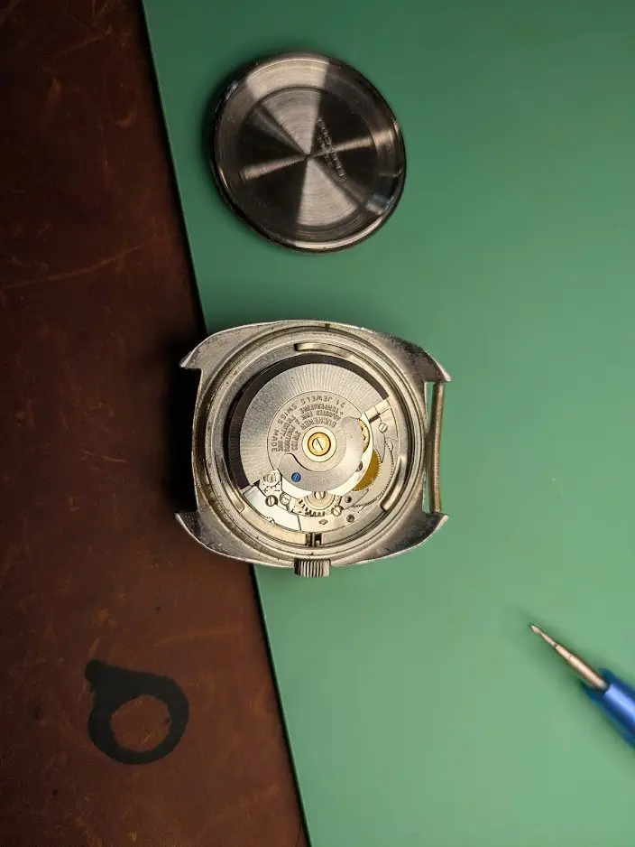

Now that the case back is off, I had my suspicions confirmed, an ETA 2728, which is exactly what I was hoping for, a good quality ETA movement in need of somehelp.

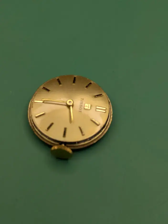

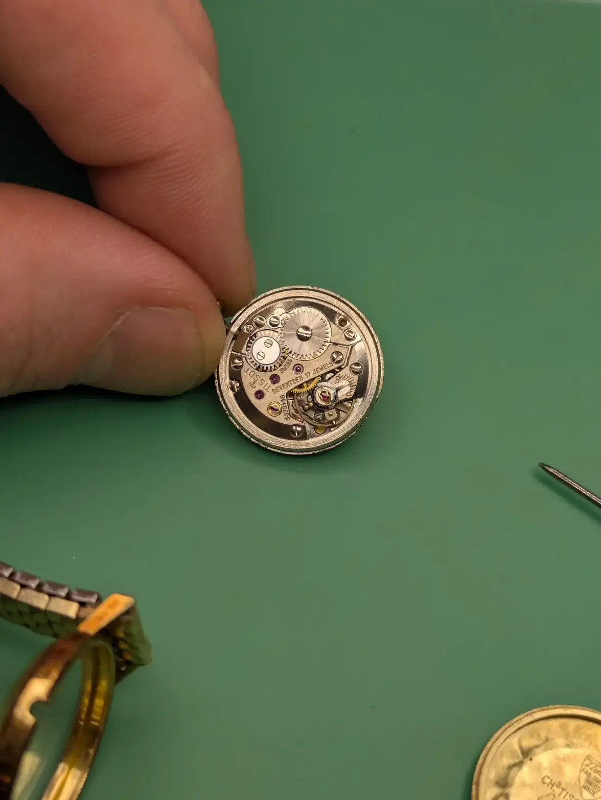

THEN, I went to take a look at the Tissot. It is ticking, but very poor looking on the time grapher. It ended up coming out case back + movement:

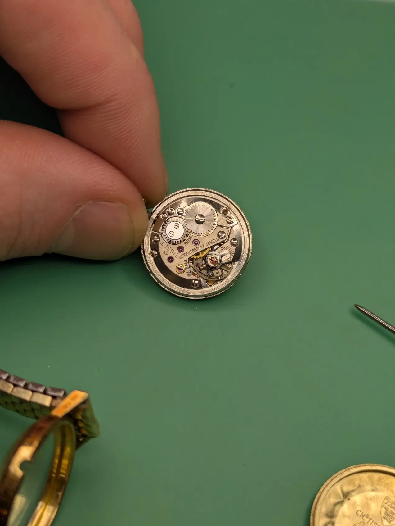

The movement itself was VERY stuck and required some prying to get out of the case back. Inside, a LOVELY looking Tissot 709 that will be a challenge and a half!

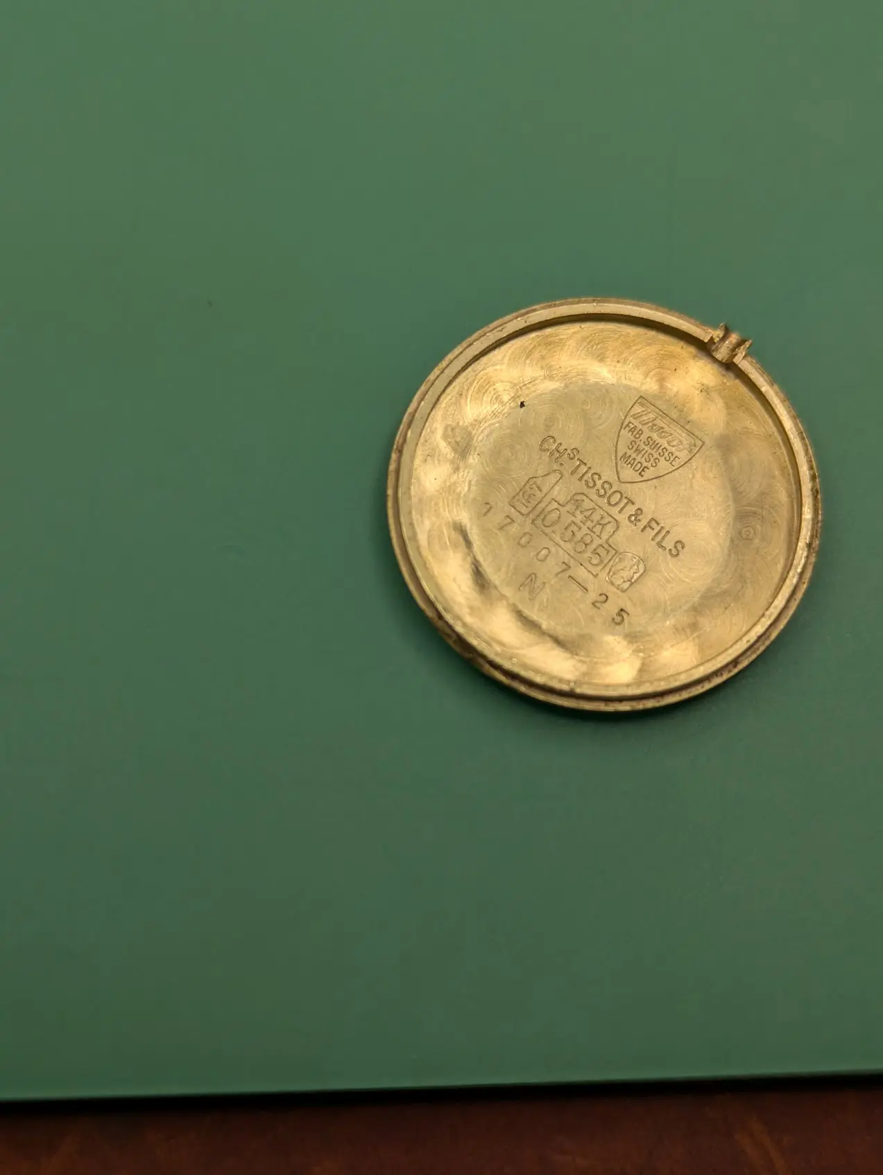

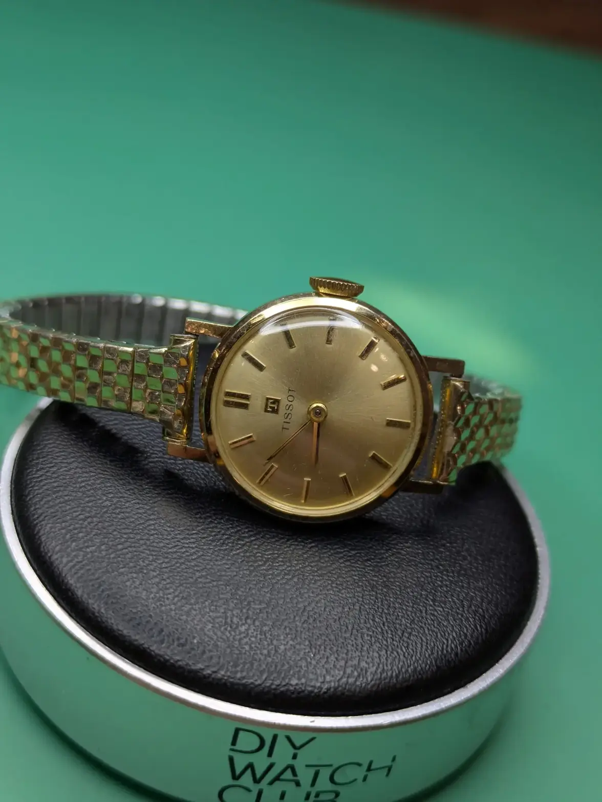

BUT <and here's the luck!> I then went to 'clean up' and put the watch + case into my storage for future projects, and noticed this!
What I assumed was a gold-filled case, is actually 14k! The band is a cheap stretch bracelet that IS plated, but it looks like the watch itself is gold! Again, a watch that had my wife not showed interest in, would have just gone to the 'spare watches/parts' box, and I had no interest in when bidding on.
That movement is tiny, I wish you luck with it if you decide to service it.
Your nice surprise was made by Carnal & Cie. SA, La Chaux-de-Fonds.
I'm going to have to service it, the trace on this is a snowstorm. I'm not familiar with that manufacturer, is that particularly special?

Interesting pieces. I was always impressed that Bucherer could market a Certified Chronometer for about $25-$30 when sold. They sold tons of these kinds of watches to tourists who went into their stores and wanted a Swiss watch as a souvenir of their trip, the Luzern store was set up to cater to the tourists. Rolex on the bottom floor, the Bucherer and other lower grade watches on the second floor, Swiss Army knives, embroidery, and other trinkets on the top floor. Something for everyone. Now, it's all expensive watches and some jewelry, no bargains anymore at Bucherer.
Just one of the many case makers used by the various watch companies at the time.
Most of them have been gobbled up by entities like Swatch in order to have complete control of production.

I spent some time on the bench with this guy over the last few days. The movement was kinda filthy with some corrosion, but the cleaning machine went to work! I weighed the case + crystal, and it is ~5g (my scale is in whole grams only). I measured a different crystal (that is bigger) that was barely less than 1 gram, so value of the case is at best ~$400, still a great deal 😀
Unfortunately, one of the incabloc springs broke in the cleaning machine, so I've got some on order from otto frei. BUT it probably means this won't be ready for christmas. Oh well!
