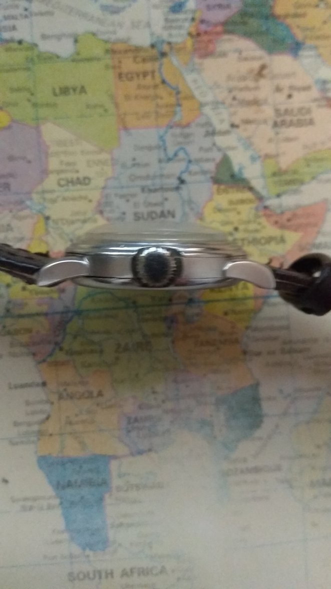

  2. Manu_de_atar Mar 15, 2018
    6
    7
    more pictures

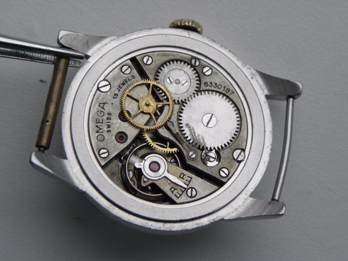

  3. Tire-comedon First Globemaster Mar 15, 2018
    1,314
    3,639
    It's a 23.4SC ref CK 650. Although it is presented as such in AJTT p.126, it isn't what Omega named 'Medicus' in the 30's, this name was only for the first 23.4SC model ref CK651, with square case.
    It is however an interesting an unusual model. Serial numbers date it from around 1939. Dial and hands seem original, even if it is difficult to juge on those pictures. The part that keeps the central second hand pinion in place (don't know the name in English) is not original.
    Mine (same dial, different but also original hour & minute hands, probably wrong second hand, right crown) says hello :
    [​IMG]

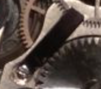

  4. Manu_de_atar Mar 15, 2018
    6
    7
    THX for the information, u mean this part, I have the same field, but I remember seeing another move with a very close serial ( + - 300) with the same piece that made me doubt it. I'm gonna go look for it.
    Tire-comedon likes this.
  5. JimInOz Melbourne Australia Mar 15, 2018
    15,492
    32,382
    Called a "Ressort friction", or in English, Sweep second pinion spring (friction spring).
    The OPs looks to be a hand made replacement, it should be much finer in form.

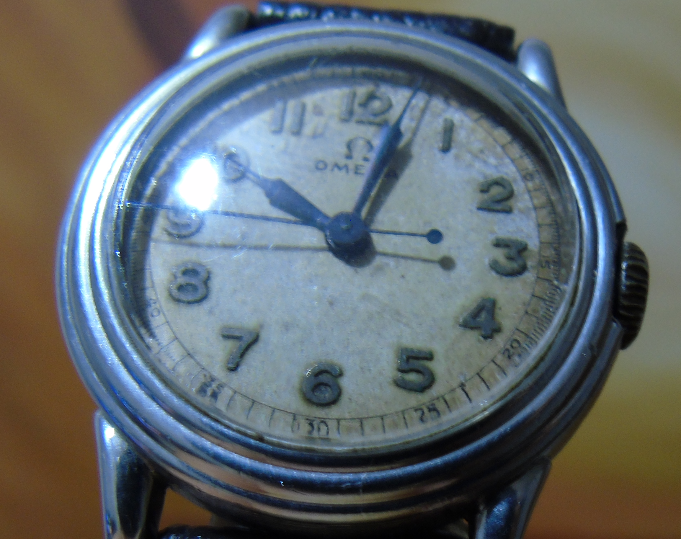

  6. Manu_de_atar Mar 15, 2018
    6
    7
    another picture of the hands
    ConElPueblo and Tire-comedon like this.
  7. Tire-comedon First Globemaster Mar 16, 2018
    1,314
    3,639
    I have no doubt on hands being original. I was talking about the dial. It looks fine but a it needs a clear picture of the dial and especially of the logo and Omega name to be more affirmative.
  8. Manu_de_atar Mar 18, 2018
    6
    7
    the dome has a few stripes between 11 and 12, and the dial has less patina between 1 and 3 and other imperfections, that should call your attention, but as the watch was used daily by my father and grandfather, we all know the evolution of the dial in the family over time so I am sure it is original and has not been replaced.

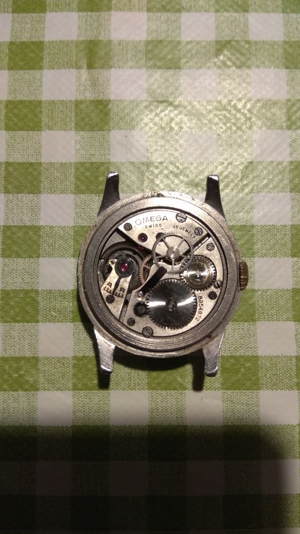

  9. Manu_de_atar Mar 18, 2018
    6
    7
    other one
    https://www.ebay.com/itm/Omega-very...tainless-Steel-watch-Circa-1937-/232172353706Purchases made through these links may earn this site a commission from the eBay Partner Network
