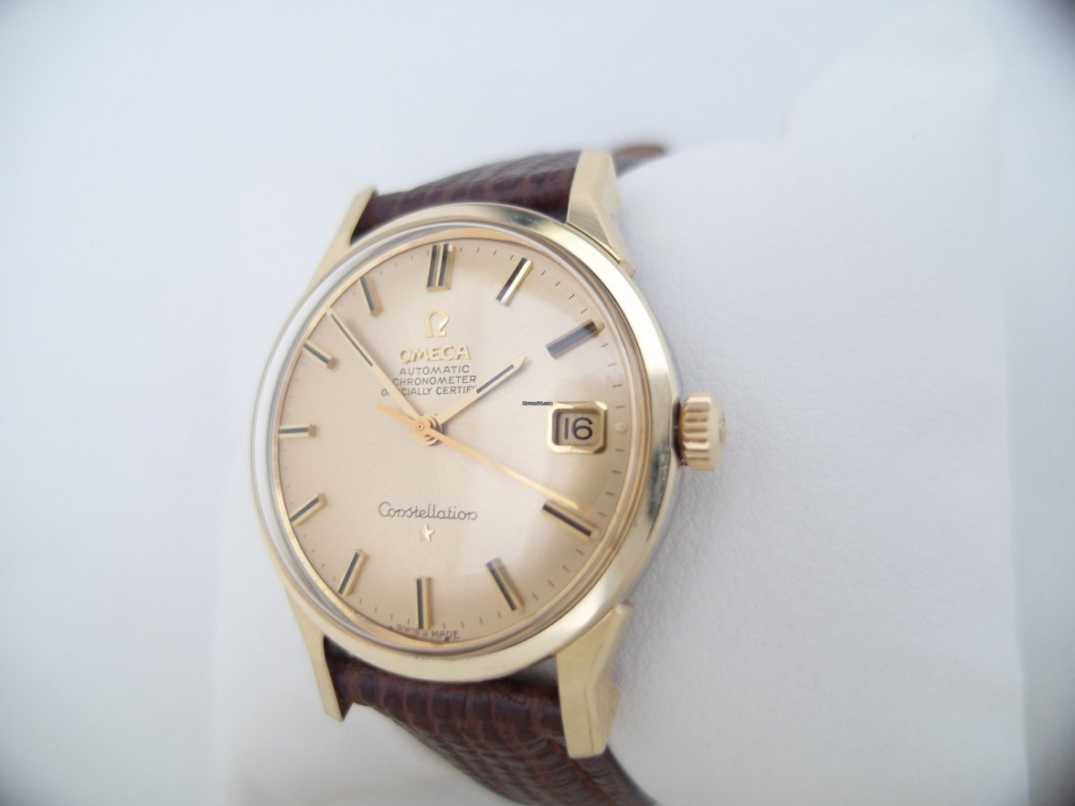

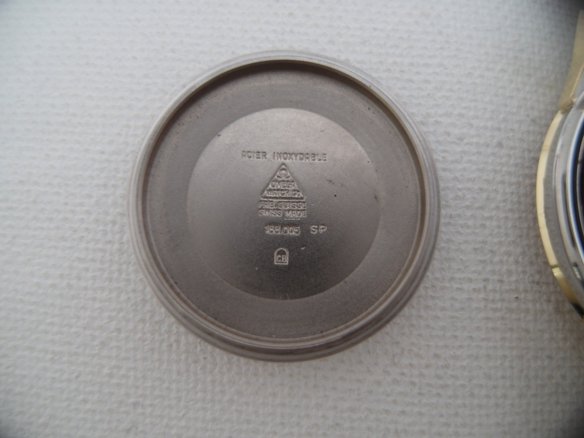

So far, I haven't found a watch that I like for a good price and reasonable condition (those over polishes ruin everything). I have, though, stumbled upon a Constellation that caught my attention for being NOS. The strange part is that it is reference 168.005 SP with a caliber 565 which, from what I've seen, was used in Seamasters and Geneves.
Could this be an original one that came from Omega like this?

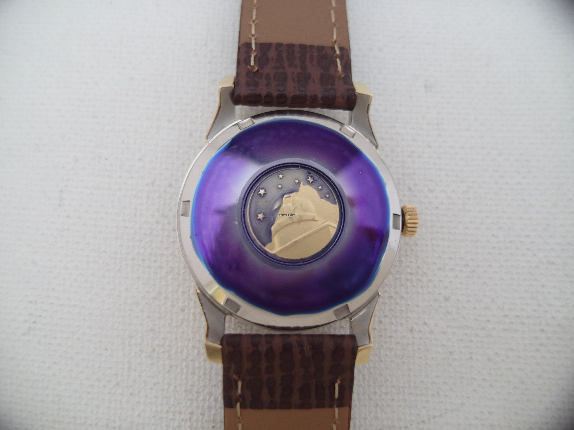

Well it looks ok not a pie pan unless my eyes are bad but what up with that purple on the back?

You are right, it is not a Pie Pan but since supposedly it is NOS I wouldn't mind buying it as my first vintage watch and then maybe in some time buy a Pie Pan.
The blue/purple from what I could research is some factory paint meant to "protect" the case.

I would like @Peemacgee’s opinion but I would like to see better photos although I am on my phone. 1600 euro seems high to me for a gold capped connie.

Purple goo can be bought and comes on replacement case backs from Omega
I’m a little indisposed at the mo’ but also looking on my phone, this watch looks less than convincing.
I don’t like the shape of the lugs
At the very least the hands are wrong, possibly the whole dial.

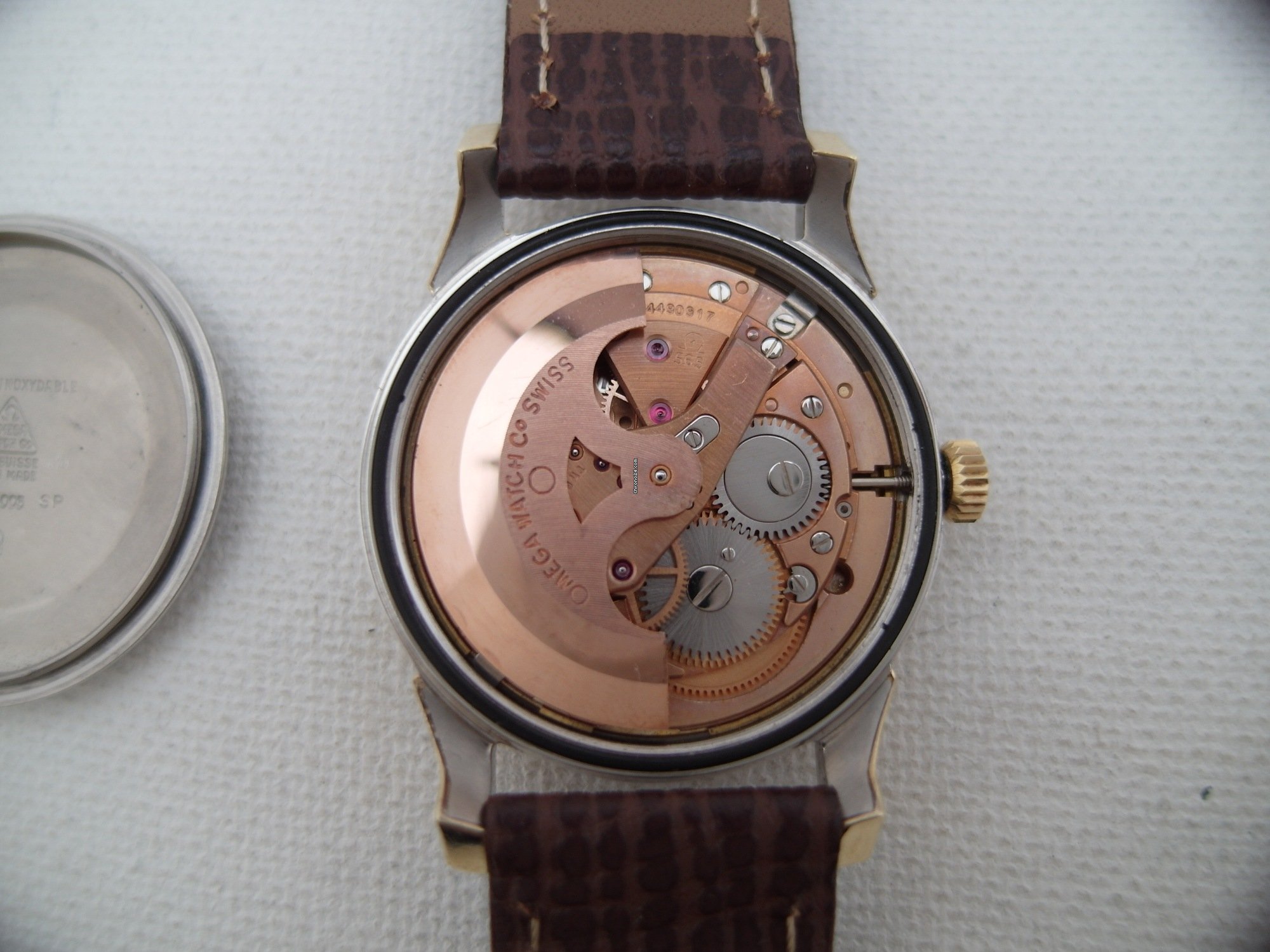

The movement is wrong.
I would expect perlage in the case back.
I wonder what the purple snot is hiding?

Just from what I have read, shouldn’t a older NOS Omega have a yellow gasket? This one is black
5,026
18,607
A non chronometer movement for a connie?!? And with a serial 44xxx for a 168005!?! It's a franken alright...

My thoughts exactly. A franken (565 instead of 564, and the crown 🤦), a bad dealer's special, at a good dealer's price. My advice : run, don't buy.
I can live with a replaced movement, shit happens to a watch in 60 years. But at the very least it should be the exact same caliber ref.

I suspect this is some Franken between a Connie case and a Seamaster/Geneve movement. I've been browsing the web and found a lot of Seamasters and Geneves with the same movement and hands.
I'll definitely stay away from this one.

In addition to all the things that already have been pointed out, it also seems as the stem is too long, the crown doesn't sit tight on the case.

No yourr not mistaken, they are meant to be dog leg lugs.
I just don’t like the proportions.
The fact that everything else is a put together leads me to believe it could be a fake case
