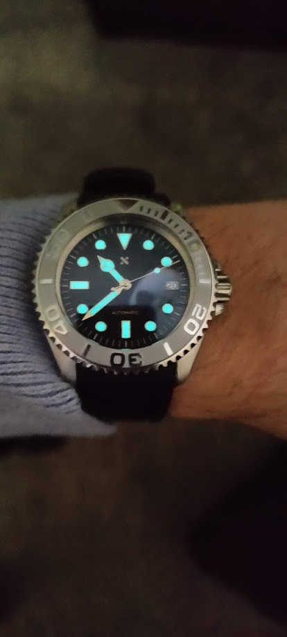

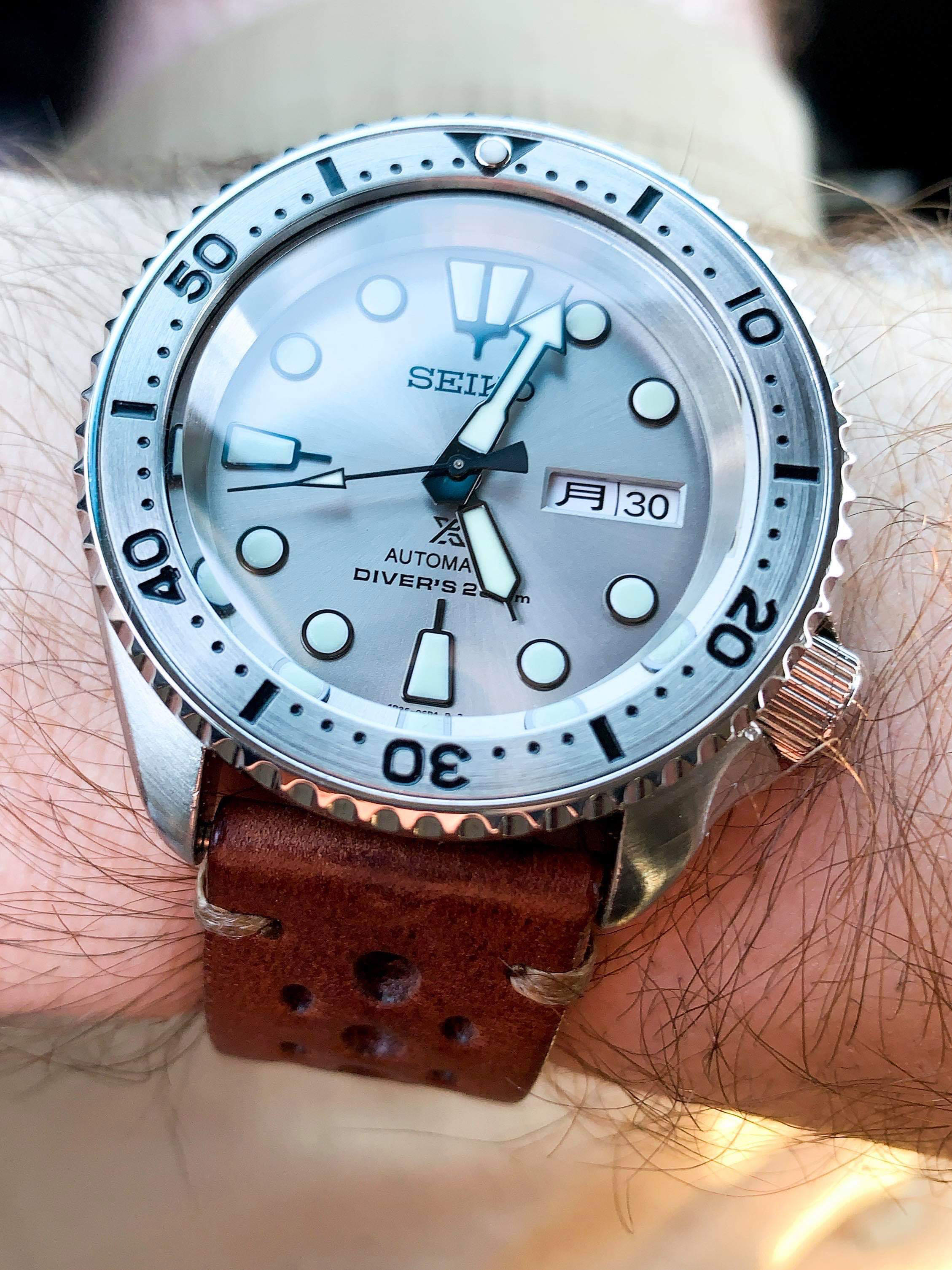

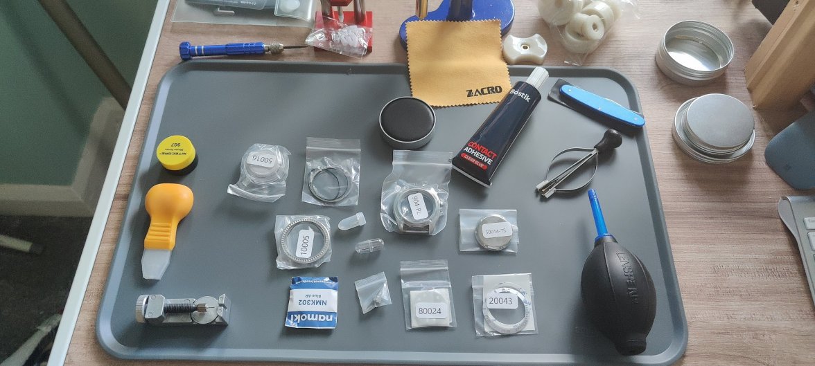

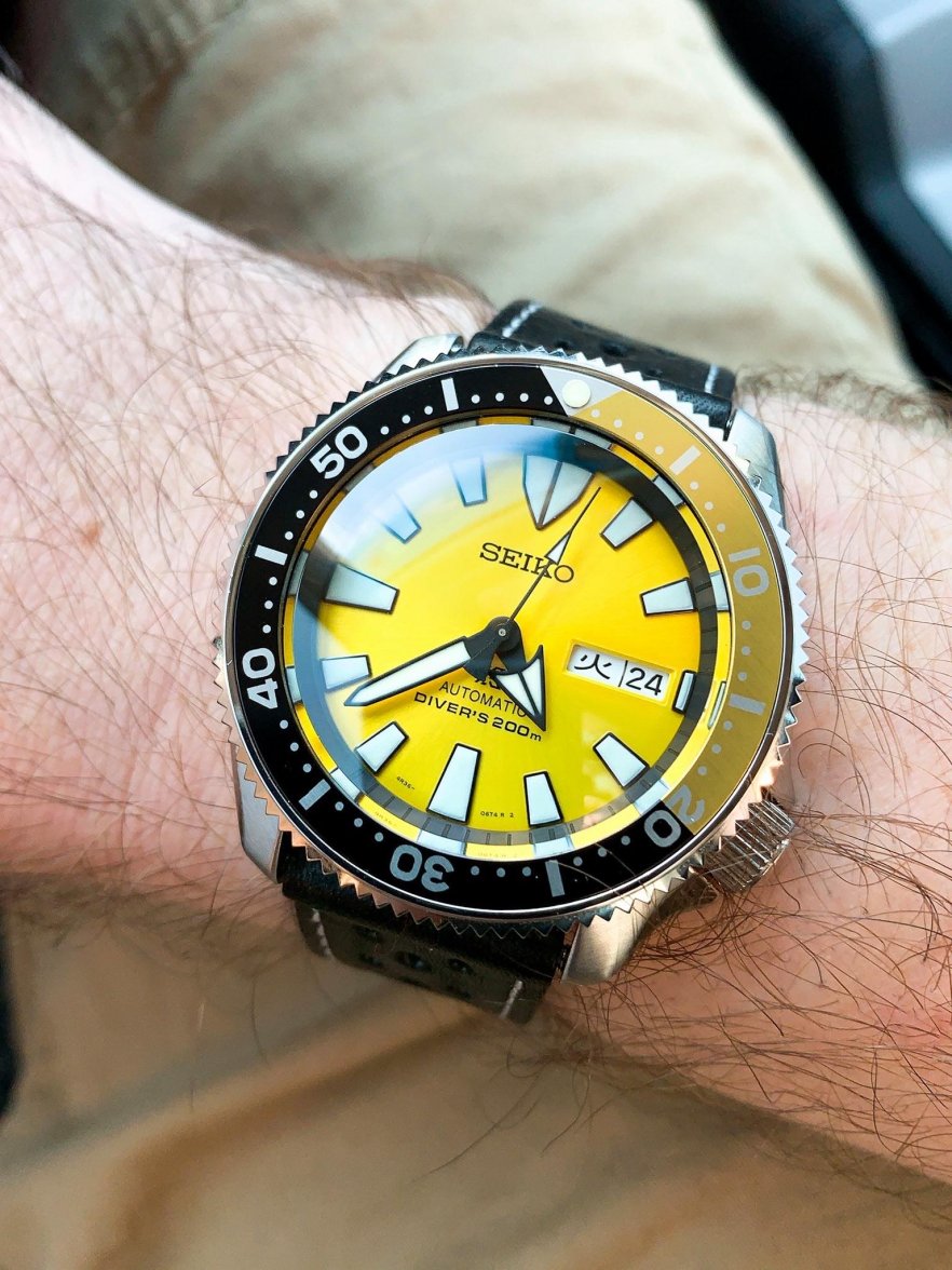

I still very much consider myself a noob in watch collecting, with only a few years under my belt so far. I wanted to learn more about the movements and mechanics and thought the best way was to try and build a watch (not the entire movement of course thanks to the NH36). Did a lot of research and opted for Namoki parts.
I really enjoyed it, took me 6 hours all in all, took my time, made plenty of mistakes and learnt a fair bit (I think). My top learnings were:
- I could never be a watch maker, those that are have an incredible talent.
- I should have ordered a magnifying glass before starting.
- Attaching that seconds hand nearly beat me. The other half was amazing at finding it in the carpet when it flew off, only took 20 mins before she said "doesn't it glow? Let's turn the light off". Absolute legend, I was sat on the floor near defeated feeling so close, yet so far.
- The moment I could see the dot/pip needed on the arm to release the crown & stem was a massive highlight 馃憤
- Definitely should have not missed the Chapter ring off the order, but it only took me 10 mins to pop the glass off, remove the movement, it the chapter ring and re-assemble.
Now it is all working, keeping time and date I am really proud of it and would definitely do it again 馃榿 some pics of the finished model. I also love the blue lume!

It's amazing how many things pop up to test you in watch making and tinkering, but the experience gained will mean the next one goes that little bit more smoothly.

Great job and I can tell you it can become very addictive.
I've been modding Seikos (and other watches) for several years but the huge number of companies now selling great aftermarket parts for Seiko mods make for an amazing choice of parts.
You definitely need a magnifying glass (Loupe) its absolutely essential, you can not do without one.
For the seconds hands there are some techniques to making this easier, I used to cut a very thin piece of masking tape and stick it to the back of the seconds hands, this makes positioning it very easy. I use a hand fitting press (I see you have one in the picture) and I find these have much more accuracy and control, however many modders seem to like the individual hand fitting tools and I started using these when I first started, but these can slip when installing the seconds hand if its very tight, so a lot of care is needed. I would also suggest using a dial protector when fitting or removing hands.
Hands can also be easily scratched when fitting so it can be beneficial to put a small piece of clear plastic over the center of the hand when installing to help prevent the hand fitting tool leaving any marks.
Above all enjoy the process 馃憤

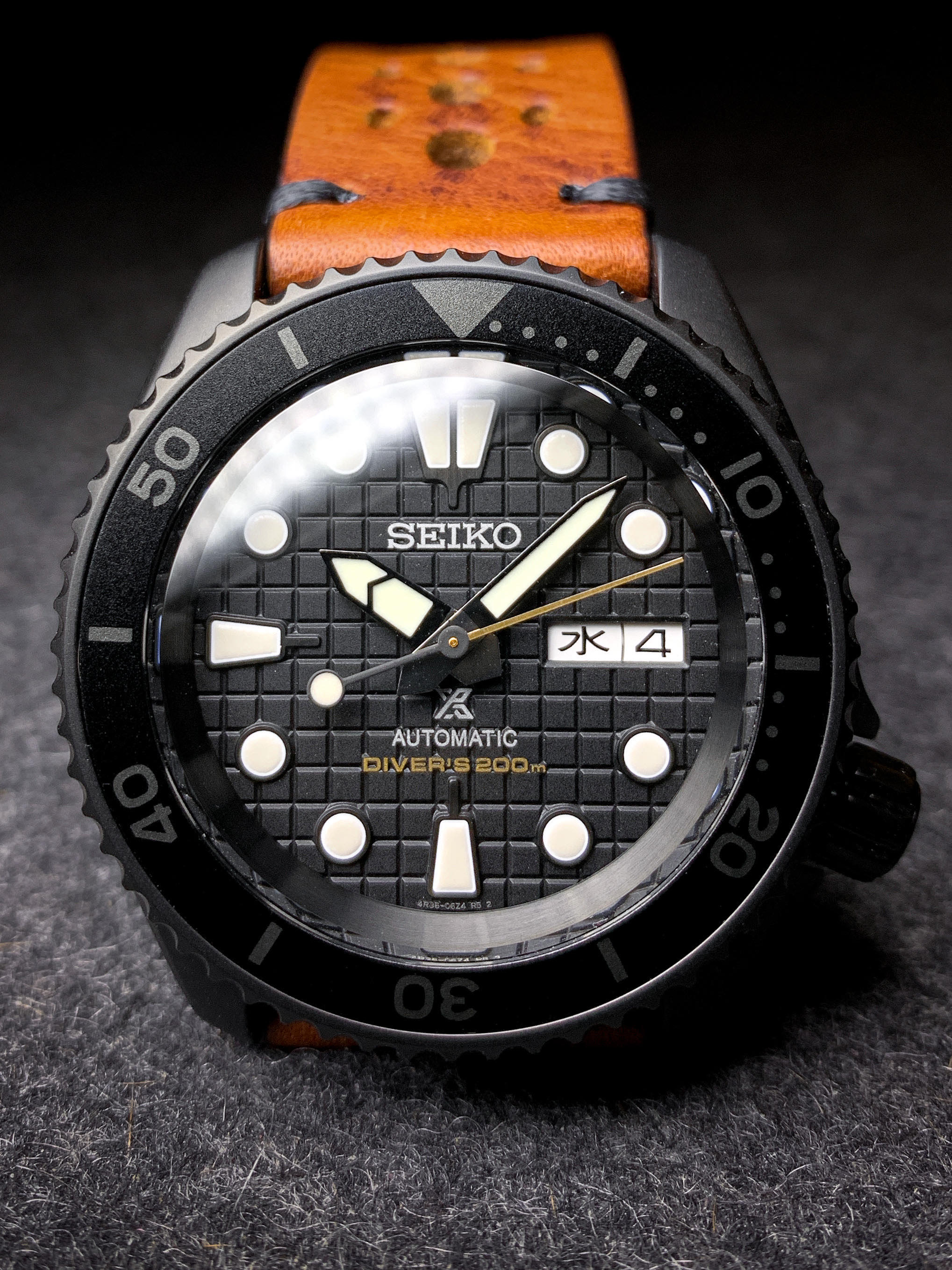

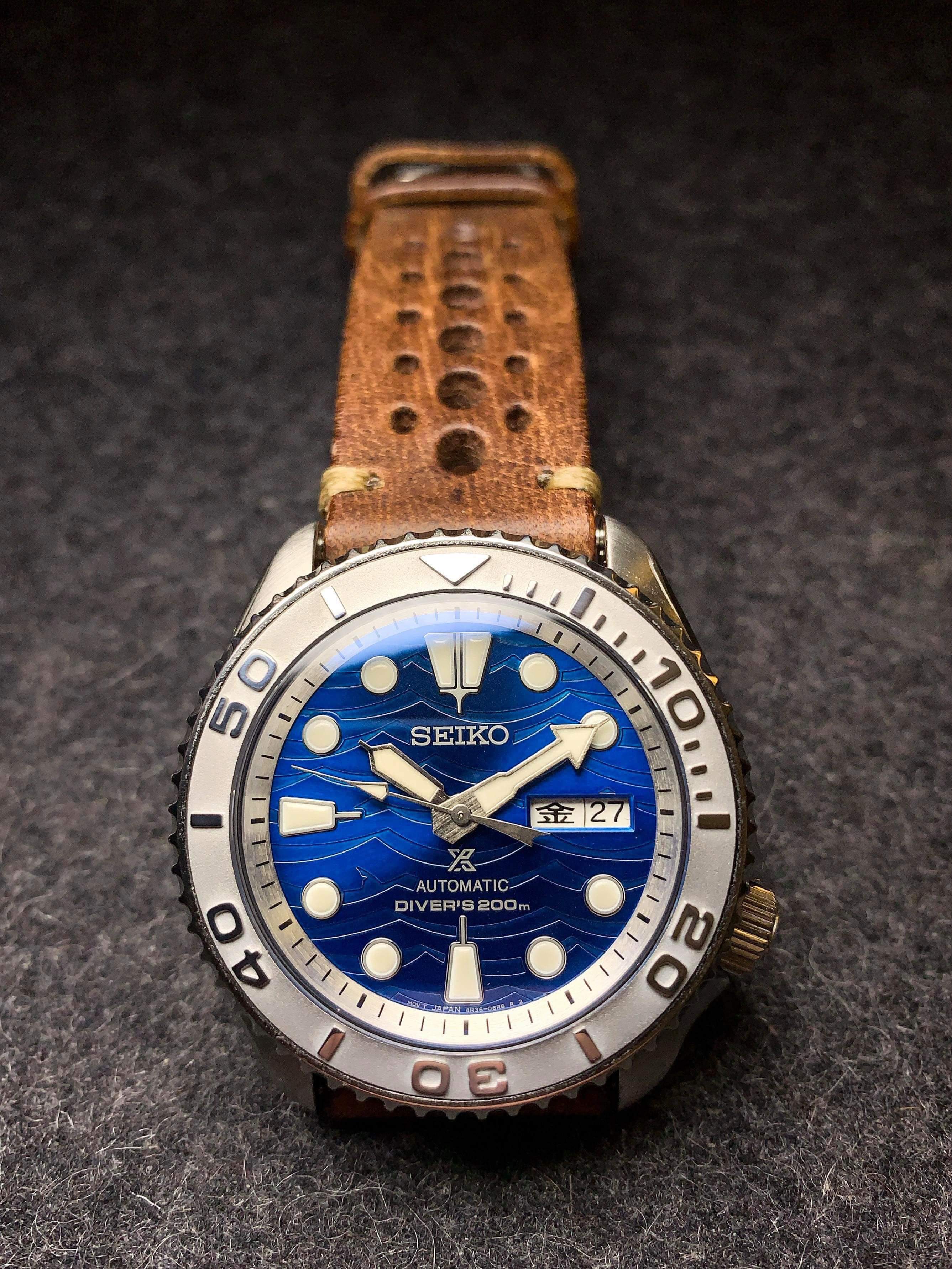

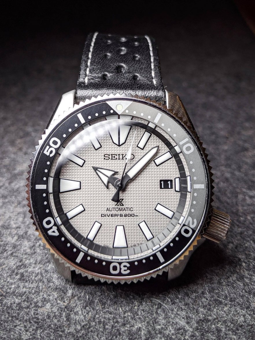

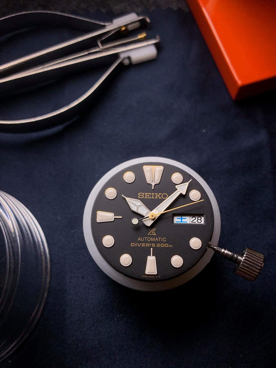

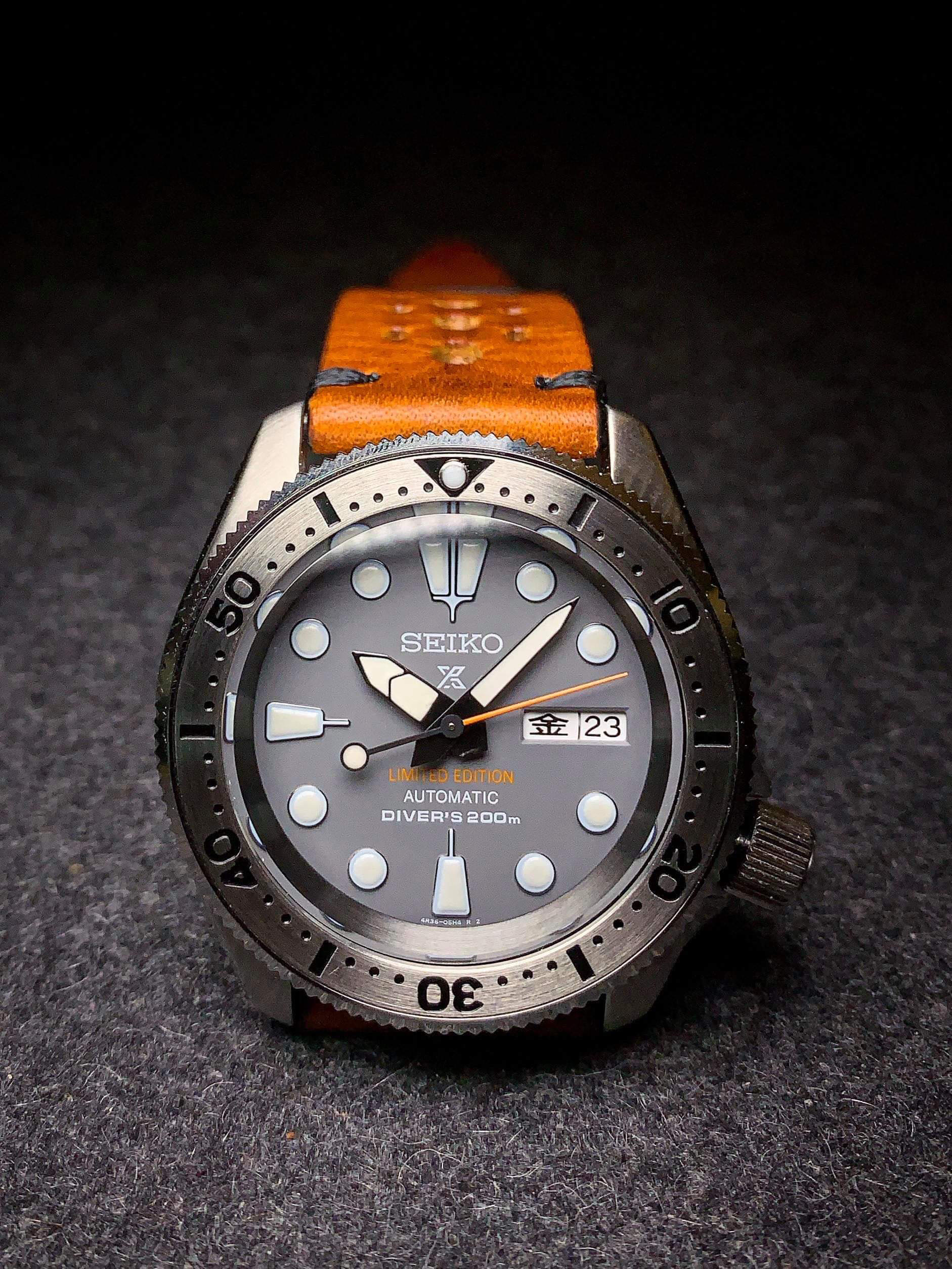

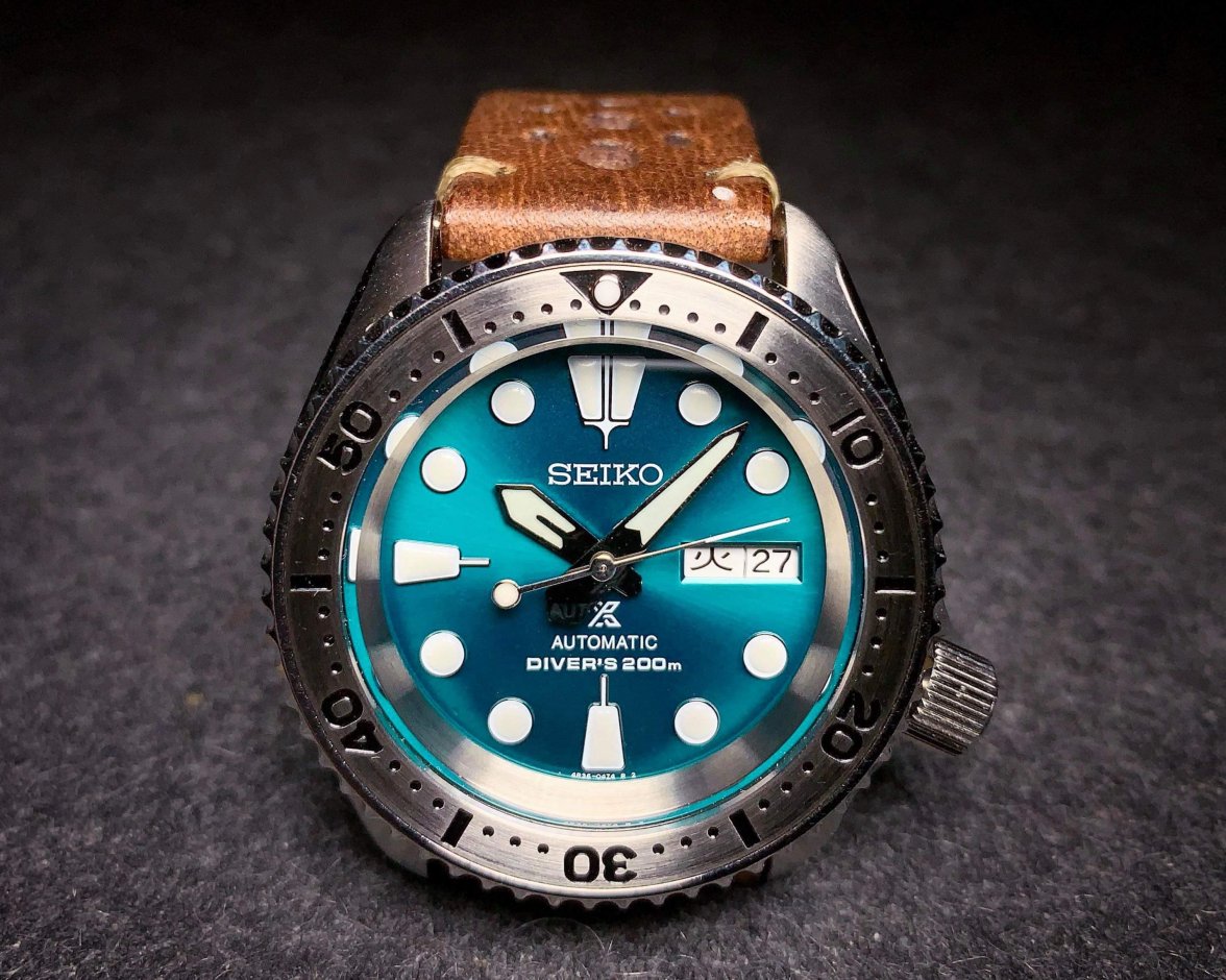

I can confirm that it can be addicting and expensive... especially when you buy OEM LE parts. But, it鈥檚 a lot of fun. I did all of these early/mid 2019. The dark brown leather strap on a few of those was just a placeholder until the bracelets showed up.

@pascs thanks for the tips - I have now invested in a Loupe to help me next time! For the seconds hand i used a similar approach to the above, dial protector & some blu-tac but will try you approach next time so I make sure I protect the hands! 馃憤

I spent a happy couple of years experimenting with watch modding, I started with Vostoks and moved into Seiko, mostly Sumos as they were what I wanted to wear at the time. Dials, handsets, chapter rings, crystals, movement holders, rotors, stem/crowns.
Loupe? Definitely and you might want to think about something which you can either fix to your face or hold over your work using a stand or something: why? For me it was the sweep second hand and needing to use both hands just to hold the movement and press the little stinker into position. You've had the "ping - she flies!!!!" experience and we understand each other. FWIW the technique which worked best for me was to fix a small blob of blutack on the end of a short stick and pick up the sweep second hand right over the pivot point and then press it into place. My blutack had to be small enough to align things visually and once you've pressed the hand home it releases easily enough from the blutack.
Tools? Well, blutack, a set of cheap brass tweezers, a pukka hand-setting press, a crystal press for removing and replacing. Oh and a shallow tray to hold my work in and a large smooth cloth to cover my workspace and hopefully avoid those flying hand moments. Here's a real "pro" tip. If something pings off into space your first step is to not move, not drag your chair about but look down, check your lap, check your shirt front, work your eyes down your legs, down the chair legs. Or maybe you'd like to learn about mashing a second hand with the leg of the chair? No, don't do it!
You can have a lot of fun, you can chase designs and see how you like them "on the wrist"

I concur with everything @tikkathree has said...I also found when any of the hands flies off onto the carpet then turning the lights off speeds up finding the missing part 馃榿 I have done a few Seiko mods now and found with each one experience has improved.
I bought some loupe glasses with a touch and they are a godsend for fitting that seconds hand.
There is definitely a couple of routes you can go...buying all component parts and do a "proper" and full build or you can buy a case from eBay where it is mostly assembled for you (case includes chapter ring, case back, crystal, date magnifyer, bracelet).
Most importantly have fun with it 馃榾

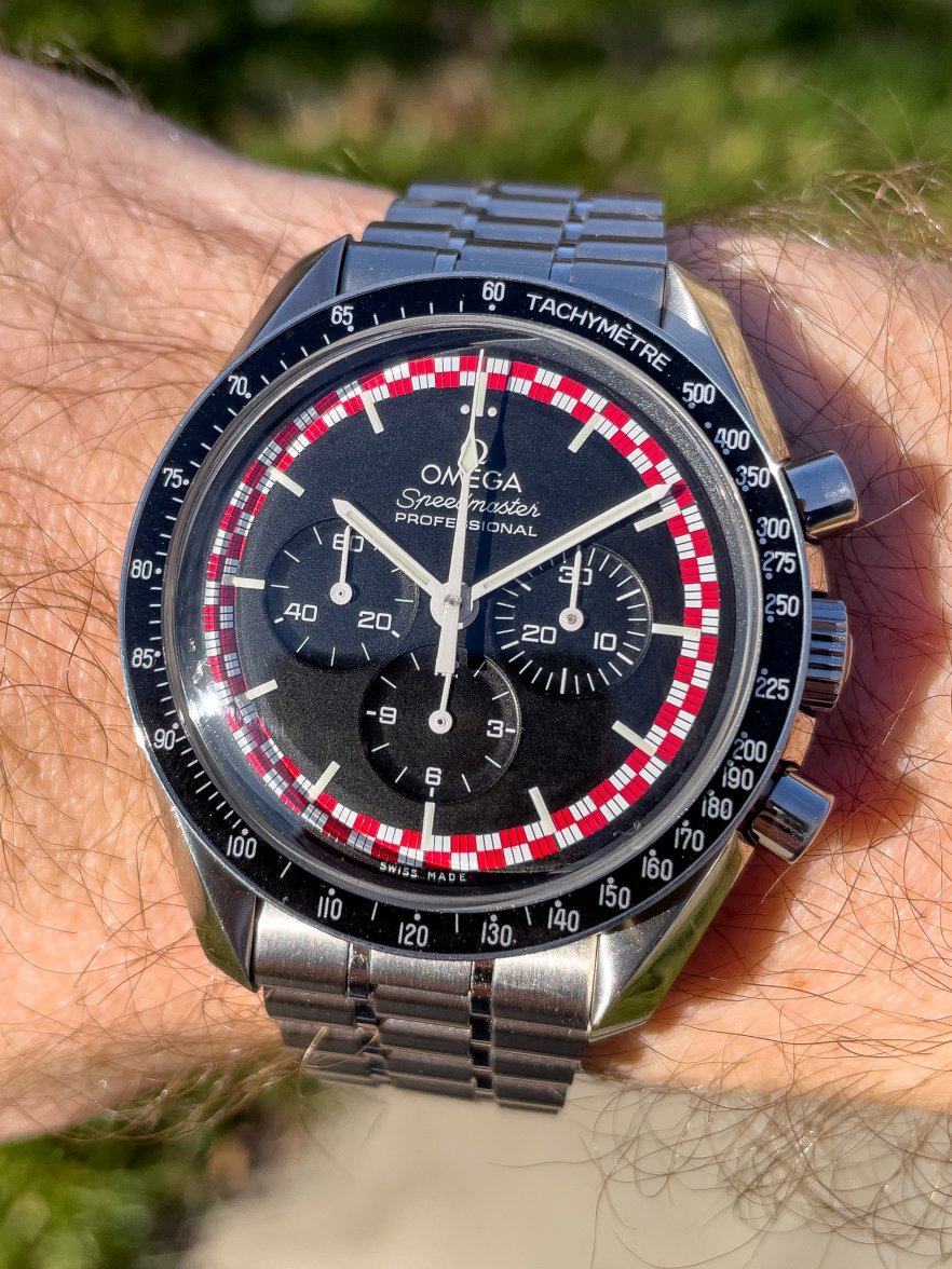

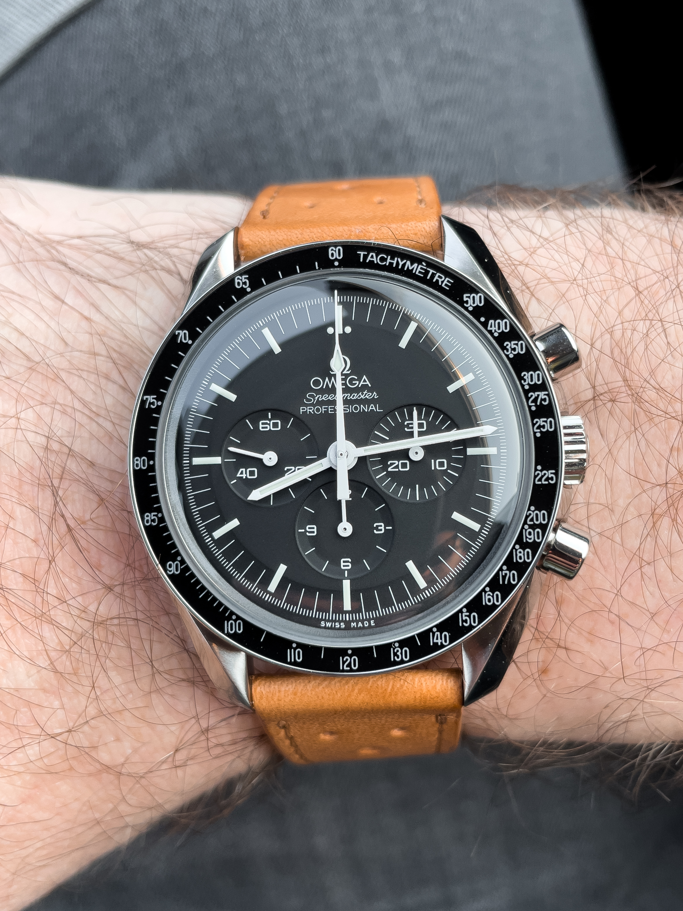

Modding Seikos has ultimately led me to mod one of my Speedmasters 馃榿
This
To this

That's great that you've ordered a homage to have a play around with. My main lesson is choose parts carefully. By this I mean I started off buying all the components separately from modding sites (I'll share the main ones at the end of this). I found those parts to be of a much higher quality than those of marketplaces and the bay. I noticed a lot of modders that sell their pieces buy the "mostly done" mods so case, caseback, crystal, bezel, bracelet already installed and yes granted you could get all that for around 拢30-拢50 but my experiment with one of those was the quality just wasn't there and I didn't really feel as though I had truly modded. I think it took me about 20 mins to build the "mostly done" one where as a true (imo) mod from all component parts (bar the movement of course) was a real labour of love over many hours and the accomplishment was much greater. Another top tip; when you undoubtedly lose your seconds hand when it flies off into the air and into the floor or carpet turn the lights off and you'll find it immediately. After around 20 mins of crawling on the floor looking for it my smug wife came in and turned the lights off and the lume did it's thing immediately 馃憤. Here's the go to mod parts sites I used, seikomods, namoki, dwl, luciusatelier.
Look forward to seeing some pics of your adventures soon 馃憤
