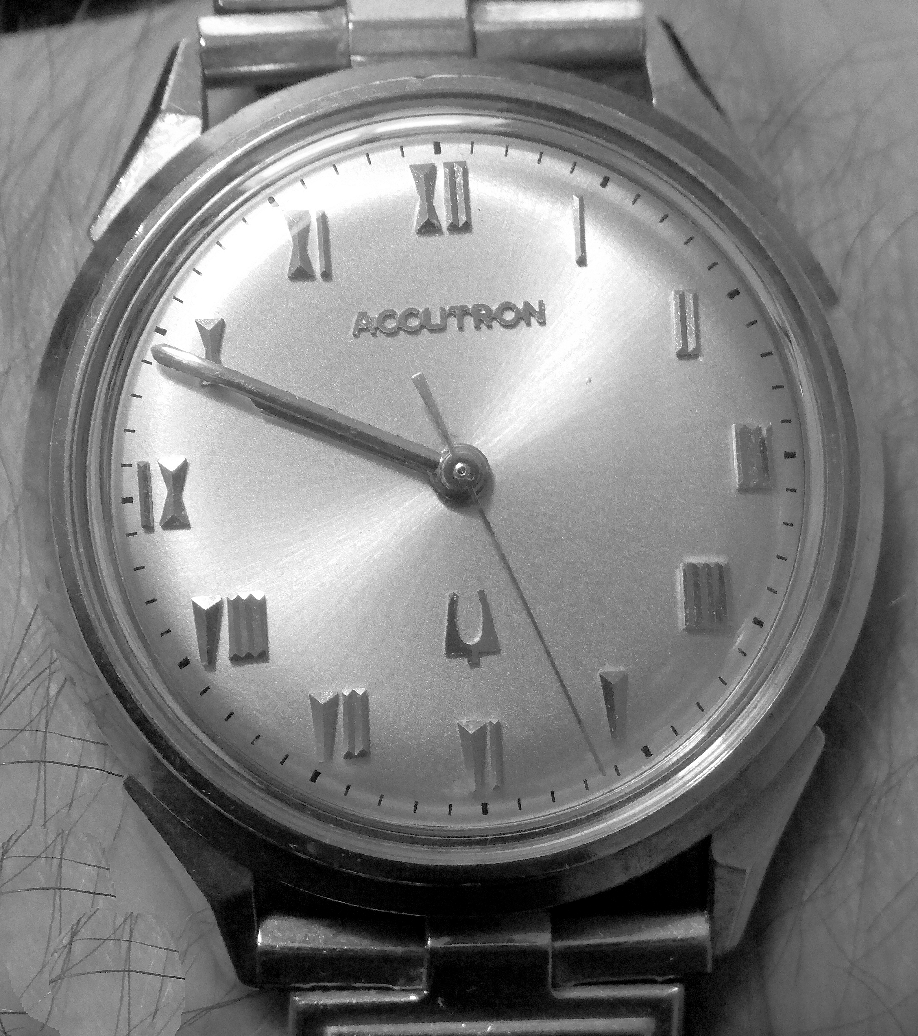

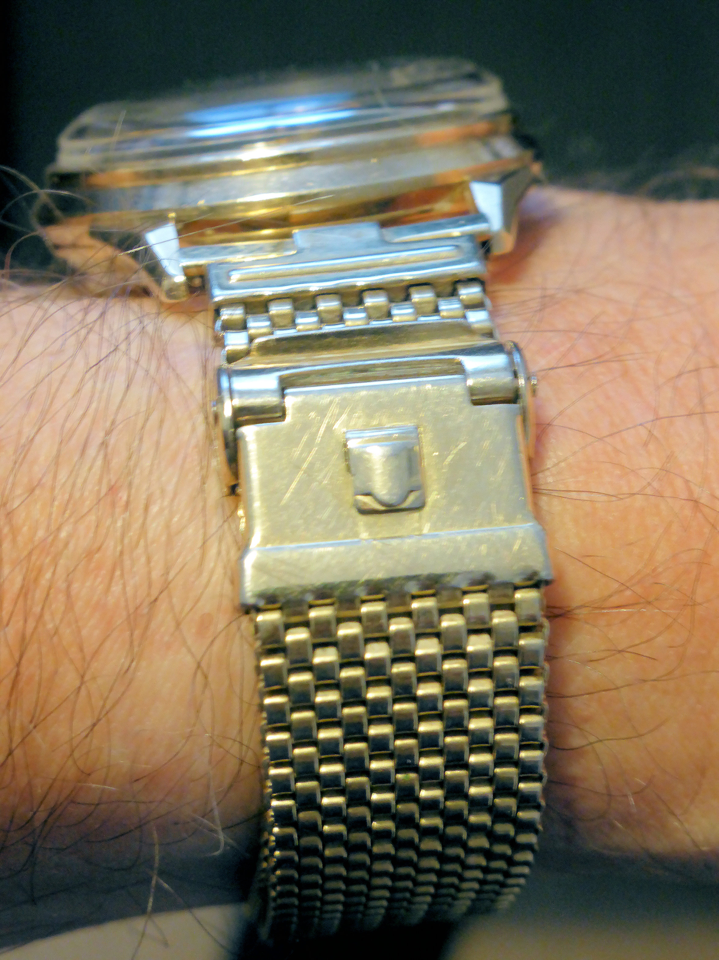

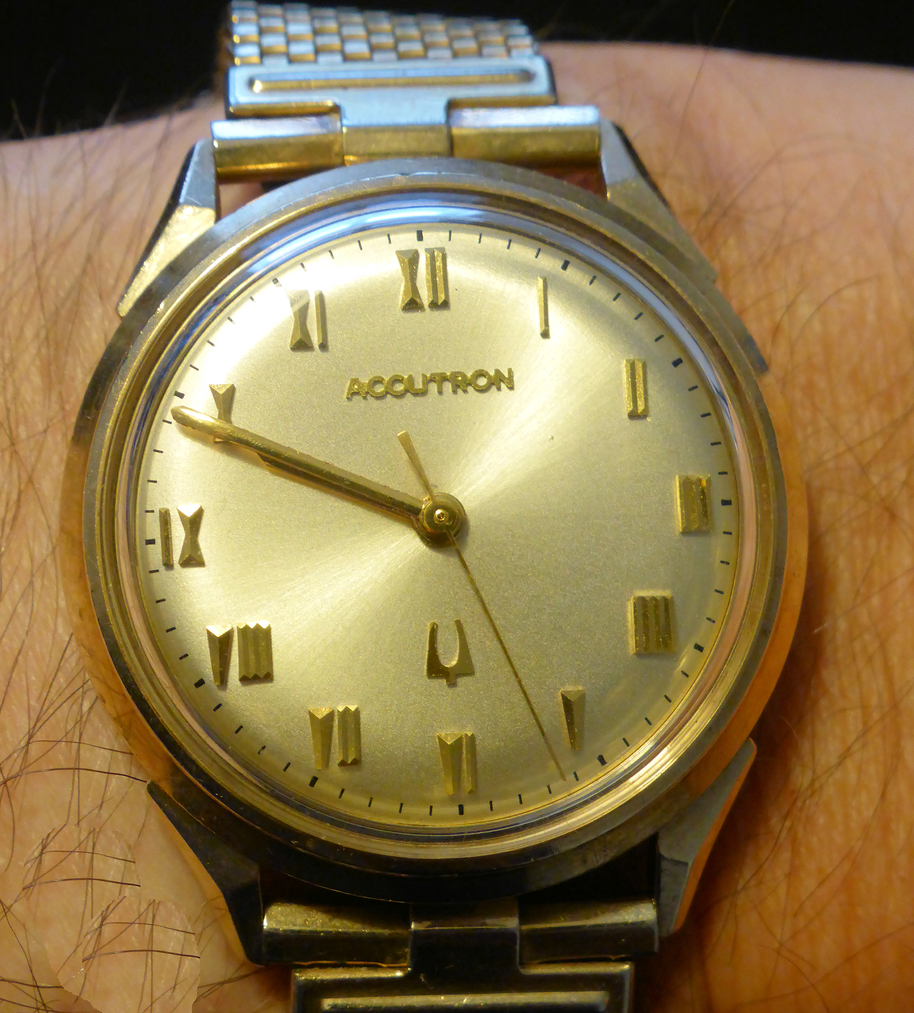

So I just got my first new 'old' Accutron which has stayed in the Forum family (thanks @pnwyankee for selling this).
Not sure why I was drawn to this watch- but very happy with my purchase / first wrist time today. Also loving the JB Champion bracelet. I am a hummer convert.
If anyone has more info on this style / date of watch please let me know or link to past posts. I am interested to learn more.
Also looking to the future any recommendations for service and repair work in the UK (I plan to hang onto this one). How often do they need a service?
Accutron ref. 2527 10k GF c.1970 (214) on JB Champion mesh bracelet

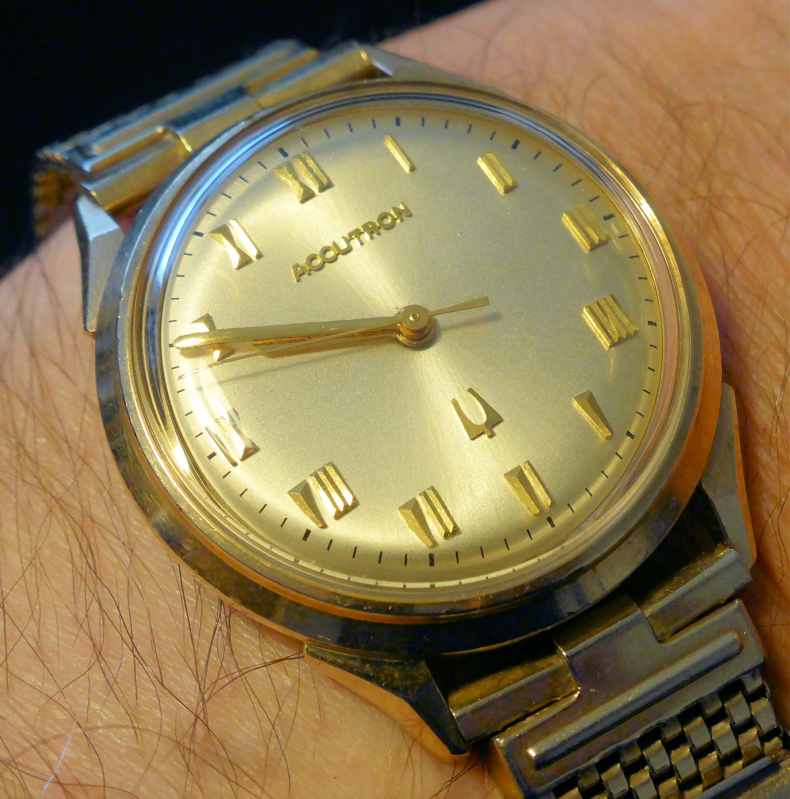

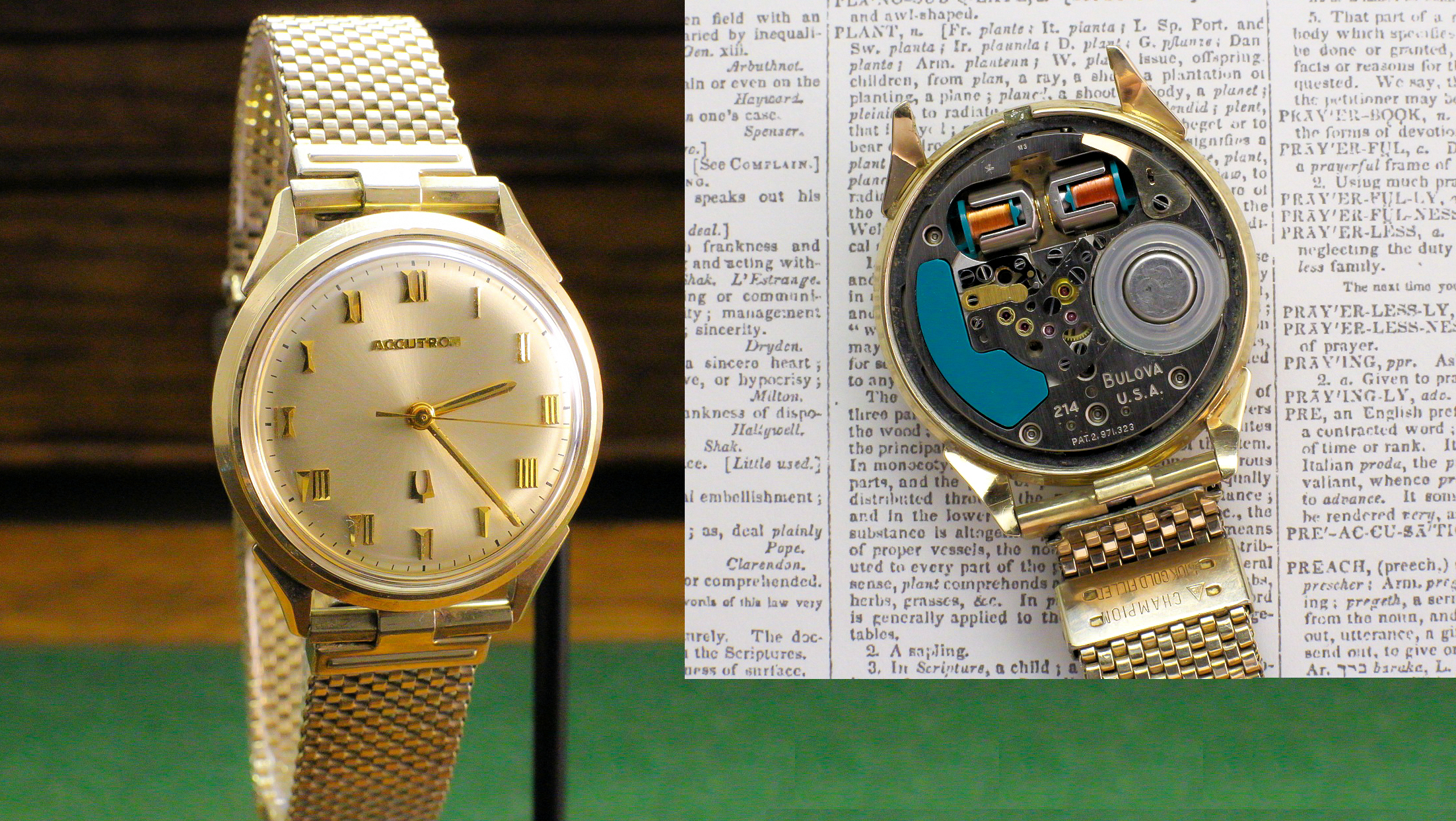

I own the very same Accutron. The nice thing about this watch is it actually existed like that from the factory with a Model number and Style number. The only thing not matching is the leather strap but we all know those leather straps wear out over time so we often see miss-matched straps/bracelets on watches.
Facts:
OP watch is indeed a case # 2527
Style # is: 24048-1y
And it's an Accutron Model 425. (See Sales Rep reference pic below).
My Accutron Model 425
My 425 showing the movement date (M9) and the case number 2527 dated (2-9) Feb/1969. This watch has seen very little wrist time since purchased new.
