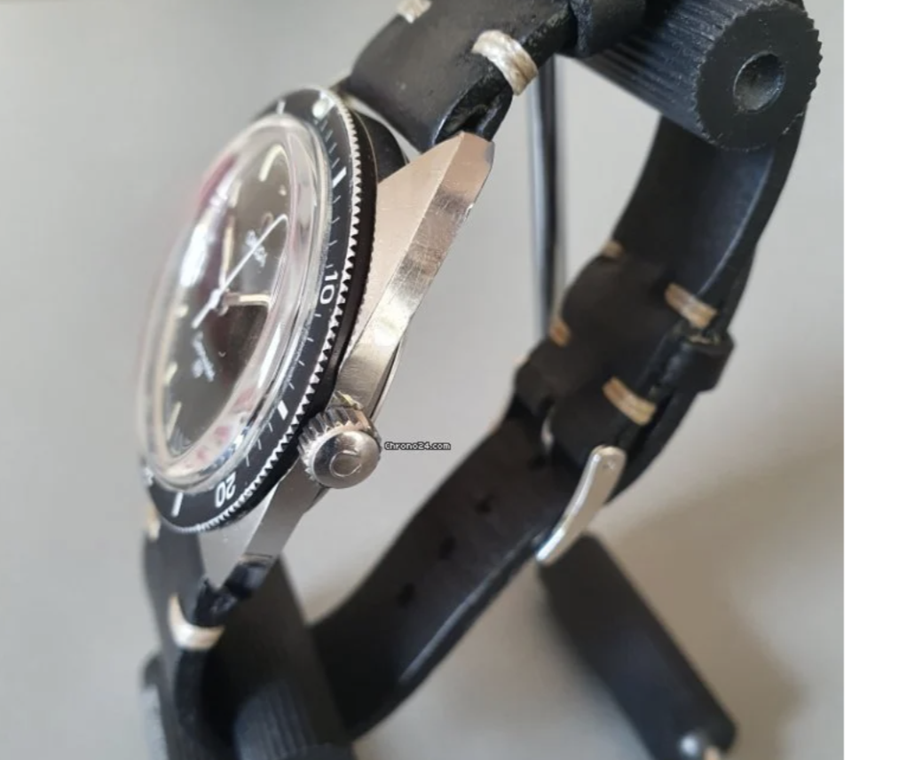

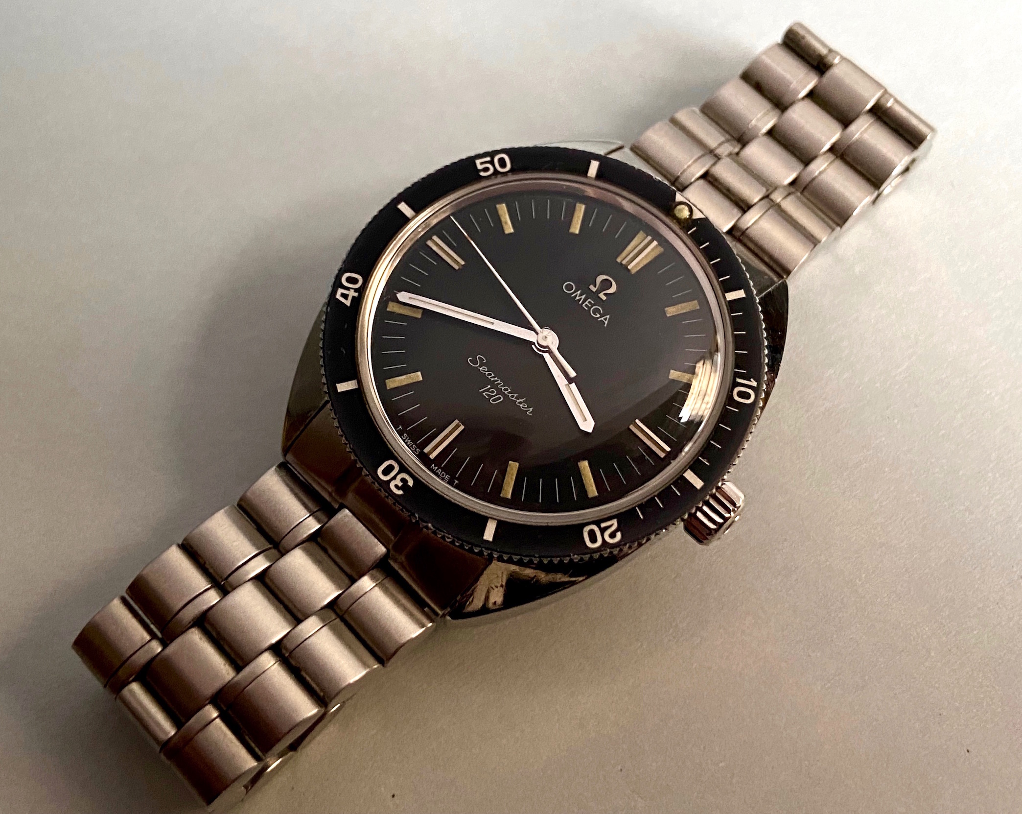

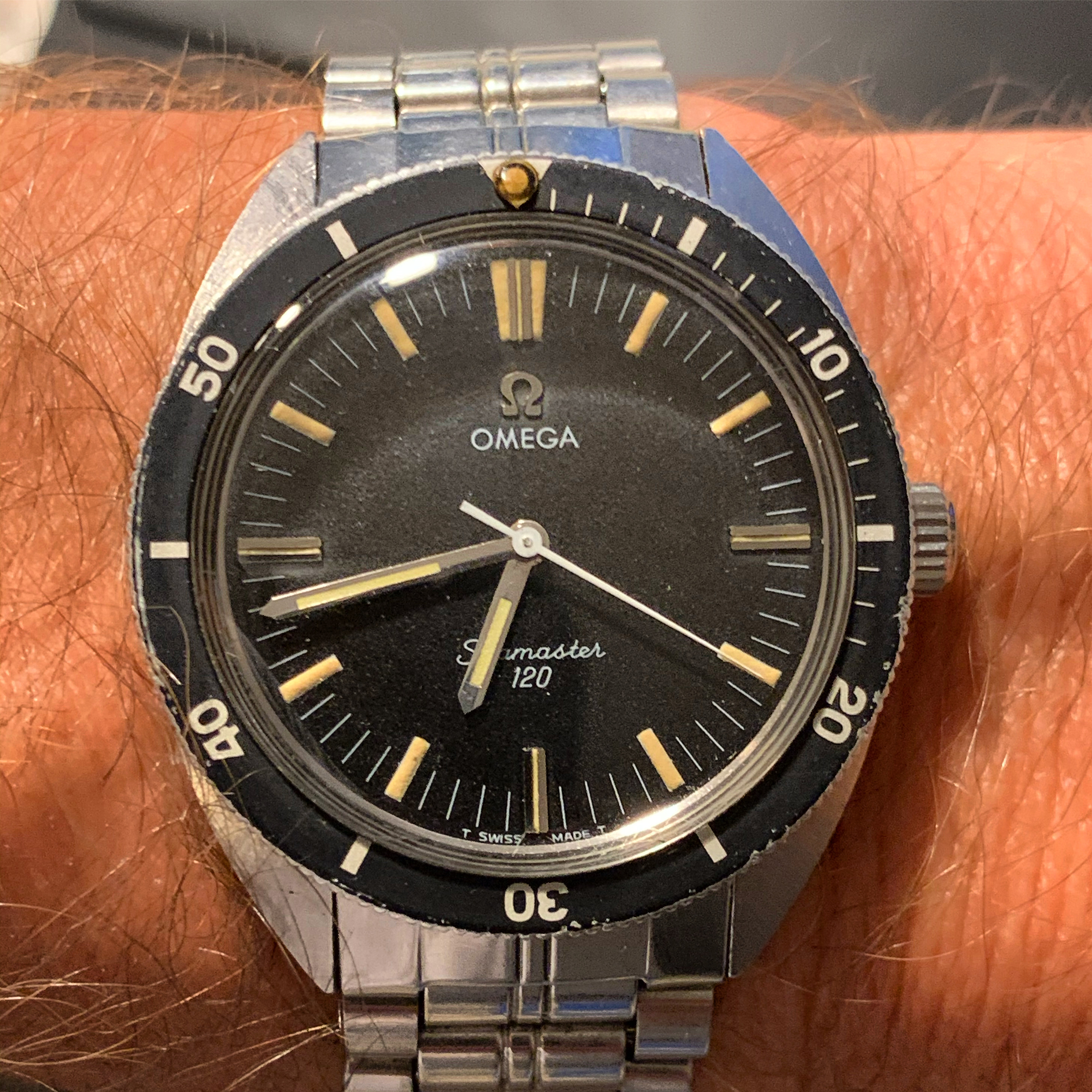

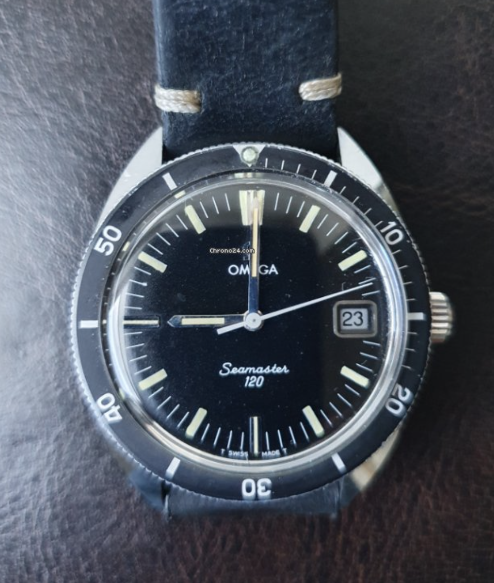

This is the first example I’ve seen of a fake bezel on a genuine watch.
i have seen it a few times, and I confirmed it does work in this thread:
https://omegaforums.net/threads/1969-seamaster-120-conundrum-to-mix-or-not-to-mix.144849/page-2
That’s actually my listing. I decided to sell one of my two Seamaster 120’s and decided to restore/keep my 166.027.
Happy to add/share info about it. I was originally going to sell it without a bezel, but I figured this set up would make it more wearable.

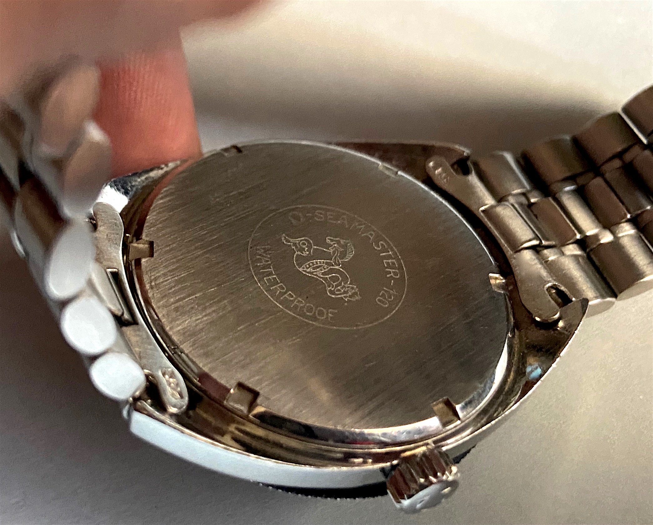

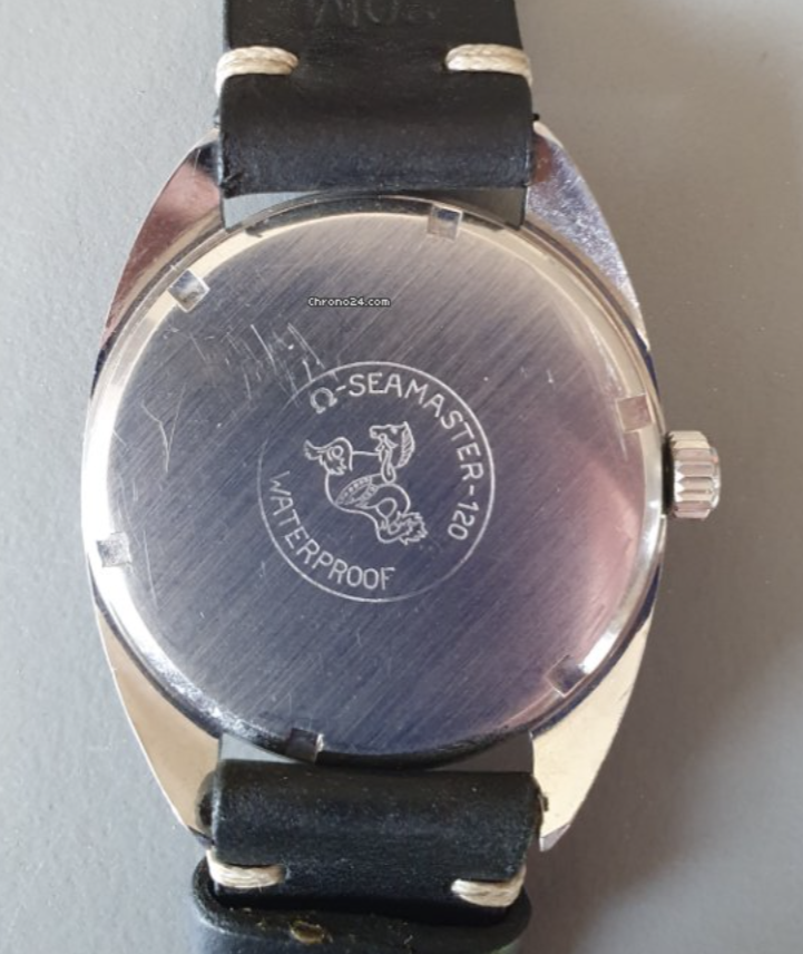

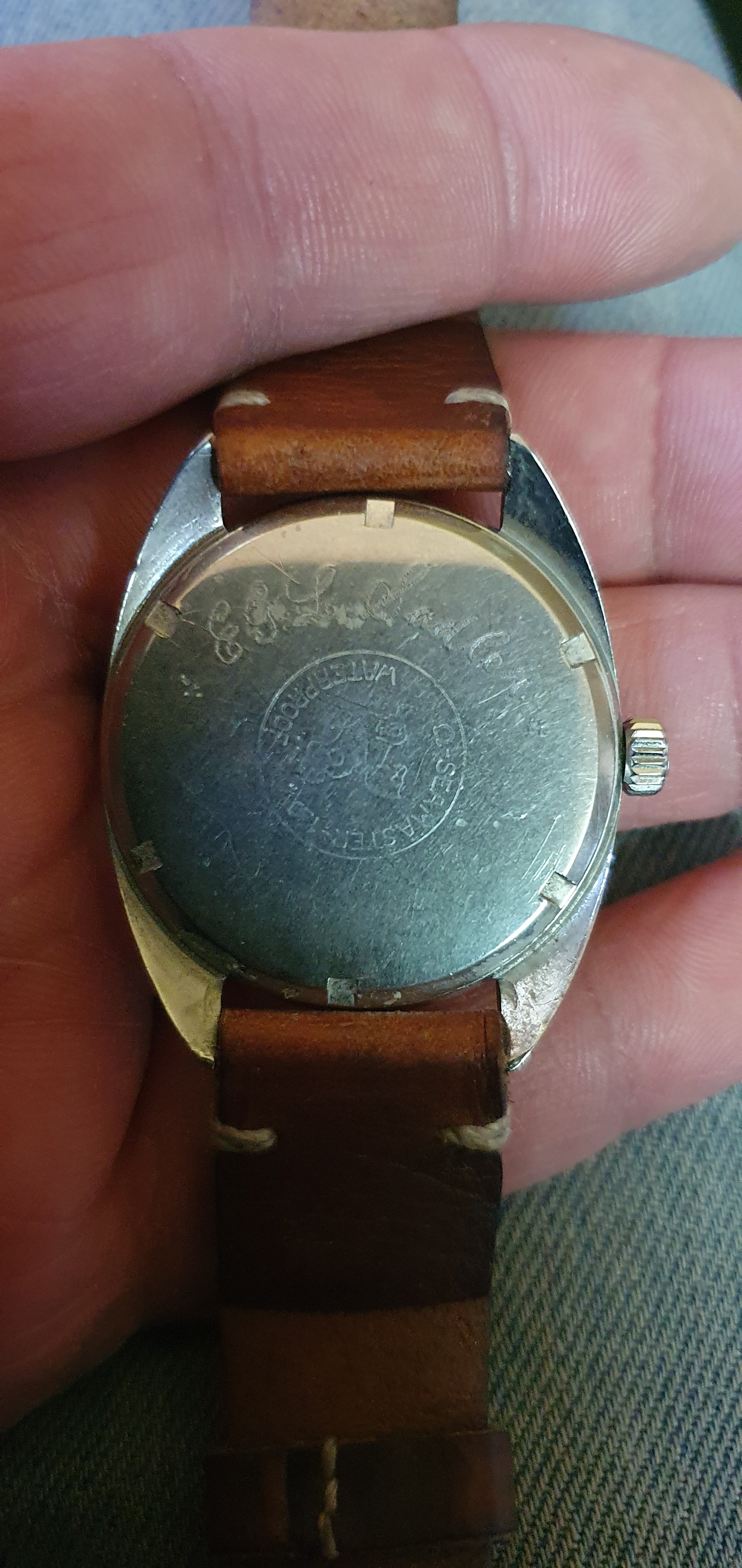

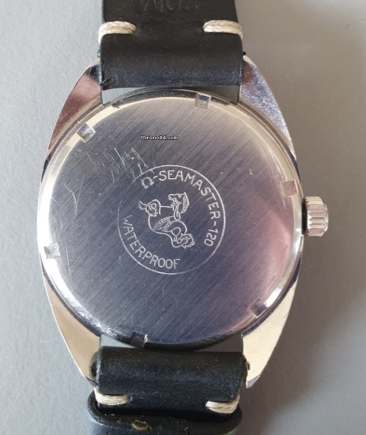

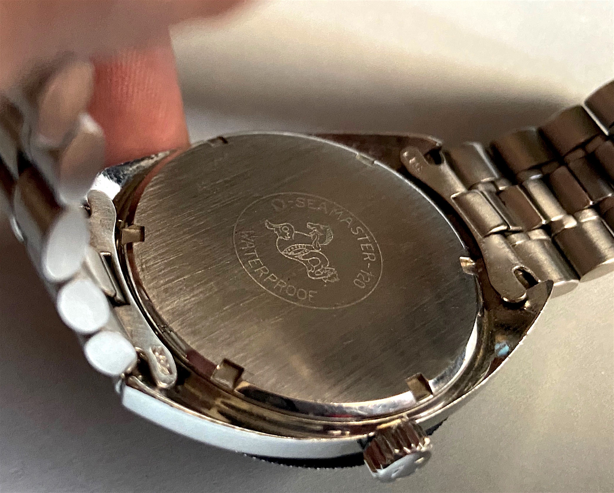

The emblem on the case back .. from what i have gathered is the mark for the AFGHAN Military ... my friend ... Mustafa Sarwary in KABUL has a vintage 120 and i inquired about the mark on the case back of his 120 .... pictures of his 120 ... seems the afghan military were issued these watches according to him .. as i have seen the mark on a few pieces as well floating around for sale ... so ur statement ... "FAKER SIGNED THE CASE BACK" ... might not be so accurate
Did he have an extract from the archives to confirm it?
Like the 300s issued to the British military or 120s to Israeli military
it’s an interesting theory i suppose

You clearly stated it in the listing- good on you. It is far more appealing with the replacement bezel to someone who just wants a Seamaster 120 than crazy collectors like us. As I have said before, since Omega has orphaned these watches we gotta do what we gotta do.
13,555
23,503
I found it interesting that it actually fit. I’m sure I’d read in a couple of threads that the aftermarket bezels wouldn’t fit a genuine case.
It’s fine in your case as you were open about the bezel not being genuine, but it highlights the need to check all aspects of these watches when buying, especially with the rarity and value of these bezels.
Sorry i didn't mean to resurrect an old discussion with you about it, i only just realised we'd spoken and disagreed about it before.
i was reading the whole thread about the SM120 again and saw the reference to ANA issued watches so commented before making sure i wasn't going over old ground with the same person, no hard feelings
I linked his info/contact, you could ask him

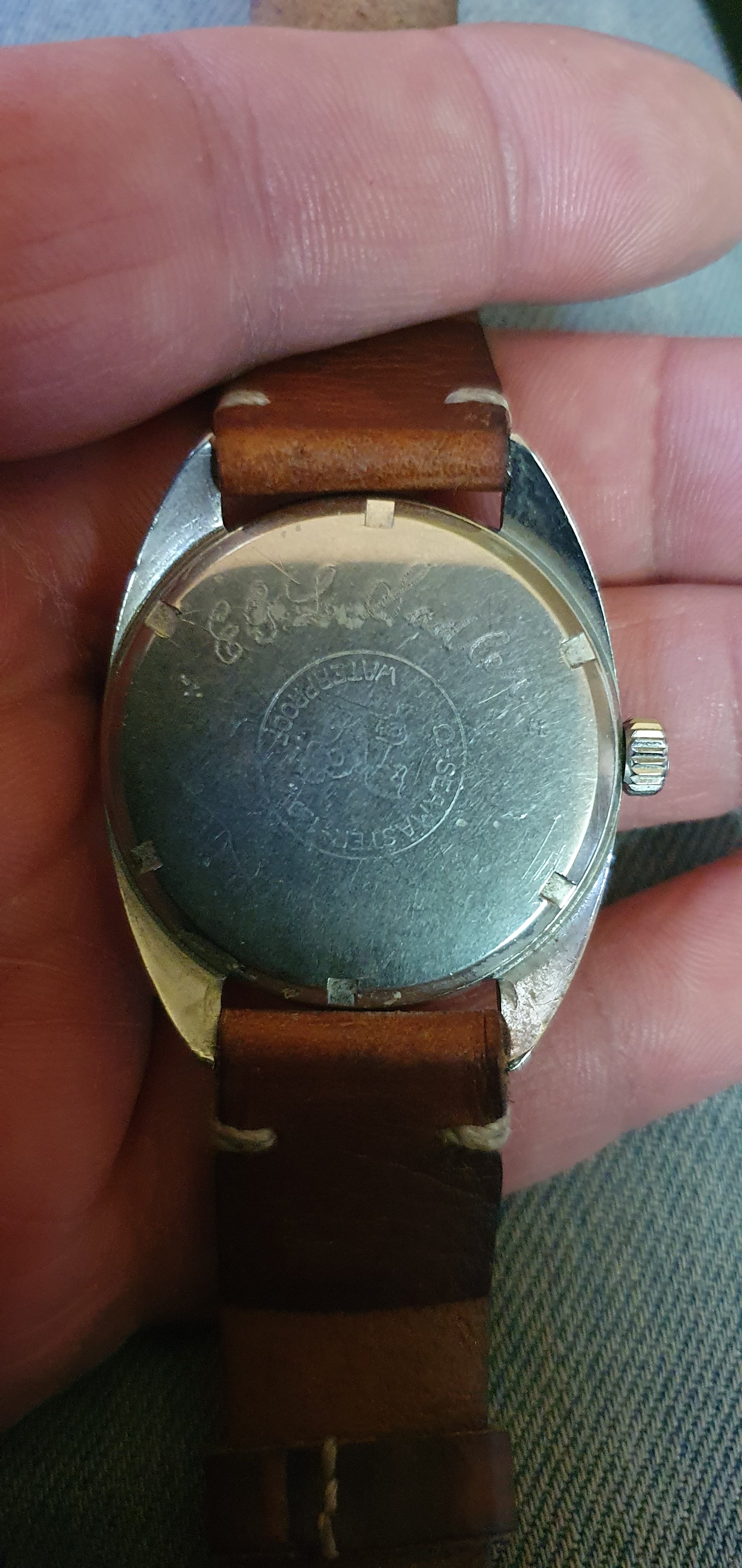

You see the name MUSTAFA in blue? you can click on it should take you to his profile, theory I really wouldn't know,

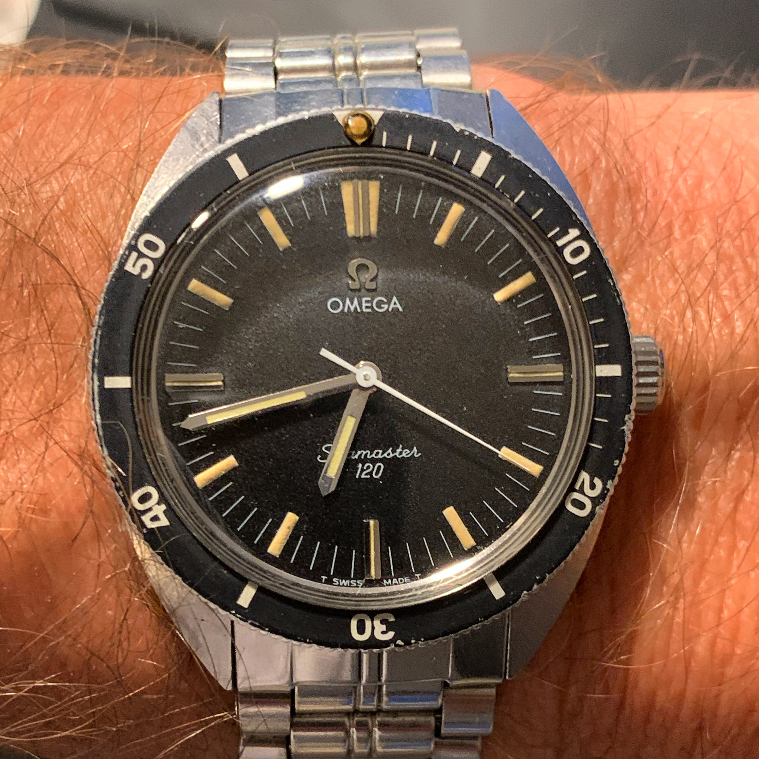

she is what she now, and i still do love her ...
16,305
45,025
1967
OMEGA Seamaster 120
No date / Manual wind
Overhauled 2018 by Omega service center
original handset with tritium lume had flacking,disintegration not because of moisture / water intrusion but due to age was replaced
One of the nicest bezels I’ve seen

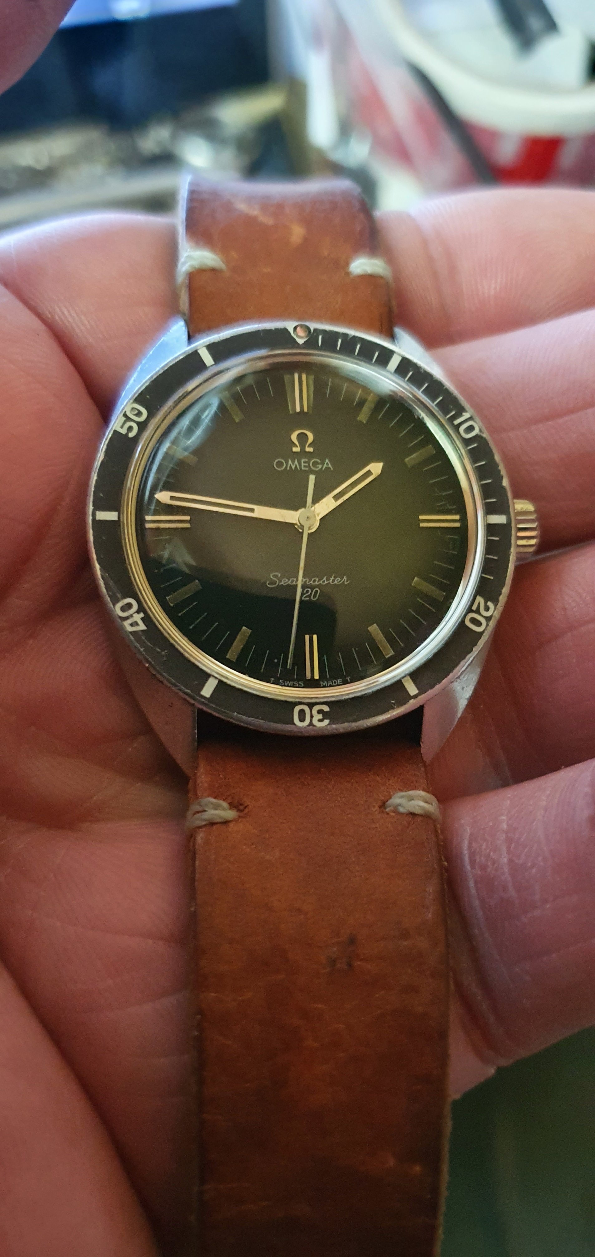

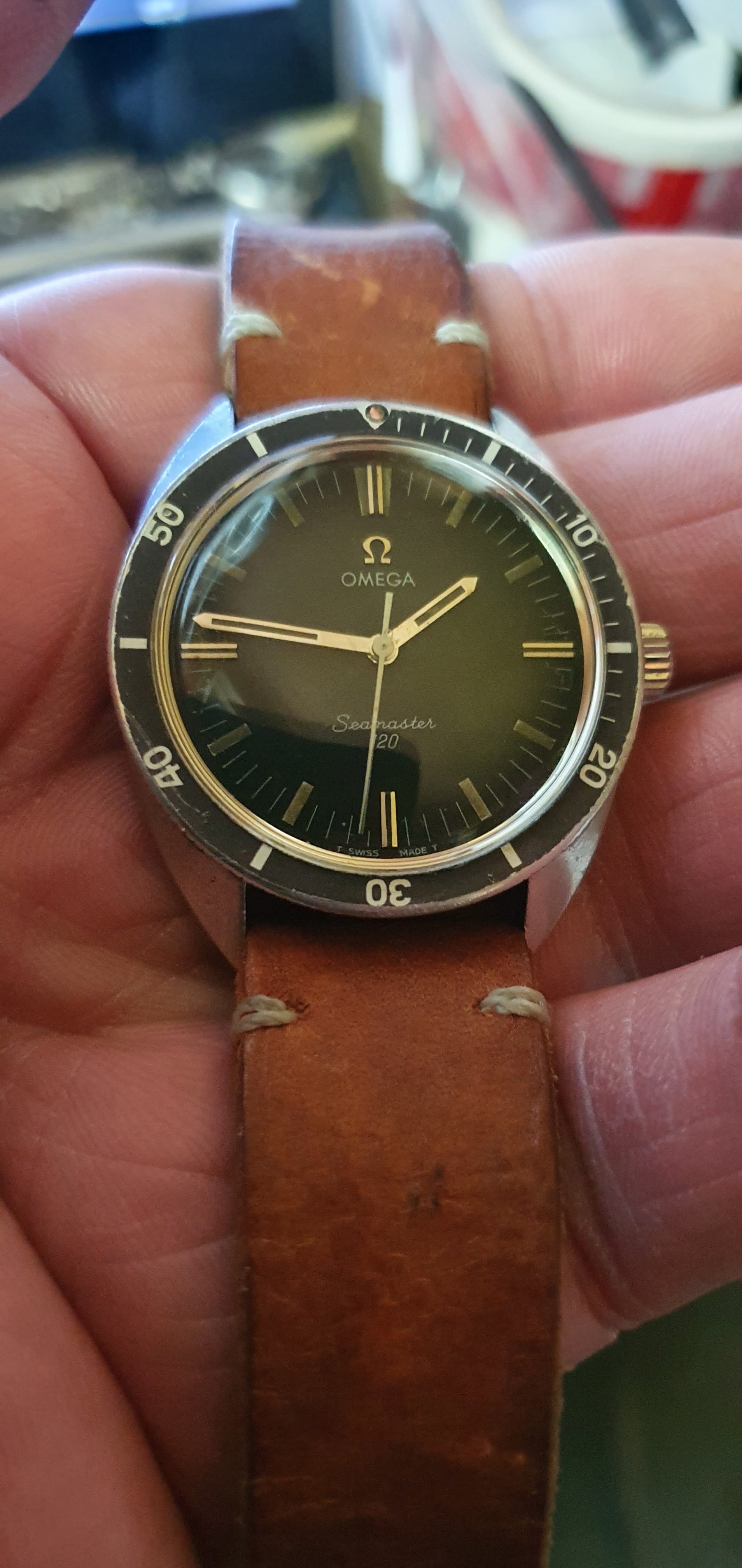

Hi there

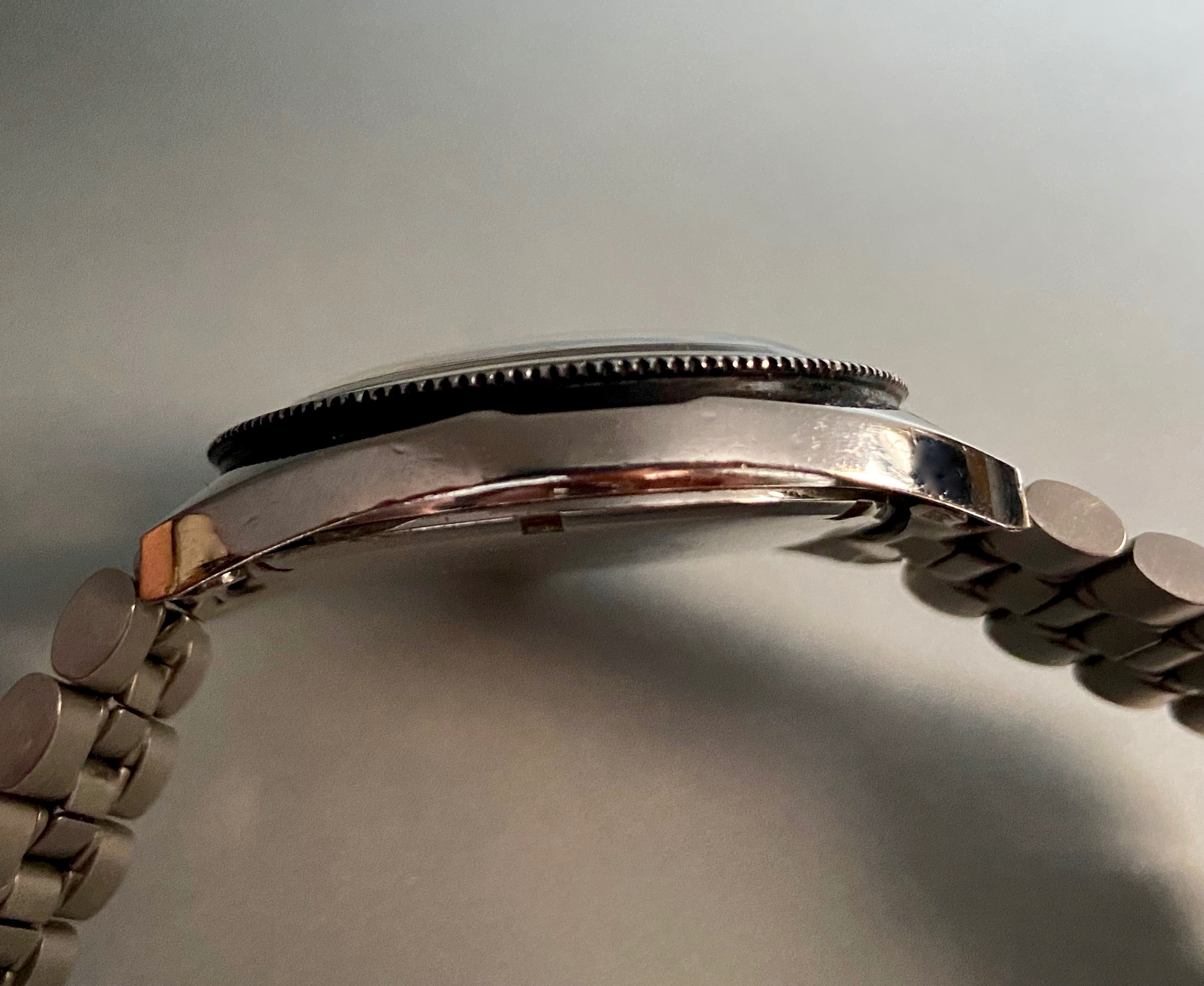

any opinions on this watch? IMHO it looks genuine, white fonts, dial looks good..
168
468

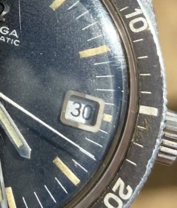

Hi there
It might be the light but the minute hand lume looks more yellow/amber than the hour hand and dial’s own hour-lume markers, perhaps it’s been repaired with new lume, (i’ve had one of the hands on mine done) the old tritium cracks and falls through, sometimes it can make it’s way down through the date window and into the movement, apparently, although i’ve not witnessed it happen, it sounds logical, apart from that it looks lile a nice watch, a few photos of the movement are always handy as well just to see if there’s any burred screw heads or rotor scraping occurred, which would be beyond my experience to diagnose but more of a reassurance if those wear indicators are absent
168
468
Hi there
It might be the light again but the applied surround on date window usually has a vertically central raised apex type of edge to it, (there's probably a more elegant way of describing them) as seen here on another member's example, visible by the light and shade:
But it's not visible in the photo of the one you posted, not to say it isn't there, or there may be pieces that have a perfectly genuine different applied surround, but thought i'd mention it, maybe somebody else can comment on it to confirm it or otherwise.
All about the detail, doubt it until there's nothing left to doubt

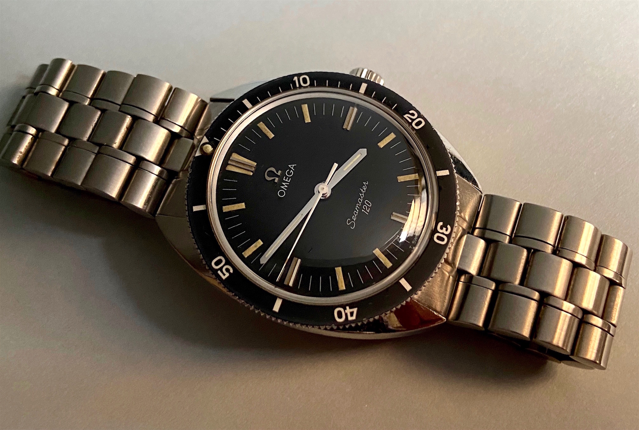

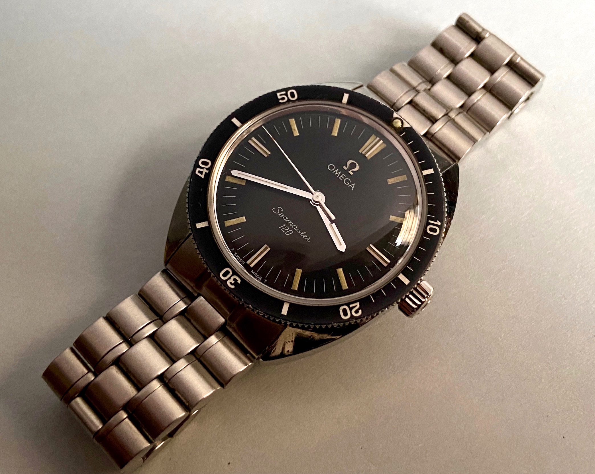

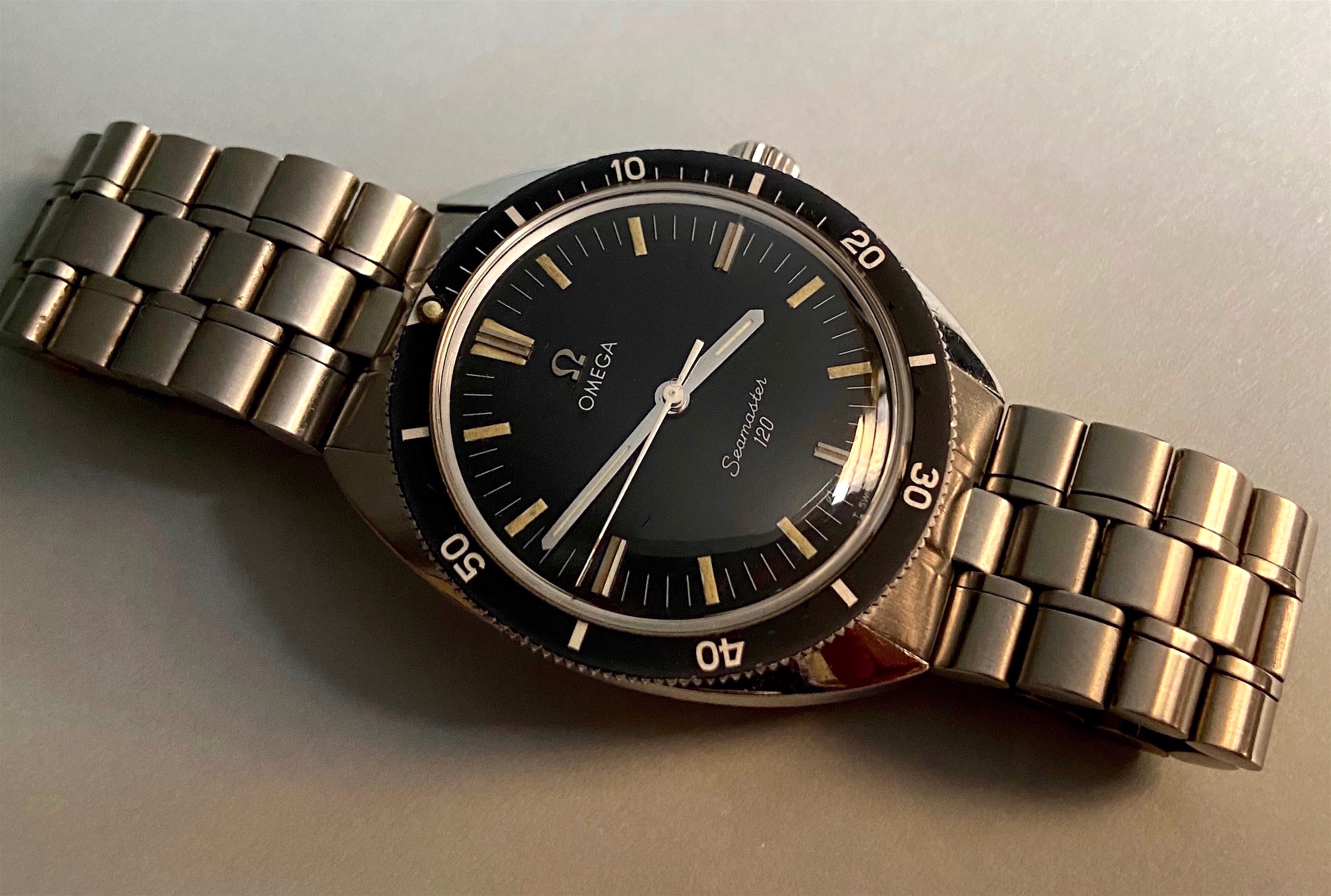

Another landed. This time with the black date disk and a wonderfully sharp case.
326
558
What a fantastic thread, it has really opened my eyes. Can I just say I am sorta sad that this this thread is 45 pages long. So many fakes out there. I do however feel more equiped to navigate the minefield and hopefully not be burnt. Well done to all contributors.
1,177
1,757
Wow
Can I call dibs on this please?
