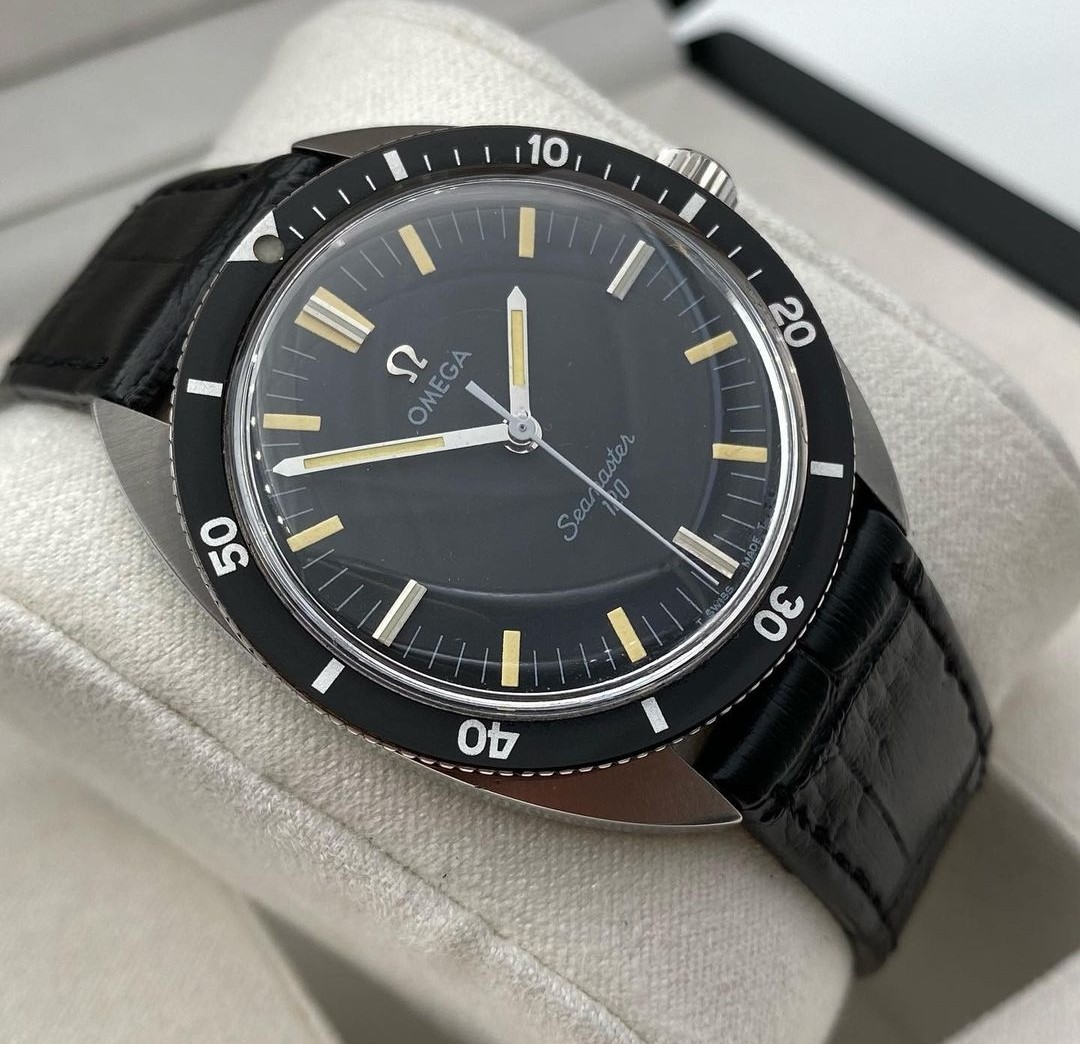

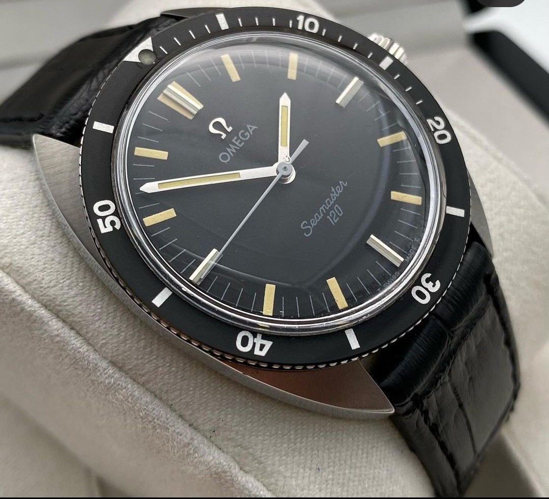

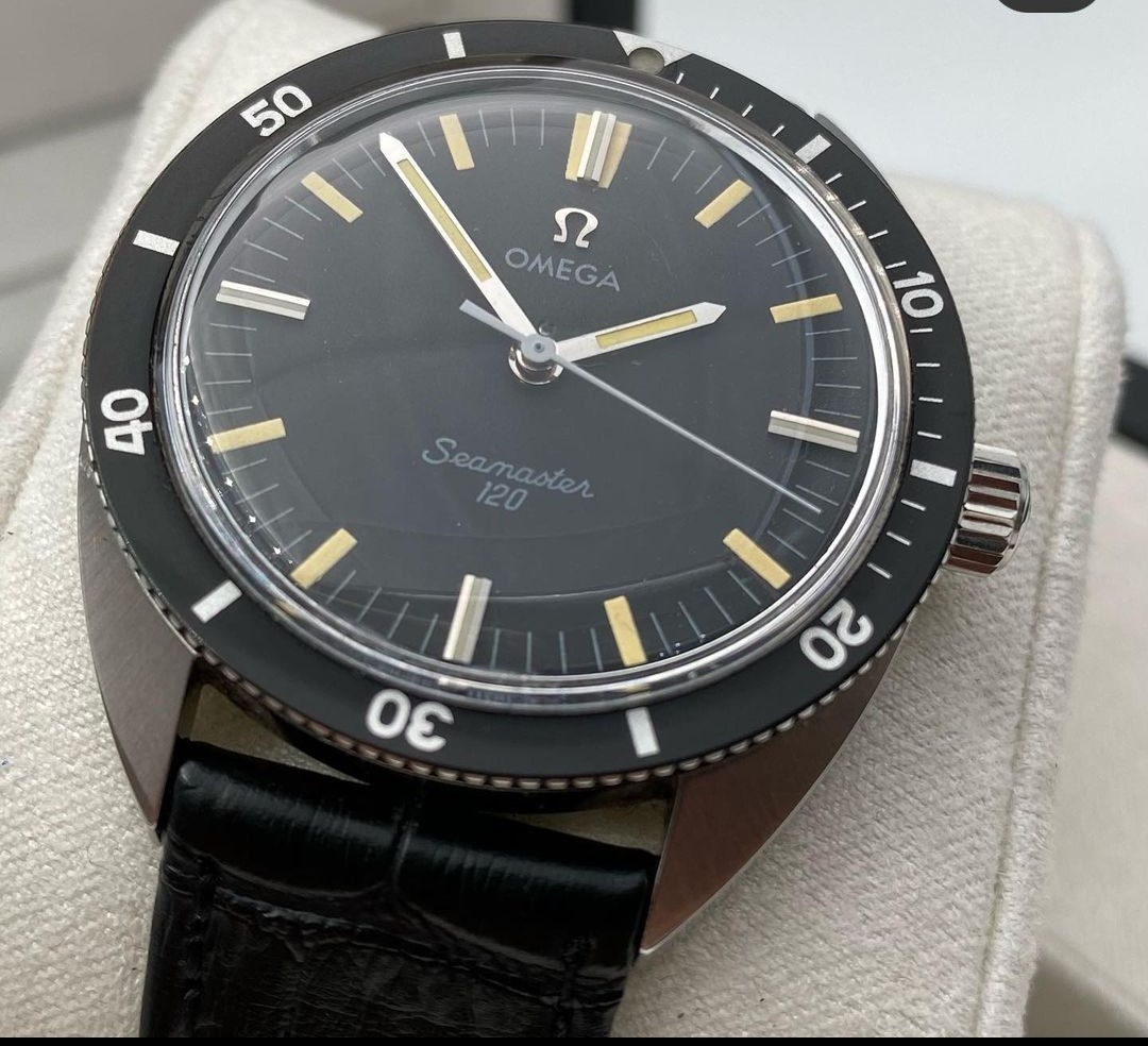

Hey everyone! This seems to be one of most comprehensive and useful threads on the forum, which I've only recently discovered! Lovely read and many thanks to all contributors, particularly the OP馃摉

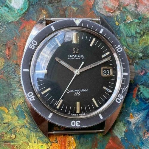

I've come across the Sm 120 below. While it looked beautiful and quite attractive, there are a few dodgy things I've noted, which you can find in the bottom of the post.
- The way Seamaster is written: m has the starting line so not a "Seanaster" but doesn't have the tail on upper left. I've noticed that in this model, t is smaller than neighbouring s but in this model, t is higher. Finally, r didn't feel right.
- The colour of the font: just faded, wrong or also plausible?
+ Apart from above, I believe that the font used for Omega and Seamaster 120 parts are overall ok for its time. Also the bezel seems to be right and fine. Tritium lumes looked lovely. If it passed the "dial screening" I will go on to the movement and case back checks , so waiting for your comments 馃榾

Hi Winston - the font should be bright white. I'd be leaning towards a fake dial. I can't tell 100% from the photos - but the sides of the case should have a notch at 3 and 9, typically on the fake cases those areas smooth. Maybe ask for photos of the sides of the case? Id also ask for a shot of the case back as the seahorse is a good way to also spot a fake.

It's clearly fake. I'm surprised you're even asking after reading this thread

@wcm82 and @COYI , thank you guys for your valuable comments.
I was indeed suspicious and thought that this one is to be rejected on similar grounds as the one in page 28, note the fade grey font and t taller than s in Seamaster (post below). But the seller is somehow a "trusted" one and I just wanted to make sure. Also, I think the more we see examples like these the easier we can track fake trend patterns in the market, just like this one.

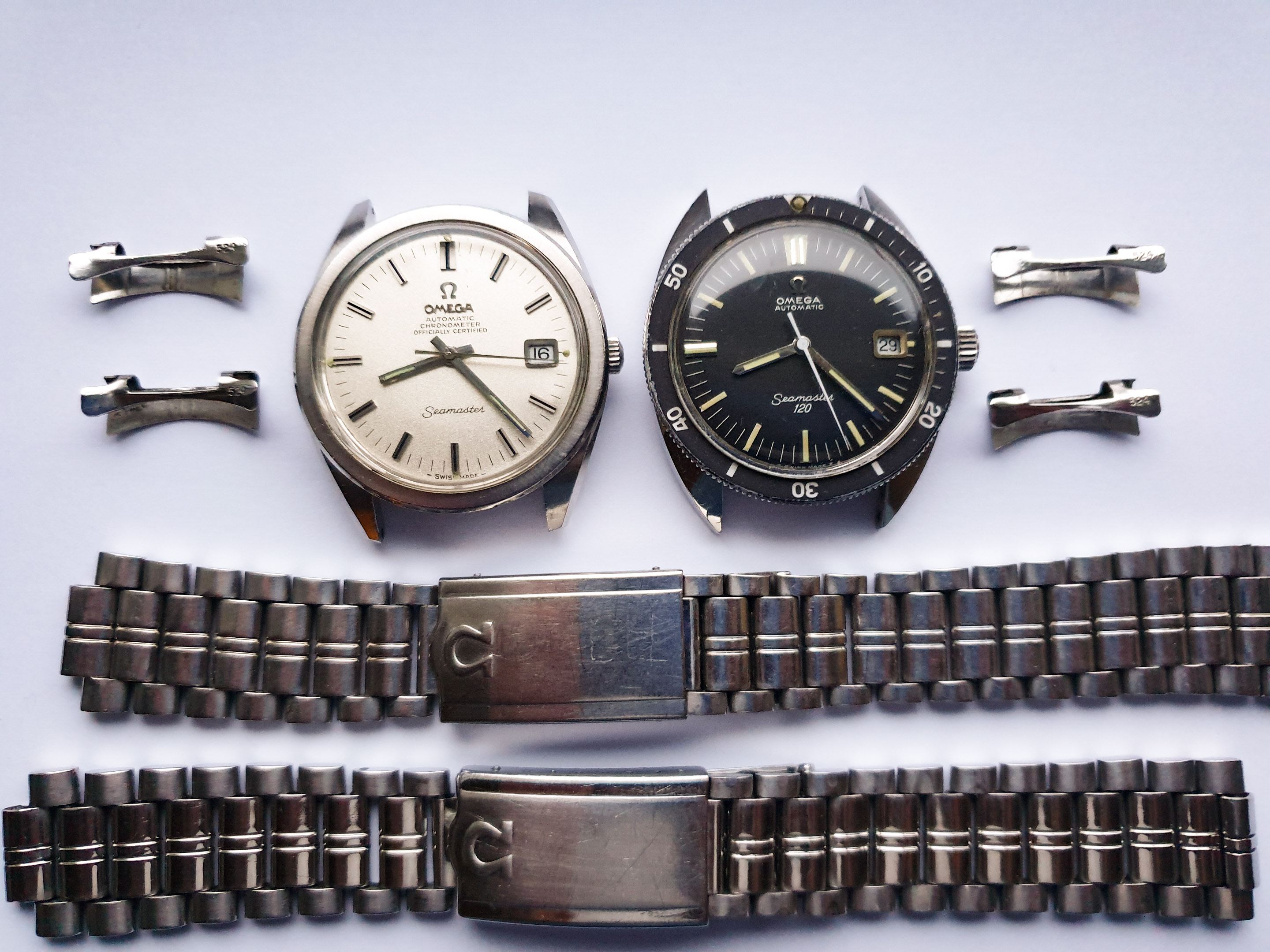

I love revisiting this post to see all the examples of my favorite Seamaster. Now I have to find a 1069.
Too late, I got all of them 馃榿
They show up every now and then but I find it much harder to get the 524 end links.

Wow that Seamaster on the right sure looks great with that dial! If you don't mind - what's the model number?

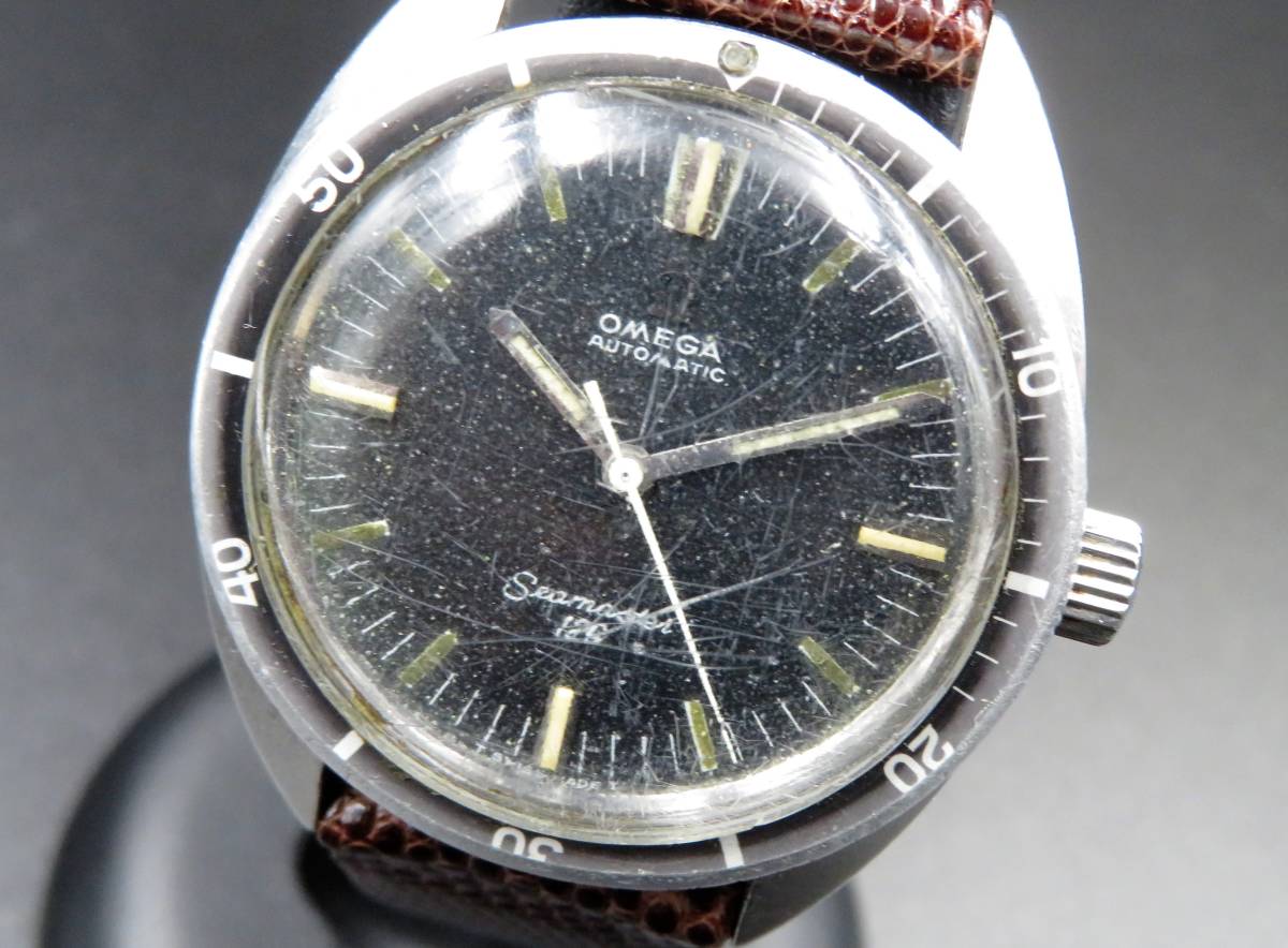

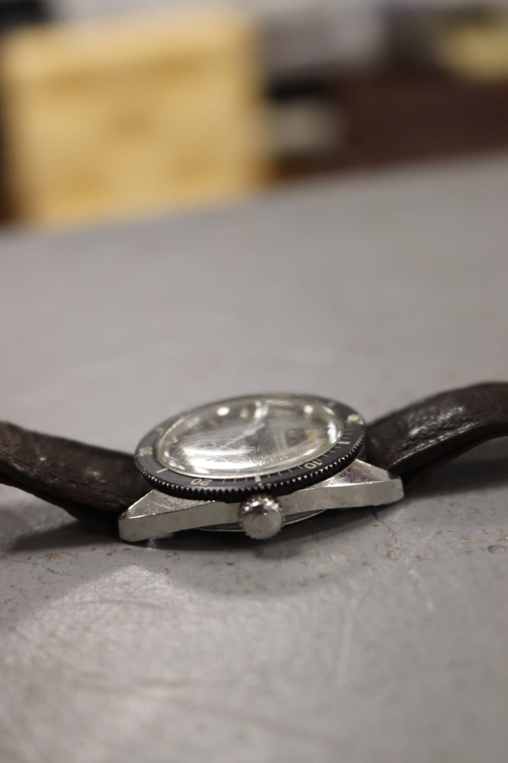

Hi all!
Very nice thread I just found looking for info about this piece : it鈥檚 a local auction, reference not even given...
These pictures are already what I got after asking for better pics so it won鈥檛 get any better. It looks nice and I touched from here but I鈥檓 not familiar with these 120鈥檚 so maybe I鈥檓 missing something and time is too short to read this whole thread before it goes...
What ref is it? Is it worth pursuing? Up to what point?
Thanks for any help!馃榾

It looks ok but this is the smaller 31mm diameter model 565.007

Ahah thanks! Size in not even mentioned and I guess it matters here! 馃槜

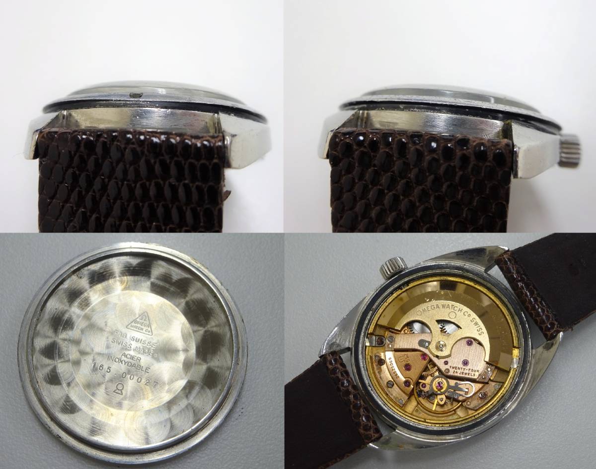

Once again, thanks for this thread - another auction going on for a 165.027 - thanks to this thread I was able to verify it's original (mainly the 3-9 notches sealed the deal), but since it's automatic, without a date, it went out out of my budget curiosity buy range
It concluded for $965 by the way - so after all, there's still hope for sub $1000 Seamaster 120's - don't let this worn images fool you either, there's a 50/50 chance the buyer is going to flip it in the next 2-3 weeks on Reddit with a little polish for $1790 minimum

Out of curiosity, what is the market for a 1069 bracelet with 524 endlinks? I bought a watch as a gift that has a full length 1069 bracelet, but I'm going to sell the bracelet to offset the cost

And to answer the question, I personally paid my bracelet just above a 100 euros if that may help

100 euros is a very good find honestly, even on Japan where Omega prices are below worlwide prices, in demand steel bracelets usually exceed 200's - I personally bought the watch I bought expecting $250 net from the bracelet
A 1069 / 524 sold just over a month ago on the forum, asking price was $800 USD.

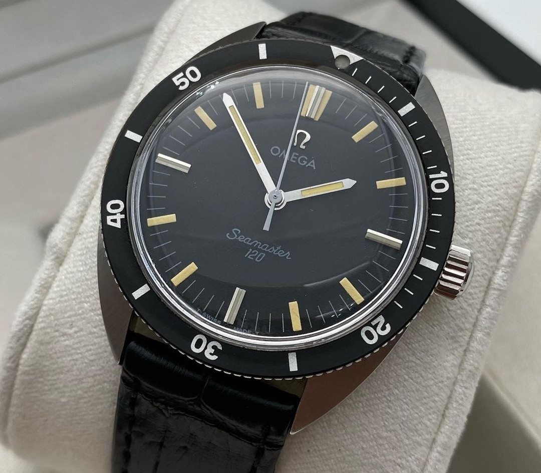

There's a new 120 on Reddit, seemed ok to me and it's ok priced as well, suprising for Reddit
5,026
18,608
That one has been sold and relisted a few times but the same seller- not a good sign
Yeah. The Brasil one. Very strange...
