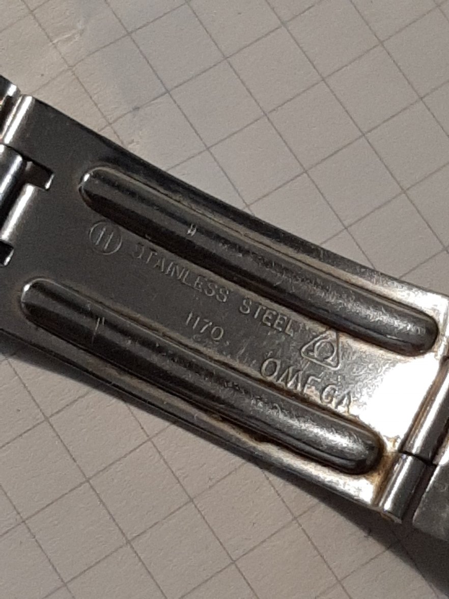

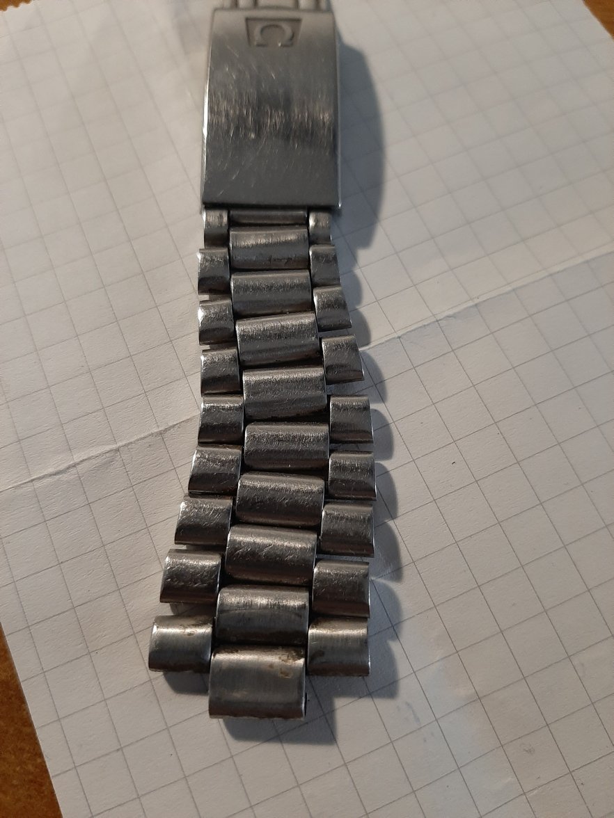

Hello,
When my dad bought his Speedsonic back in the blooming '70s the watchmaker didn't give him the Lobster bracelet nor the Corfam strap, he gave him instead the watch mounted on a 1170 bracelet. He wore it in this unusual configuration for 30 years and then the watch arrived to me. I studied a little and saw the it was unwitting. Now I wear the Speedsonic with a good strap looking for the original Corfam one, but I still have the 1170 and I want to wear it as well.
Is there someone so good to know where the 1170 bracelet goes? Which models? Which endlinks? I would be very grateful as it has a family story and has always been with my dad and me. Thank you!

Sorry for the terrible formatting of this, but here is what I have on the 1170 bracelet, the respective endlinks and the models they attach to
________
604 Endlinks
22 mm
1170 Bracelet
Models: 166.064, 166.065, 168.034, 168.035
________
625 EL
22 mm
1170 Bracelet
Models: 145.007, 145.008, 145.019, 145.020, 165.066, 145.0019, 145.0020
________
626 EL
22 mm
1170
Models: 166.092 166.0092, 168.005
________
640 EL
22 mm
1170
Models: Seamaster 200, Seamaster Deep Blue and various other 'chunky' Seamaster models from the 70's. 145.0022
________
653EL
1170
Models: 145.029, 176.001, 176.007, 145.0029

Here is text I copied from Ofrei website ages ago when I was looking for end pieces for my 1170.
"Omega Bracelet 1170 is Discontinued and No Longer Available
Used on case numbers:
145.007, 145.0007, 145.008, 145.008, 145.019, 145.0019, 145.020, 145.0020, (end piece 625)
145.029, 145.0029 (end piece 653)
166.064, 166.0064, 166.065, 166.0065 (end piece 604)
165.066, 166.0066 (end piece 625),
166.068, 166.0068 (end piece 631),
168.072, 168.0072 (end piece 618),
168.073, 168.0073 (end piece 634),
166.092, 166.0092 (end piece 626)
168.034, 168.0034, 168.035, 168.0035 (end piece 604),
168.0050 (end piece 626),
176.001, 176.0001, 176.007, 176.0007 (end piece 653)"
This bracelet reference 1170 has been discontinued by Omega, and after replaced by the reference 1171. "
So a few more options 😀

Folks,
Does anyone know what endlink will fit on on 166.0132? (I know it was originally a strap watch but looking at options)? I am thinking 633 as it seems to fit a lot of watches but also possibly a 677?
Peter
84
118

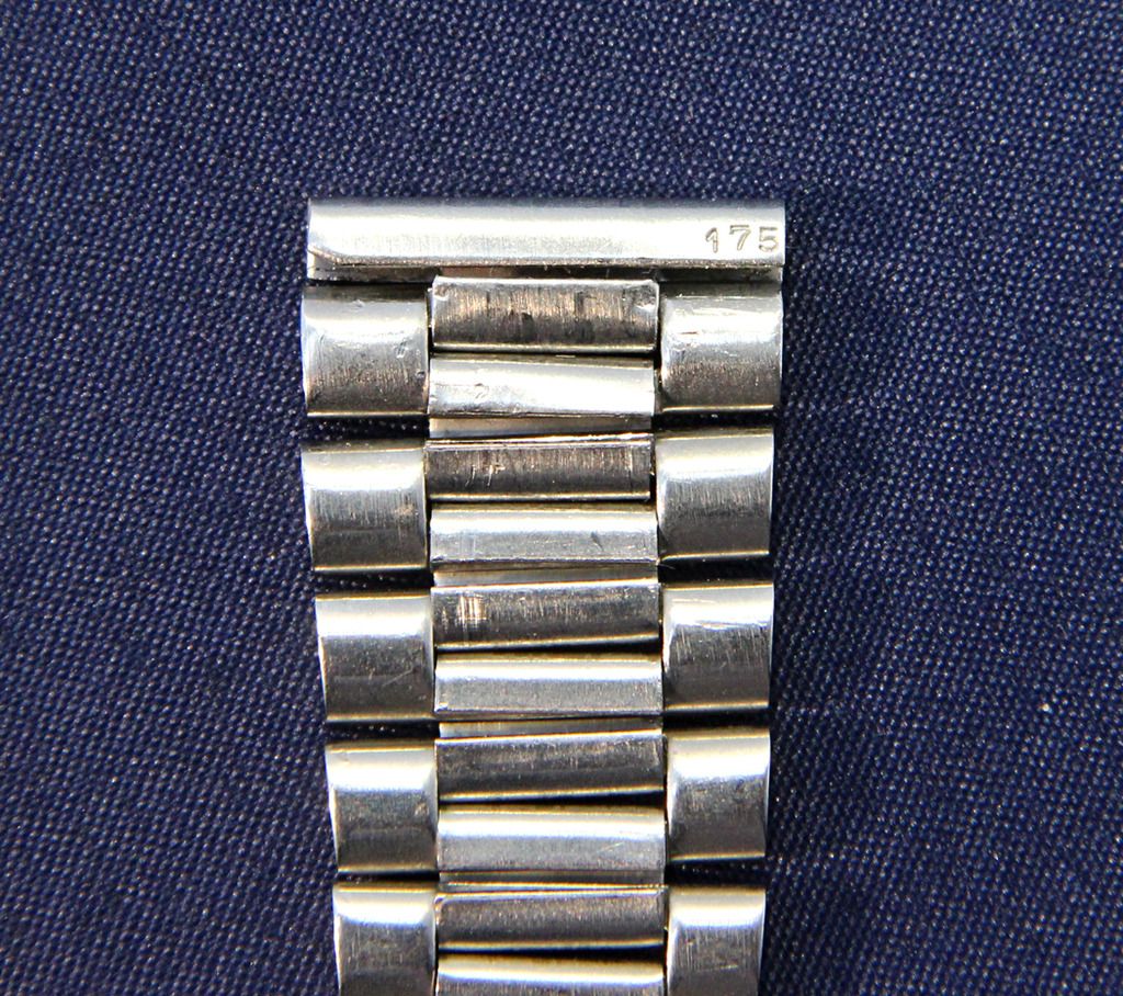

It looks like 175 end links came attached to the bracelet from factory - unlike 633 which attach to the baracelet via a spring bar
*pictures taken from google search

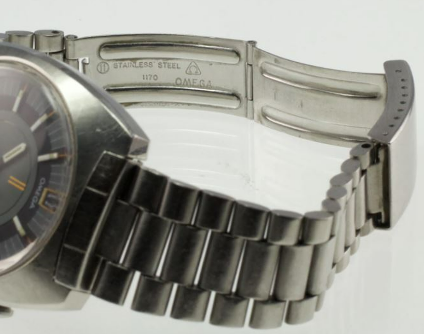

The 1170 with 618 end links is also the original bracelet combination used for the Seamaster Memomatic ref. 166.072.
82
152
Also works at 176.007 and 176.001 with 625 end link - however to my knowledge this combination never was a genuine, period correct omega combination (625 came with 1162)
