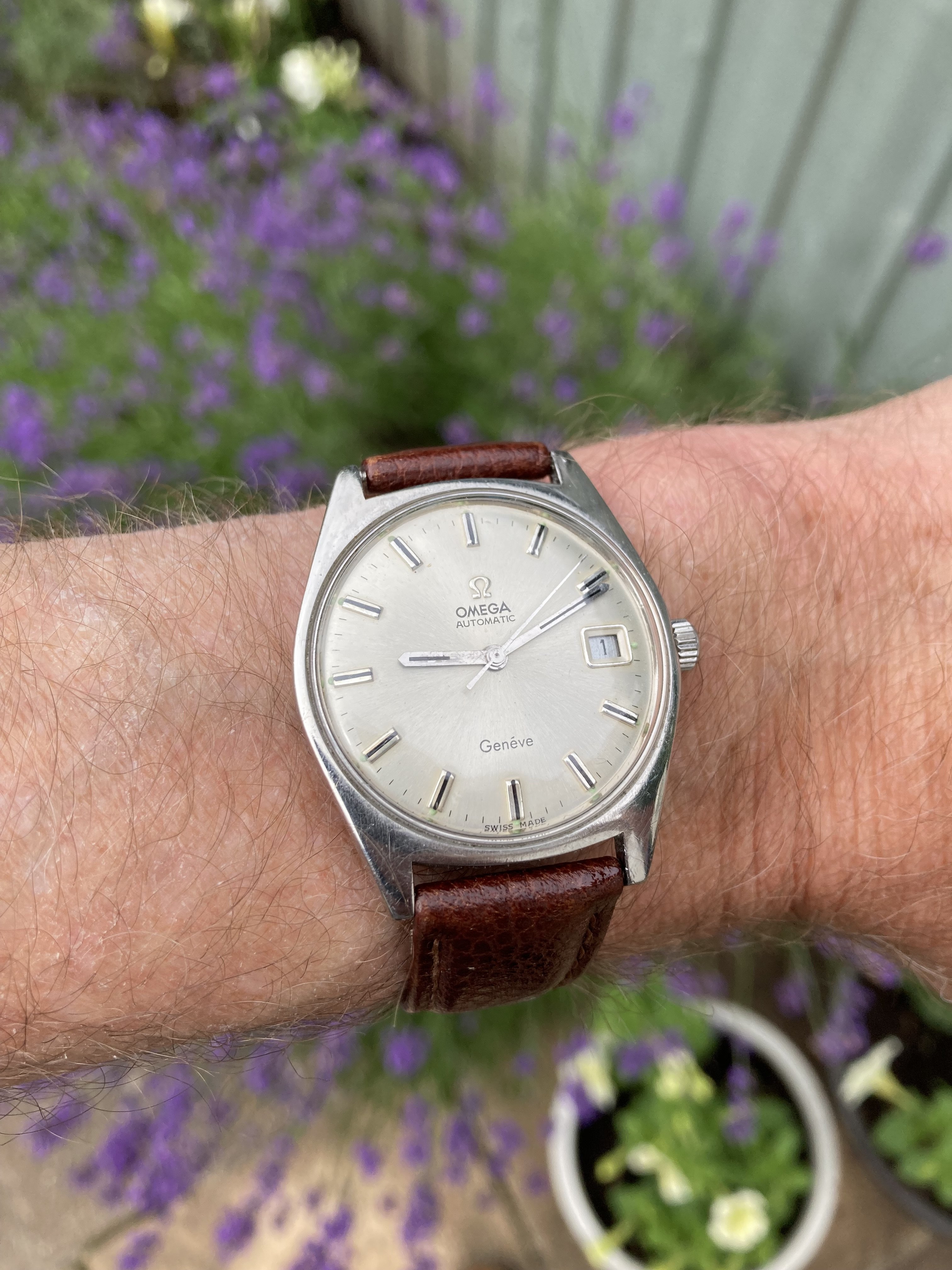

Hi Everyone,
I’m new here. Somehow the winding stem was broken, so but I’ve no idea about the calibre of this watch. Can anyone advise please? Dont have any tools to open up the case back and see. Appreciated.
Cheers

Welcome to OF. You might have a caliber 610 inside (corrected below to 56x), but it would be hard for anyone to confirm that without opening the case back. If a piece of the old stem is still in there, you would have to open it anyway, so I would do that now (or take it to a watchmaker) before ordering any parts.

Likely cal 56x: 562, 563, 565.
Not a 610 which is a hand wind.

thought this should be cal 565 in respect of the omega logo and text etc.

It’s probably a 166.041 with, as mentioned above, a calibre 565 movement.
Although the caseback unscrews and you can use a rubber ball unwinder, as I would, obtainable on eBay, it rather sounds to me as though you should send it to a watchmaker local to you.
If you let us know where you are, someone will be able to recommend a local watchmaker. It’s not just a case of buying and fitting a correct new stem, there may be other issues that show a need for re-alignment and adjustment and these are such good watches, it’s not worth f***ing it up if you don’t know what you’re doing.
The fact that you didn’t know the calibre or case model suggests you are, at best, inexperienced.
A service should cost around £150 plus parts but you should use someone who knows what to do.

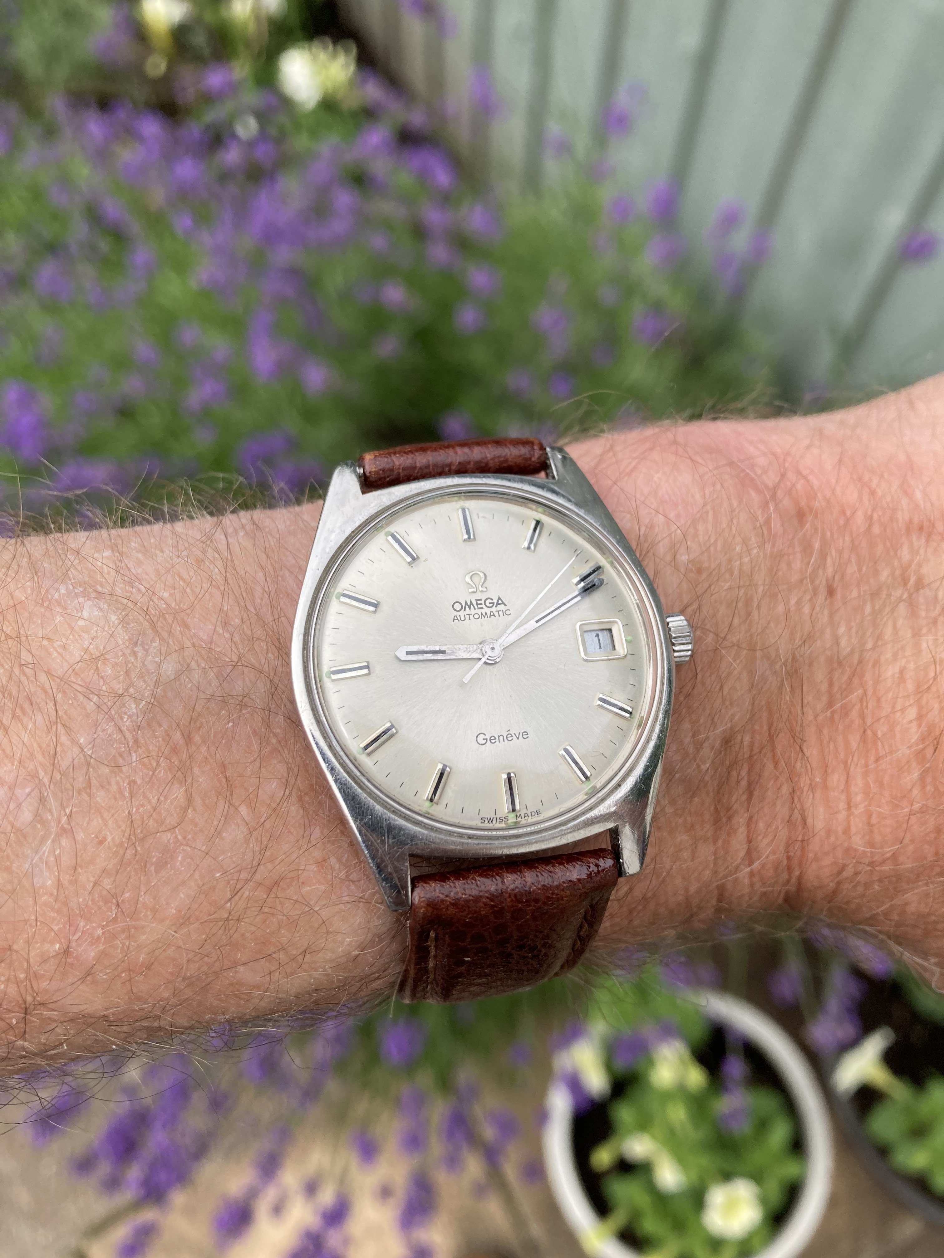

I have a similar model
Wow…yours look great indeed.
