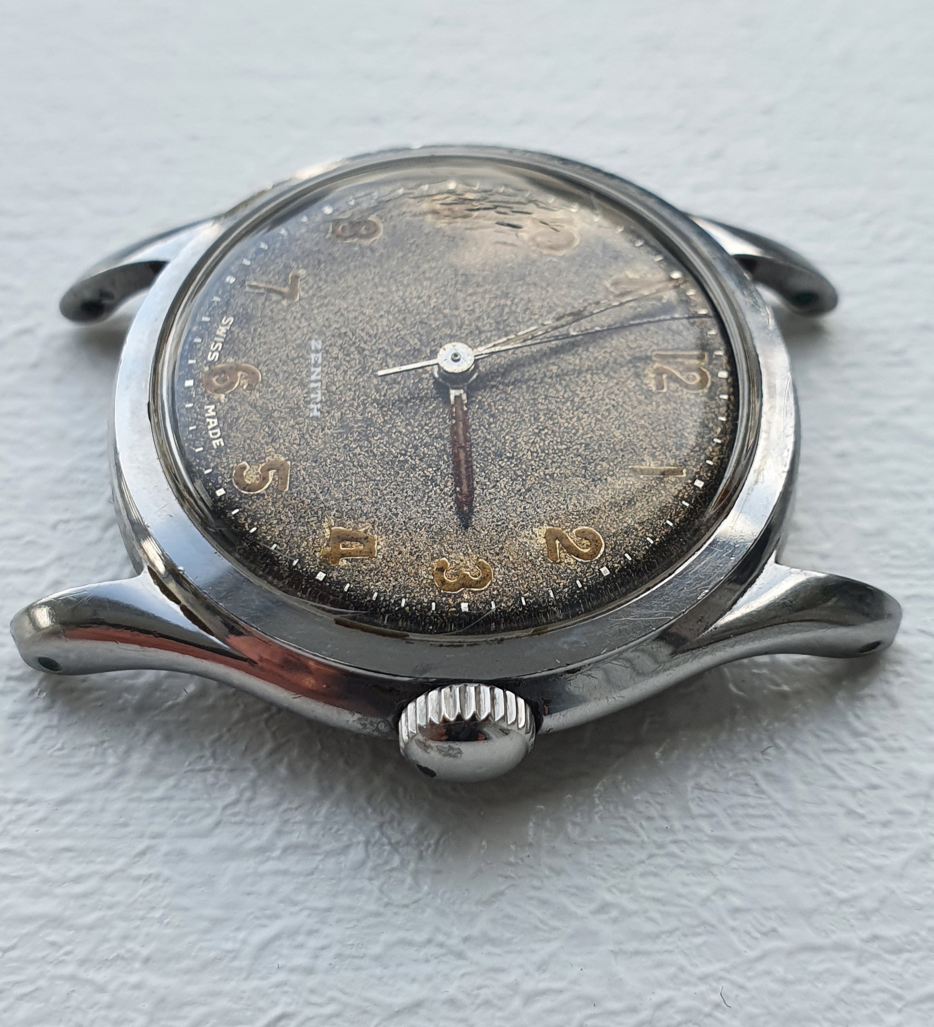

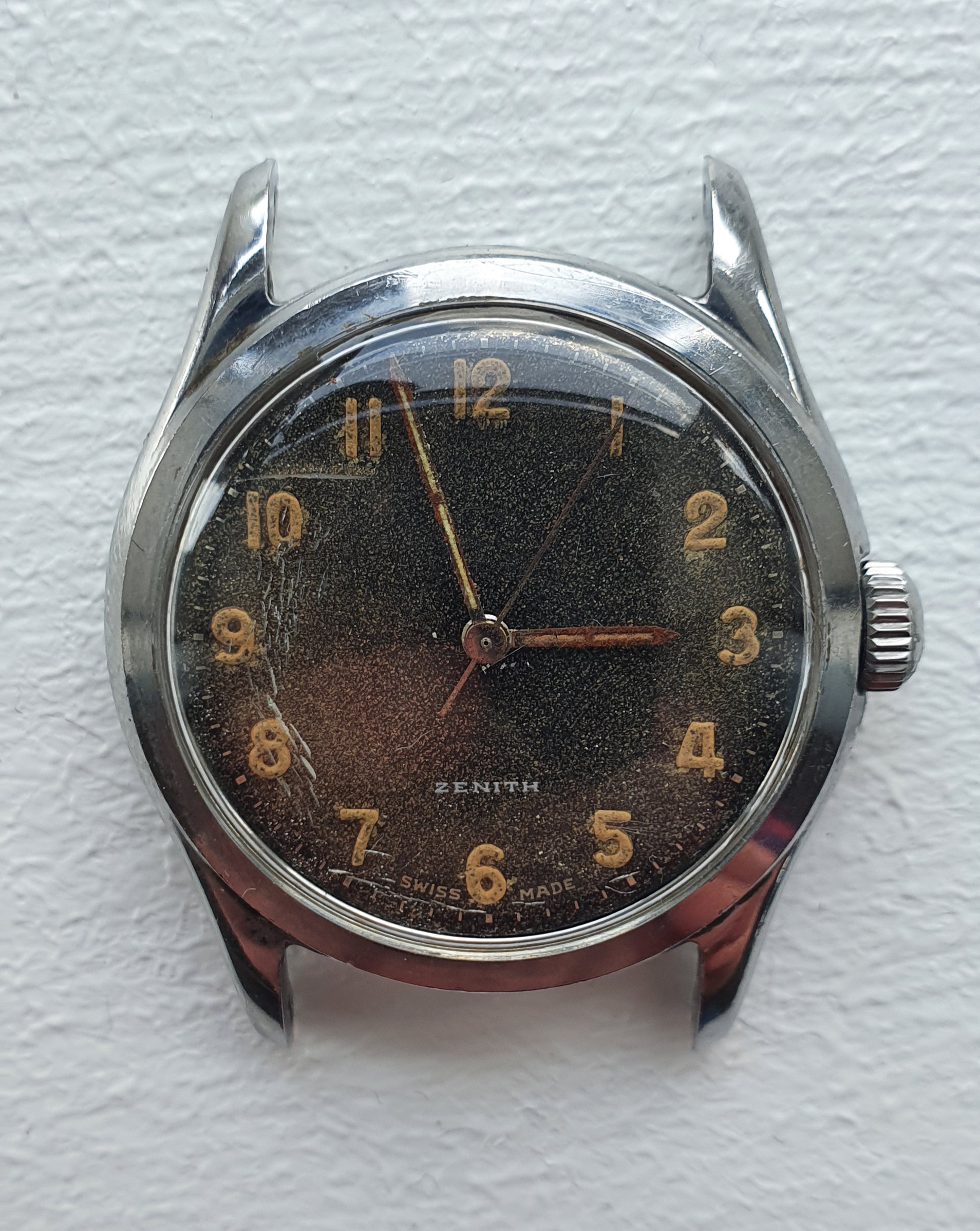

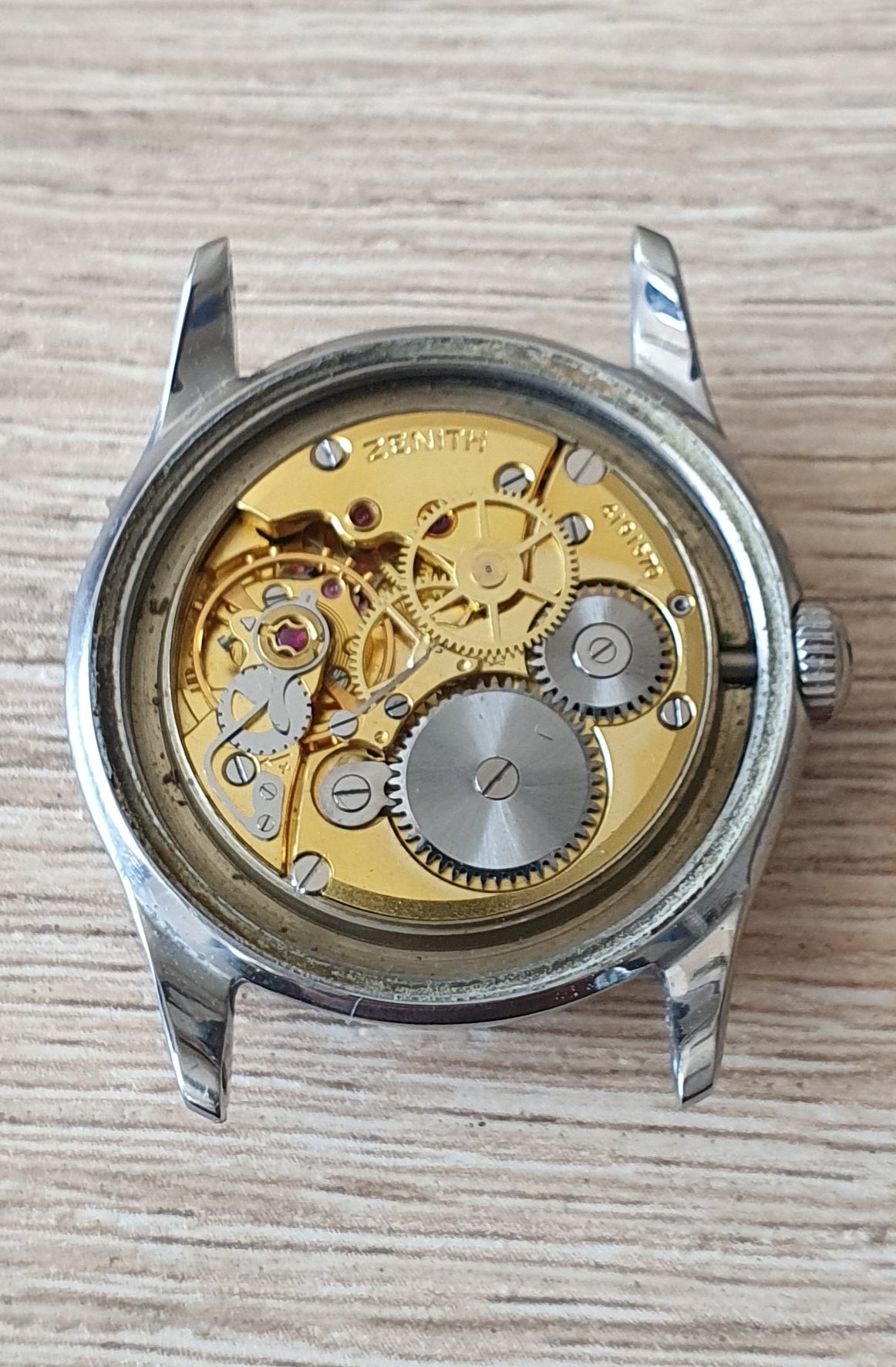

Can anyone help identify the movement in this Zenith 'military style' timepiece dated from 1953?

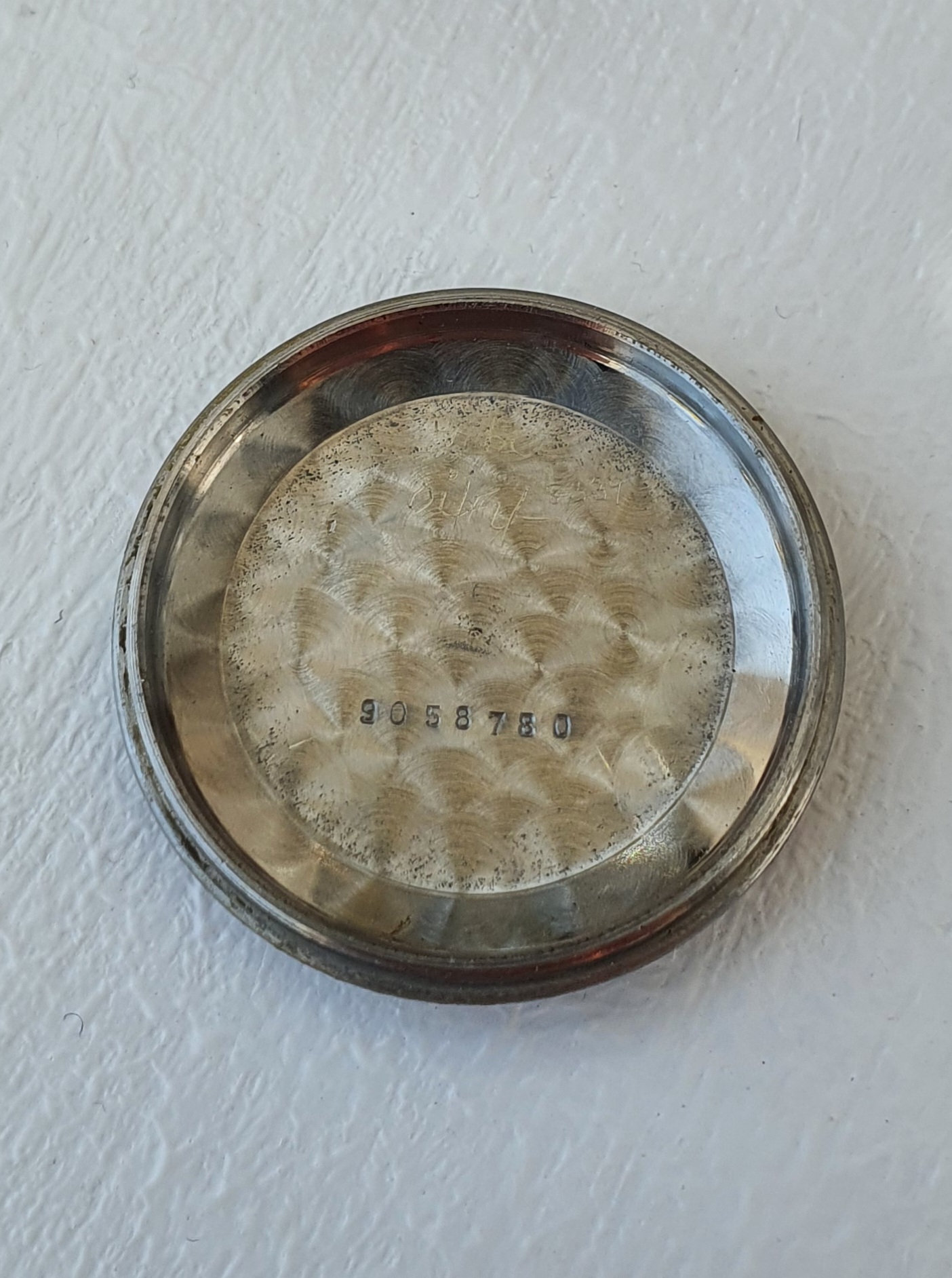

I can't find any Cal identifying marks on the movement and the case back number didn't appear to refer to anything specific?
Let know if any further more detailed pics may help?

Please google watch movement database.

I'd also like to source a replacement crystal but not sure where to start as there is no model number on the case.
The case is approx 32mm. Any ideas about where to start with sourcing?

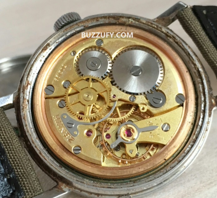

Looks like a 106-50-6. Look under the balance wheel. Often the number there
188
170

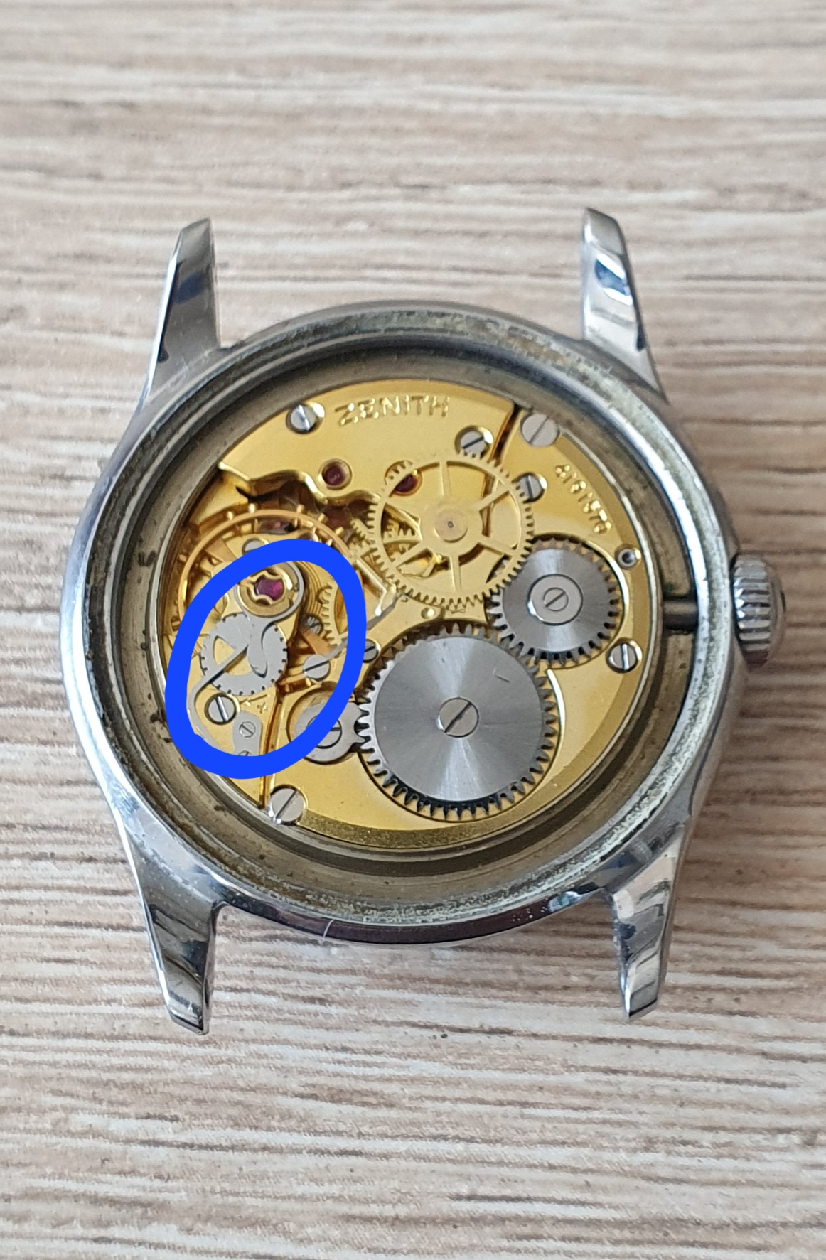

I thought that at first but the parts circled is different?

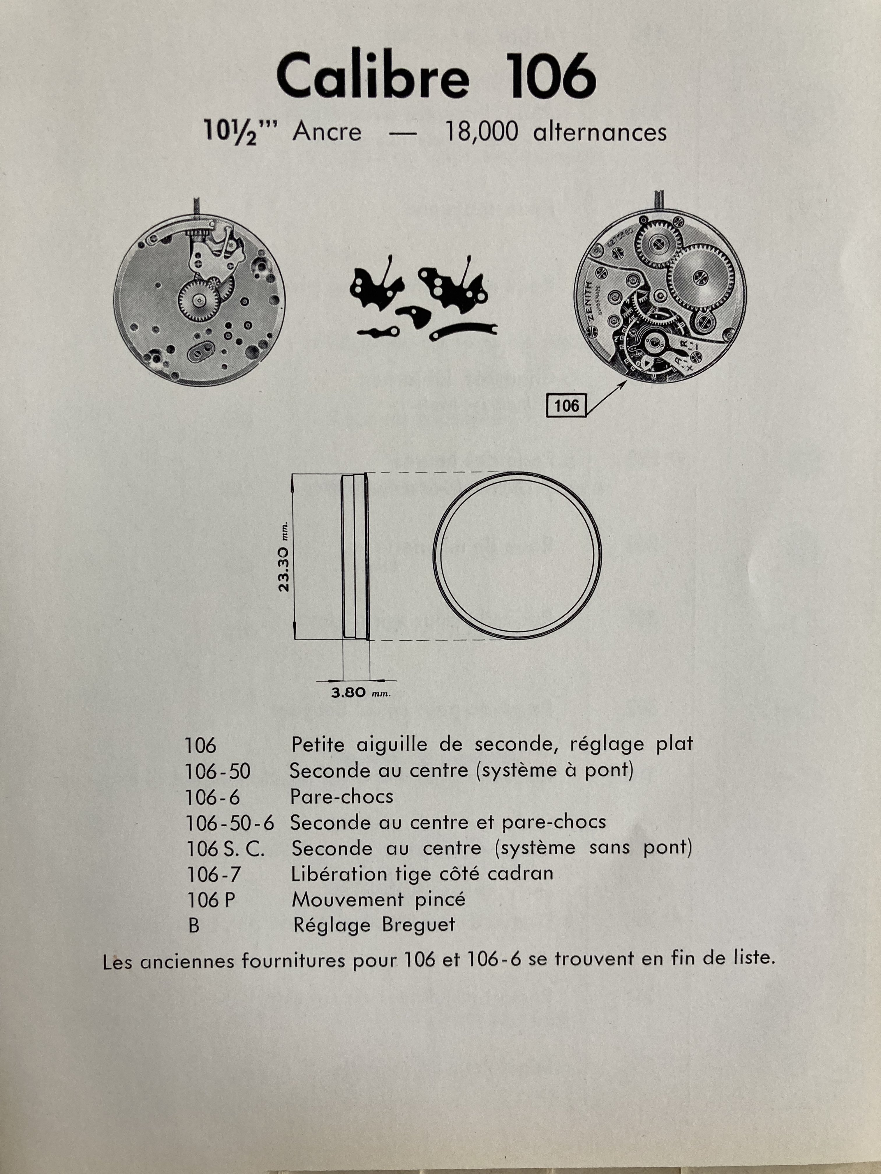

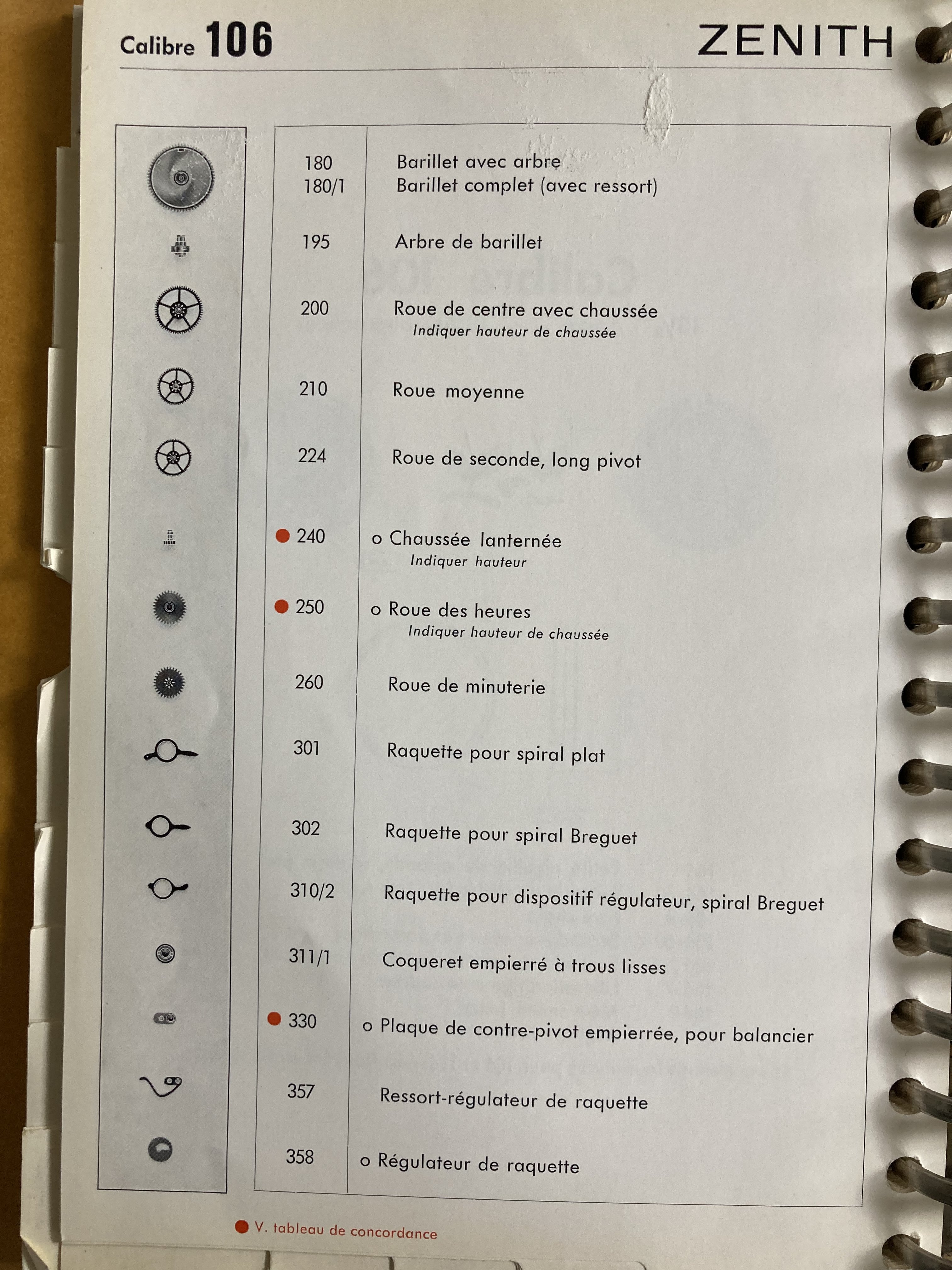

Look at the pics from their parts catalog. Numbers 310/2 and 357 were part of the 106 series
Thanks for taking the time to clarify this for me 馃憤.
