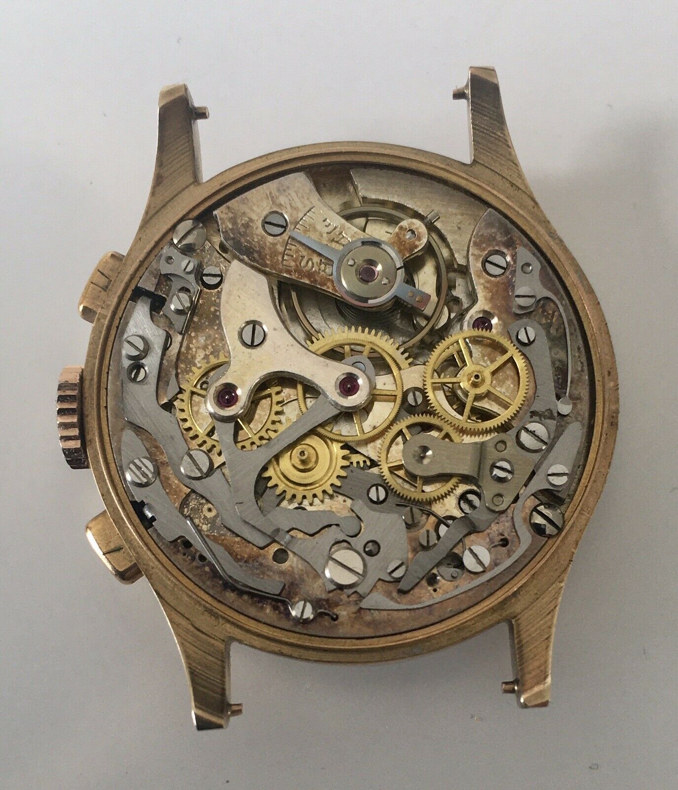

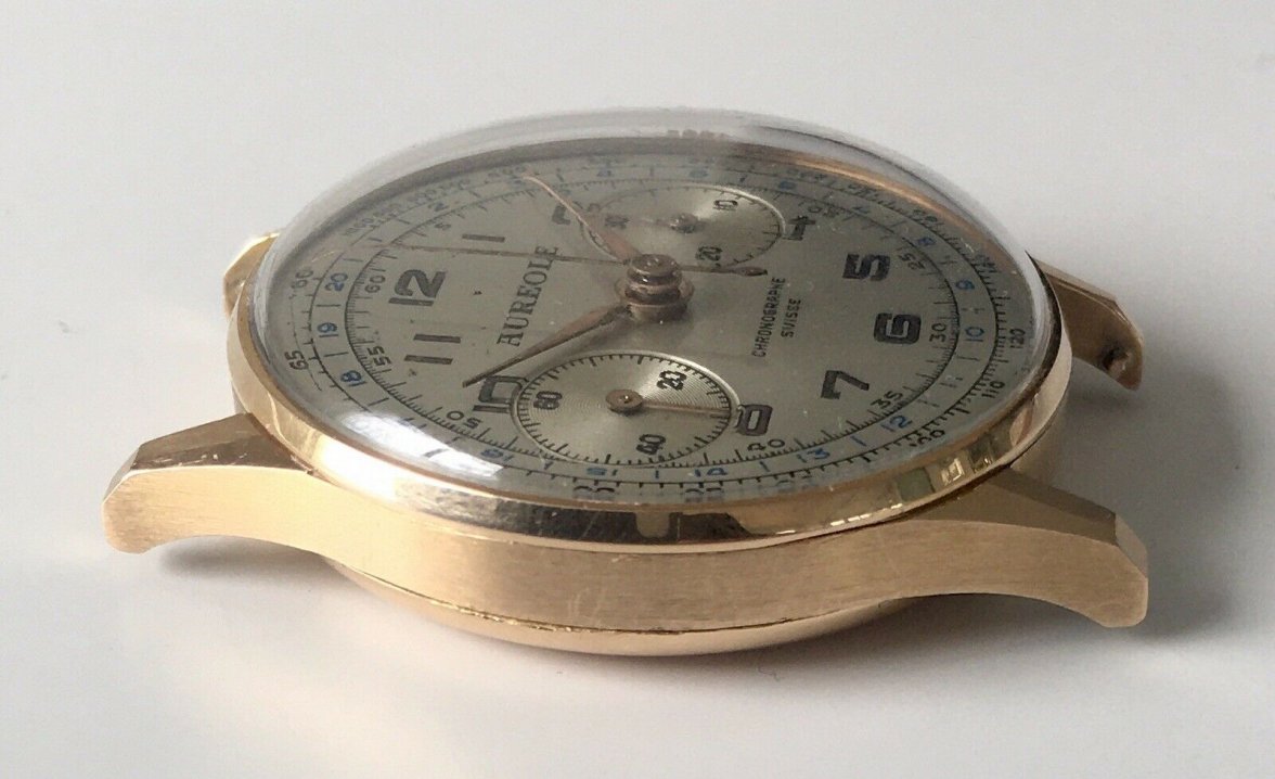

Is anyone able to identify this movement? Seller claims unmarked but I daresay someone with a keen eye will be able to identify.
Additionally, regarding the staining on the movement, does it look to be superficial (and can be cleaned) or does it appear to be corrosion? Would you guys take the punt?

Landeron 50.
None of the steel parts are rusted so I suspect it's only tarnish that will clean off if done with care.

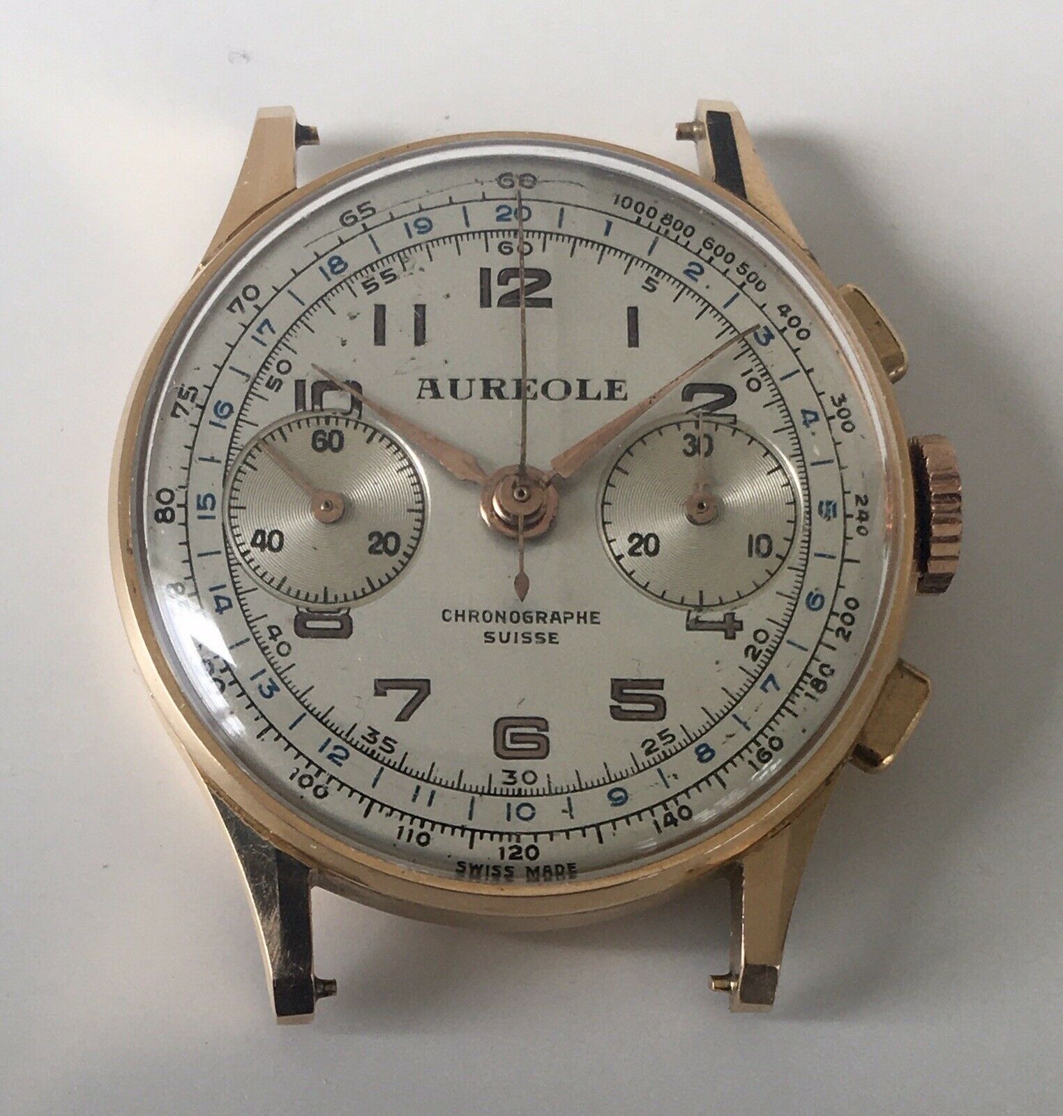

Based on what I'm seeing, I going to guess it is a Chronographe Suisse variant.
I thought that as soon as I saw the lugs. Start your search for spring bars now, let me know if you can't find any.

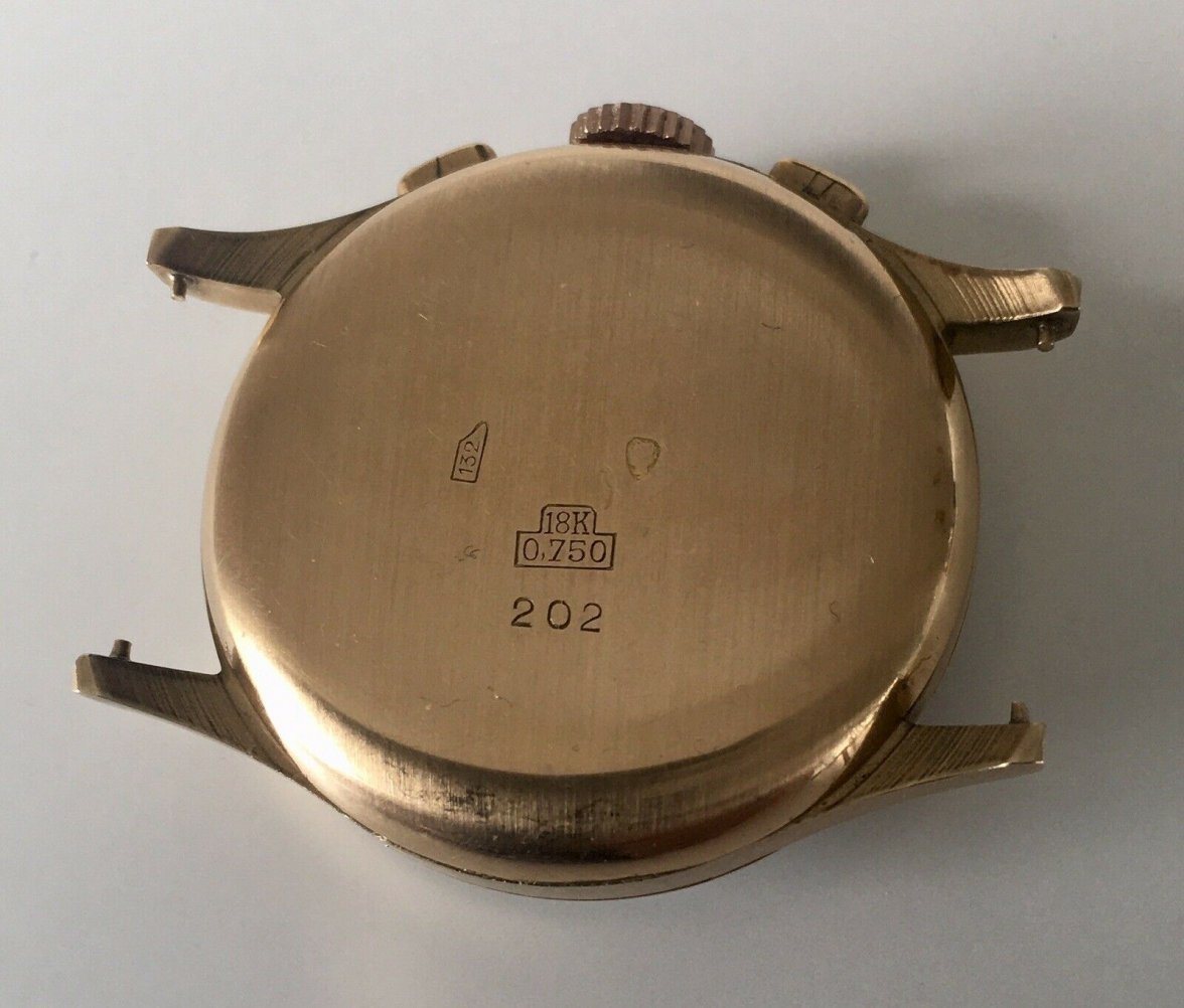

Be careful when you fit the bars, female bars can need some persuasion, more than one CS has been destroyed by clumsy bar fitting as those lugs are likely paper thin and are easily distorted. Was there a brass inner caseback? Those add a lot of rigidity if so.

Congrats on winning the watch. As noted, the lugs are hollow, so you want to be careful.

Appreciate the heads up @padders and @Dan S. From the images provided, there didn't seem to be an inner caseback. Fingers crossed it does come with one and was just omitted from the photos. Excuse my naivety (I am very new to all this), but until you mentioned it, I didnt even consider there were male and female bars - I think I will reserve this fitting for a watchmaker. Do either of you two own a CS per chance, or do you tend to steer clear for the reasons noted above?
Last one from me - just out of curiosity, for this particular watch, how much would you you expect to pay? For reference, I paid just under $900 USD.

The CS cases usually have a heavy (brass?) cover inside the case-back. I always assumed it was to add heft to the case, which would otherwise feel flimsy. But perhaps it provides structural integrity as well, as @padders suggested. I've never owned a CS, but I've had the chance to handle them on various occasions, so I'm somewhat familiar with them.

I like these and have had 3 but I have warped one myself so I was speaking from slightly embarrassed personal experience. Prices vary wildly as there are many variations, I鈥檝e seen them go as high as 拢700GBP so I guess your figure isn鈥檛 silly but perhaps not quite a steal. Black dial models occasionally fetch more still. There is a lot of variation in dials cases and movements though, so who knows what is fair for a given combo. This one might not have had the inner brass back so don鈥檛 panic if it鈥檚 not there. There is a good existing thread on CS on here if you search. I鈥檒l try to find some pics of mine.
