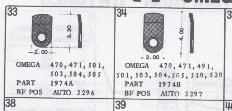

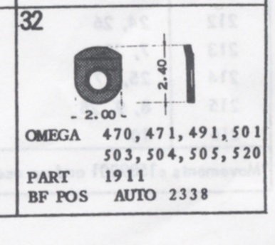

Hey folks,
I’m looking for the necessary movement clamps and the corresponding screws for a 2846, cal 501. Got the movement, the dial and the case, stem, plexi and crown, so that’s the last piece to connect them. Haven’t been successful on my search through the internet so if any of you have some spare parts they’d part with I shall be the happiest man. 😀
As always, thanks a lot for the space @OF!
609
789
The 501 uses one of three clamps, according to case. Cousins UK has all of them. Here are part numbers and length for the three. The Bestfit part number could also be useful for searching
