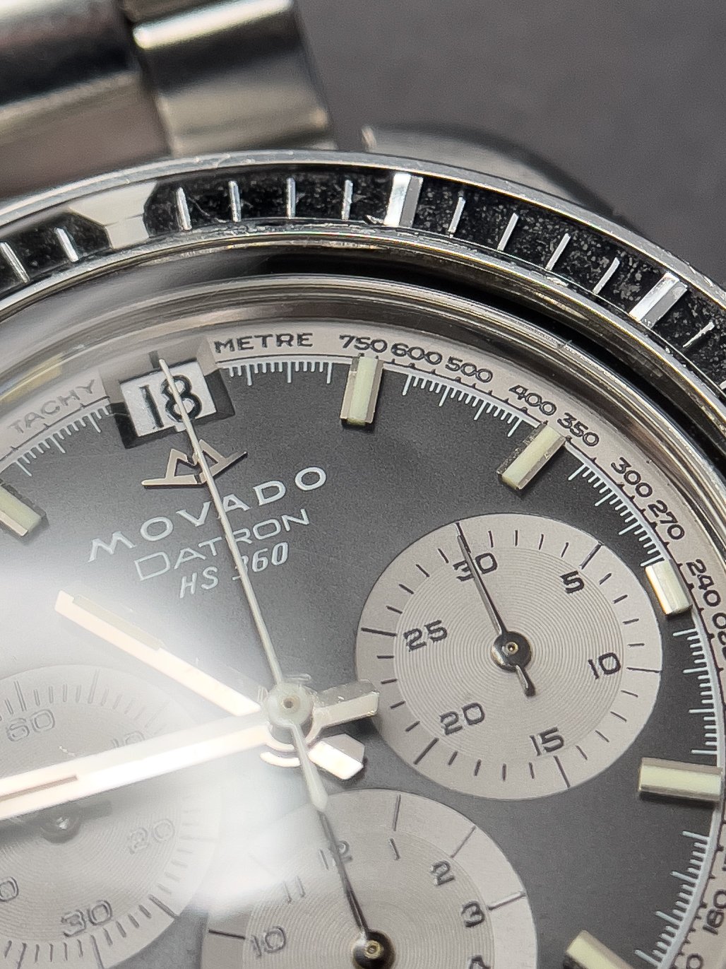

Hey Achim, yeah I remember being shocked at that estimate pre parts. I hadn’t considered or even thought it was a viable option to reach out to Zenith for a quote. To be honest, there was both a lot going for and against this watch. The positives were- it was an eBay auction that went unnoticed and my final bid was ~$2,500 (compared to others on the market being listed around $4k in worse condition and without the bracelet). It had an incredibly sharp case, original full length GF ladder bracelet, signed crystal, and Bakelite bezel condition was very good. The negatives were- it was sold as “just serviced”, which usually doesn’t mean anything to me. However, in this instance, I believe more damage was done as a result of it. The included paperwork for the ~$300 service had an address to one of those battery changing suites in a mall. The chrono hands would “reset” to a random location on the dial and was hit or miss getting them to reset properly. The auto weight would spin around under its own power. But the biggest negative was between the 1 & 2 indice, the dial had an undisclosed inward dent. Not entirely sure what would have caused that as there were no impression marks on the surface. The eBay listing photos were good and the seller provided more when I asked for them, but I realized after the fact that, just like my photo above, the minute hand was in the same place, which hides the dent.
My photos below
Long story short… my attempt to find someone to properly service this was me trying to accept/live with the dent given the rest of the condition and purchase price. However, with the taste left in my mouth from the whole thing, it was just easier to return the watch.
