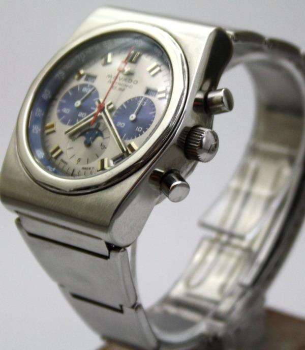

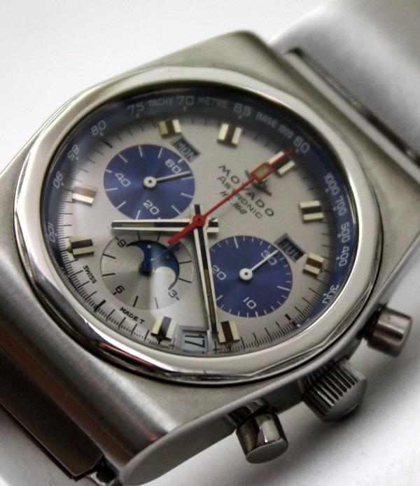

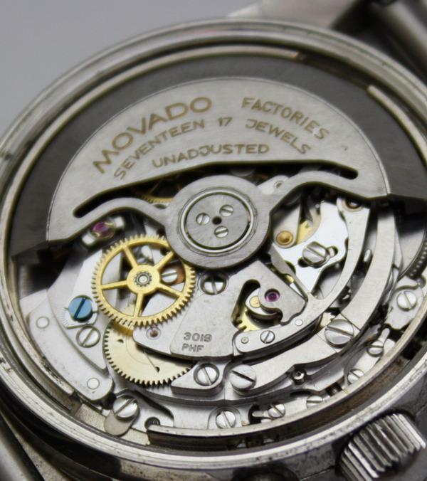

    The story is that Zenith and Movado were part of the same holding company (MZM) from 1969 to 1983 (along with another downmarket company called Mondia). There was much sharing of movements and parts between the two, and Zenith's El Primero and cal 146 replaced Movado's cal 90M and 95M as chronograph movements across both companies. Zenith was also at the time involved in a long running trademark battle with Zenith the television company in the US, so tended to push the Movado-branded models Stateside, which in turn tended to be equipped with 17J versions of El Primero so as to avoid punitive import dues. With the exception of the jewel count and certain minor cosmetic differences the Movado Astronic HS 360 was absolutely equivalent to the Zenith Espada. Today, you can frequently find the Movado versions for less money, as Movado prices are negatively affected by the company's "mall watch" reputation.
    Here are some images of the Espada for comparison
    [​IMG]
    [​IMG]
    [​IMG]
    [​IMG]

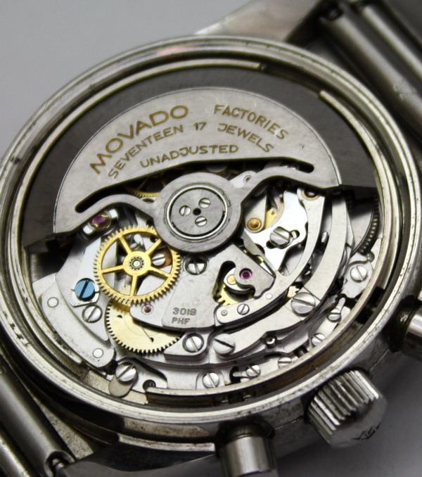

    both have the Primero 3019 PHF, with the addition of day-month-moonphase to the regular high frequency chronograph with date. It came out one year after the regular El Primero 3019 PHC, at a time when Heuer was still fussing with their caliber 11 to make it work right after its hasty and poorly prepared launch.

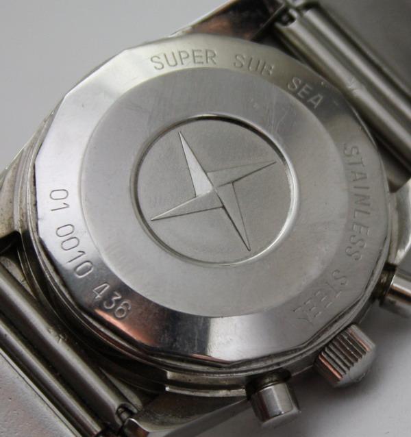

    ***EDIT*** Didn't see LouS's post, as I started queuing this one up and then had to step away for a while, but here's my take, and pardon the redundancy. The Movado Astronic is the 17J version of the 31J Zenith Espada, the El Primero with addition of day, month and moon phase, predecessor to the Zenith Chronomaster. Same 3019 PHF movement as the Espada, with jewel count reduced (I believe through de-jeweling of the chronograph), likely to avoid excessive duties in the US on watches with more than 17 jewels, and branded Movado, likely due to trademark disputes with Zenith Radio Corporation in the US; same thing with the Datrons. So basically the American market version of the Zenith Espada. I believe "Super Sub Sea" means depth rating to 10 ATM; you'll note it was called "Chronodiver" in this brochure from around 1974:

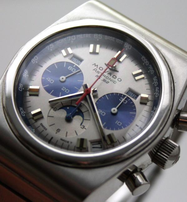

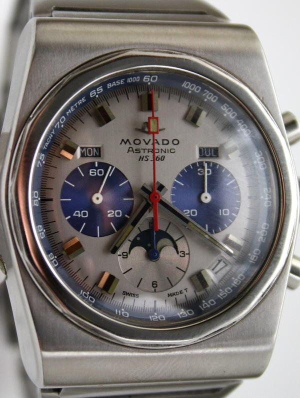

    The hour markers differ from the Espada's. The case and dial are otherwise basically the same. As with the Espada, there were two series of Astronics, produced probably between 1972-74, in low numbers. A production number of 100 steel Astronics has been quoted, but I suspect it was a little higher, as they are rare but not vanishingly rare on the market. Like the Espada, the second series has the new 70's Movado/Zenith star logo on the dial instead of the Movado one.
    The price for the one you show might be a little on the high side, but around $5k would not be outrageous as it looks pretty good. This seller has listed an Astronic at this price for quite some time now... I believe the same watch... though it looks like he has found a correct screw-down crown; there was a generic replacement crown on the Astronic previously listed by him at this price. One thing to look closely at is the internal tachometer bezel, as the blue tends to oxidize into little gold patches; this one looks pretty good. The clasp is a replacement - it should be signed Movado; this switch is very common, and replacement Movado clasps are introvabili.
    I think the Astronic is among the most collectible Movados, up there with the Polyplan and M90/M95 chrono. Here's mine, purchased by the original owner in 1974 for $360 (sticker price was $425).
    [​IMG]
    [​IMG]
    It was probably the most advanced mechanical watch available in the US at that time (I don't know what's more awesome than an automatic, high-beat, triple-calendar-moon-phase-chronograph-diver), sold at a fairly steep discount off the MSRP. I consider that moment in 1974 to be the end of the pre-quartz era.
