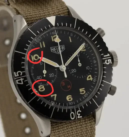

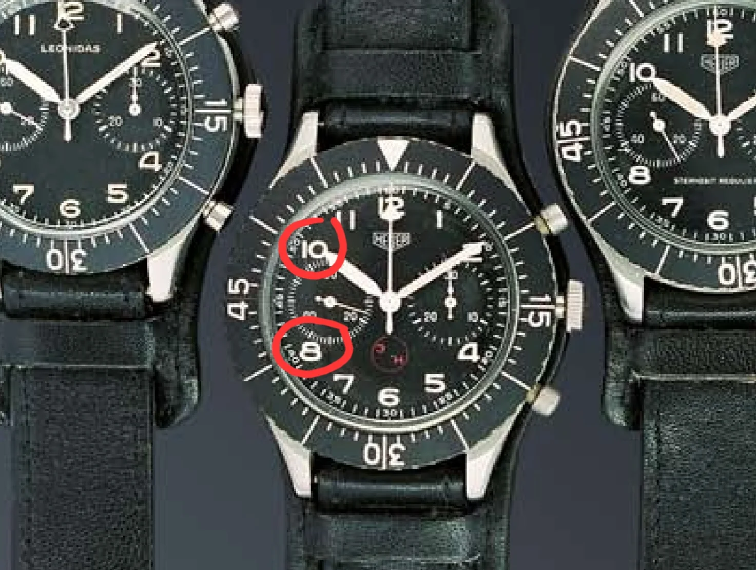

Konrad Knirim's authoritative book has dials that are exactly like this one.
24,229
53,958
Impossible to verify from that low-resolution image. And I would certainly assume that photos of service dials are routinely included in most books.
17
73
Yes..it is in the book but is a not genuine dial . ..it is a reference book which is great but there are some mistakes ....no T and 3H is not possible
190
17

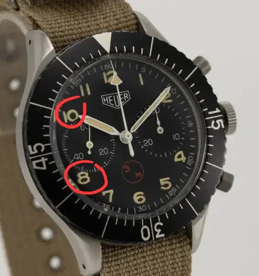

Pele, can you show me an example of the dial you mean.
17
73

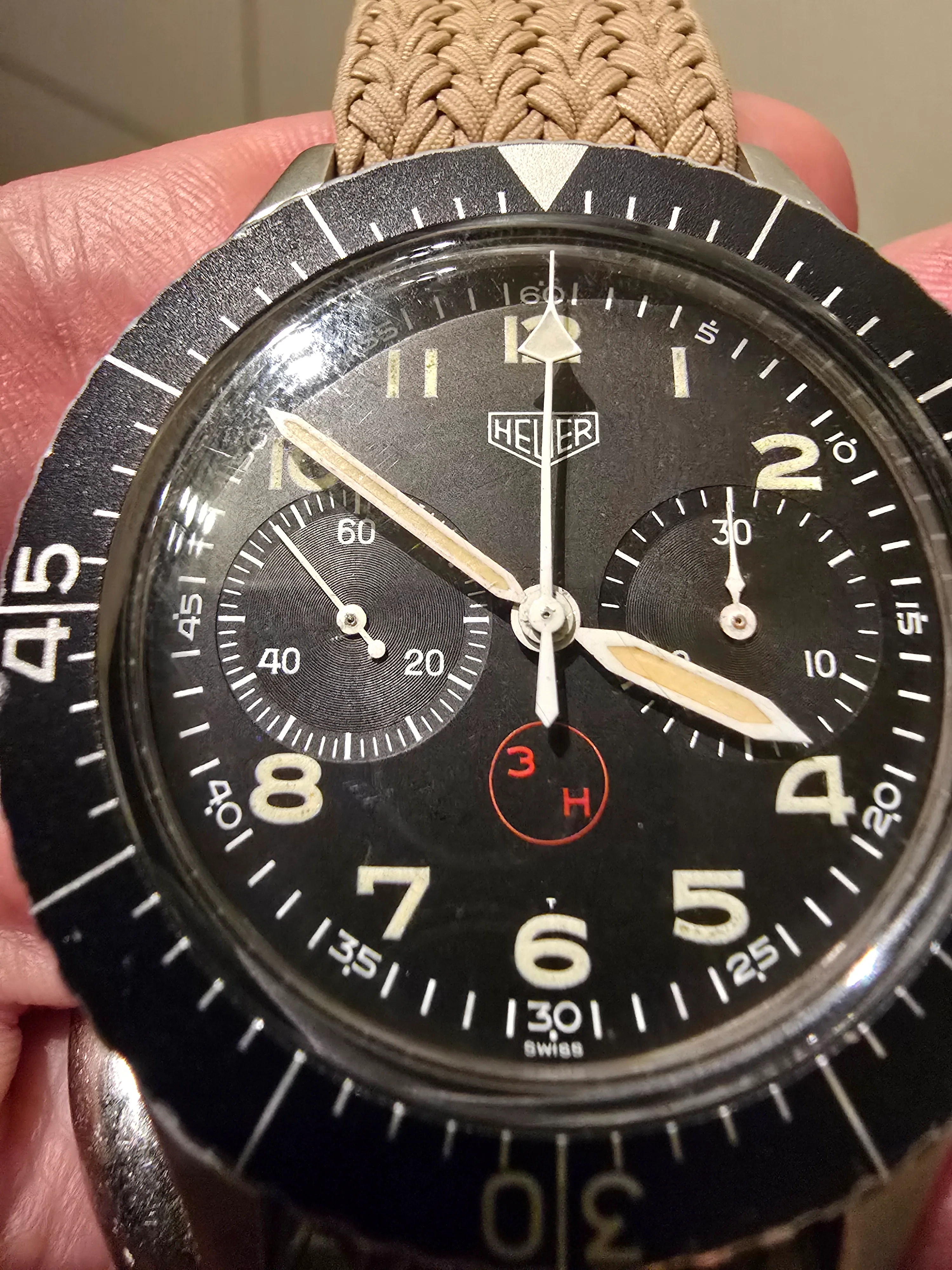

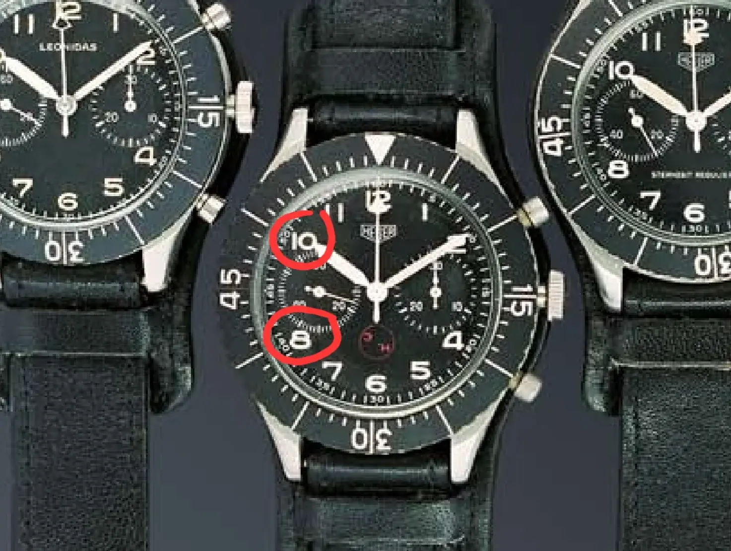

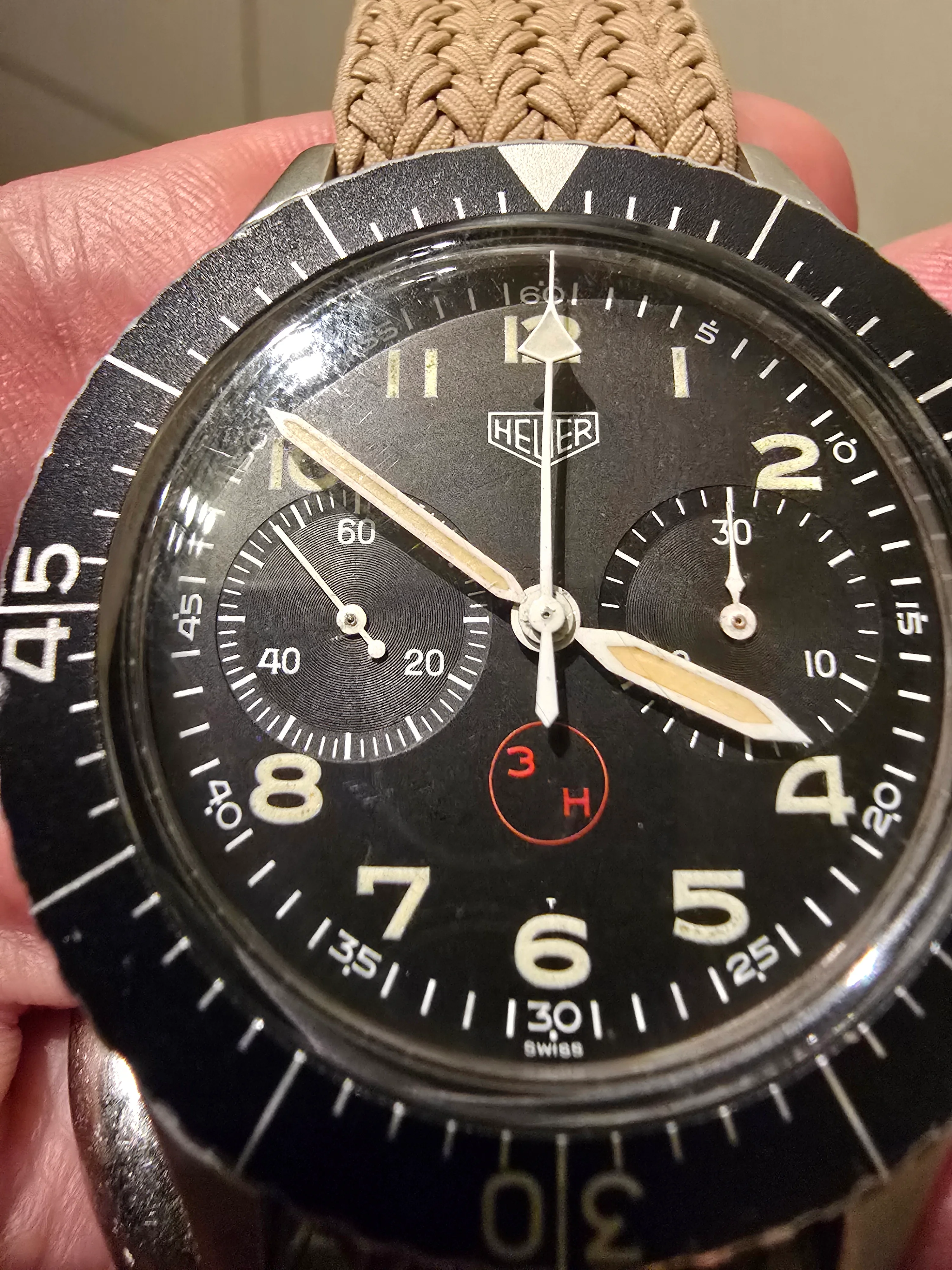

The dial should be like this, although 3 variants are known , the back of the 7 is the point where the difference can be seen.
Here is a "straight" 7, there are two more…a straight 7 with a difficult to see small "foot" and the curved one ( like yours)
ALL have the T above the six and may have a 3H print. ALL have full numbers without cutoff. The only variant with no T is the later superluminova dial with the clipped numbers at the subdial and therefore no T and no 3H as there was no tritium anymore
190
17
Thanks for the examples and the info. If it had been your dial I would have paid much more than 3.2OO E.

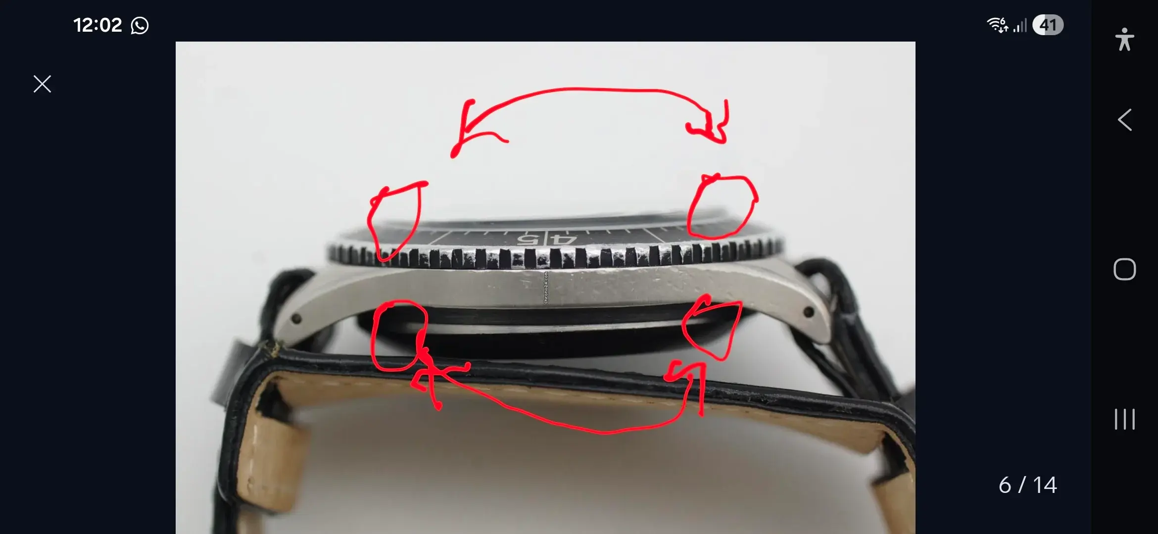

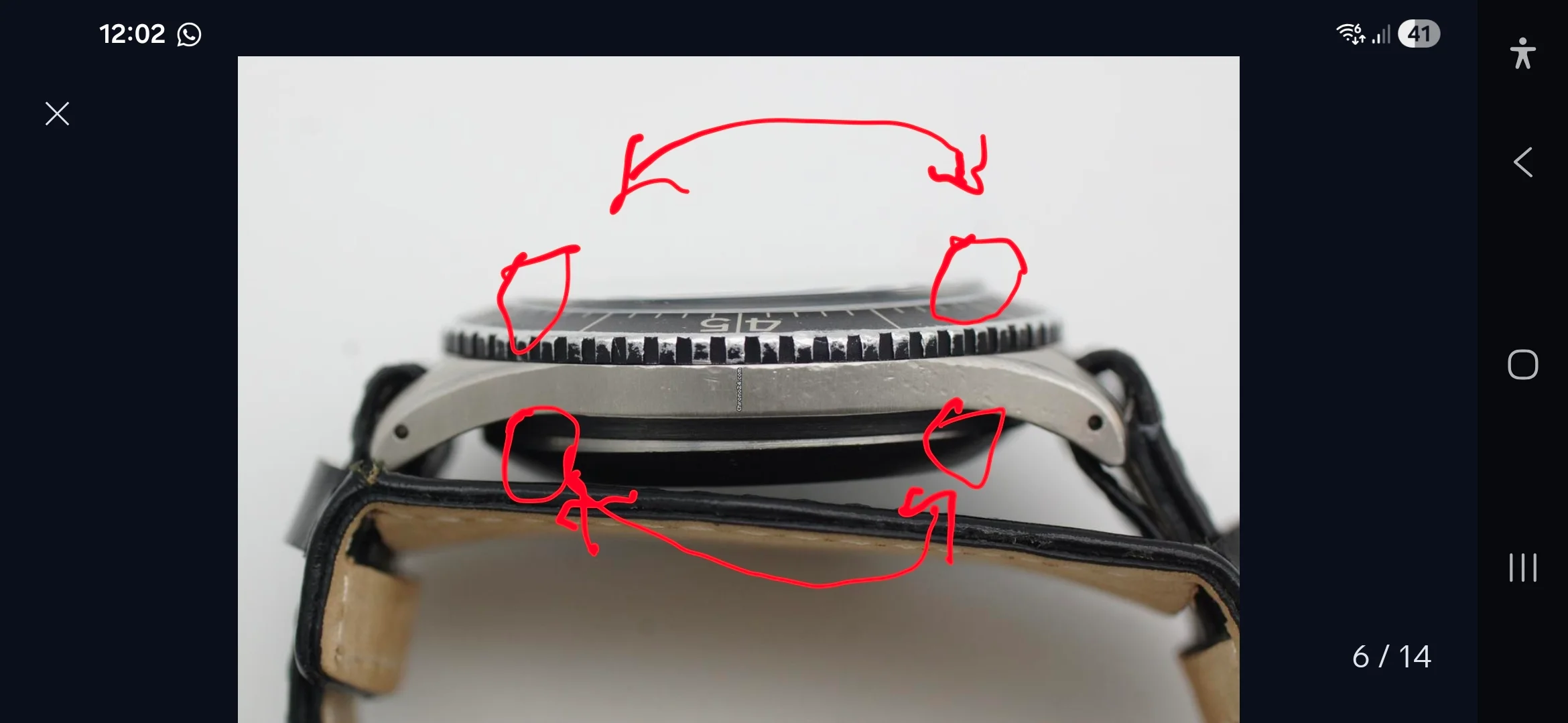

Looks okay but photos are bad...but this watch shows no photos of the engravings and has a"thick" plexi (Sinn aftermarket). The case parts are not fitted correctly, not in line..are you looking for a second one?
Cheers Dirk
190
17
plexiglass was norm in the 70s , esp for military watches. Feel free to send me a watch via PM , thank you . Why is the case not correct ?
17
73
Sure there is a plexi in all 1550,but they are flush with the bezel, the case parts are misaligned, you can see at the plexi which is higher on one side and the caseback is uneven fitted to the case
190
17
thank you friends. Well, I have concluded that I will take the original one I got from the auction . It is perhaps a service dial by Sinn but the bezel is good , the watch came from a solid collector and at least I won't be on the blacklist 😀 .
