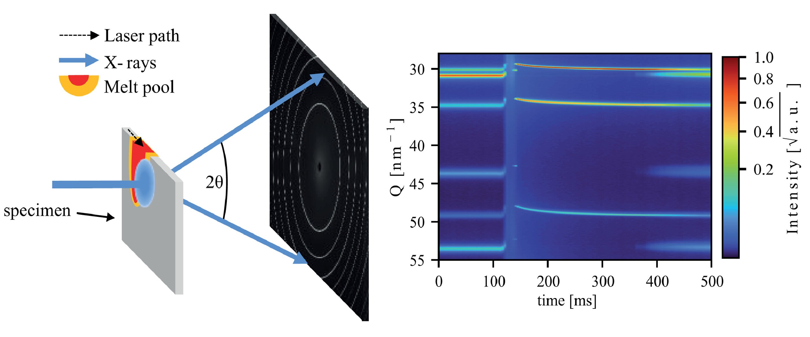

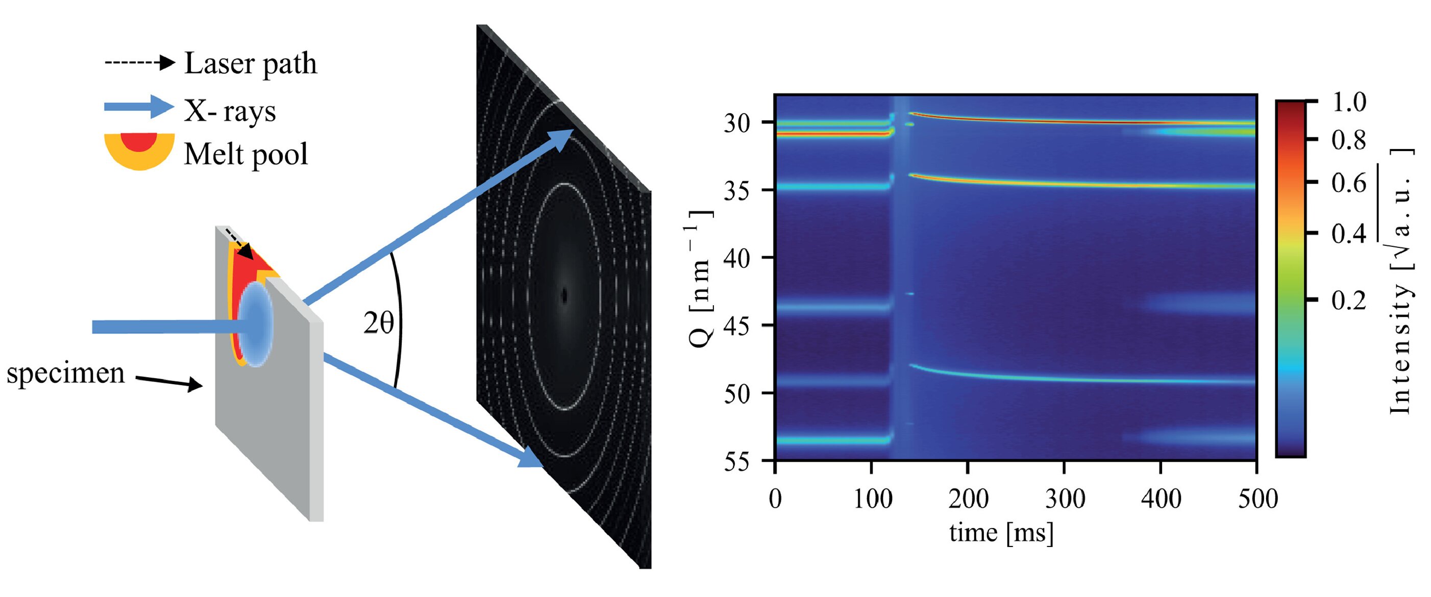

A link from my rocket club.
https://techxplore.com/news/2023-03-metal-3d-printing-conundrum-propel-technology.html
An interesting writeup as to why metal printing is not quite ready for things like tiny watch parts. I think one of the reasons I burned out on watchmaking in the early 2000s was that I wanted an easy way to make replacement parts. At the time greed bay was mostly scammers. So apart from the dying material houses and collecting clubs (which were at that time dead men walking.) There was not much one could do.
