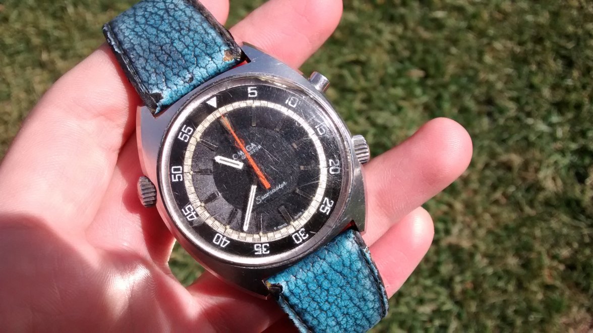

I have a 1161 bracelet for mine but I think it came on a 1171 bracelet too. To be honest I prefer it on the leather strap. I have, what I believe is the original strap that is blue and a spare one that is red. They both come on a no.27 clasp and the lugs are 22mm.
This is the blue one. It looks less beat up in the flesh. I also had the watch serviced and a new crystal put on it.

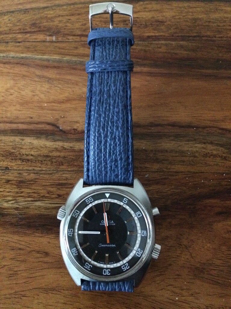

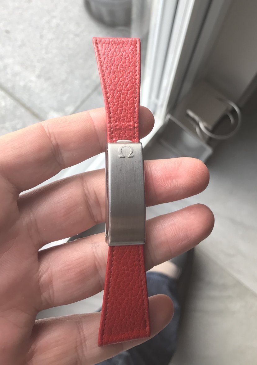

And here is the spare red strap that I bought earlier this year. (Sellers photo)

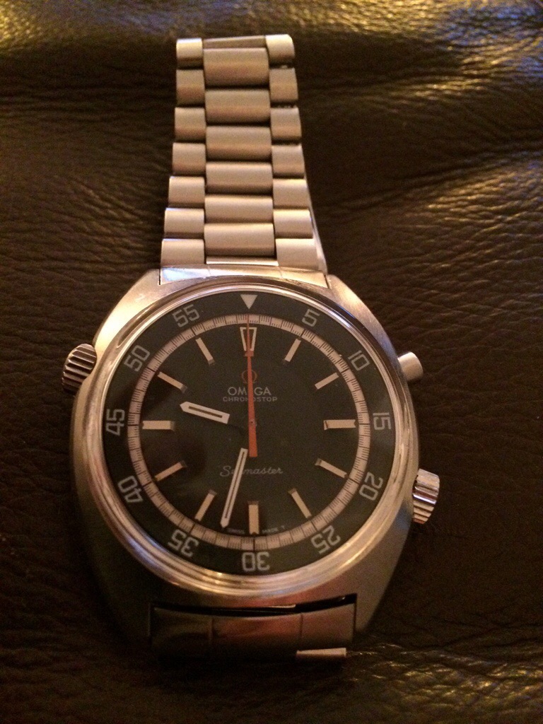

Stupid auto correct, I meant to write 1170. Couldn't remember the end links though. I actully got a 1162 bracelet with 172 endlinks because it was the only bracelet that I found pictures of, on the watch, with a bracelet refrence number. The end links are straight so don't sit snug into the lugs.

Could you put some pictures of the 1161 bracelet?
2,763
4,361
Sorry, It was a 1162 with 172 end links not a 1161.
1,060
1,632
1162 is not original on 145007/8, replacement only.
2,763
4,361
Yeah I knew when i bought it, that it was not original to the refrence, but finding a 1170 bracelet is/was quite difficult. I bought the 1162 because it fitted the watch dimensions. 're reading my original post it reads like I am suggesting that the 1162 was also original to the watch, this was not the intention.
1,060
1,632
1159 Bracelet with 549 endlinks also 😀
no, it's not.
1159 was produced with fixed straight endlinks: 155 (22mm) and 154 (20mm).
1117 has 549 endlinks.
Any 1159 with 549 endlinks is probably a 1117 with a swapped unoriginal 1159 clasp

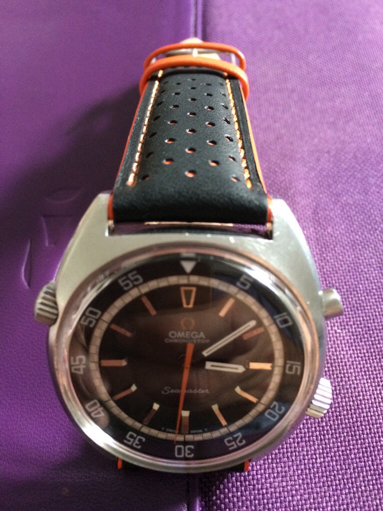

Love that one on the left. What model # is that? Beautiful.
The stitched leather is actually what's in my avatar photo. It wasn't bulky at all but sure did stick to my wrist throuought the warmer months (which, here in the North East, is about 80% of the year now...)
What about a leather strap with matching stiches?

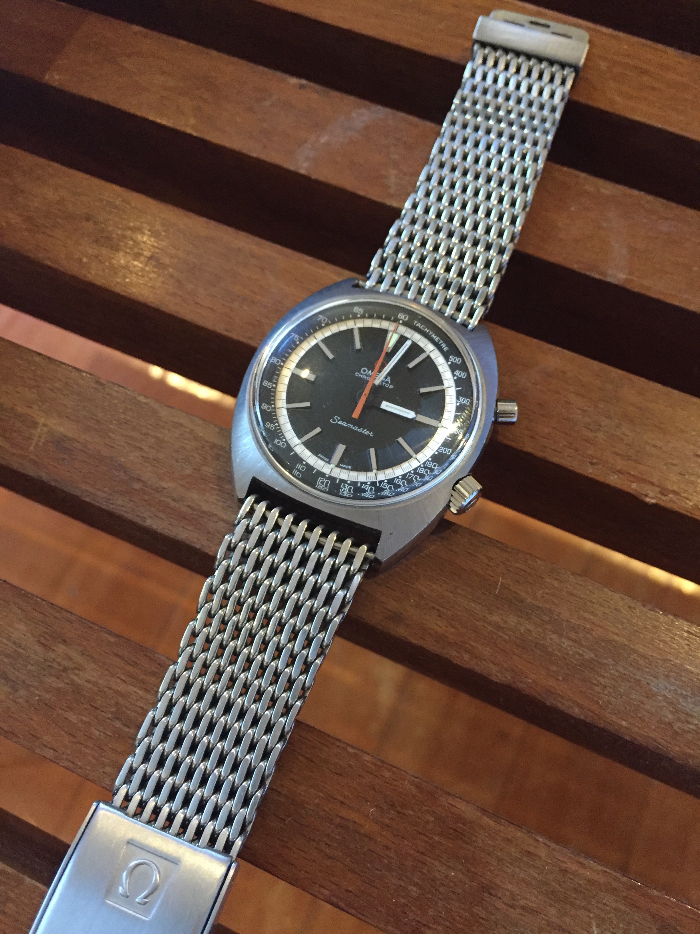

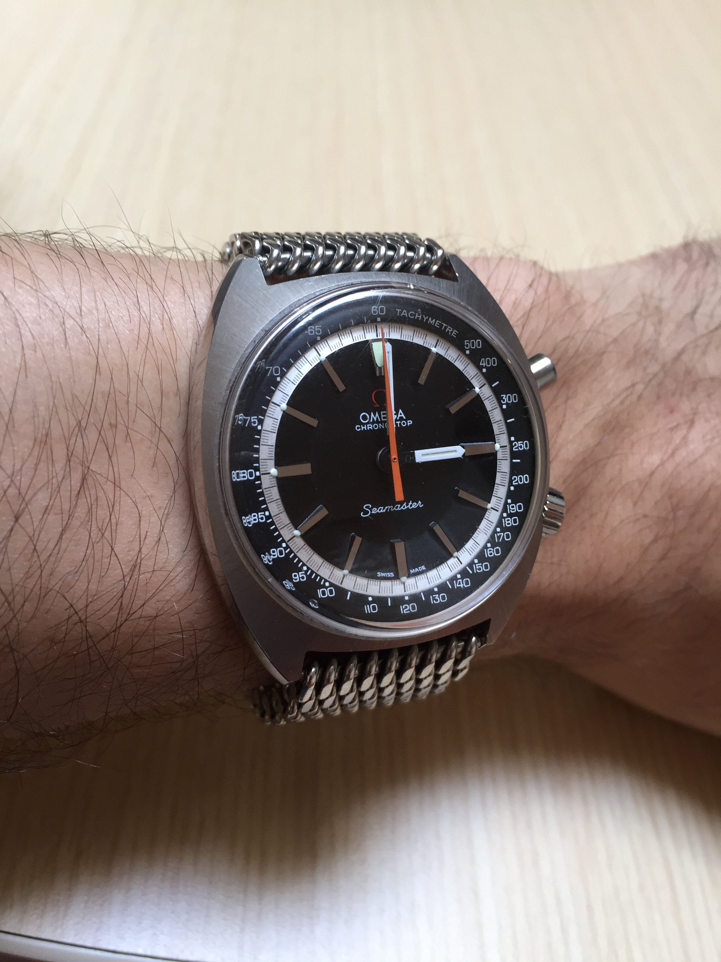

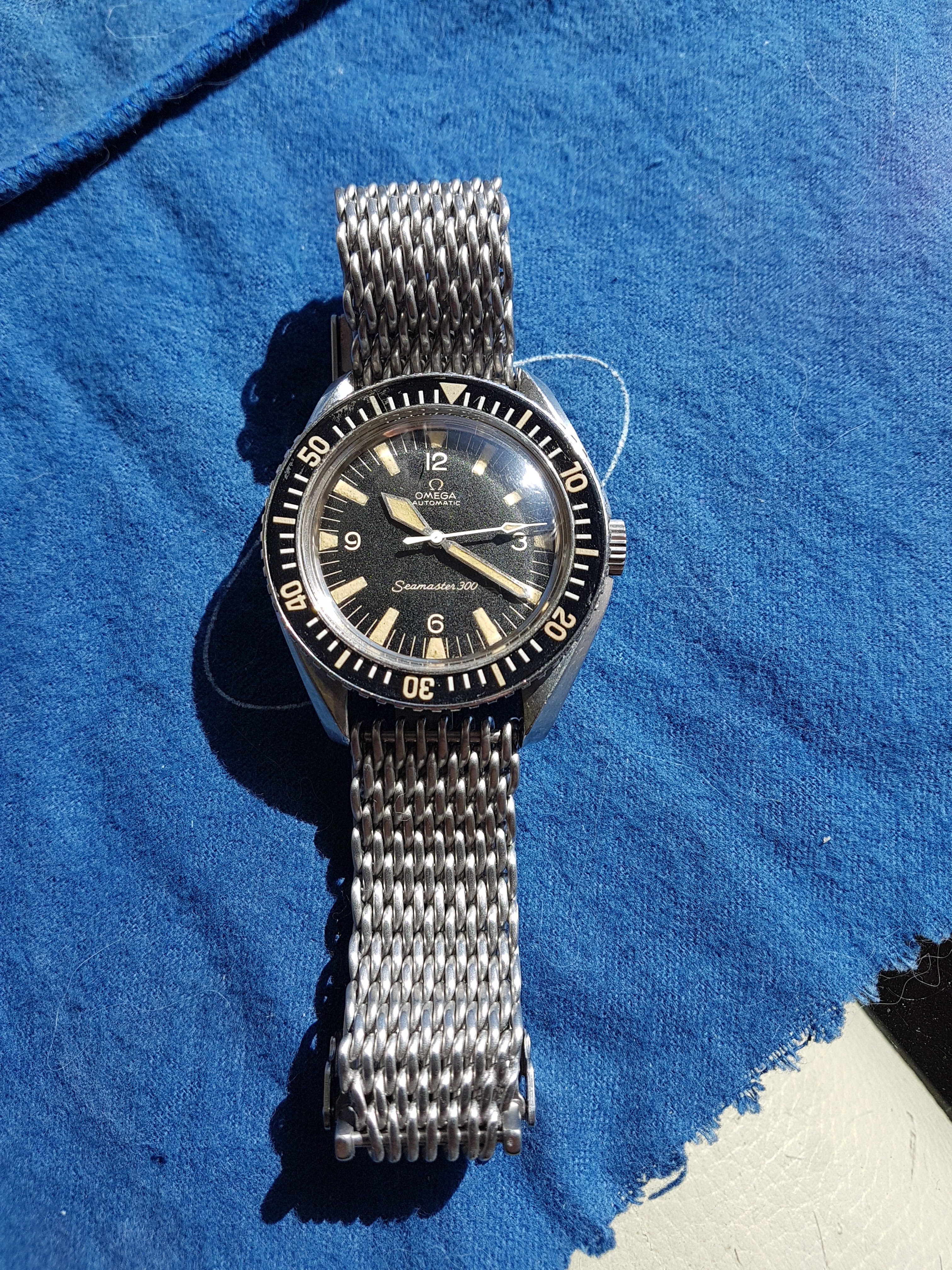

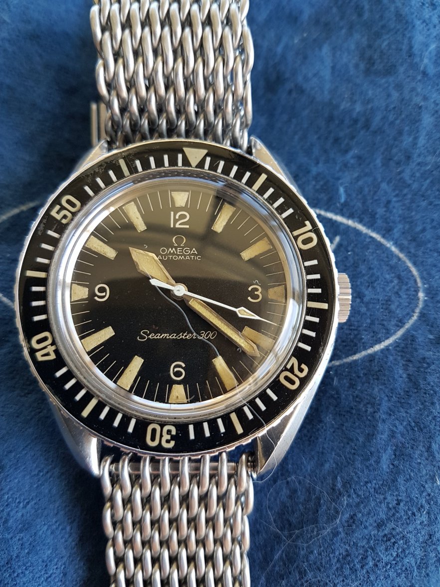

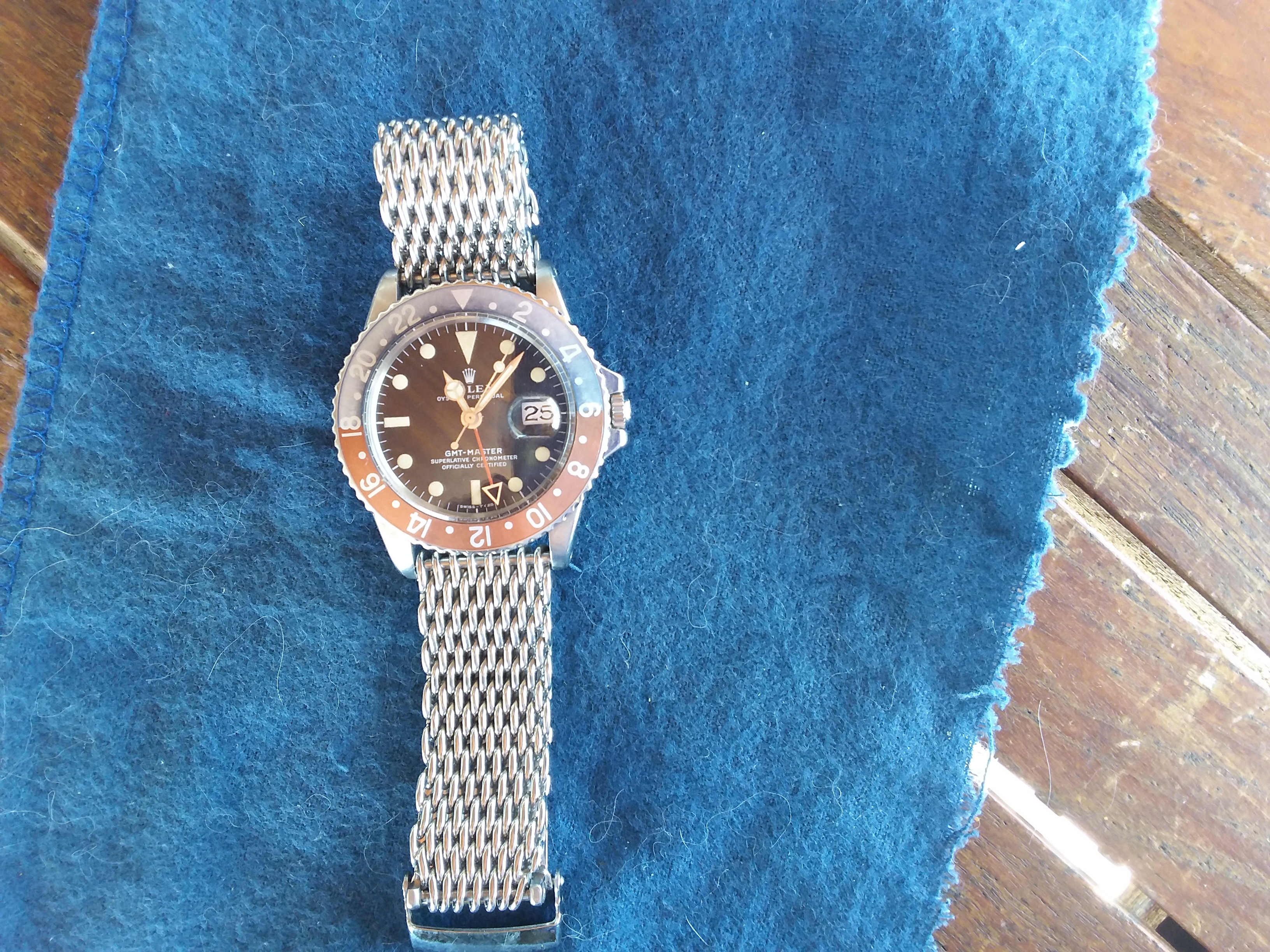

I have a couple of watches on mesh, both from Geckota in the UK. Quality is excellent delivery fast and not expensive for the quality. Easy to adust by removing links .Both of mine are deployant, one is polished the other matt. I prefer the polished.
Pics attached

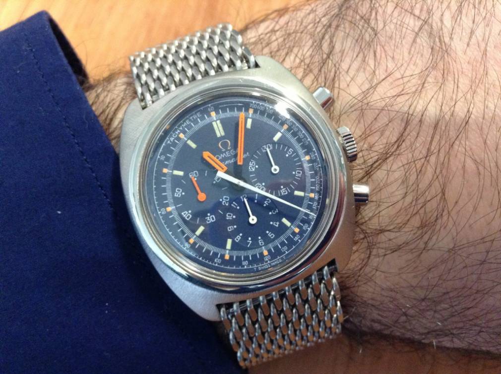

My 145.008 came to me on an 1184/625. Would be really interested to see one on a shark mesh. That said, looks good in blue shark skin too IMHO.

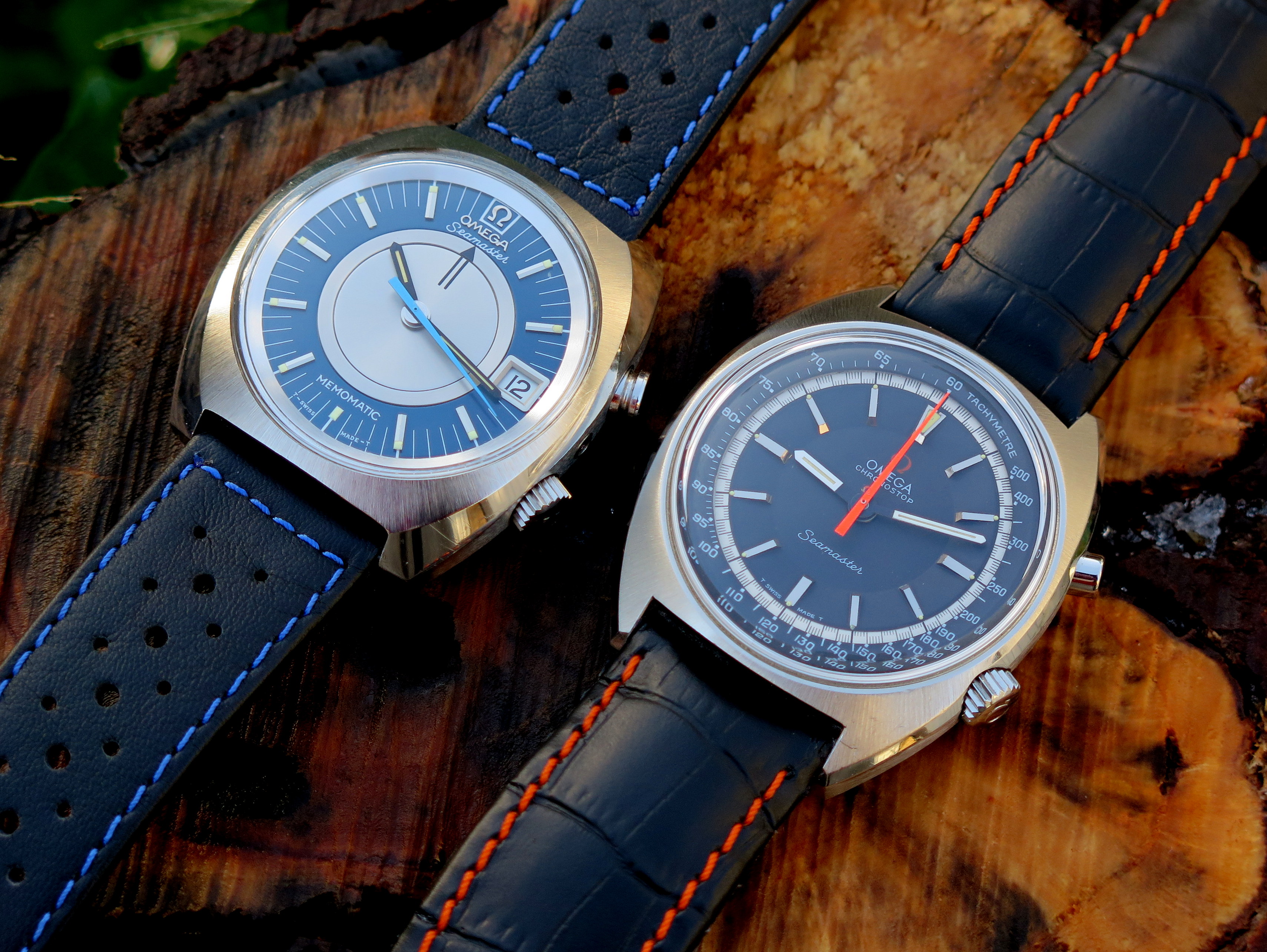

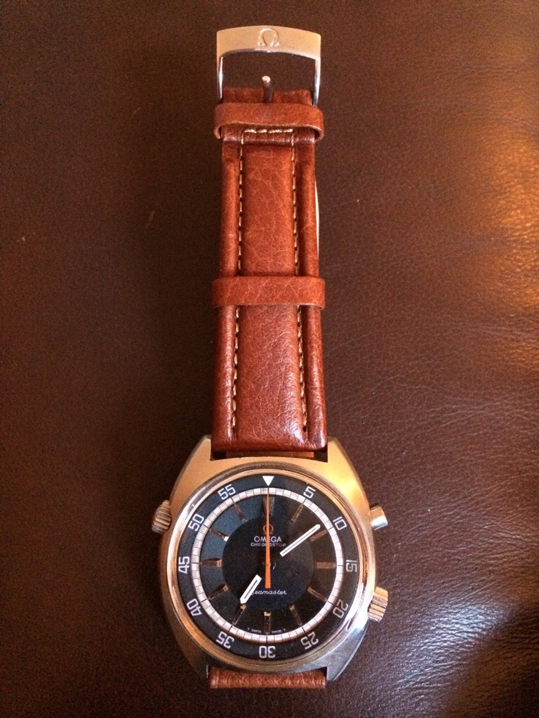

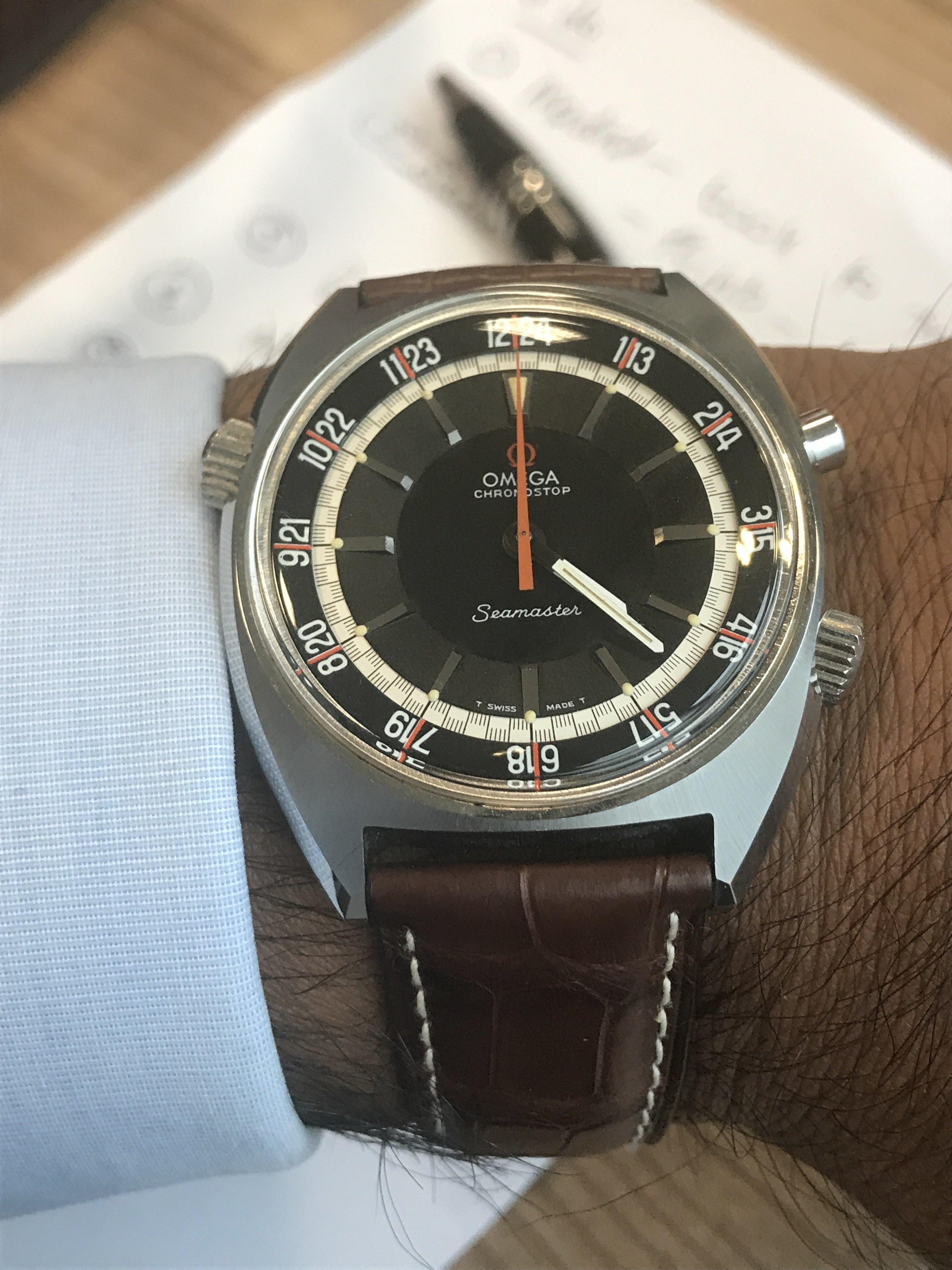

I had mine on bracelet and took it off - I also wanted a more informal dressed down look. In the end I put it onto a brown, slightly worn leather band with contrast stitch:
At least here in the UK, brown leather is still considered informal (at least where I work..)

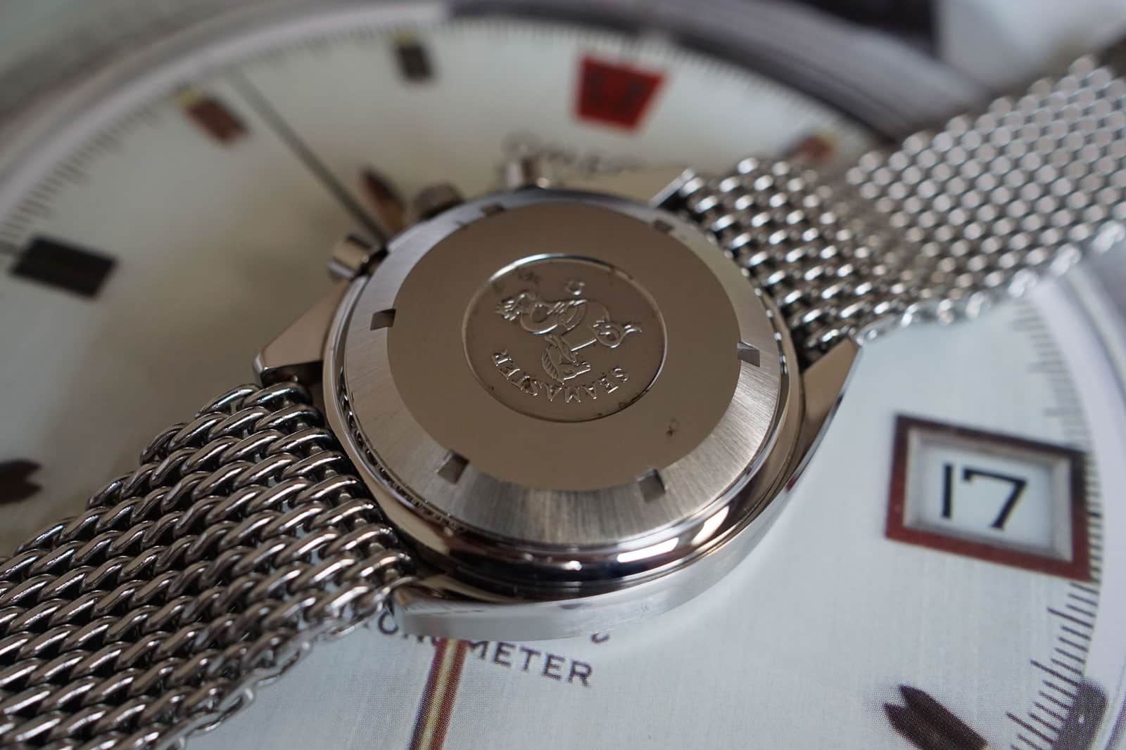

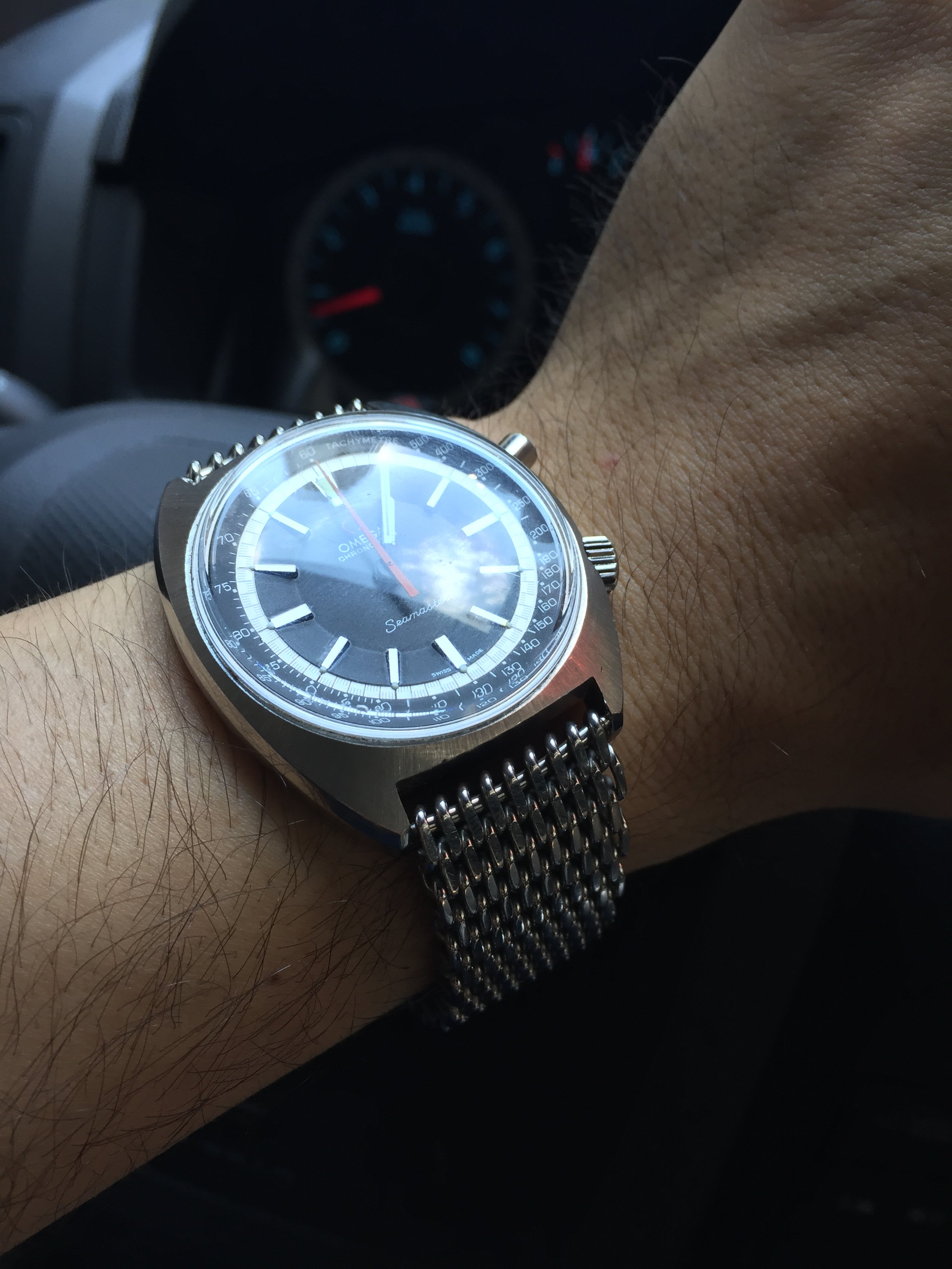

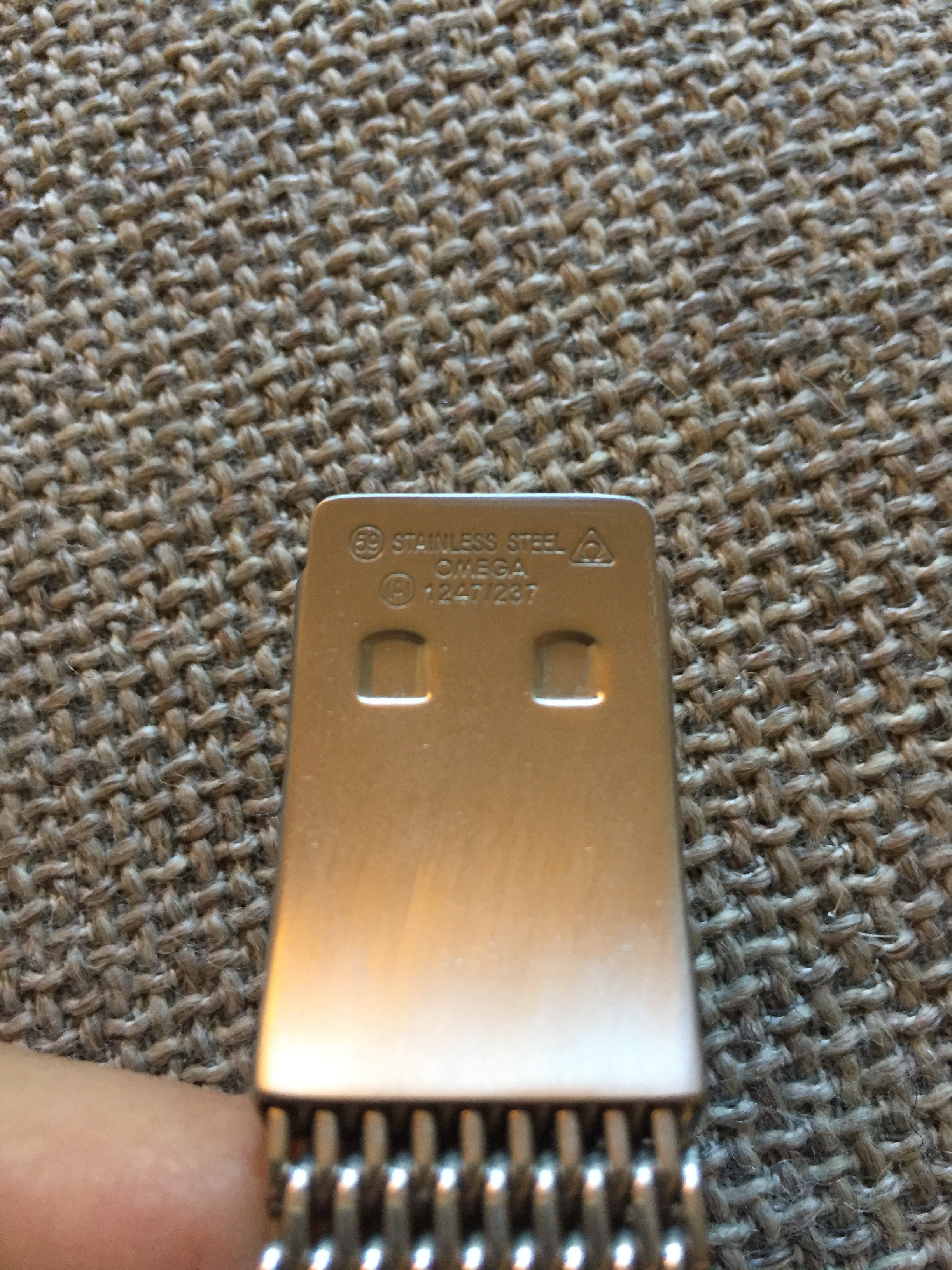

Ended up grabbing this. I wasn't so much in love with the aesthetic aspect of the metal mesh, but the sleekness and breathability.. though I do like the Miami coke dealer chicness to it 😀 This has that in spades and is made by Omega, though the guy who helped me out today told me to make sure it is authentic. Thoughts? Photos:
1,301
3,087
These are very nicely made and look lovely. One big drawback is when putting the watch on be careful to do it in a carpeted room or over a bed. It is very easy to drop the watch whilst trying to fasten the seat belt style clasp. An acquired skill, just when you think you have mastered it is when you drop your pride and joy. Beware.
