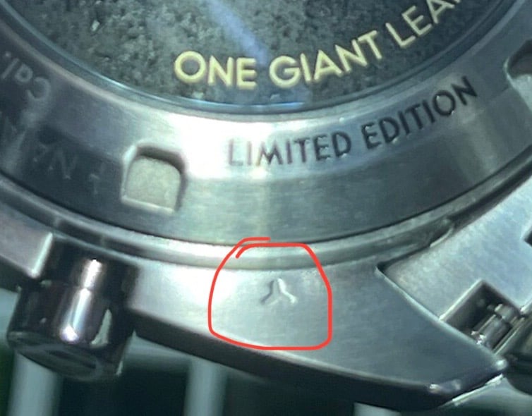

Hello, what’s the meaning if this symbol (image attached)?
I tried searching the forums, as well as Google with no luck.
Further, is there any official document about all possible symbols engravings in watch case?

Niad lock case.
special threading to make sure the caseback always aligns correctly

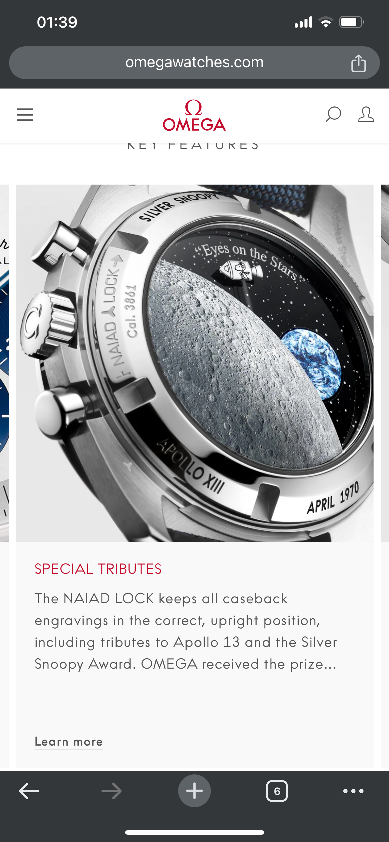

Cool, thanks for your information.
I always thought the word "NAIADLOCK" in the caseback is enough to indicate its present. I own a NTTD with naiadlock, too. And IIRC, that symbol is not engraved in the case (lugs).

I noticed my Snoopy 50th has this symbol, and no other engraving on the caseback since it doesnt fit.

Not sure what you mean, the caseback of Snoopy 50th definitely said "naiadlock".

Oh lol, I guess I missed it since its not filled in with black paint like the other engravings.
Hmm then maybe the marking is so people (watchmakers during servicing) know exactly where to line up the case back during reassembly when its not obvious what orientation the back should be?
I'm assuming the NAIAD can lock into place in more than one orientation. Like exactly at 0, 90, 180 and 270 degrees (just an example, I have no idea). Its obvious on stuff like solid case backs with an engraved medallion, less obvious on display case backs with just lettering on the edge.
My titanium ultradeep doesn't have the marking on the case. Haven't checked all the others yet but this is interesting.

I do believe it’s the start point for Niad lock to ensure things line up correctly.
