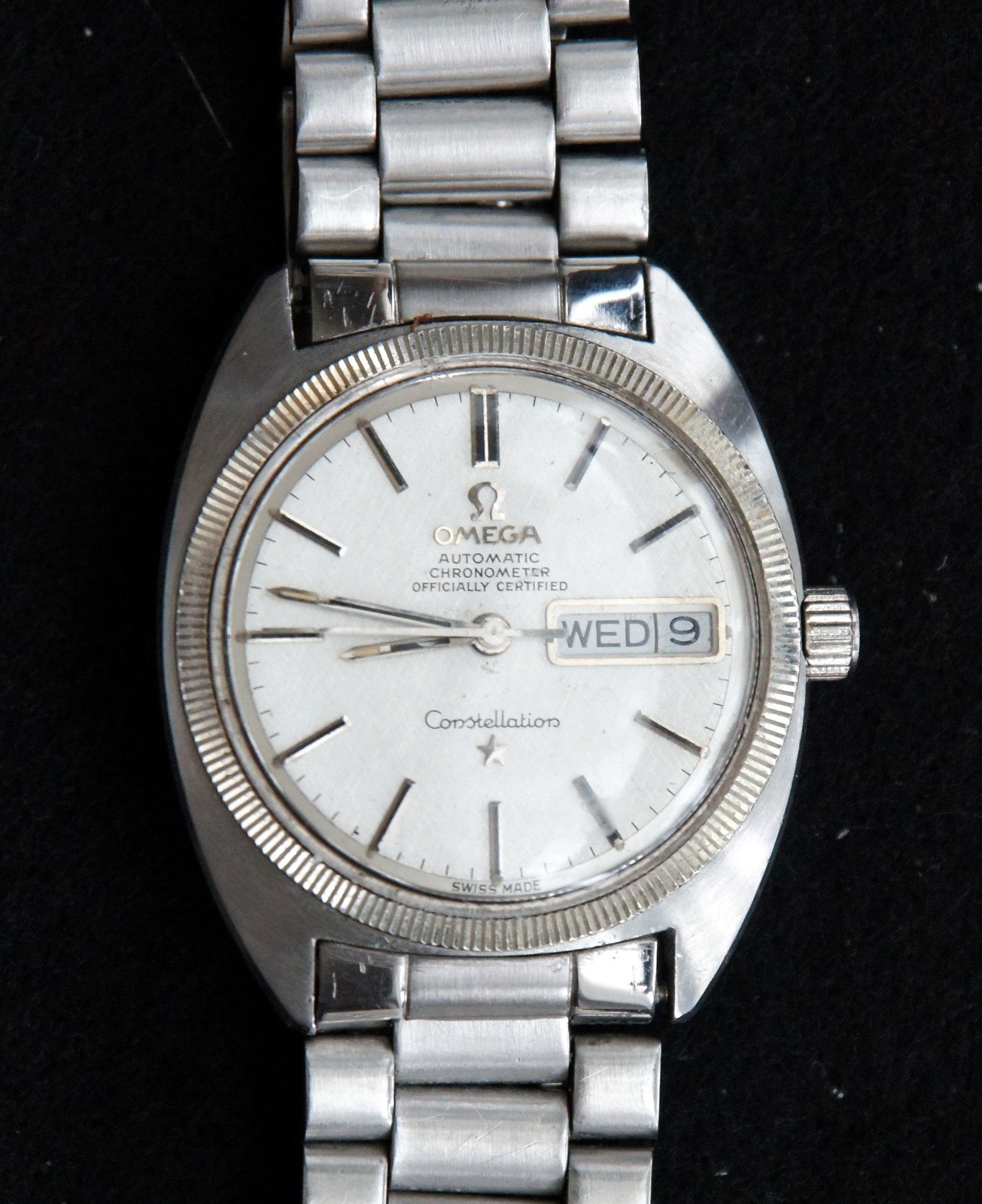

I have a 1970 Constellation with Speedmaster bracelet. I'd like to put the proper bricks bracelet on it. How do I find the right reference numbers for the bracelet and end links?

The most common bracelet is the brick style, 1040 with 518 ends.

Just make sure one of your seaches leads you to Omega. There are some they still stock, though not all any more. They still sell the 1171 and a five-row BOR, for example. I'd hate to see you pay $1000 used for something you can get $500 new.
