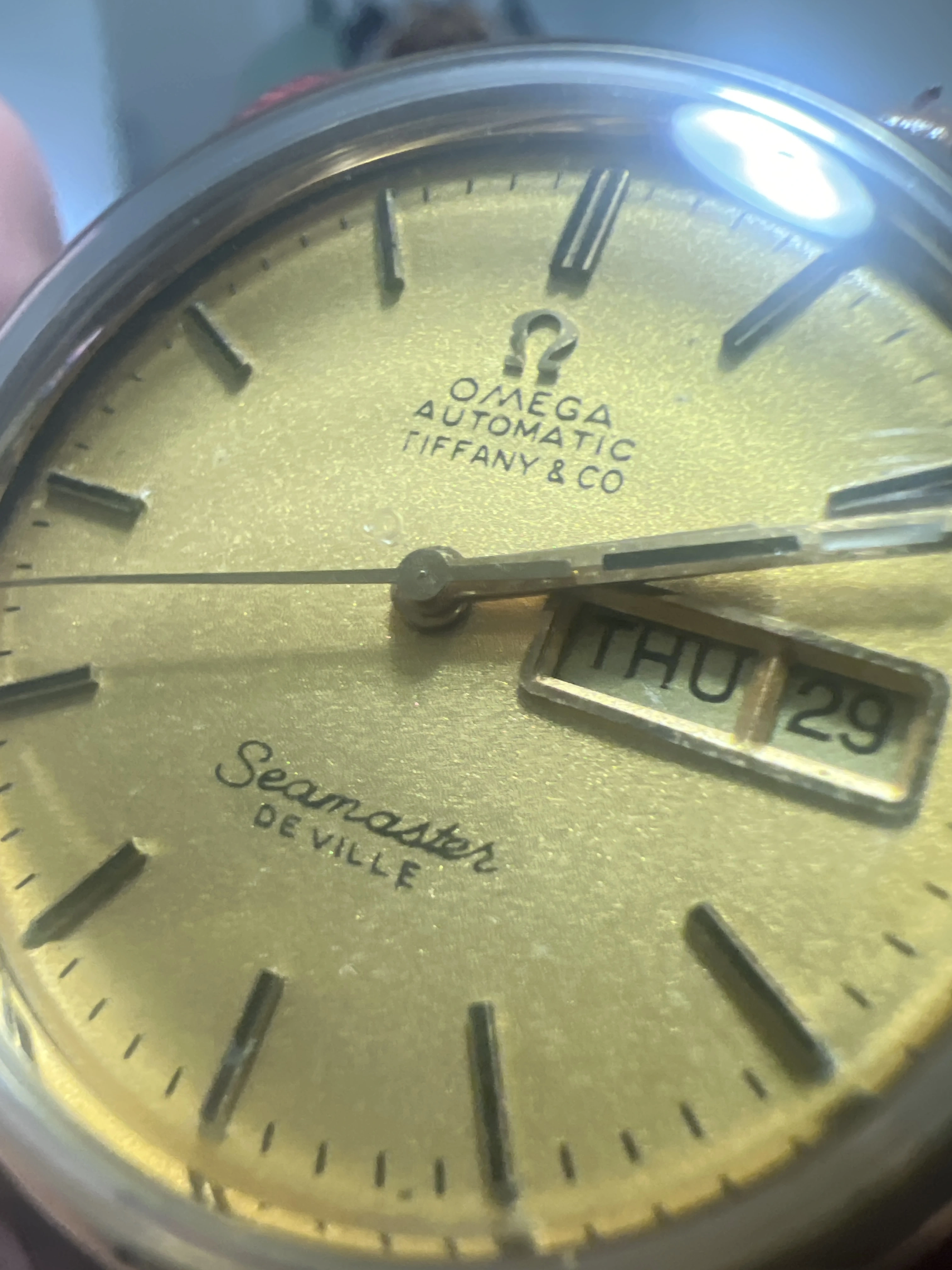

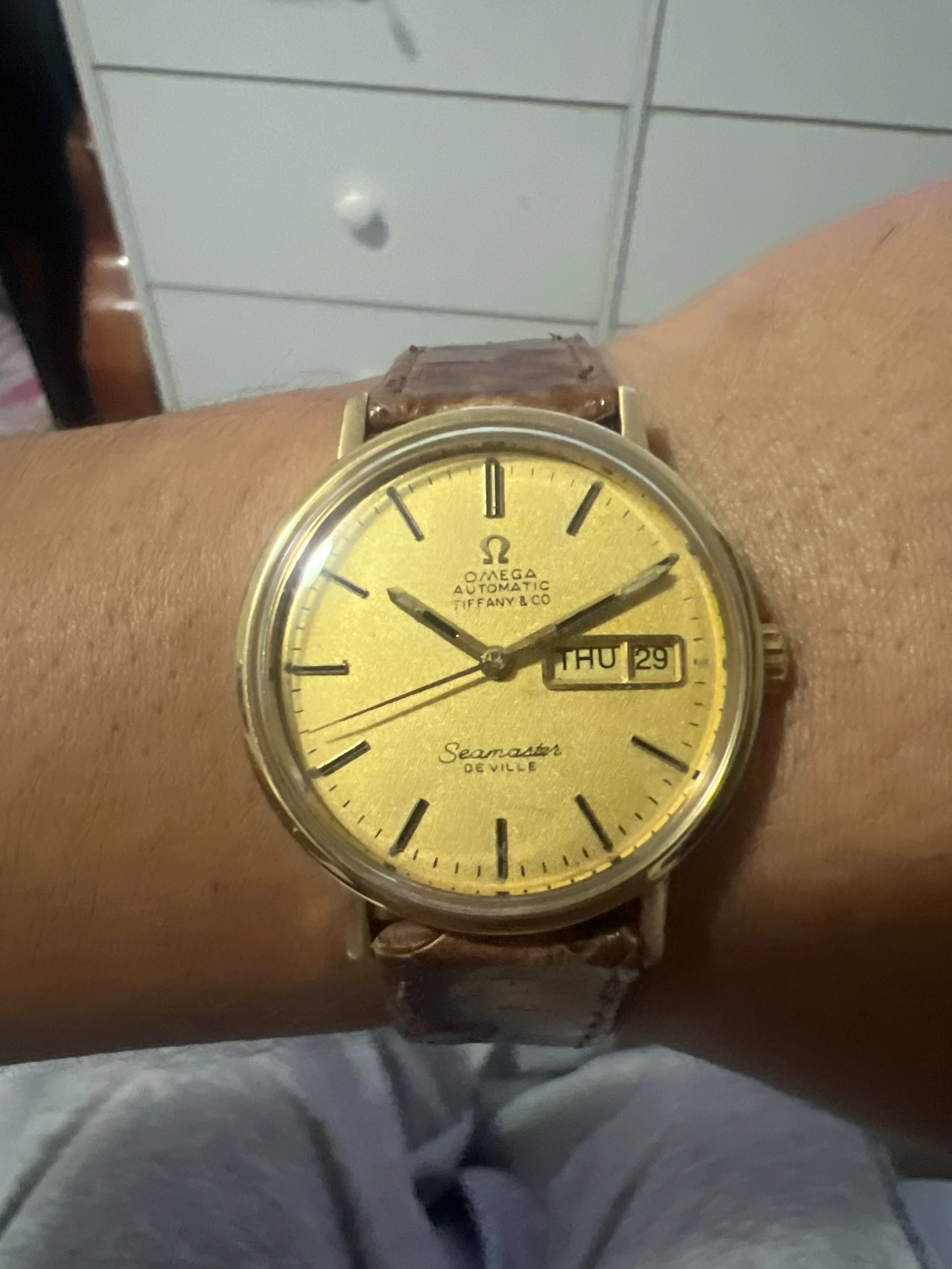

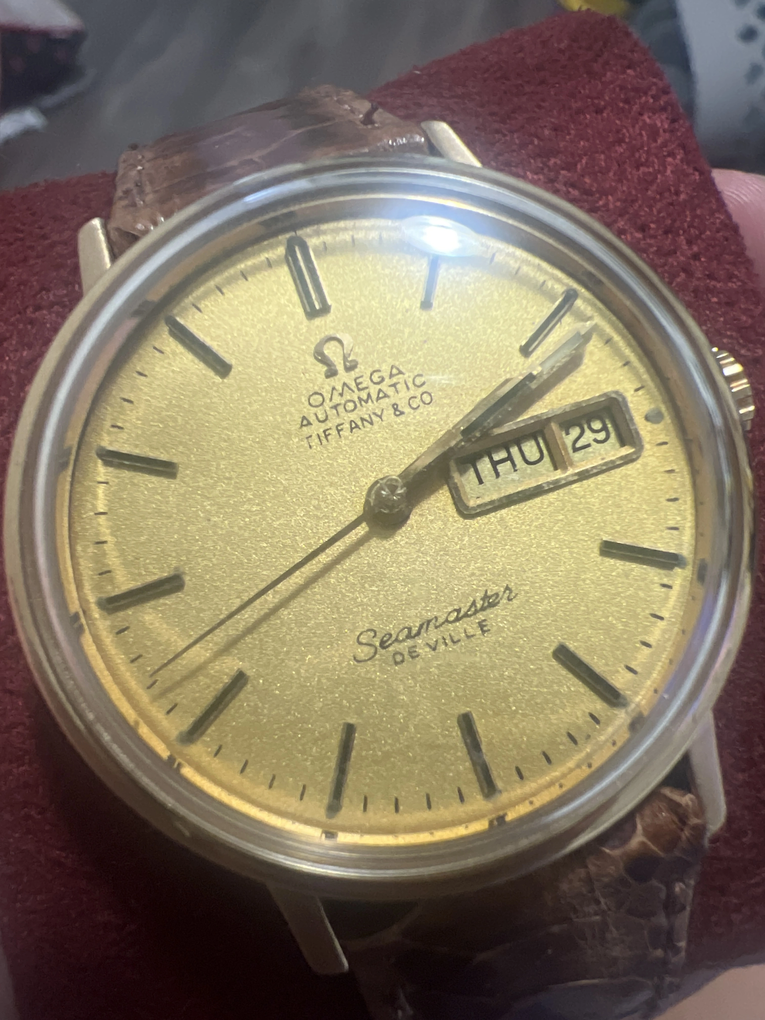

Purchased this watch but wasn’t too sure about the Tiffany stamp. Does anyone know if it’s an authentic stamp or retouched? Are there any signs?

It's a very poor photo, but at first glance the whole dial looks repainted.
The photo isn’t any better in the other thread either

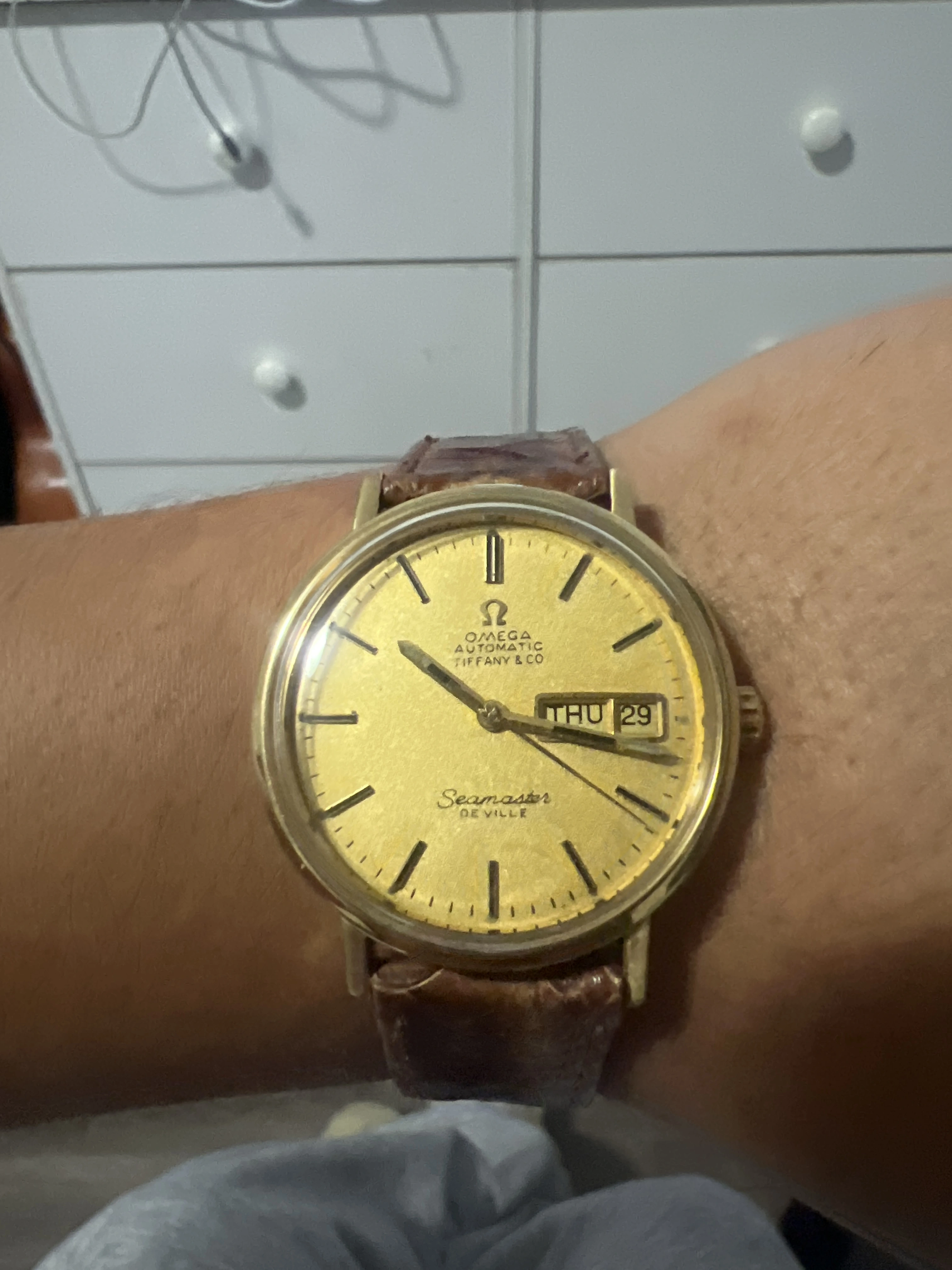

Those photos are good. The dial has been completely repainted. Those aren't the correct fonts, the finish is wrong, and the printing is poor quality and misaligned. If the seller specifically said that the dial was original, it would be grounds for a return.
Appreciate the feedback. I know the value is significantly less on a repainted dial but do you happen to know about how much it’d be worth in it’s current condition?

It's really hard to put a value on a watch like this, but I would say less than $200 US.
