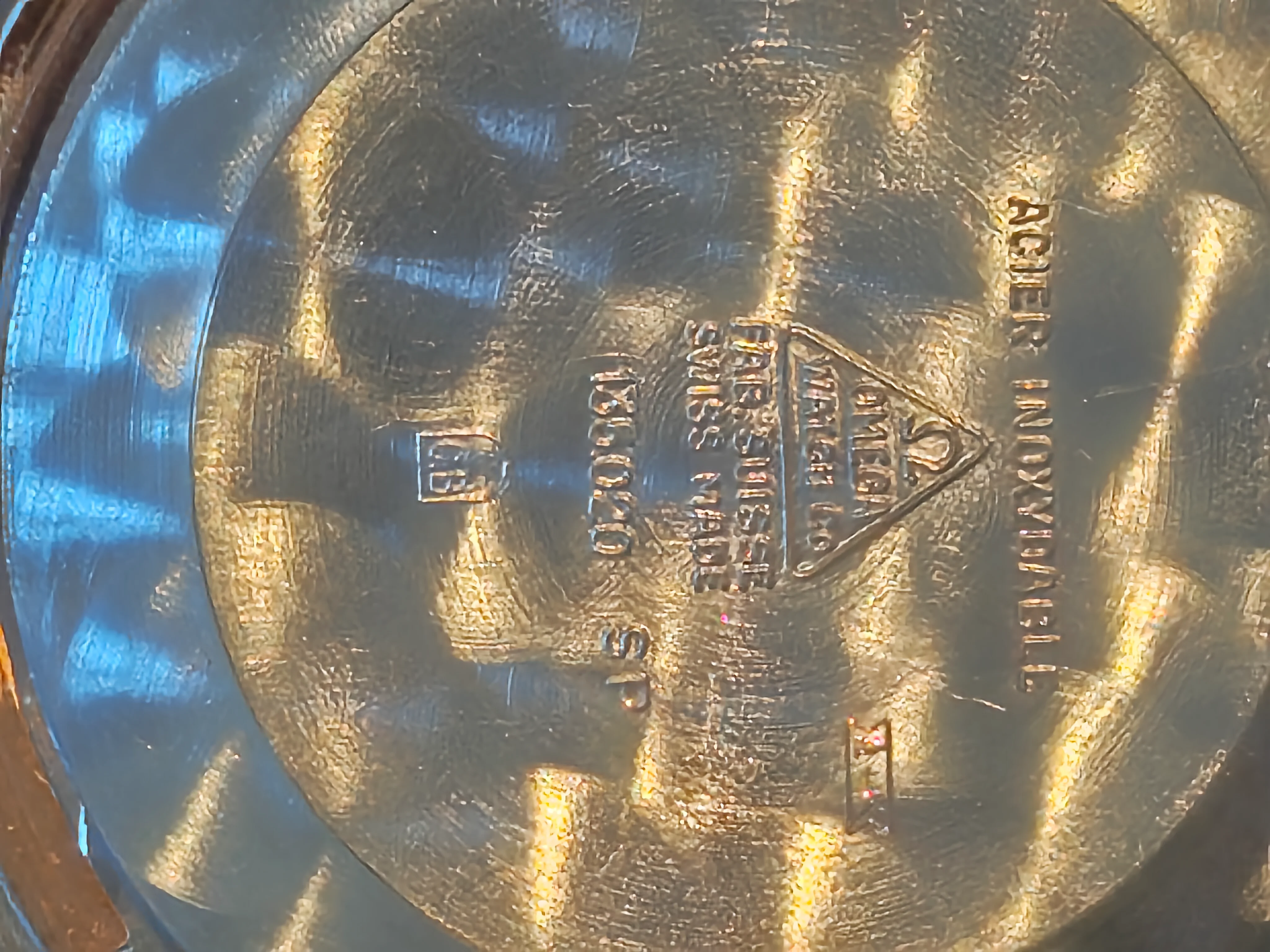

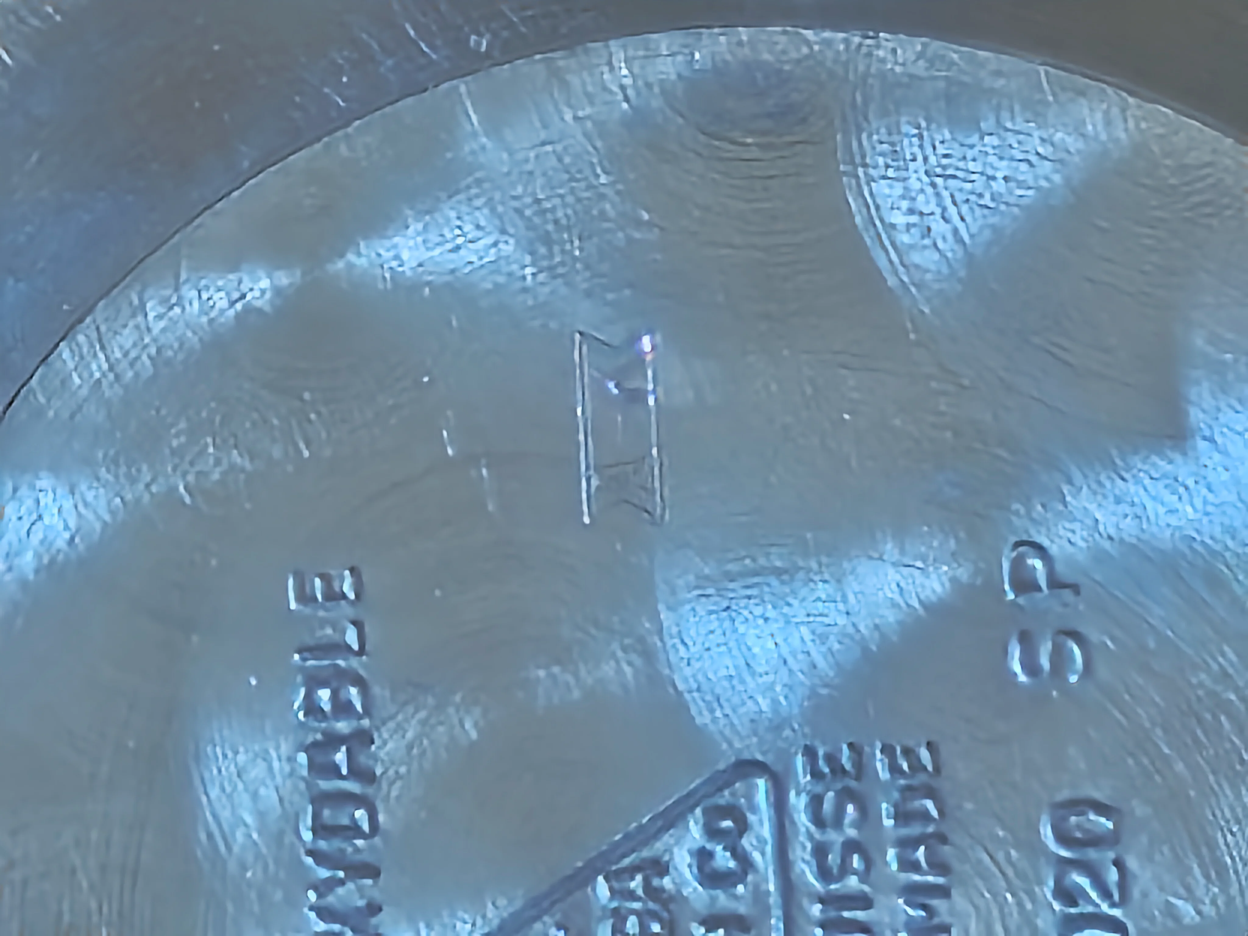

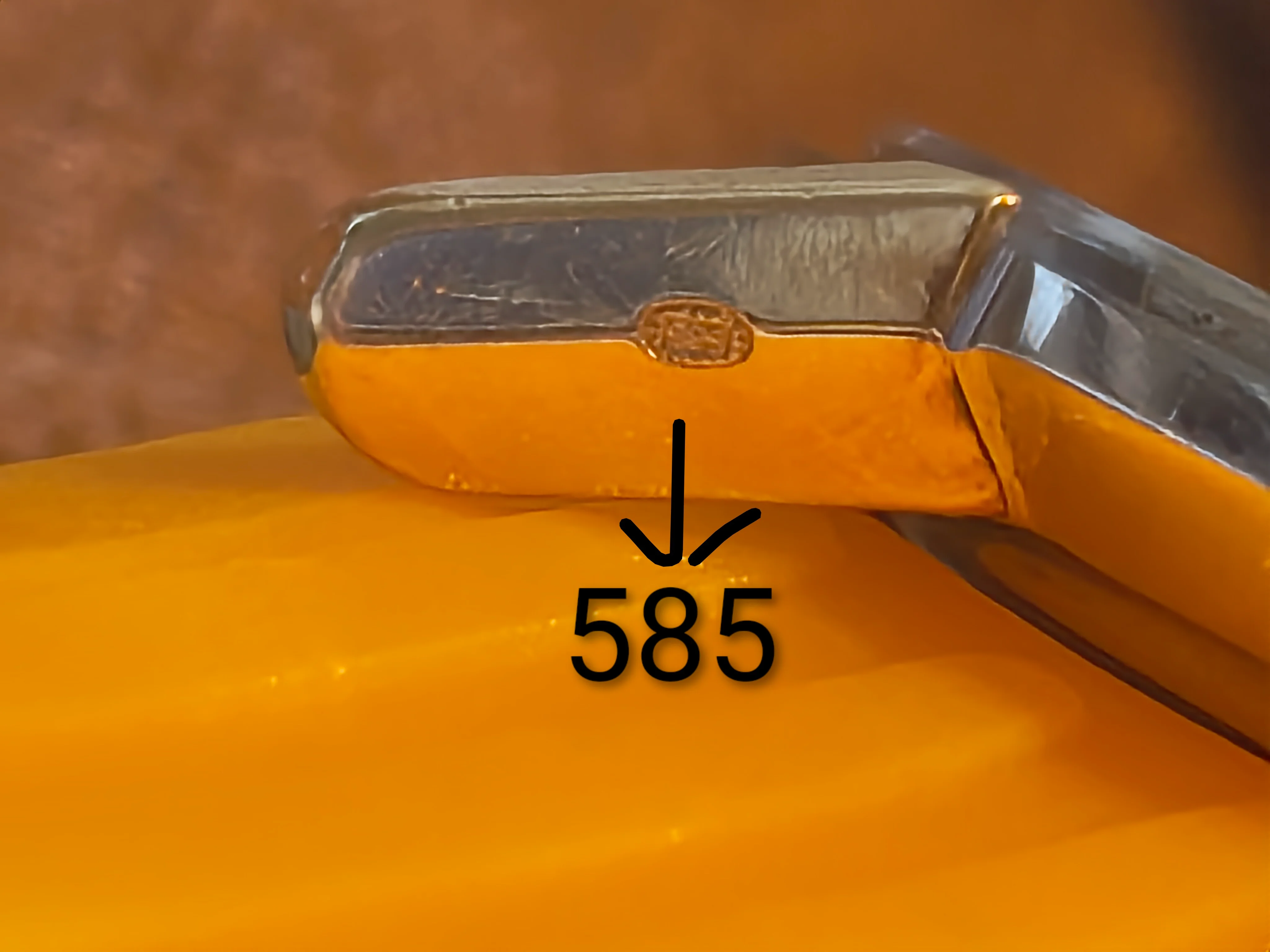

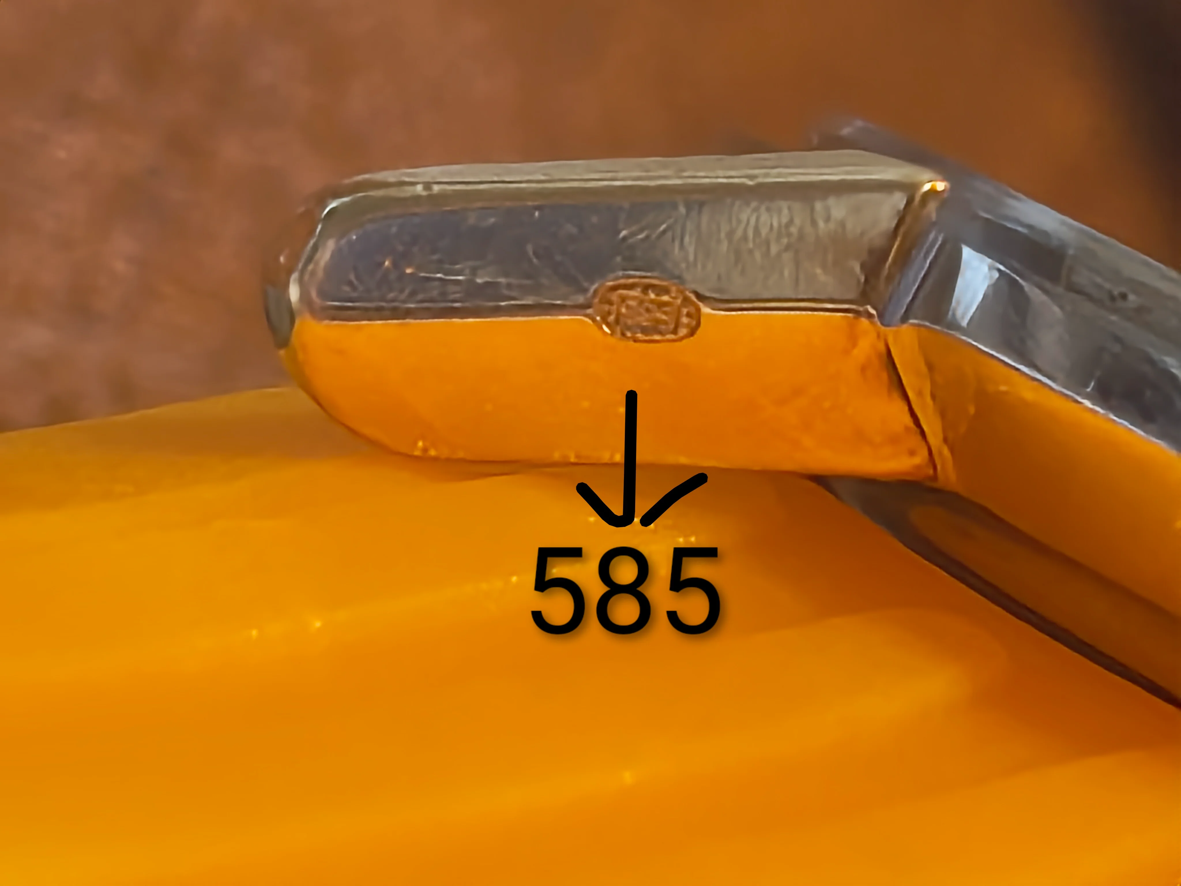

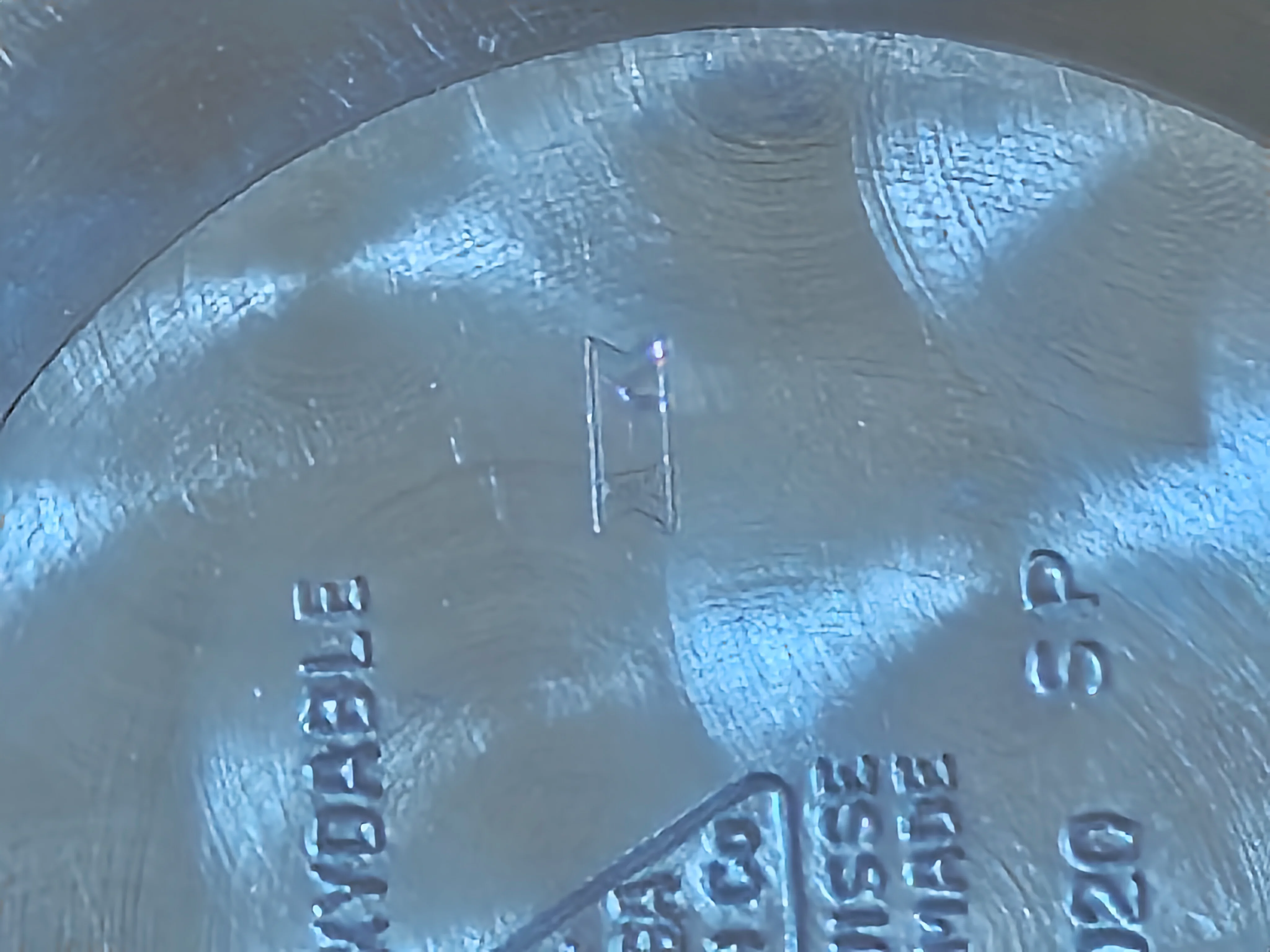

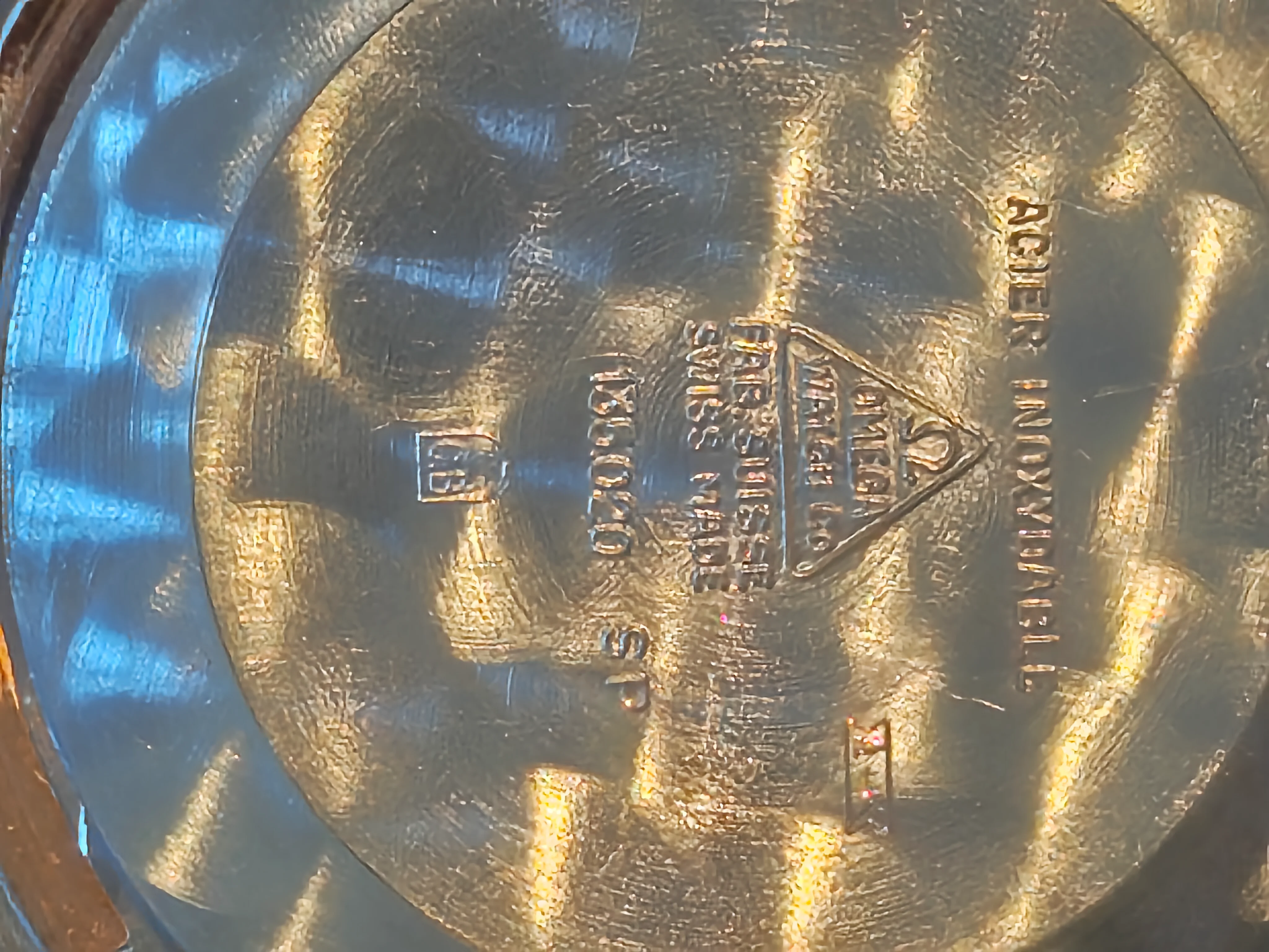

Just got this 135.020. The seller told me it was gold plated, but the inside doesn't show the typical gold plated markings. I found a stamp on one of the lugs that looks like a 585 14kt gold stamp, but I can't seem to find any info on gold stamps on lugs on omega watches. Inside I found a stamp that I cant really identify. It looks like a "A-K", but now I'm thinking it might mean "14k" or something like that. Haven't had much luck finding any info on this so any help would be greatly appreciated.
My apologies for the bad camera quality, the camera on my phone is pretty bad and I dont have any other way to make pictures at the moment. If need be, I can maybe try to get a real camera this weekend to get some higher quality images.

The A-K mark inside a case back that is stamped “acier inoxydable” (stainless steel) definitely is not a 14-K stamp! The steel back is stamped “made in Switzerland”, in which any 14 karat stamp would likely be marked as .585. I don’t have an answer for the .585 stamping on the lug. It is unusual to find a karat gold case with a stainless steel back.
3
Thats what i thought too. But i found this thread with the same stamp in which it was identified as a 14K stamp.
3

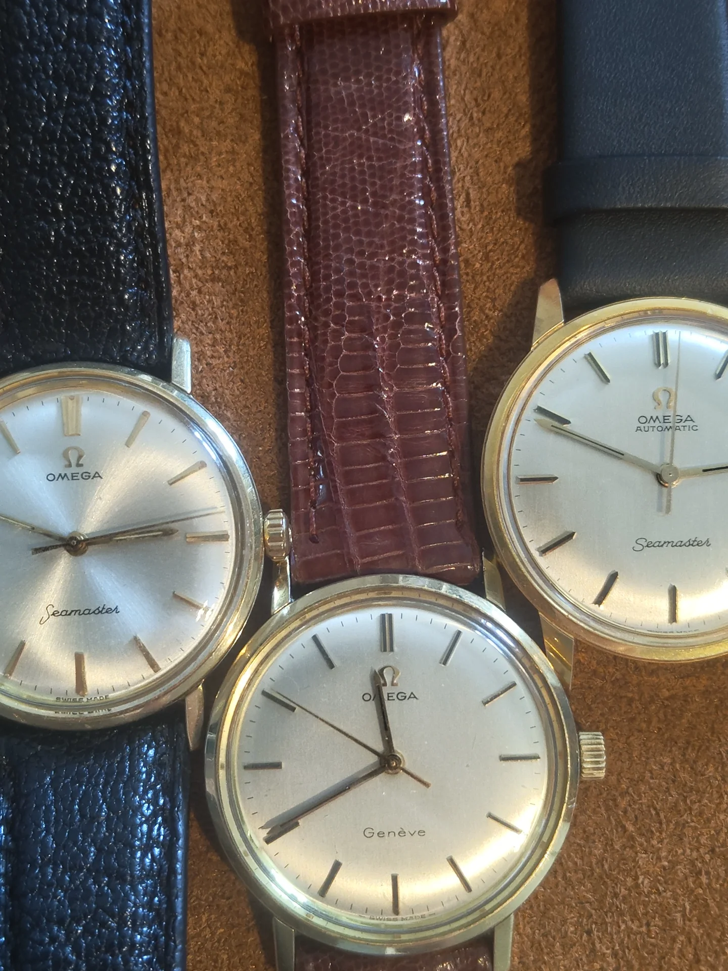

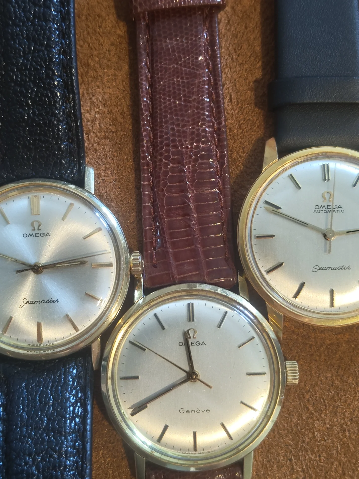

I must also add that the colour of the gold reminded me more of my other 14kt gold capped seamaster than it did of my gold plated one. See the photo i added for reference; left is my 14k gold capped, middle is the one i suspect to be gold filled, right is 40 micron gold plated.
