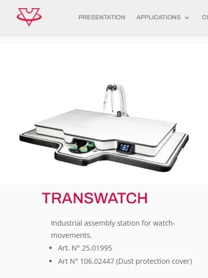

Many factories, and now service centers, use an assembly line process for assembling movements. This is called sequential assembly, and it reduces the need for skilled labour, as people can be hired off the street and trained how to do one specific set of tasks in the movement, before the movement moves onto the next workstation.
This sort of assembly isn't new - this is a video I took at a watch factory in Switzerland in 2007 - Vacheron, so a company that at the time made maybe 50,000 watches per year tops:
In this video the worker is mounting mainspring barrels on the main plate, and under that table top there are a series of conveyors that circulate the movements around to be presented at the workstation. This was an isolated workstation, so my guess is that once she had installed barrels in each watch, she would get additional parts and cycle them all through again. Not sure when they would have moved on to another station.
Having been through a lot of watch factories, they are very much like any other factory. Most of the people who work in watch factories aren't watchmakers, just like most of the people who work in an automotive assembly plant aren't auto mechanics. Most of the work is done by unskilled labour, either running machinery or doping assembly tasks that they received on the job training for. The trained watchmakers are typically only involved near the end of the process.
