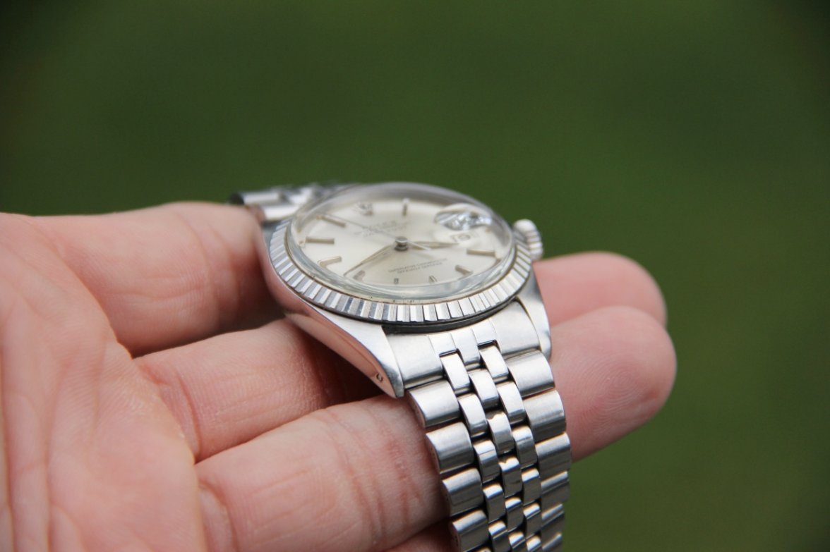

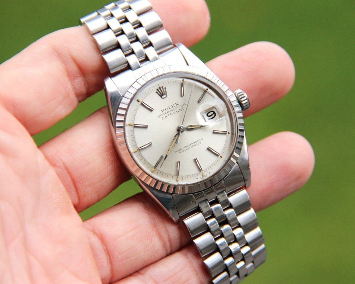

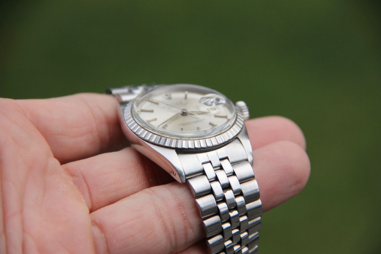

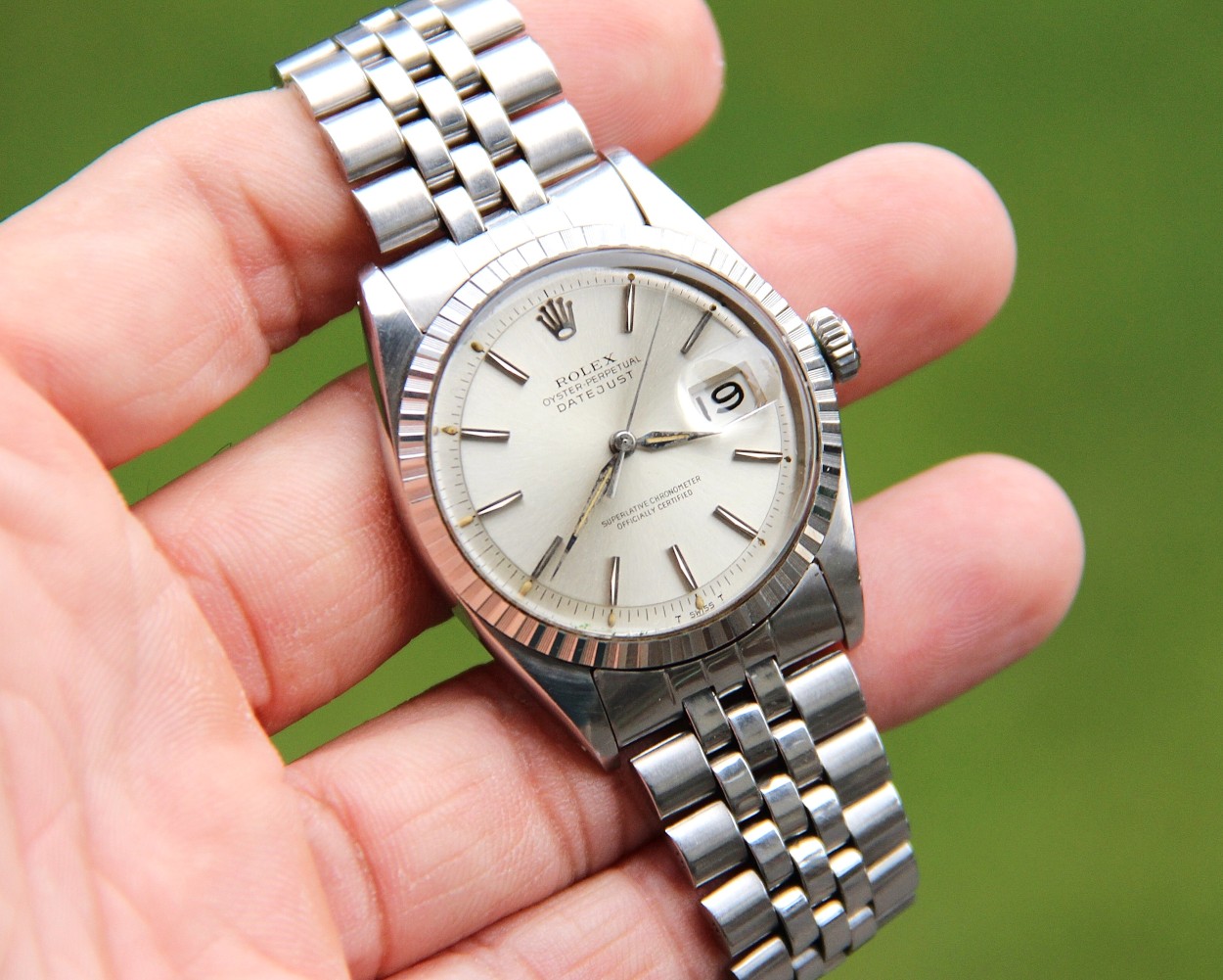

I agree in theory but in practice I've noticed that most watchmakers charge the same for manual vs automatic, but do start ratcheting up the service costs for many other complications. That said, early Rolex and Tudor autowind movements are notorious for having neither the most reliable autowind mechanisms nor availability of parts for them, so it's indeed something to be careful of. A case tube can always be replaced although not always with an original crown in many of the early watches.
Beautiful Datejust there, I much prefer those dauphine hands to the usual batons.
