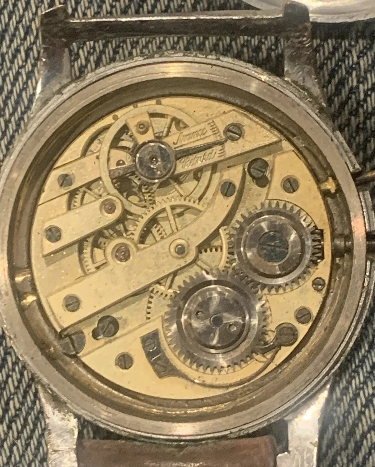

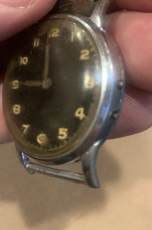

Kindly may I know which movement is that and also what function of the the crown at the 4 o'clock.

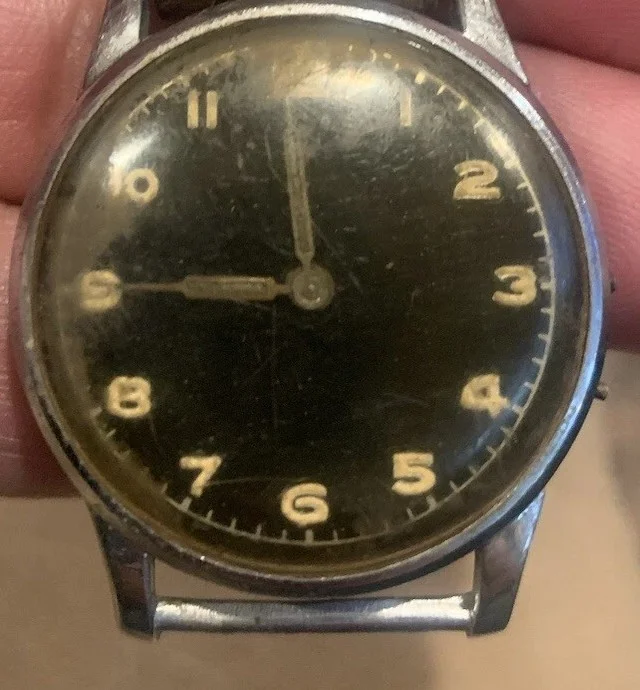

Ah, sorry Jim, please find attached

It looks like a re-cased ladies pocket watch movement, the "crown" at 4 is a push pin for setting the time.
PS: Looks like it may have a cylinder escapement as well, so possibly from the first quarter of the 20th century.
Thank you very much. I now understand , I have no experience on cylinder escapement, do you think it is original
I was searching after your clarification and it seems that Cylinder escapements are becoming increasingly difficult to service because they were largely phased out of production in the early 20th century
