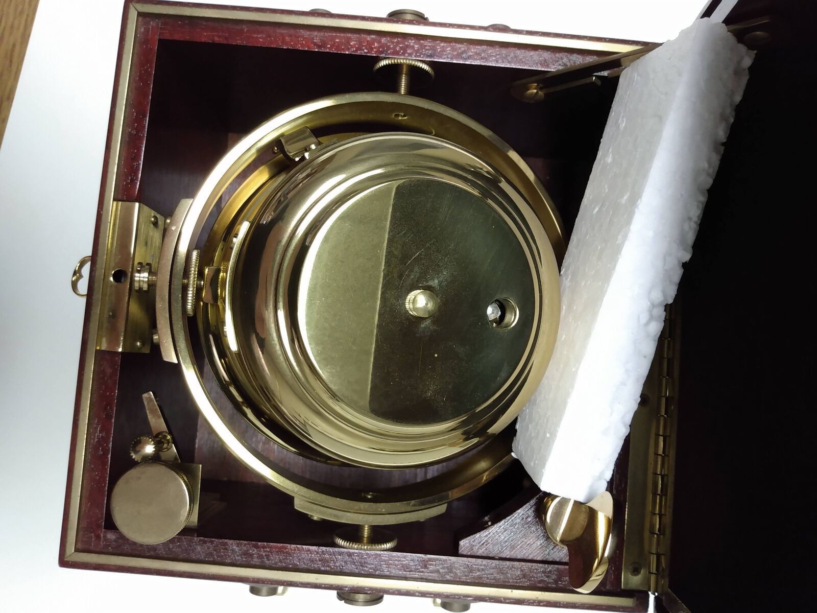

The main issue is that it is pretty hard to find a good model 21 that hasn't being abused or neglected. The very few in good state are a bit over my budget.

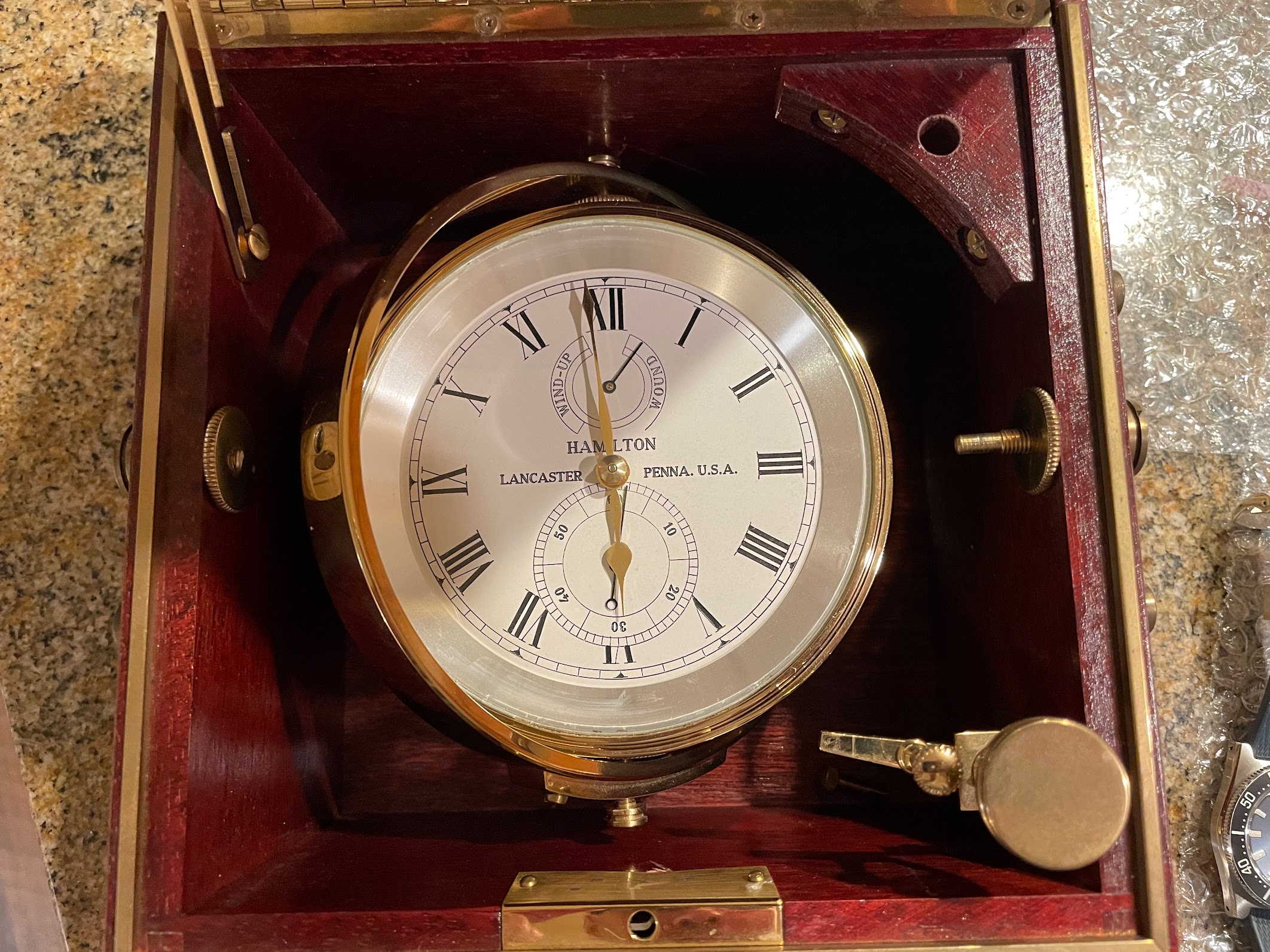

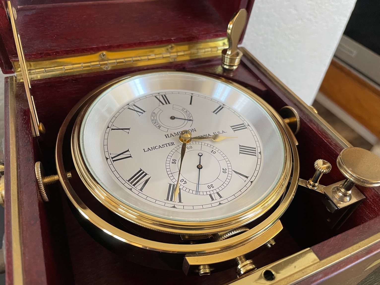

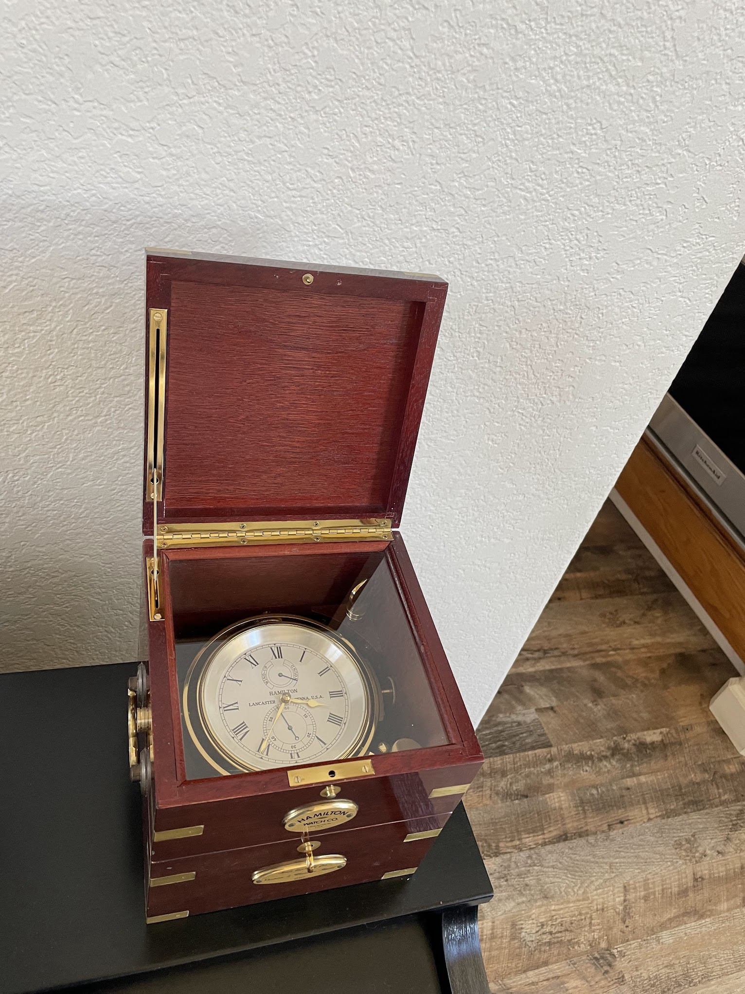

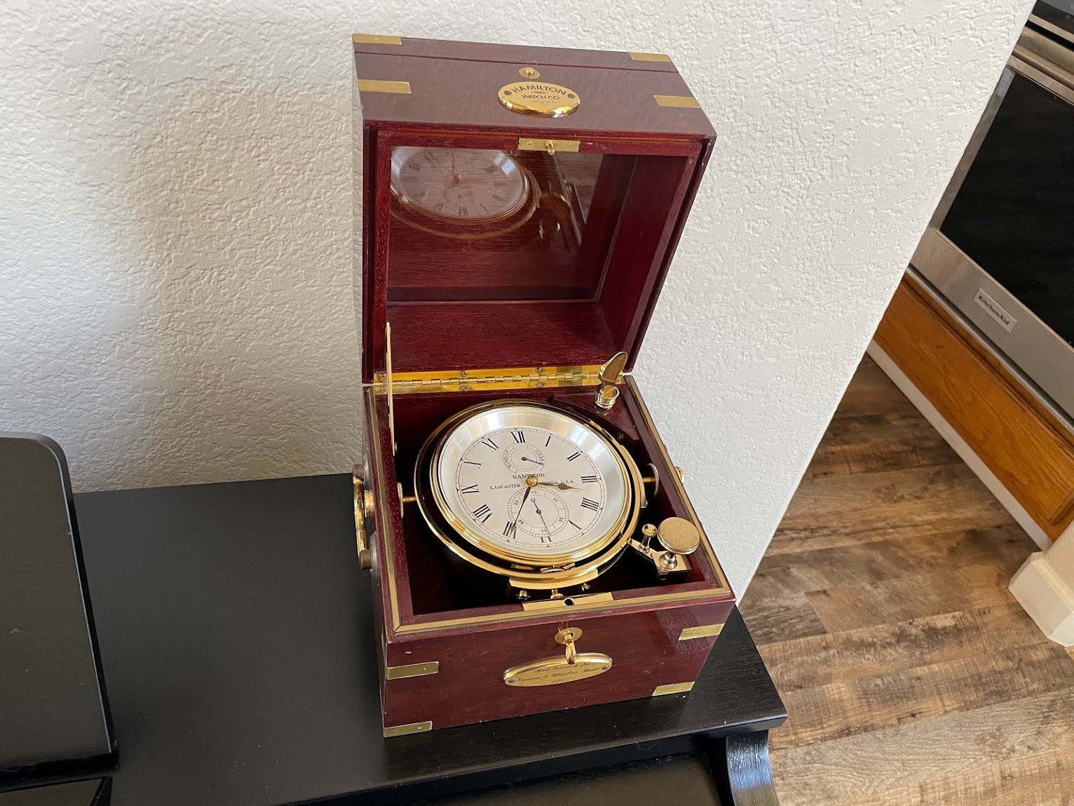

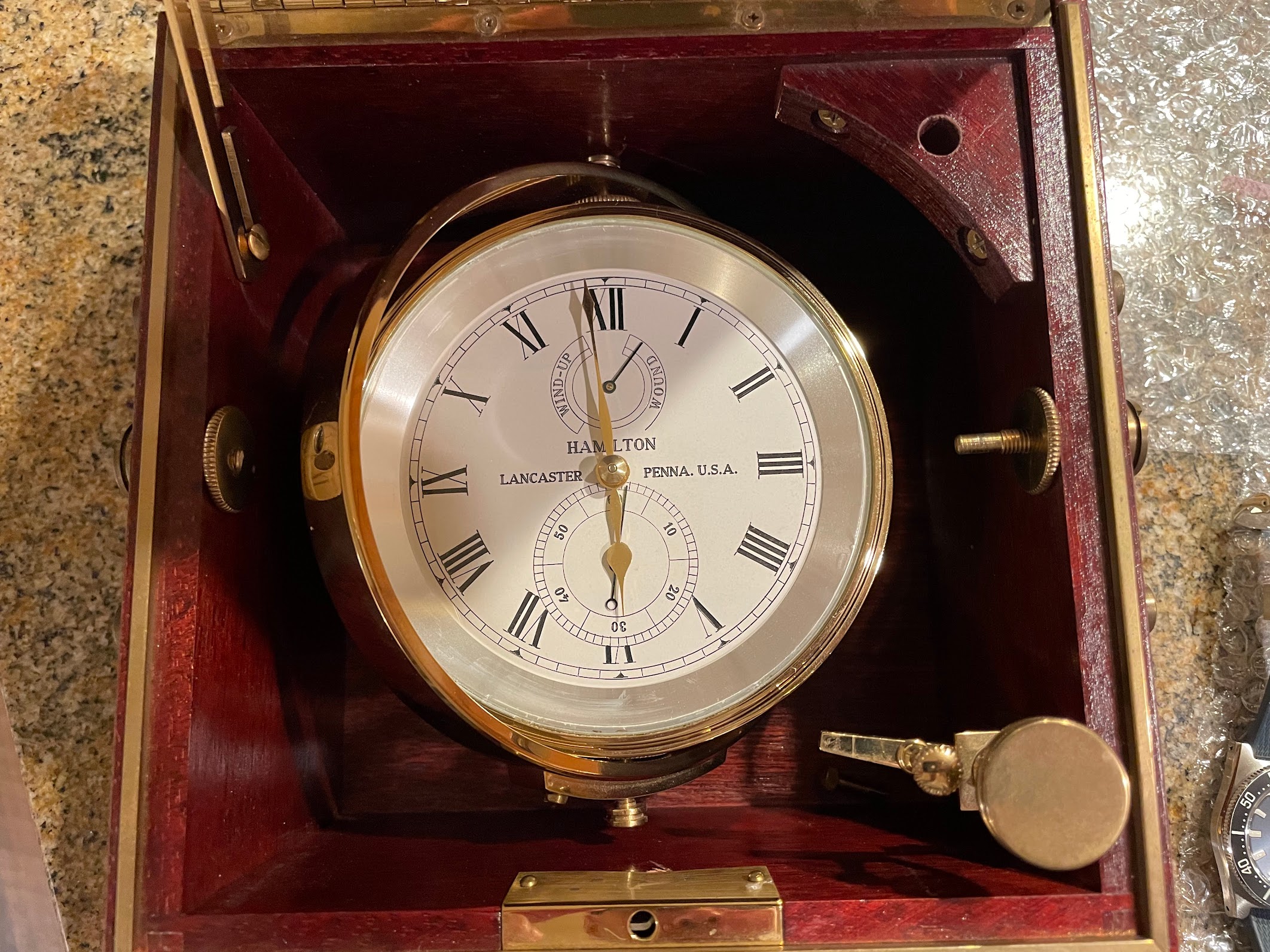

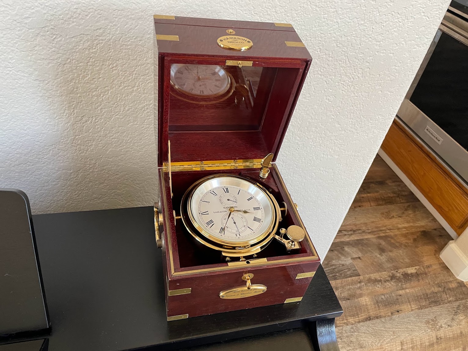

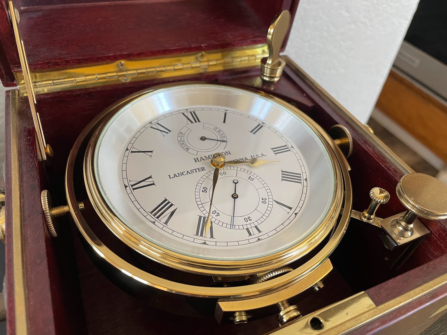

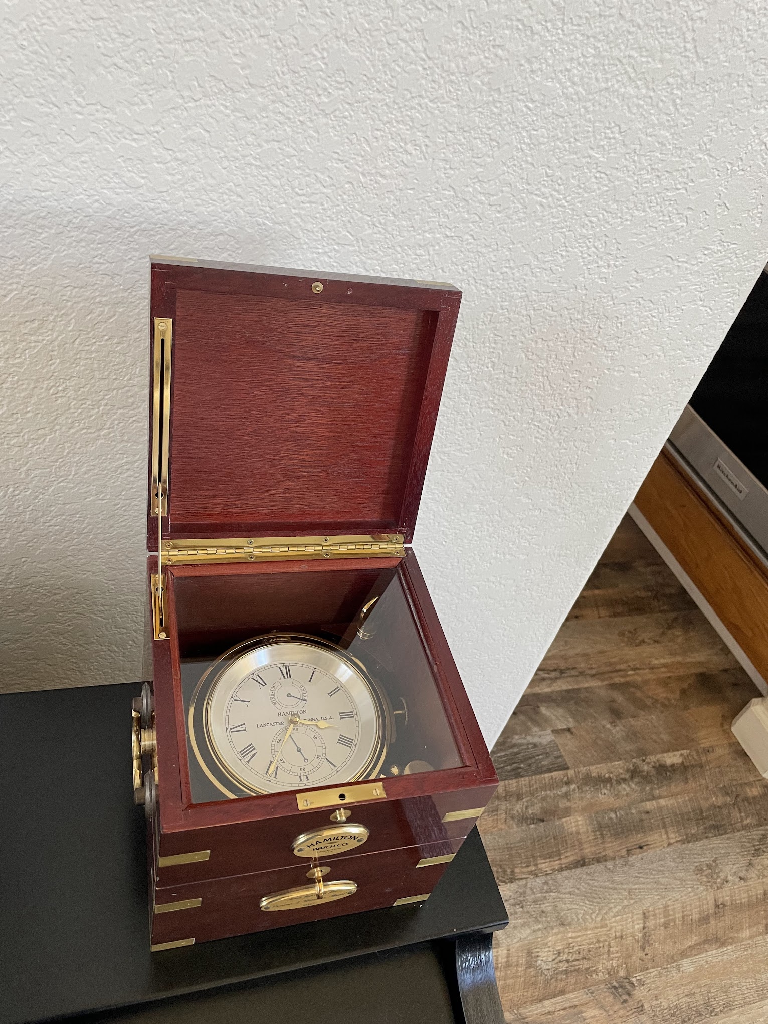

Looking on EvilBay I chanced on a ad that listed a 'Hamilton Model 21 Tribute edition'. It looked in pristine state and the price was low, so I decided to pull the trigger.

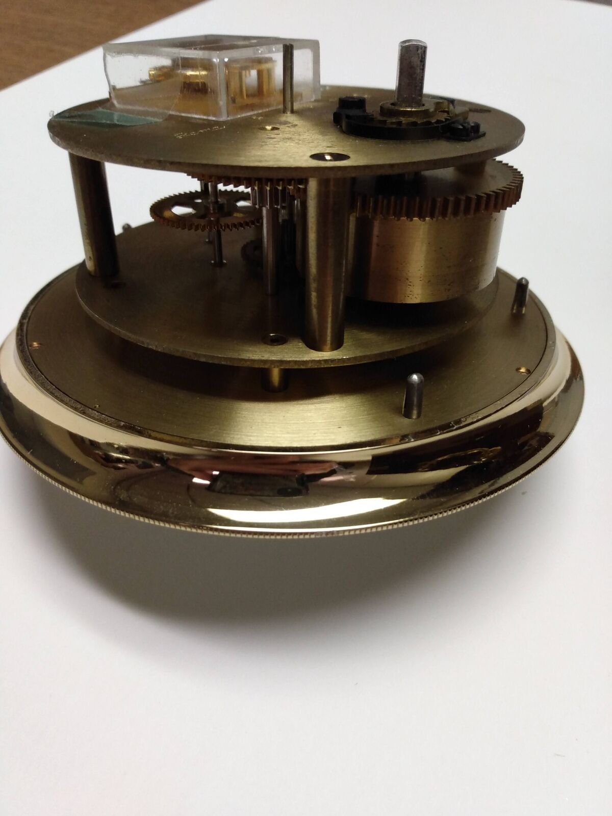

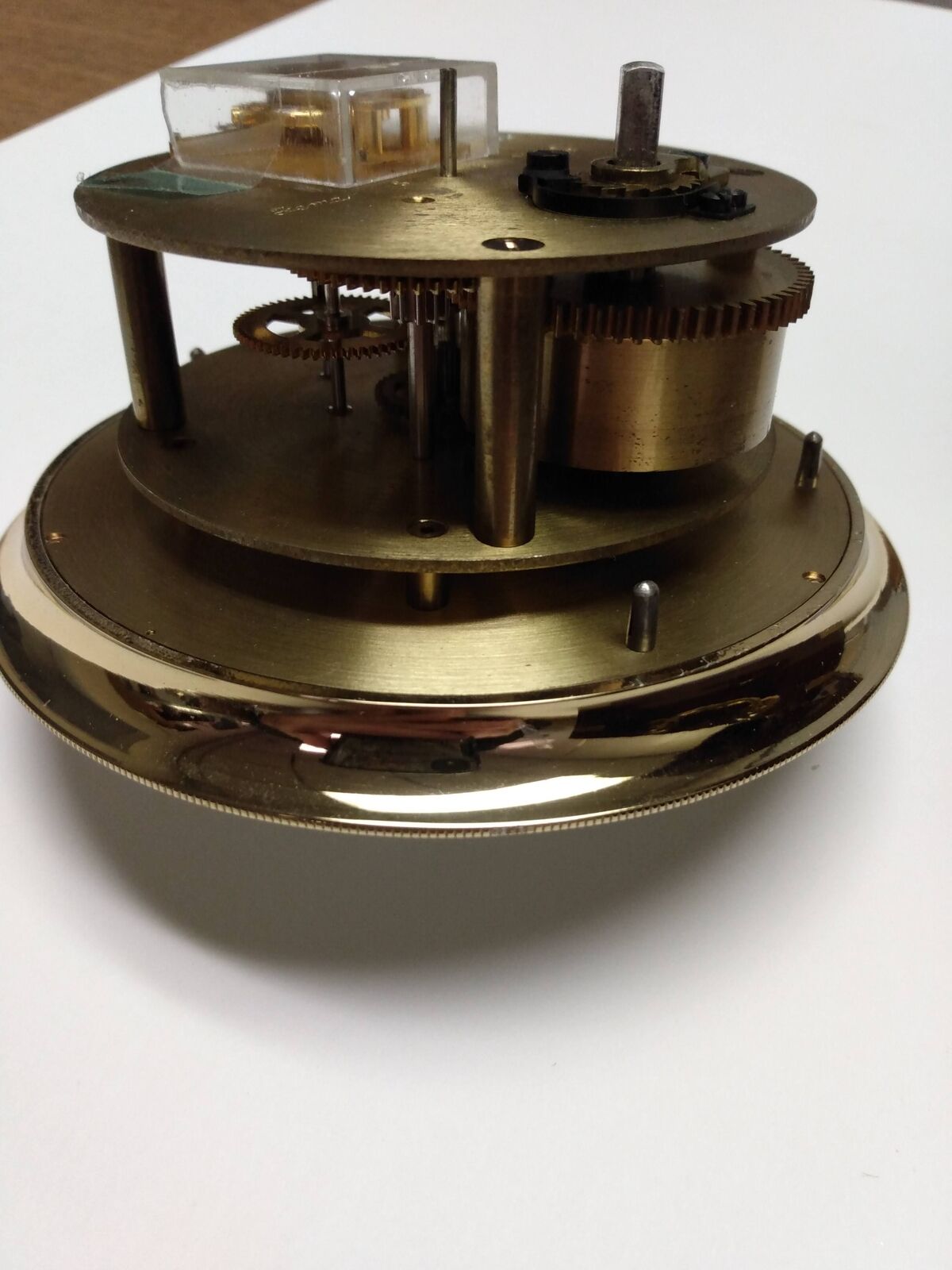

Performing some research (after the fact), to my surprise I learned that I bought a clock made in the 80's. Apparently this 'Tribute edition' was a limited edition made by the then going bankrupt Hamilton.
It features a small plate on its front with a dedication for the original purchaser and serial (in my own it is '090', but I'm unsure how many were made).
Its movement is *not* a marine chronometer (i.e. no detent or fusee), but instead swiss lever escapement. It apparently was made by a manufacturer called 'FEMA' in the UK and has a power reserve of I believe 8 days.
I decided to keep it, it looks pretty cool and its an odd piece. There was an issue with postage where one of its mounting bolts were damaged, but I managed to find a really nice enthusiast watchmaker near my neck of the woods that manufactured new bolts (since their dimensions are *not* the same as the ones in the original Model 21 from the 40's).

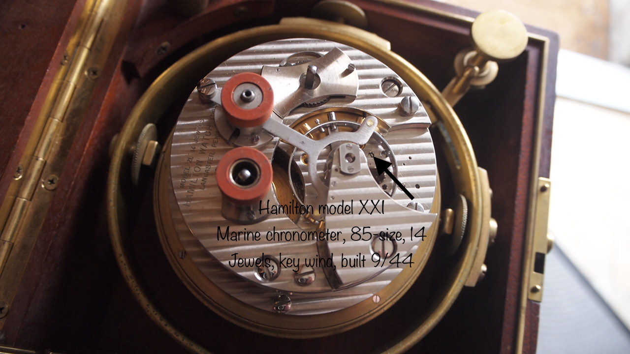

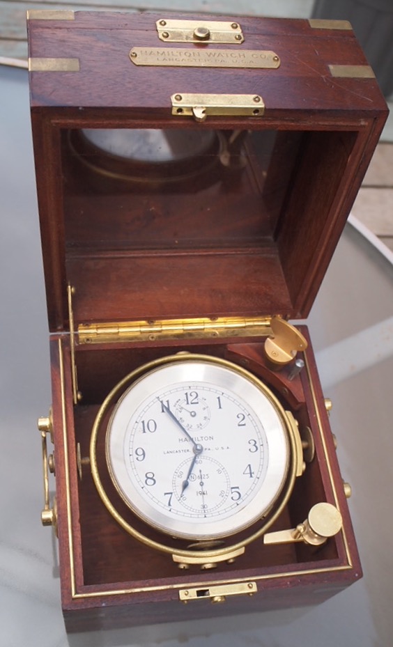

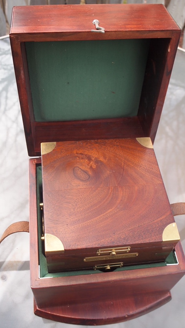

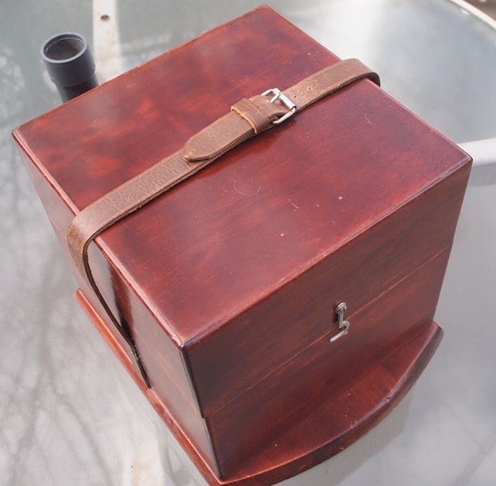

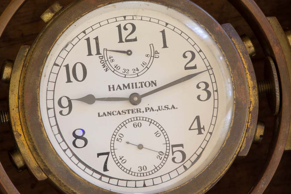

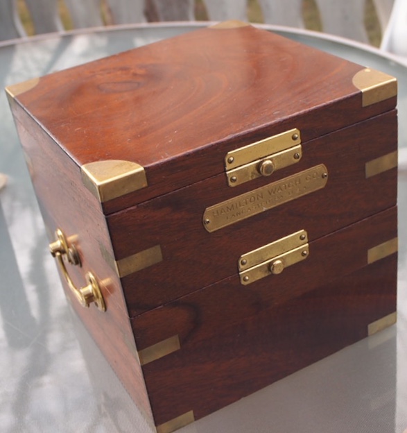

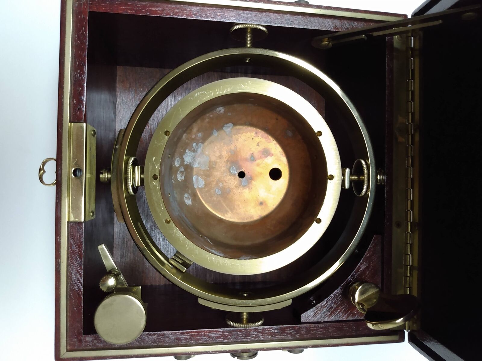

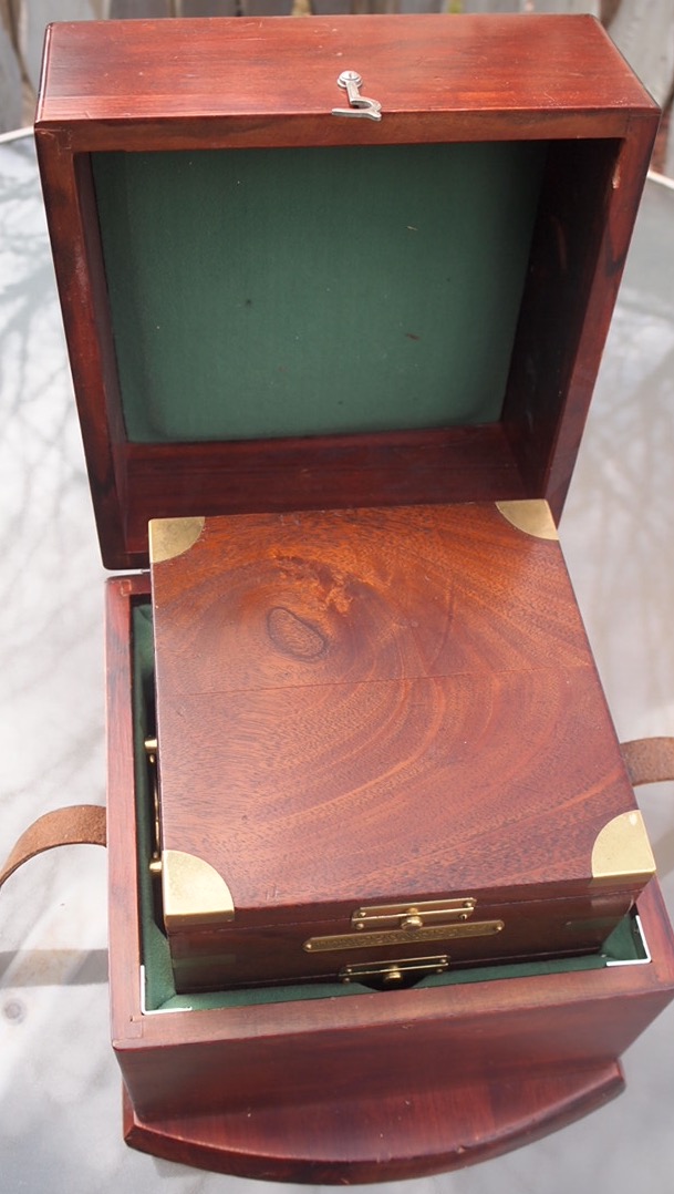

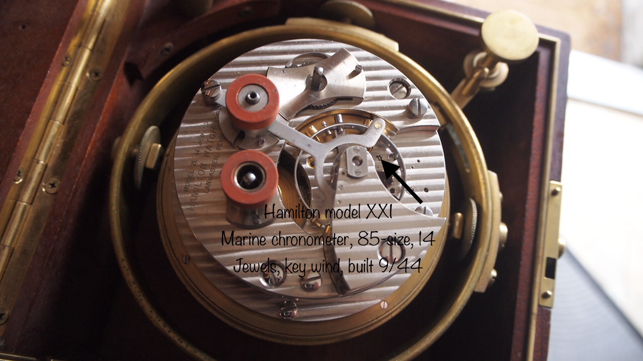

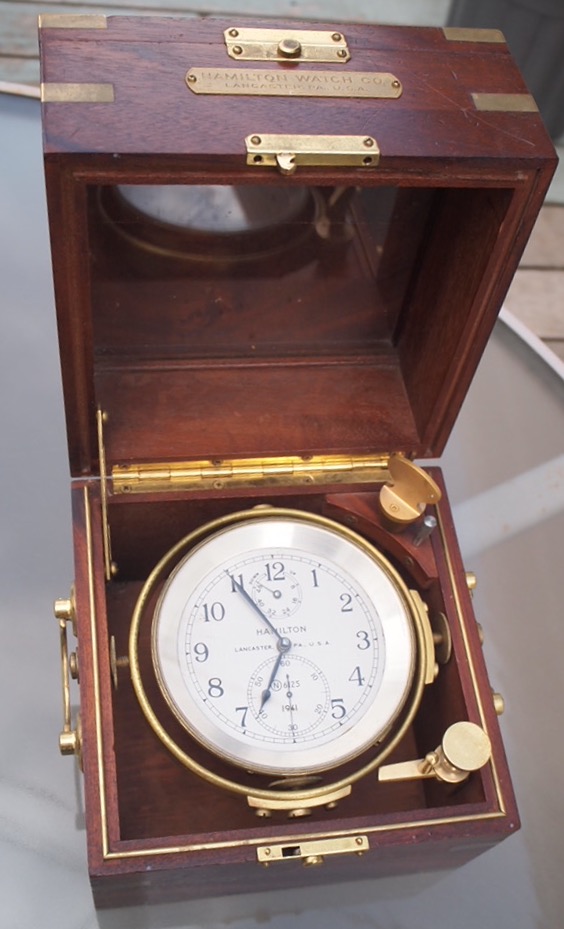

Serial # 6125 (September, 1944) sends salutations. These are a treat to own. A 52-hour reserve, 14-jewels, fusee, Earnshaw (dead-beat) escapement, 14,400 bph, key wind, key set, helical (elinvar) hairspring, free-sprung, mahogany cases by Heintzman Piano Co. The contract was awarded to Hamilton in 1941, but the first production model wasn’t delivered until early 1942. Elgin and Waltham were also bidding for the contract. I have seen pictures of the Elgin chronometer.
(Edited to correct “palladium” to Elinvar, and date changed to 1942.)

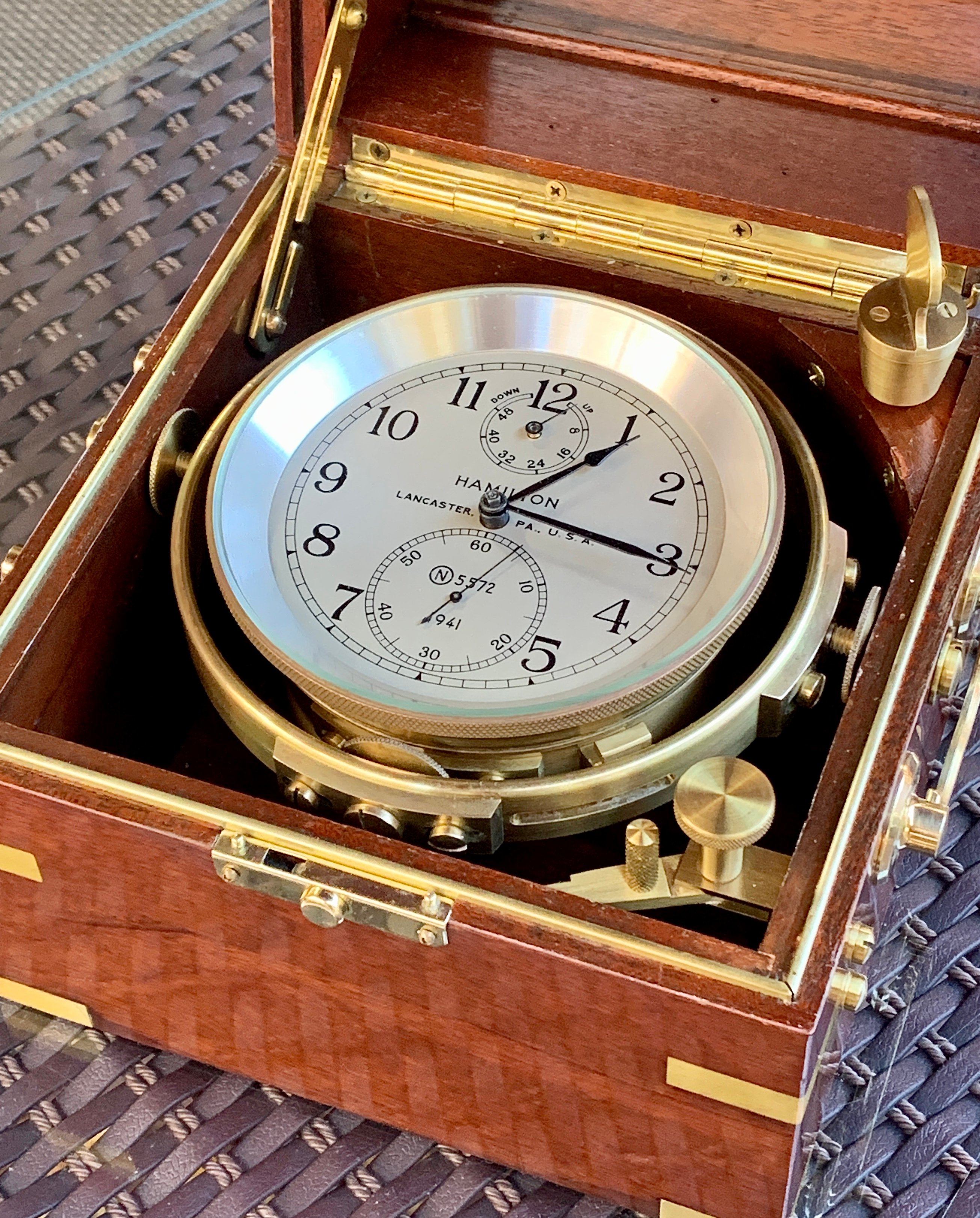

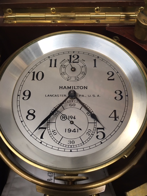

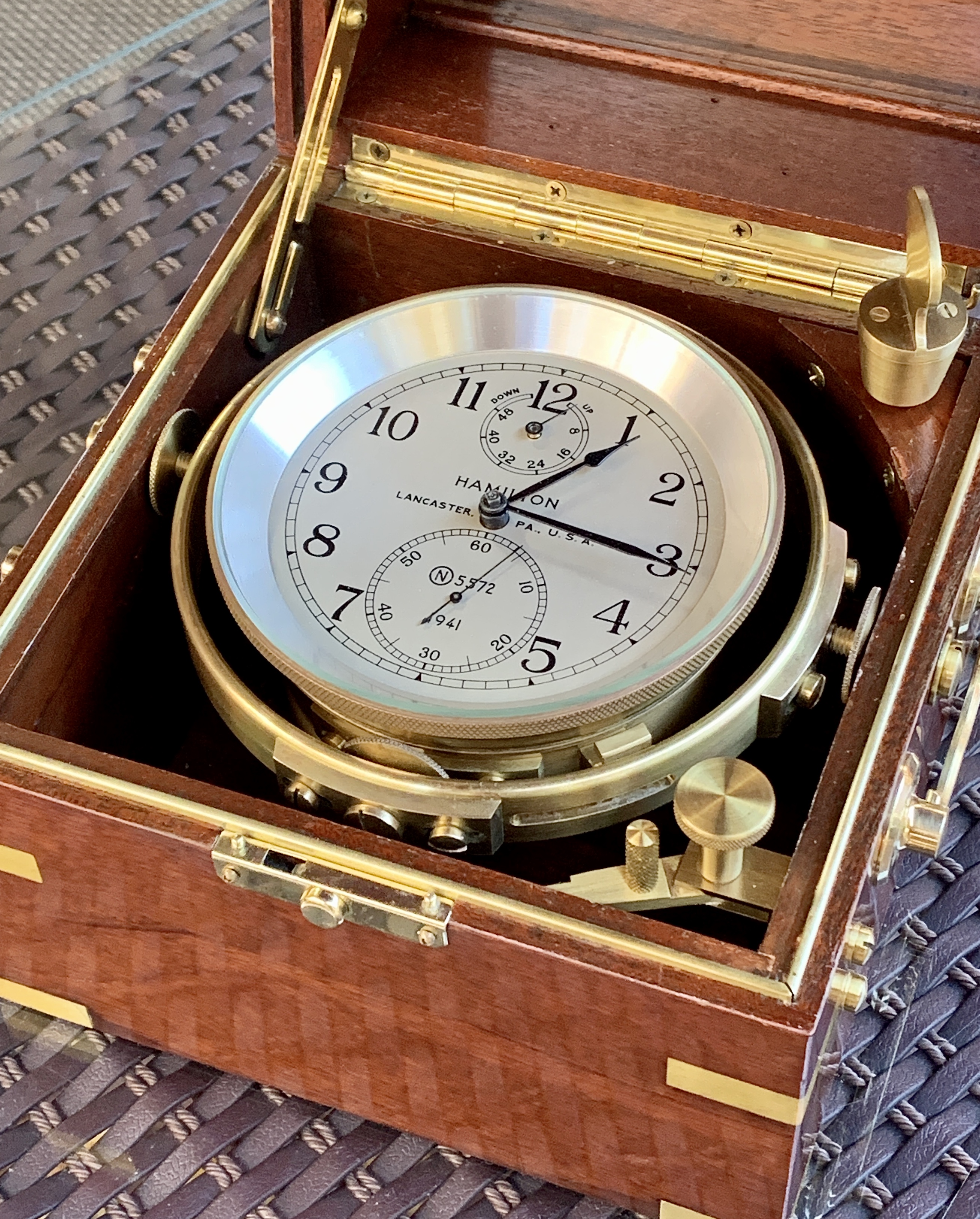

Mine. #5572
Hamilton Model 21 video of the detent action. Regular video frame rate for the first 14 seconds. Slo-mo after that. Notice the detent and escape wheel do not appear to be moving at the regular frame rate.
16,002
48,156
@Deafboy is very modest. About two years ago, or so, I received a PM from him regarding servicing a Hamilton model XXI, the chronometer in his post. He had happened upon several posts of mine on the OB concerning my XXI, and he was planning on servicing his. He had questions.
Over a period of a month or three, we PMed back and forth while he carefully followed the directions in the service manual. He completely went through the movement, and restored the case to the glory you see in the photos. I don’t know what @Deafboy ‘s background is, and what exposure he has had to projects such as servicing a model XI, but I gather this was a first for him. His addition to this thread reminded me of our earlier communications, and I must say that he has done a remarkable job, considering this was his first experience with servicing a model XXI. Well done!

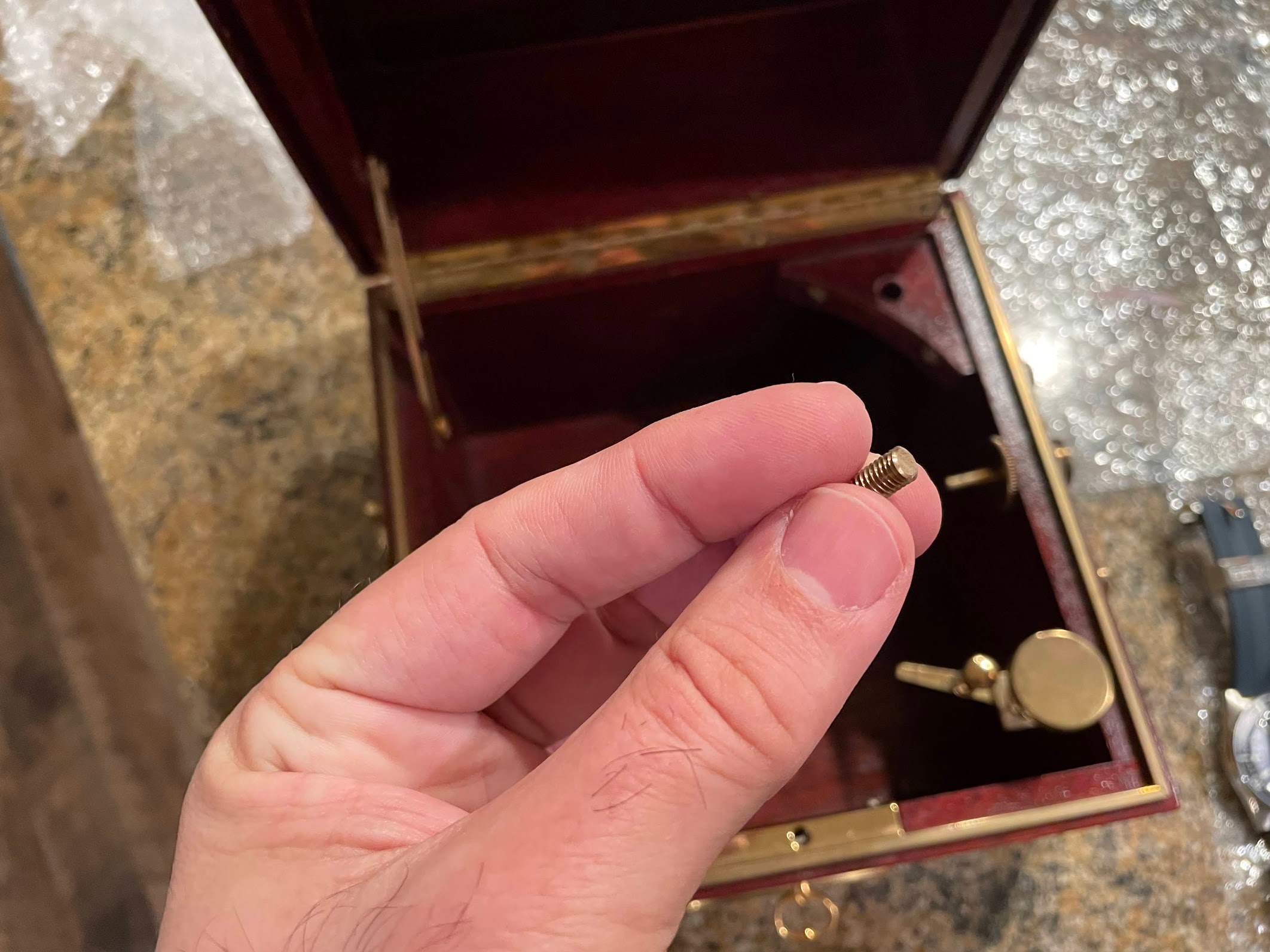

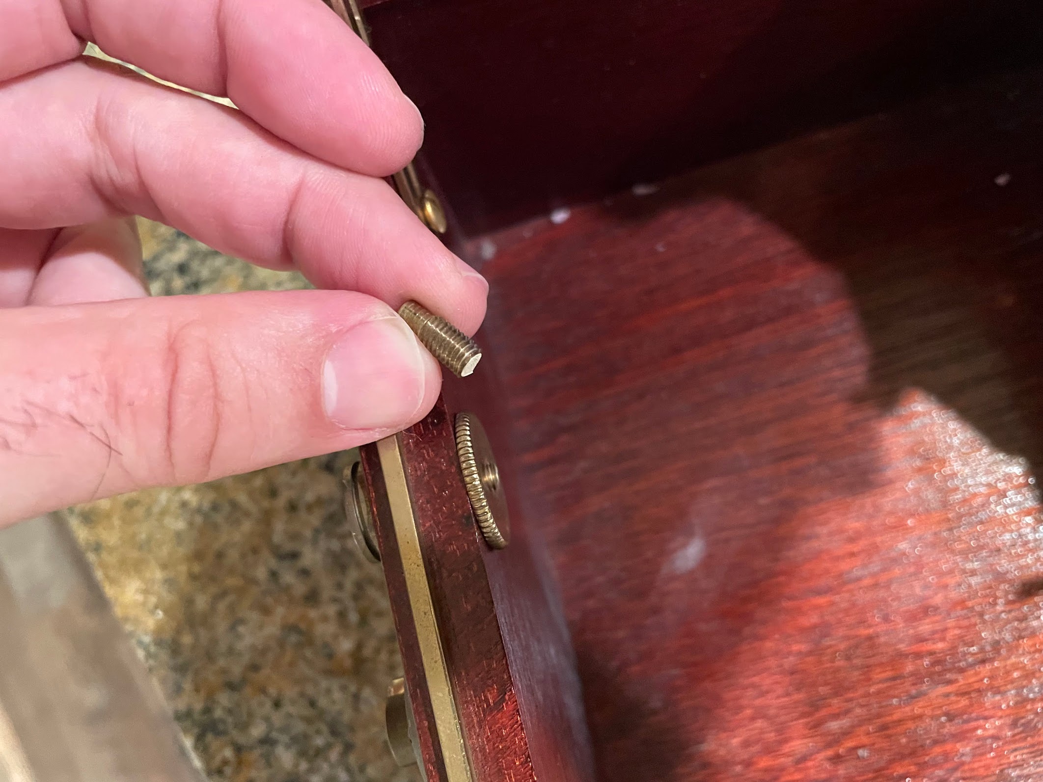

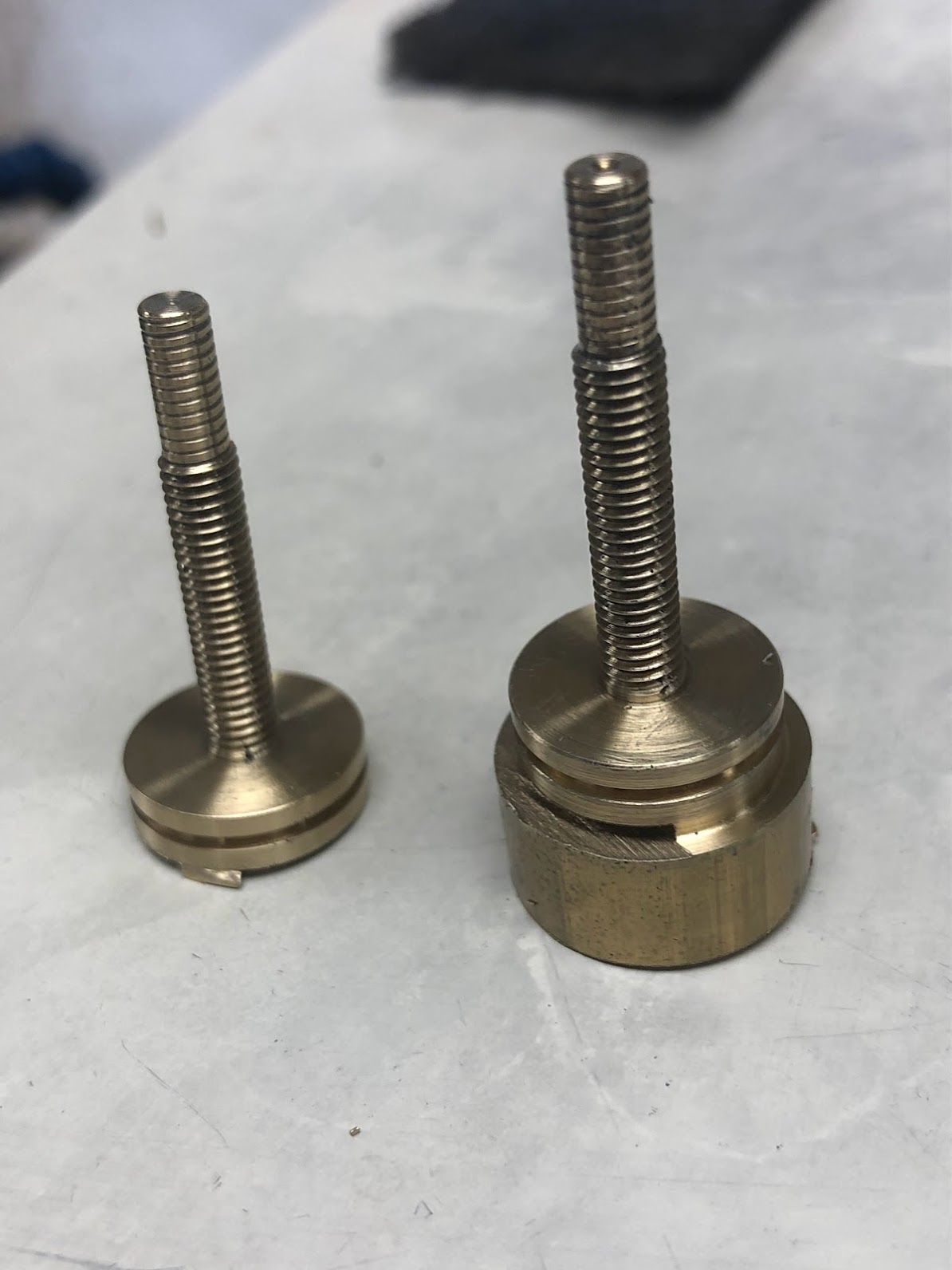

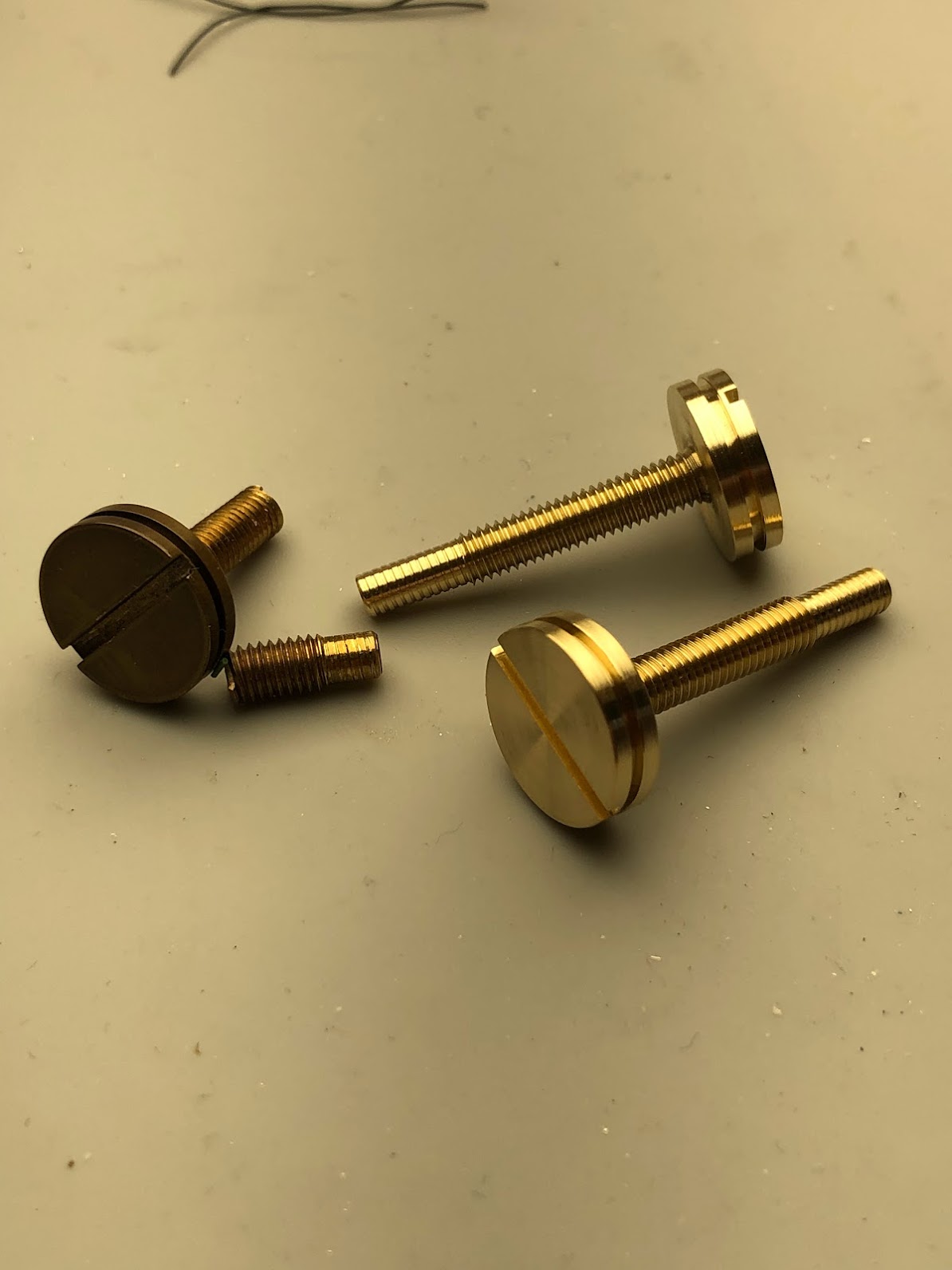

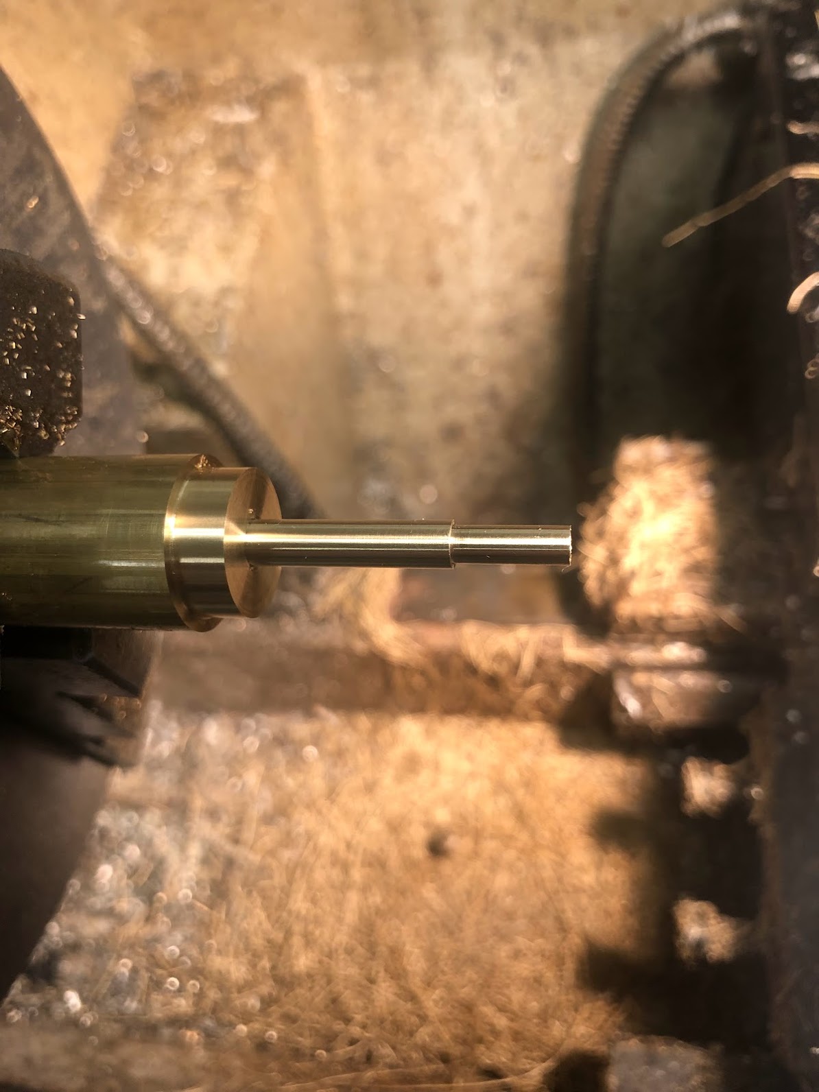

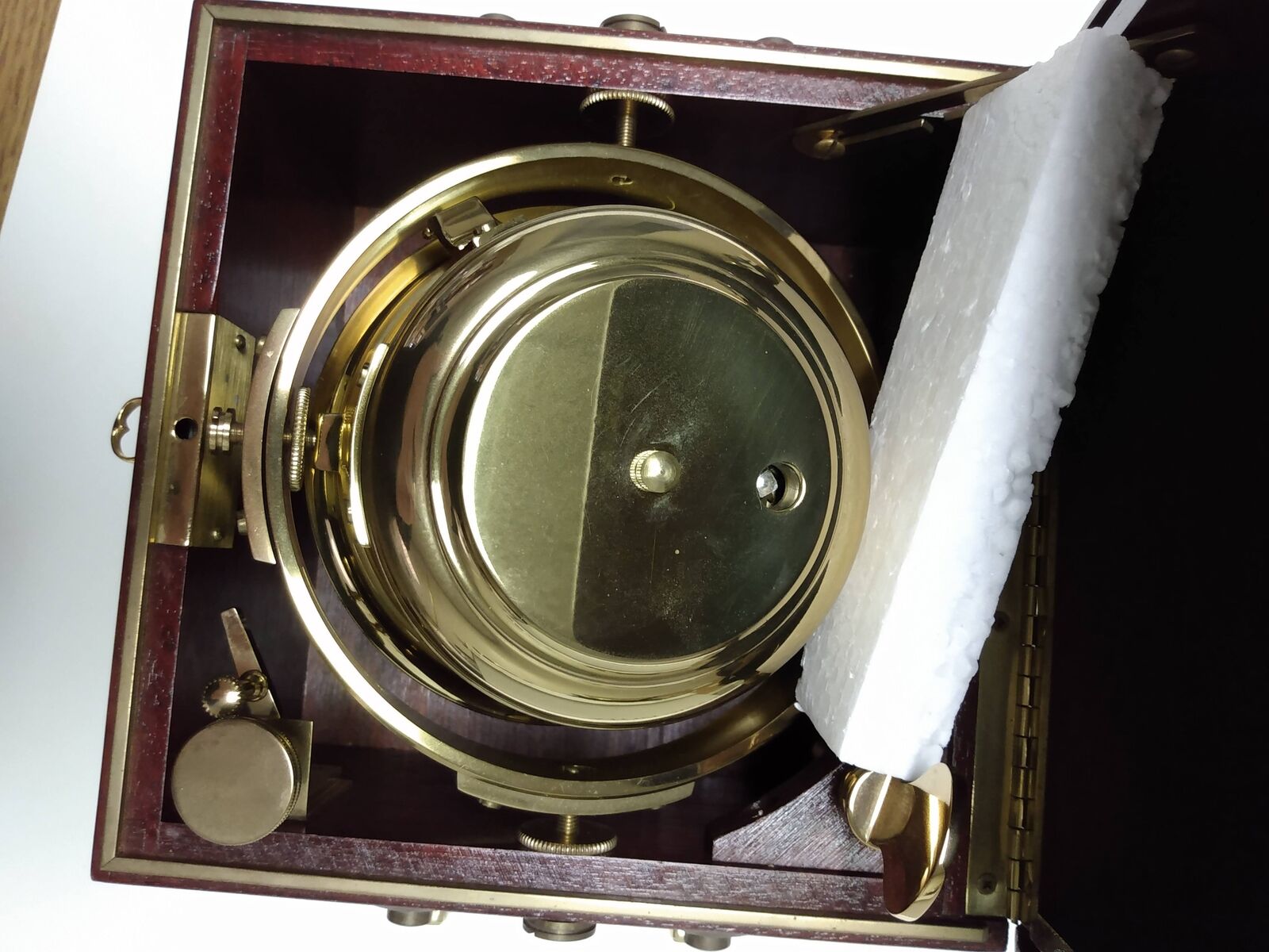

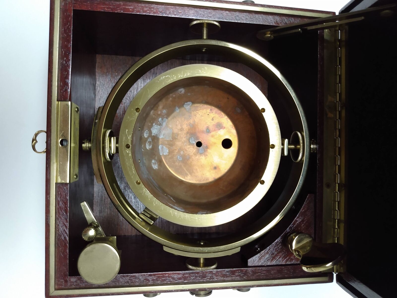

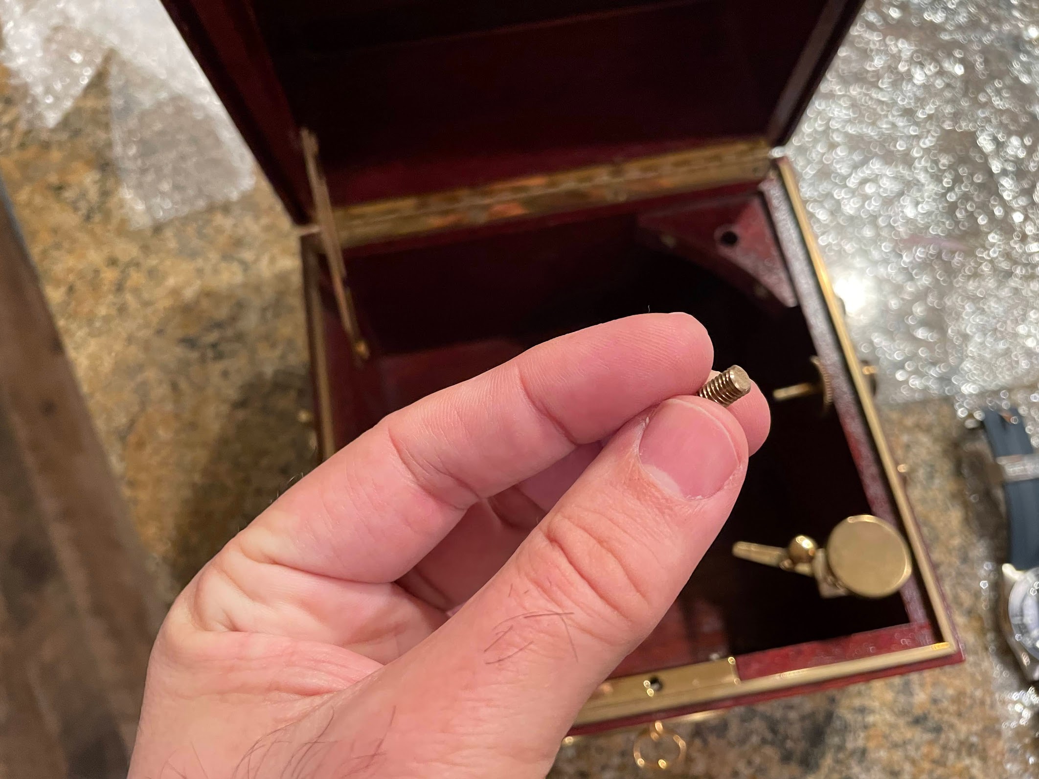

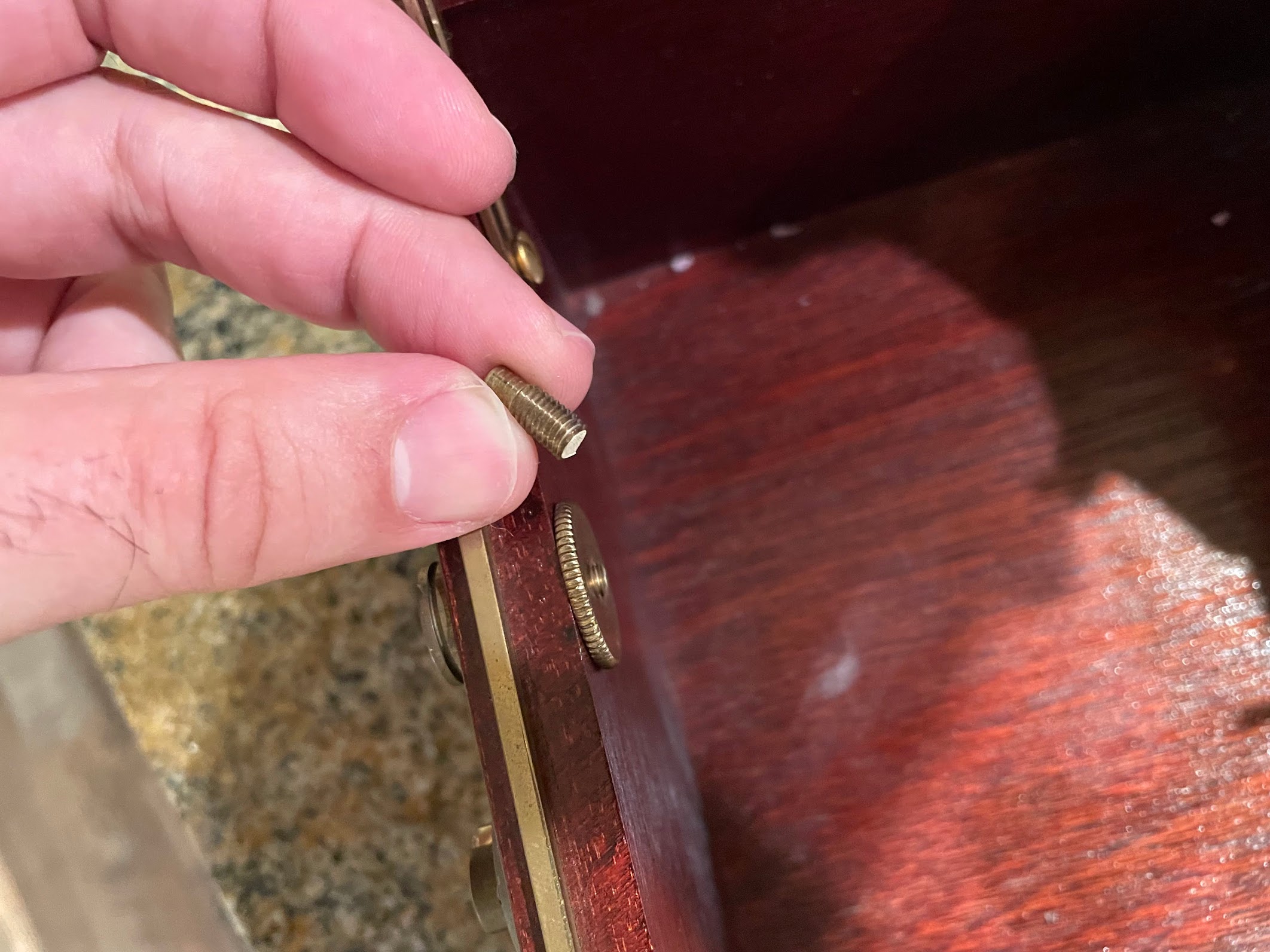

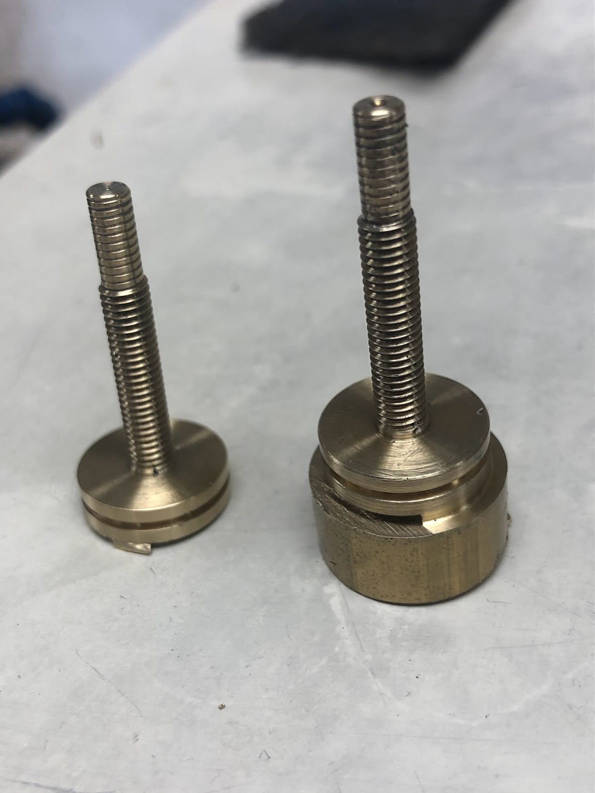

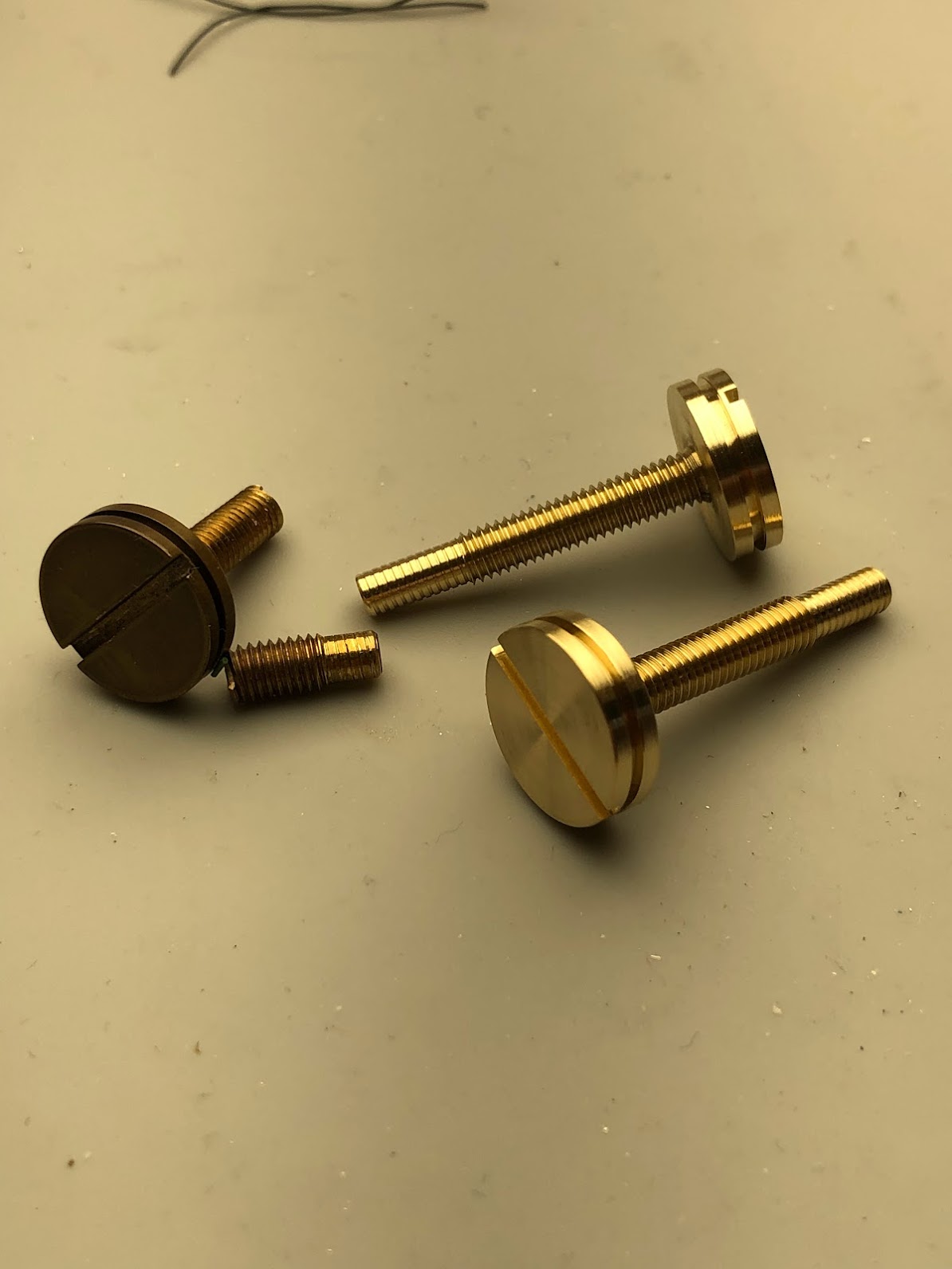

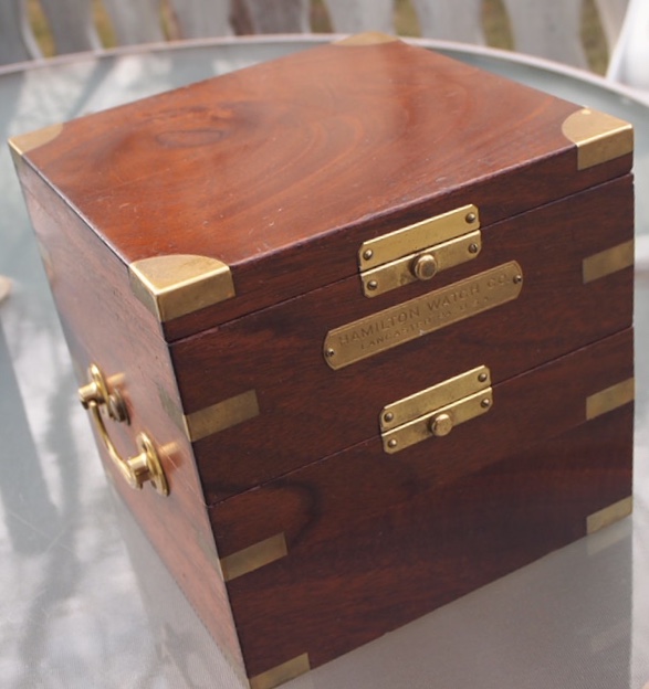

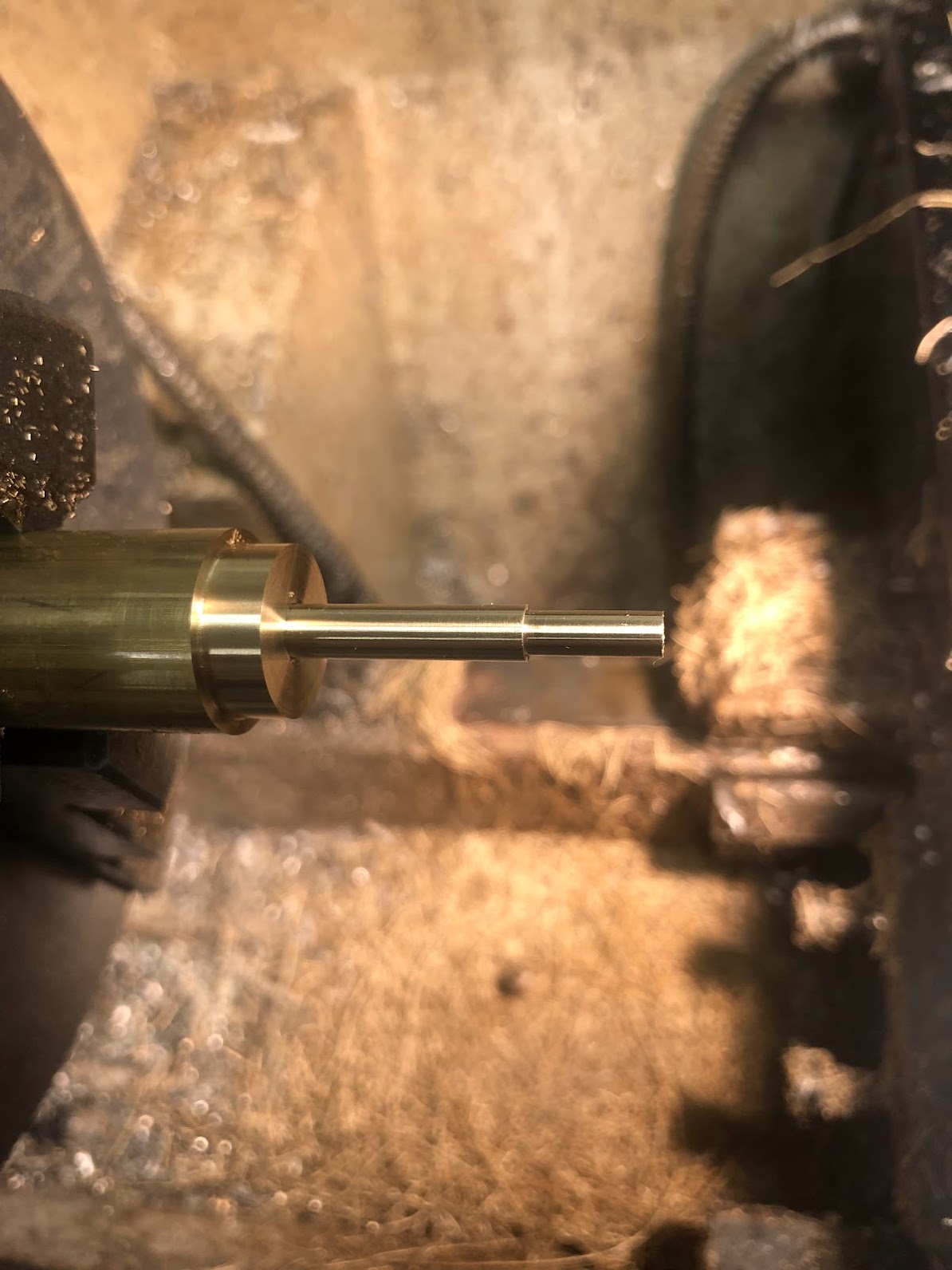

As I mentioned in the first post, there was an issue with one of the bolts that mount the clock in its case (it was damaged during the transport).
After considering what to do (should I send the clock back?), my wife suggested that it looked so nice so why not try to fix it?
444
753
I initially bought some bolts from an original Hamilton Model 22 from the 40's, but they didn't fit.
So I reached out to a fine gentleman that is a watch enthusiast and aspiring watchmaker based here in California, explained what was the issue and sent to him the broken bolt after sharing some photos.
He started making the bolts based on photos and finished them after receiving the broken one to verify what was the thread of the originals.

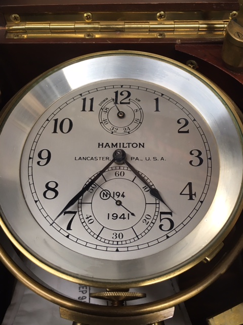

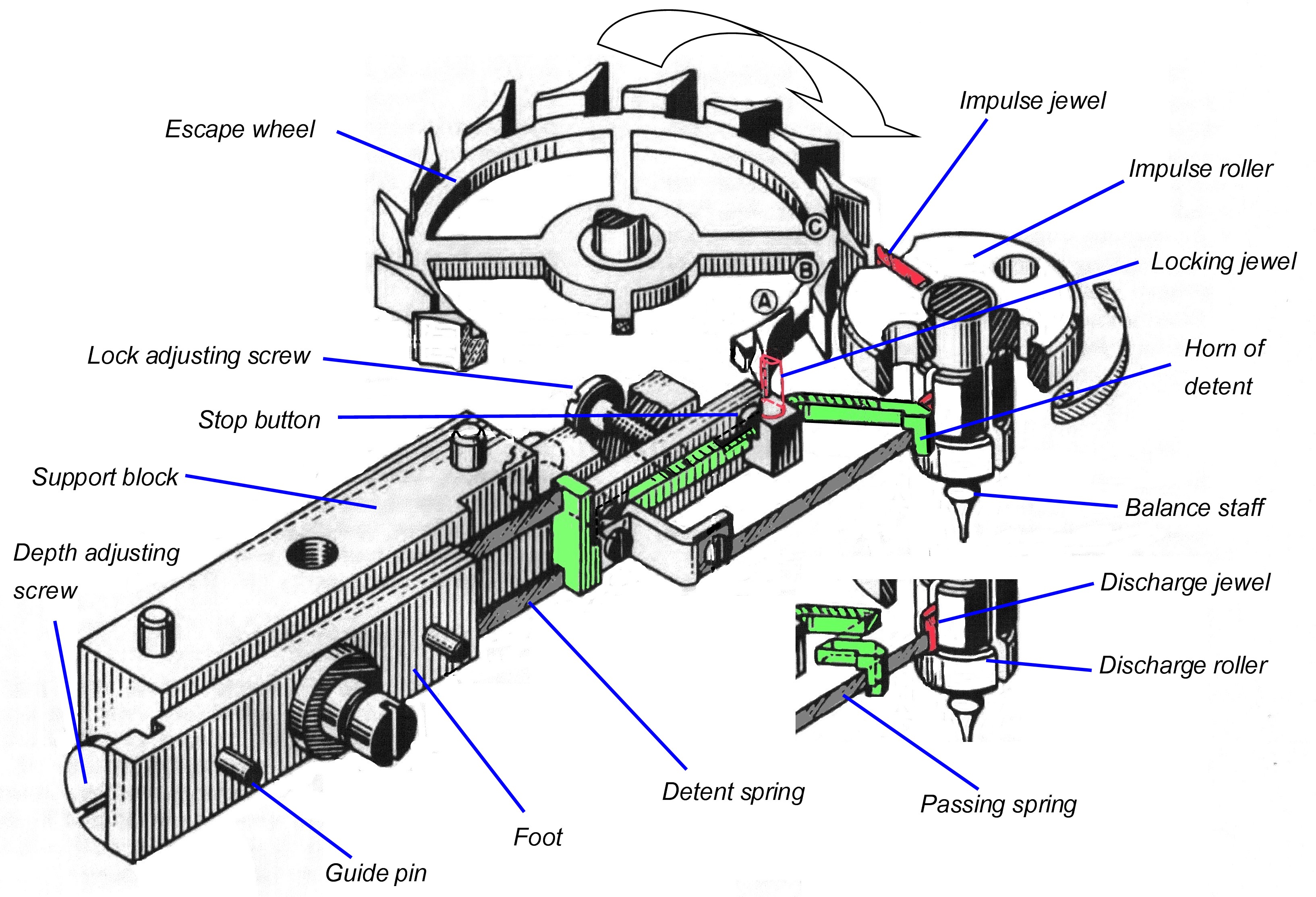

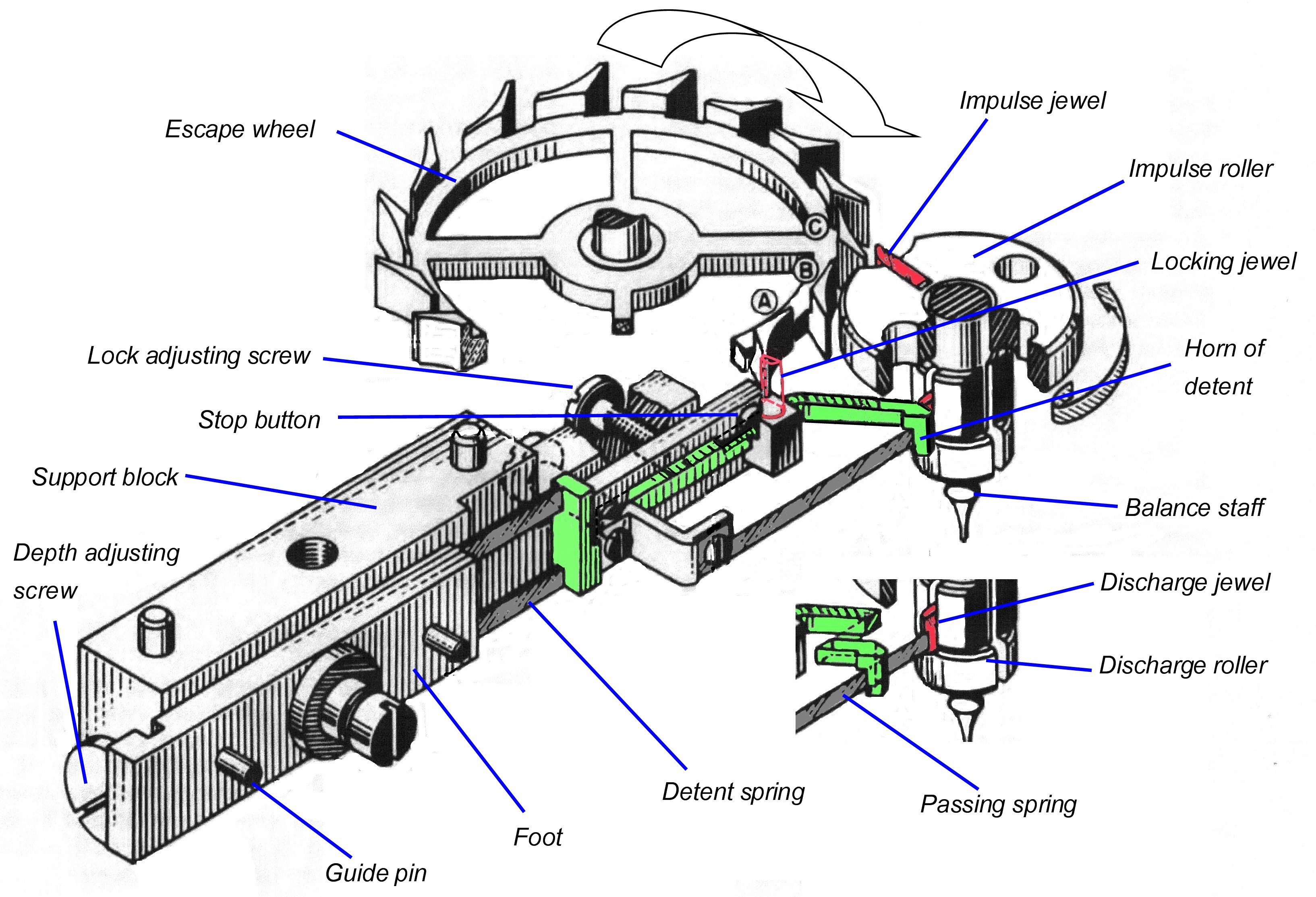

The Hamilton model XXI detent block and associated components wasn’t made by Hamilton. If I recall correctly, it was produced for Hamilton by a St. Louis Miss. retail jeweller. Apparently, Hamilton had problems producing this very vital component.
1,372
2,001

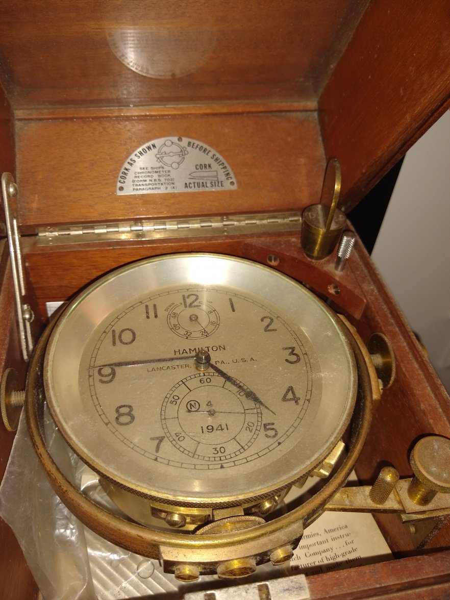

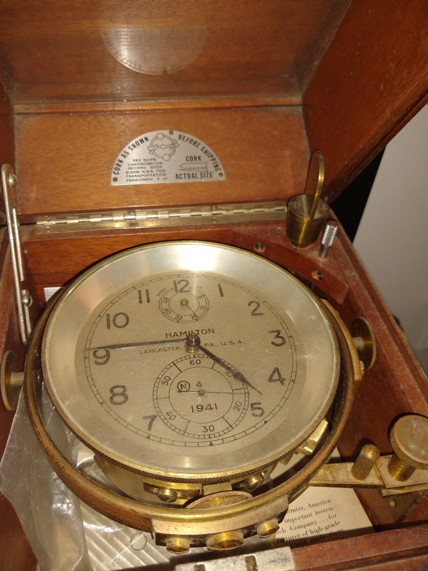

It's still a pain in the ass to manufacture, if the color of the air in my watchmaker's shop is any indication. 😁
Unfortunately, I don't have a better picture as it's back with my parents, they being settled in their new house now.
16,002
48,156
WOW! Serial number FOUR! How is it that this one is not n a museum, somewhere? Outstanding! According to Marvin Whitney, serial number 4 was one of the model XXI chronometers delivered to the navy in May of 1942.
1,372
2,001
Government surplus sales are a funny thing.
It will end up in a museum eventually, but my parents and I like having it around for now.
